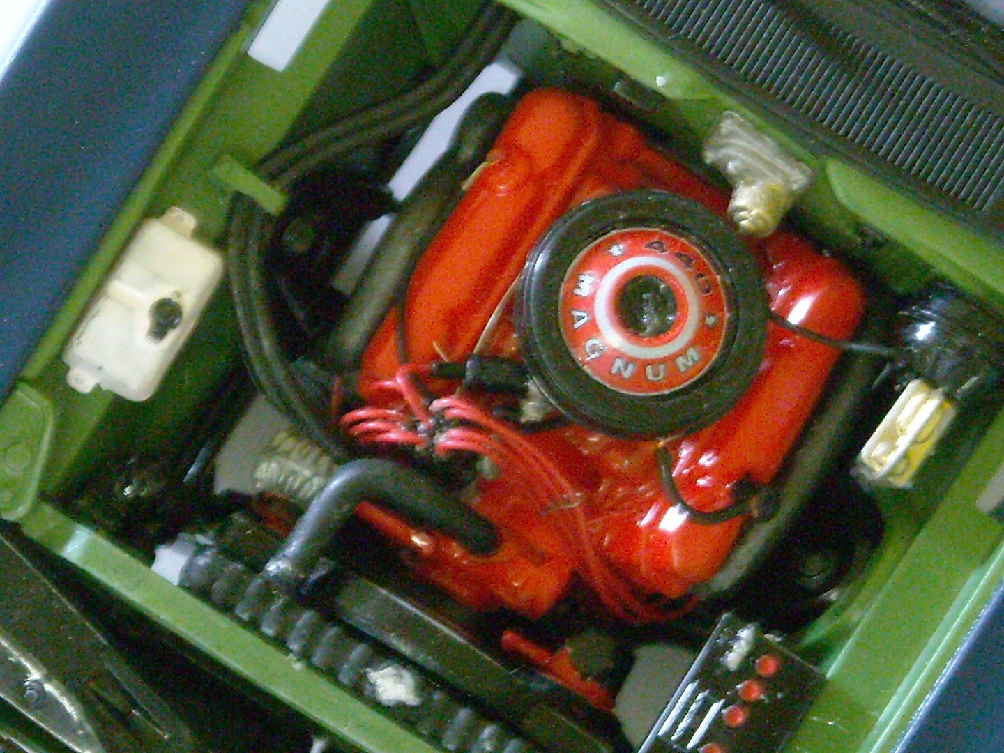

Kit Basher Posted February 10, 2014 Posted February 10, 2014 (edited) You're right, that decal is a bear to get down. Micro Sol may work, I didn't have any to try. Micro Set wasn't enough. The advice I got on this forum is use a rag soaked in very hot water to push the decal down. That helped a lot, tho I still had a few wrinkles. If I did it again, I think I would cut out the center of the decal (where the wingnut is) before soaking the decal in water. Edited February 10, 2014 by Kit Basher
