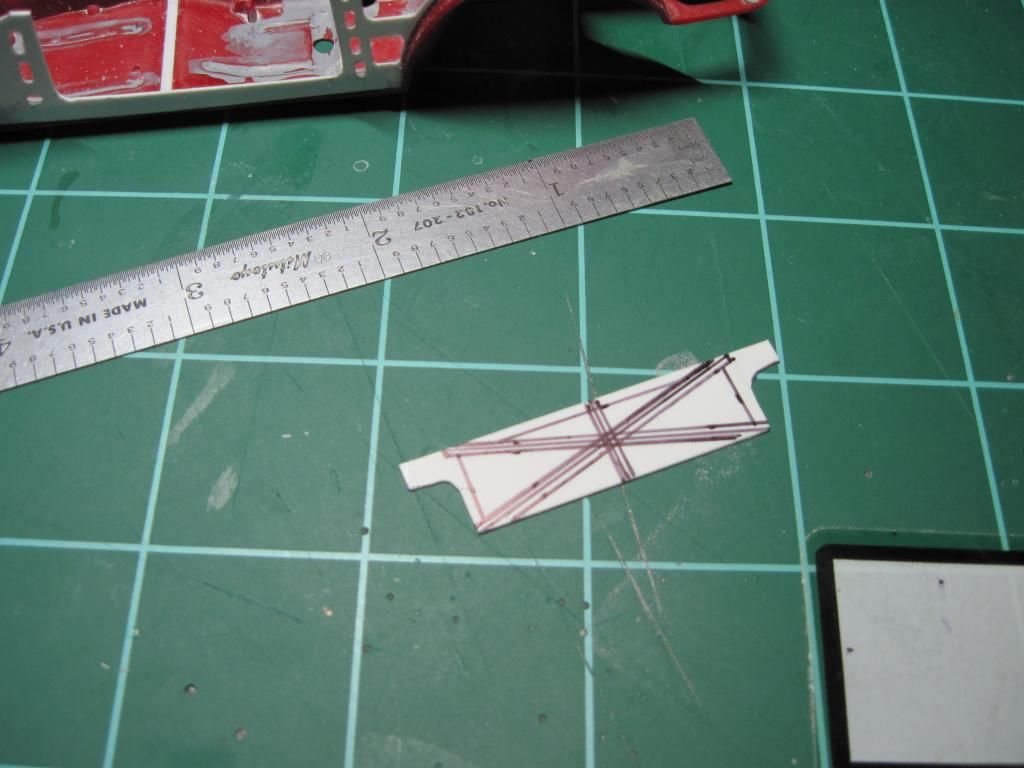

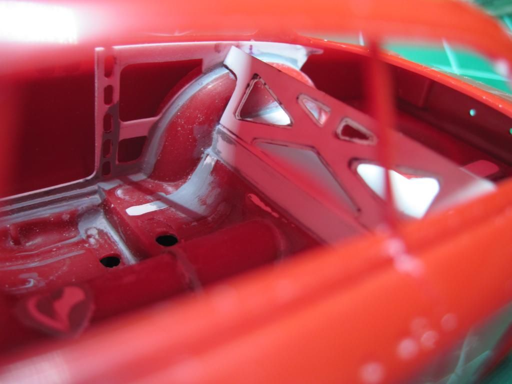

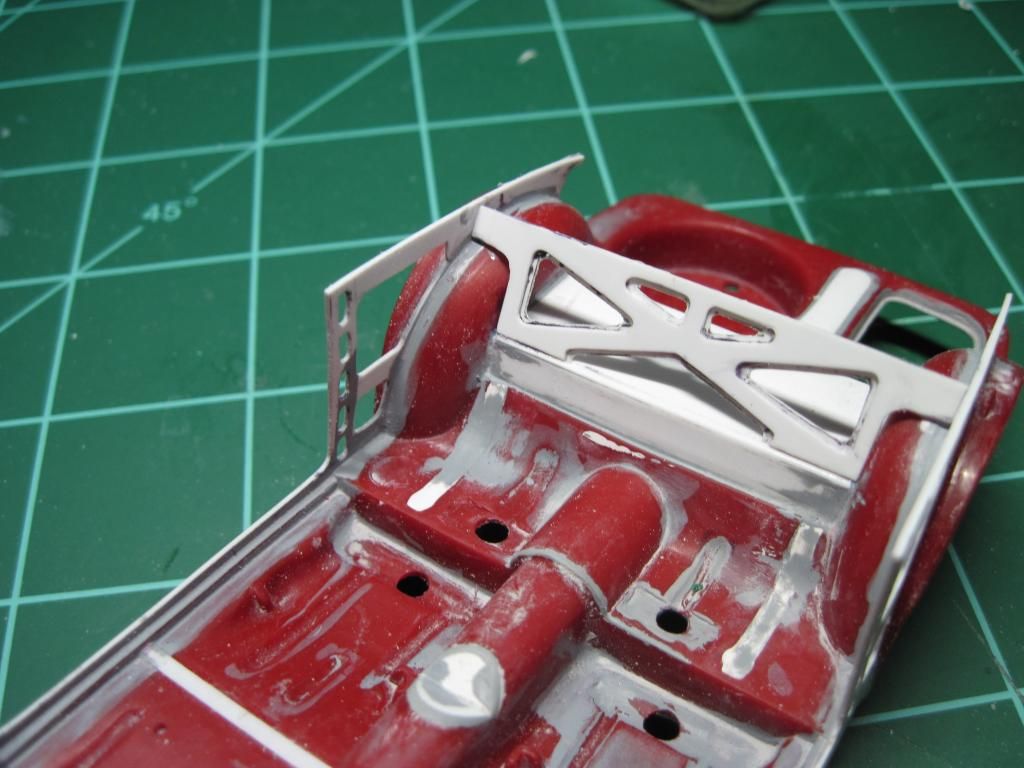

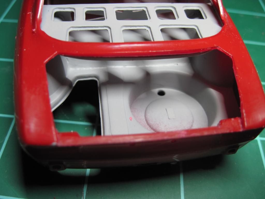

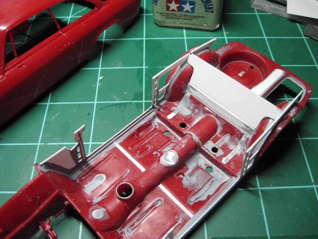

mikevillena Posted April 27, 2014 Author Share Posted April 27, 2014 Started work on the rear bulkhead: Lots of trial and error trimming and shaping: The bulkhead's sheet metal was swaged so: A bit more trimming and some blending with dabs of spot filler/primer. Then it's on to the parcel tray. Quote Link to comment Share on other sites More sharing options...

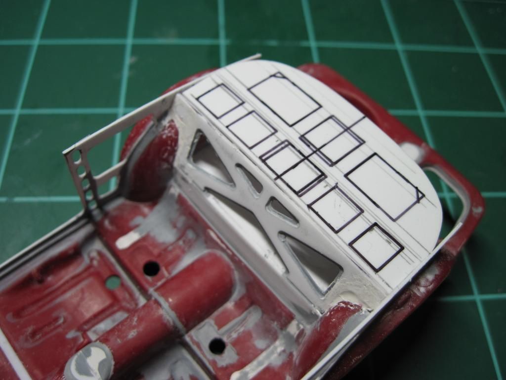

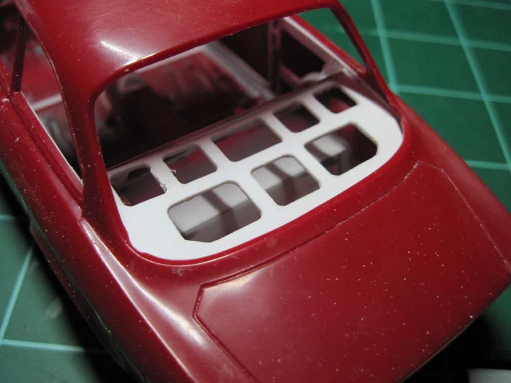

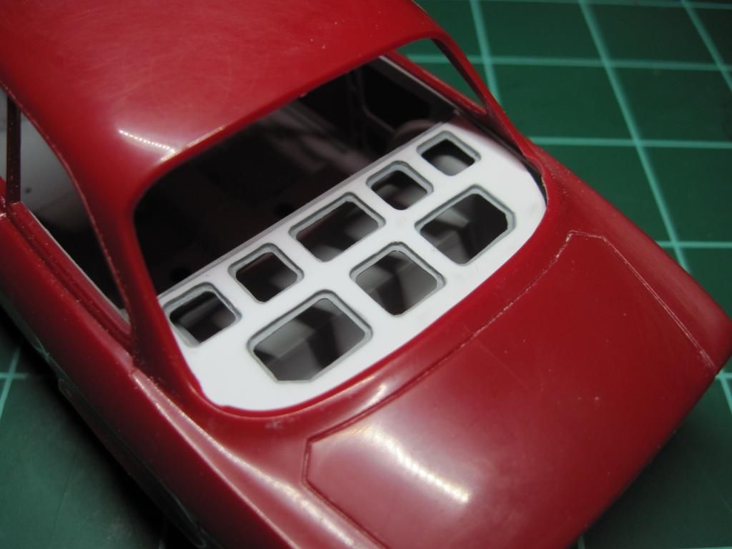

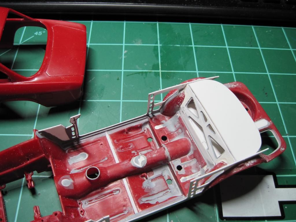

mikevillena Posted April 27, 2014 Author Share Posted April 27, 2014 Rear parcel tray roughed out: Quote Link to comment Share on other sites More sharing options...

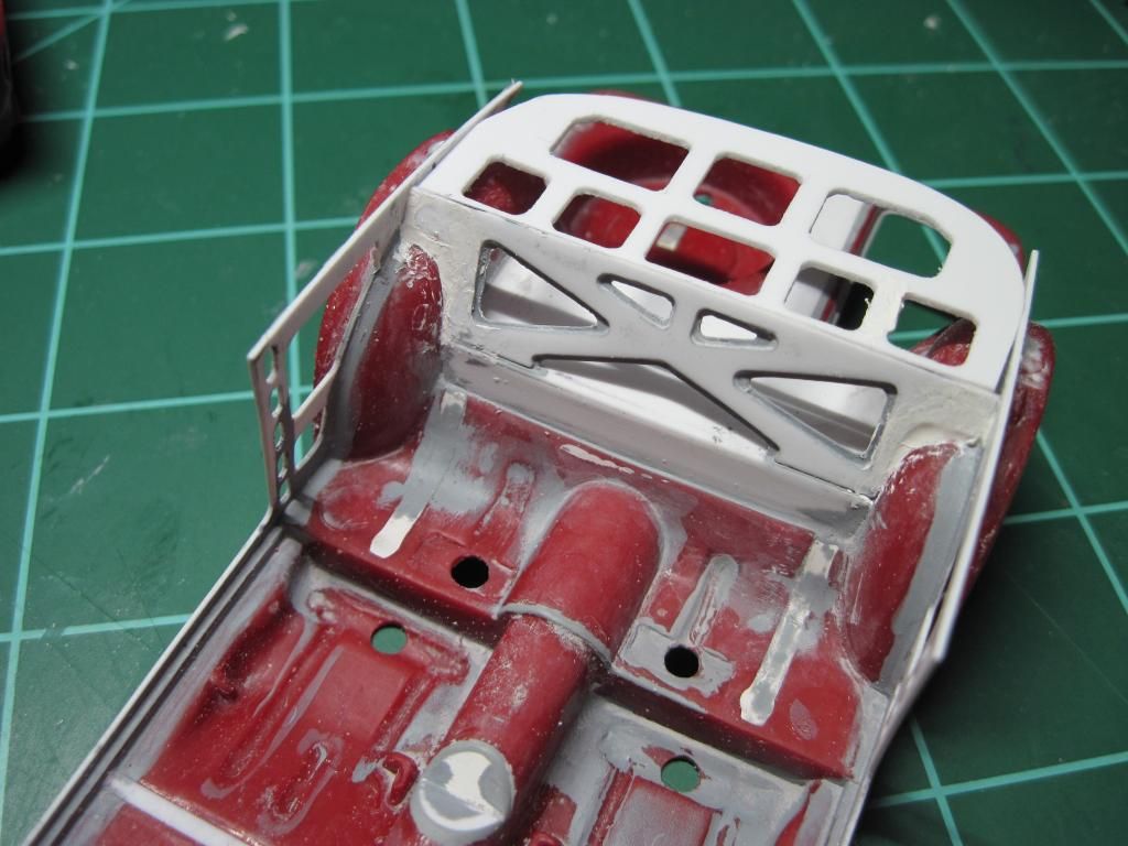

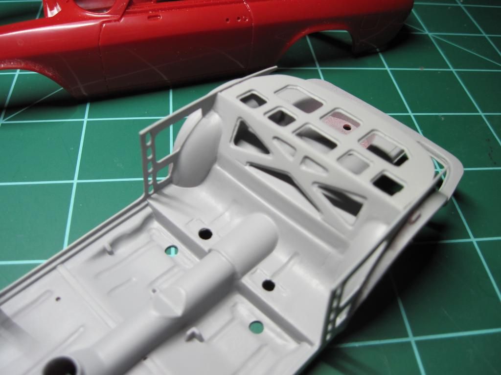

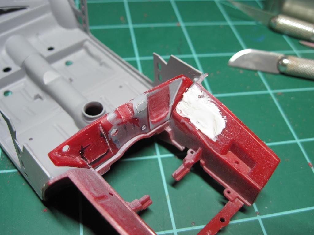

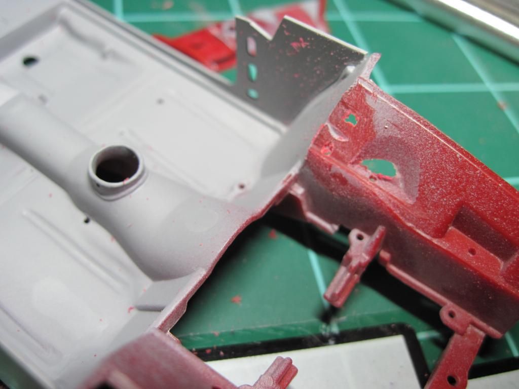

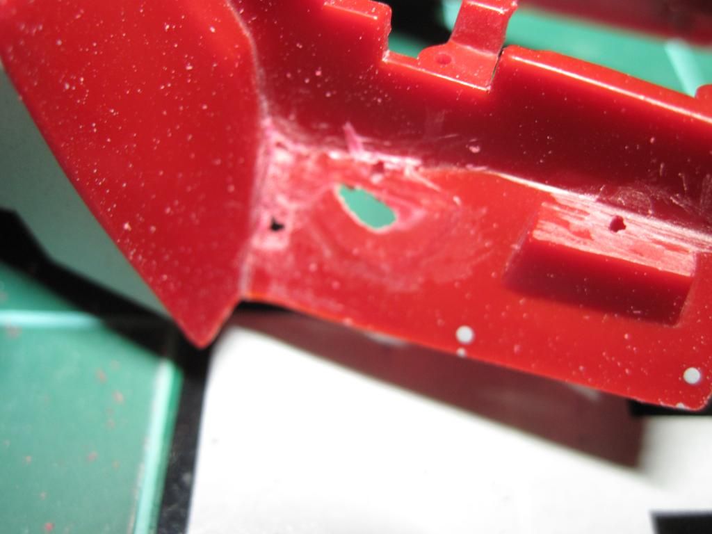

mikevillena Posted April 28, 2014 Author Share Posted April 28, 2014 Finished the rear parcel tray and give the rear a shot of Tamiya Grey primer. Much finier than the usual automotive primer that I have been using. Moved onto the engine bay. Decided to delete the vacuum booster for the brakes so I had to blank out the recessed perched. Also removed some of the molded bosses. Quote Link to comment Share on other sites More sharing options...

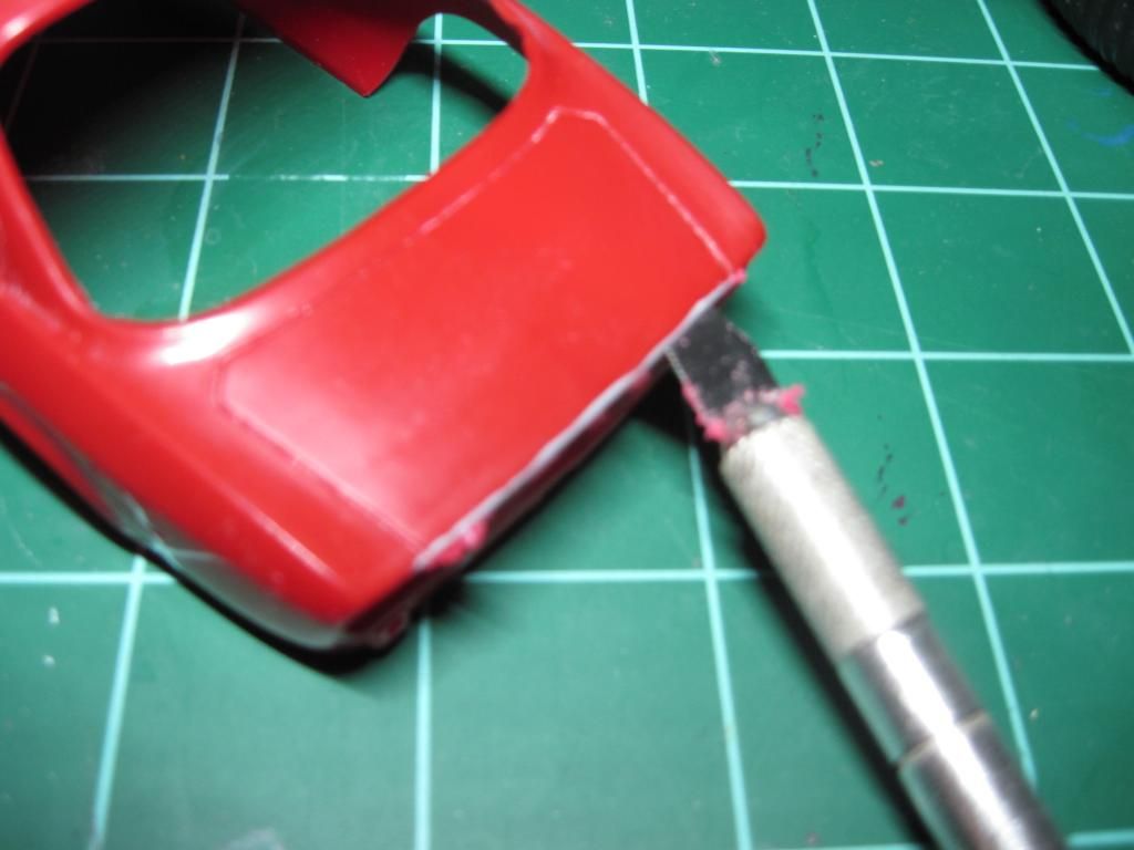

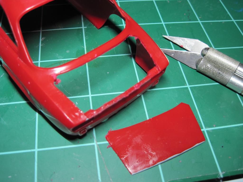

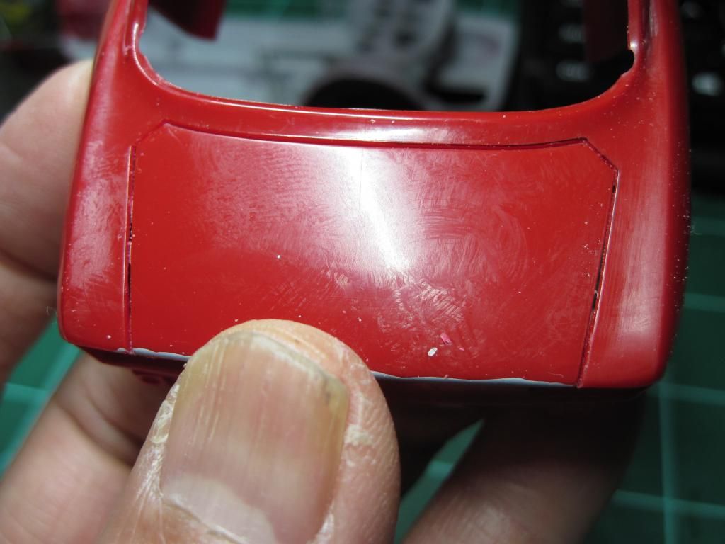

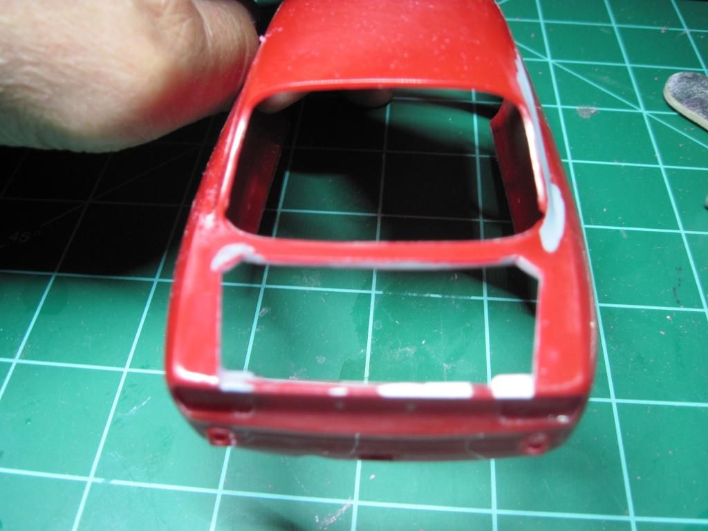

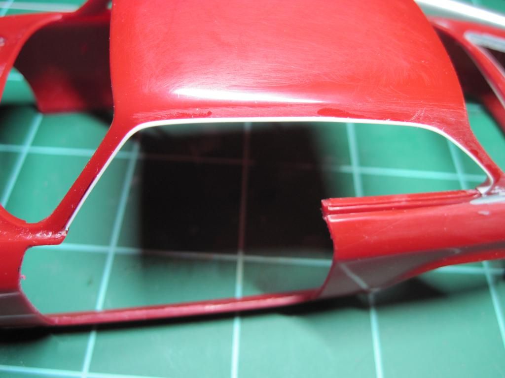

mikevillena Posted April 29, 2014 Author Share Posted April 29, 2014 Time to start cutting the bodyshell. Began with the trunk which is the trickiest since there isn't a molded line for the bottom lip of the trunk lid: Applied some dishwashing fluid to the initial scribe line and to the blade to lubricate the cut. Managed to pull off a very clean cut with minimal waste: Quote Link to comment Share on other sites More sharing options...

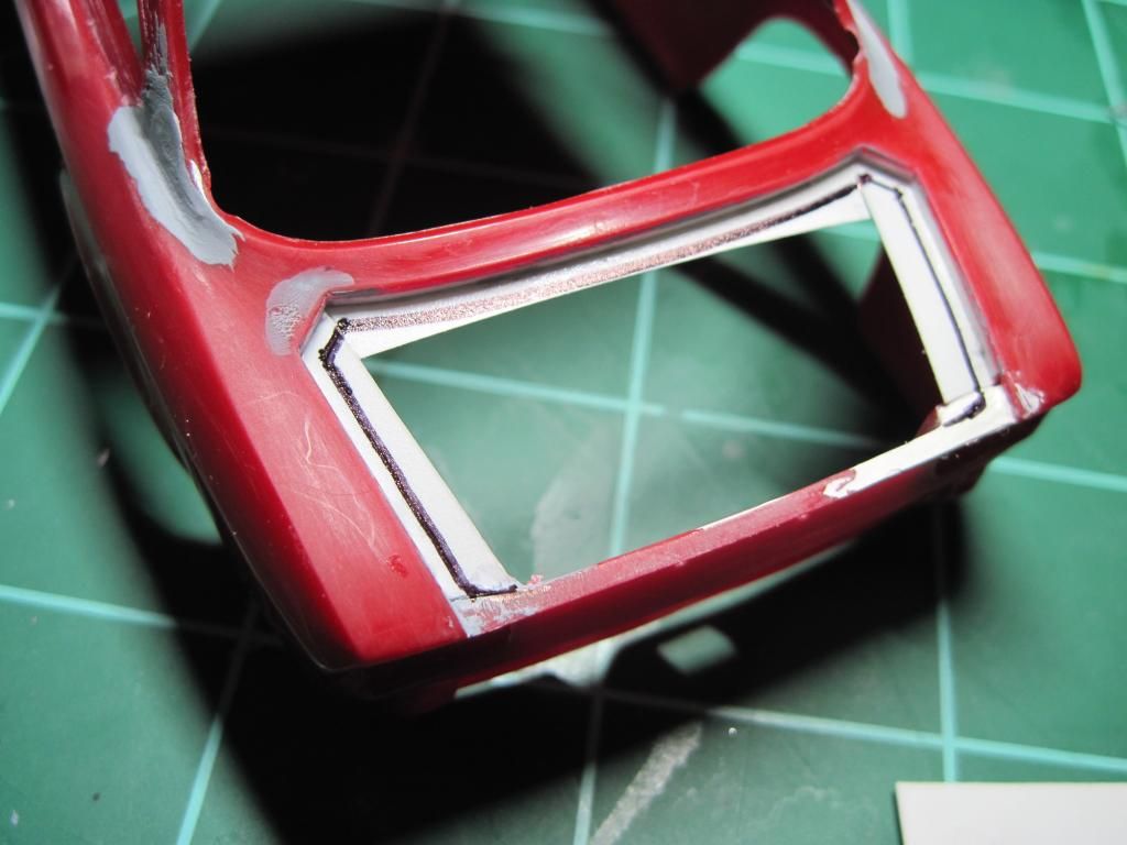

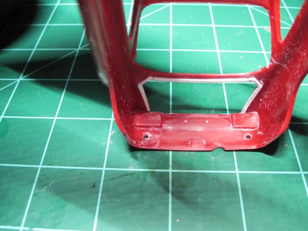

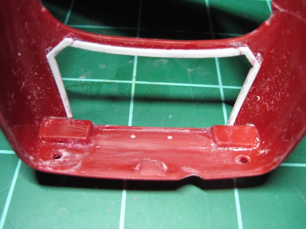

mikevillena Posted April 30, 2014 Author Share Posted April 30, 2014 Started framing out the trunk opening: Quote Link to comment Share on other sites More sharing options...

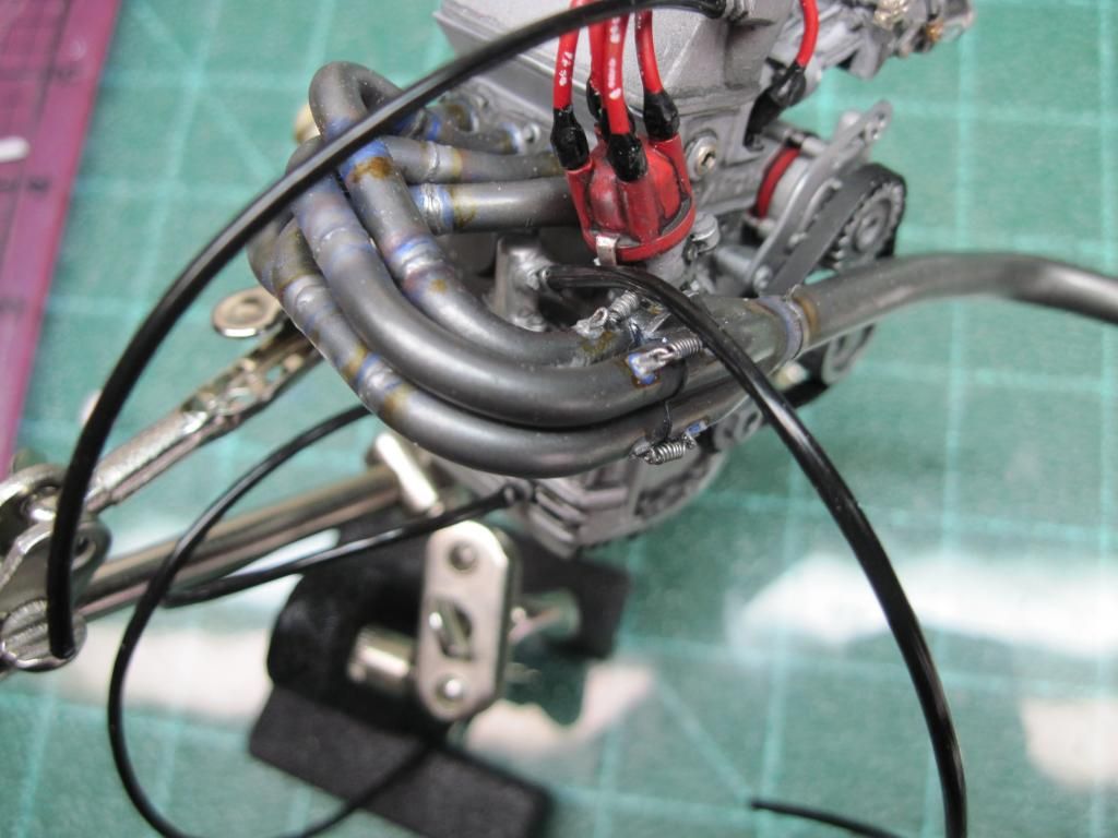

jaftygas Posted May 1, 2014 Share Posted May 1, 2014 My hat is off to you Mike that is some sick styrene work. What is the grey stuff on all of your seams. Quote Link to comment Share on other sites More sharing options...
mikevillena Posted May 1, 2014 Author Share Posted May 1, 2014 Very nice details and your work is very nice. Thank you very much Dave. My hat is off to you Mike that is some sick styrene work. What is the grey stuff on all of your seams. Thank you Joe. I use automotive scratch filler/primer in the small touch up applicator. It helps blend the styrene pieces and simulates the fillets typical of swaged or stamped sheetmetal. I also use it to simulate welds: This is on my 1/10th scale RC Tamiya Abarth. Thanks for all of the kind comments and for following this build Quote Link to comment Share on other sites More sharing options...

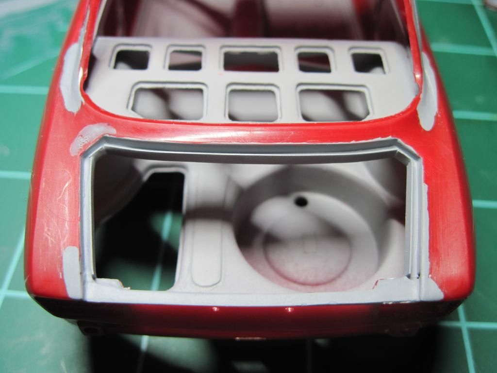

mikevillena Posted May 1, 2014 Author Share Posted May 1, 2014 Slow progress on the trunk opening: I'm at the point of planning the driver and passenger door openings. I might have to wait until much later to cut the doors open because slipping the chassis in and out forces me to flex the bodyshell slightly. I am also on the fence as to whether to shave off the incorrect rain gutters and scratchbuild the proper ones. This will take some planning to pull it off. As an aside, I found a nicely built Tamiya kit: http://i-am-modelist.com/2012/09/28/alfa-romeo-giulia-sprint-gta-1965/ Some of the paper models on that site blew me away. I remember seeing some incredible English cardstock and paper models from the 50's and 60's (old Airfix book). Goes to prove what craftsmanship can do even with simple materials. Quote Link to comment Share on other sites More sharing options...
jaftygas Posted May 1, 2014 Share Posted May 1, 2014 Oh my god! The header is unbelievable. I'm sorry for putting my question on the scratch filler in the form of a statement, but you got the idea. pearly academic. Anyways thanks for the answer. I'm not into the early European stuff, but my god man I will be eyeing this post like a hawk! Cheers. Quote Link to comment Share on other sites More sharing options...

mikevillena Posted May 1, 2014 Author Share Posted May 1, 2014 Oh my god! The header is unbelievable. I'm sorry for putting my question on the scratch filler in the form of a statement, but you got the idea. pearly academic. Anyways thanks for the answer. I'm not into the early European stuff, but my god man I will be eyeing this post like a hawk! Cheers. WOW!!! Thank you very much guys! That Abarth is in 1/10th scale which is a little easier on my poor eyesight and clumsy fingers. Hope to eventually pick it up again to re-build and finish it. Quote Link to comment Share on other sites More sharing options...

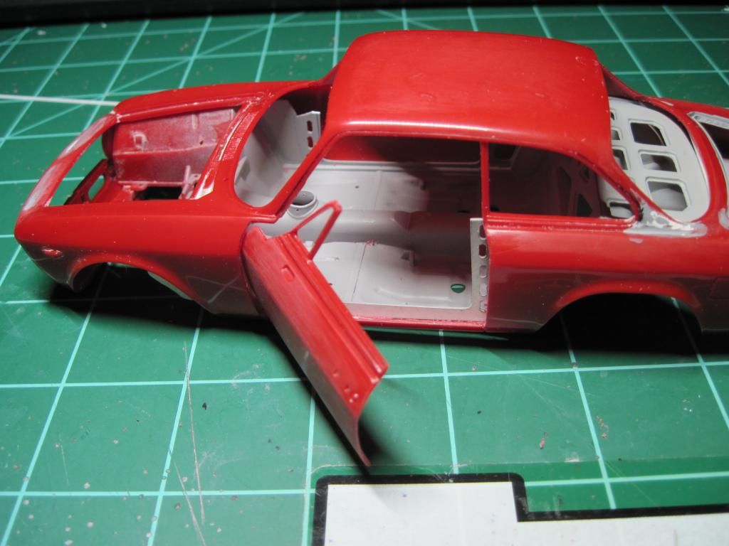

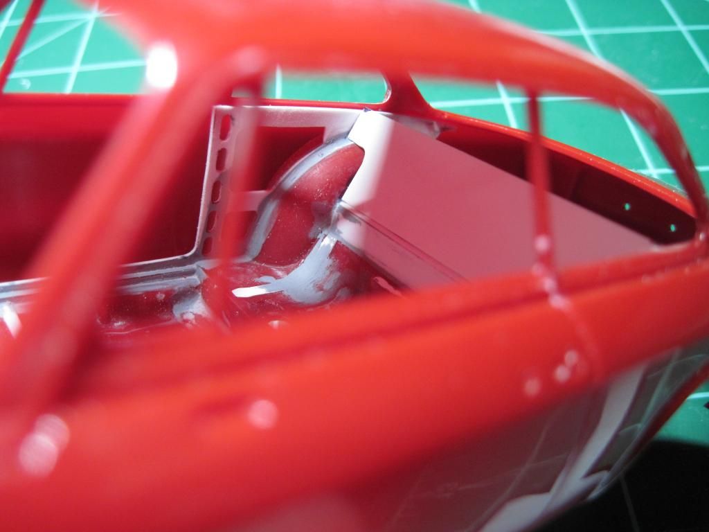

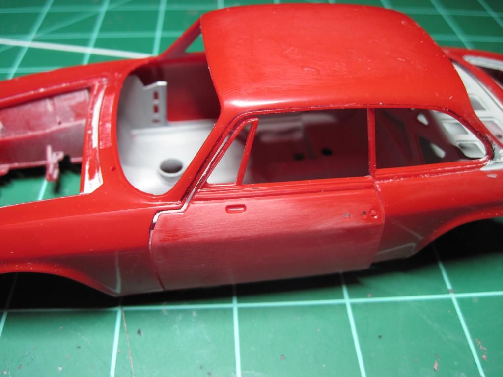

mikevillena Posted May 1, 2014 Author Share Posted May 1, 2014 Well, took the plunge. I decided to work on one side at a time since there will be extensive cutting and grinding involved in fabricating the extensive door jamb and internal roof structures. Quote Link to comment Share on other sites More sharing options...

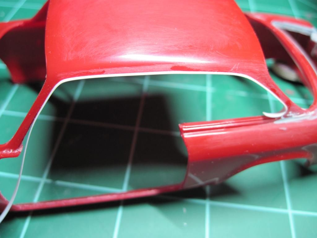

mikevillena Posted May 2, 2014 Author Share Posted May 2, 2014 (edited) Now at the point of no return as I ground and scrapped off the rain gutters. Also had to cut out the "B" pillar and set it aside to be re-installed after the gutter is finished. Used a short strip of .010 x .060 styrene to build the horizontal portion of the rain gutter: I'll have to wait until the hobby shop opens tomorrow to get some .005 x .005 strip for the vertical elements. Edited May 2, 2014 by mikevillena Quote Link to comment Share on other sites More sharing options...
