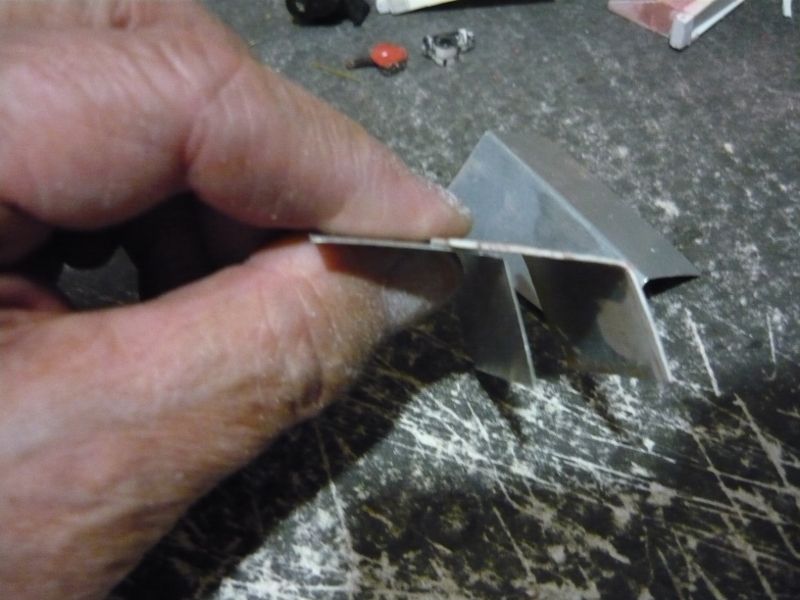

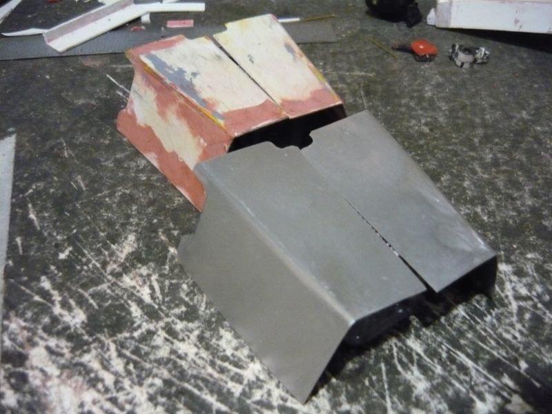

mackd Posted February 26, 2015 Author Share Posted February 26, 2015 I decided to make the wings of more realistic Hood.First it was made with of styren 0.030 a scale its represents 3/4 of an inch thick.Not very realistic.My new wings are manufactured in aluminium of 0.011 represents 1/4 of an inch, very close to reality. Quote Link to comment Share on other sites More sharing options...

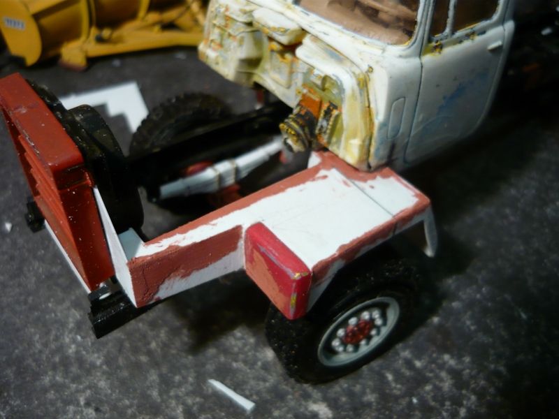

mackd Posted March 5, 2015 Author Share Posted March 5, 2015 Here is the finished Hood.I encountered several difficulties has make the Hood hinges and finally I found a method very simple.For the brackets of the Hood fasteners it is much more difficult, because the parts are very small.The rivet head is 0 "015 = 3 / 8 of an inch."I broke three drill to drill the rivets.Aluminum I use is a little too hard. Quote Link to comment Share on other sites More sharing options...

gatorincebu Posted March 5, 2015 Share Posted March 5, 2015 Alain, Once again you have raised the bar. The hoodand hinges are fantastic! A tip for you. When you want to work with aluminum. before drilling anneal it. That means heat it up with a small torch. This will soften the metal and make it easier to work with. You might want to experiment with a couple of pieces though. Be Well Gator Quote Link to comment Share on other sites More sharing options...

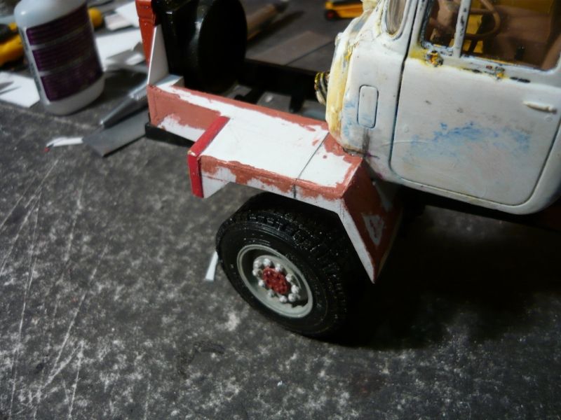

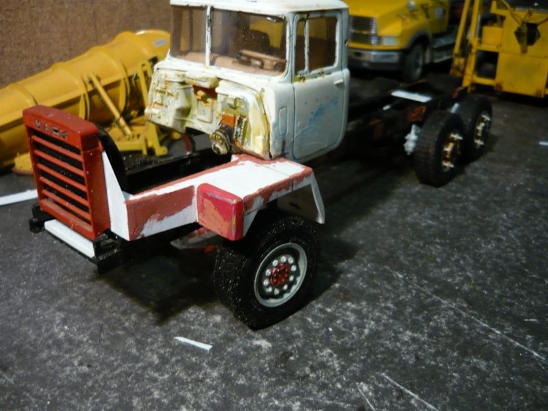

mackd Posted March 15, 2015 Author Share Posted March 15, 2015 (edited) Here is my Advanced.I met some difficulties of adjustment, its my retarded in my project. Edited March 15, 2015 by mackd Quote Link to comment Share on other sites More sharing options...
Mopar - D Posted March 15, 2015 Share Posted March 15, 2015 Nice progress it's starting to take shape now. Quote Link to comment Share on other sites More sharing options...
Ken Gilkeson Posted March 16, 2015 Share Posted March 16, 2015 love the front tire to fender fit. great work. Quote Link to comment Share on other sites More sharing options...
