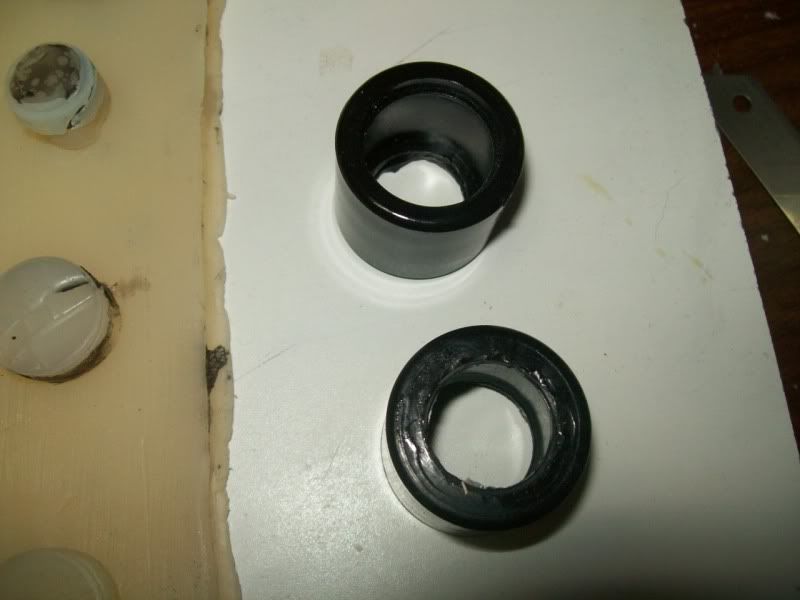

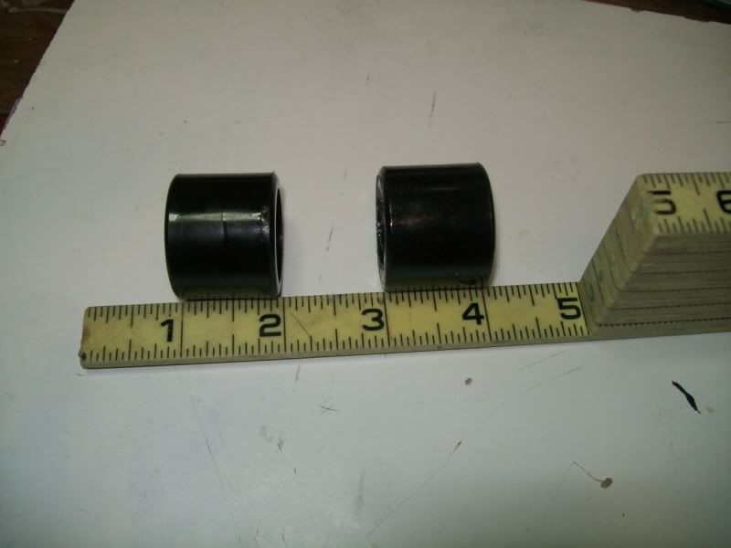

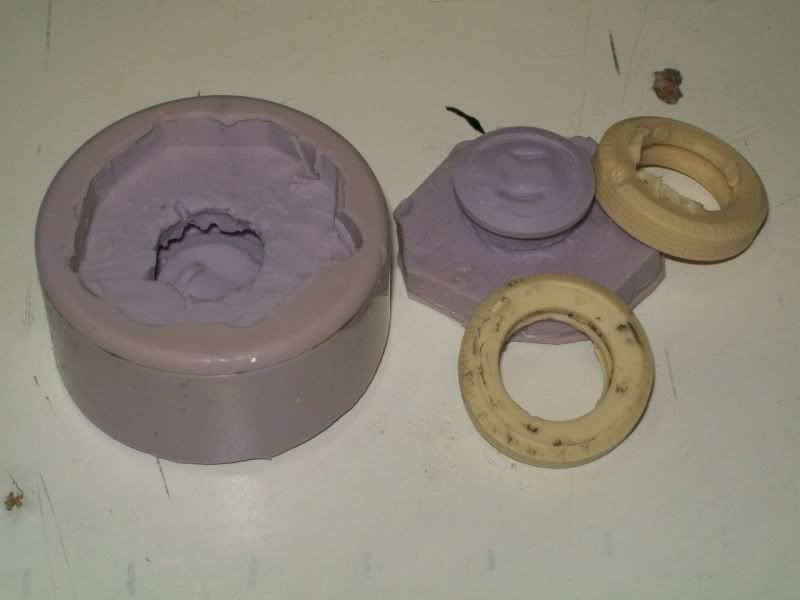

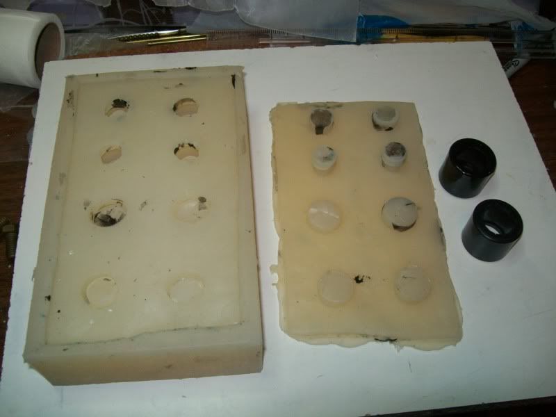

Greg Wann Posted January 8, 2012 Share Posted January 8, 2012 (edited) Here is a tire mold I made a few years back. These are the rear drag slicks from an original Tom Daniels Groovy Grader kit. You have to imagine that the part just left of the tires is the blue clay and the master tires are just barely setting on the little stands of clay. The mold part to the left of that is the silicone that is poured over the tires and clay. Once the silicone is cured. It is unboxed and flipped over and the clay is removed. there is no reason to remove the tires. A good coat of Price Driscoll mold release is sprayed over the exposed surface so the next pour of silicone will not stick to the other part. And then you pour the silicone in and cure. The tires are really hard to remove, but they are better than nothing. The bottom pic shows how wide these babies are! I think it is a 1:24 scale kit. Here is yet another tire mold I made. It is more recent. I think it is from a diecast. Notice that the inside opening is formed nicely. It is to be stretched over the two piece diecast wheels. One has some black resin residue stuck to it. I bought some resin that does the black tires from Aero Marine and it set around for sometime before I tried it. I pretty much ruined this mold from trying to remove the uncured resin from it. This type of mold goes through a lot of stretching to remove a tire from it. I made some from Task 8 resin just for showing you. I don't have the master tire anymore. Edited January 8, 2012 by Greg Wann Quote Link to comment Share on other sites More sharing options...

Greg Wann Posted January 8, 2012 Share Posted January 8, 2012 (edited) Ryan, that is some SUPER nice work there and a very helpful post Greg? sorry, but that is some rough looking stuff there Yes, the bottom tire is pretty rough as I beat the mold up trying to get the black uncured resin out of it. Your focus is supposed to be on the mold design. Did you even notice that my mold re creates that groove that is supposed to be in the tire? I had made some perfectly good tires from this mold before. I'm still on a learning curve for making tires. http://smcbofphx.pro...play&thread=661 Here is a link to a post on my forum from when the mold made perfectly good tires and I made the other wheel parts. Edited January 8, 2012 by Greg Wann Quote Link to comment Share on other sites More sharing options...
