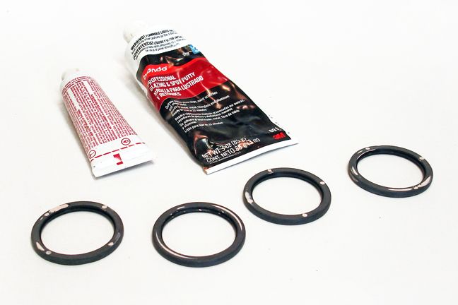

Ok... let's get this show on the road. First order of business will be the tires. They are black molded plastic, same as the rest of the black plastic parts, and have ejector pin and sink marks all over them. A little Bondo and a little sanding will take care of that...

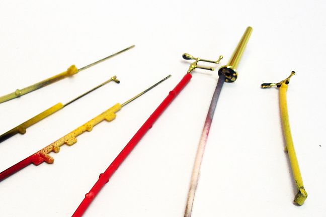

The brass plated parts are a bright neon yellow... not exactly "brass," if you ask me. Compare the steering column to the actual brass pin vise collet... that's the color I want for the "brass" parts:
The first step in assembling the steering column and hand controls is to clean up each piece... remove mold seam lines, etc... these are really tiny pieces, so I had to be careful not to break any of them. Once I had each part cleaned up, I glued each to a scrap of sprue, so I'll have a "handle" when I'm painting the parts:

Here is the finished steering column/tiller/hand control assembly after "the treatment" (Rustoleum Metallic Brass, Future/acrylic black wash, and knobs/handles detail painted.

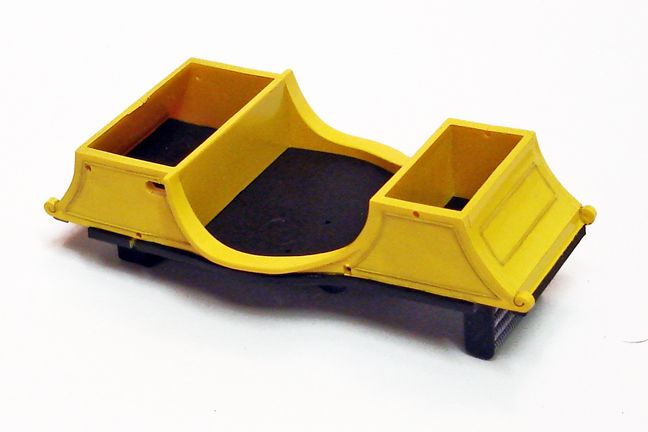

This kit is so simplified that the frame rails and body are molded together. I decided to go with a yellow body, black chassis/suspension, black fenders, and dark red wheels. Here is the body after painting, with the frame rails brush painted gloss black:
Floorboard and radiator installed:

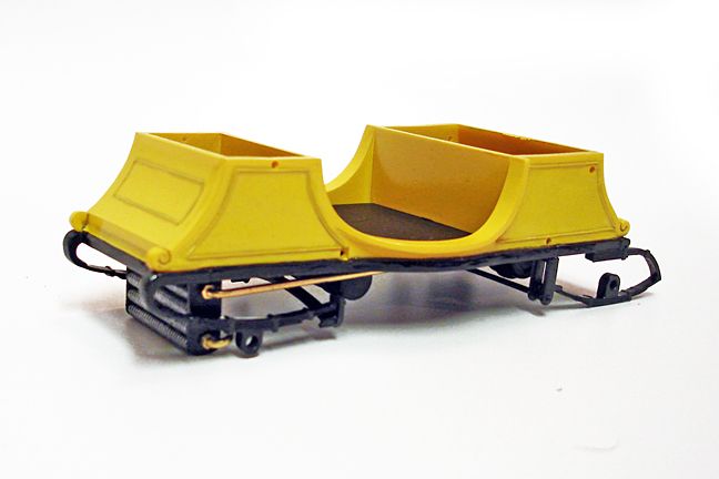

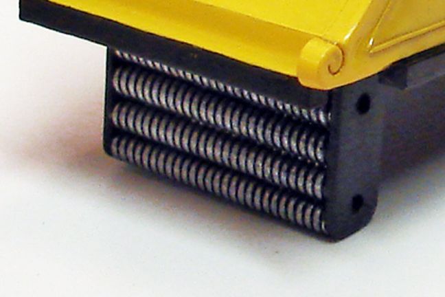

The corners of the frame are part of the springs, so once the springs are attached, the "frame" is complete. I added some coolant lines made of brass rod:
The radiator was sprayed silver, then blackwashed, then the end caps painted black:

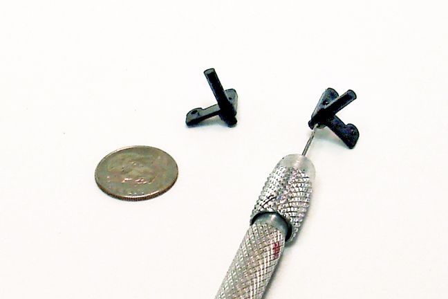

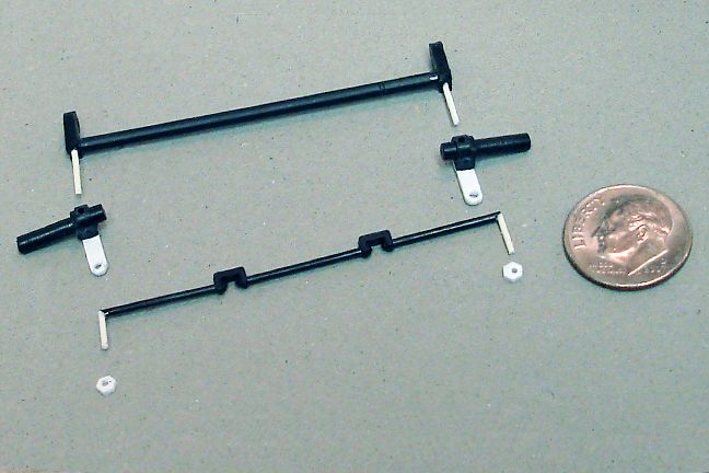

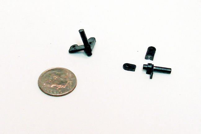

The front spindles are not very accurate... plus I decided I wanted to add posable steering, so I needed to rebuild the front axle and spindles. First step was to drill a hole in each spindle with a pin vise:
Then I cut the spindles apart, in preparation of rebuilding them. The reason I drilled the hole first and then cut the spindles apart is that drilling the hole is much easier when you have something more substantial to hold onto as you drill. Trying to drill the smaller part after cutting apart the spindle would have been much more difficult:
Finally, I added the rest of what I needed with styrene rod and strip. I added the 90º ends on the tie rod, and drilled out some hex-shaped styrene rod to create the "nuts"...
Once these components are painted and installed, the model will have posable steering.
