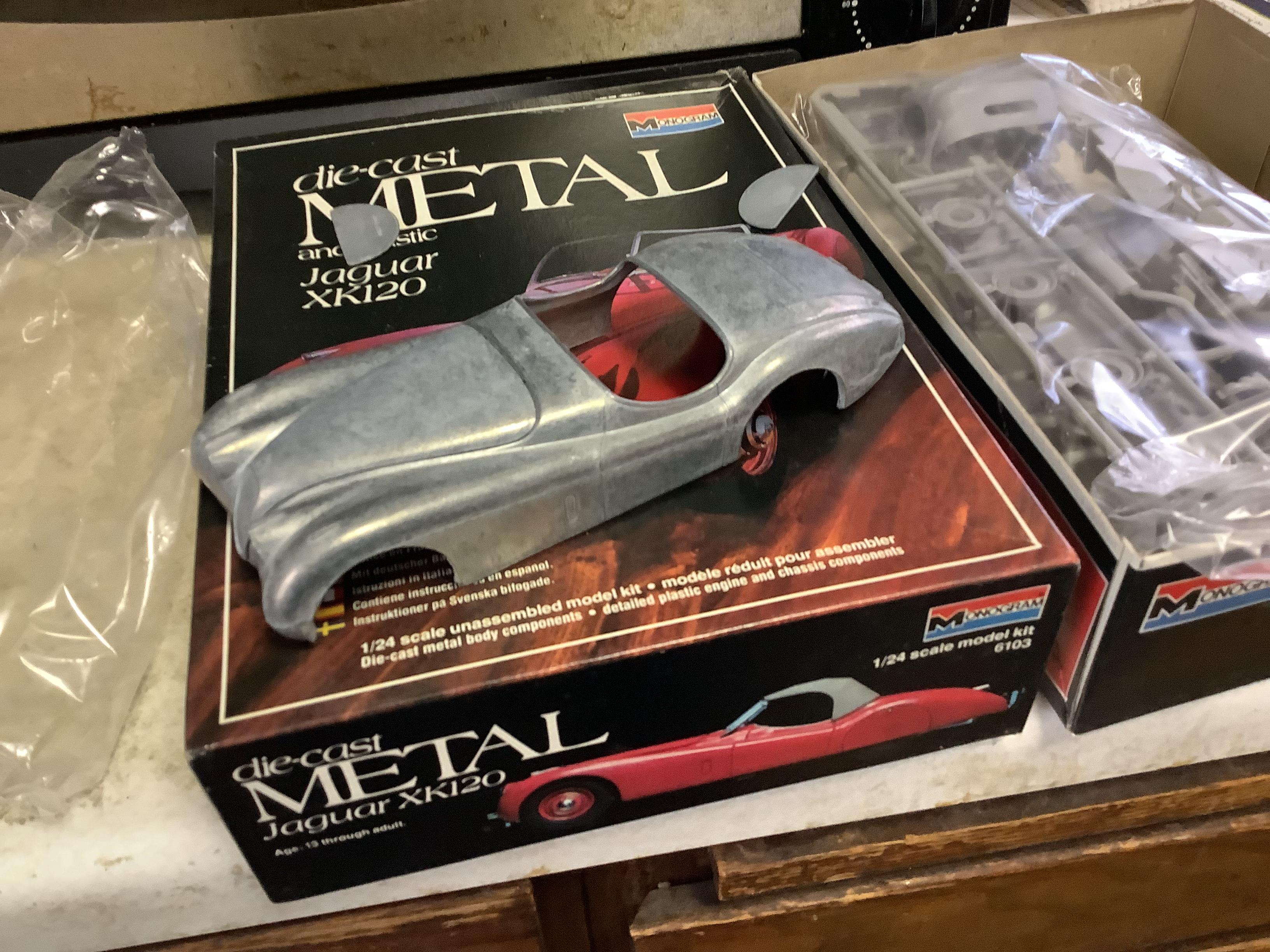

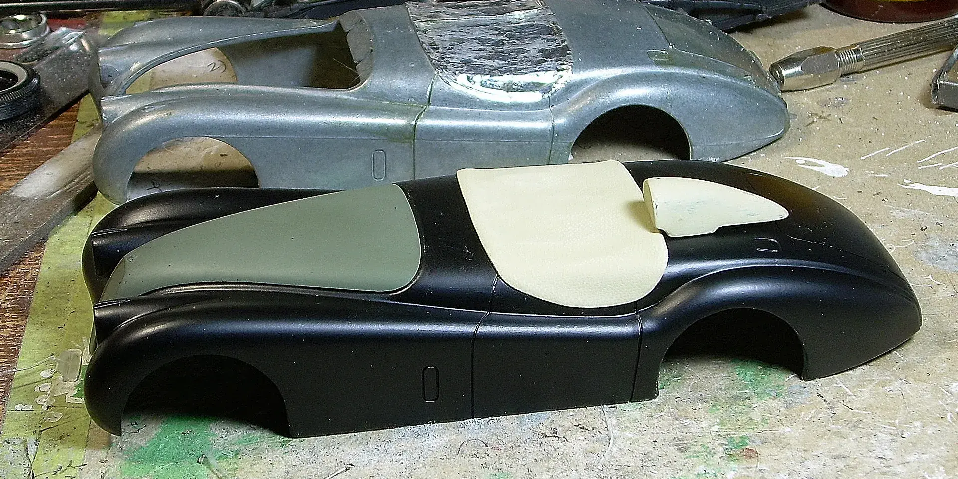

  1. 7 hours ago, Ace-Garageguy said:
    That's all there is to it.
    These Jags are from the same series as your MG, same metal.
    It's soft metal and won't hurt your tools, though they'll dull a little quicker than on plastic.
    Notice the heavy parting line along the side of the upper one.

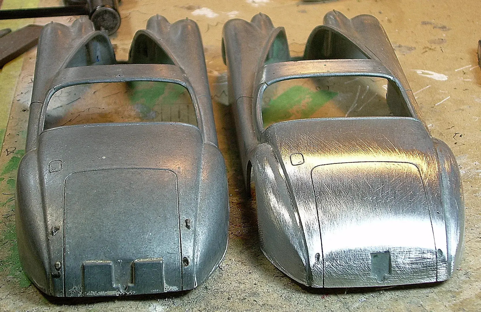

    5 hours ago, Ace-Garageguy said:
    Rear of the Jags, with some unwanted details removed and the surface prepped for first primer coat with 180 grit paper:
    ...and because these models are metal, you can use very "hot" automotive self-etching primers for best adhesion.
    By the way, I ordered the Jaguar from a vendor on eBay yesterday. That one body seam is a duesy. A little sanding is going to be required there. It looks like it will be well worth it.

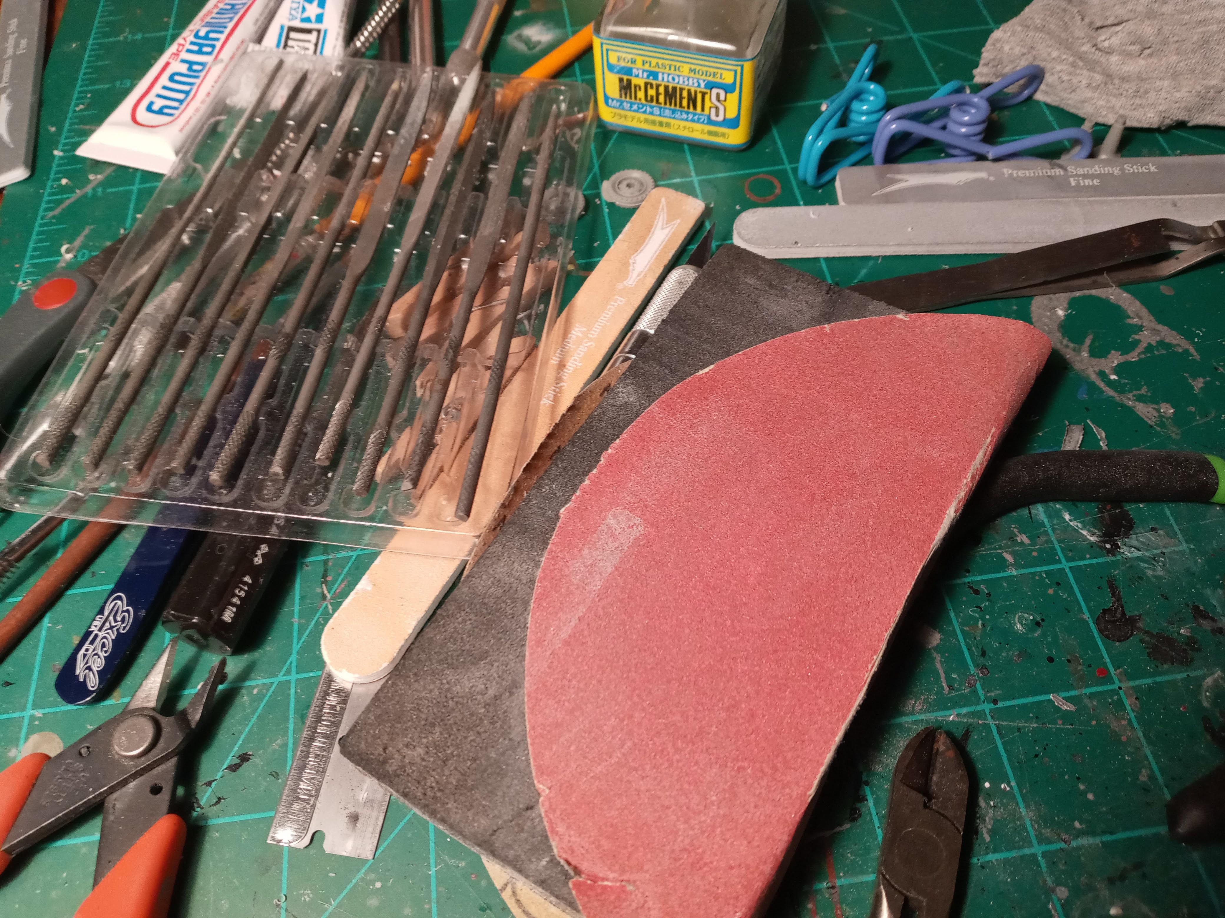

    I do a fair amount of the old Hubley metal models and I use a set of small files, sanding block with 280 or 320 paper and a set of cheap cutters/nippers from Harbor Freight.
    5 hours ago, TonyK said:
    Ace is right. I've used files and sandpaper with good results but haven't used the "wet" method. A good cleaning afterwards and some good primer will get you to the painting part.

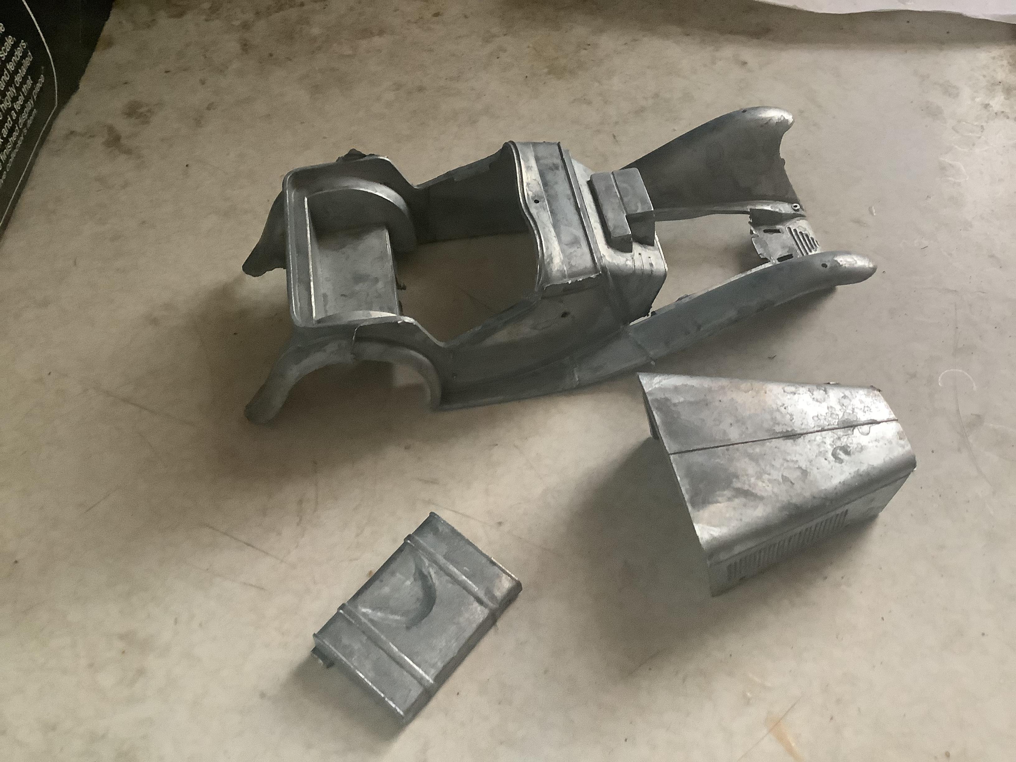

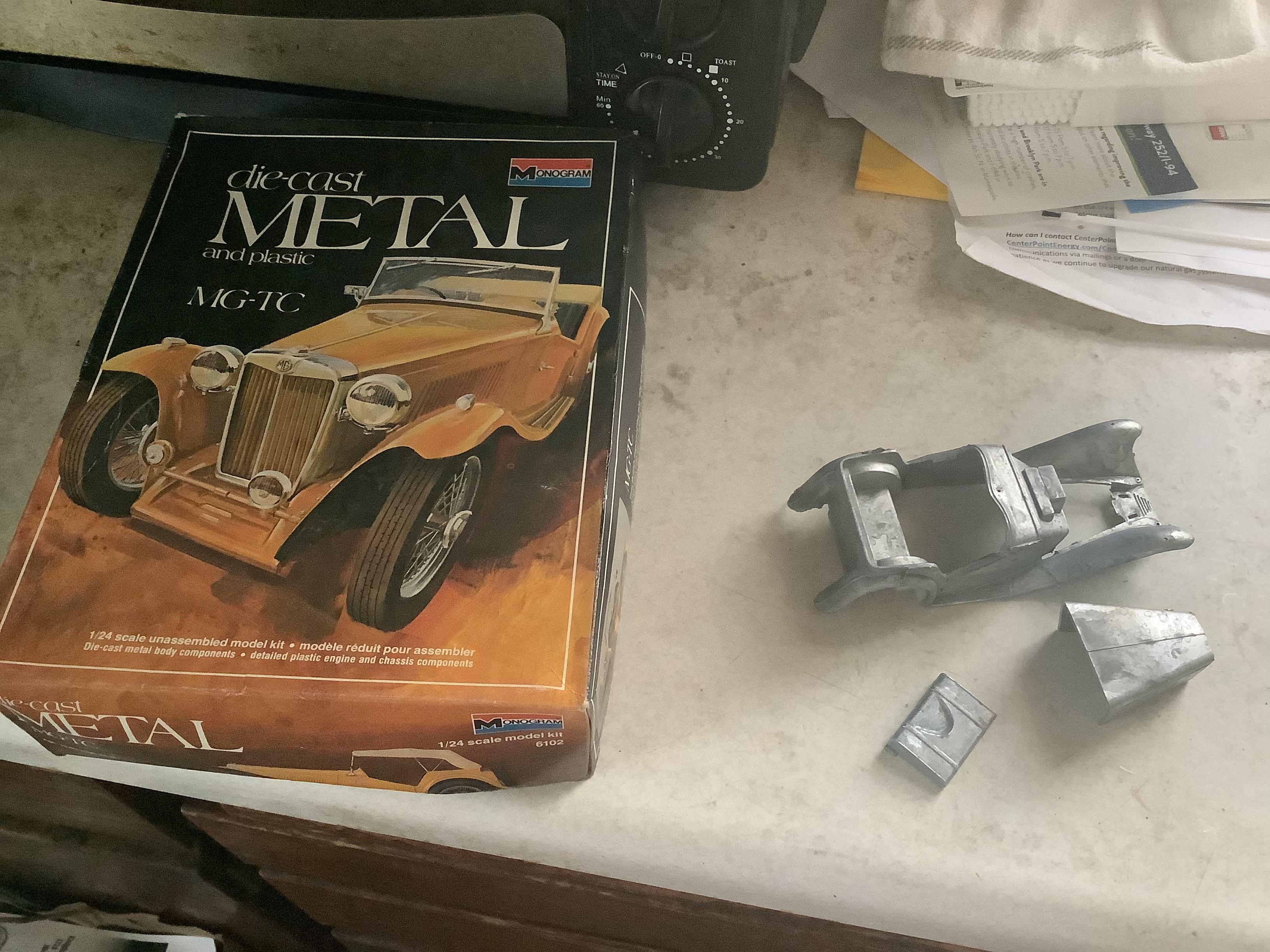

  3. This last Wednesday night, at our MCCM (Model Car Club of Minnesota) meeting, another member came in and handed me an old Monogram die-cast metal MG-TC kit. He thought I might like to build the car. And he was right. I do look forward to building it. But, never having built a metal bodied kit before, I’m wondering how do I cleanup, and deburr the model? What tools do I use? And what will the metal do to those tools?
    Here is what the instructions say: “As you examine the unfinished metal parts, you may notice small amounts of flash along the mold parting line. Use a flat or round jeweler’s file or a razor knife to carefully remove the flash and mold parting lines. Be sure to retain the basic contour of the surface you are filing. When you have removed the flash, sand the filed surface with 600 wet-or-dry sandpaper. This type of sandpaper works best with water. Be careful not to sand down the raised details such as door locks and nameplates.”
    Sounds good. But, is there more? Or is it that simple? And again, what is going to do my files and other tools?
