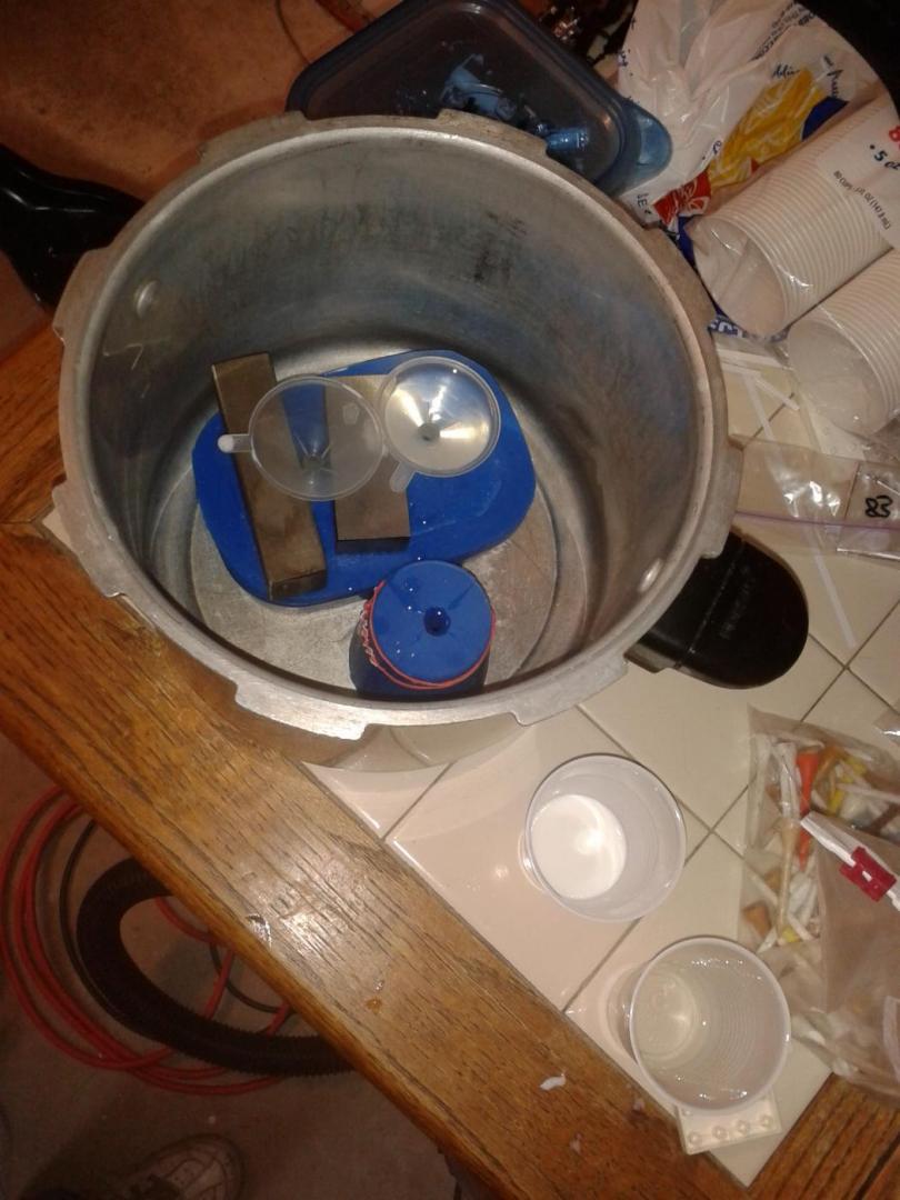

  15. I never have problems with bubbles. I always pressure cast. I mostly do two part molds. Some cheaper resins have a tendency to naturally produce bubbles. Careful, Some resins will foam up when you vacuum. I use Smooth-On products for all my casting needs.
