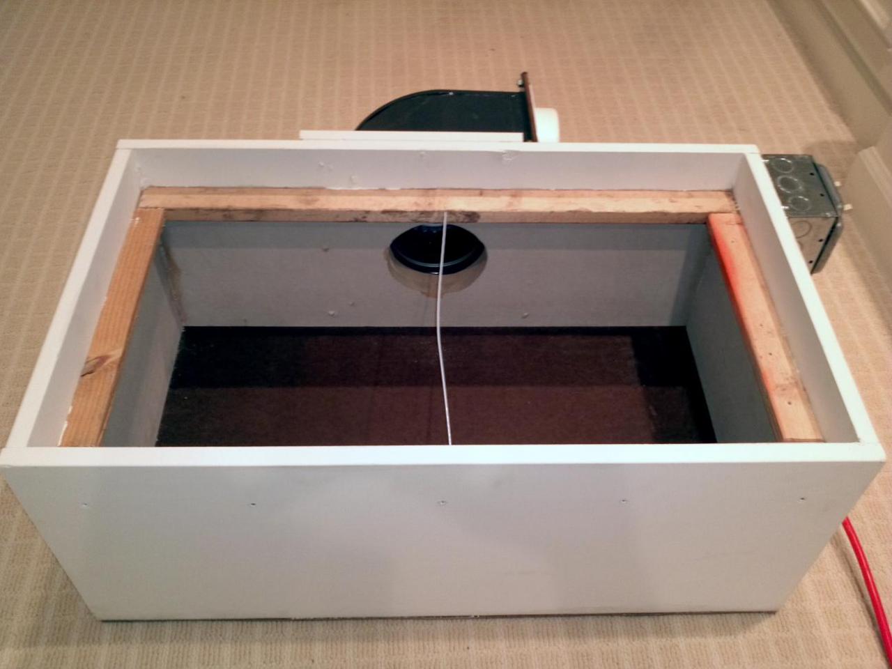

  5. I bought the fan at Grainger. I will need to see what model the fan is. All in all, the spray booth cost over $200.

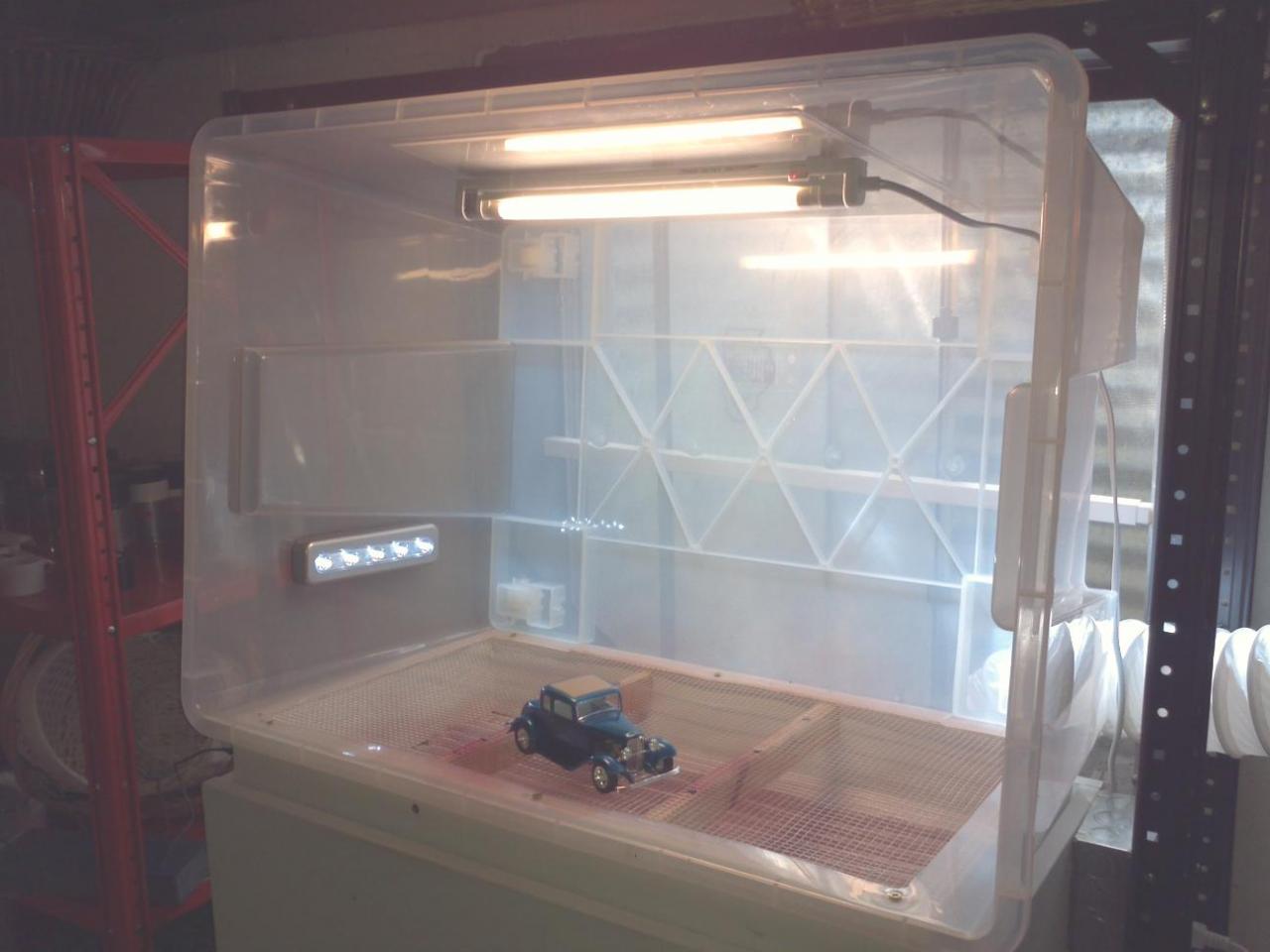

  7. Hi, I just completed my new spray booth and would like to share some photos with everyone. I live in the Chicago area and became tired of using a cardboard box located in my garage as a spray booth, especially in the winter. So I built a spray booth with an exhaust fan that I installed in my basement. The first photo is the completed spray booth. The dimensions are 30 inches wide, 20 inched high and 14 inches deep. The second photo is the bottom plenum and the blower. A furnace filter sits on the unpainted wood cleats that also support the top box. The third photo is the top of the booth which is made from a plastic storage container that I purchased from Ikea. A metal screen is located on the unpainted wood boards to support the model that is being painted. Photo four is the back of the spray booth and shows the blower and switch box. The blower is ducted through the outside wall of my house.The switch box controls the light and the blower. Photo five gives you an idea of the size of the spray booth. That is A Revell 1932 Ford sitting inside the booth. JohnnyK
