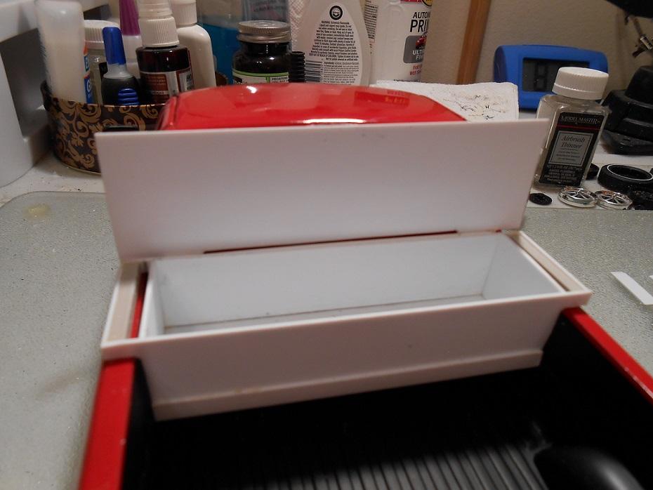

Hey Nick, here is an update on the toolbox. I added a sliding drawer, trim and handles on the lid. Almost done Cheers, Lance

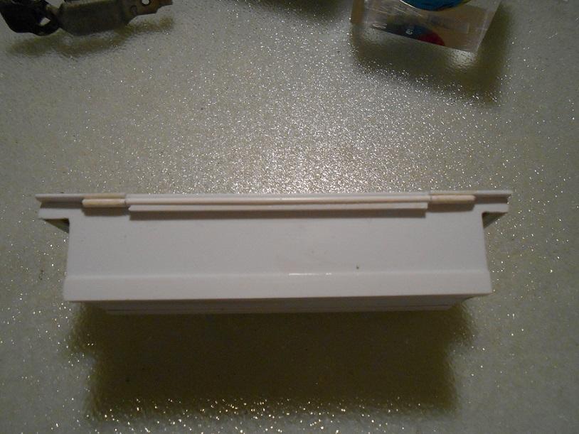

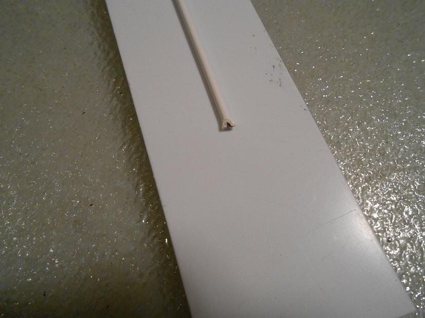

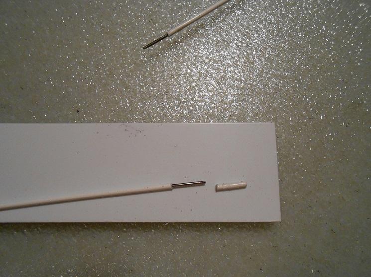

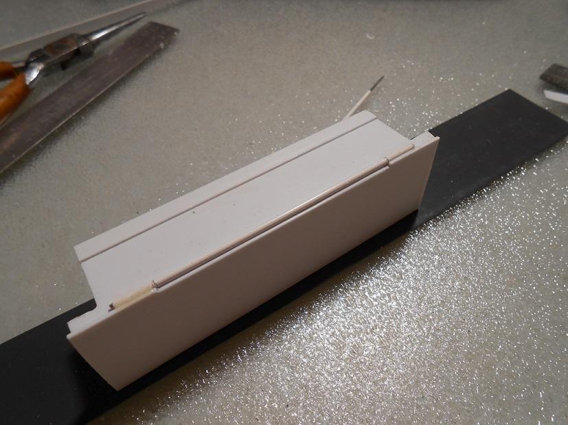

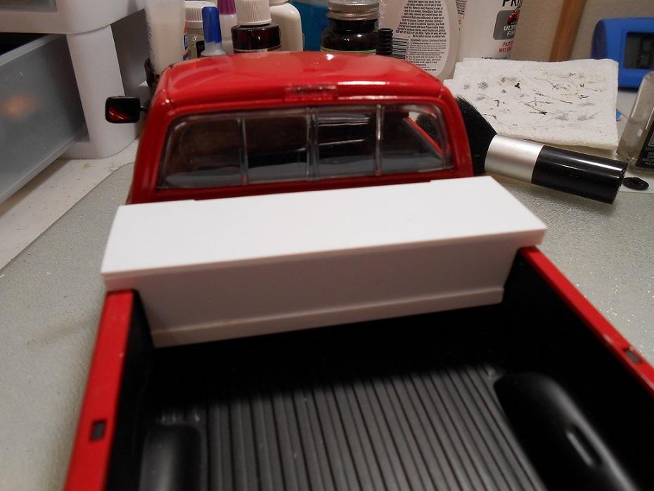

Hey Guys, I'm scratch building a 1/18 Pickup bed Toollbox, and wanted to hinge the top cover. Its a very simple pin style hinge made from plastruct #90102 1/16" coated wire. In the pics, you will see the end of the rod is rough cut, so you need to smooth that out, so the plastic coating can slide off. be careful not to bend the wire. cut back the distance you want with an Exacto knife for the end piece. Score the plastic all the way around down to the wire, then slide the end piece off the wire, using the Xacto blade to push it off. This is a process that requires patience, as sometimes it will slide off easier than the next one. Then take a small file, and file the exposed wire all the way around until the plastic piece rotates freely when you slide it back on. Repeat for the other side. You will see, I cut a relief in the lid, so that it will not bind when opened. The ends will be glued to the cover, and the center piece will be glued to the box. I just added a piece of Plastruct flatstock for added support on the middle of the hinge, because of the hinge length. Cheers, Lance

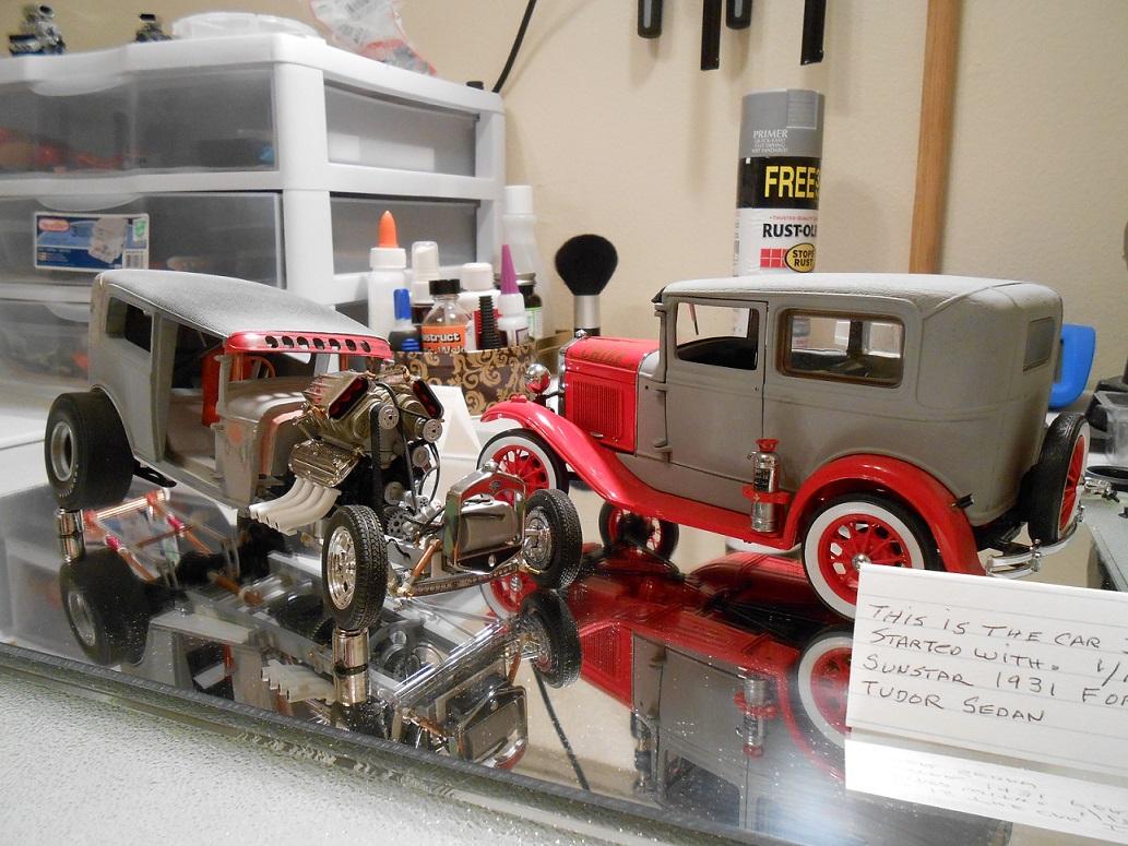

Thanks for the support, Guys. Tom, you should have seen my work table, before I cleaned it, and put the tools away Seems like every tool you have finds its way out to cause clutter, but if you put it away, I minute later you need it again! I'm heading to a model/Diecast show, this Sunday, and they have a project table, so I pulled out my display case to present it there. Here you can see the Diecast car that I started this project with. Cheers, Lance

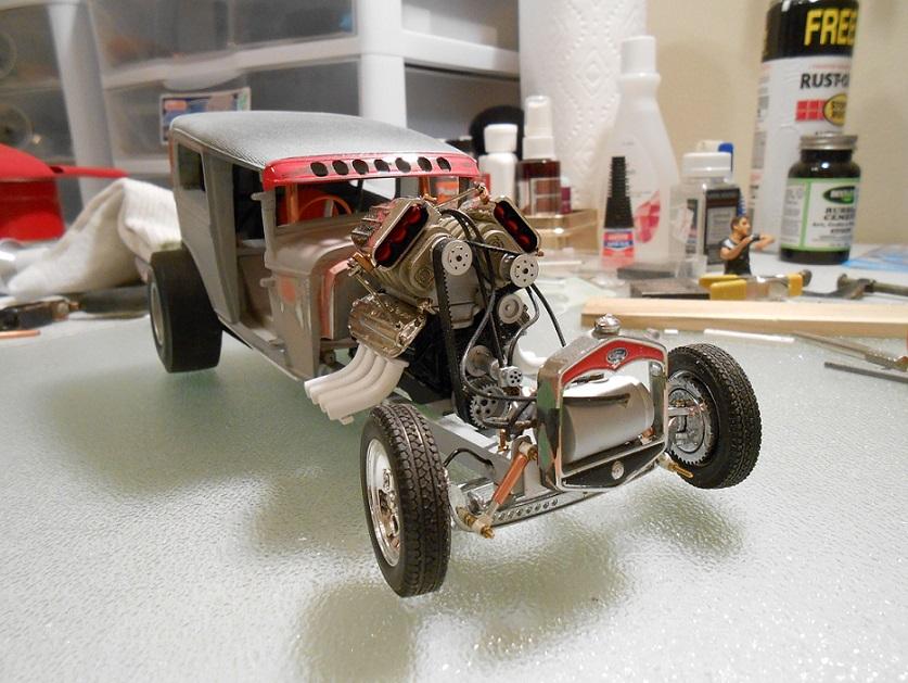

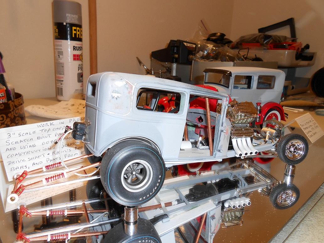

Hey thanks Tom, and Christian. Here are a few pics of where I'm at on the build. Lots of scratchbuilding, and Diecast parts are very hard to come by, not like the old model car days, I had thousands of parts! Still have a ways to go, but will post a pic of the finished model. Hopefully I'll be done before 2017 Cheers, Lance

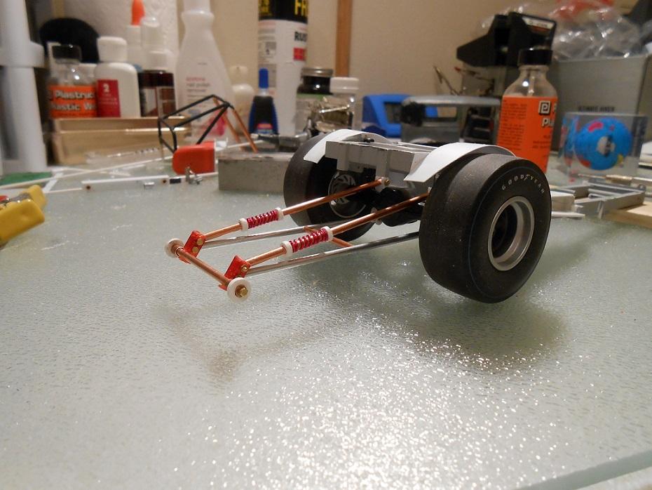

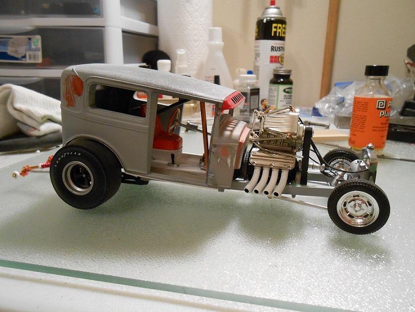

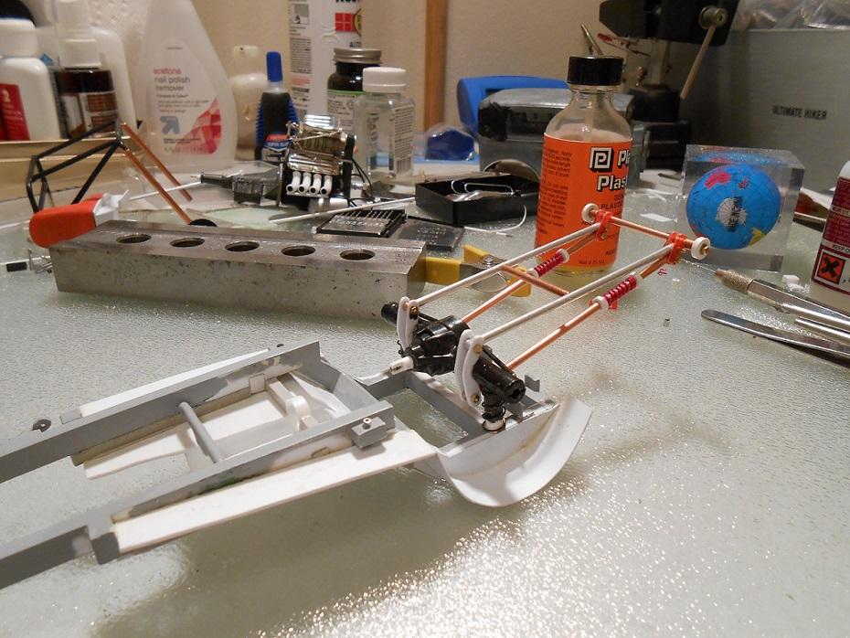

Hey Guys, I decided to bite the bullet, and hand form the rest of the brackets for my 1/18 scratch built wheelie bars. I finished making the wheelie bars, and thought I would share a few pics. Cheers, Lance
