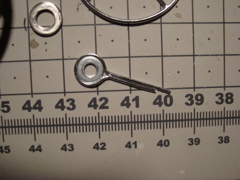

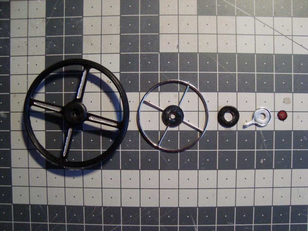

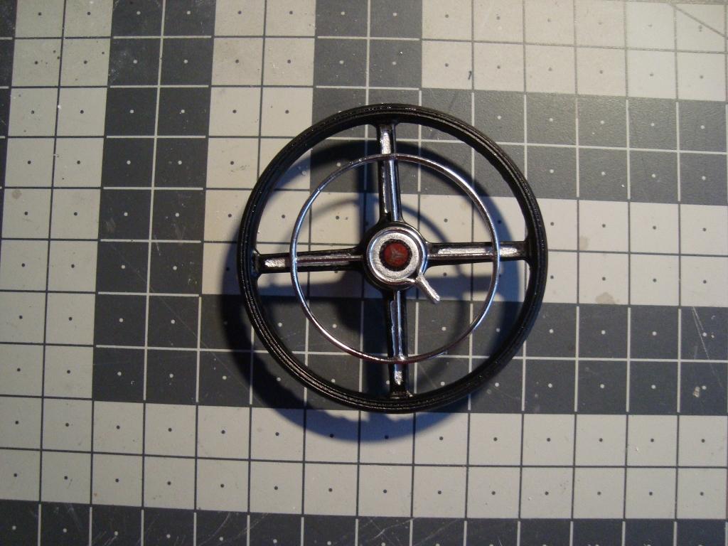

While I am waiting for the ”Future” to come from USA, I start with the steering wheel. I have bought the horn ring from MMC, but made my own ignition lever from al wire and a washer and I used the Pocher steering wheel.

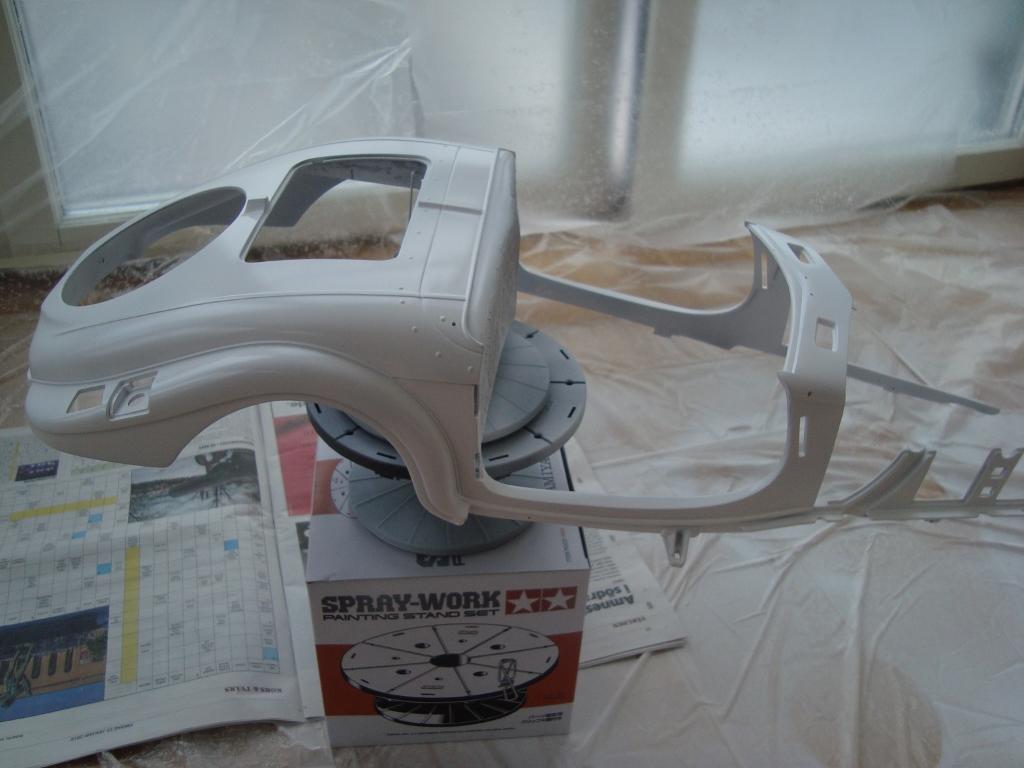

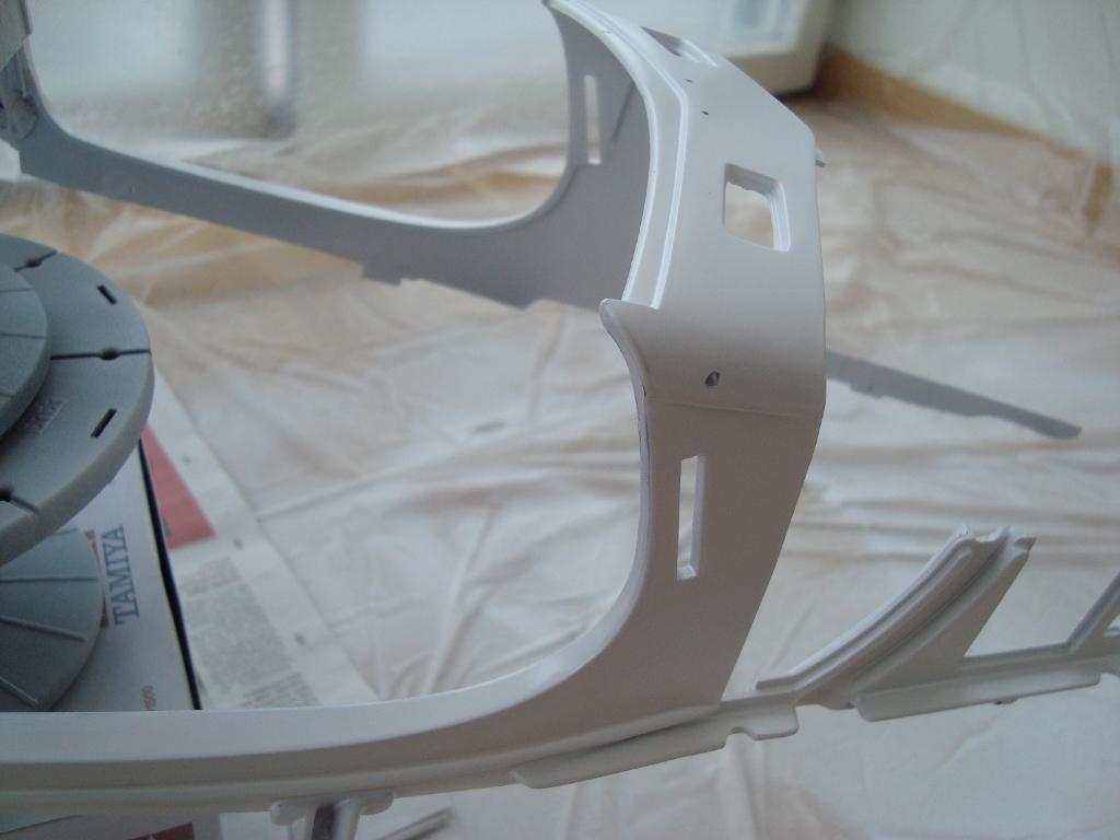

Trying to paint this red beast to white, not easy! The red tone is slightly visible through the white primer and paint, more primer and paint maybe. I have put this question in “Modeling how-tos”
I´m building this Pocher Mercedes in “Big boys” but I think my question is general so I put it here. This was not easy, I have put on three layers off Tamiya fine white primer and wet sanded between. Now when I put on the first layer of Tamiya “pure white” I see that the red I slightly visible. It´s not pure white, it has a kind of darker white, not as white as the fenders. The fenders and all other parts are in white plastic, so they get fine in white paint. Can I sand the paint and put on more layers of the primer?? Any idea how to solve this problem is welcome.

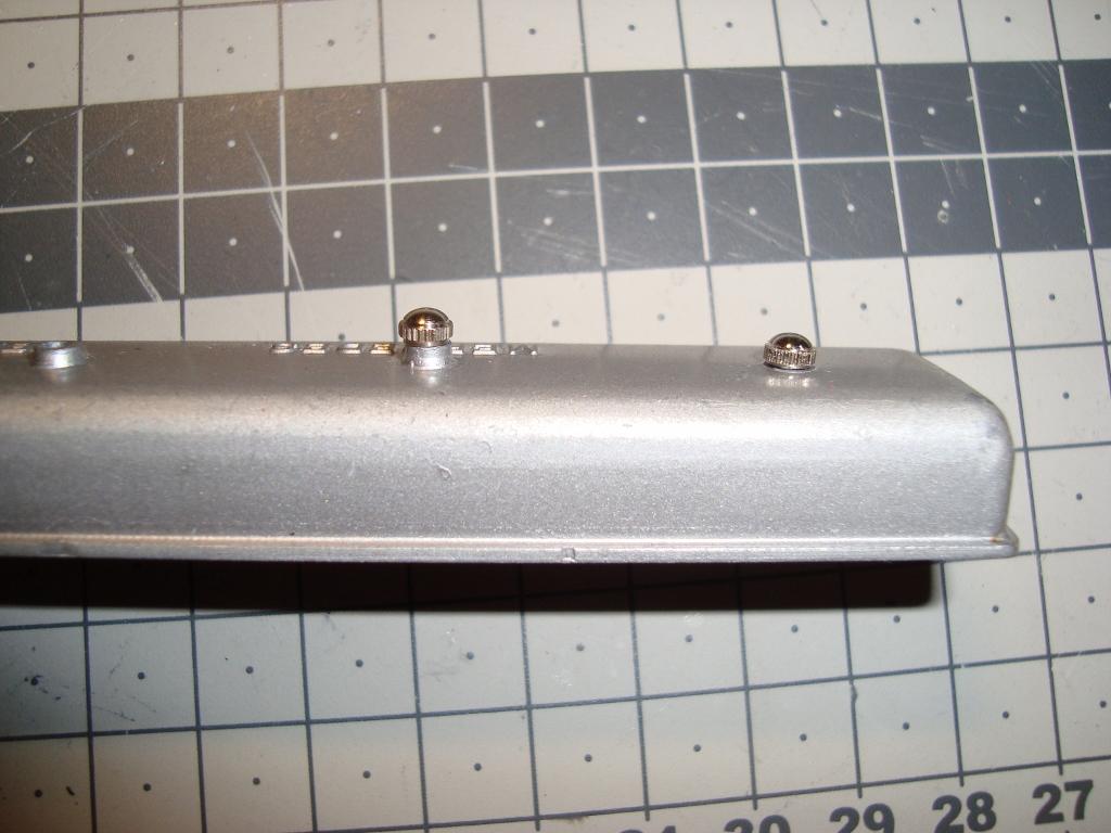

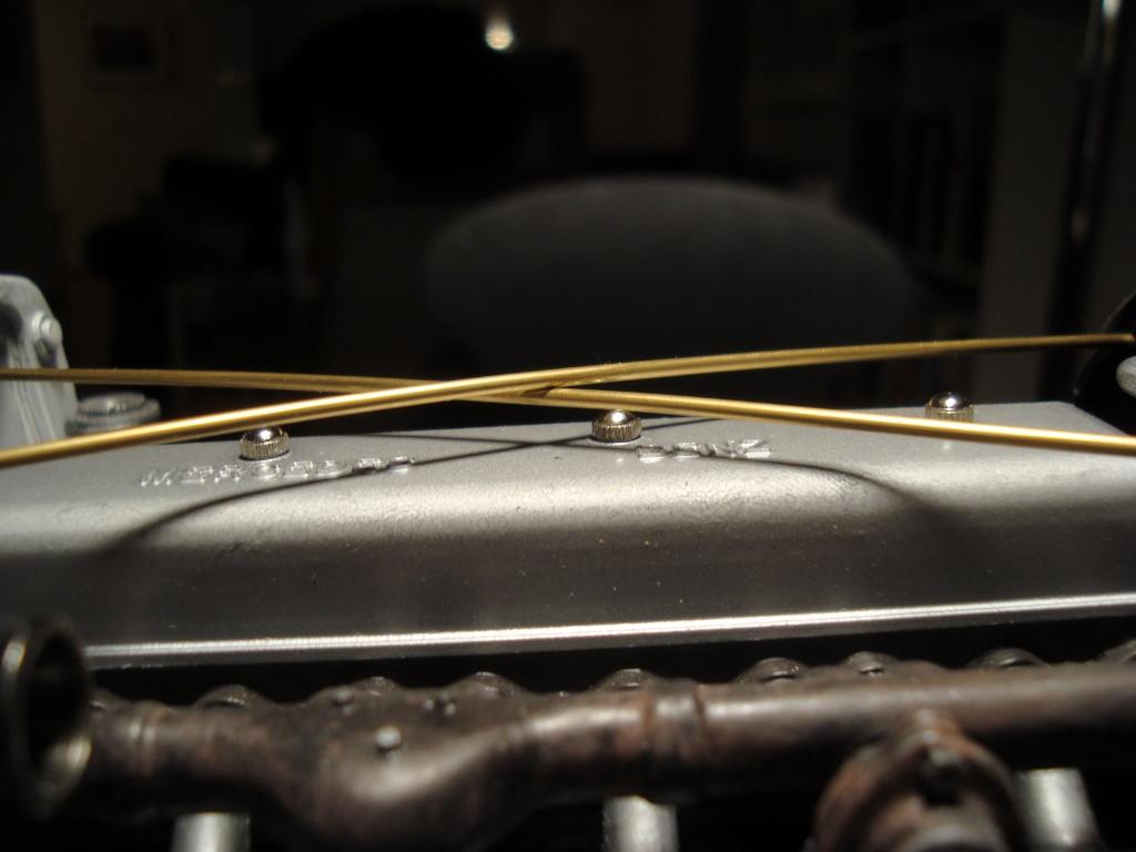

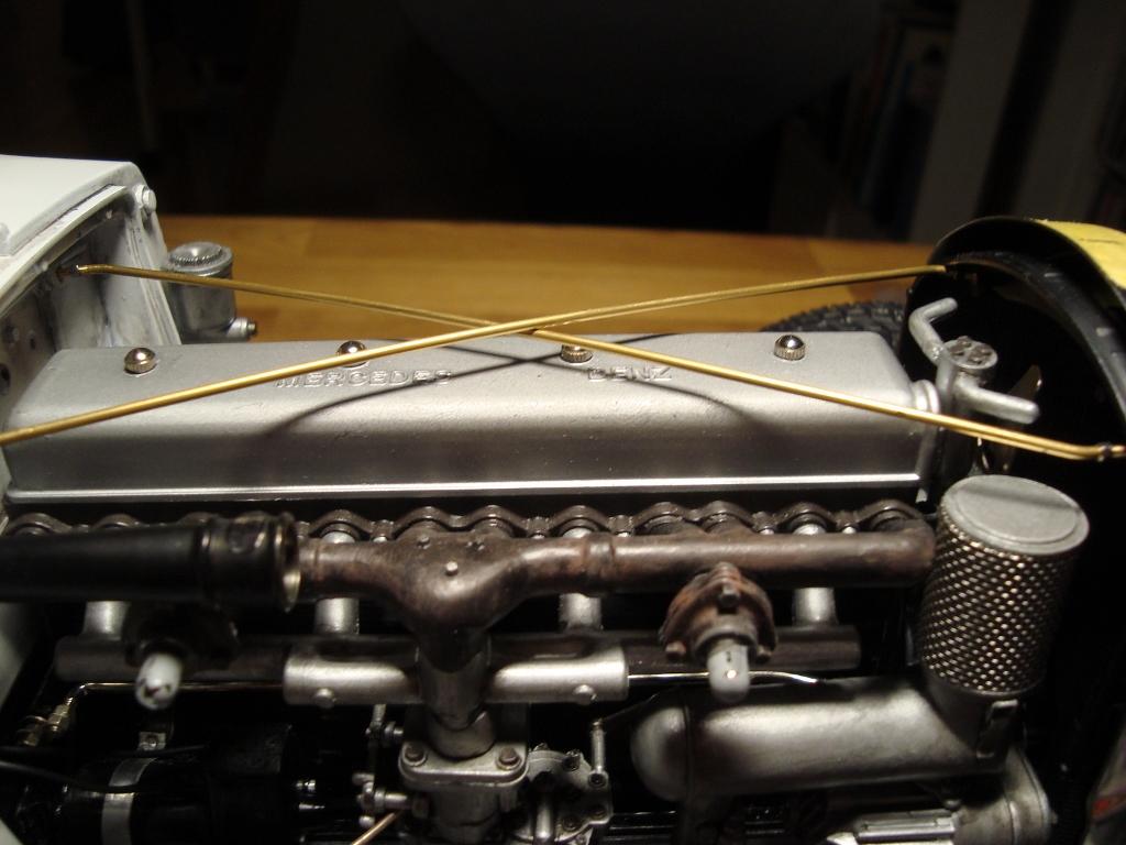

I have, which said earlier in this thread, that the radiator braces come to close to the engine top. I cut of the plastics “tops” and save some millimeters. Now I shall put some BMF on them.

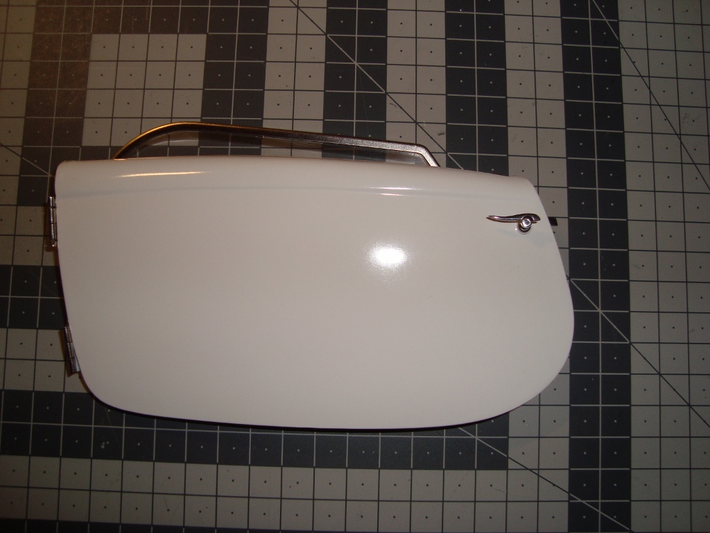

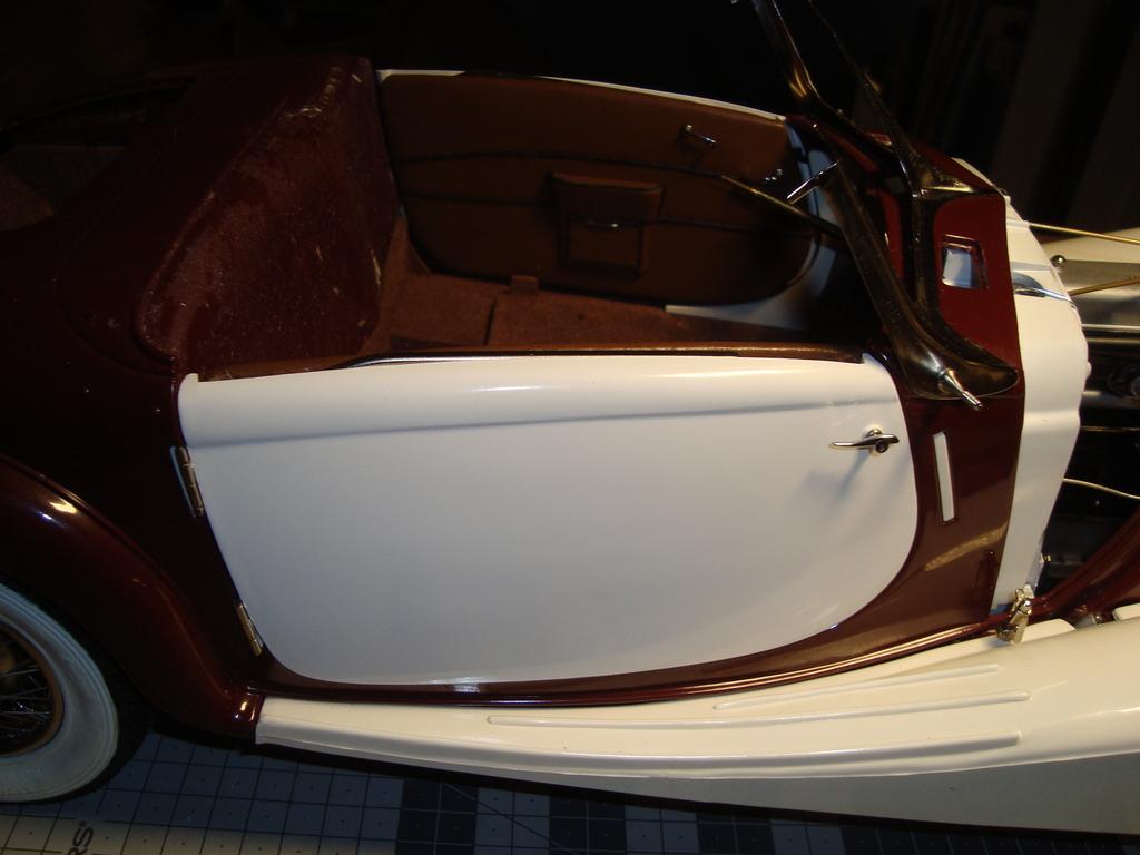

I think I got a decent fit for the doors. Maybe I have to take away some tenth of a millimeter around, to make place for the paint. Yes the door handles work and also the windows crank. I was not pleased with the fit of the hood, so I have to redo it, and glue the hinges one more time. Hope it will work this time.

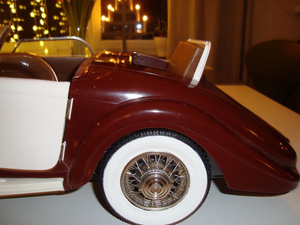

Cato you are right. My complete kit was missing this “small” part, so the only one I could get was this used maroon main body. I think I can manage this crack with some filler and sanding before painting.

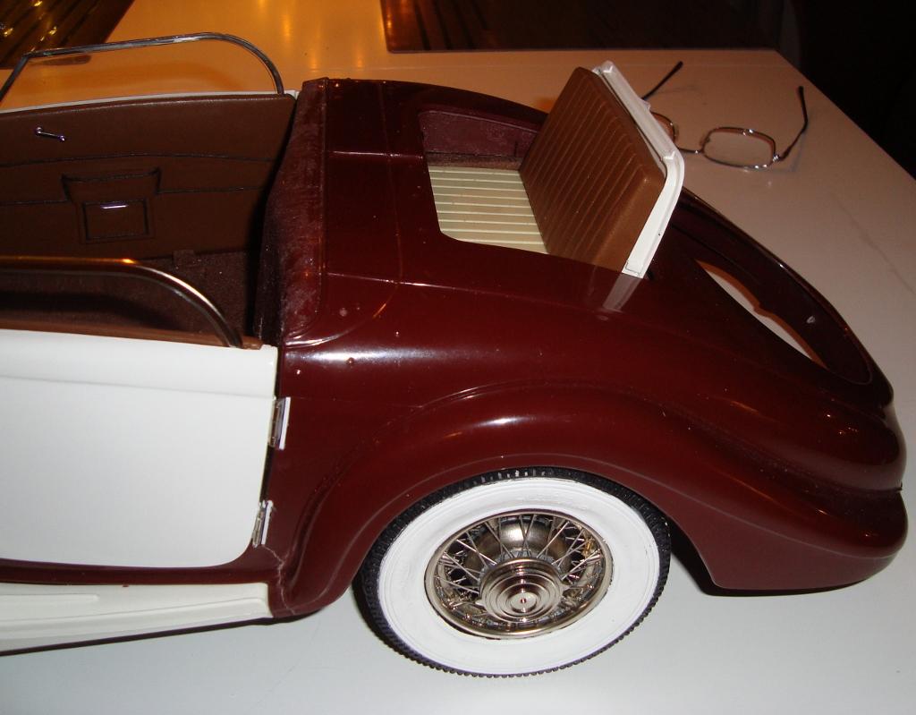

A new year and new challenges. Is this the right “height” of the rumble seat cover, when it is in open position? I don´t have any good reference photos.

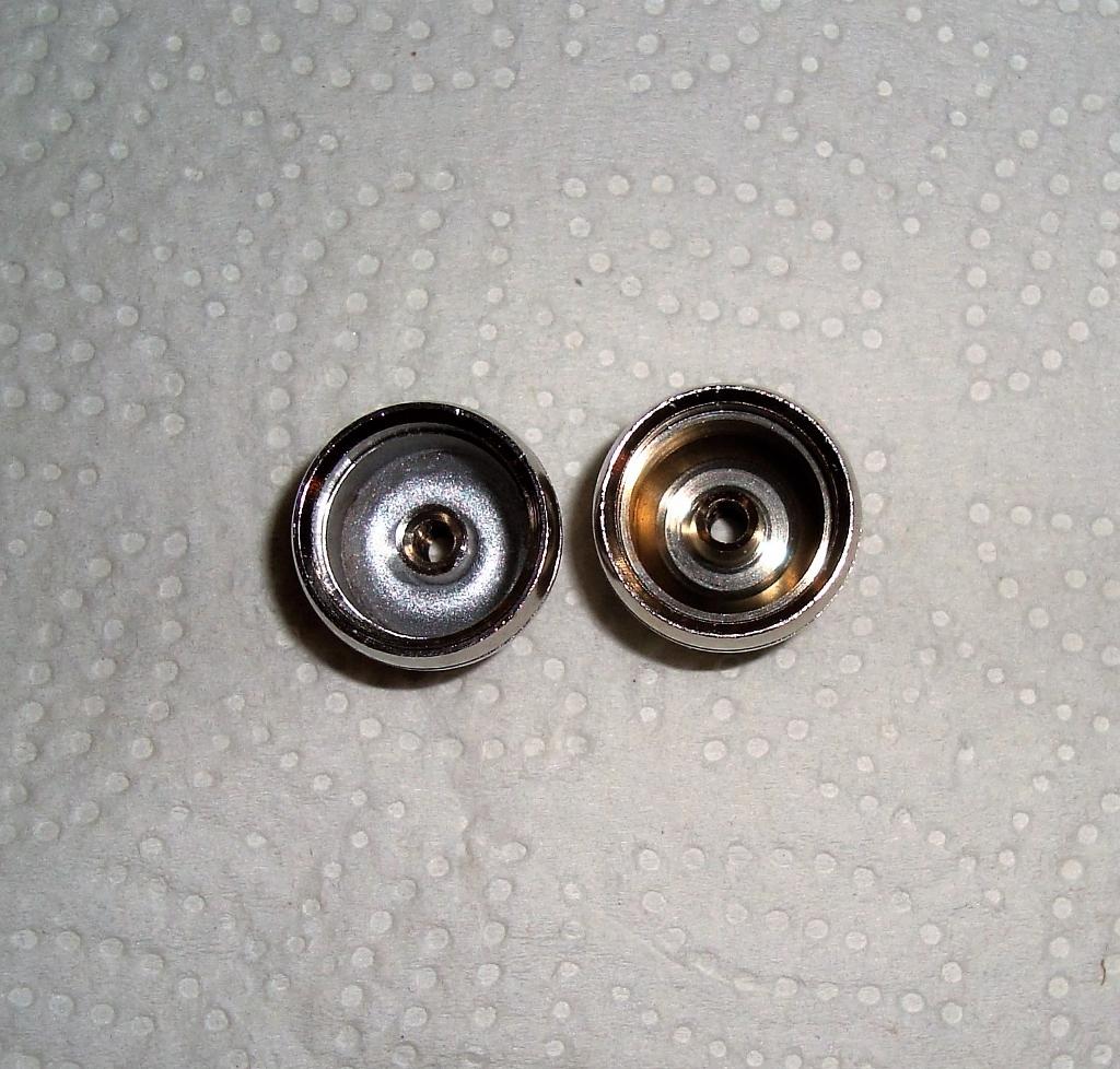

Some works with the spotlight/center headlight. Painted inside the housings with some chrome/silver to get rid of the “brass shine”.

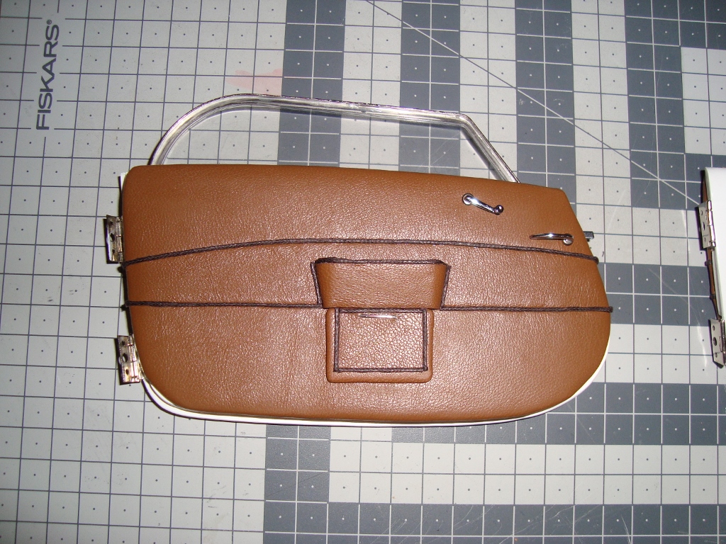

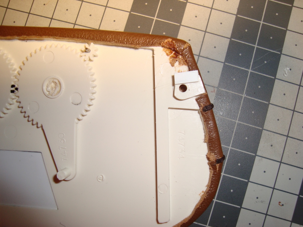

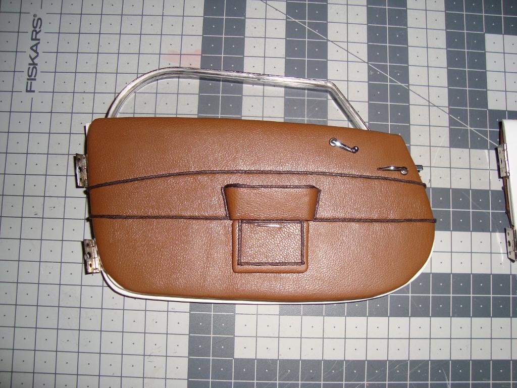

The windows “up and down” is working if I move the cranks careful. I have “dull down” the leather little, with the tips from Cato (fine steel wool) but you don´t see that in the photos. I think I am ready to glue the door half’s together. That I don´t know is what kind of glue I should use for this? Contact glue, CA-gel, CA-thin or ordinary “serious glue”. This “moment” of putting thing together is a little bit scary, I don´t want to mess up with it. Any tips is welcome.

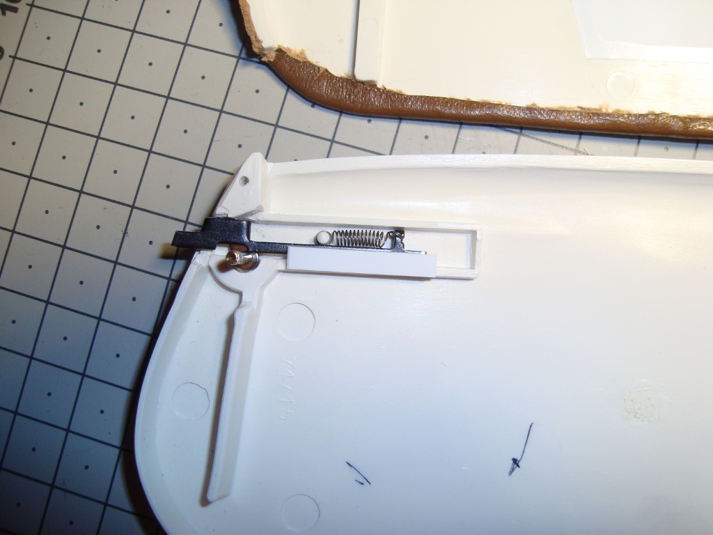

The doors! As you can see in the photos I glue some plasticards strips on the door, to improve the function/movements of the door latches.
