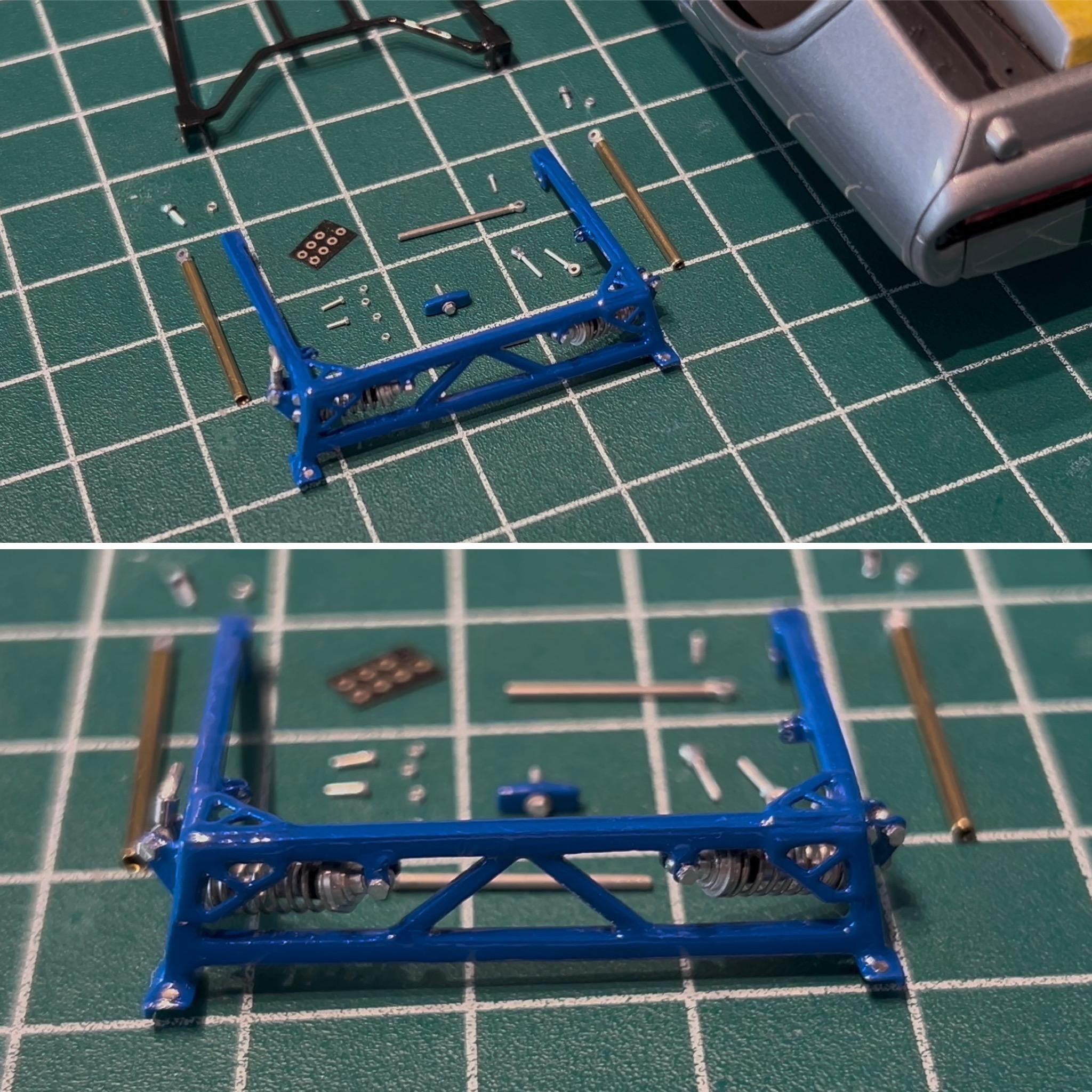

Above is the Total Control Products suspension upgrade that was installed on the Eleanor “Hero Car”. For those of you that have been following my post from the beginning, you’ll recognize the subframe connectors (painted in Black) that I scratch built. Also, the Rear Push Rod Coil-Over Suspension and Watts Link set up (both painted in Blue). TCB, Adam

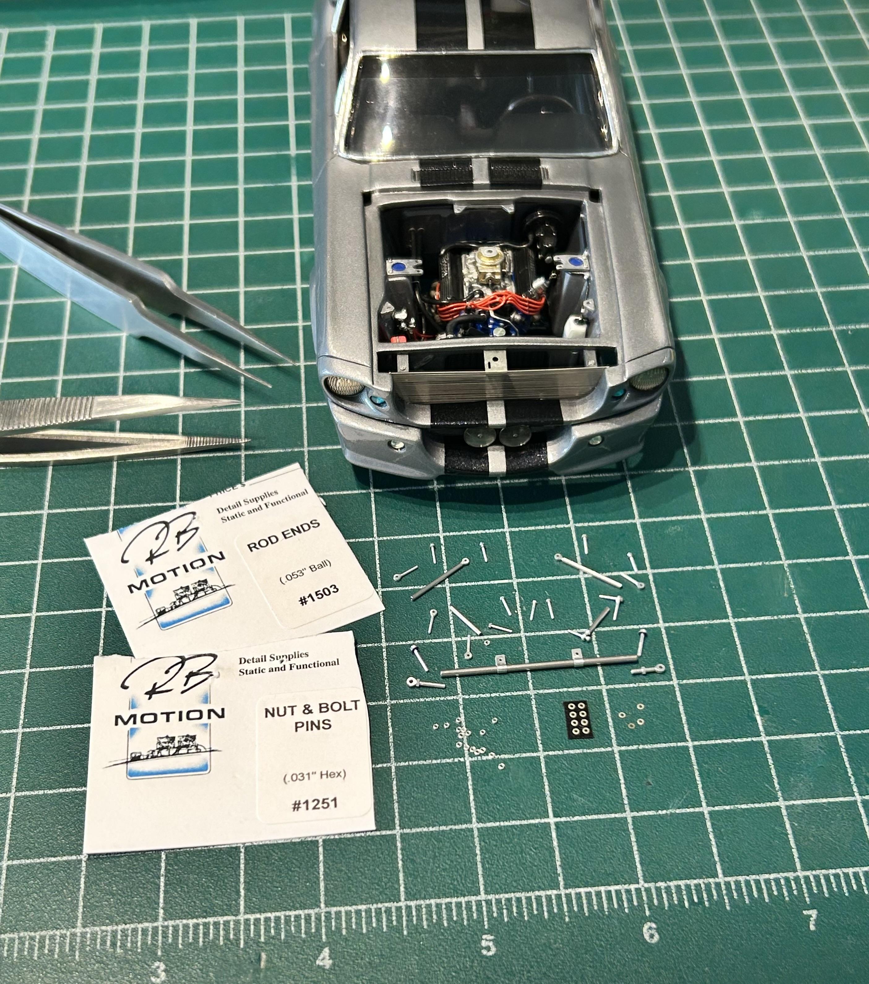

These are all the parts to build the Shock Tower Brace Kit from Total Control Products. I’m using 2K Clear as glue, so I don’t leave visible glue residue. All the machined aluminum tube, rod ends, nuts & bolts are from RB Motion. Not cheap, but he has the highest detailed quality products on the market. TCB, Adam

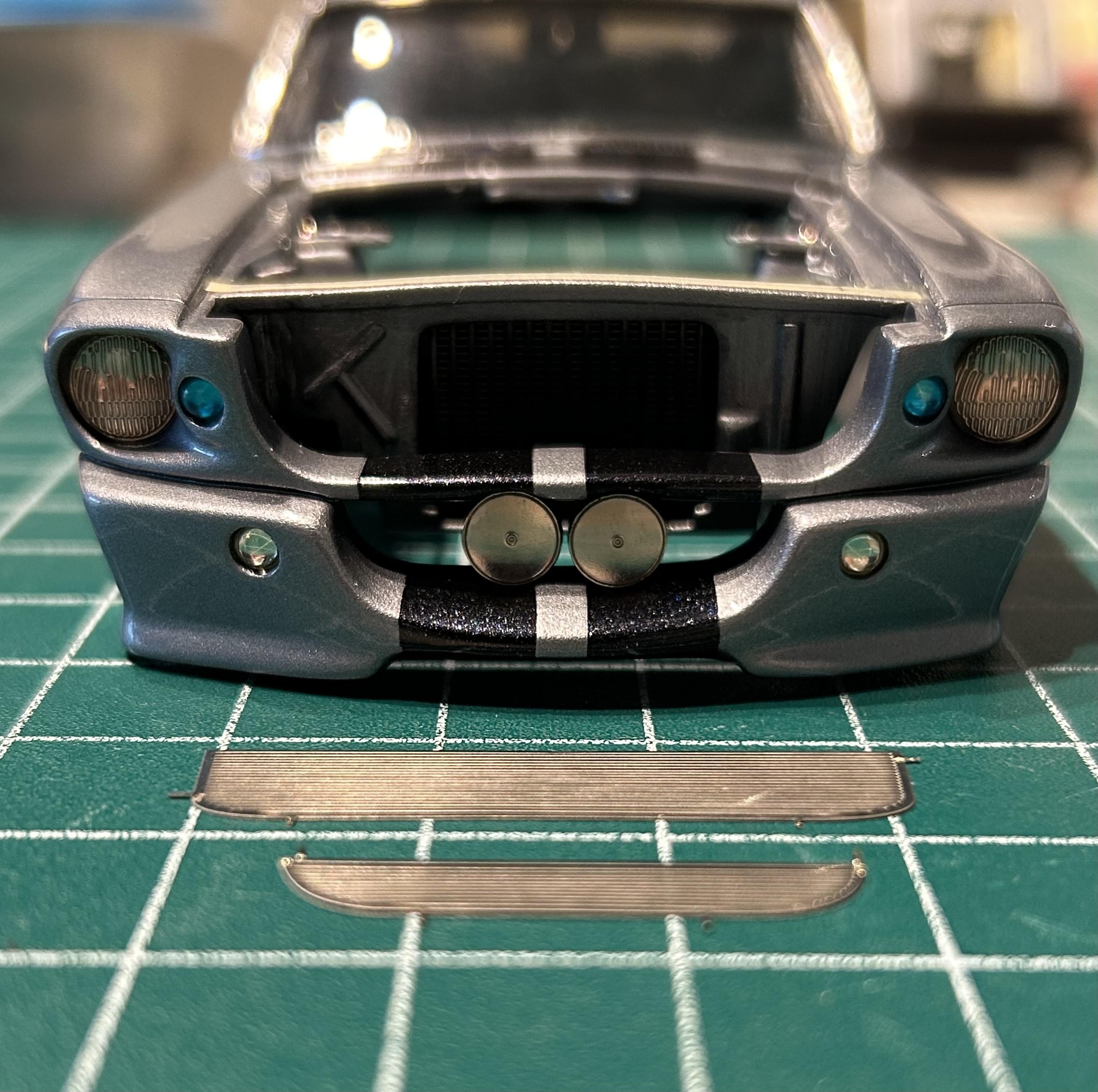

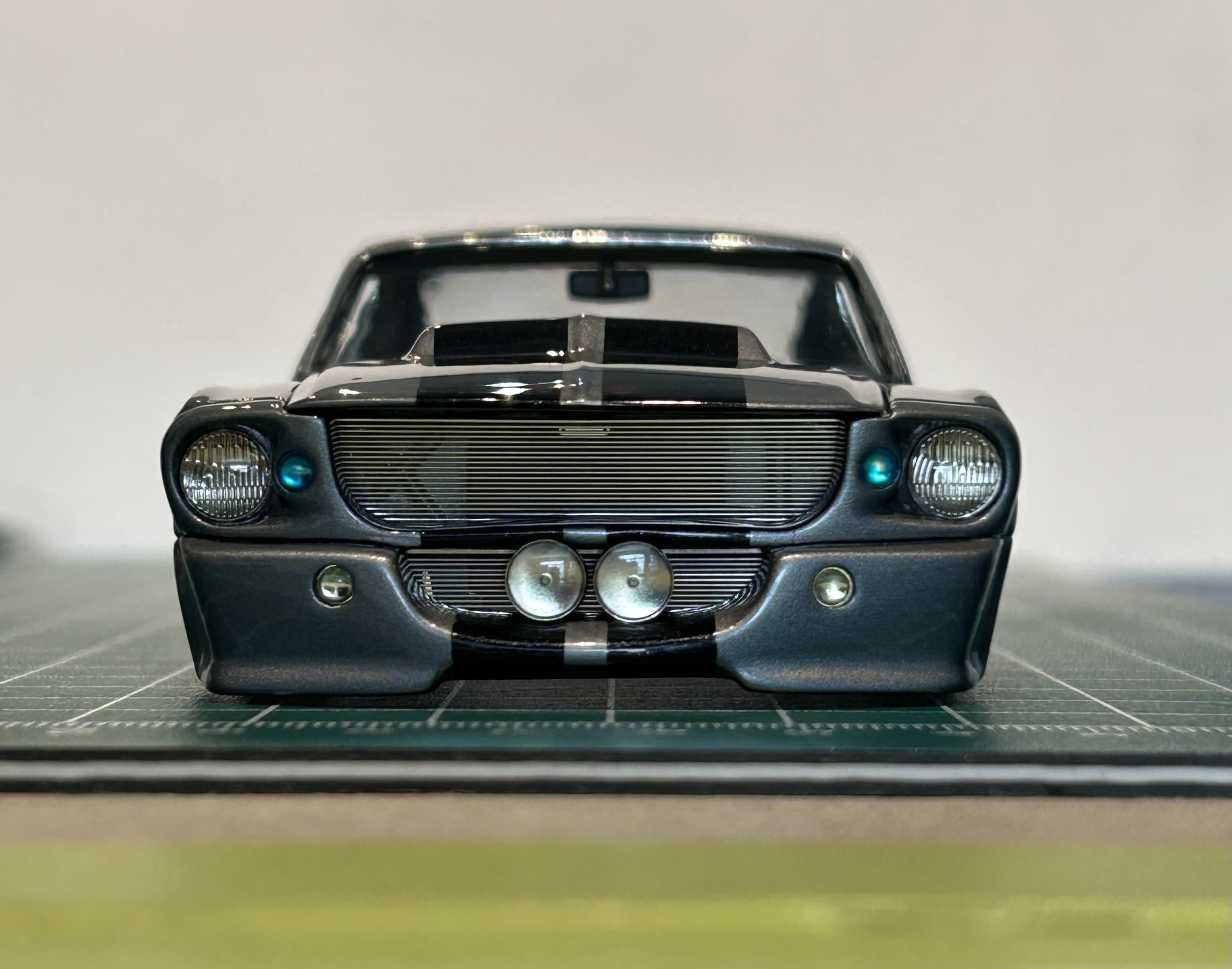

Head Lights & Fog Lights installed. Scale Productions produce some very highly detailed head lamps. Photo etched grill inserts are next. This Eleanor is getting her face put on !

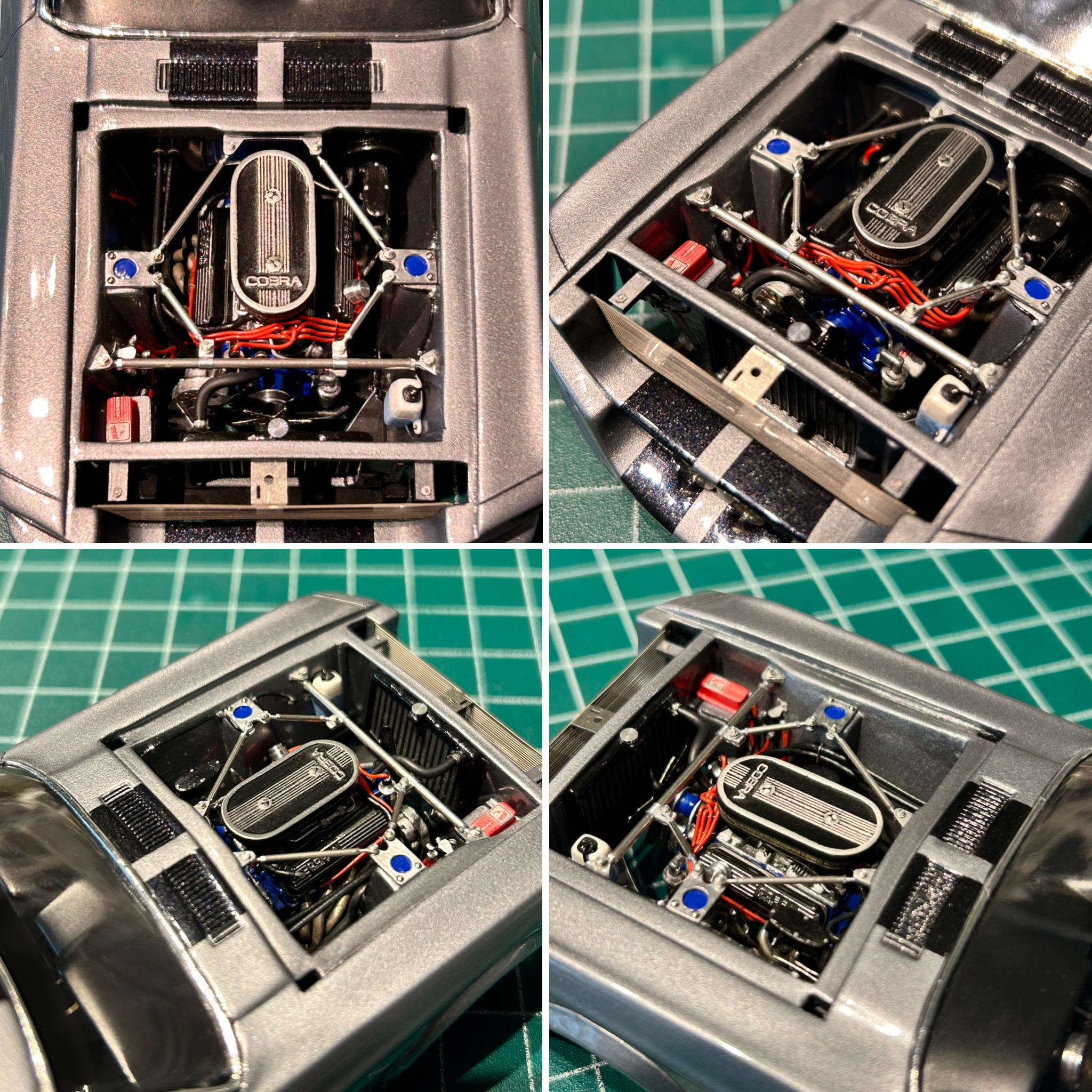

Some nice overall engine photos before the body gets in the way. Throttle linkage wire and Master Cylinder vacuum hose to be installed. All wiring and hoses get attached once body is attached. - Up Next: Completion of Front Strut Tower Bracing. Interior Flocking and Assembly. Roof Liner and Window Install. TCB, Adam
