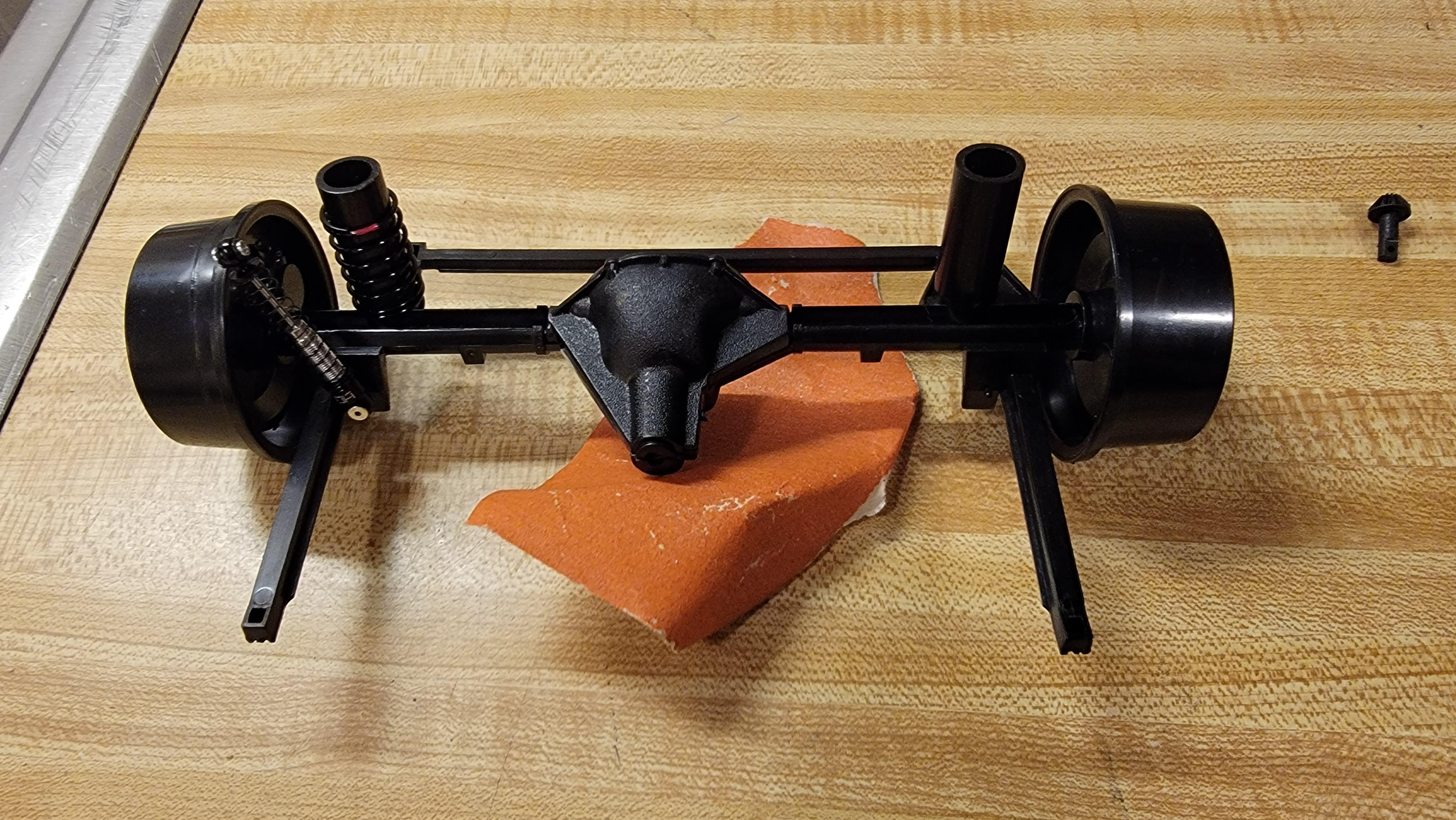

  6. So knowing these posts on the rear axles have to go so I can do the coils that are supposed to be there I was curious about what the ride height would be if I didn't use spacers on the touring car springs. I decided I'd marke the posts and cut them at that height before I lopped them off completely. Doing the scale conversion it's roughly .25" which equates to a 2" drop on a 1:1 scale.

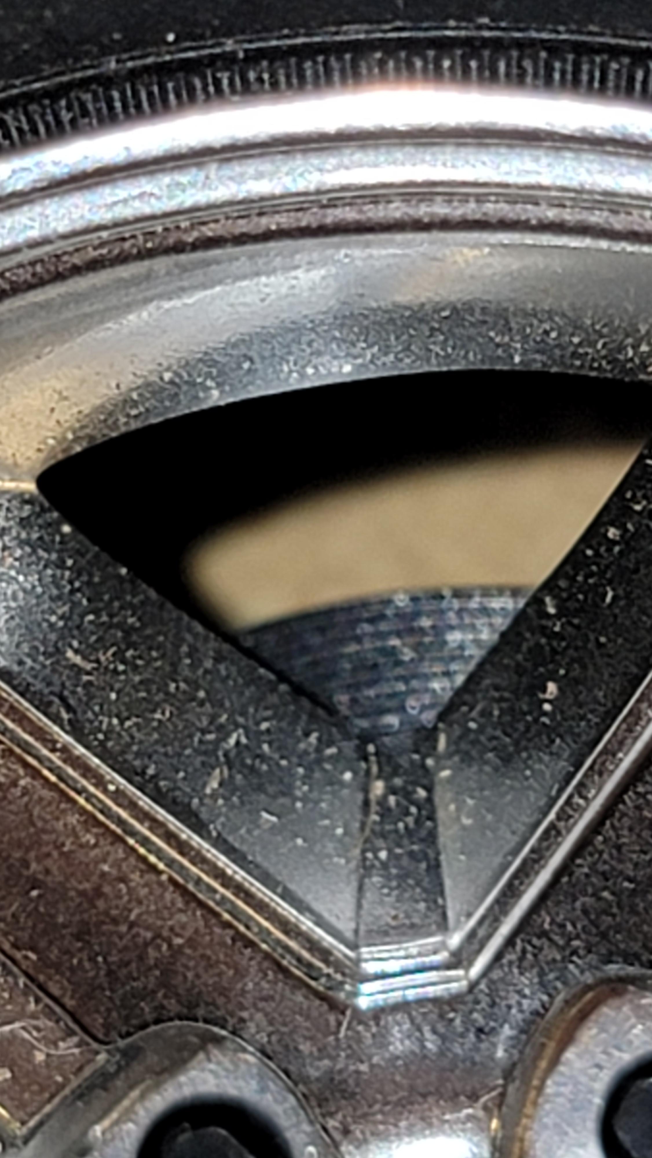

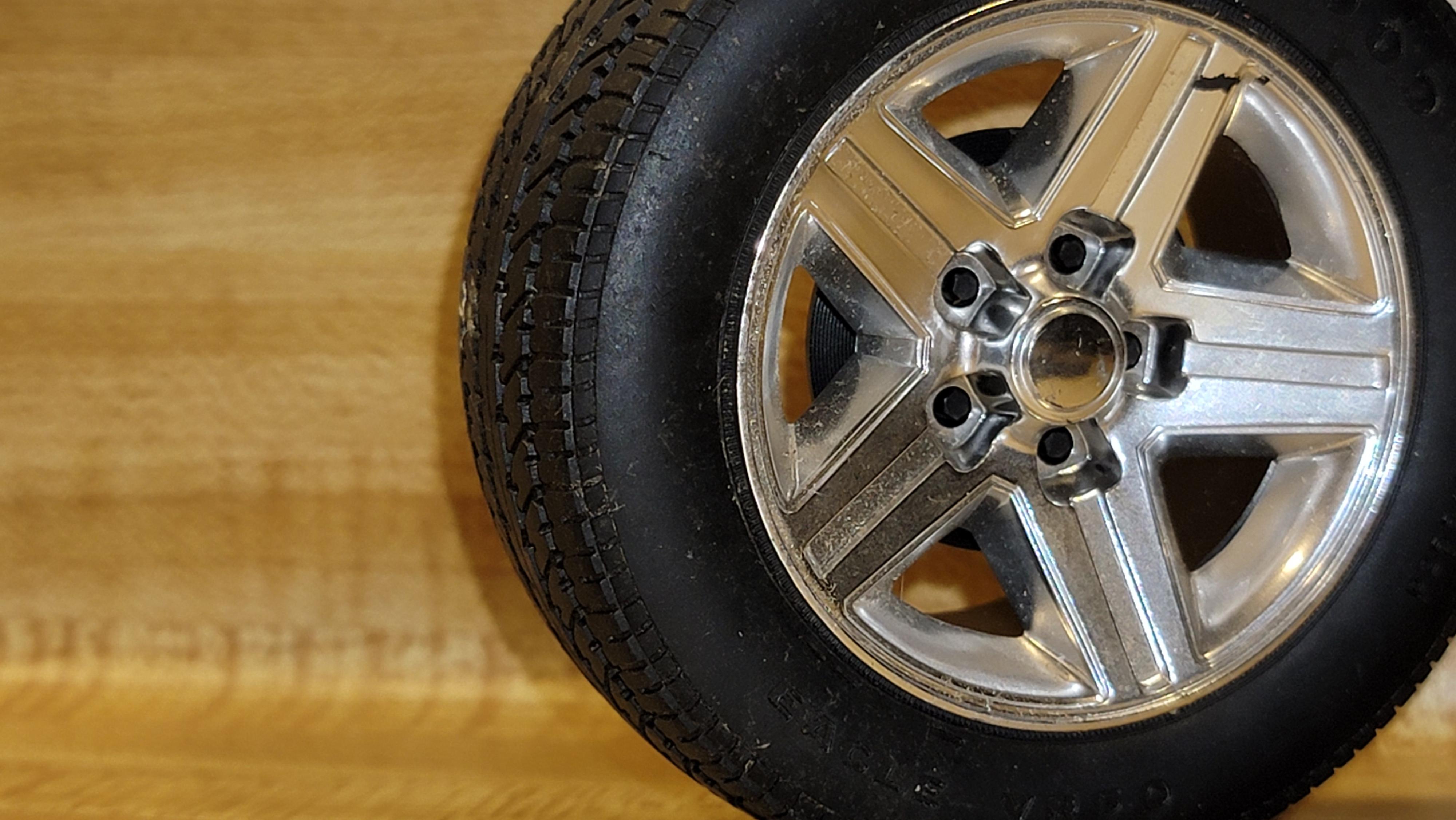

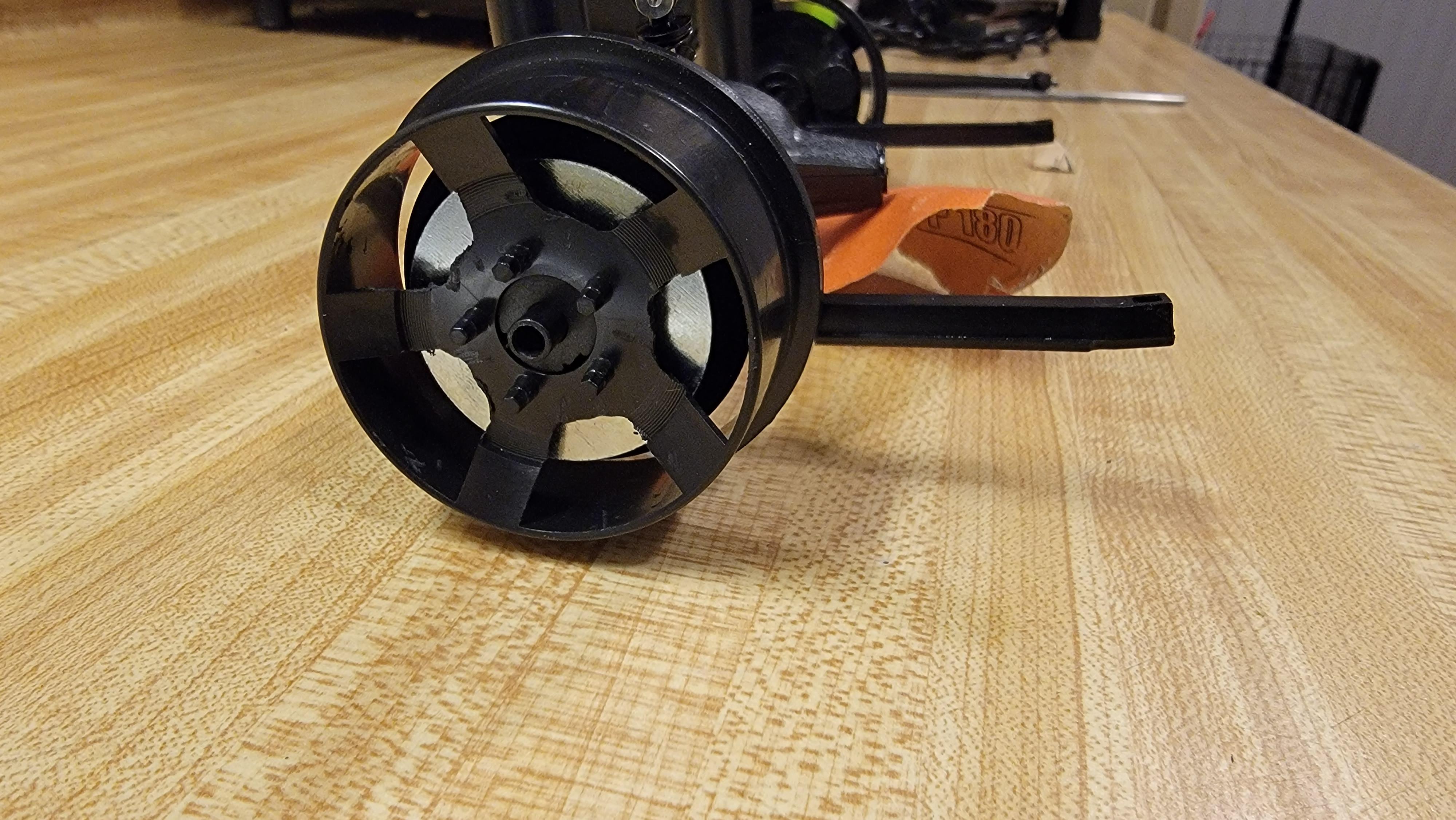

  7. I see two huge roadblocks coming up. For starters I forgot that monogram used the spacer on the axle shaft as a tire retainer. This isn't going to pose a problem. However I haven't decided what the best way to attach the wheel to the axle shaft. ??? Well.... guess that's some brainstorming while I'm making jet parts. The other roadblocks is that I've cleared the material that they were using as a brake disc. I'm using a 1.25 inch washer behind the wheel. The problem is that since they molded the brake disc into the wheel I don't have clearance for a brake caliper. ?‍? for that I'm going to build up material on the face of the backing of the wheel. Once I have enough to follow the profile of the back of the wheel face, I'll trim some from the backside of the back of the wheel to make the clearance. Since this kit doesn't come with calipers I'll have to make them using the brake shield that mounts to the axle and spindles.

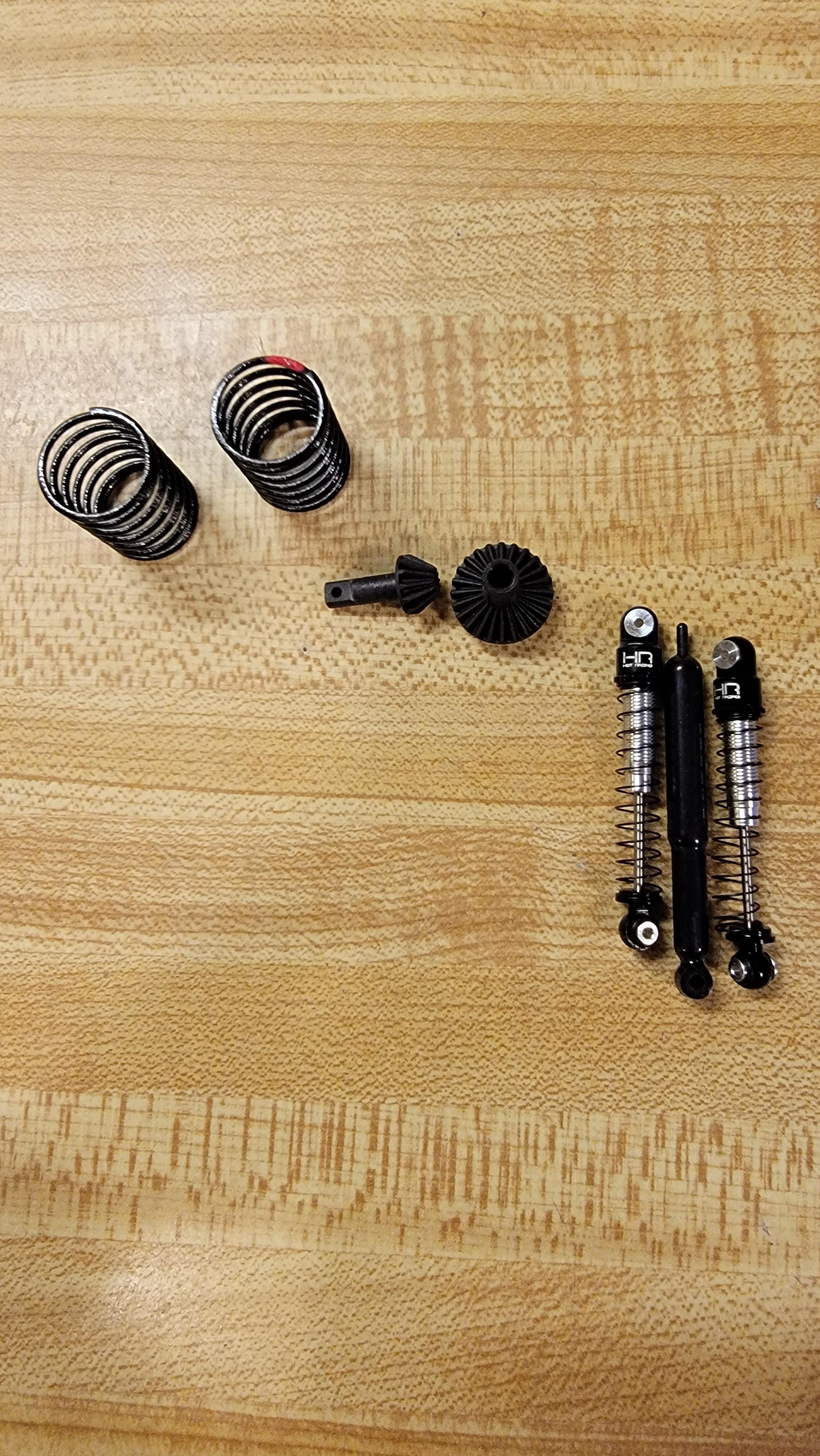

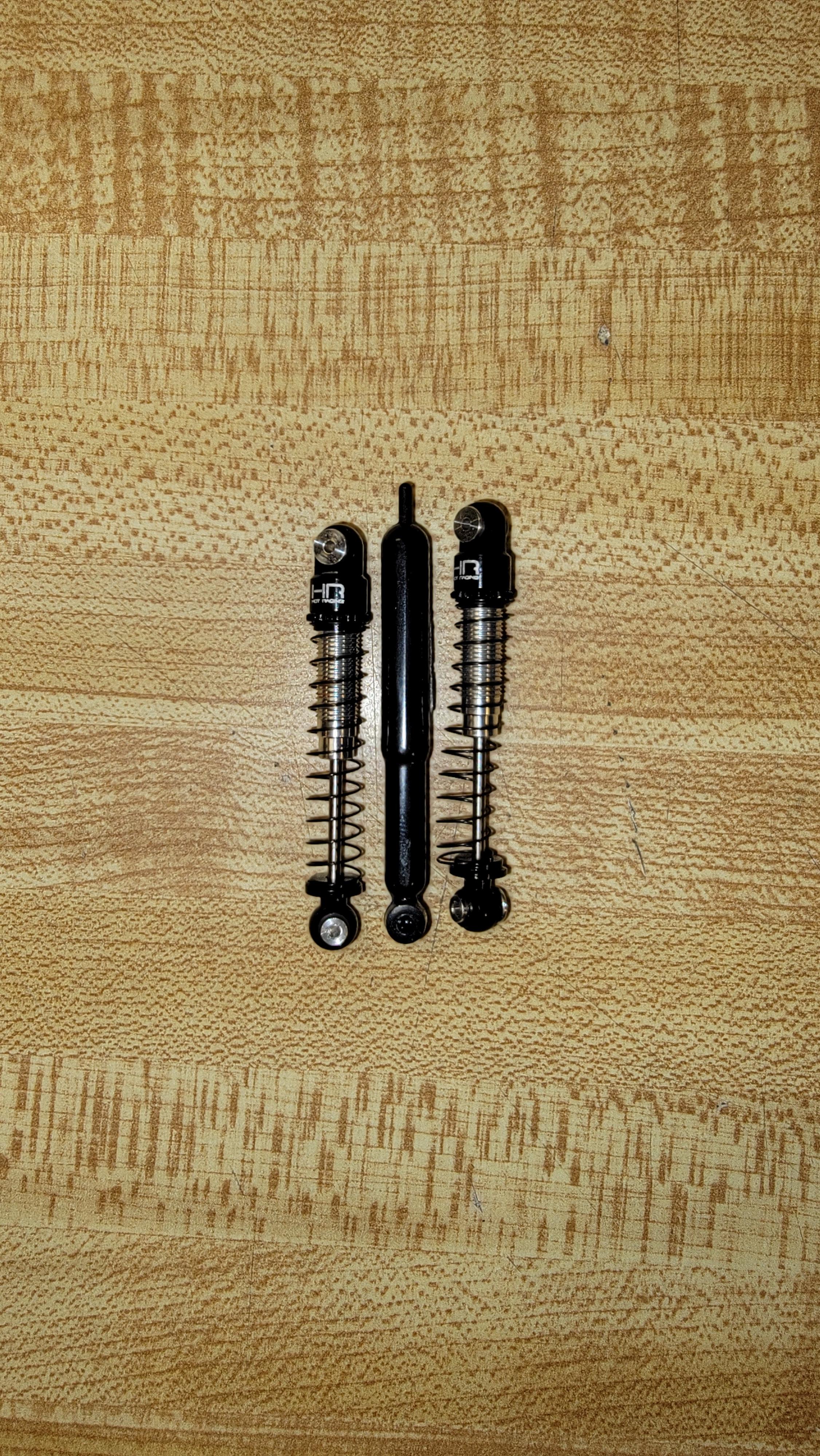

  8. Working on the car a bit tonight. Stopped by the LHS and picked up a couple things I was hoping would make life a bit easier. Picked up a traxxas diff, some 1/24 scale shocks, and some 1/10 touring springs. I polished up the .125 metal rod I'm using as axle shafts. I'm liking where this is headed. I'm not one to blend hobbies (RC into styrene) however, the scale of things seems to work out a bit. The shocks came with really small screws. These seem like they'd work great for pinning things if you don't have pins. I'll probably use them for the rear shocks.
