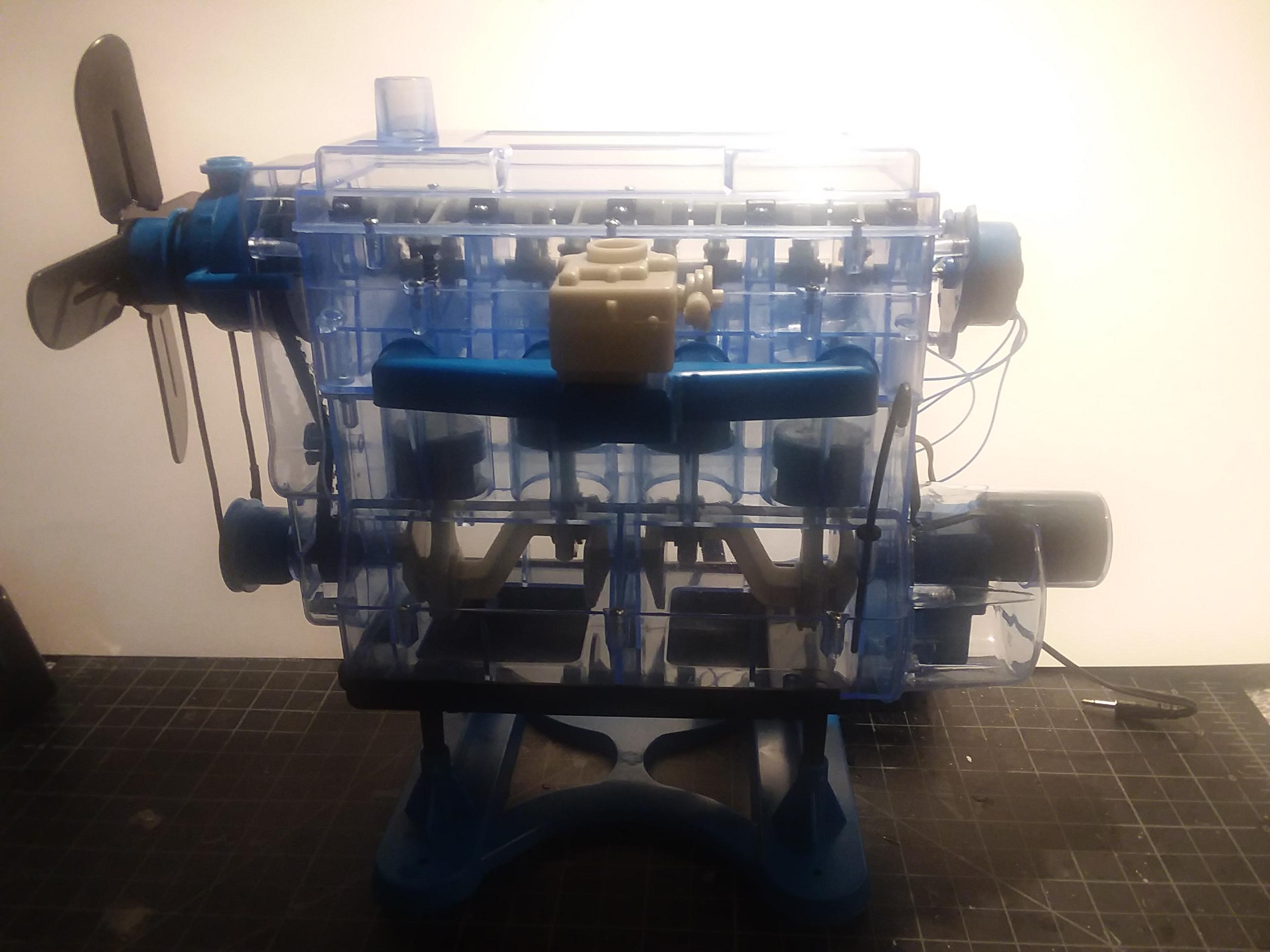

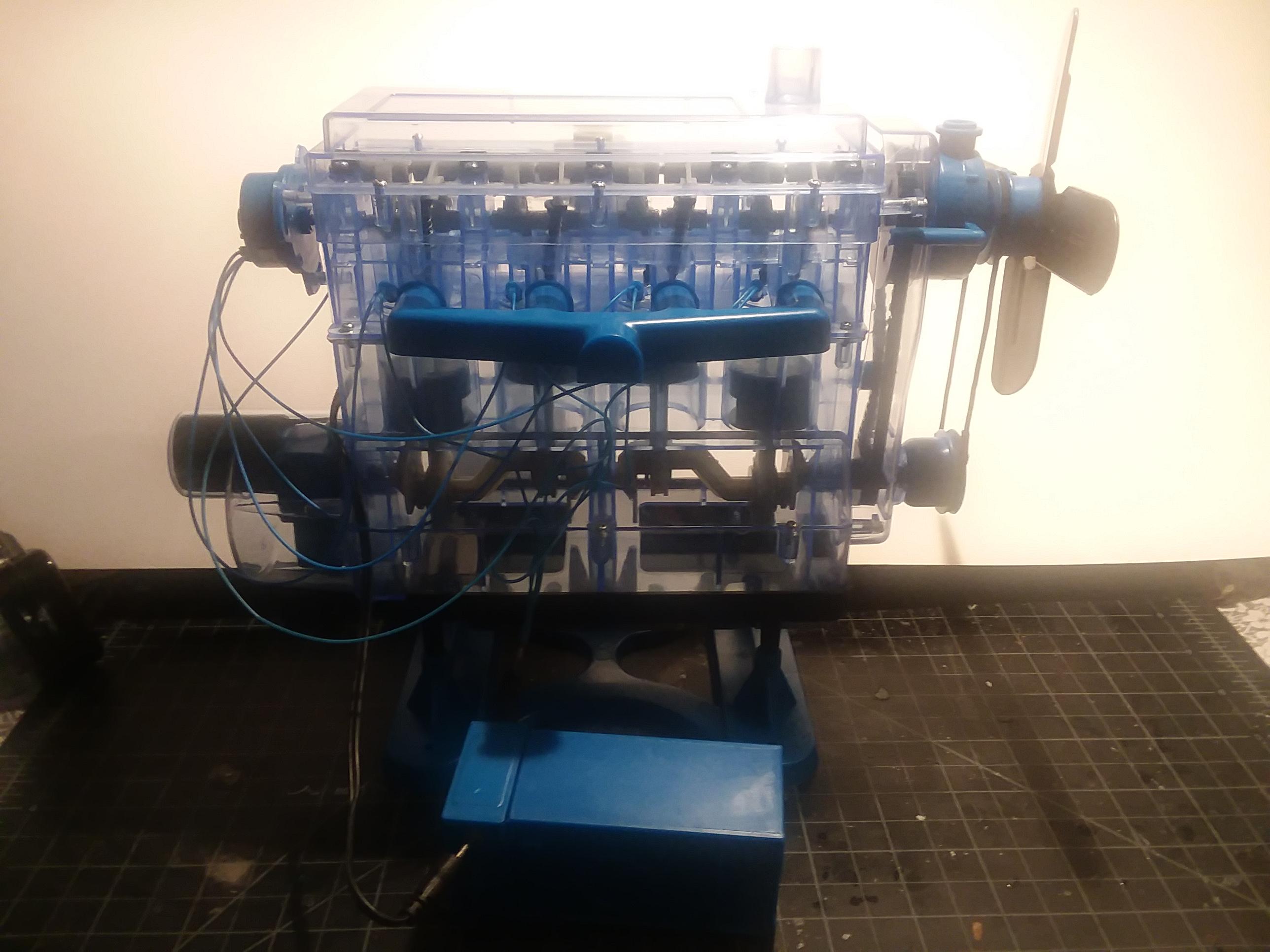

Next up is this Smithsonian 4 cyl. kit purchased in DC years ago. From what I've read, the new kits on Amazon use a more brittle plastic that splits when the assembly screws are installed. The plastic in this kit is softer so we will see. -

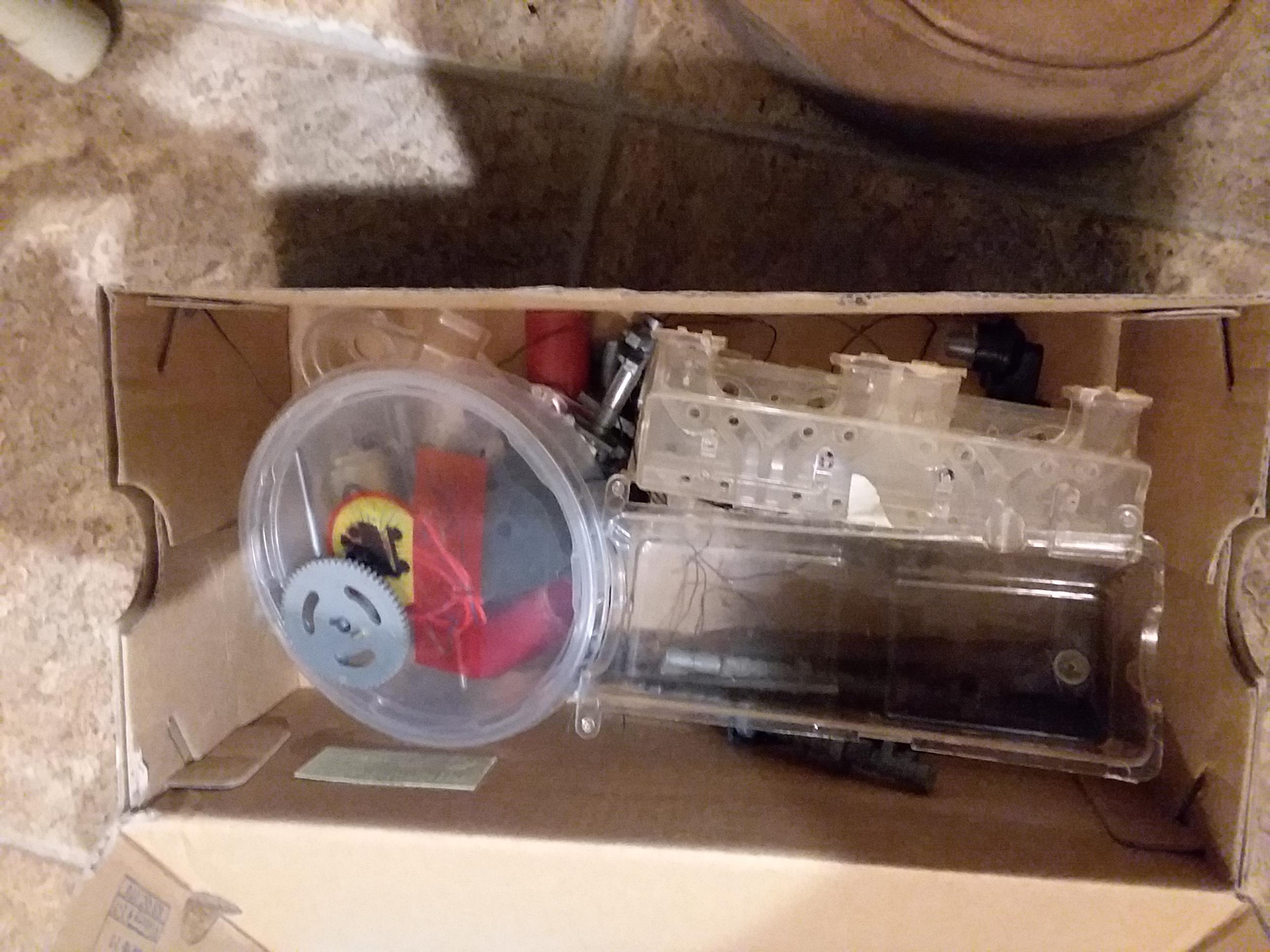

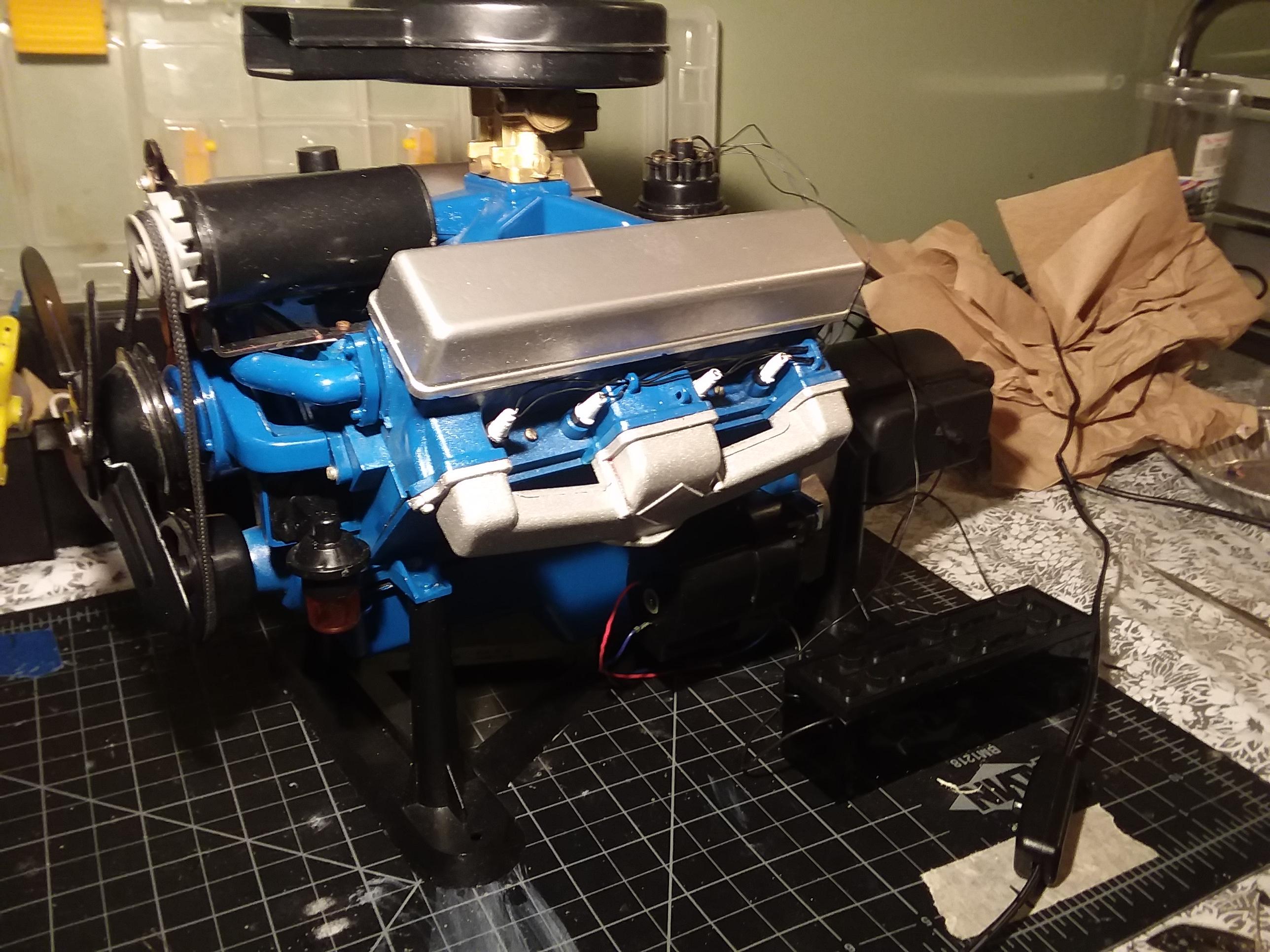

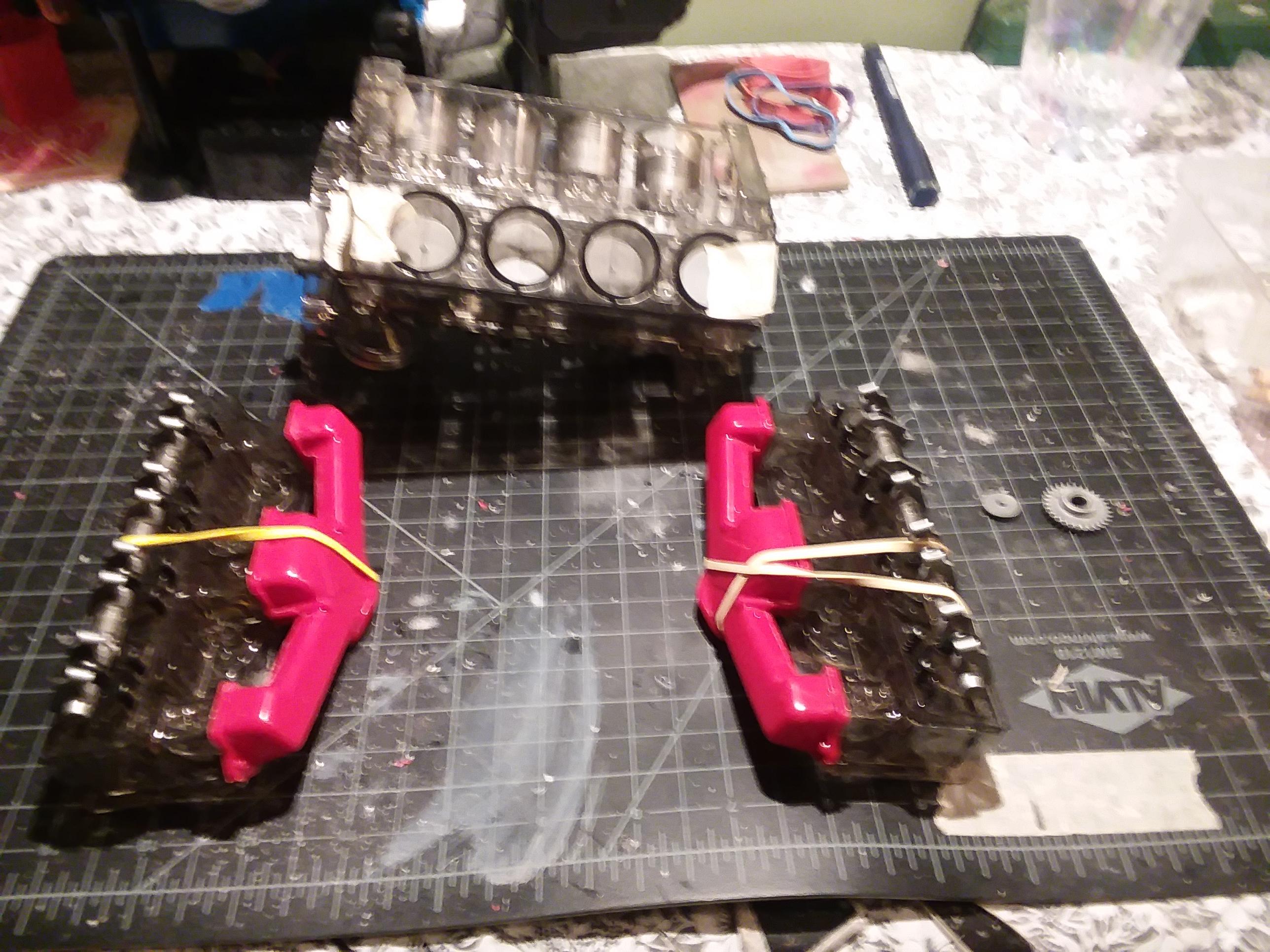

Visible V8 attempt No. 1. First attempt when I was a kid and what's left. (1960 copyright ) Attempt No. 2 as a teenager (copyright date of kit unknown) Resurrected it about 10 years ago and made it into a painted non-functioning display. (too many broken parts to save). Took it out of storage yesterday and freshenend it up. Attempt No. 3. New in the box purchased off of Craig's list for $100 about 5 years ago. This is the 1987 copyright motorized version. Some flaws that need correcting that were learned over the years. Make sure camshaft is free of mold marks, add upper cam bearing caps (see second pic of second attempt) , round off bottom of lifters, add thrust washers to remove play in camshaft. Here is a pic of the upper camshaft bearing support used to keep the cam from flexing -

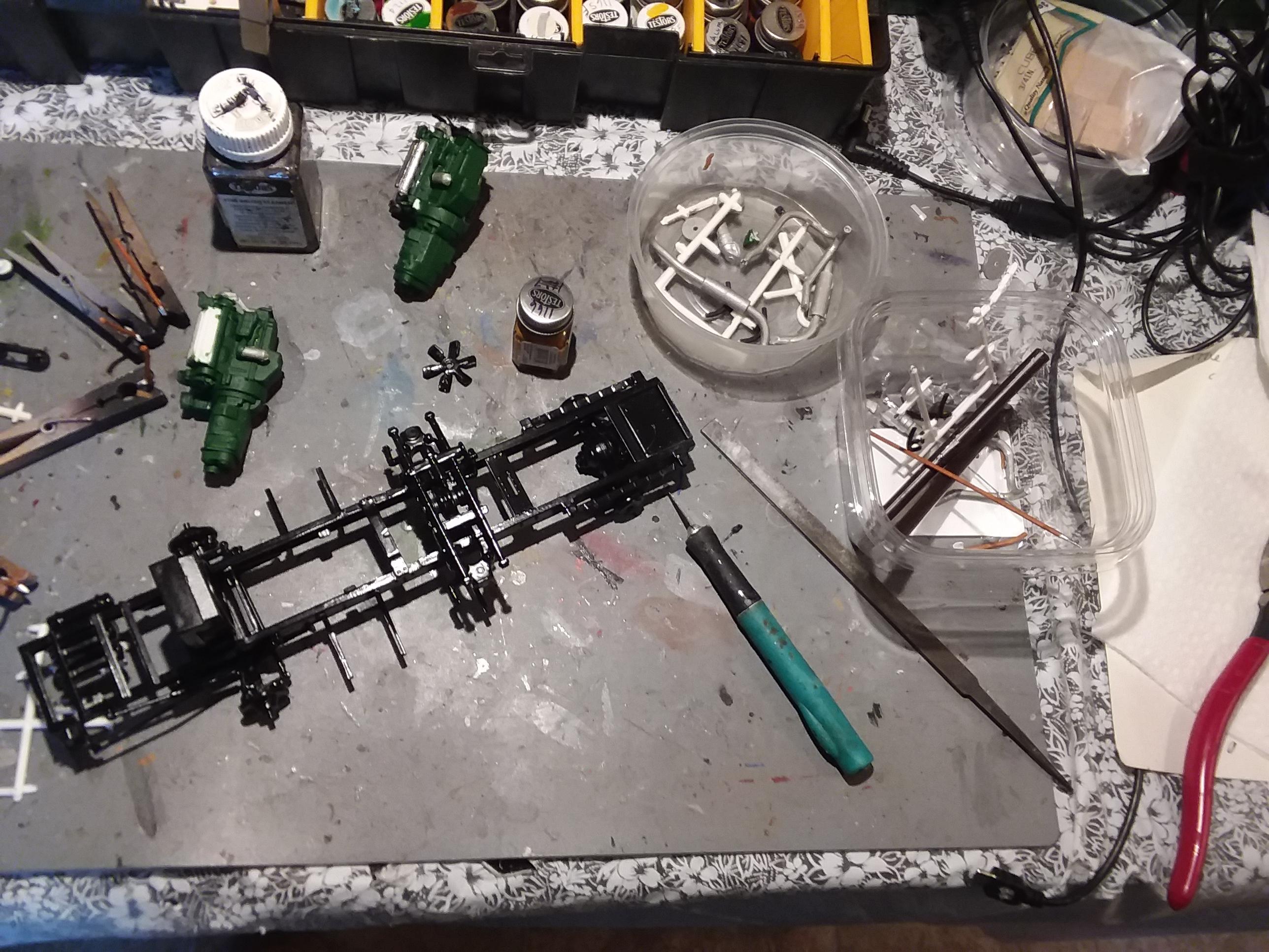

Another one done, 66 Suburban on 78 GMC 4x4 pickup chassis. Built the trailer from the leftover parts. Now working on two AMT American Lafrance fire trucks.
