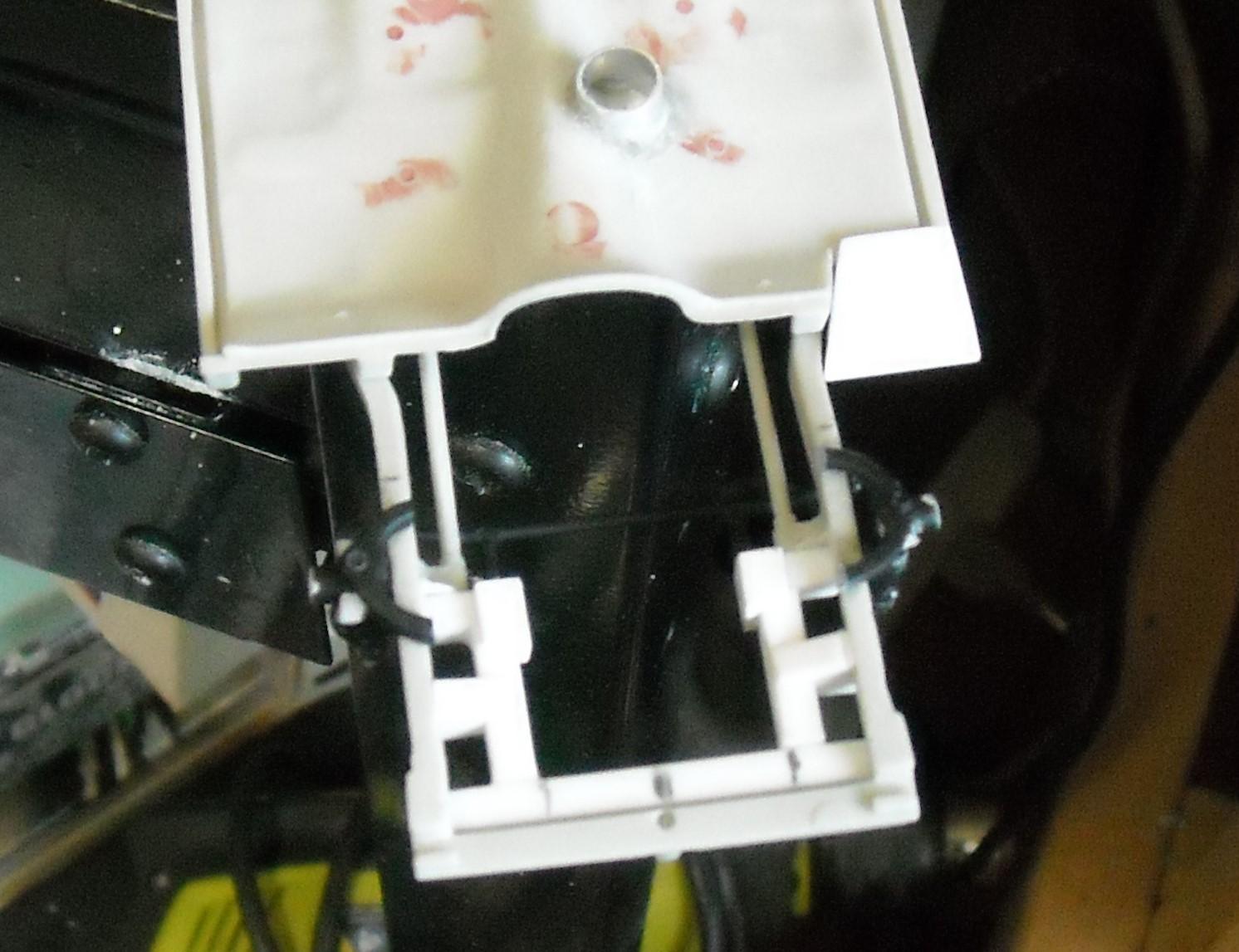

  8. Started over with the Nichels chassis. This time I spaced the 1/8" square tubing with a 3/4" gap to drop the engine into, this gives the oil filter and pump more clearance on the drivers side and the fuel pump more room on the other. I added 4 pieces of .020 plastic sheet 1/8"x3/16" to serve as motor mounts. This places the engine level and reduces the 3/4" gap enough to mount the engine. Also placed the front cross member 3/64" more forward to clear the fan. Still a long way to go!! Gerald

  13. Think I may rebuild the entire chassis! I can use the first one as an example of what not to do! ?
  14. Yeah, I'd say lose about half or more!!! At this point I need to rebuild the whole front of the chassis. The engine cage is also to tall!
  15. Got to do some major suspension work!!
  16. Sadly upon the final assembly, the engine cage is too tall and will have to be rebuilt. I'll put this on hold and work on the mercury for now?
