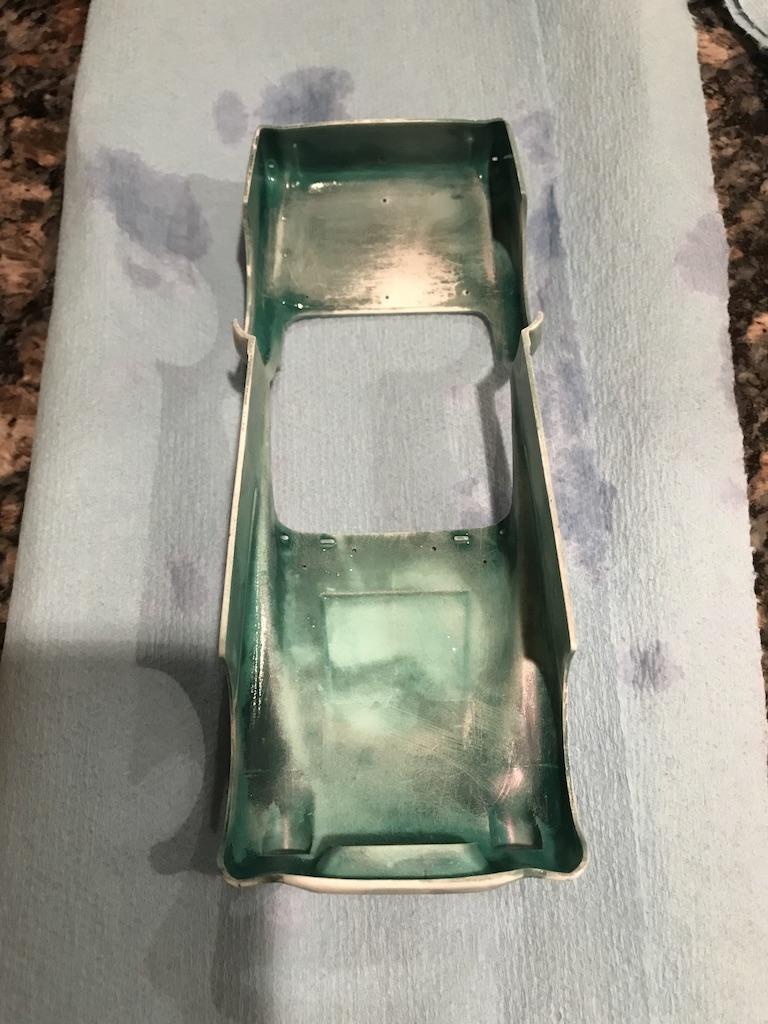

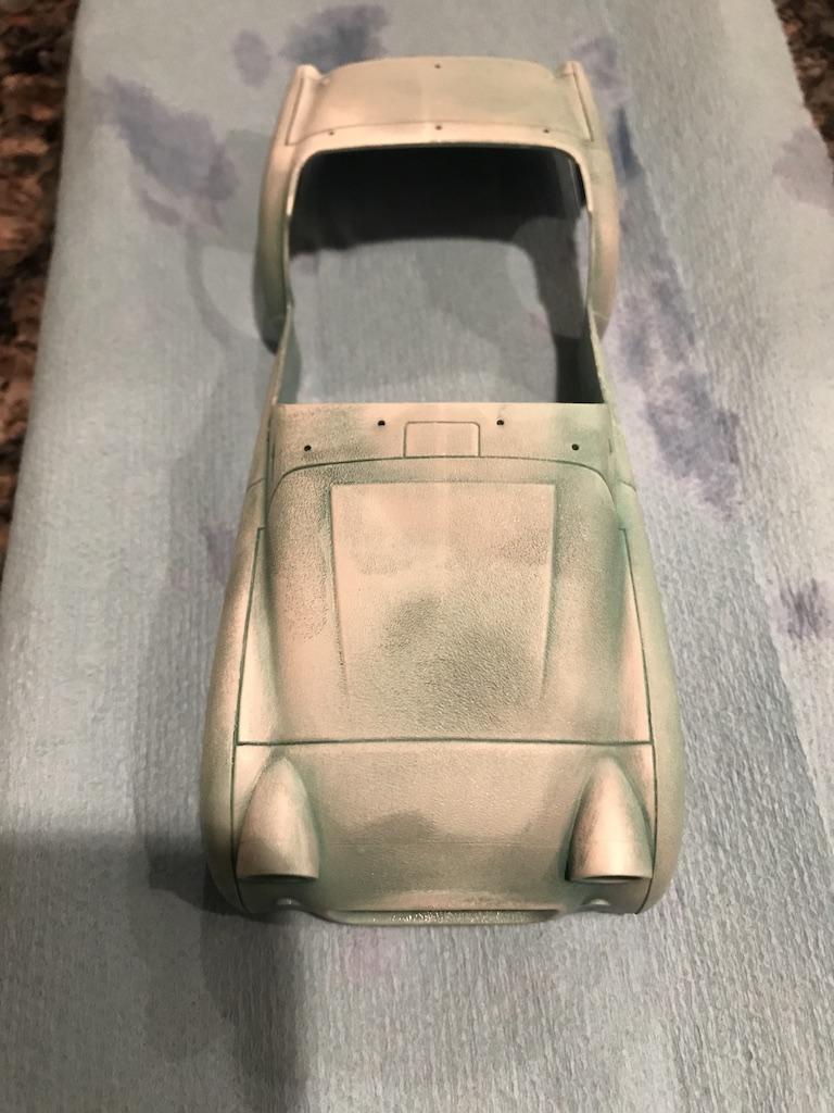

So the first one, which was the worst, finally came out of the bath a few minutes ago (work has been killing me the last two days). The plastic is crazed like everyone thought - the bumps are in the plastic. It's almost feels like a textured finish now, and you can see the effect on the hood. Does it look like I stripped enough paint off? Since I'll have to sand, I didn't think I needed to get it perfect, but given this is the first time I've stripped a body, I wasn't sure if I need to get it stark white or there will naturally be some paint/staining. I used a kitchen sponge and Q-tips to get the paint off, and interestingly, I couldn't get that much off on the underside (which won't be shown anyway given that these are curbside). I guess what I'll try doing is sanding the body down, and then using Mr. Surfacer 1200 primer again which helps fill minor imperfections (actually, I just ordered some of the heavier Mr. Surfacer to get a little help on the filling of the imperfections). We'll see how that goes. And of course, I'll practice on some spoons. In the meantime, I just put the second body (from the earlier pics) in the bath and will let that soak a few days too. This green body may not be salvageable, but the blue one isn't nearly as bad. -

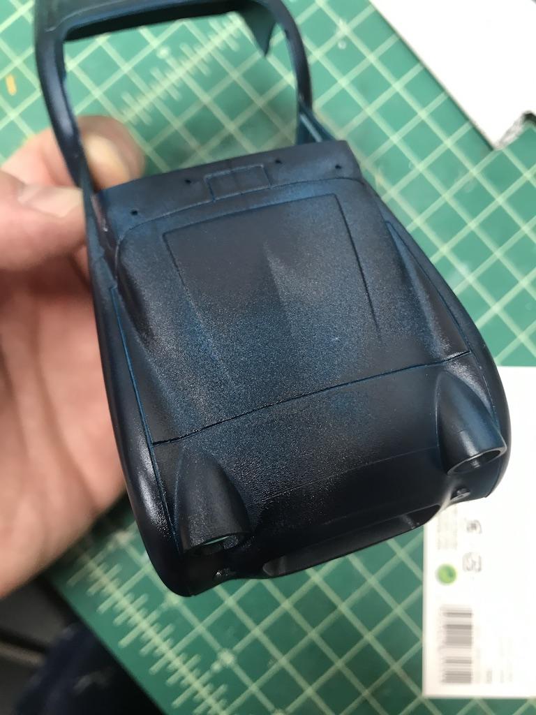

Thanks guys, really appreciate it. I couldn't quite figure out if it was from drying too quickly before hitting the body (too much PSI, too far away), or just burning through the primer and crazing the plastic. The Mr. Surfacer primer is very much like Tamiya primer, so I think I should have been fine there. When I was spraying the first coat very lightly, I don't recall getting any of that grittiness. I waited 5 minutes, and then sprayed the second coat. With the second coat is really when I started noticing it, and I probably made the mistake of going back over it thinking i needed to even the paint out (which I've done with other paints like Tamiya and the Mr. Surfacer/Mr. Color line which self level really well). So my guess is that I sprayed it on too thick, and probably also had some drying issues. I've been spraying in a spray booth in my basement, and with the forced air heating, it's very dry in the house which probably doesn't help things. I'll try spraying closer and at lower PSI and see how that goes. I also have a GSI-Creos PS-290 airbrush with I believe a 0.5mm needle. Would that be better to spray Zero Paints with over the Iwata Eclipse with 0.35mm needle? It shoots a bigger cone of spray really nicely. Maybe I should have used that one instead - part of the reason I got it was for larger areas to spray like car bodies. Here's another question for you guys. The instructions say to spray coats every 5-10 minutes. Do you guys have issues with the paint drying in the airbrush waiting that amount of time? Reason I ask is that there is no way I can wait that long spraying Vallejo, which tends to dry quickly and gum up my airbrush. I didn't seem to have any issues letting the Zero Paint sit in the cup between coats, but wasn't sure if I should think about swabbing the tip with the airbrush cleaner in between coats. -

That's what I'm not sure about. The air pressure was 20-25 which was within the guidelines of the FAQ, and I probably had it around 6" or so away. I thought it might be too heavy a coat in some places because as I saw the grittiness, especially on the first body, I went back over it and that just seemed to make it worse. I'm just not used to this issue with other paints, it's been a bit surprising especially when everyone says how easy these are to use. -

Ugh, thanks guys, really appreciate it. I have two bodies that were painted. One has already been soaking in the Purple Power Bath for the last five or so hours. I'll probably strip that one completely, since it was the worst by far. The one in the pictures hasn't gone into the bath, so I'll sand it down and then reapply very light coats. See whichever approach works best. At least these were inexpensive kits. It's too bad as the colors I was using looked fantastic. I had a few other colors I ordered for some future models, but now am leery about using them. Seems like a real pain, especially with the toxicity and clean up and all the rest. -

Hi Trevor, many thanks for this. I certainly hope it's not crazing of the plastic, as that might be a nightmare to fix. I primed the bodies with Mr. Surfacer 1200 which I thought would have been sufficient, but maybe not. Ugh! What's interesting is the FAQs suggest that any primer is ok. I didn't thin the paint either, so maybe it's not crazing of the plastic? From the Zero Paints FAQ: Do they need thinning? No, all paints are supplied pre-thinned for Airbrush use, they are thinned to a consistency which is suitable for Airbrushes with nozzle sizes of 0.3mm upwards. Additional thinners are available if further thinning is required. It is not recommended to over thin the paint, too much thinners and increase the chance of the paint becoming to HOT and affecting/eating the plastic below the primer. If unsure test first. Is Primer needed? YES, As the paints are solvent based it is necessary to primer the plastic/resin before applying the basecoat colour; this seals the plastic/resin and creates a key for the paint to adhere to. Any brand of primer should be OK, but if in doubt do a test first. -
I tried painting a couple of Gunze Triumph bodies last night with Zero paints, and had a bit of an issue with the paint job being very gritty. Was worse the first time around, and a little better the second though I did get a bit of grit in some spots. Any ideas as to what I was doing wrong? 'm guessing the issue was from spraying too heavy of a coat, which I was a little more conscious of on the second body -- on the second, I had a little bit of that issue on the hood and trunk, where i did a couple of passes with the airbrush on the same coat, but not on the sides where the paint job ended up smooth. I saw a Youtube video of someone spraying that seemed to be spraying a lot heavier coats than I was, so I'm a little bit confused as to why I got the results I did. I know the finish is supposed to be matte with maybe some bumps, but my paint jobs seemed to be a little excessive on the grit side. I've got the first body soaking in a Purple Power bath to start over I was spraying with an Iwata Eclipse 0.35mm at about 20-25psi from about 6-8" away. Otherwise, the car was primed and lightly sanded glass smooth, rinsed, and hit with tack cloth before spraying the Zero Paints. All per the Zero Paint instructions, so I don't think it was the prep. I'm still fairly new to airbrushing and car models in general, but haven't experienced this kind of issue using Vallejo, Tamiya, or Mr. Color. I haven't done many cars (usually I model planes and ships), but the two car builds I did using Tamiya went down fairly well without issue. I just read the "Matt's tips for painting cars" on Britmodeller -- great tutorial!! https://www.britmodeller.com/forums/index.php?/topic/234956647-matts-tips-for-painting-cars/ Unfortunately, I can't pinpoint what the issue is here. Many thanks in advance! Edit - here's a picture. You can see the grit areas on the hood versus the smoother paint job on the left headlight area.
