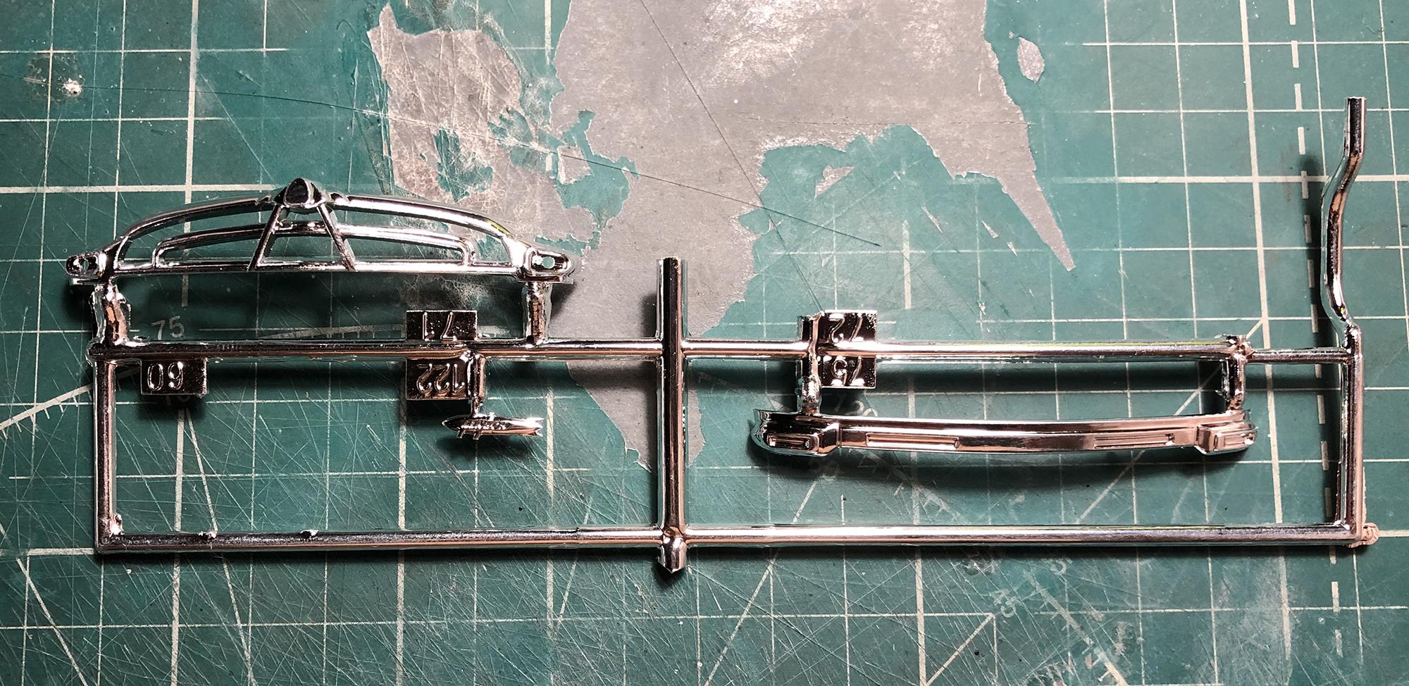

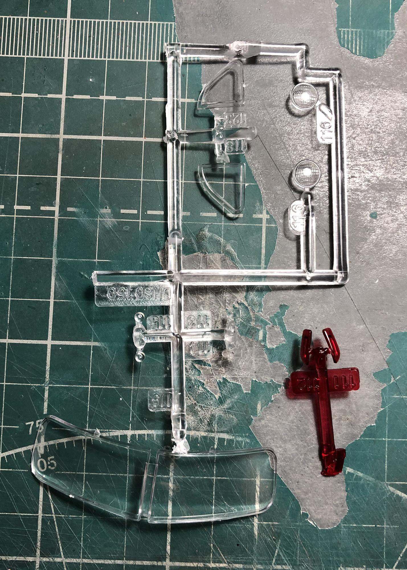

  1. Good afternoon friends. Last pre-paint update.: D Headlights with a bumper, it was decided to choose stock. But leave it like that, the stump is clear, I don't plan, it's a quiet horror - chrome optics. I removed the chrome completely, tk. The quality of the bumper was terrible with a flash and other joys. Well, for the first time in modeling practice, I sculpted reflectors from 2k putty. Back lights. With some kind of fright, we are given one through back light. We take a transparent sprue and adjust it. Before-after. Made a kind of firewall that they gave us. I didn't cut holes in it, it is not necessary, there is not much to look at.))) Well, a general view of my future custom. All the parts are washed and ready at the ground, in the next runs I will be primed and put the main first color. Thank you for attention.
  2. There will be no problems, because I will be painting this transparent shroud.

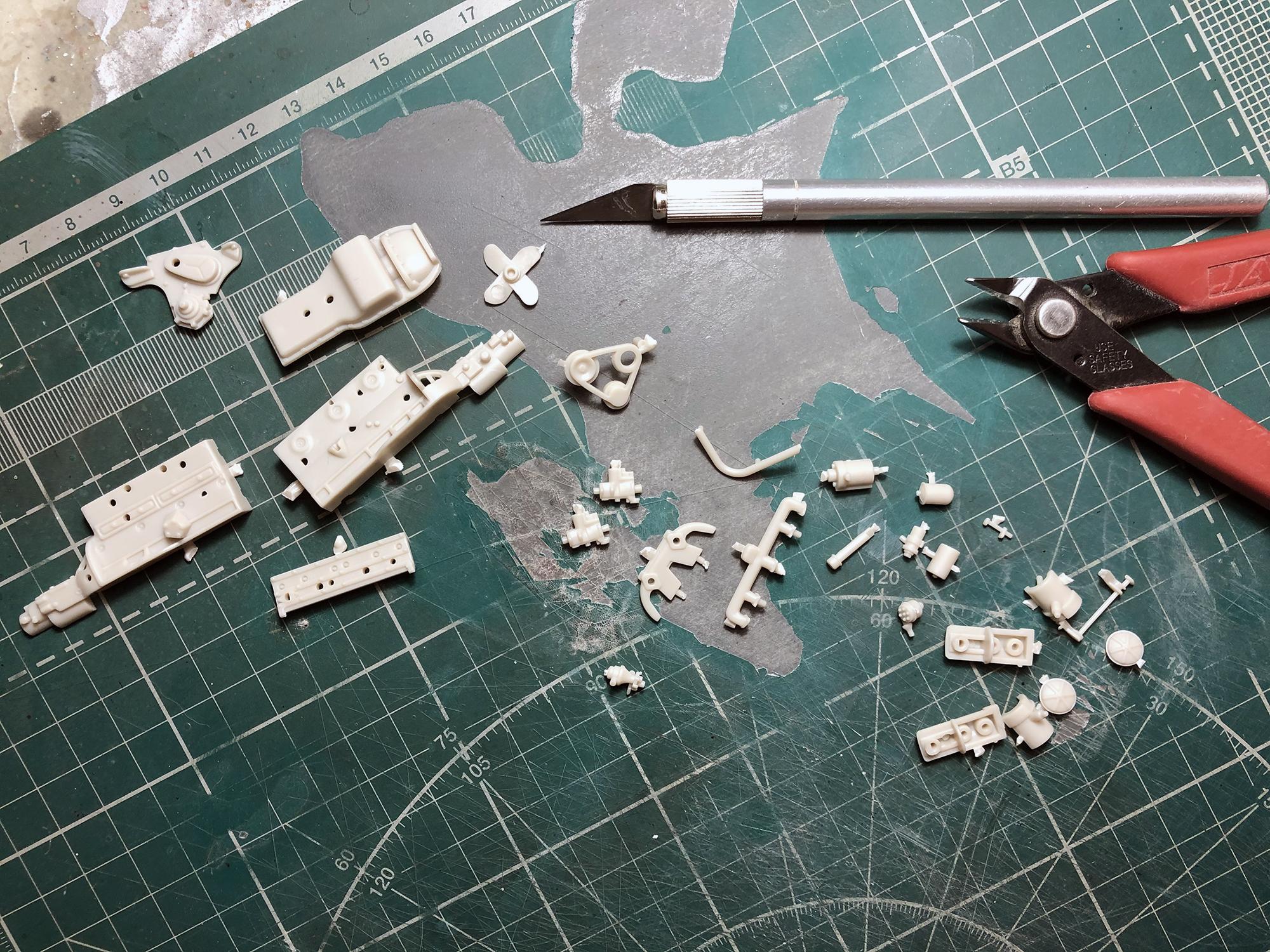

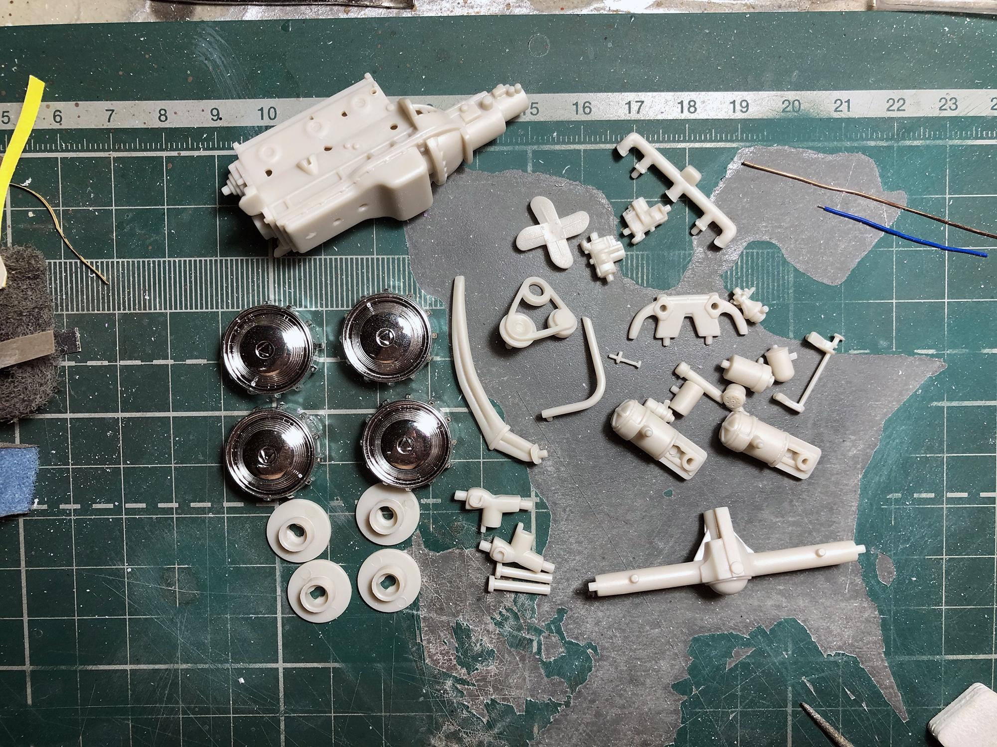

  3. Good afternoon, friends, the build does not stand still, the first update is ready. I chose these wheels and stock tires, tk. the second set with wide tires seemed completely irrelevant to me, after all, this is not an SUV. One problem immediately appeared. There are 2 types of tires in the set, but the rear disc mounts are only suitable for wide tire. I decided to get out of the situation in the following way. I cut off around the perimeter what treacherously sticks out. From the back inside it is still not visible. He removed the chrome from the wheels, will be painted in body color. Processed and prepared all engine parts. With the water pump, I cut off all the unnecessary, cast is not clear how and for what. I apologize for the quality of the photo, I did not take a picture after removing the chrome. Here we have an indistinct distributor for wiring with mold displacements on the right. The oil filter is a gnome on the left, although on a real car it is on the front mount between the pulleys belts. Well, from above, something incomprehensible. The oil filter with mount is made from scratch. As well as the distributor for wiring. I made the terminals for the battery. I processed and prepared the details of the interior, it will be stock for me. Made the door armrests. And prepared the rear suspension parts. For today, there is nothing more to show, everything else is still in work. Thank you for attention.

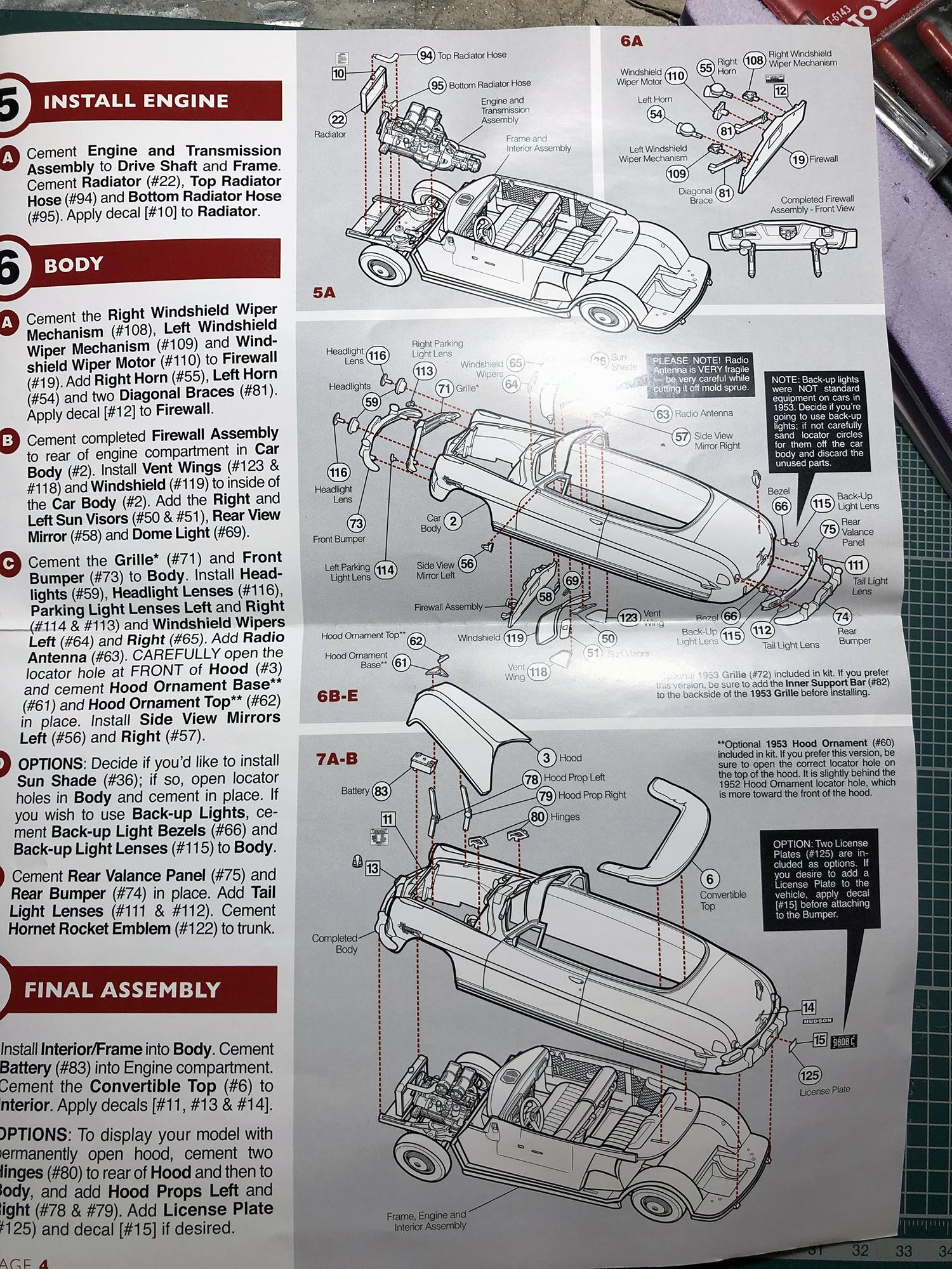

  5. The builds cannot stand still and I took out a new box, which I had wanted to build for a long time. A car that I really, really like - the Chevrolet Corvair. In the middle of its life it was positioned as a compact sports car, an analogue of "imported" (European) sports cars and a less expensive alternative to the Chevrolet Corvette. One of the main characters in Ralph Nader's book Dangerous at Any Speed. Little known due to the almost complete absence of advertising in production. Unique in that it is rear-engined. And all this he is the most beautiful Corvair. Re-issue 2004. We open the sprues. We are given the opportunity to make 2 landing options, it's interesting. Interior. Quite good indeed. The detailing, apart from the floor, is excellent, it is a pity that the rug was damaged by the pusher. Dashboard, stock steering wheel and rear folding roof. The funny thing is that the instructions do not say a word about what you can do with a convertible. The detailing of the dashboard is excellent. Engine. Gadgets for customizing. Custom hood. Front seats and stock hood. Why AMT ERTL they give plastic 2-piece tires, I have no idea. Further details for the wild custom version. The body is carefully reinforced with thick hard cardboard, this moment could be taken by all manufacturers, so that the modelers later would not be upset about the broken roof pillars. The body itself is very well made, all the nameplates and emblems are very clear, there will be no problems to highlight. Chrome sprue. 2 sets of tires. Red glasses for customization. And transparent for the body, and, for some reason, the engine cover in transparent. It's weird... Awesome decals. Manual, huge, A2 size! The set is, of course, wood-fired, but so many possibilities! So far I'm torn between stock, racing and wild custom versions, I like all 3 of them. I haven't decided on the painting yet, but I like this color scheme: That's all for now.

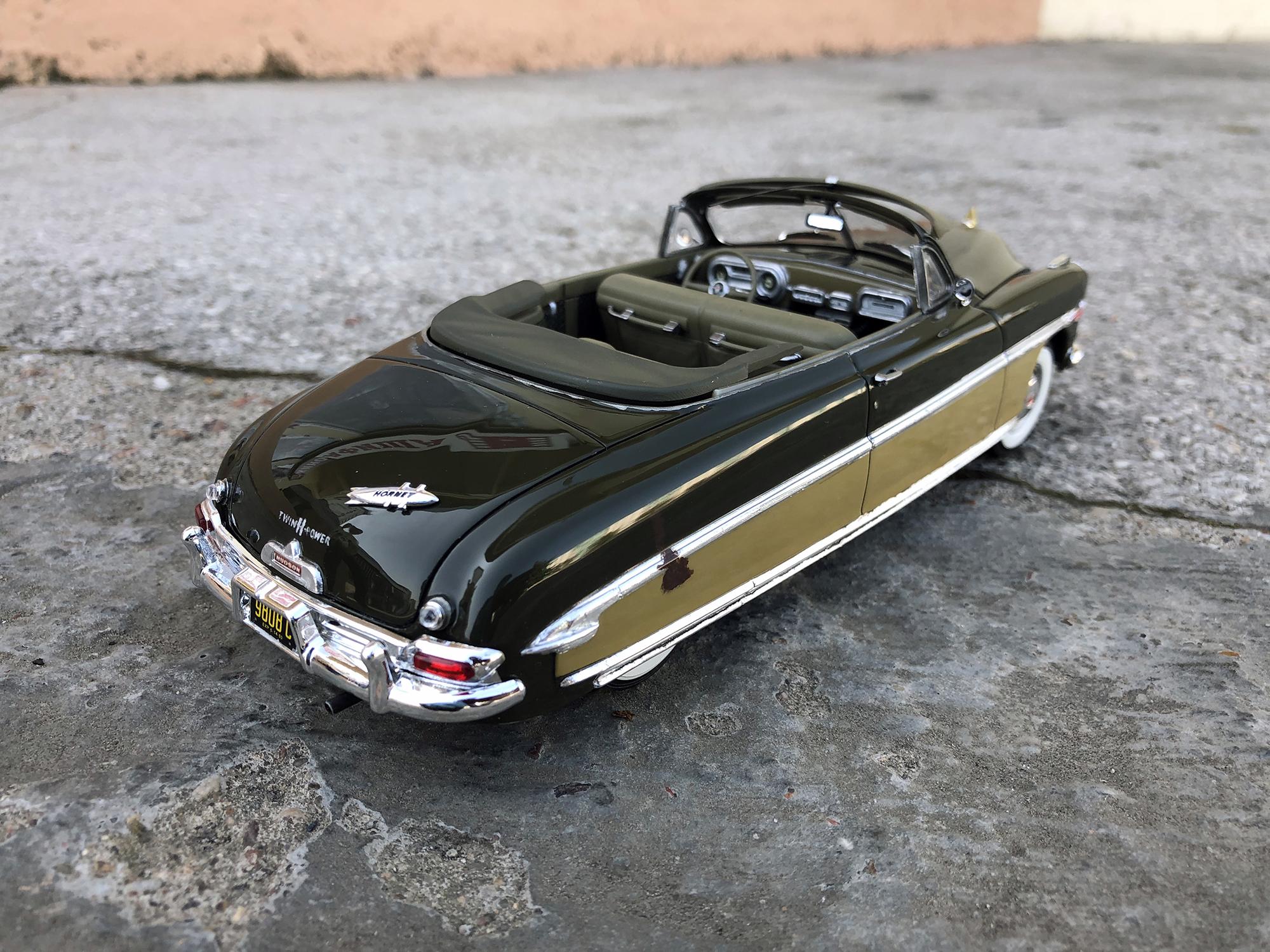

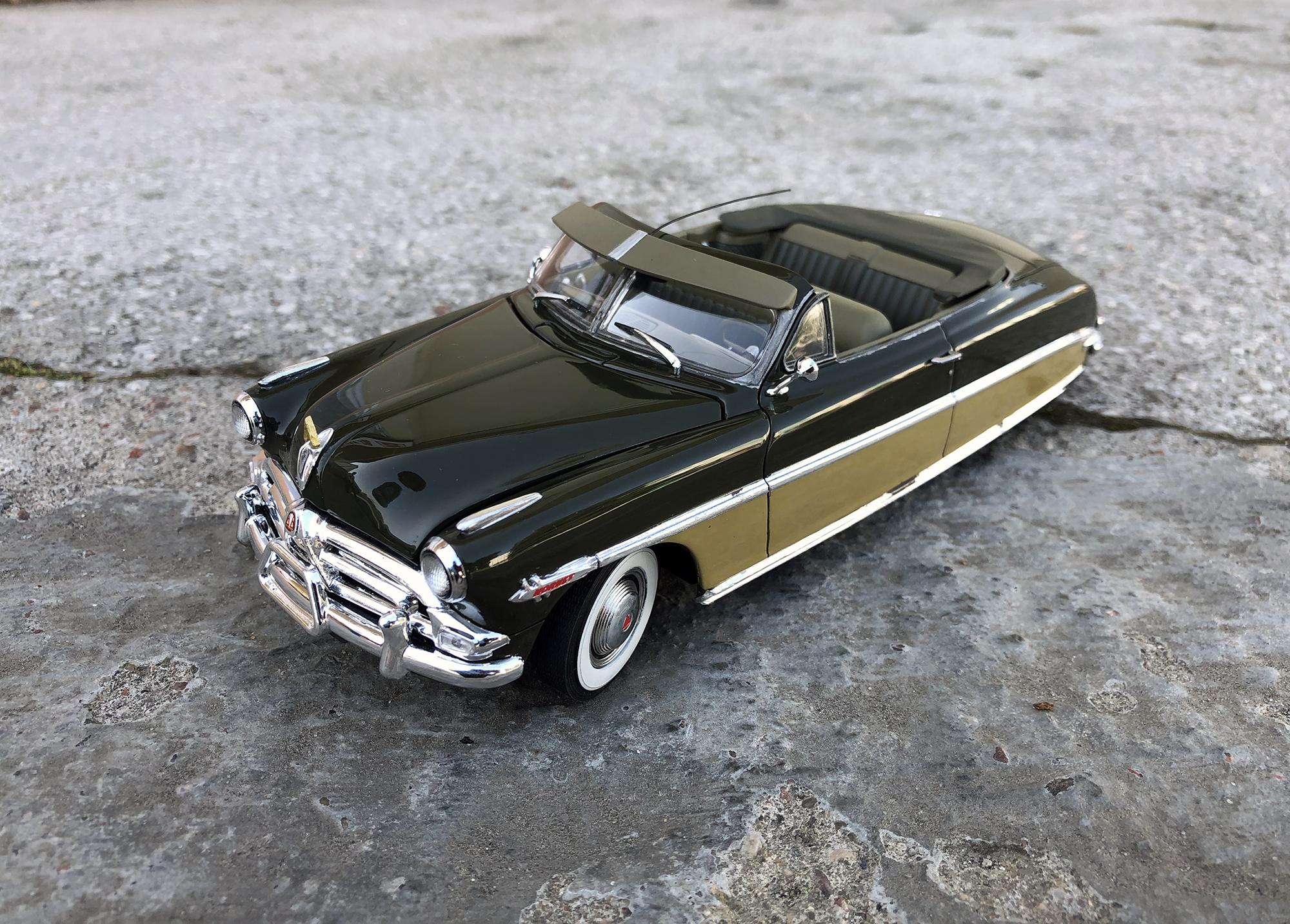

  6. Friends, well, meet my 14th assembled model of American autoclassics. Tamiya paints, body and interior - acrylics, lacquer bottom. Varnish 2k from Zero Paints. Thanks for wathing!?
  7. Good evening everyone. Last update. Yesterday, with my pants full of joy, I went to the post office to pick up my package from Moebius: But the joy was relative, the decals were of disgusting quality. This is the first time I have met this in 14 assembled models. ? Almost all decals, except for 2, began to tear, and the fact that I centered them with a soft brush was very accurate. Moreover, they were torn into segments, as if they were cut into strips. Maybe Moebius put me a deck, which is many years old, or a poor-quality print. Well, God is with them, almost nowhere to be seen, killed 2 hours to unite them and it would be unnoticeable. Well, I finished today.? My wife said that she liked the result very much, me too. A couple of photos for a start and wait in the finished ones. On Saturday I plan to take pictures in the air.

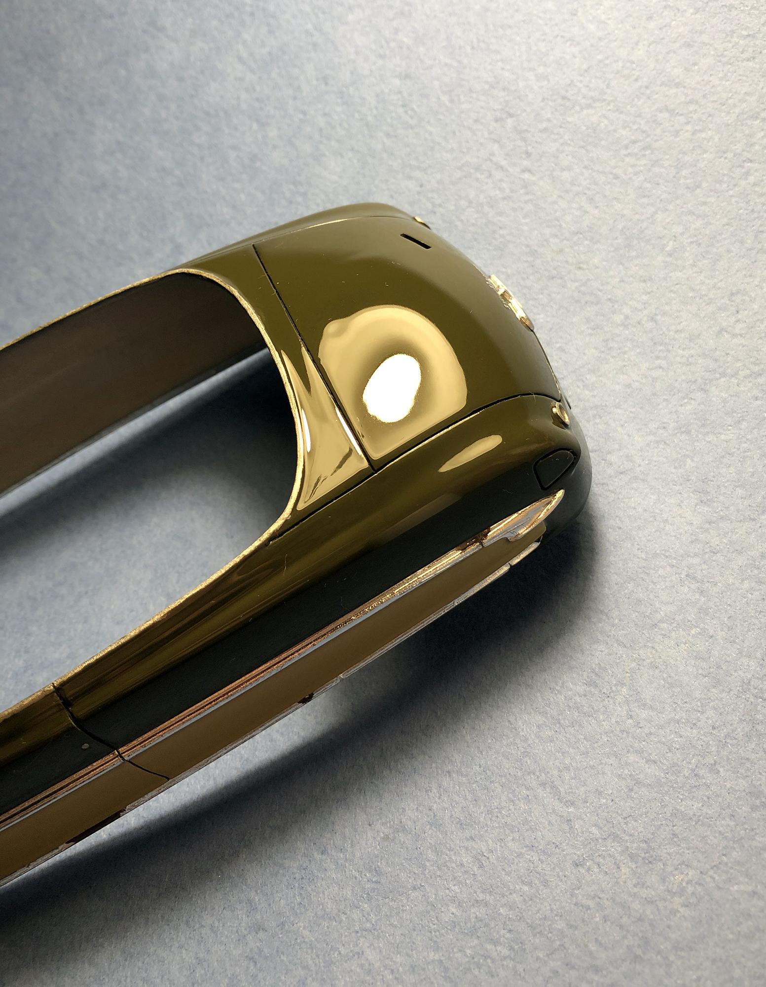

  12. In the meantime, I installed the engine in place and glued all the interior parts except the steering wheel and dashboard. Well, I polished it. This time I used only the first - red polish from Tamia, and the 2nd and 3rd steps were polished with 3M purchased for bottling.

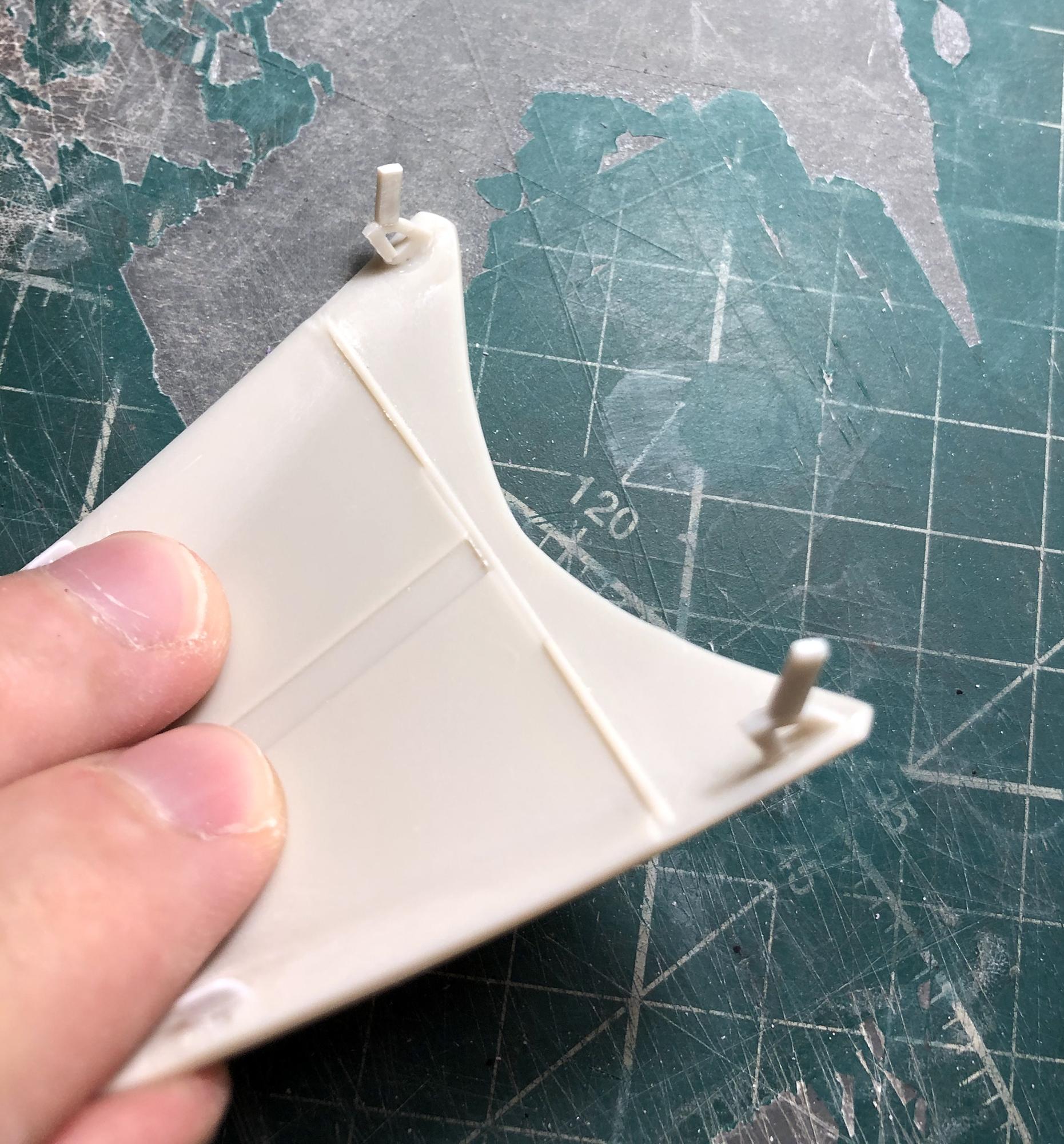

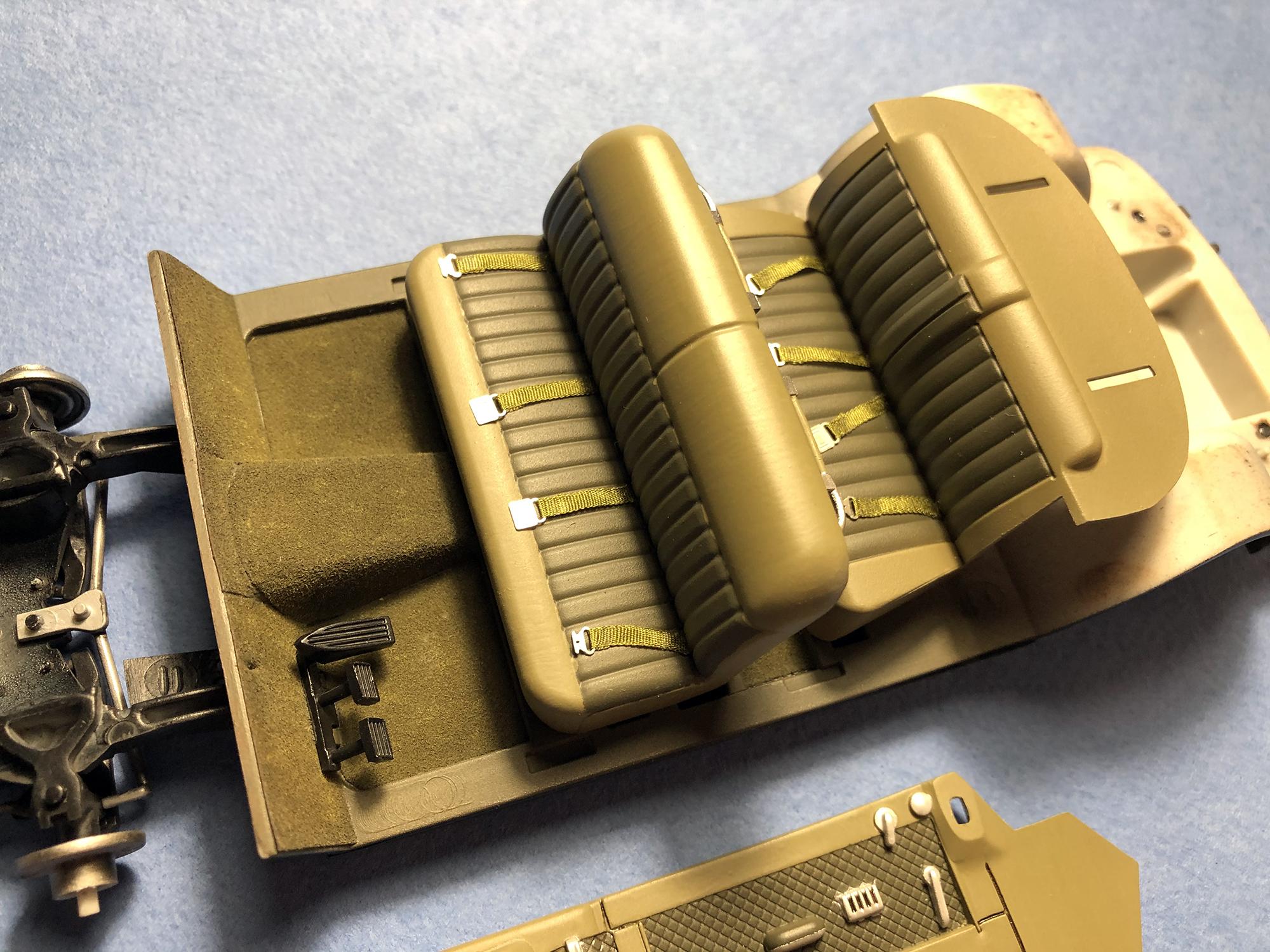

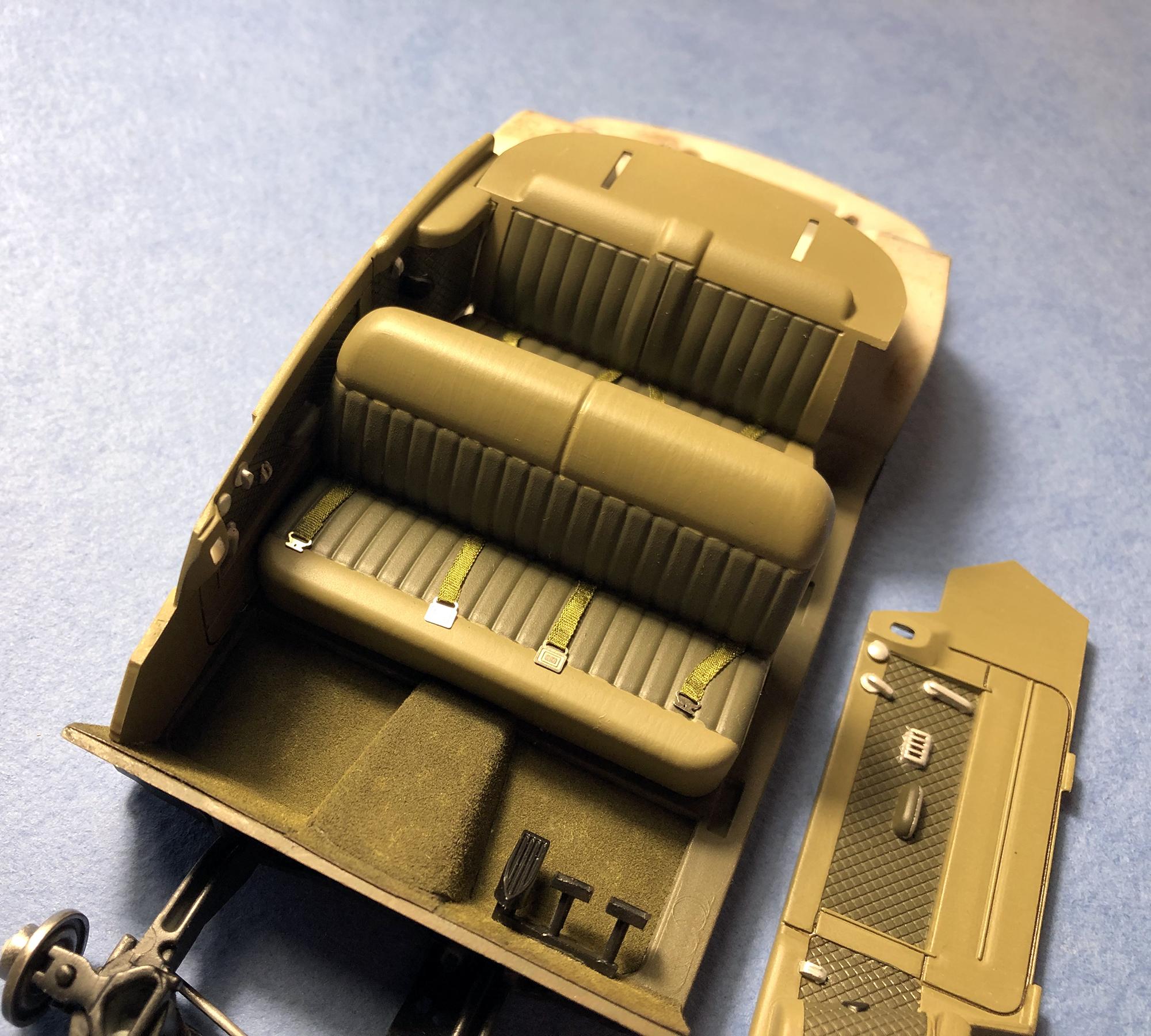

  13. Meanwhile, I completed the bottom and partly the interior. In the salon, I just put the door cards on. Instead of flock, this time I used velvet paper dyed in the interior color, the impressions from working with it are extremely positive. That's all for now. Thanks for your attention.

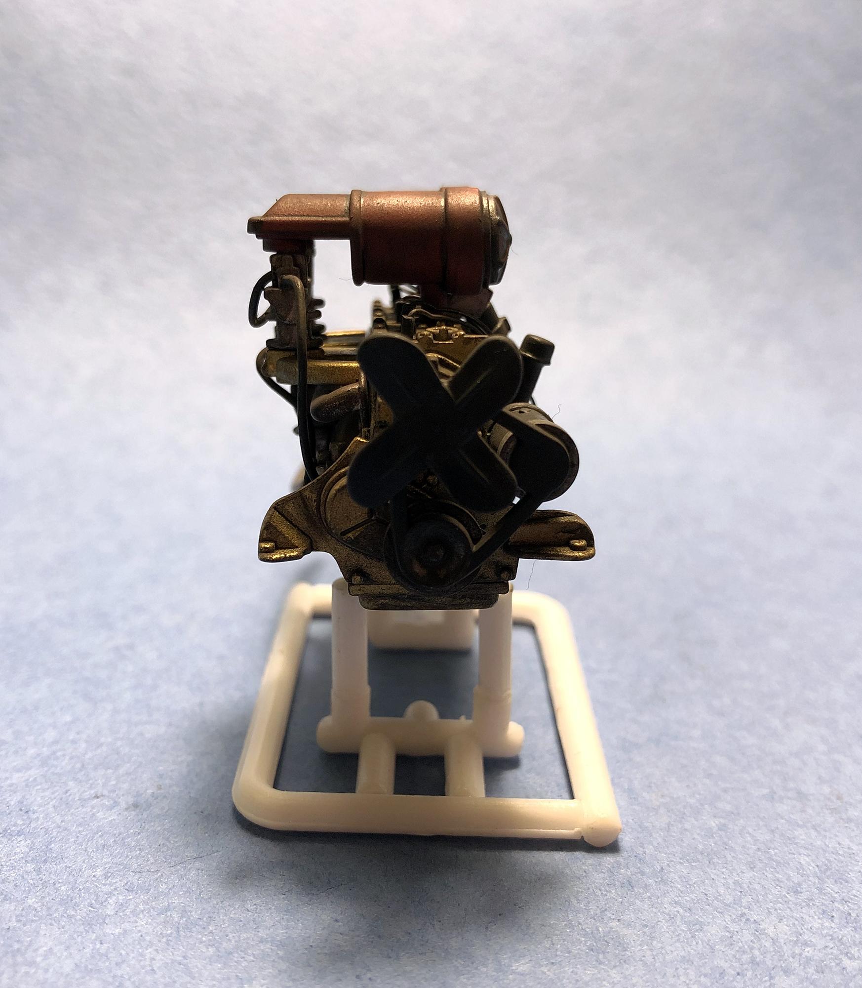

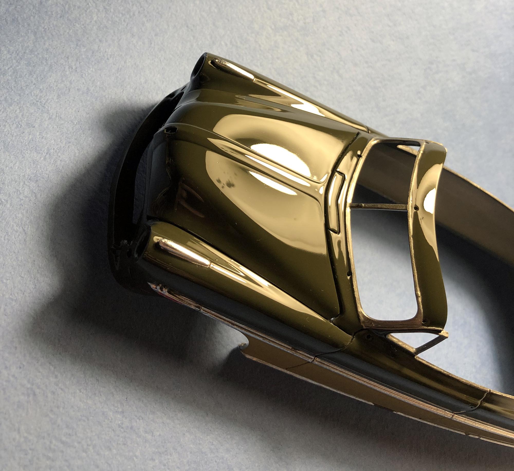

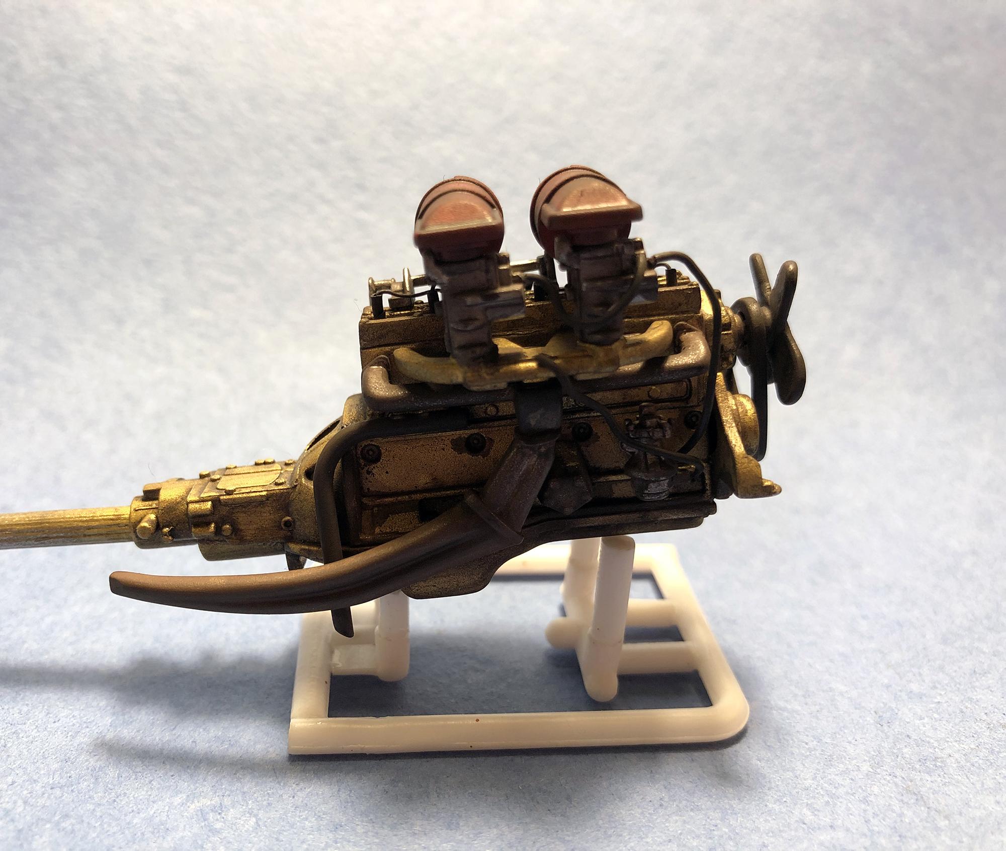

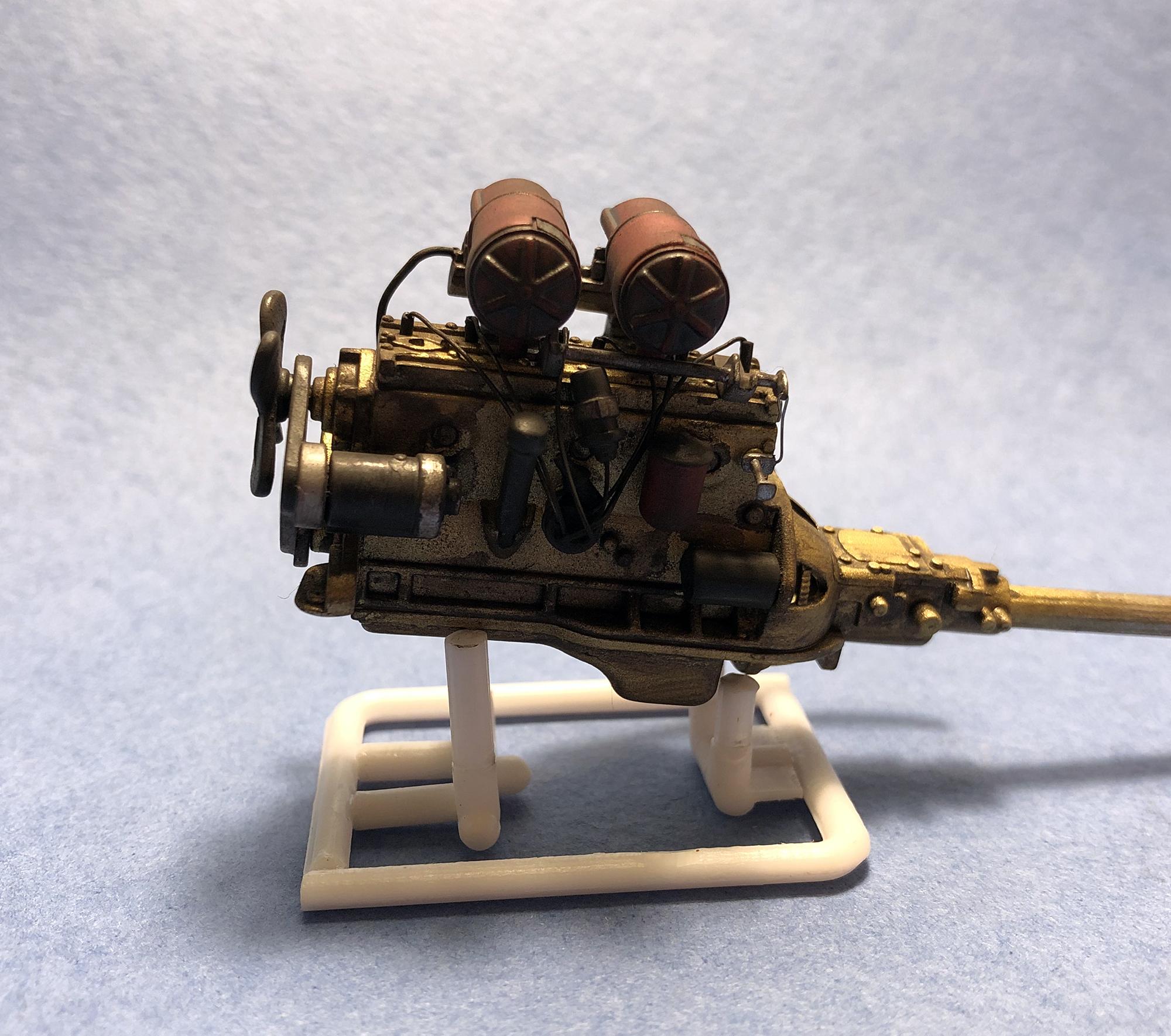

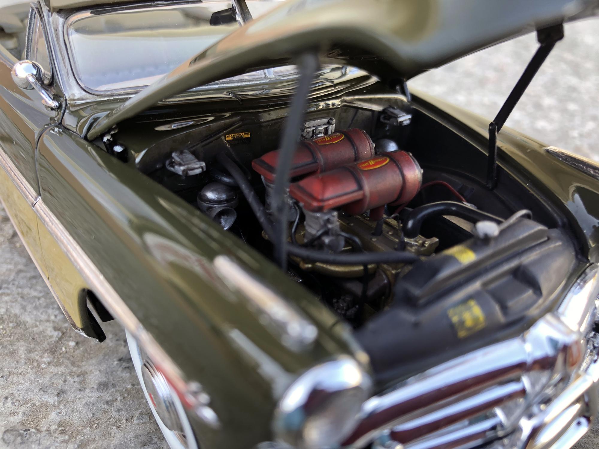

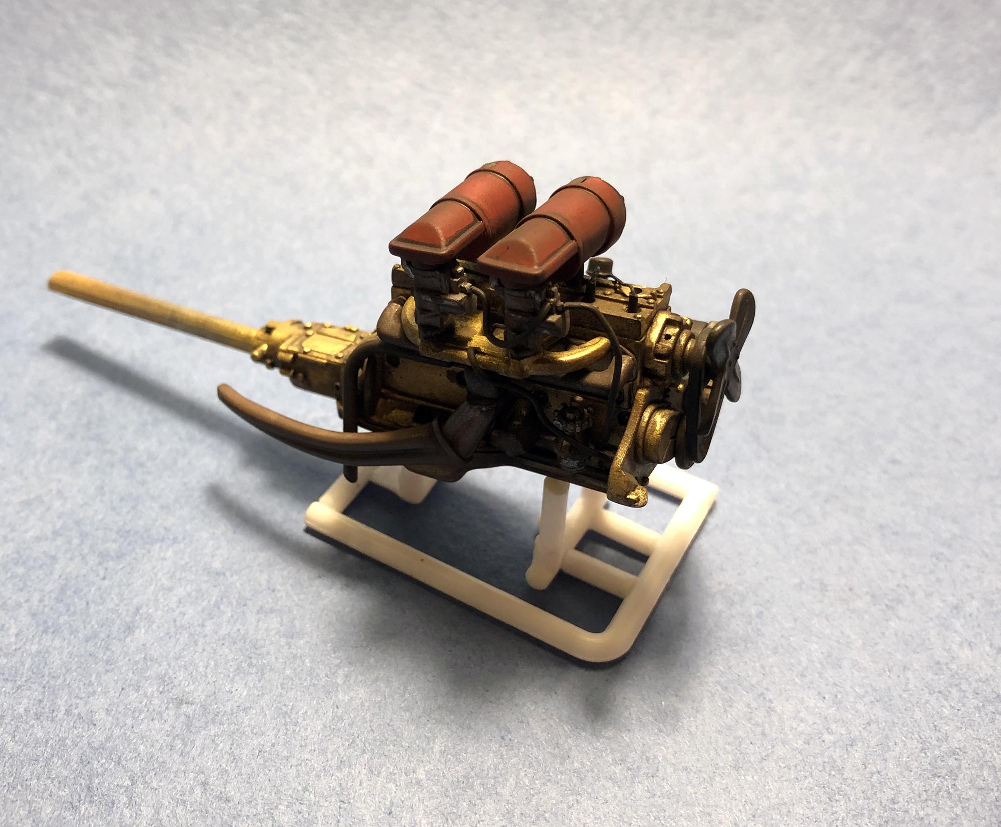

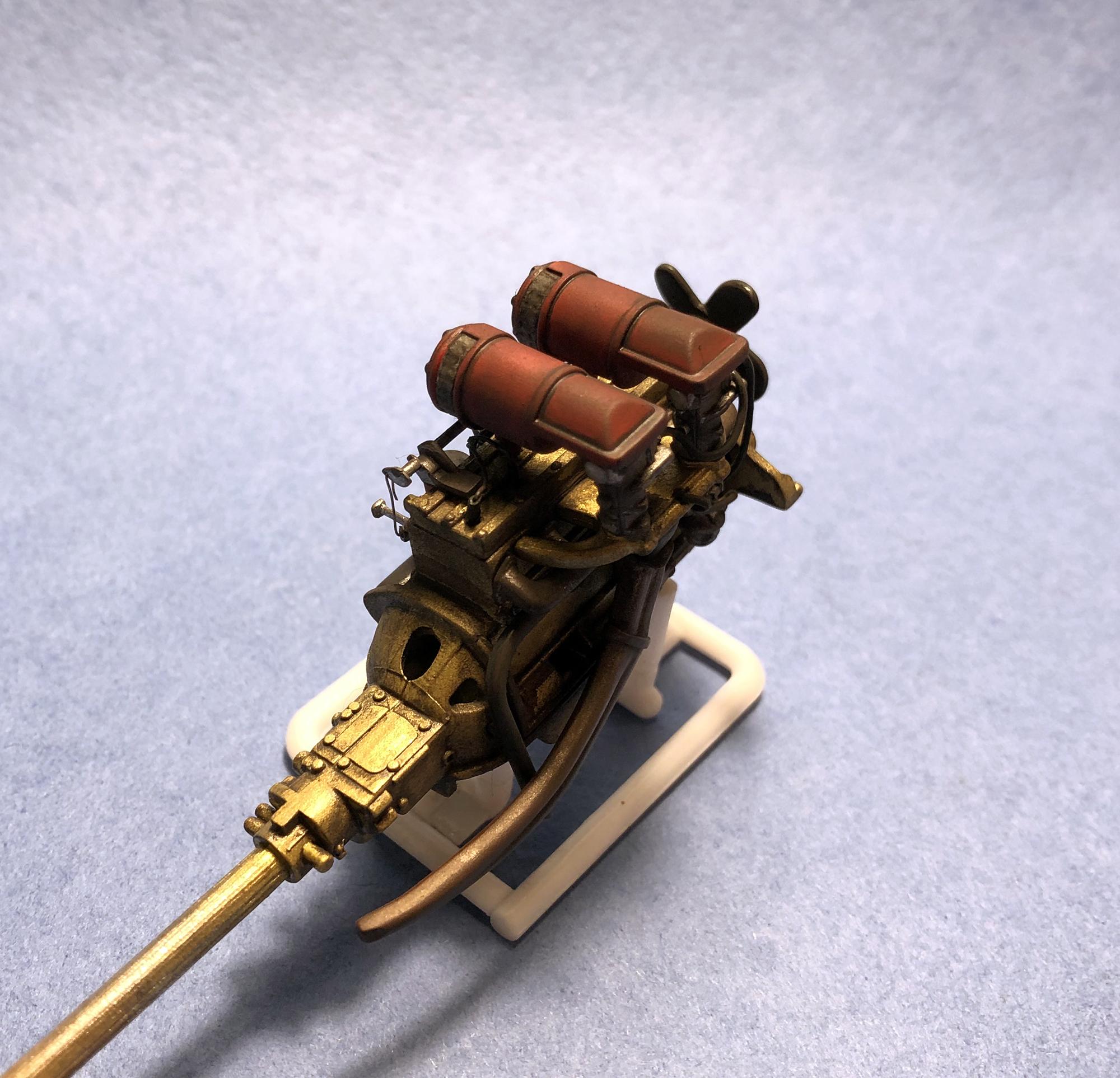

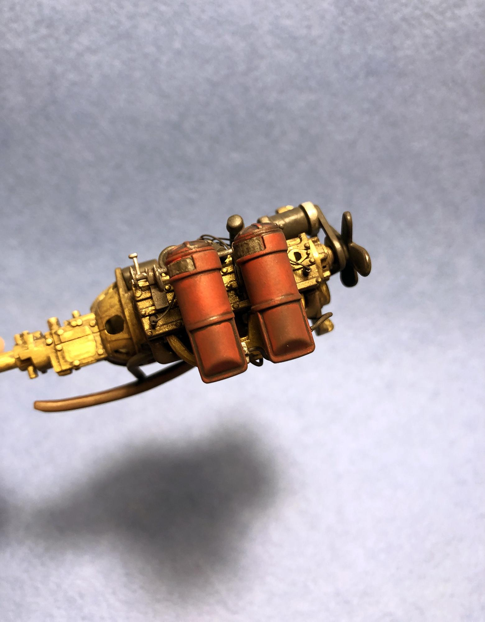

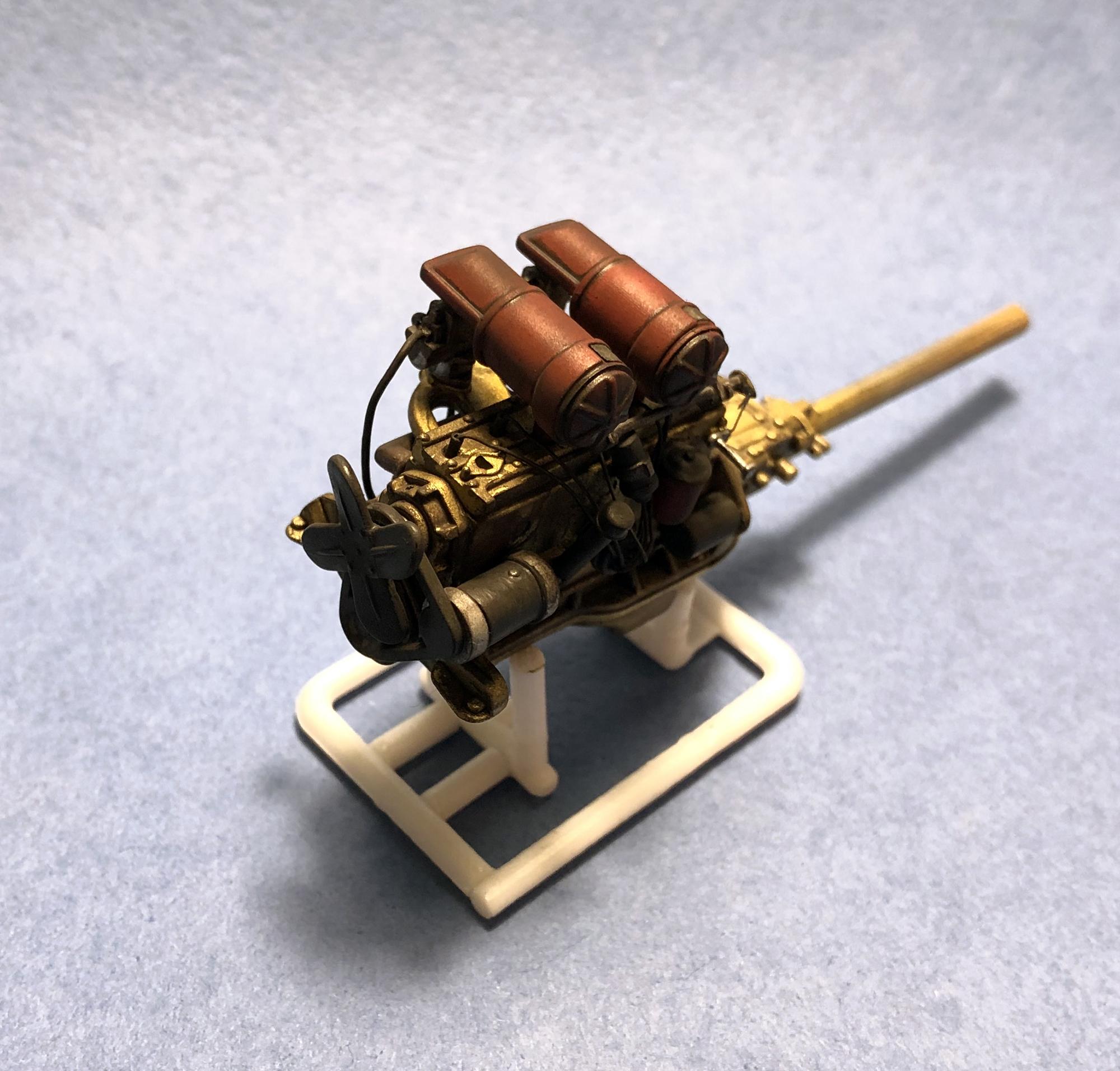

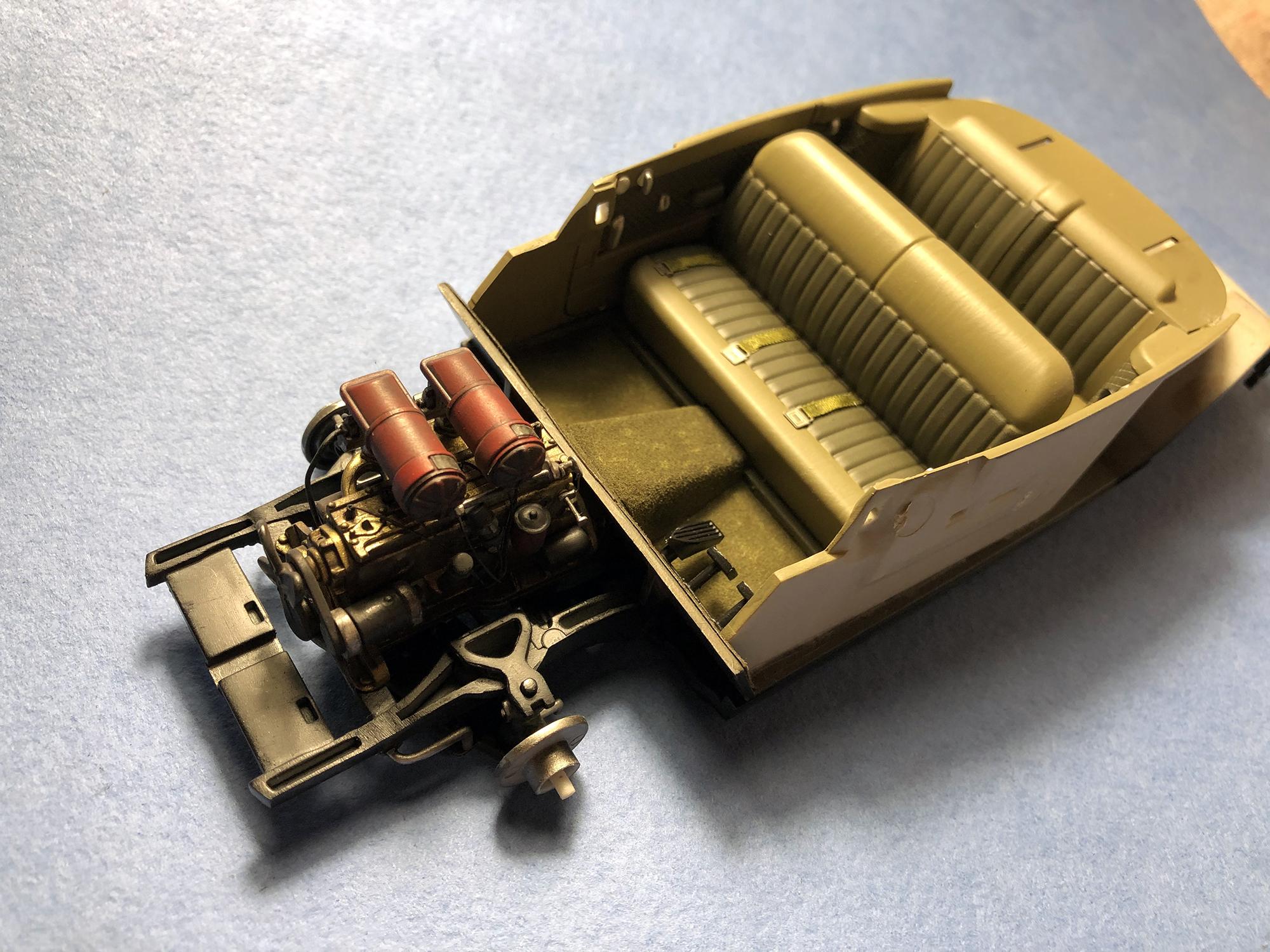

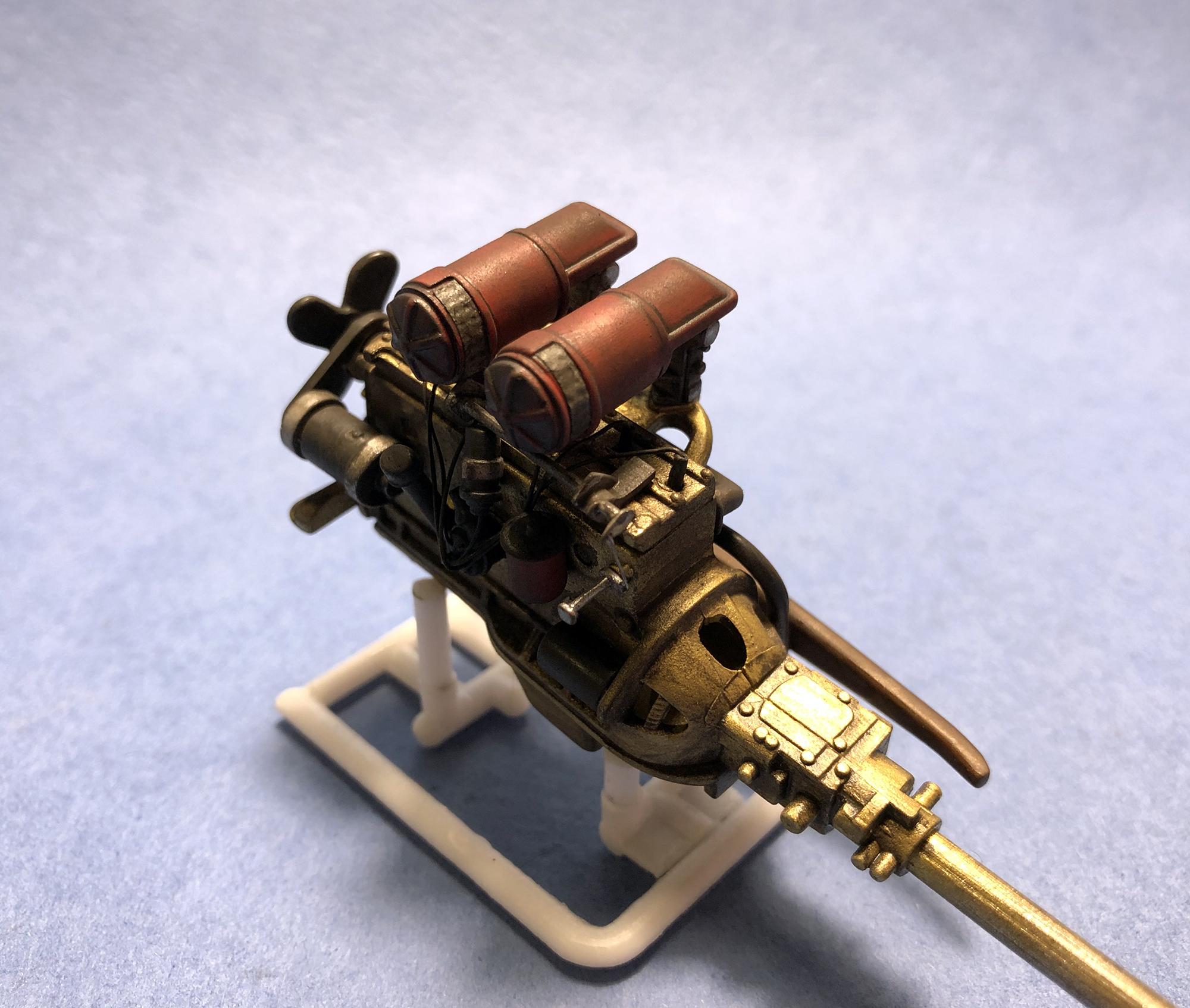

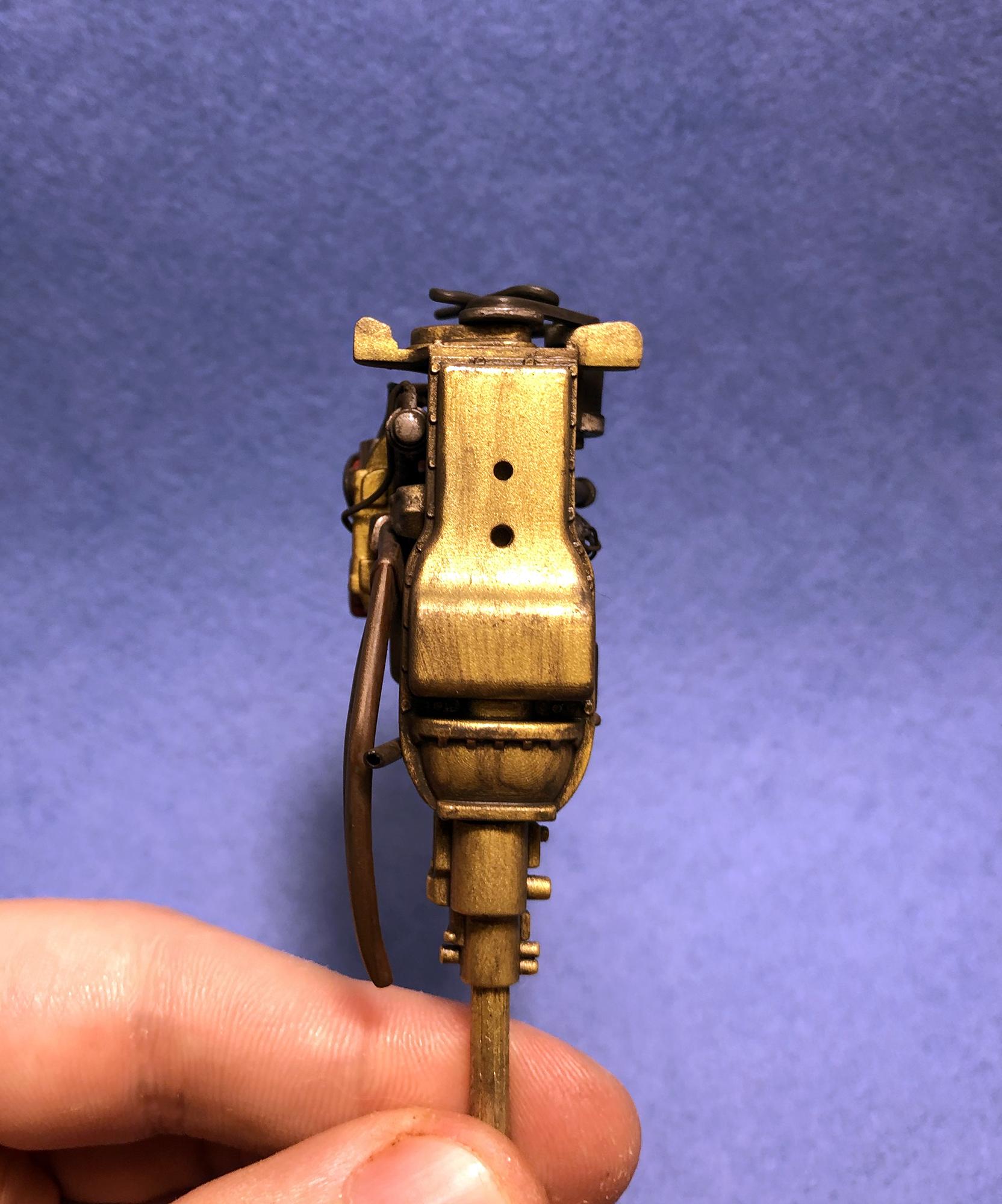

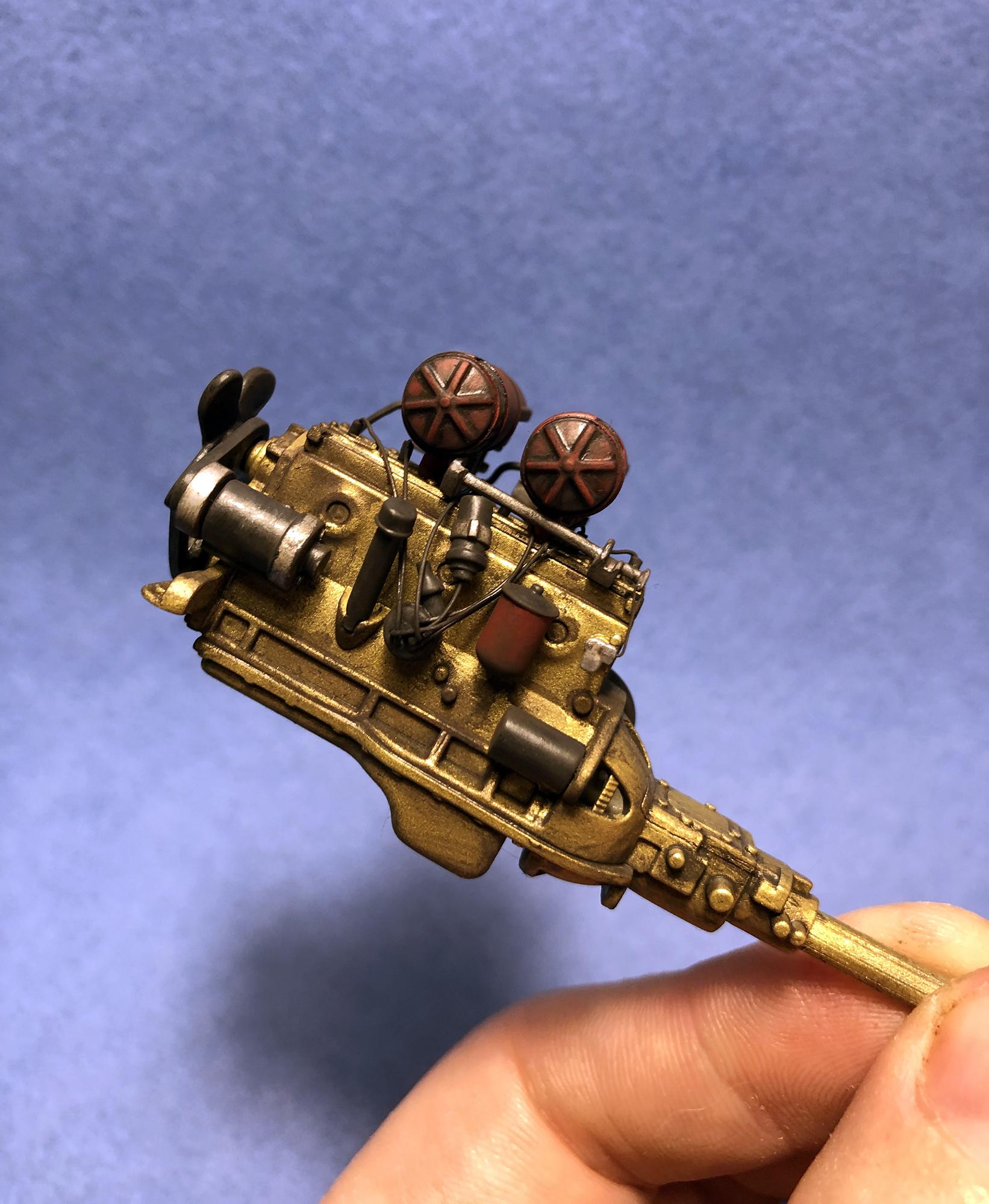

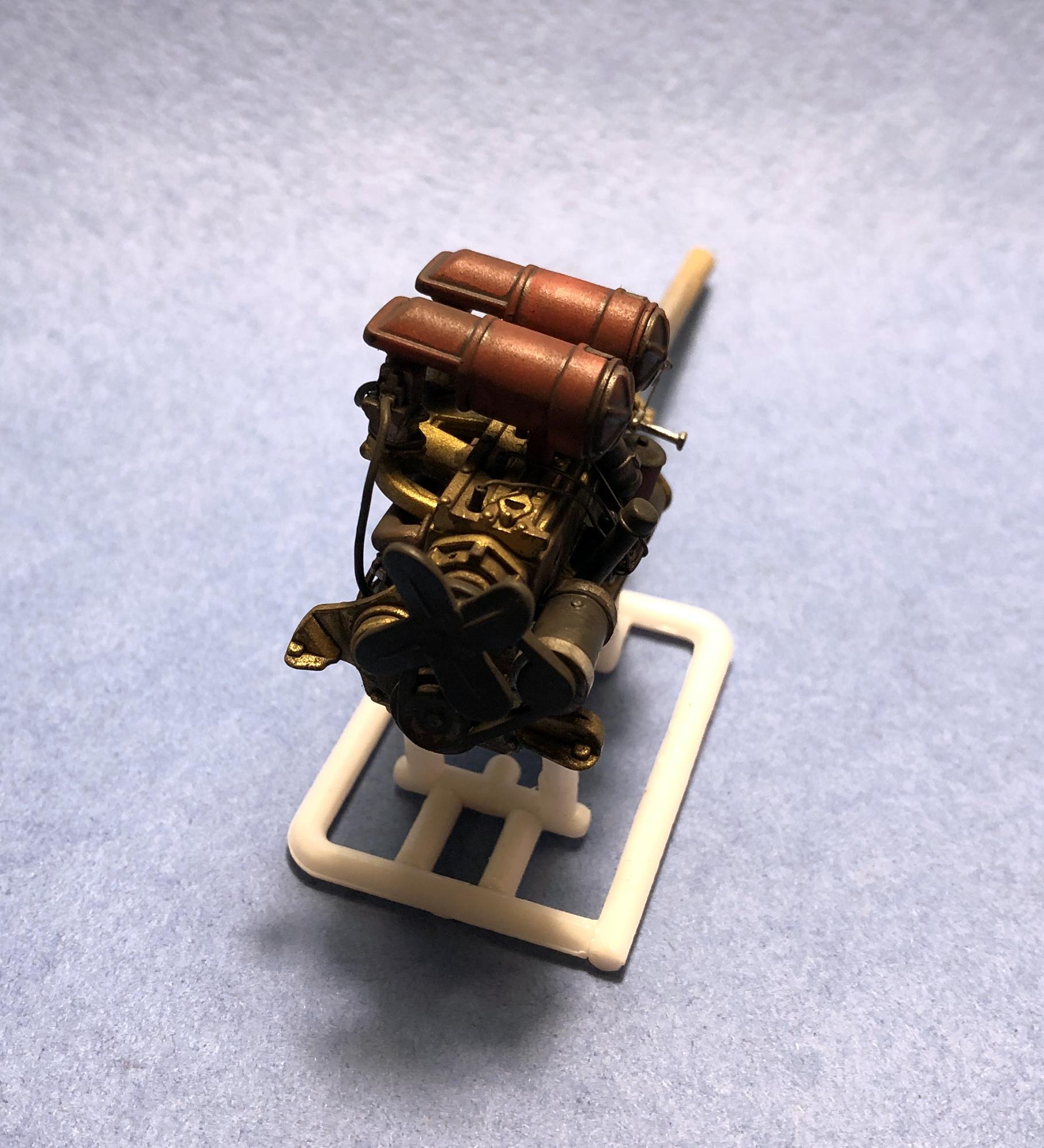

  14. Good afternoon friends.? The construction is moving slower than I would like, because judging by the track, my decks and tires with whitewalls left Los Angeles on the 15th, I hope that in 2 weeks they will reach, otherwise I will have to stand and wait, without decks, I feel like no hands. Well, okay, I was different. Body, hood and dashboard in 2K clear. Next Friday I'll start polishing. This time I decided to experiment. BMF made to varnish. But I will not repeat this experiment any more. It seemed to me that 2k clear somehow influenced (something like softened "corroded" BMF). Not critical, not fatal, after all, it was an experiment. And the sweetest thing for me. The engine is done! It remains for him to try on the decks for air filters, as they come. The air filters themselves were made from the edge of a paper tea bag. They are sold in pharmacies, such square ones. They have very pronounced corrugated edges. I pasted it on PVA, then matte white acrylic on top and a black wash from Tamia. That's all for now.?

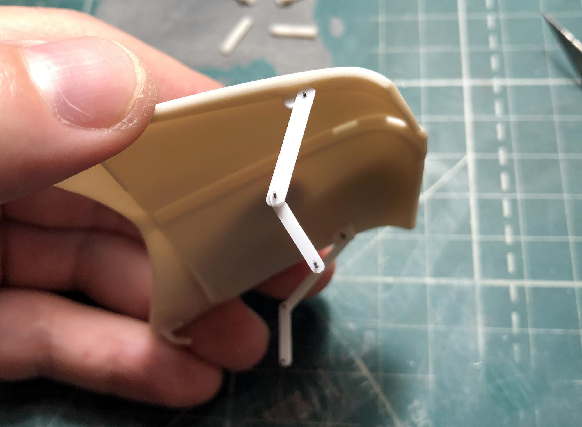

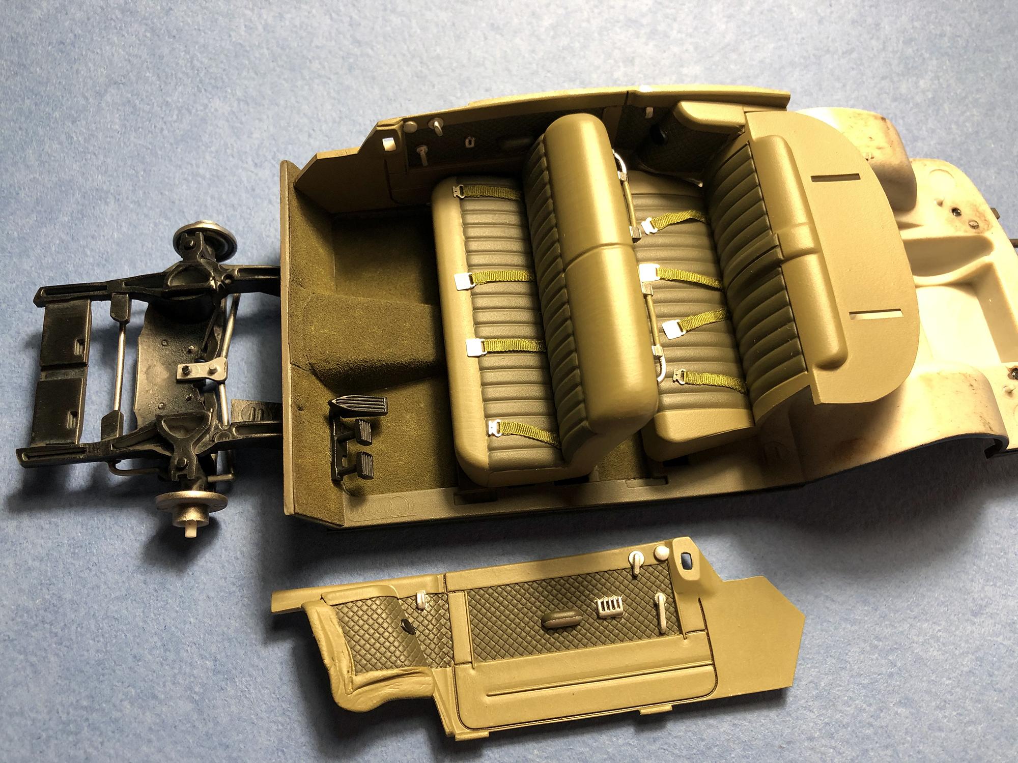

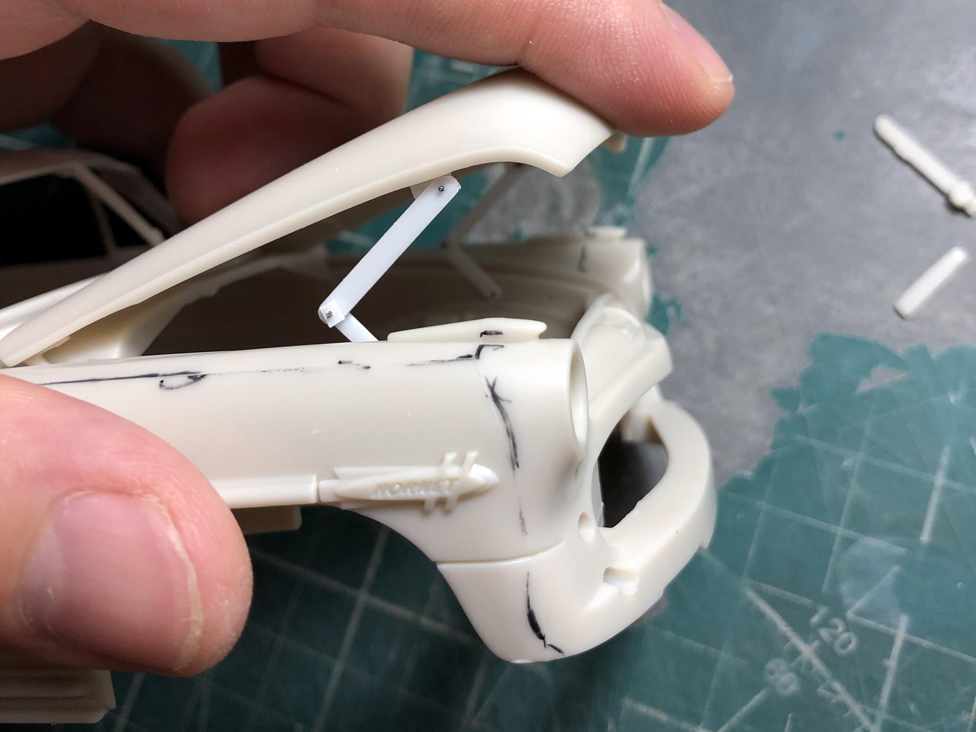

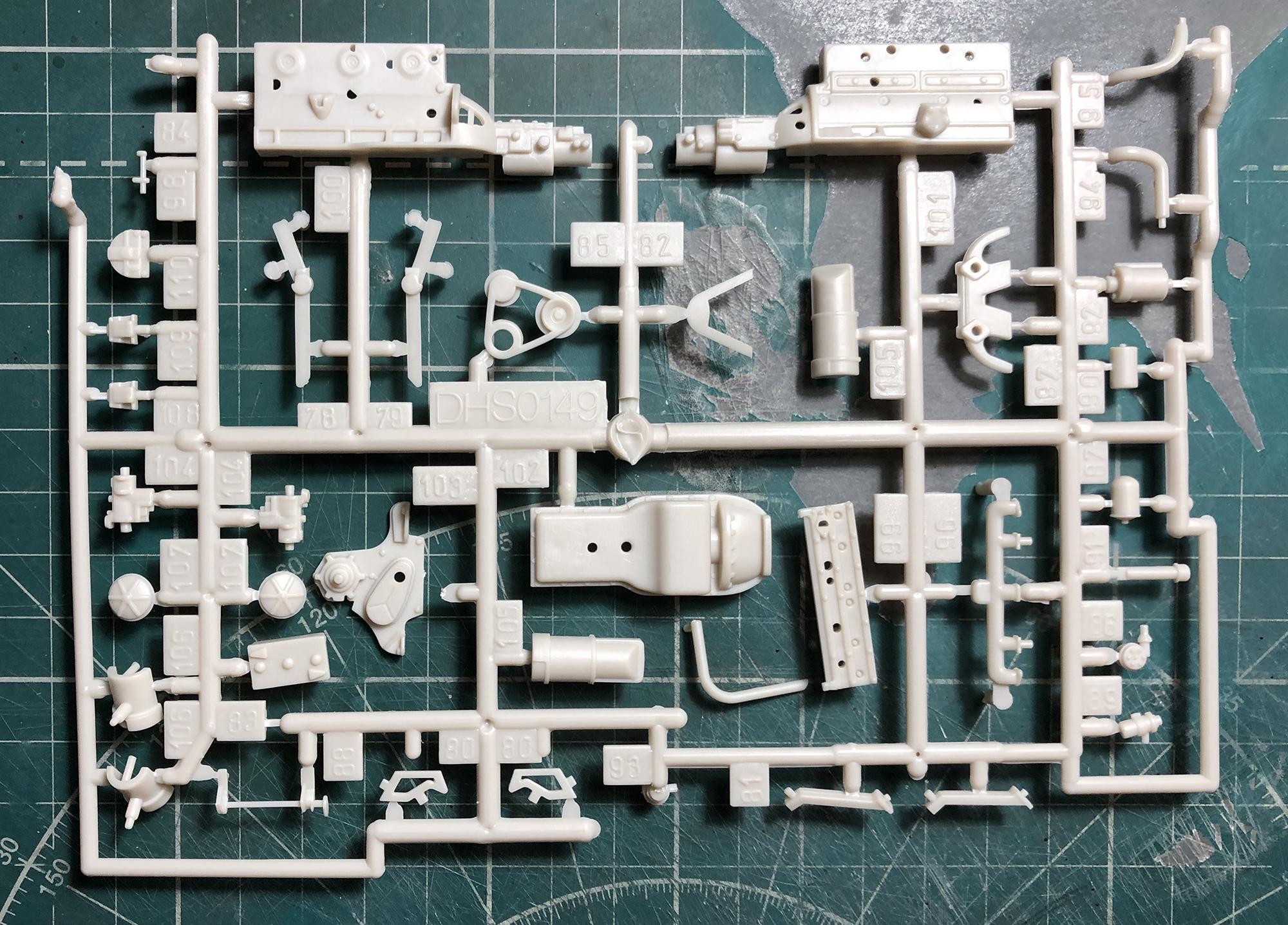

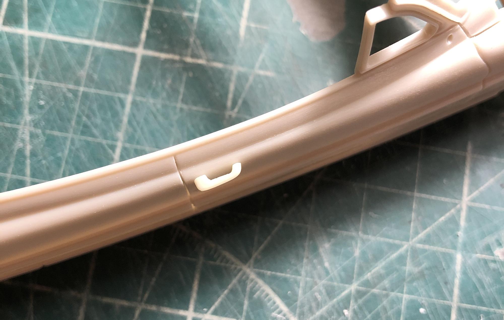

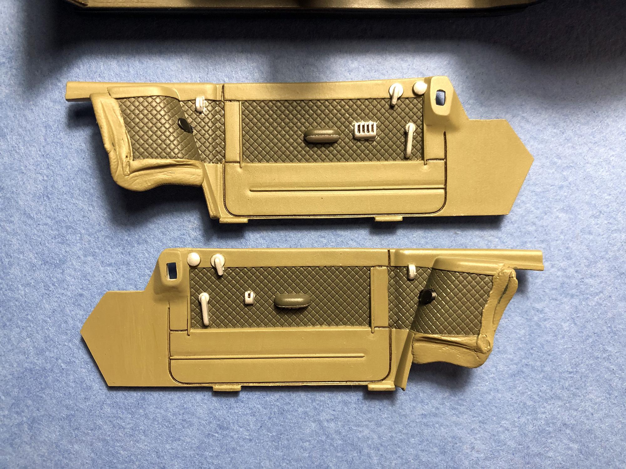

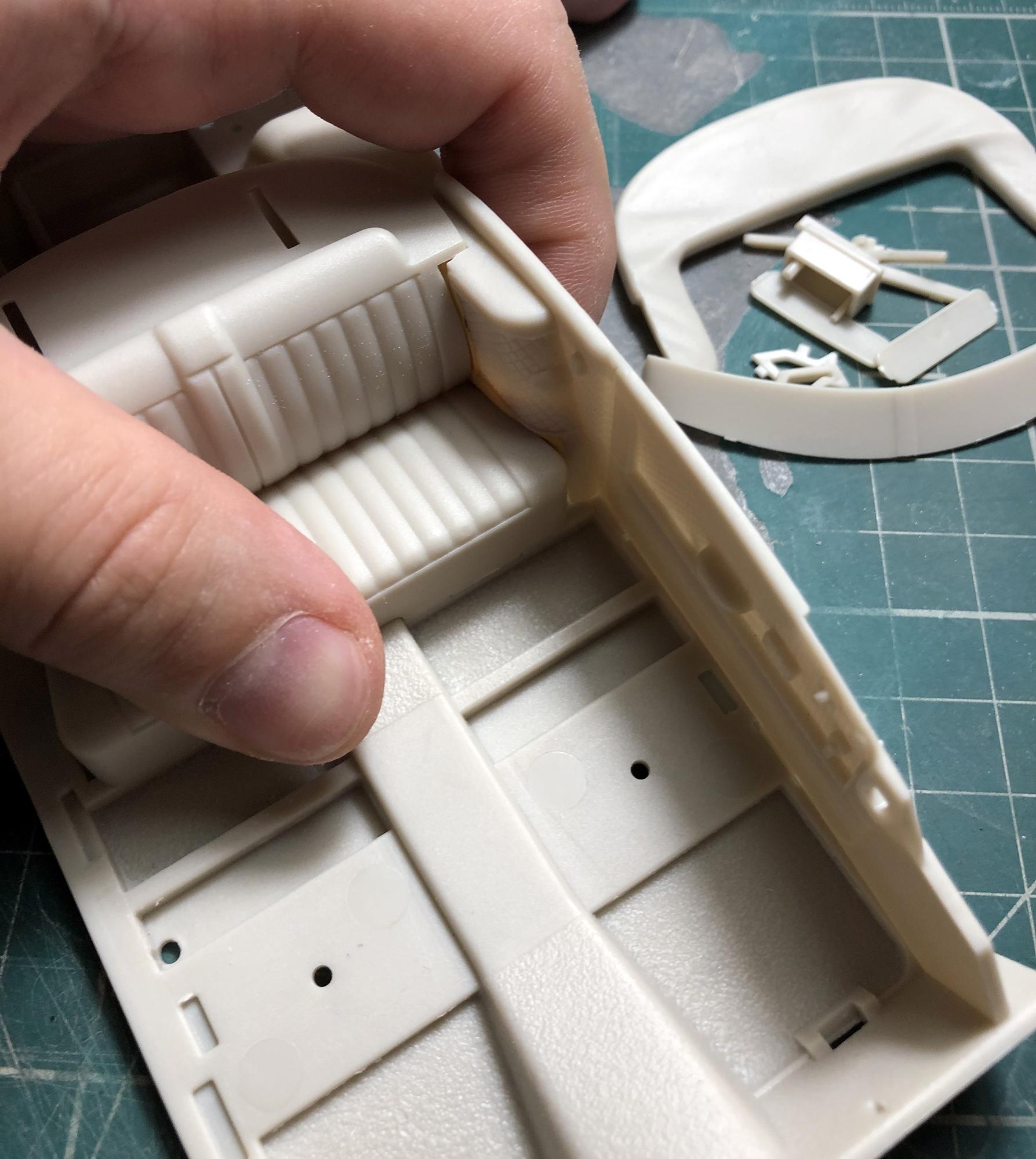

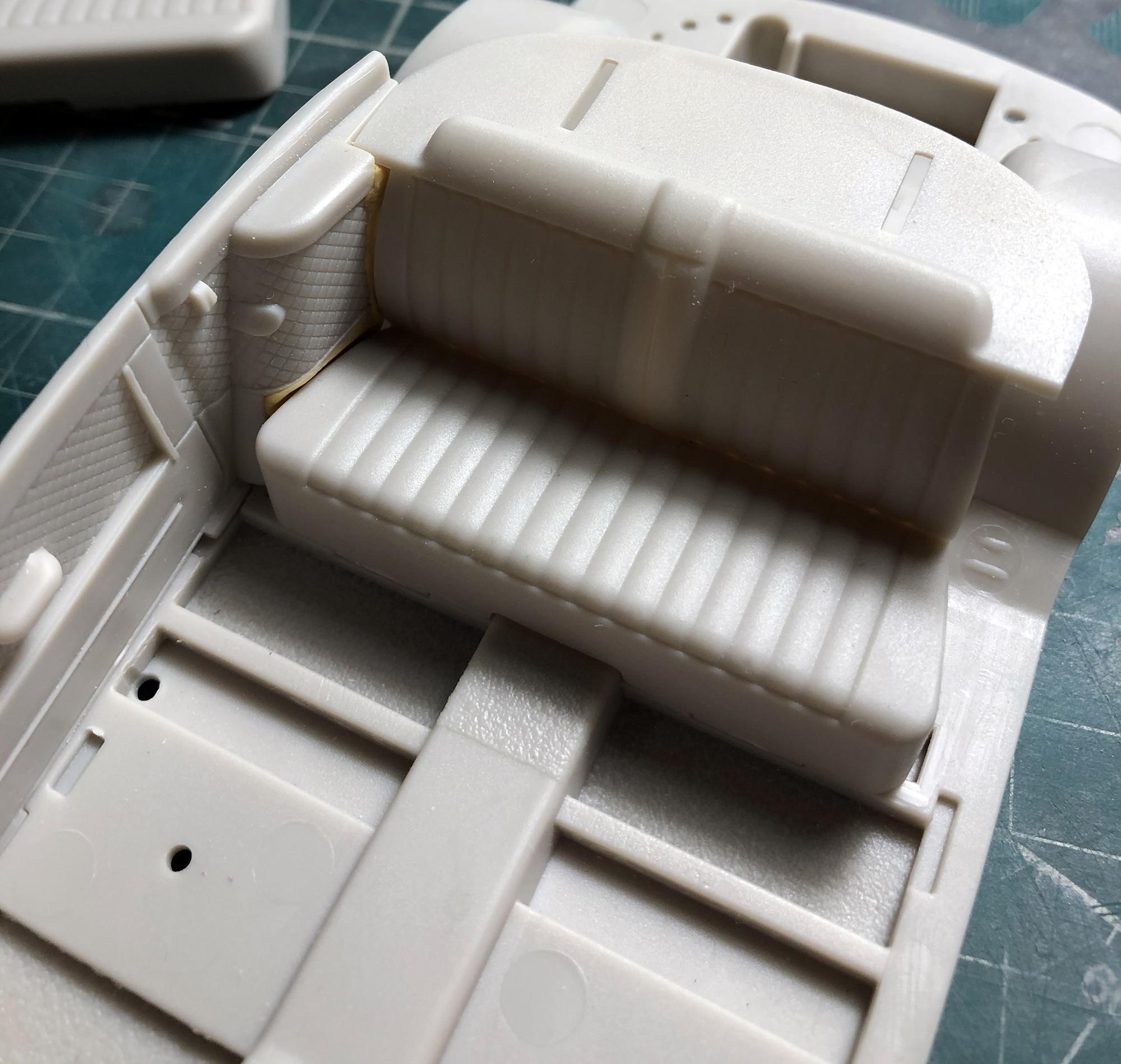

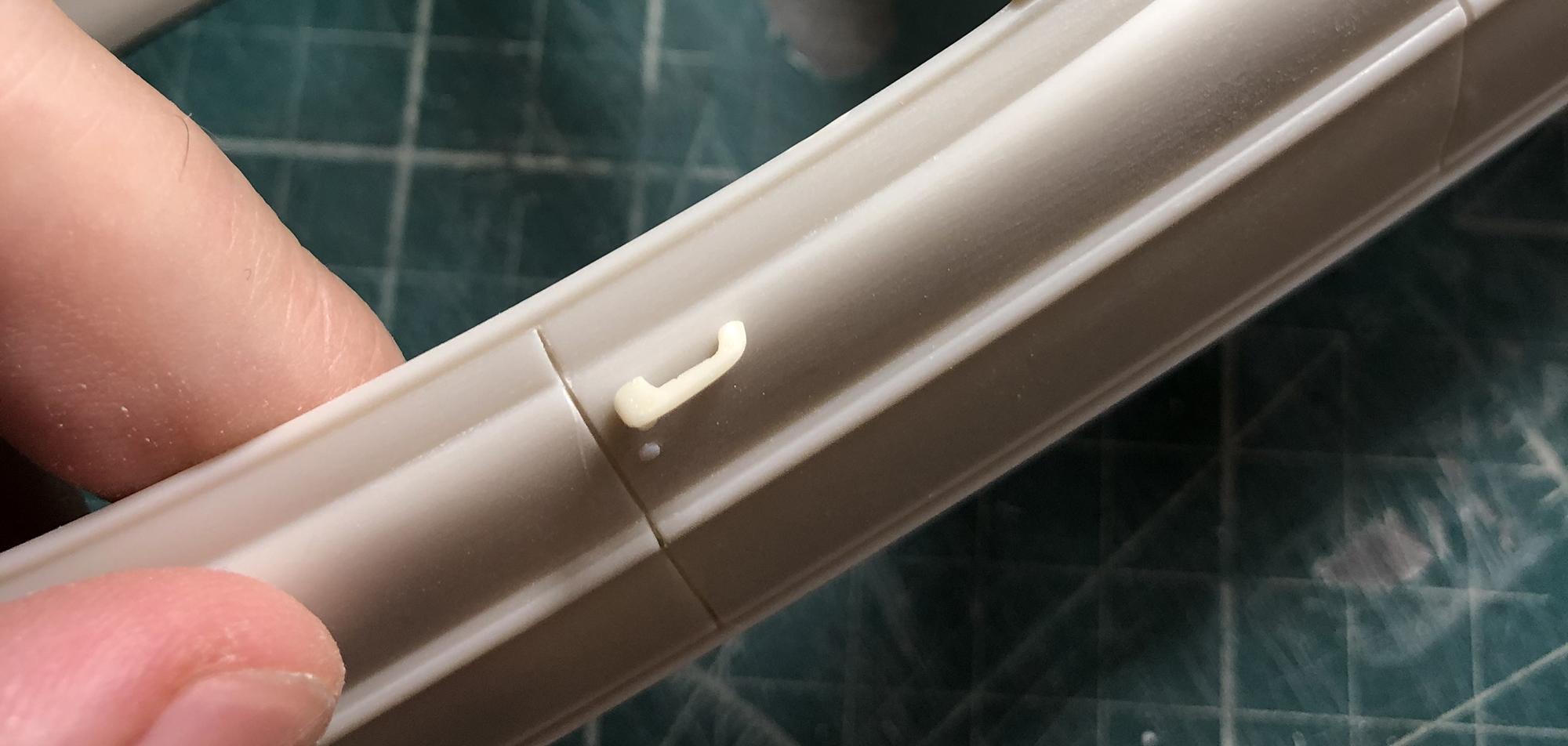

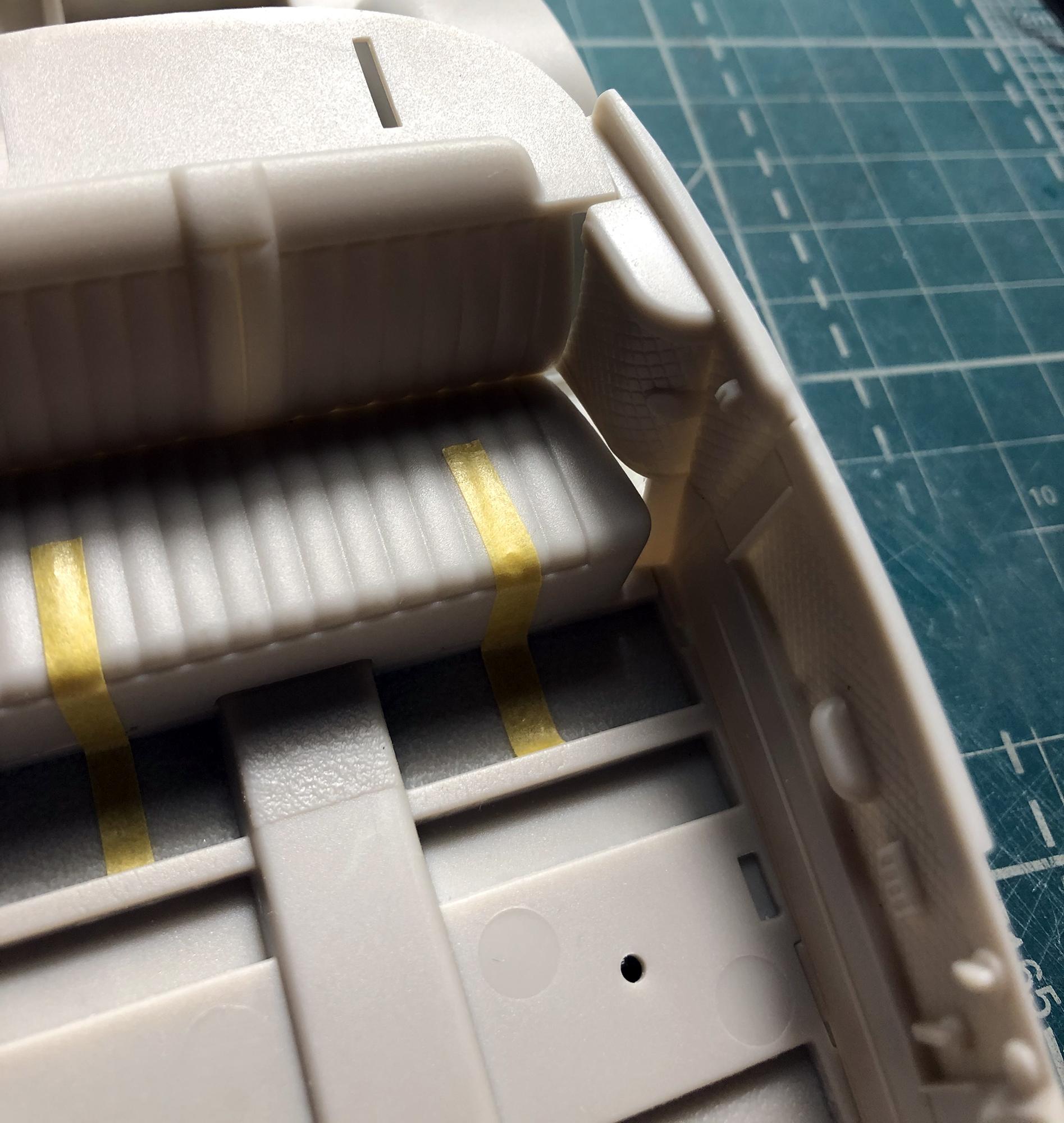

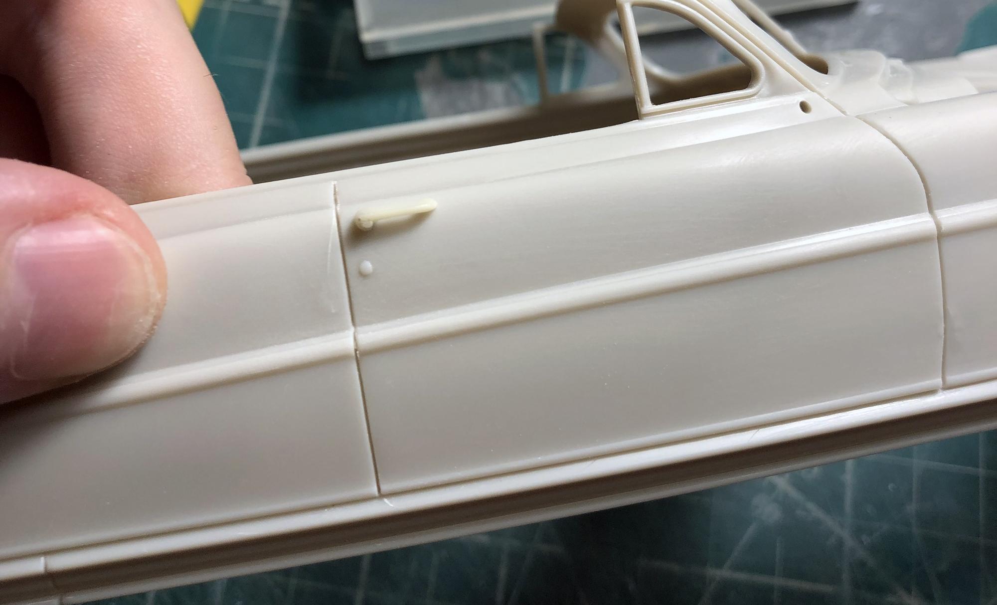

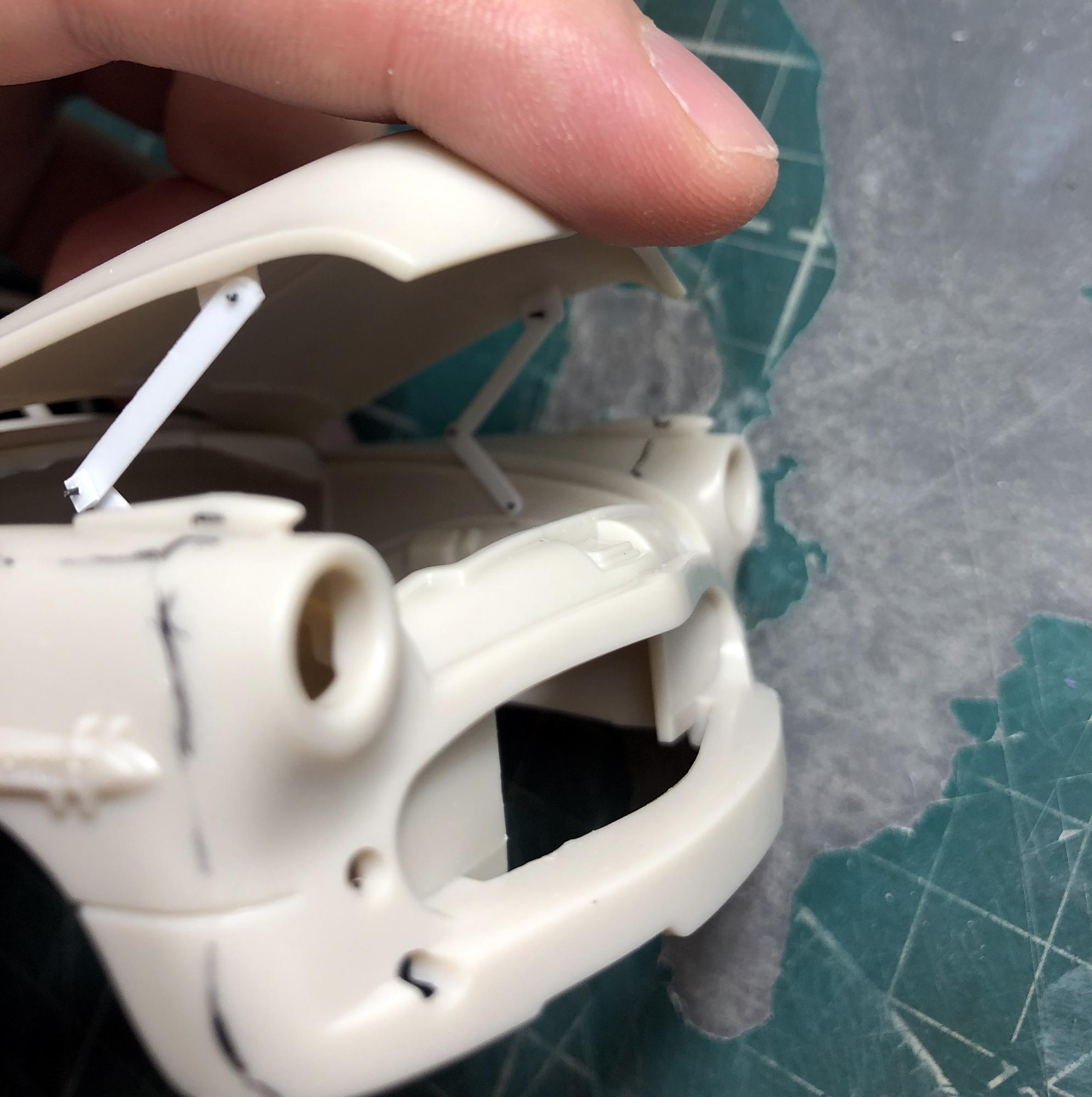

  16. Meanwhile, the construction site does not stand still. When reassembling the cabin, it turned out that there are good slots in the back of the door cards at the point where they are joined to the back seats. If I was building a hardtop, I would score, because it wouldn't be visible after assembly, but here is a convertible.: D We take 2k putty from Tamia and sculpt. Then we had to cut out the holes for attaching the hood, initially we were asked to either glue the fasteners from the set here, but then the body would always be in the open position, or not to glue these fasteners and the hood would simply be placed on top and removed. I had to invent the arithmetic mean. Yes, I know, not canon, but there was no desire to bother with it. Next, I decided to make an open-close mechanism. At first I tried to cut and make from what is given in the kit. Then I realized that it was easier from scratch and made it out of a sheet eraser and metal wire. The exit should be great. Door handles. How Moebius sees them. As I see them. Resin door handles always help out. Well, everything is in the primer. I never cease to rejoice with the nitro Gunze primer. Tamiya is now an outsider for me, I will only use Gunze. Tomorrow I plan to paint everything in colors. That's all for today. Thanks for your attention.?

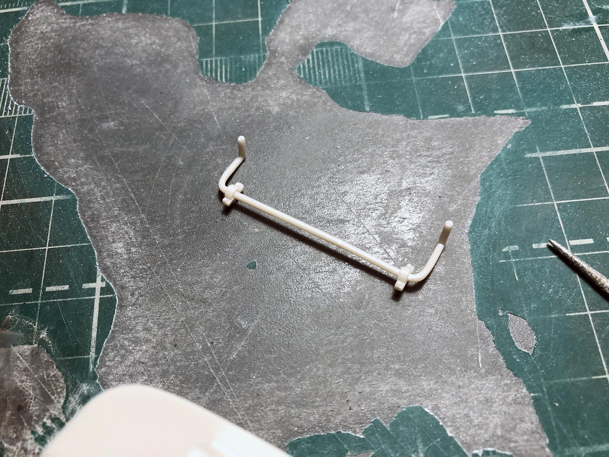

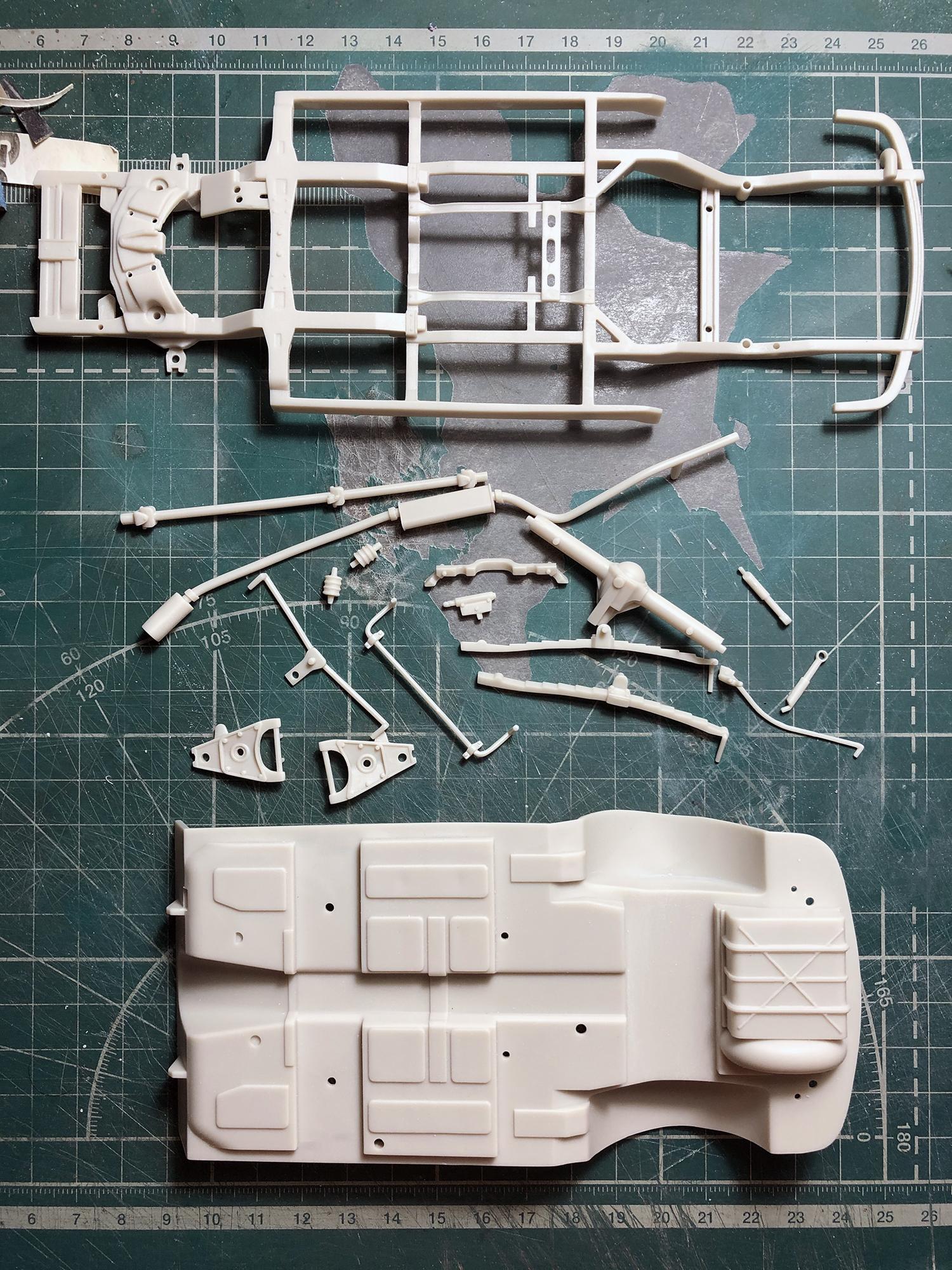

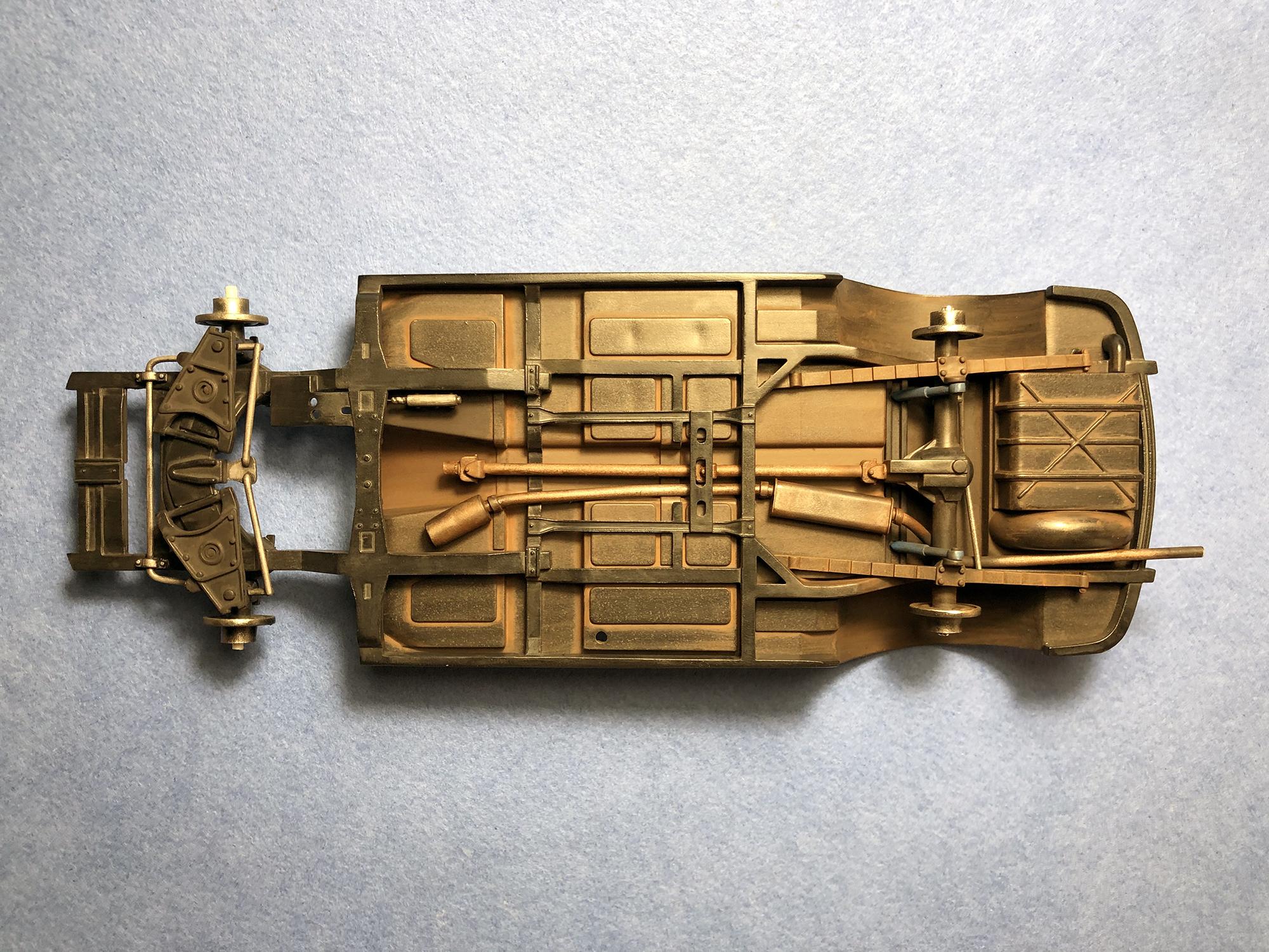

  17. Good afternoon, everyone, comrades. Details are being processed. The construction is in progress. Engine before processing parts. After. Frame and suspension parts - after. There were several nuances that I decided to highlight. This sway bar was originally very long at the ends, I did not have time to take a picture before. Here I cut off half, otherwise it would not fit with the rest of the details. Well, in the undercarriage, 2 holes had to be increased, since the frame did not dock. That's all for now.

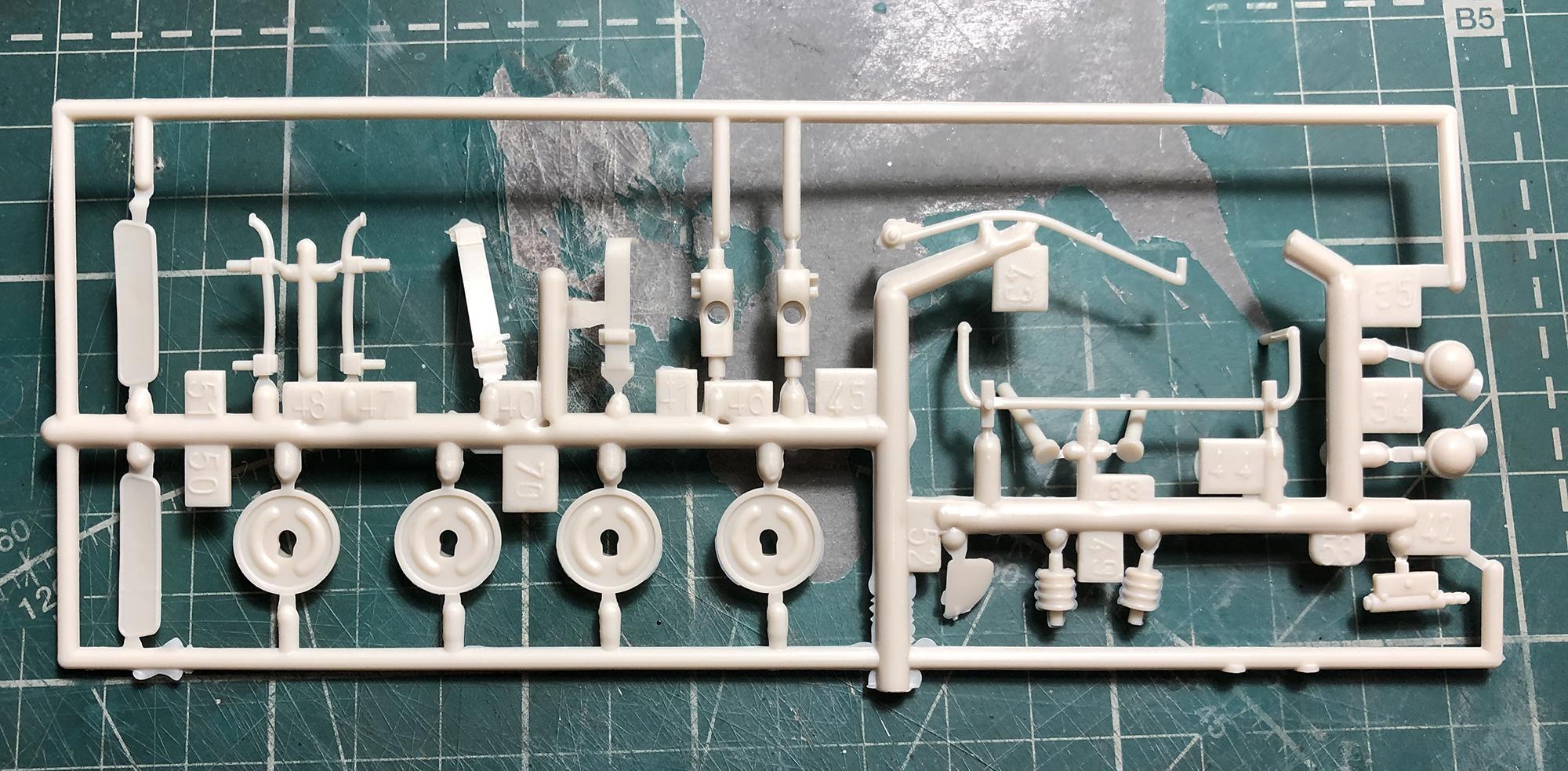

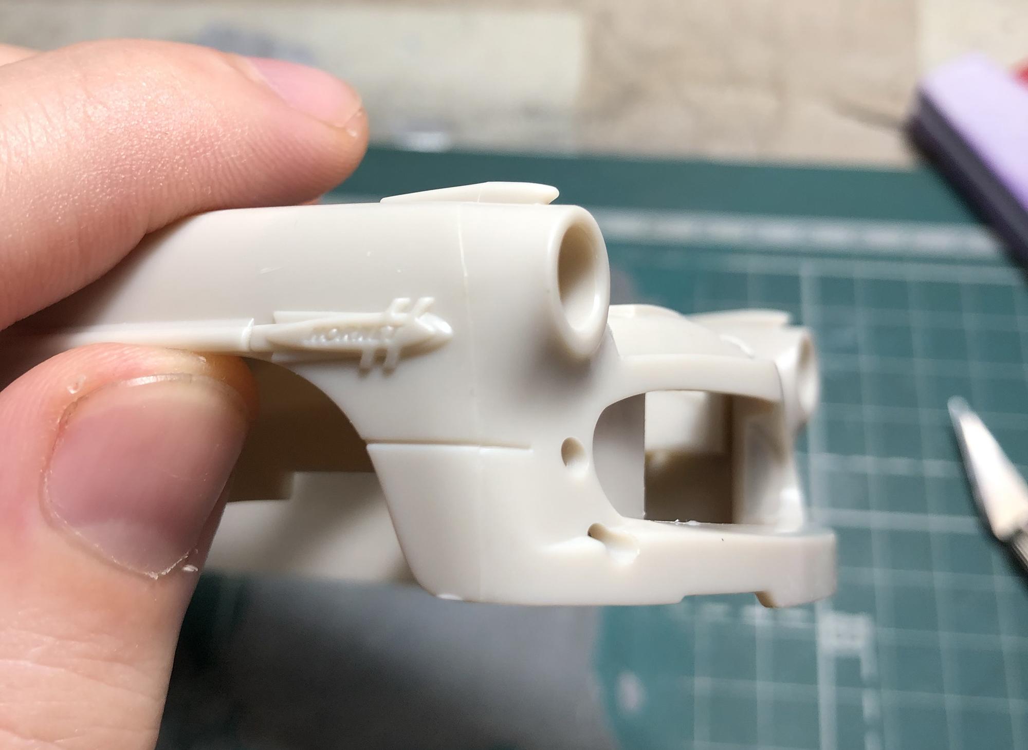

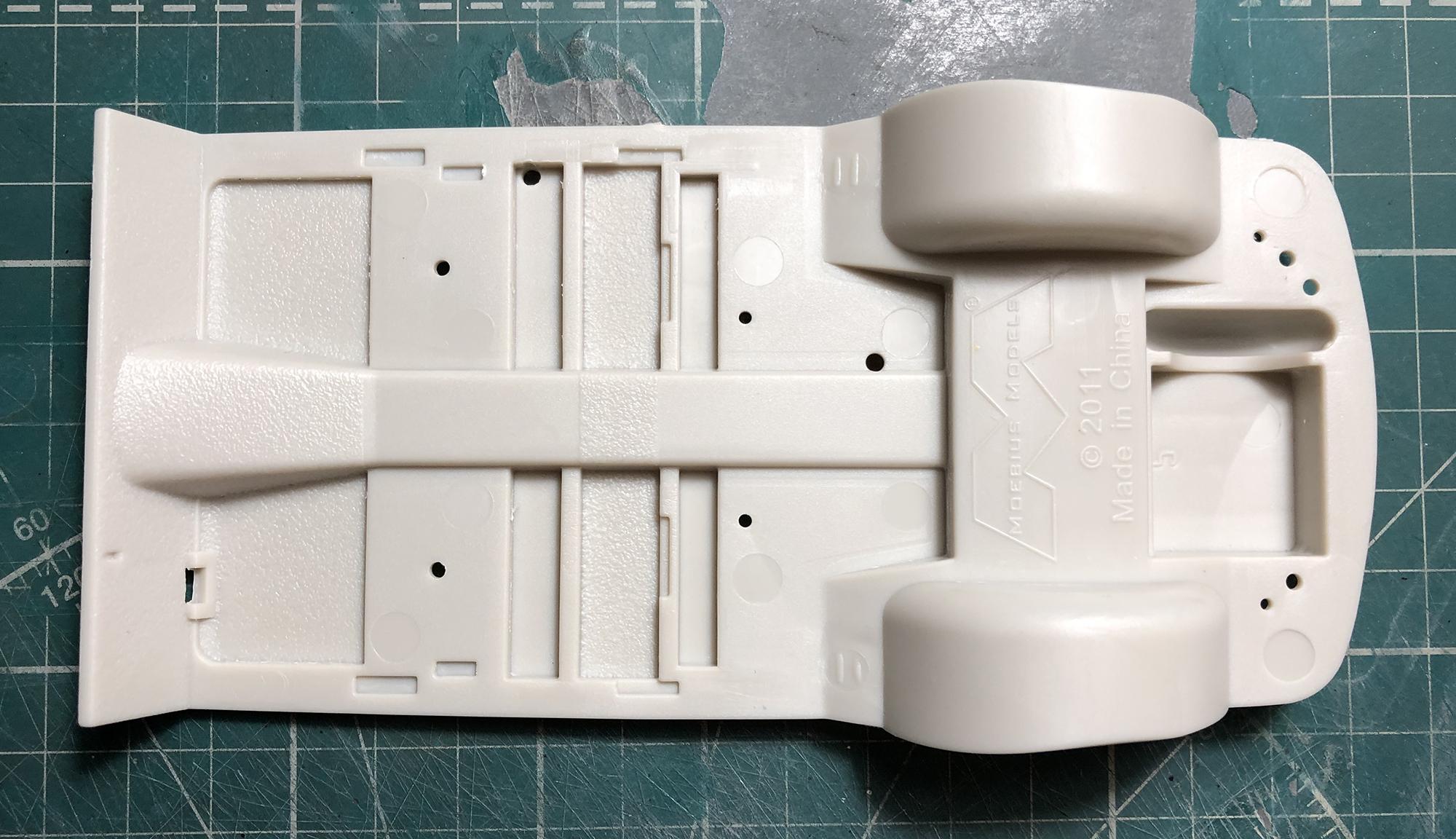

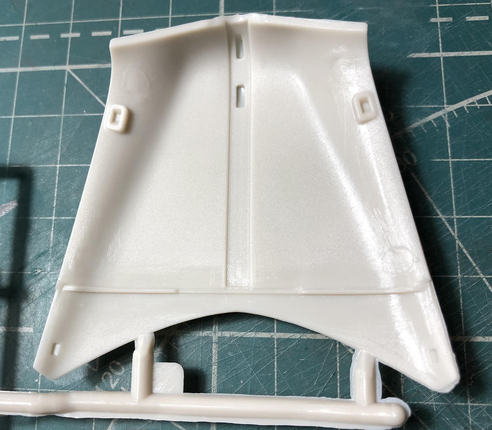

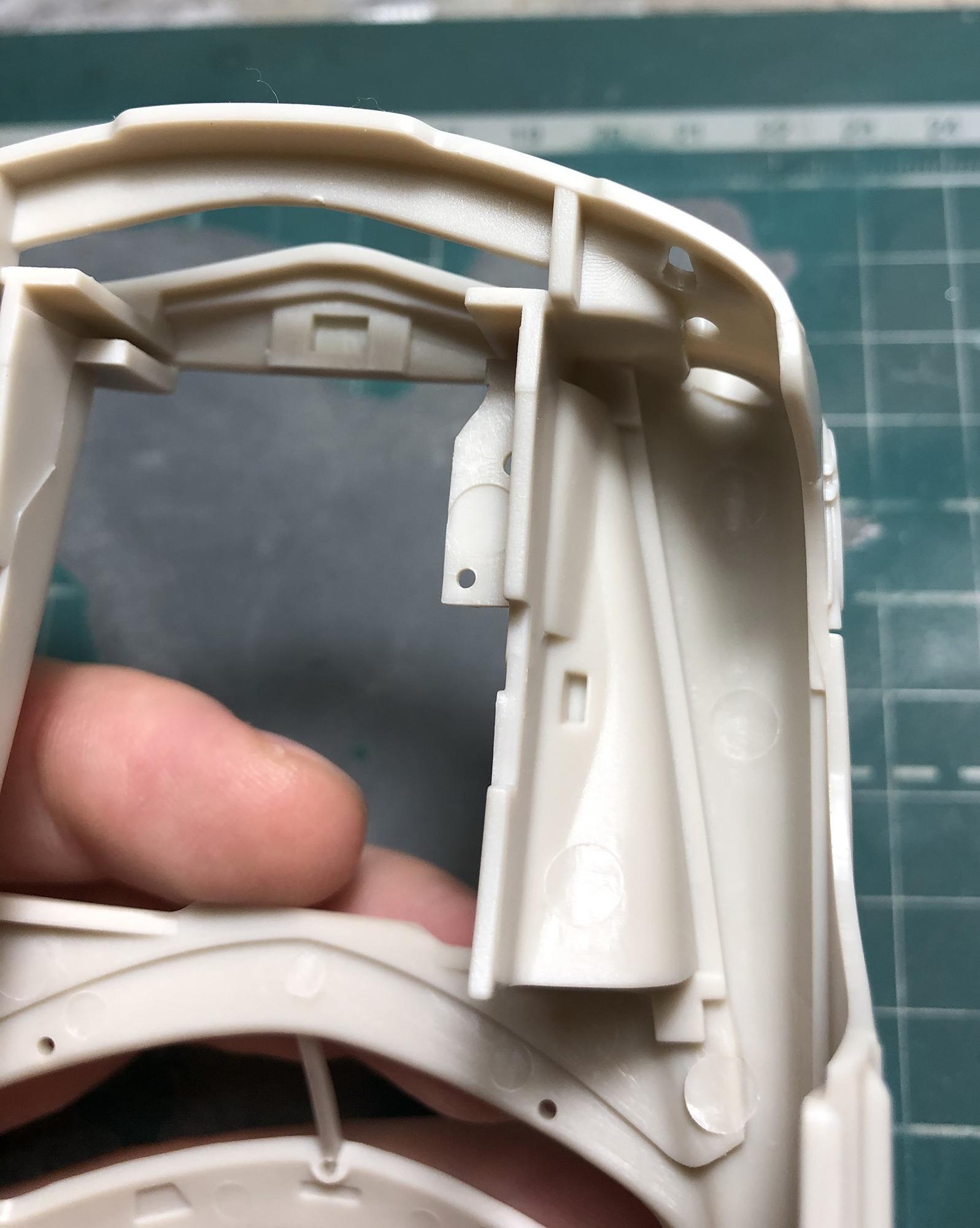

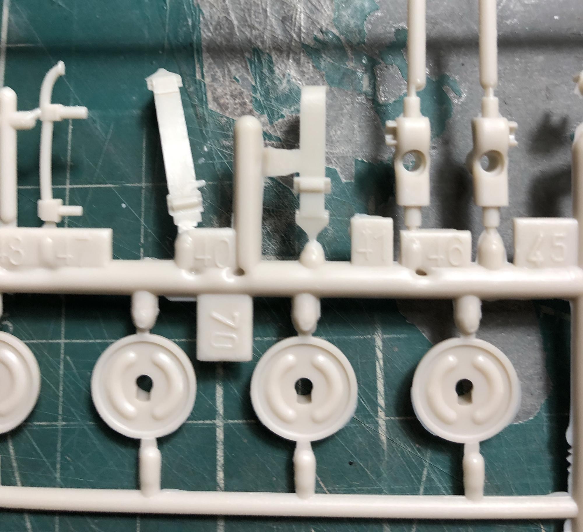

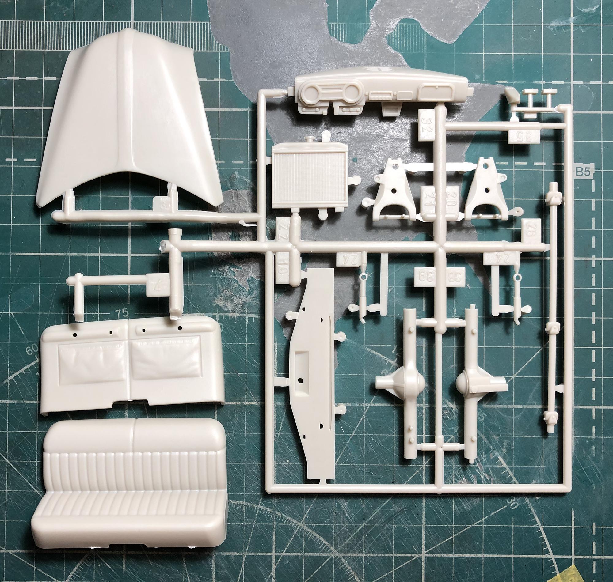

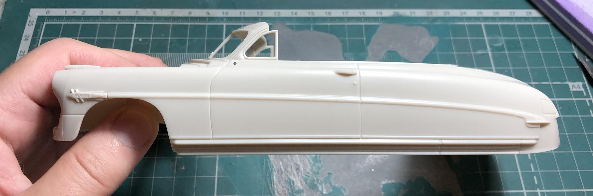

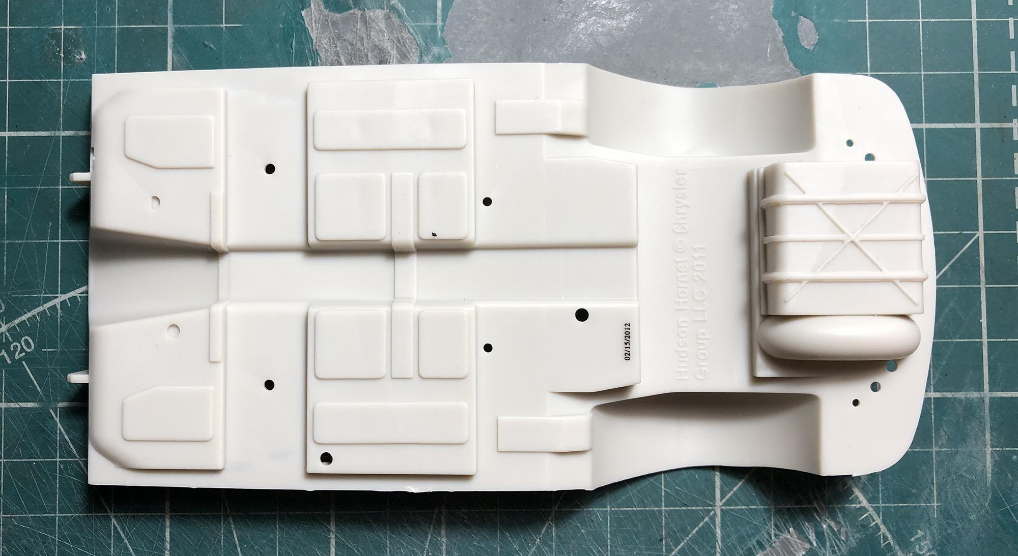

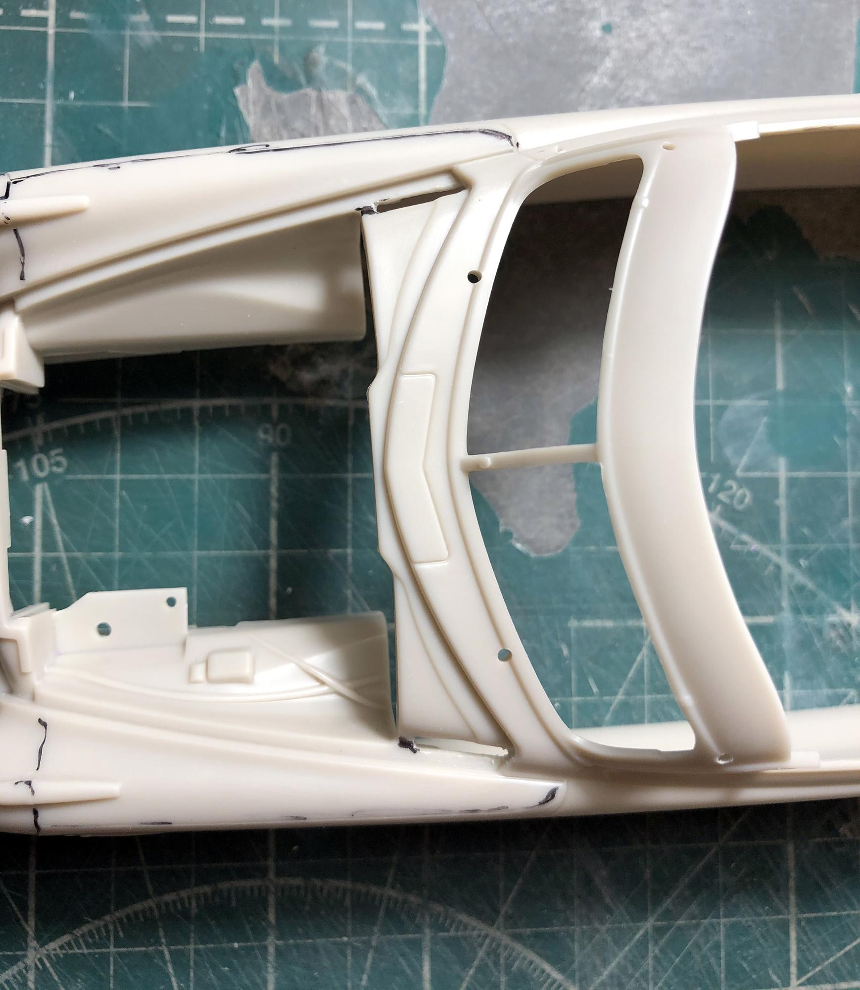

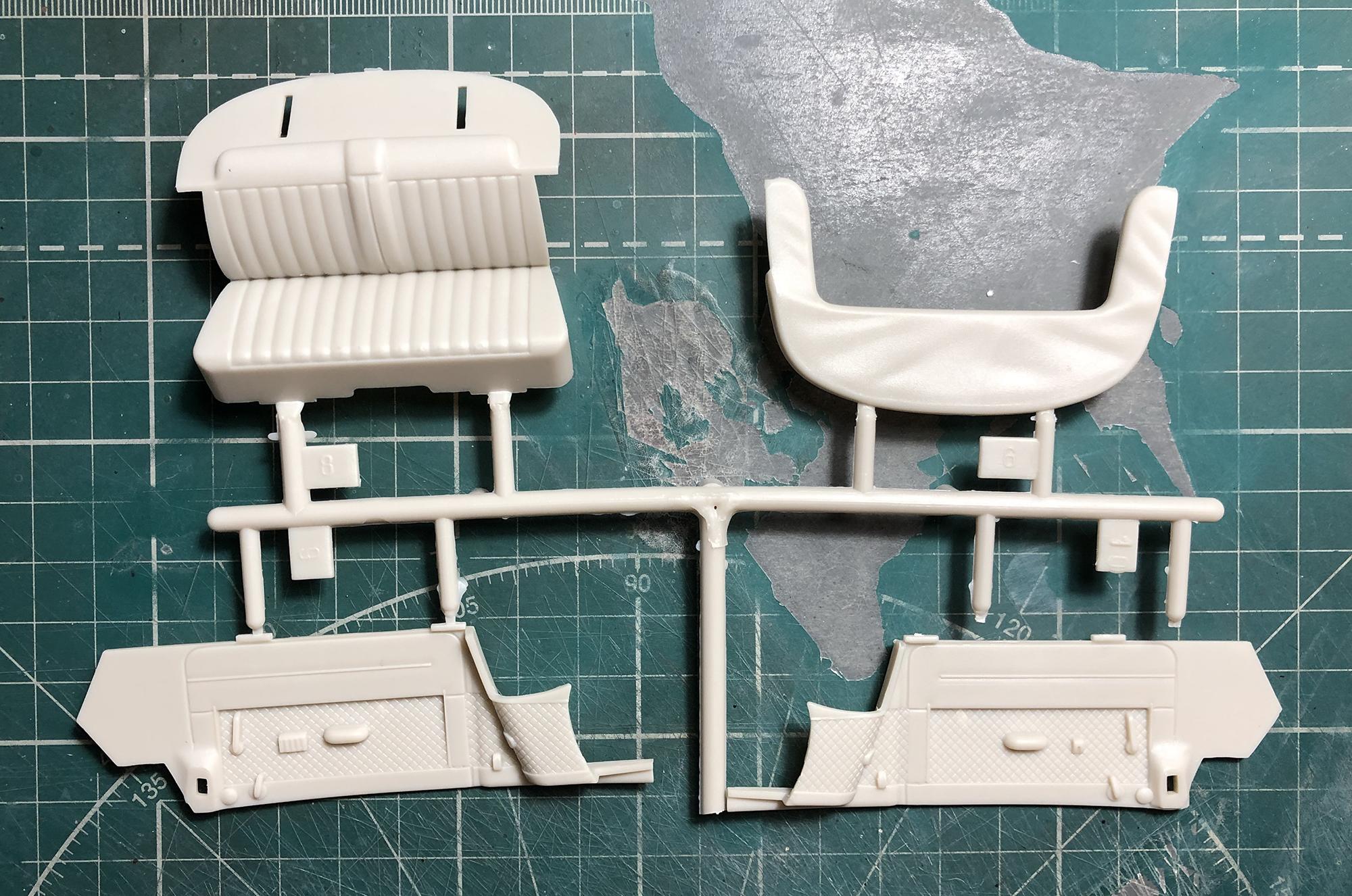

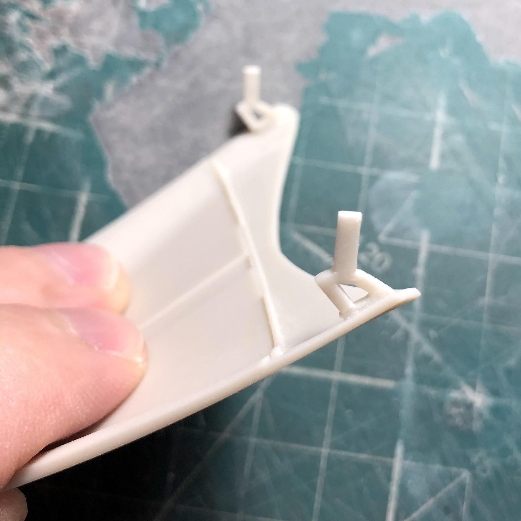

  20. Good afternoon everyone, hands are itching to the point of modeling and here it is a "new" box on my bench. I bought it from my hands a couple of years ago and finally, morally I came to her. Moebius, what can I say. Very much heard, mostly seen on YouTube with assemblies and reviews of Ford pickups. But, opening the box and starting to review the sprues, the rose-colored glasses shattered. But here I am giving an amendment to the fact that I have an early Moebius - 2011 release and now they have improved. Let's start with the body. Everything seems to be fine. But here they are - the first bells. Well, such a thing. Nothing really scary and incorrigible, but hell it. This is Moebius Okay, let's look further. Undercarriage. Well, let's go sprues. It smiled, it looks like seat belts, until I found these parts in the instructions. A flash, again a stone in the Mobius garden. Frame. Well, the sprues went further. The tidy is sad, everything is purely for decals, which, by the way, were not in my box. It is clear that he took it from his hands ... but, it's a shame. My favorite pushers are on the inside of the hood.))) The front seats is gorgeous! So are the interior sides! Glass. Chrome sprues. Metall axle. Tires, by the way, are also not native. Where the hell are the whitewalls?!? Large colorful manual, for the first time I see this in my modeling practice))). I chose the color scheme for a long time, I will paint with acrylics from Tamiya - two-tone body and interior. As a result, a bit of a controversial "high" quality, as Moebius claim in his web site. Well, when buying boxes from your hands, be careful. I am missing the part of the exhaust system that connects the exhaust manifold to the pipe, decals and wheels with whitewalls. I'll try to write to the manufacturer, maybe they will send me the missing one. Who knows. While I'm going to collect photo references and in a couple of days I will start preparing the details. Thanks for reading.
