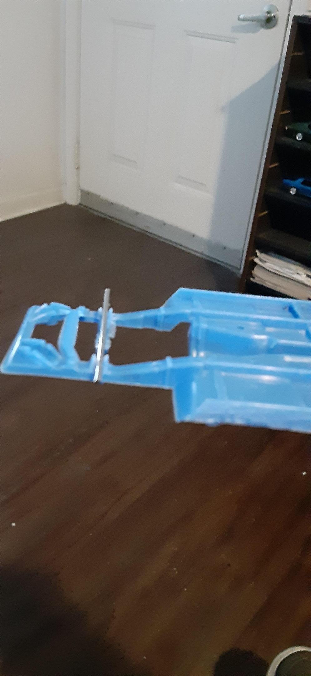

After a few hours it has taken shape. Retained much of the interior. All 4 door panels intact. Modified front suspension to retain metal axle. Will allow springs and upper arms to attach to stock engine bay.

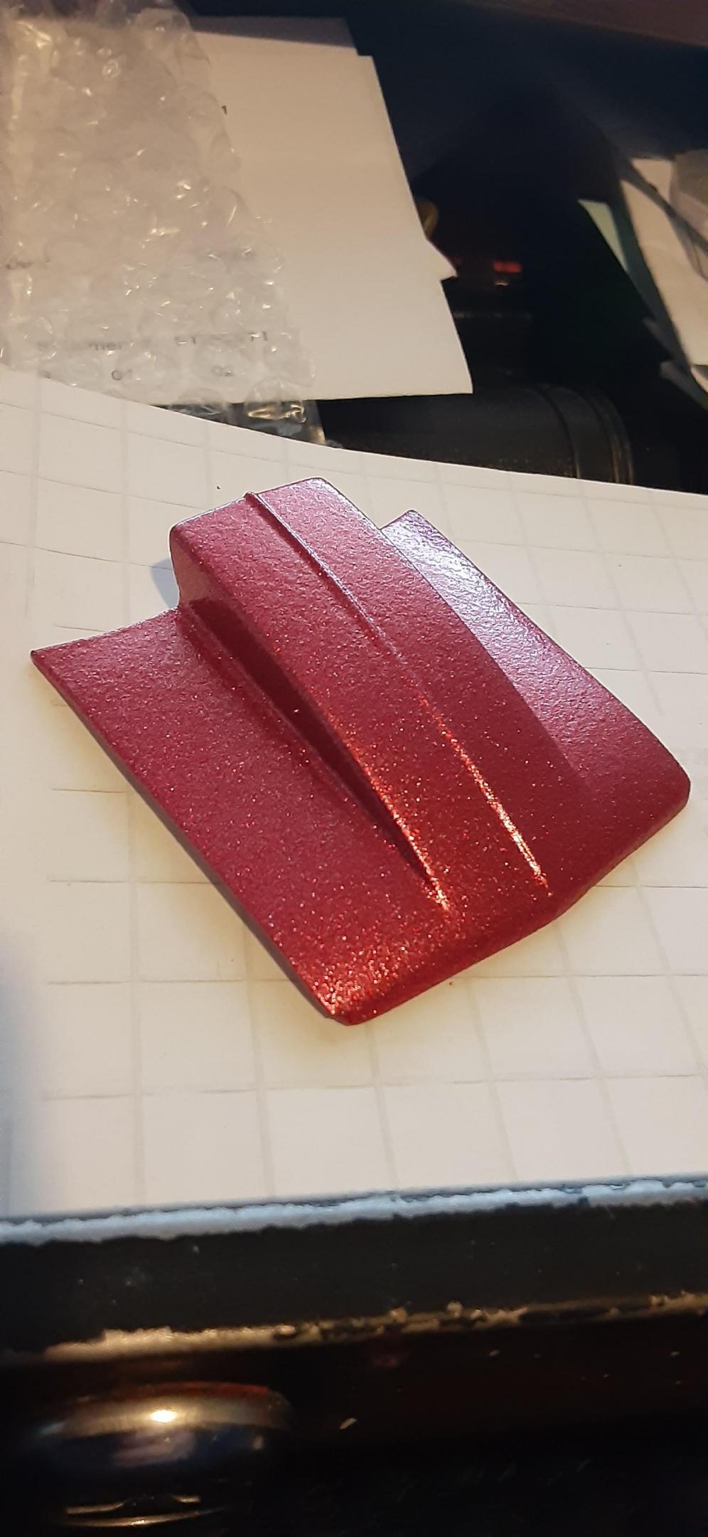

Using a resin hood from Ebay seller I have good luck with. Paint is Krylon Shimmer Apple Red. High metallic finish with brilliant reflective finish.

I have done this swap. I had to cut the Foose frame at the battery box . Keep the running board mounts to center and glue directly to the floor once you get the wheelbase right. Then add styrene and smooth. I also moved the 4 link inboard and narrowed the rear to add slicks for a drag look. It's a WIP but. I can say this. The Foose frame is able to fit many applications. It was a near perfect swap on my 50 F1
