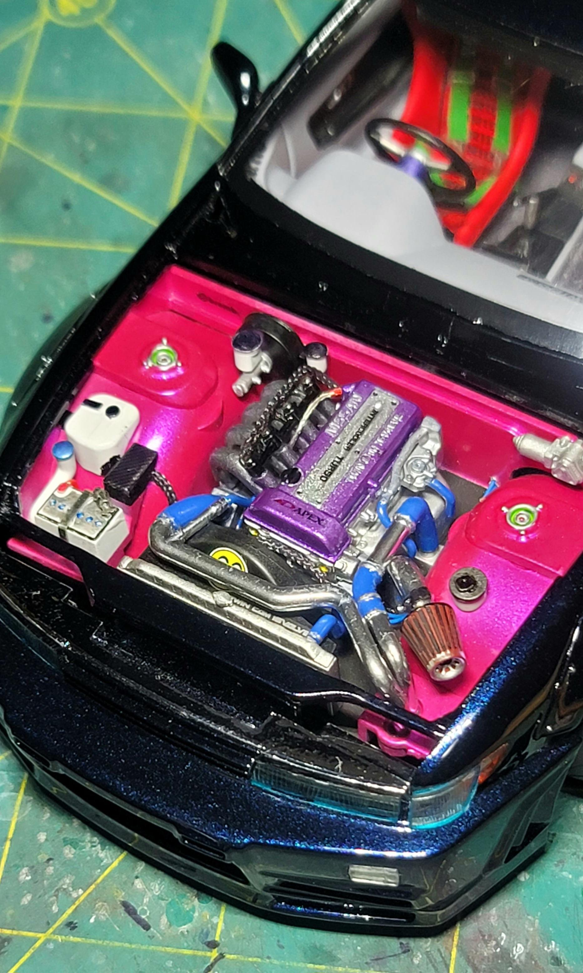

Body is on, lights, mirrors, wipers. All that's left is the PE parts, side marker lights, and detailing the wheels.
Color is done. 2k Black, sanded, buffed, and polished. The blue you see is the reflection of the sky.
Dash finally got finished. The digital gauges didn't work out very well, so I just used the gauges that came with the kit. Applied resin over the gauges, and monitors, and made the "crystal" gear selector out of clear sprew. The steering wheel was printed by my buddy Matt Reynolds The metal flake I usually use on my bodies were a bit too big for the steering wheel so to give it that look of a flake wheel I used silver pearl pigment over black, then kandy blue.
Been pretty busy doing other things and haven't really been able to sit down at the bench and build. Got a little more progress on the interior.
Decided to go with Yamamoto Model Car Parts DTM style muffler. Notched the rear for the opening, and mockup.
The interior has color and flocking. The table fits great with the rear seat pushed back into the cargo area. The chrome paint on the door handles is Green Stuff World The chrome trim on the front seats is Hasegawa film.
The rear suspension was super easy. Cut down the mounting just a bit (2.75mm) and filed the wheel mount to camber the wheels into the wheel well. I use a camber gauge by ZoomOn Models to make sure it's somewhat accurate and symmetrical (or close to symmetrical 😂).
The front lower arms needed to go up so it meets the lowered state of the spindle. A little work with my "V" shaped file and a little heat from a hair dryer fixed that.
