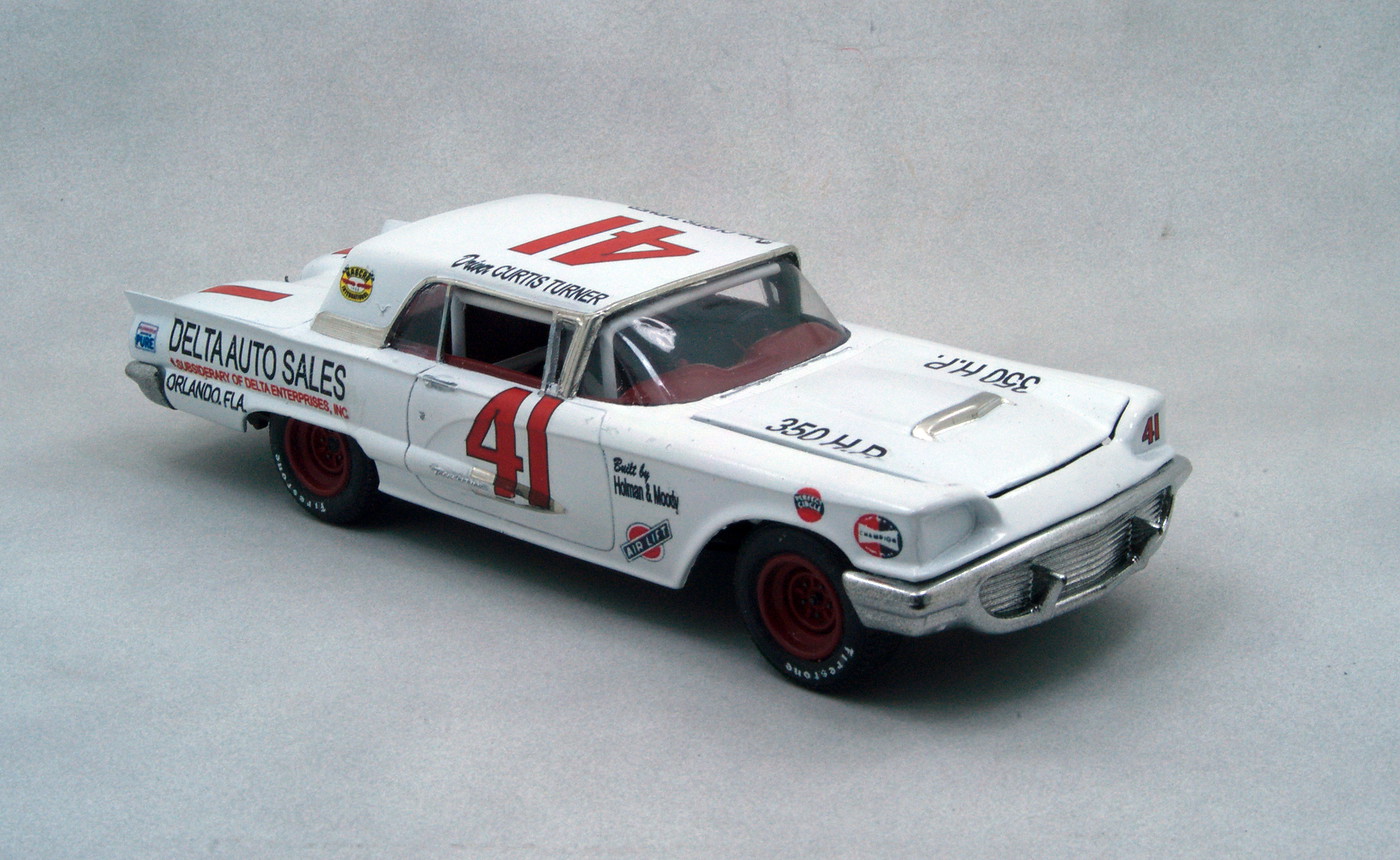

  2. In my continued quest to build a bunch of race cars Curtis Turner drove...here is a model of his 1959 Ford Thunderbird.
    He drove this car in the NASCAR Grand National Series for owner Doc White, competing in 9 races, winning 2.
    Unable to find a 1/25 scale model of this car, I did find a beat up "Wheat's Nostalgia" promotional model on eBay for under $20.00.
    I cleaned up the body, removing the under-hood pins, cut the hood out and re-chromed the bumpers with Alclad.
    Used the chassis, engine and wheels from the Revell Ford Convertible kit.
    The windscreen and rear window were unusable, so vacuum formed a set from the originals.
    Scratch built the interior, adding a roll cage and a resin cast seat from the Revell 1958 Thunderbird Convertible.
    Paint is Humbrol White and decals are from "Slot Car Fever".

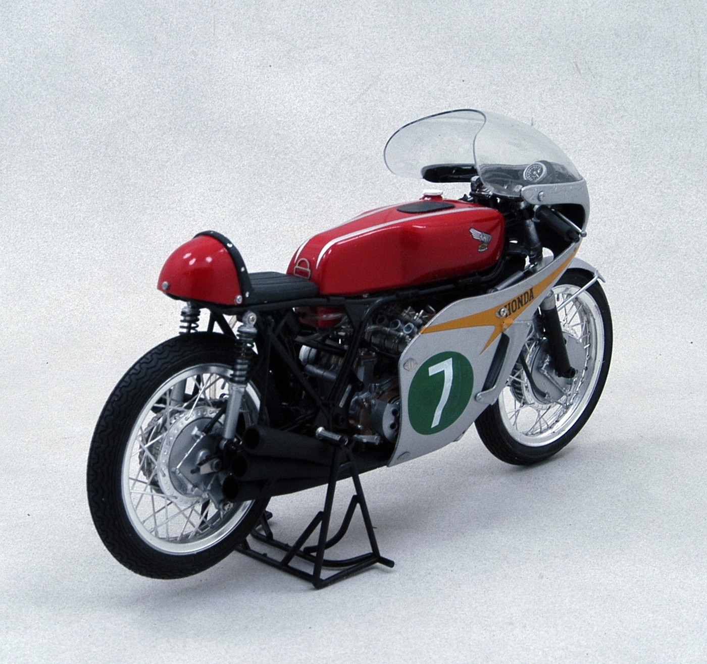

  5. Bought this kit when it first came out a few years back.
    Thought it was about time to build it...what a surprise!
    This is probably the best motorcycle plastic model kit ever produced! What a joy it was to build.
    I built it just straight out of the box, didn't use any of the aftermarket detail-up sets Tamiya offers.
    I was surprised on how small this bike is compared to other 1/12 scale bikes I have built.
    But, then again it is only a 250 cc engine with 6 cylinders. The diameter of the cylinders must be the size of Quarter!
