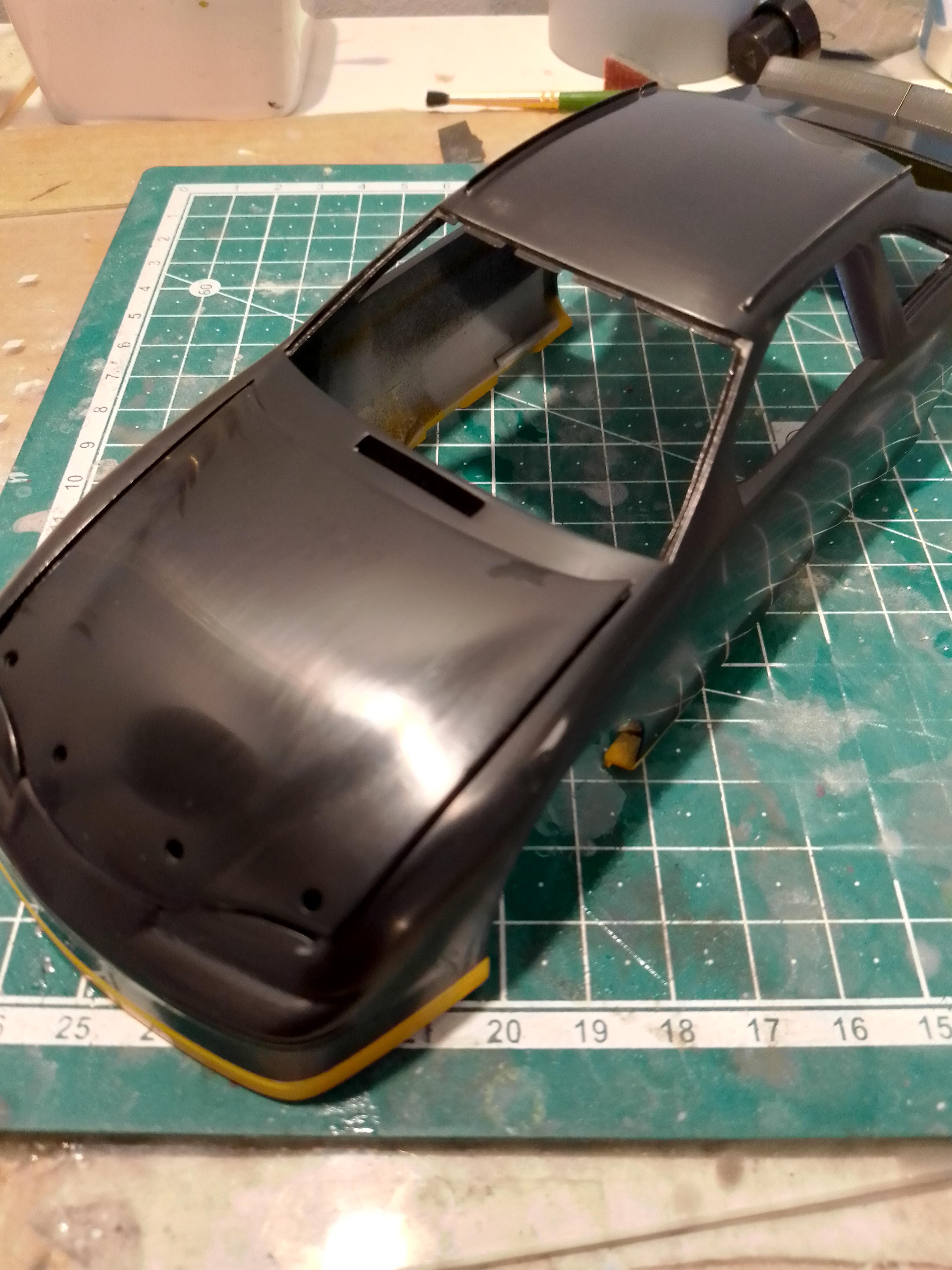

Thanks to reply. Heavy wet coats, those small Humbrol cans really blast out the contents and the dried surface, I can even catch my fingernail on it. Definitely more extreme than the blooming I've had when tried spraying in too cold weather. Already tried some sanding, does improve the finish. So now to sand the whole car! My Slixx nascars are jinxed am sure! Even when the decals lay down, the final step always fails. On another bodyshell, even had paint cracking due to a Microsol solution reaction.
Hey all. Some advice please on how to complete this rattlecan clear. I used Humbrol semi-gloss acrylic, but I have read that humidity could be a cause of this frosted surface. It's possible, as at time of spraying it was a warm humid afternoon. Damage is done now, but how to fix or at least improve it? Rubbing compound to remove or will another clearcoat hide all this mess?

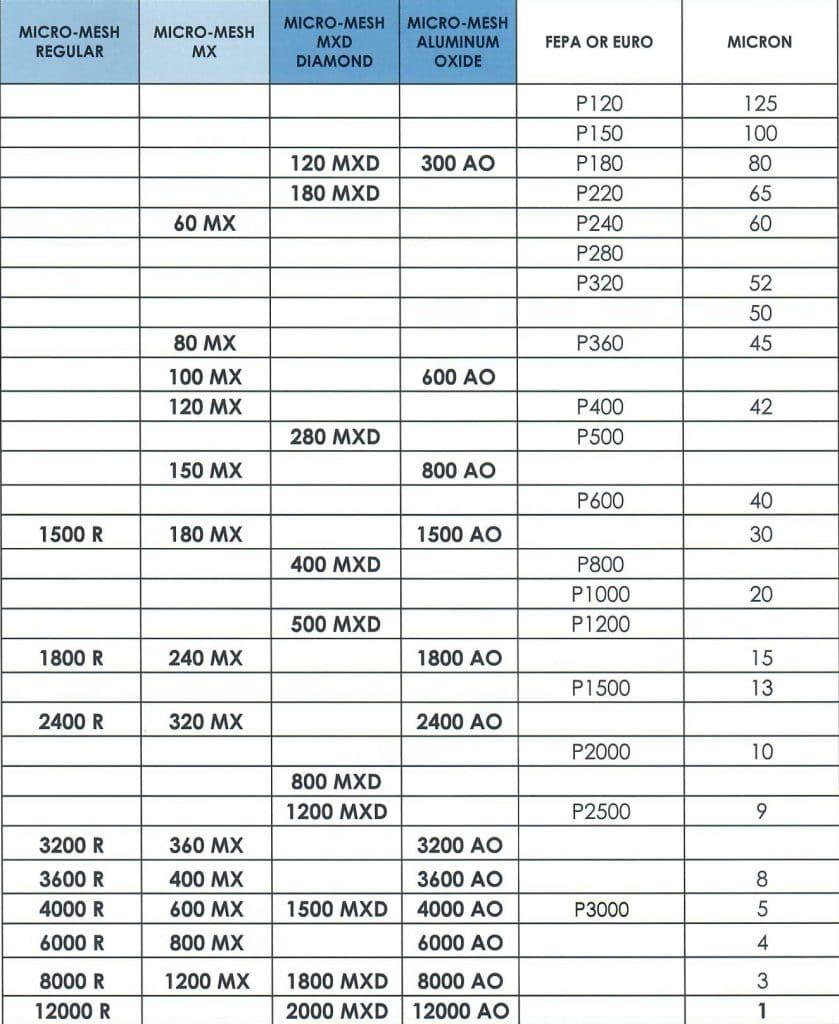

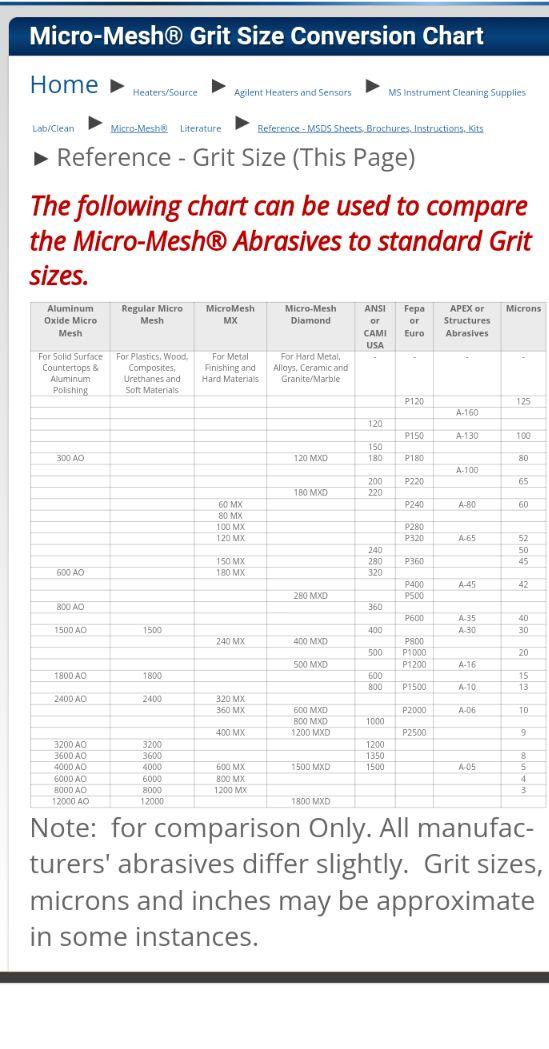

I replied with this on another thread, but perhaps it's worth a post as a heads up for all us Euro members. This chart, can see the grade differences of USA and Euro wet'n'dry. Japan too have their own number system. Cutting compounds will also use this system? Meguiars vs Farecla for example. And another chart for the MicroMesh, also some different numbers but the same micron grade.

Even with the various genuine MicroMesh, there are also 'equivalent' differences. And between USA and Euro. 800 USA = 1500 Euro, with USA having finer grades of regular paper. -

800 wet? Wow! Currently I am sanding this car down to 2400, so will stop here. Am keen to complete some painting jobs. Have also learned of primer pinholing whilst working on this. I had dozens of them. Have to say, am finding that a sanded colour coat is better to work than the actual primer. Surface problems are much easier to see. -

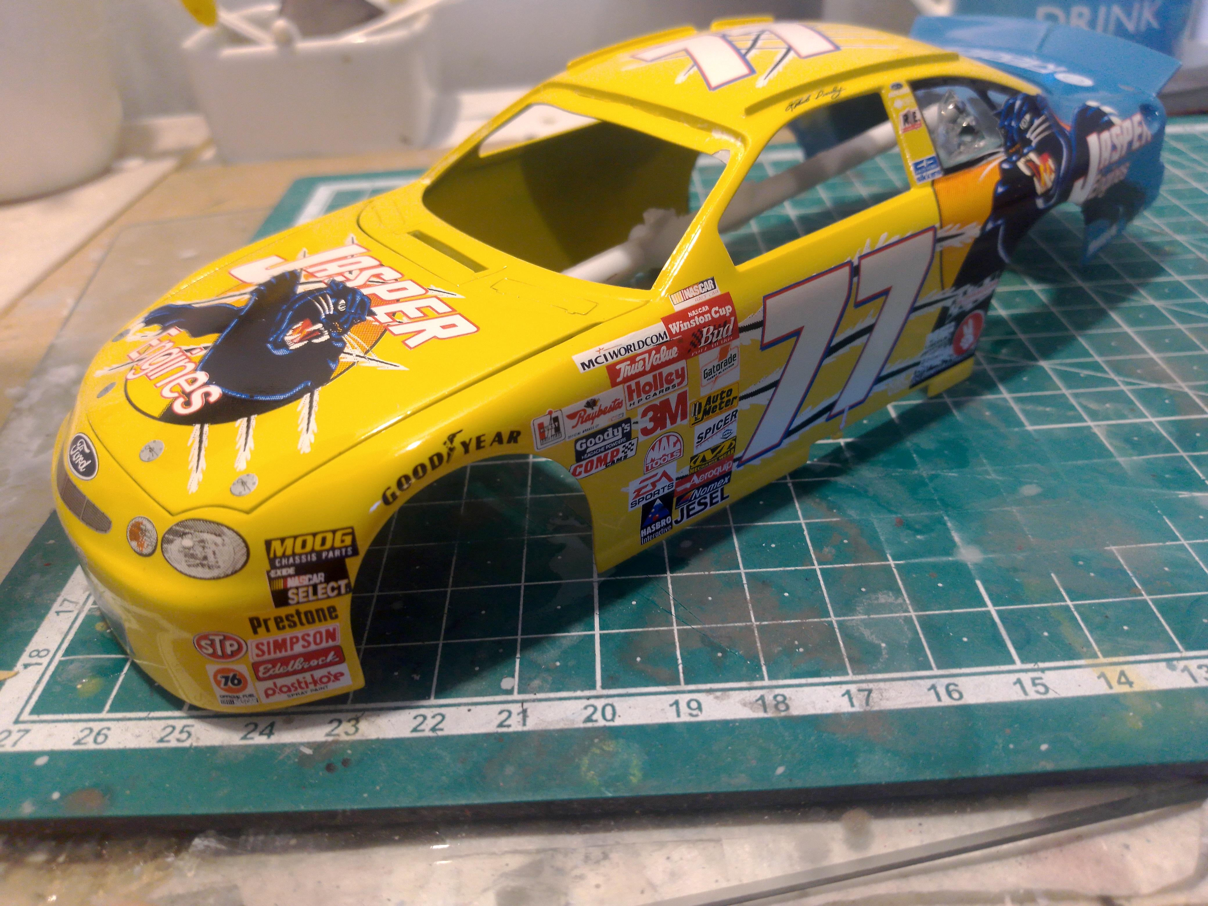

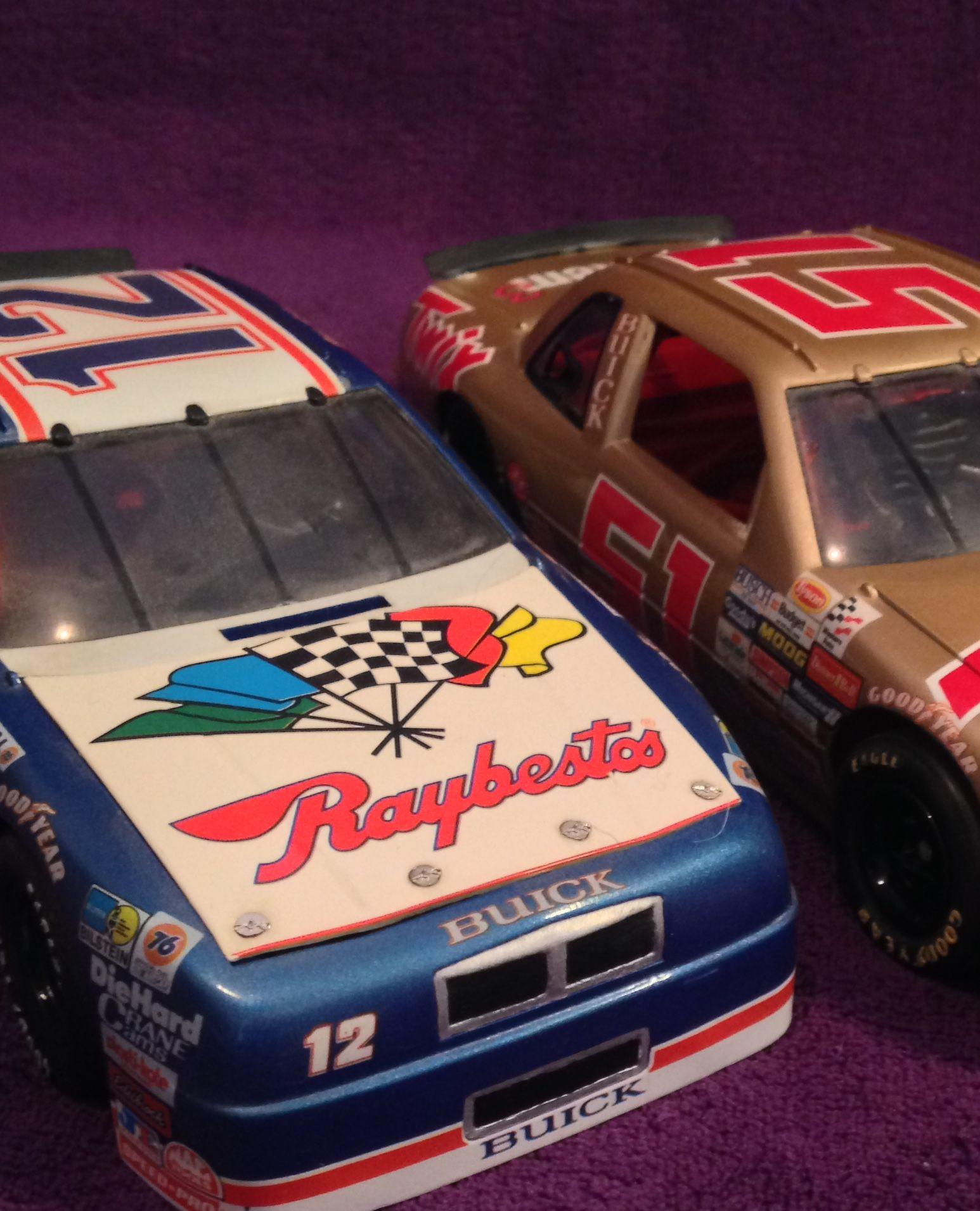

A question for rattlecan metallics only, the acrylics for 1.1 cars. Is the powder/granules used, a larger size so they're cheaper to manufacture? Compared to thirty years ago? Here is a pic of my nascars from the 90's, the metallics look quite fine and almost in scale. I have this year tried a pearl and metallic rattlecan and surprised at how large the mica/flakes looked.
