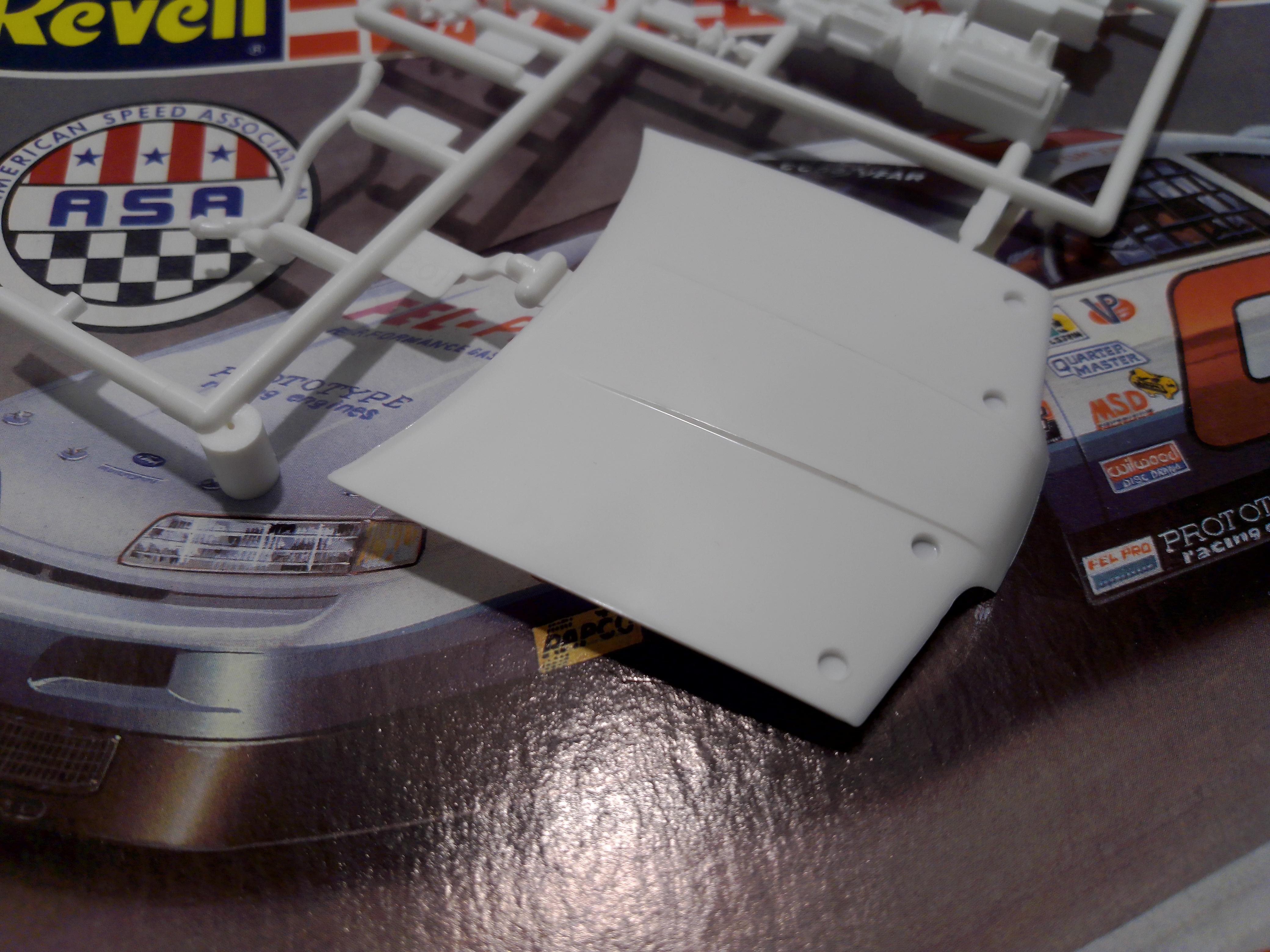

  9. Hi all. The image, the hood is from an ASA Fel-Pro T-Bird. If possible how would I make a replica? A cast of it perhaps? I have an old built ASA Zerex T-Bird without a hood. Lost in time somewhere. It's a tricky shape,centre ridge and with a slight lip at top edge.
