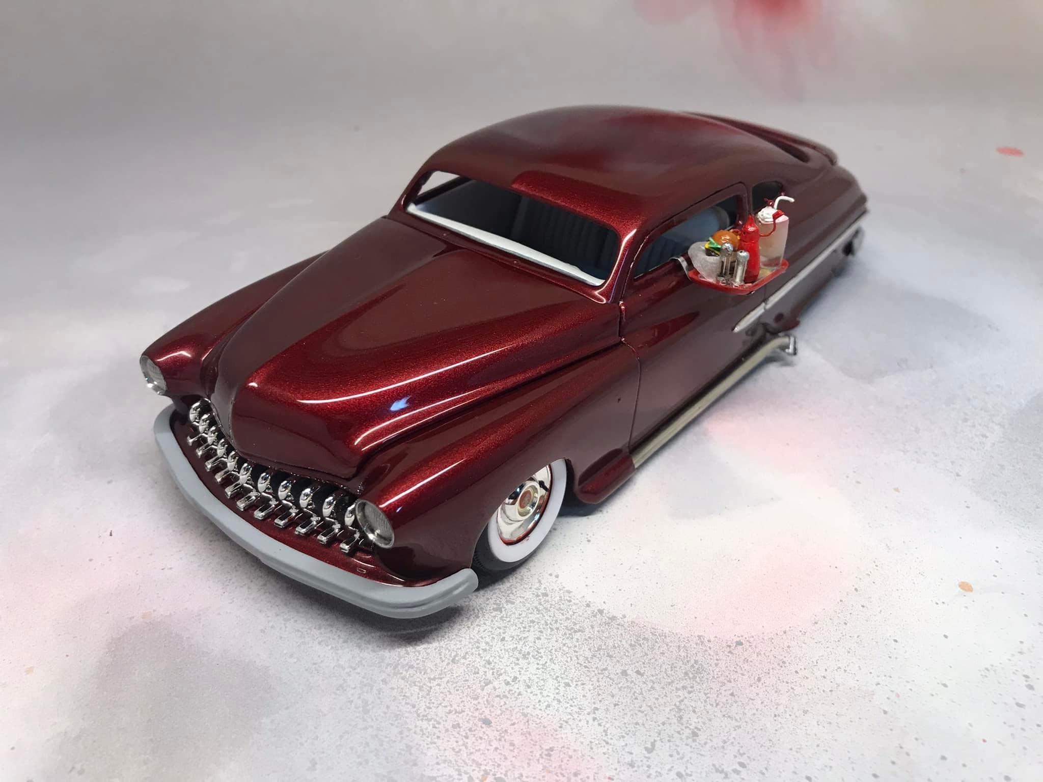

LOVE the wild color choice!! You did a great job on the body mods as well!... Here is the one currently awaiting finishing on my bench, I turned it into a tudor sedan while chopping it, I finished it in '56 Ford Sunset Coral. Thanks for letting me share it!
