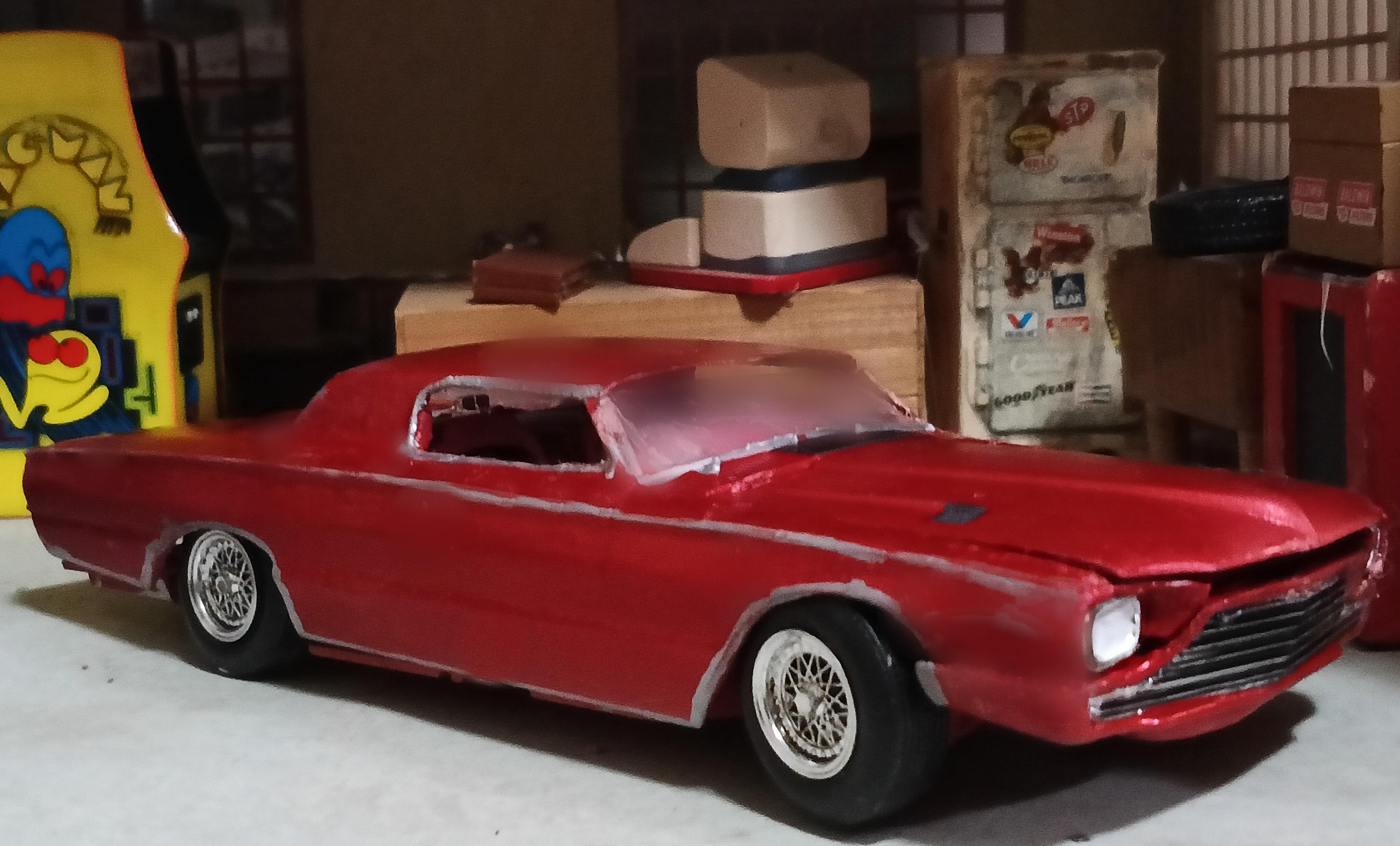

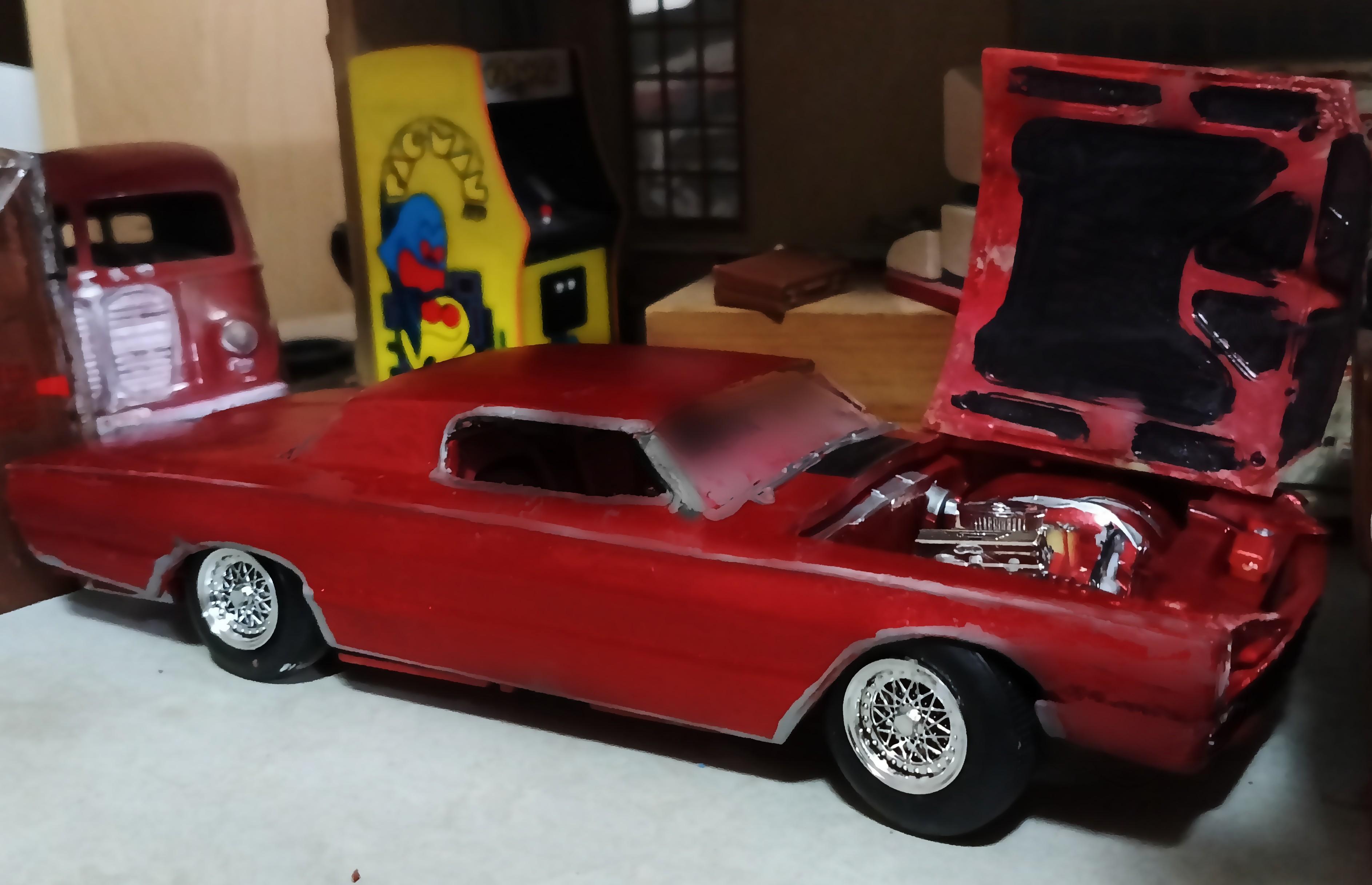

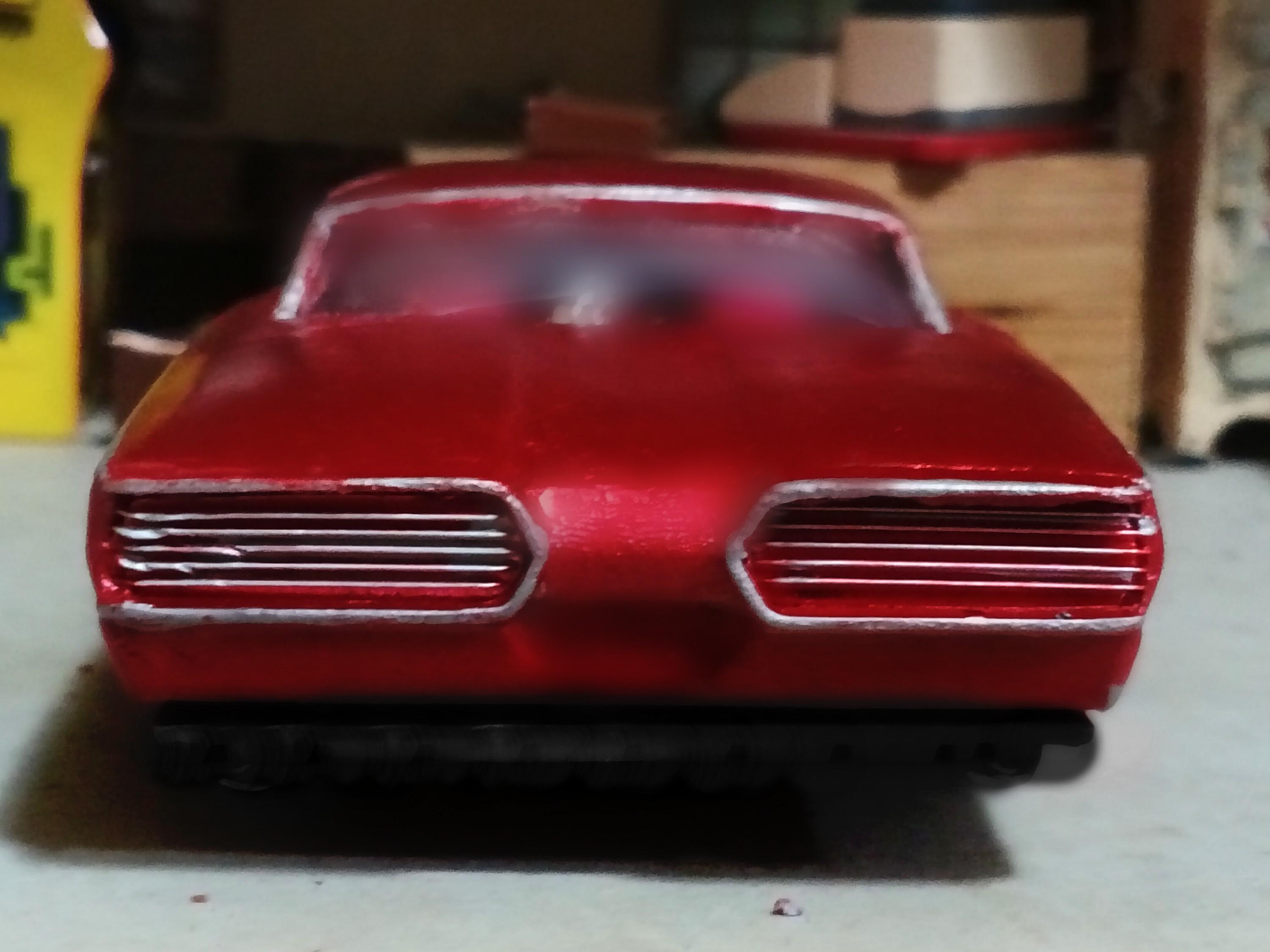

Finished build of AMT's Walmart exclusive Customizing Series '66 Thunderbird as a 70s era full custom with my first effort at a chopped top (it went well enough that I want to attempt a chopped AMT '53 Studebaker also, using kit supplied top/glass this time), the front glass switched for rear with custom rear glass, and almost every part worked over. Paint is Tamiya Color metallic red.

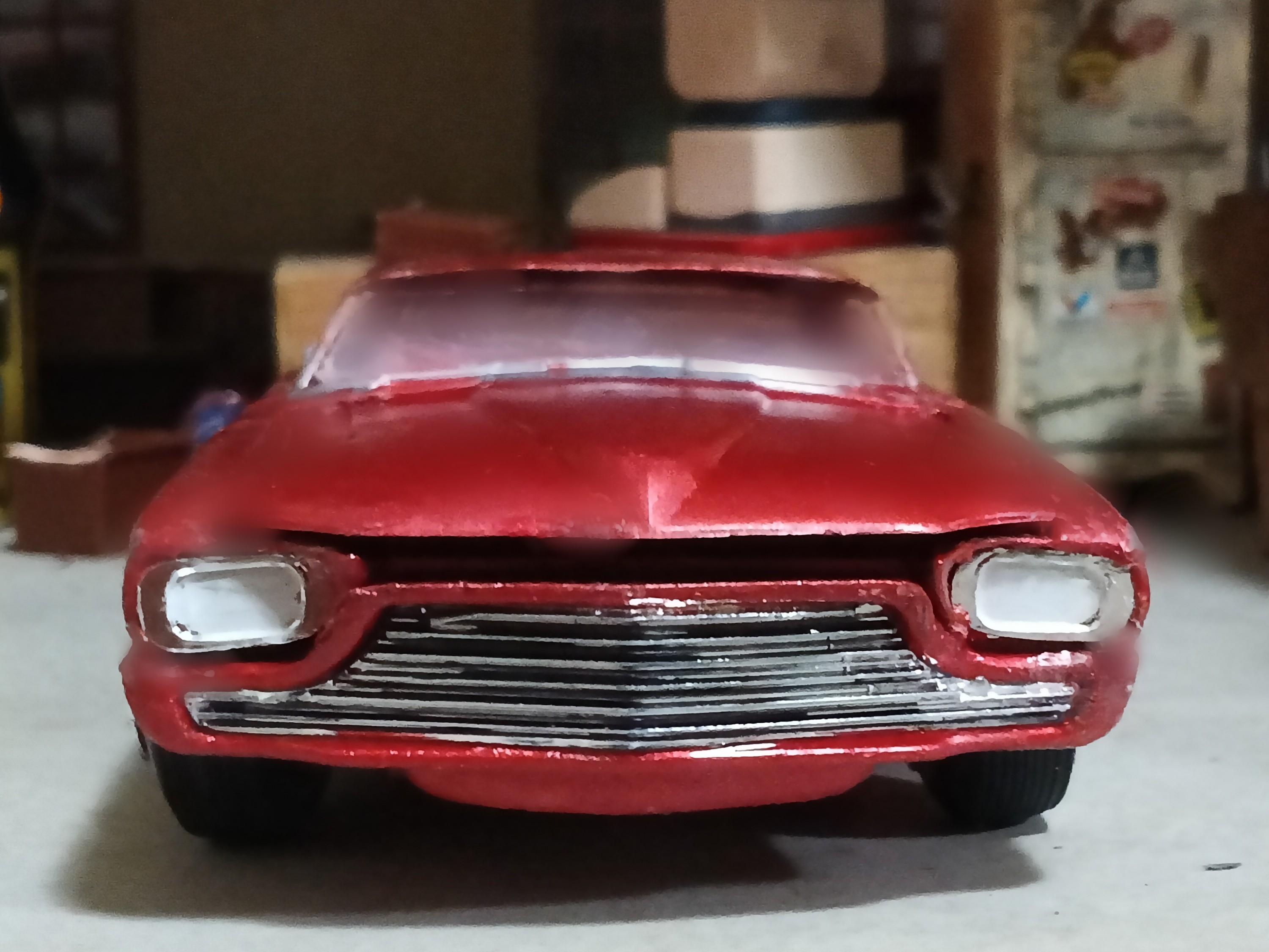

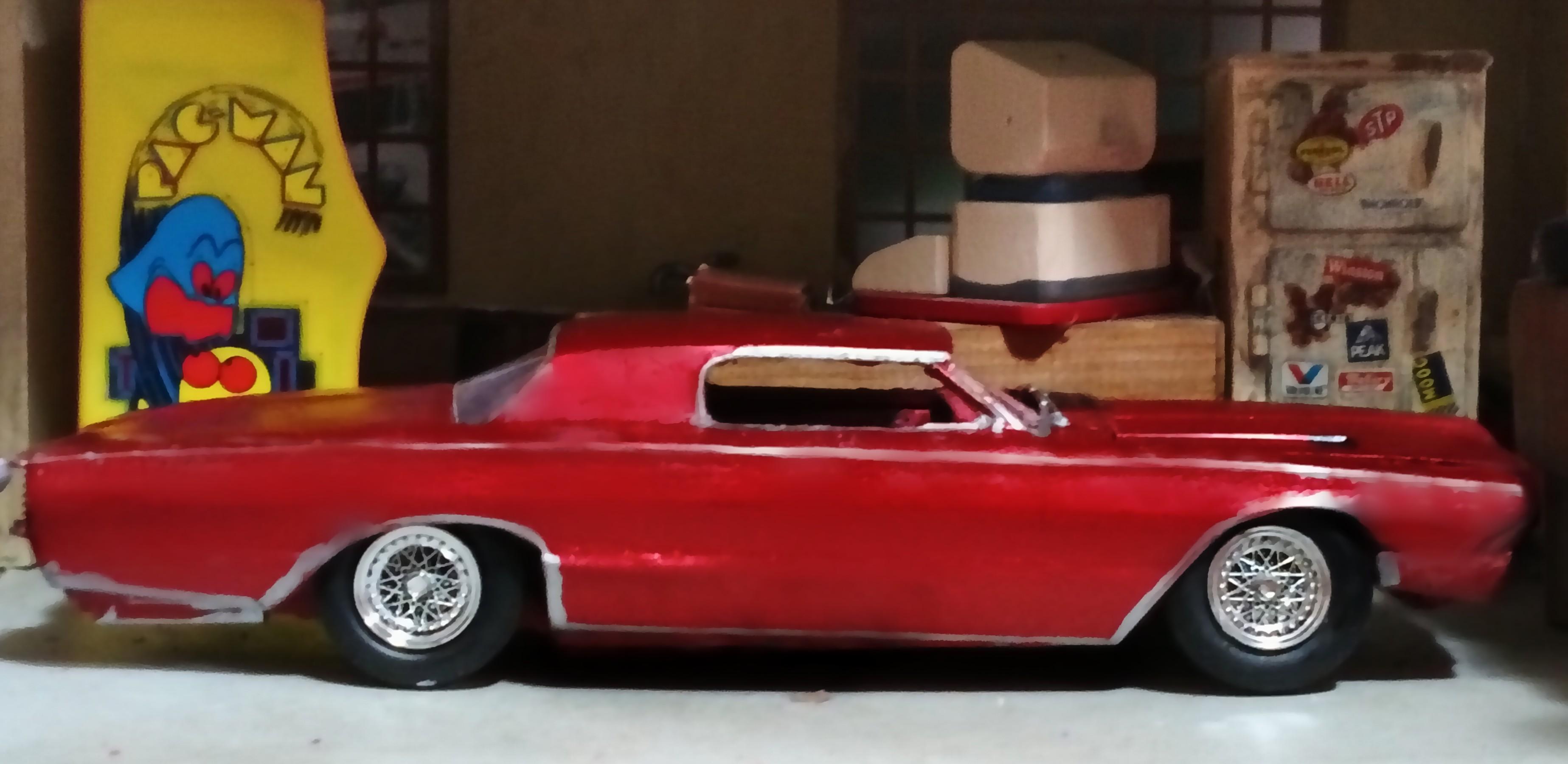

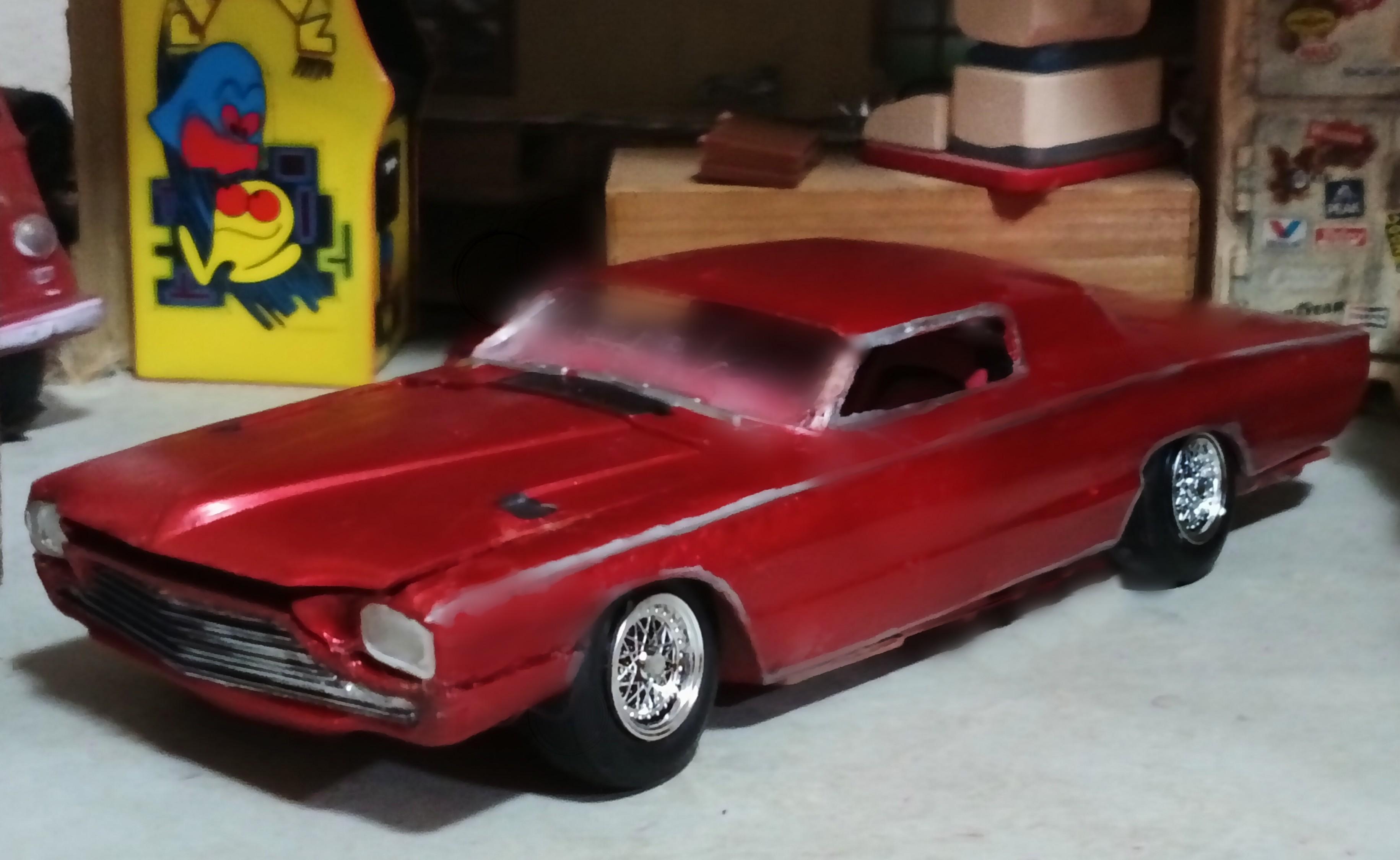

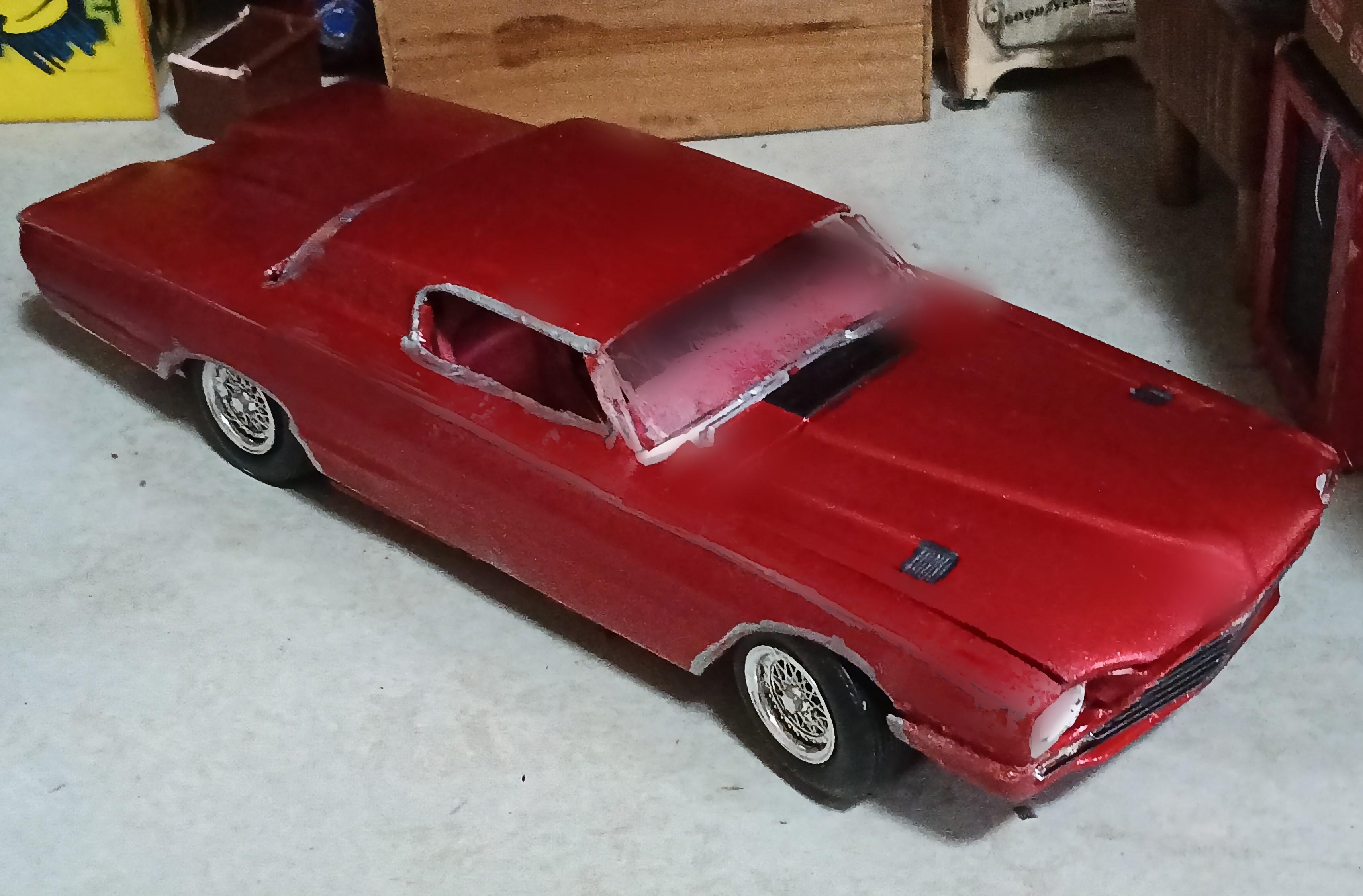

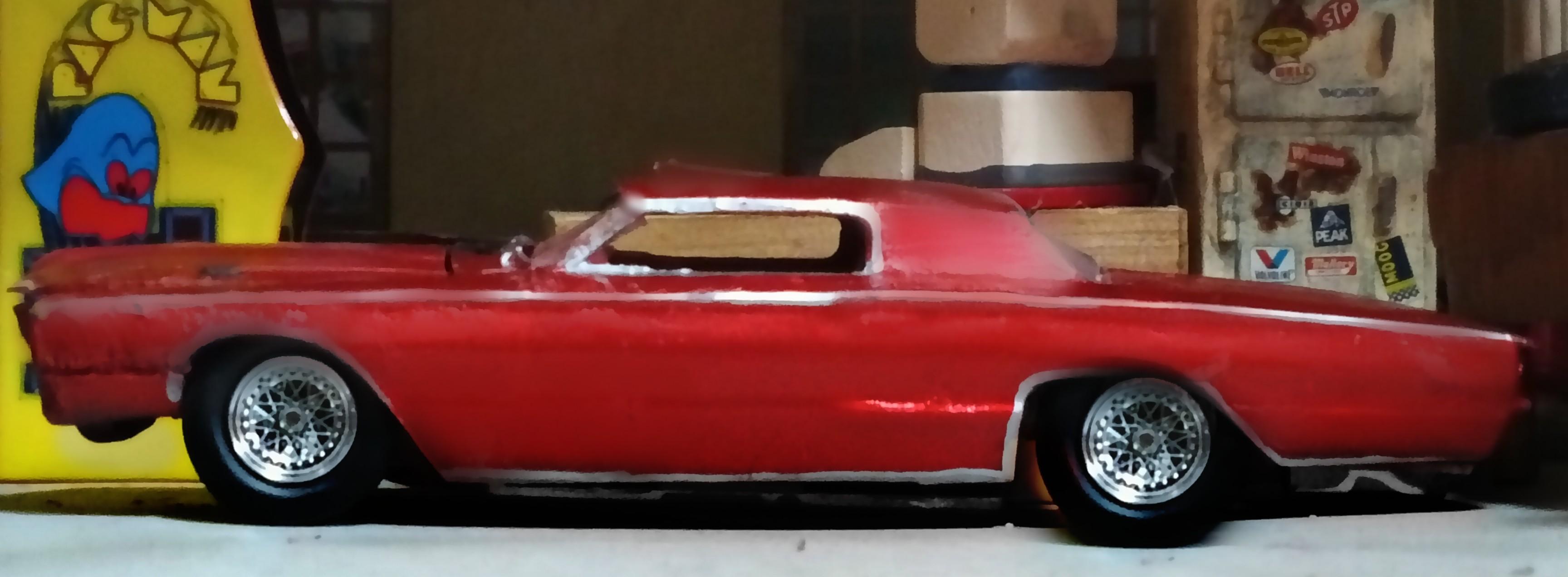

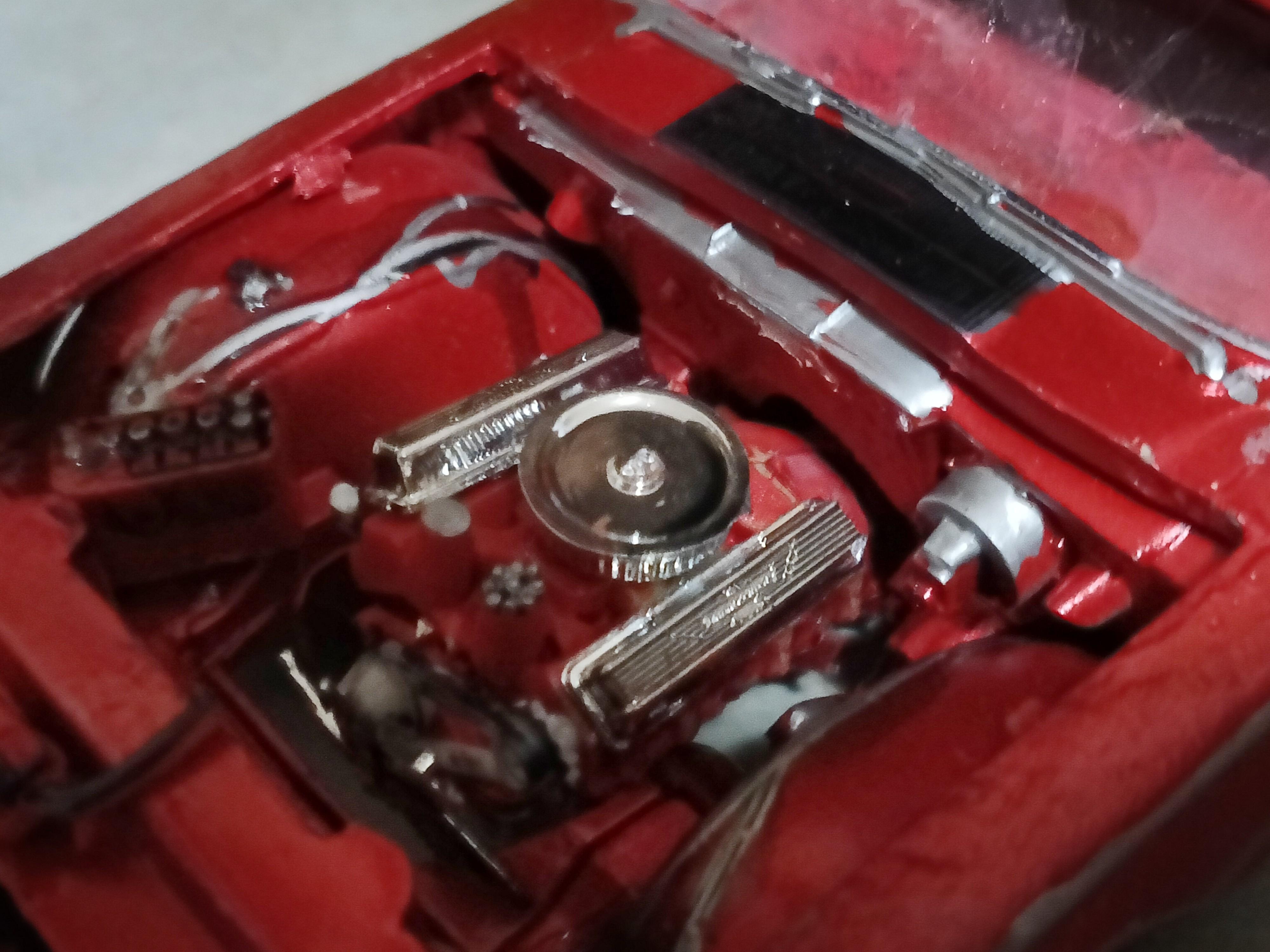

Primered/sealed and mocked up on wheels/tires. A steering shaft and lots of chrome will occupy the underhood area and decorate the 428 big block V8. Since these photos, I sanded it a bit more and laid down a coat of Tamiya metallic red.

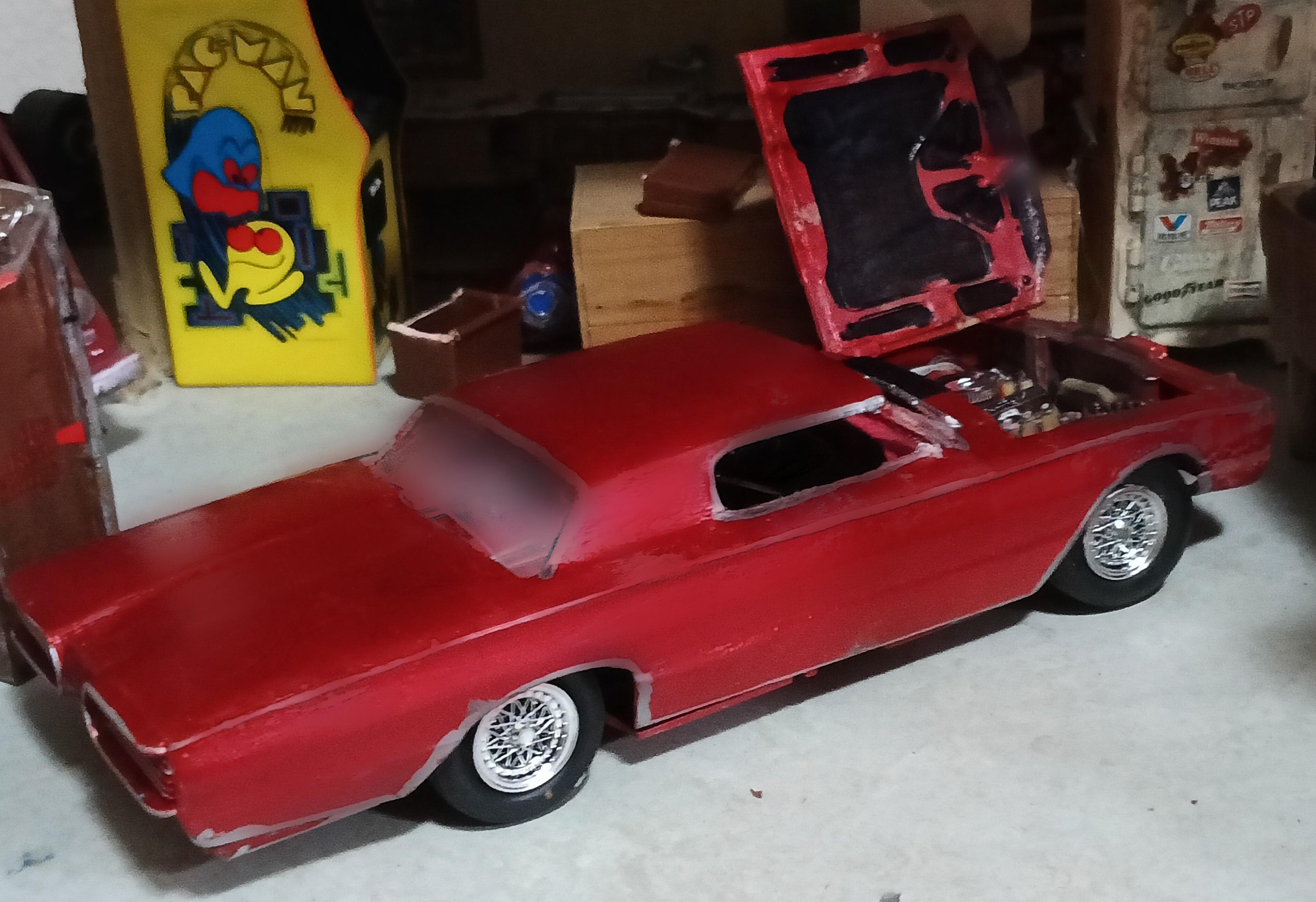

Custom bodywork all molded in. This is a thin, sanded further, coat of Bondo glazing putty, so as to limit/avoid any shrinkage in the future.
Got an idea to do this with a Walmart exclusive kit after seeing this article on Lee Pratt’s 60s Buick LeSabre and remembering similar builds by the likes of Gene Winfield, Ray Fahrner, Dave Puhl, Richard Korkes, and the Alexander Brothers in old books/magazines. The scale 6 inch top chop was surprisingly easy to pull off, and the kit supplied custom nose/tail treatments were used. The wind wings are since deleted, with the A-pillars & rear buttresses filled in with a small batch of "sprue goo" I made to use up some old school AMT sprue and get the most out of a couple almost empty tubes of Testors glue.

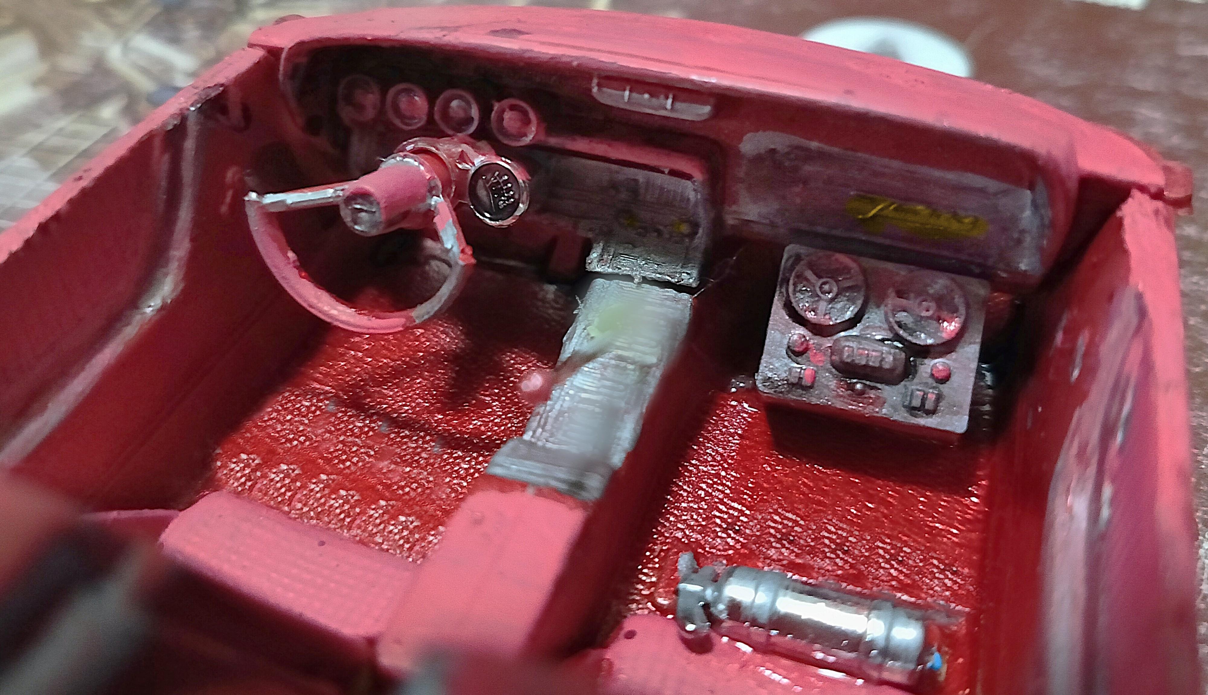

thank you! I hadn't installed the wheel/column in that shot yet. -
