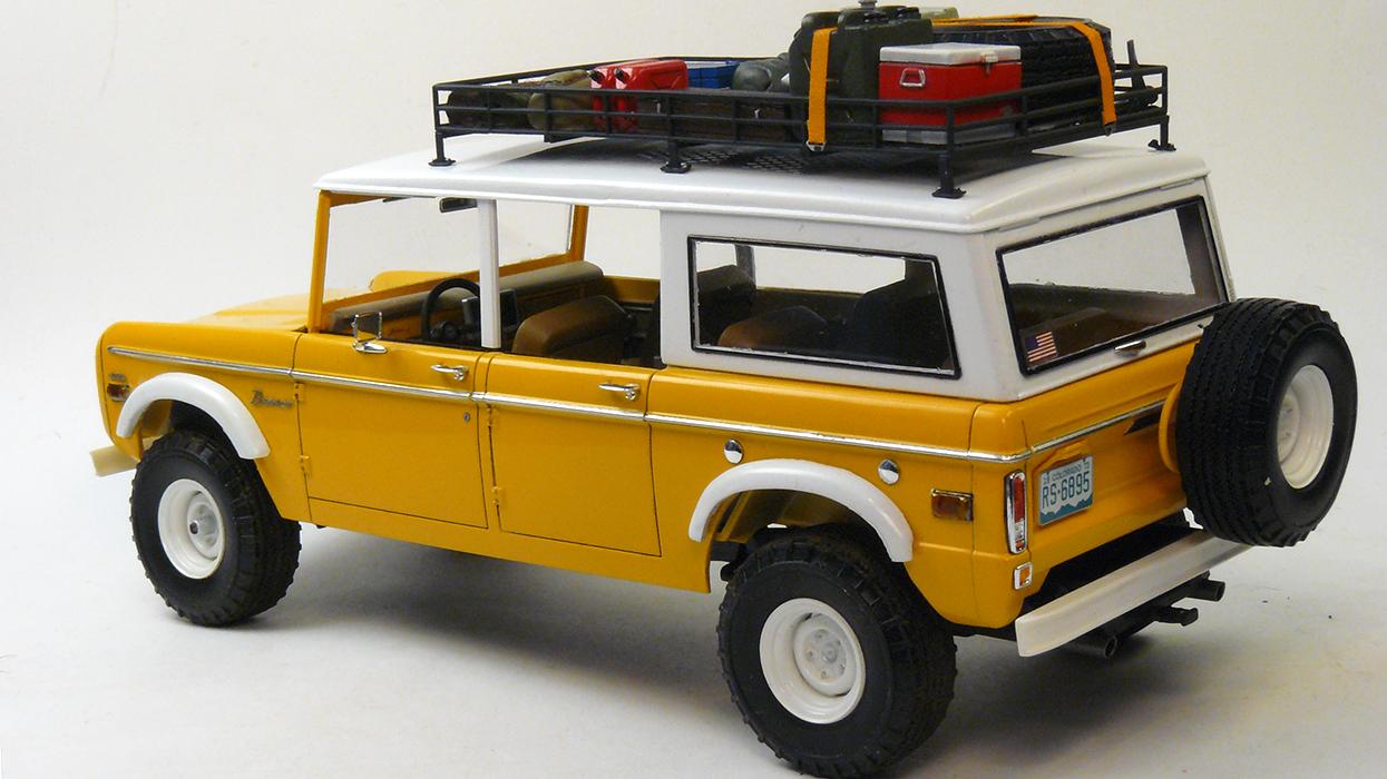

I threw away the multi piece body shell. Then raided the parts bin, and added parts that seemed to fit for the theme. Fun quick build.
Body lengthened using second body, that some Baja versions came with. Used some parts from another kit too, like exhaust and doors panels. Scratchbuild roof rack and added some stowage.

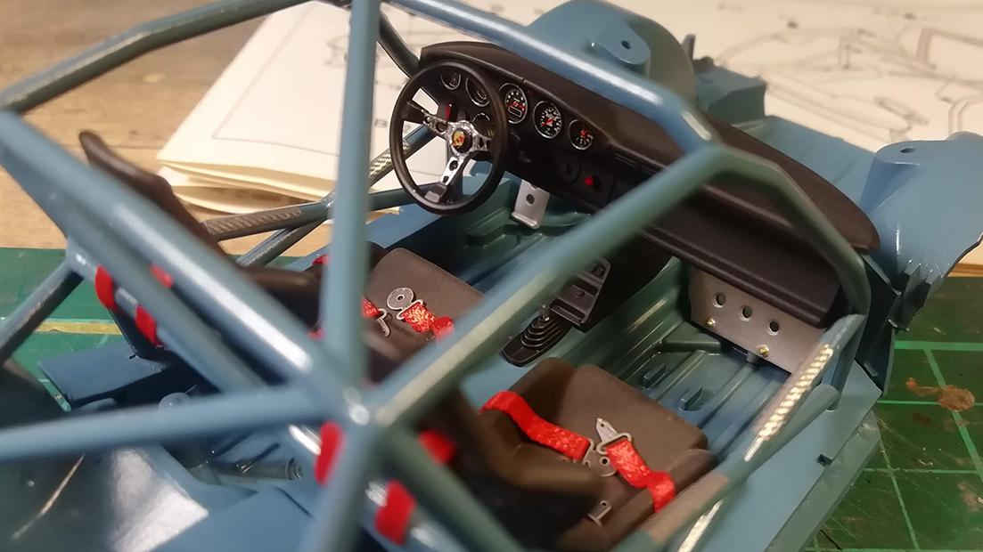

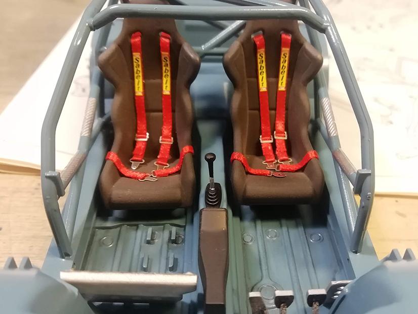

Modifications: Resin seats Added seatbelts Widened wheel arches Rims: Pegasus barrels + Opel Astra DTM spokes Smoothed rear panel + various holes for racing version Added gear shifter + 3d printed hydraulic brake

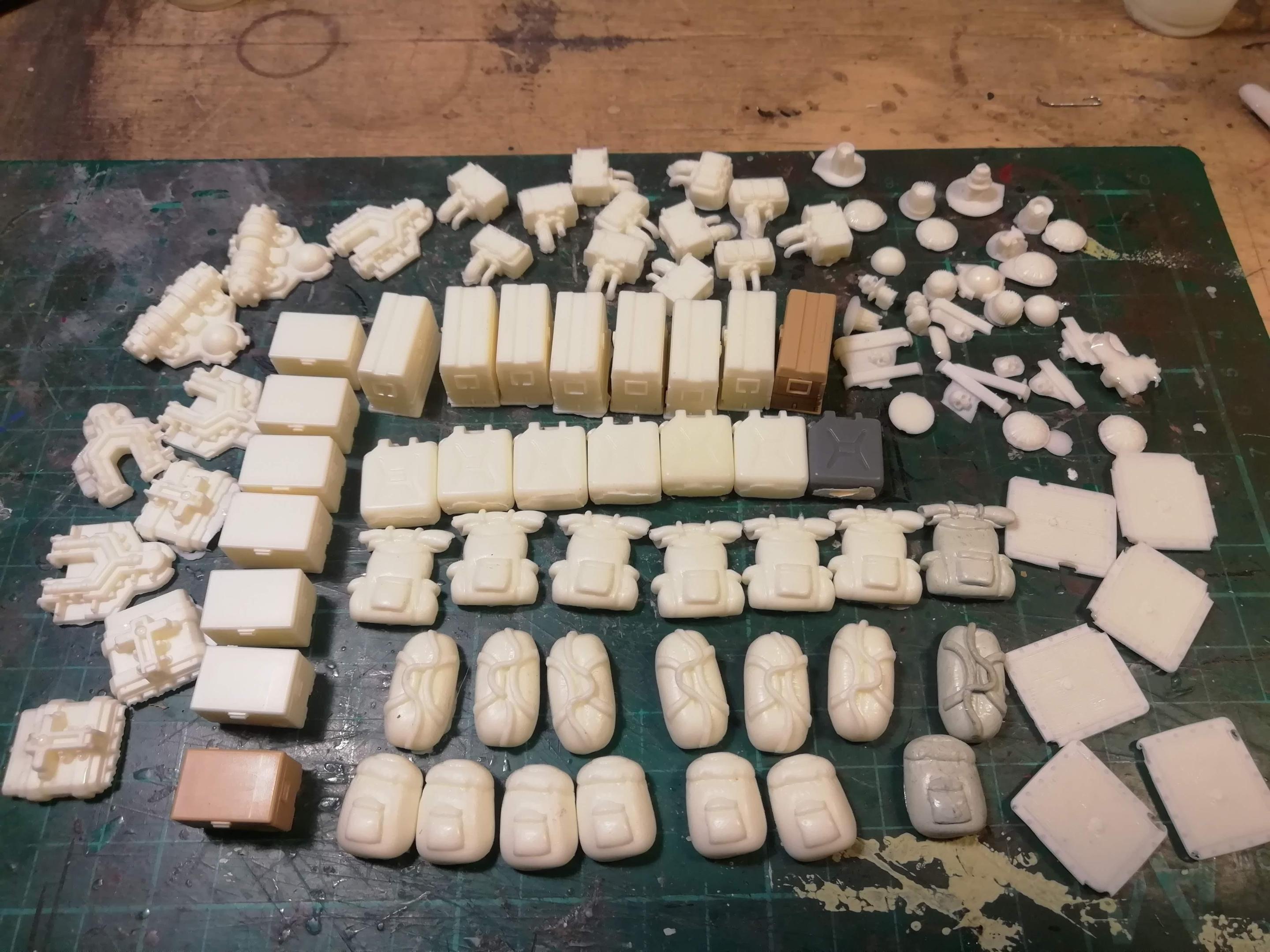

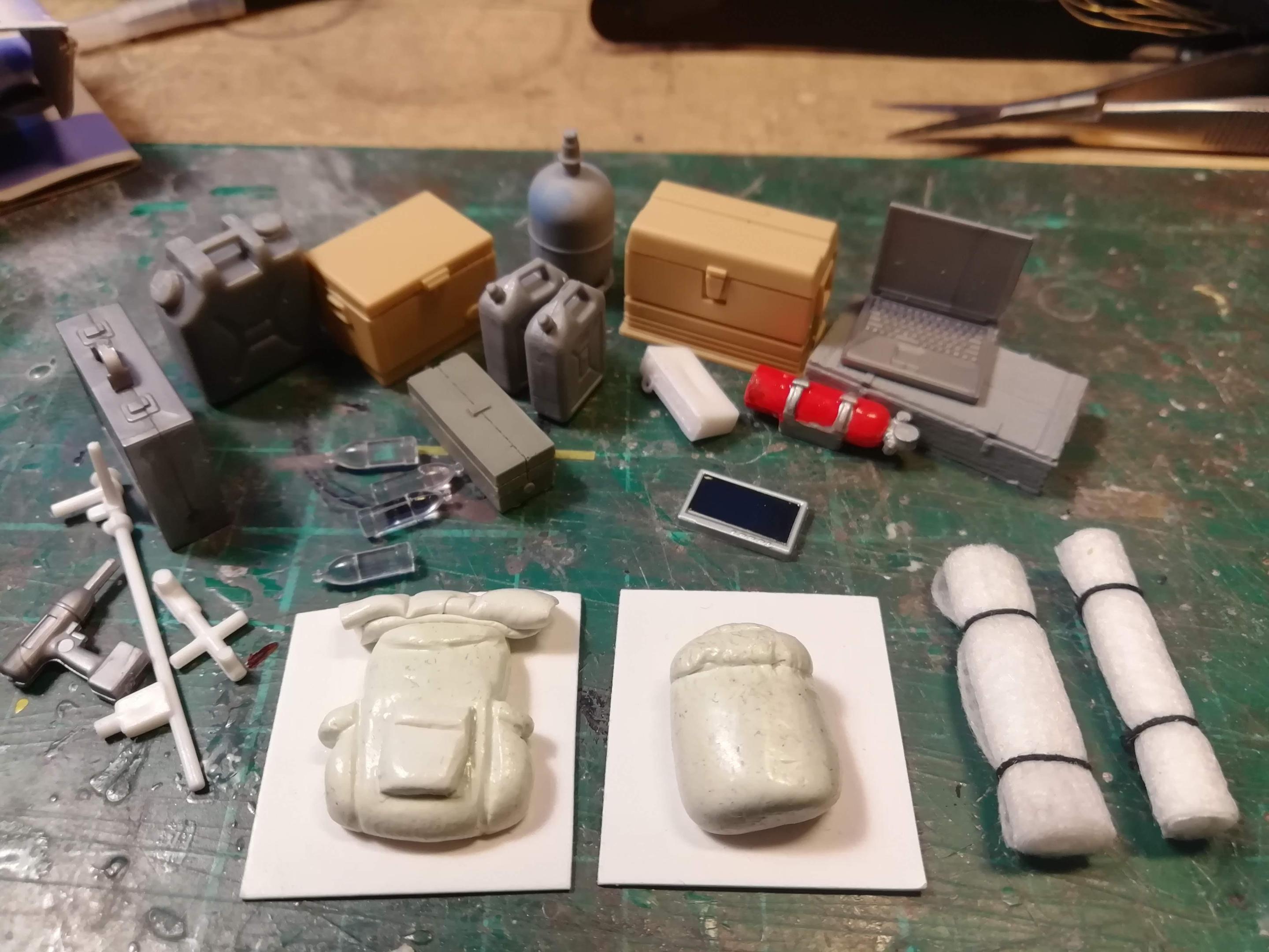

Well, got some casting done. Did some spare stowage for the future projects. Always have old molds, where to dumb extra resin. I'll give some of the greeblies to my friend, who likes to build weird stuff. -

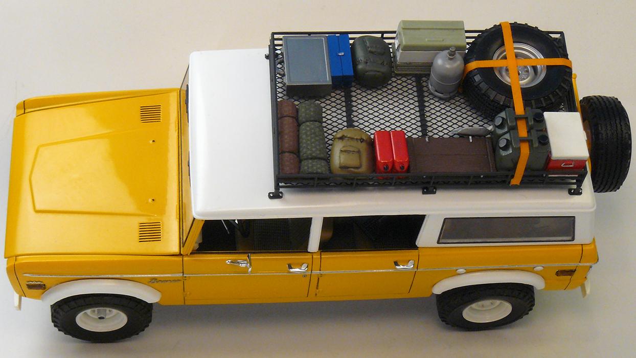

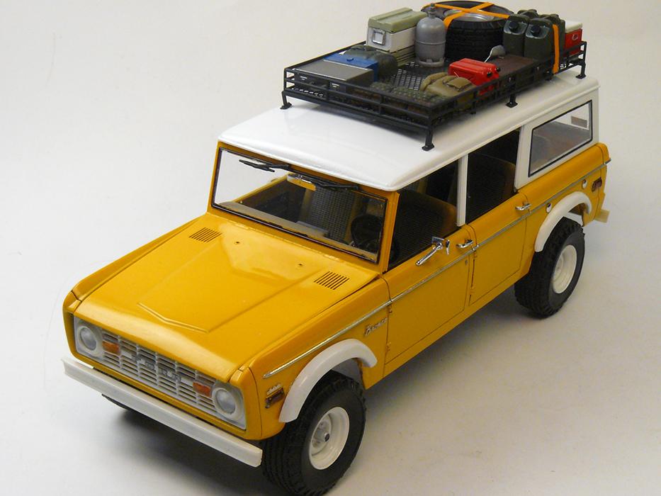

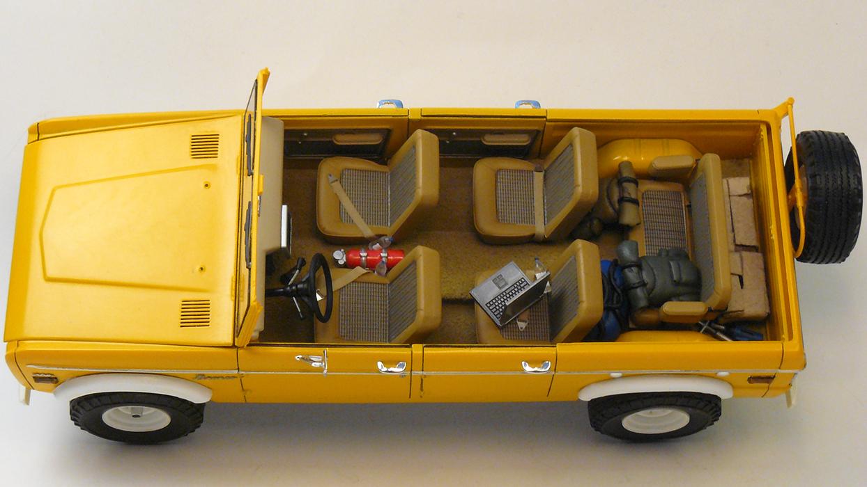

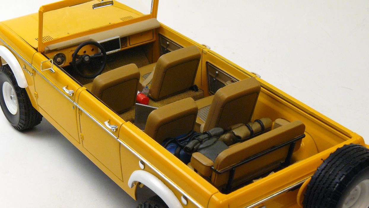

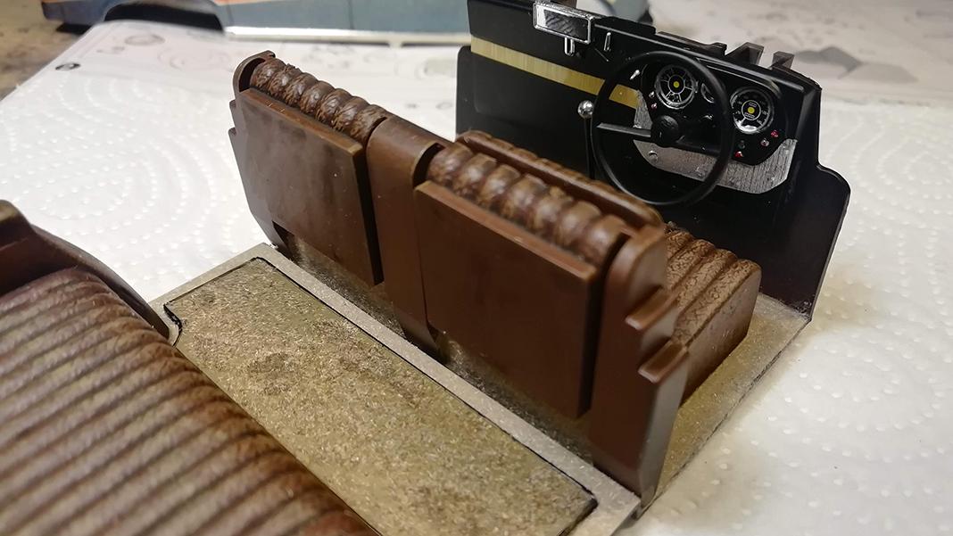

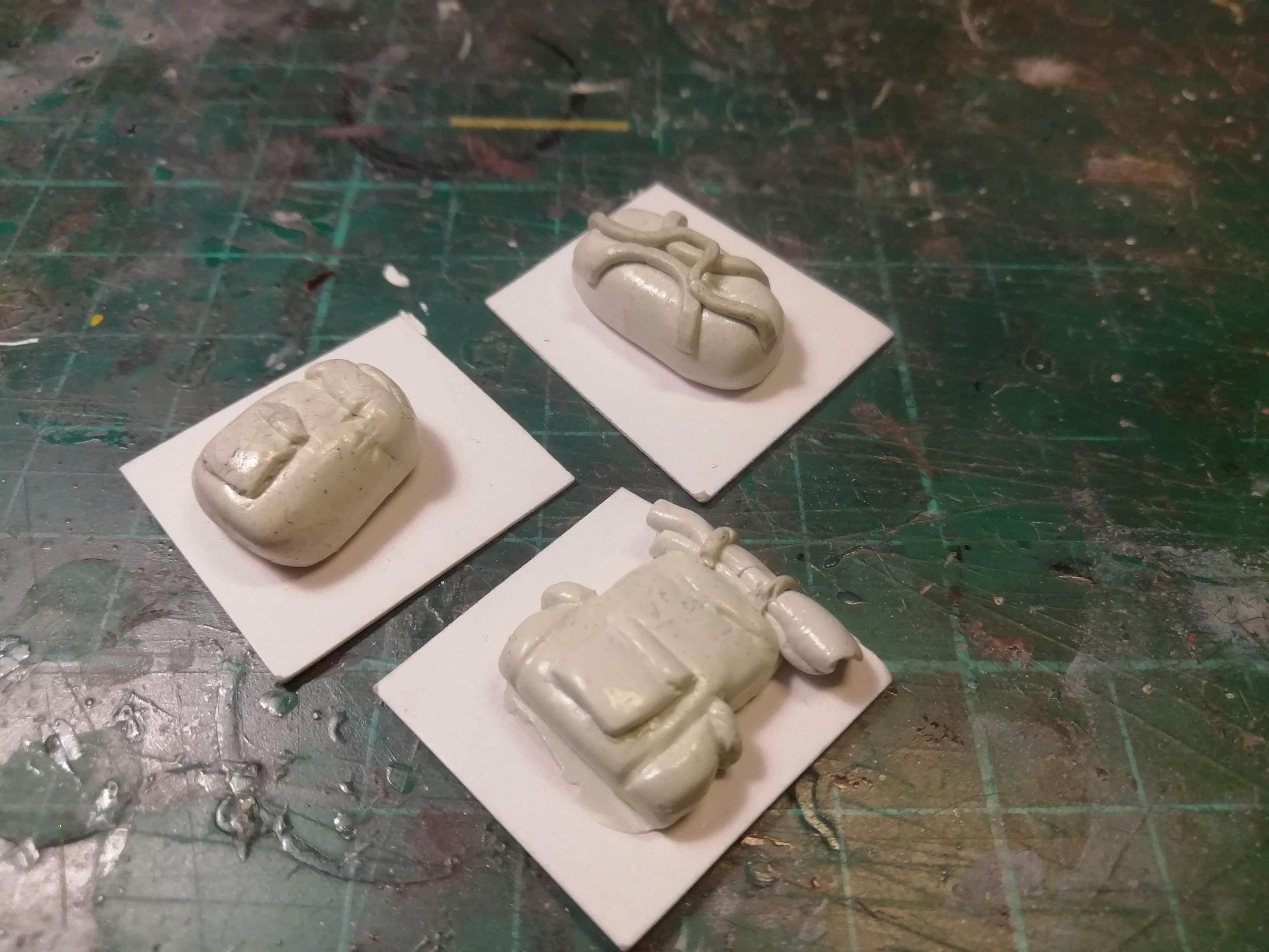

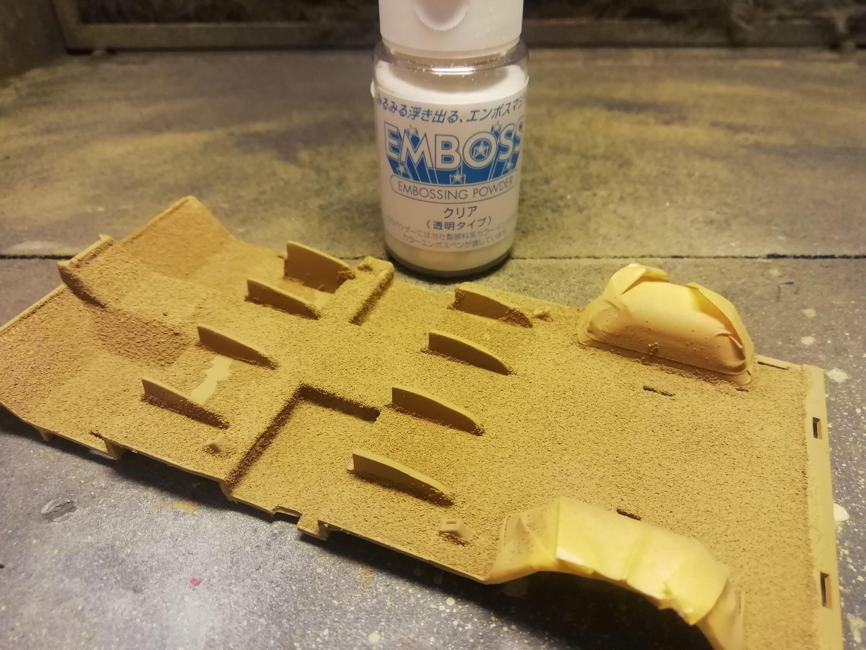

Some progress done here. Made interior carpet using embossing powder. I added two layers of it, and then painted it with Tamiya dark yellow. Collected some stowage for the roof rack and for interior. Some are 1/35 Miniart and Meng stuff. Other from various other kits. Made couple of bags from Tamiya putty. I will make resin copies for the future. -

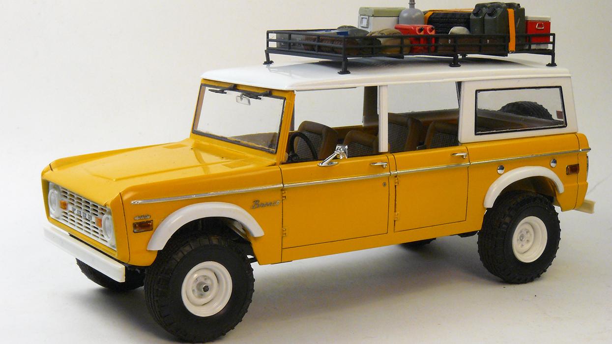

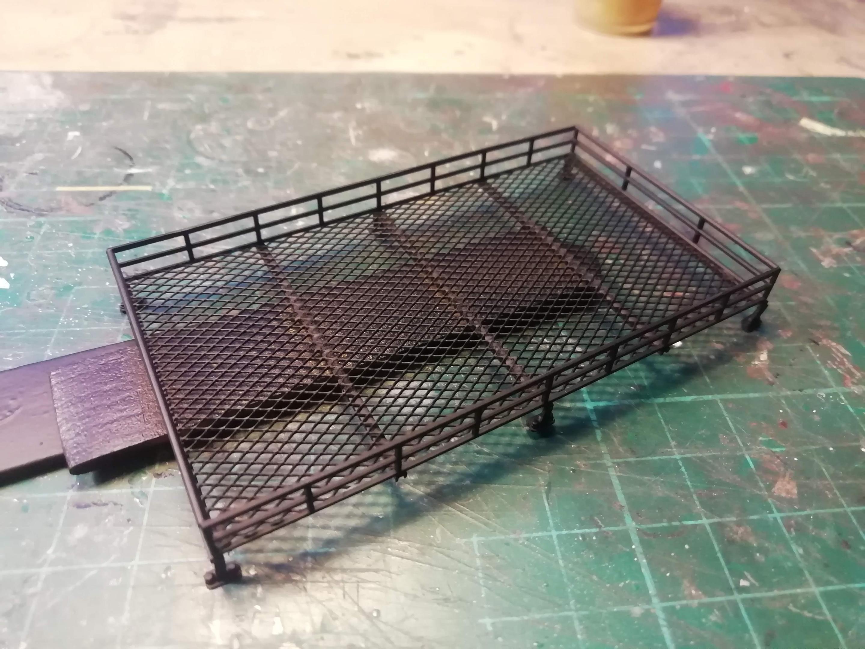

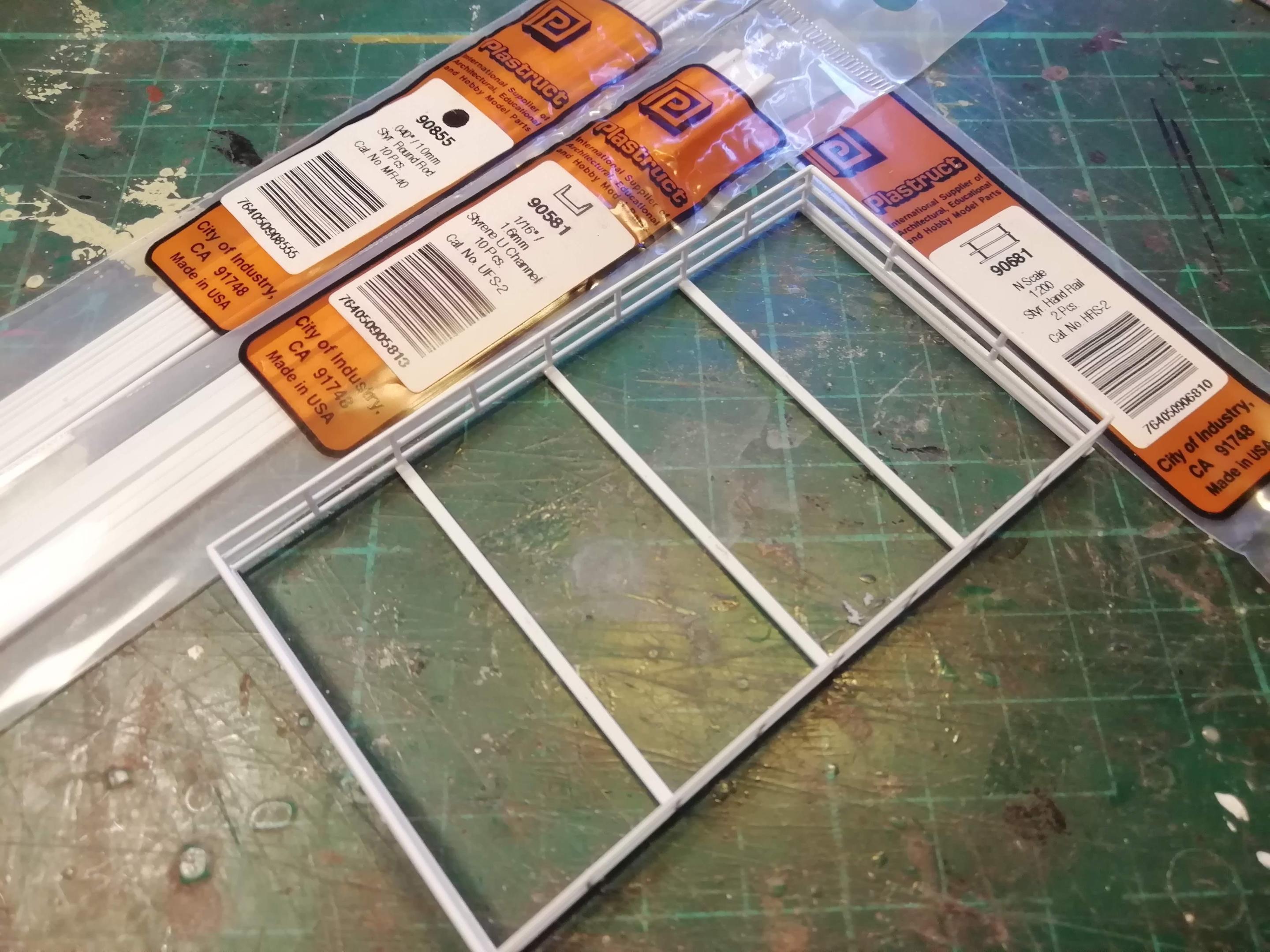

I made roofrack out of Plastruct profiles. The 1:200 rails were perfect for the sides. Then I just made the ends with 1mm round stock. -

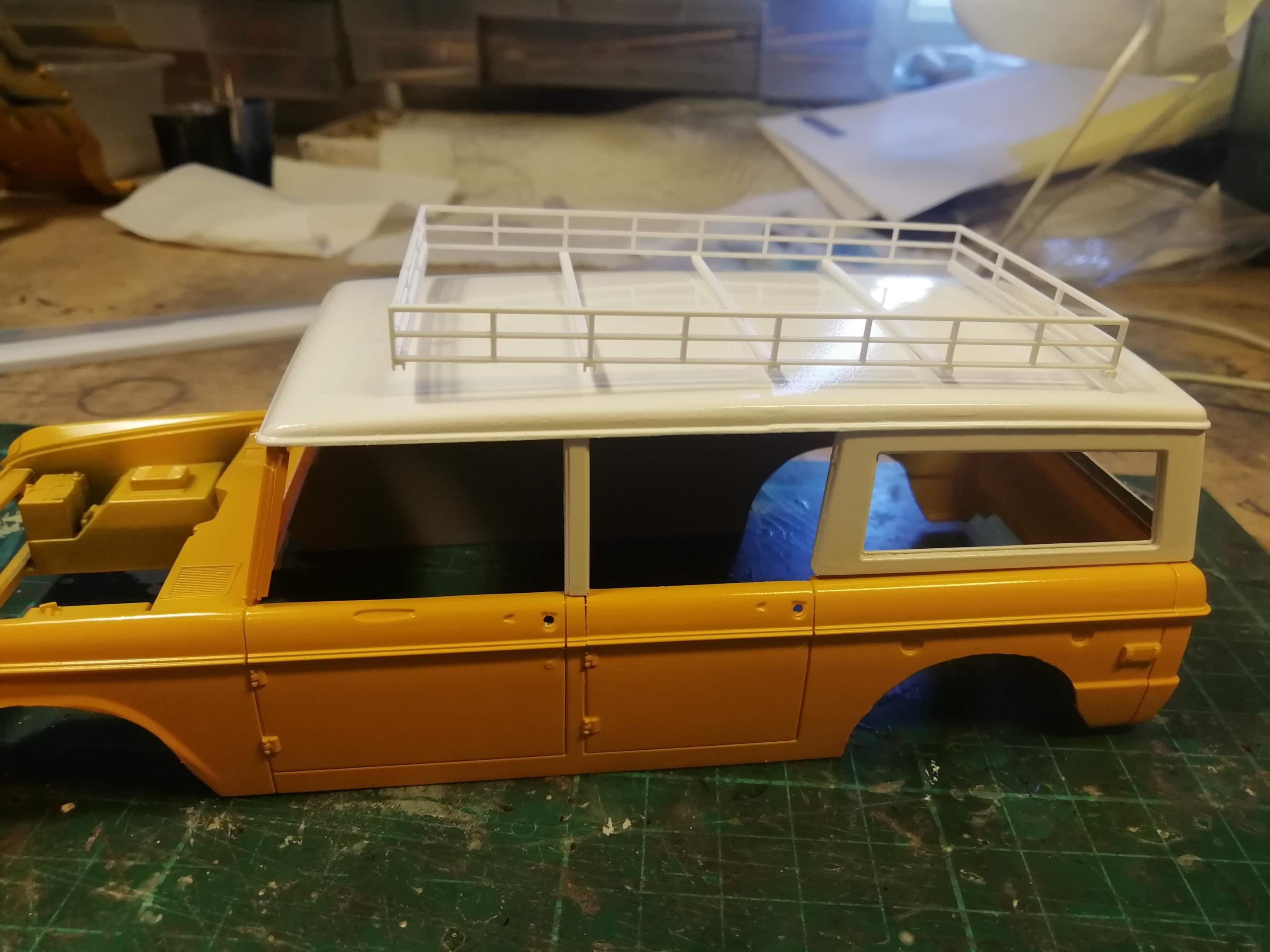

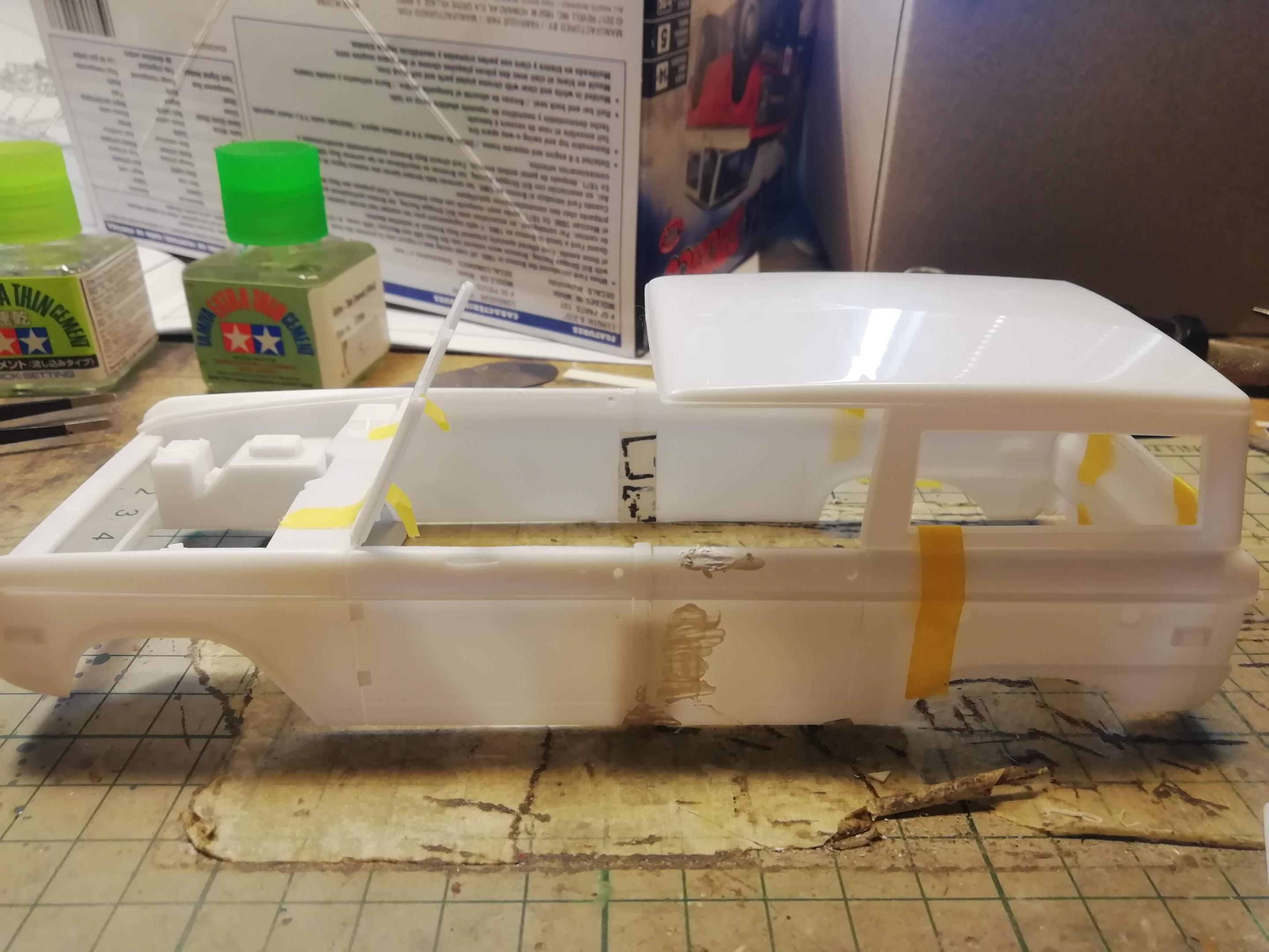

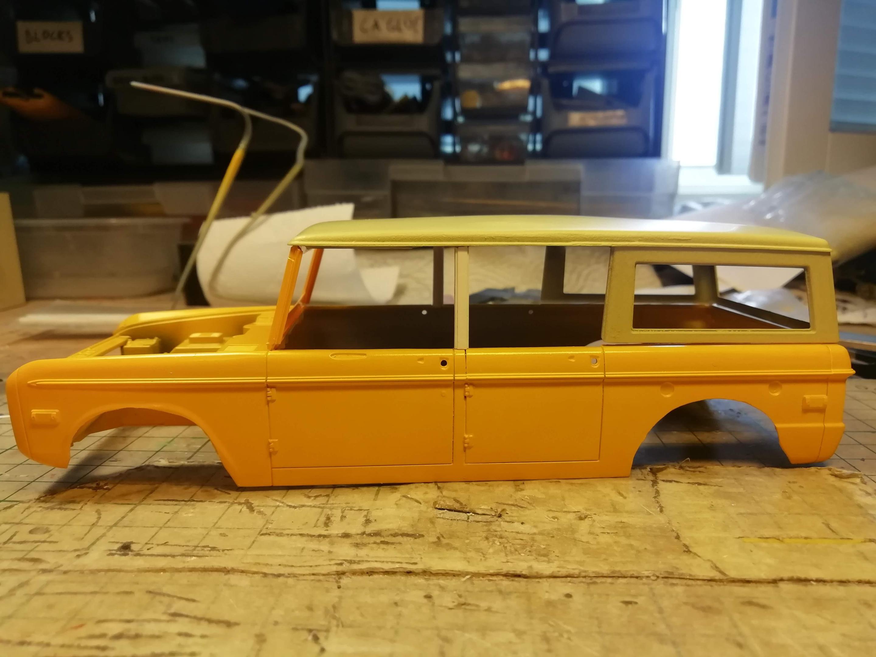

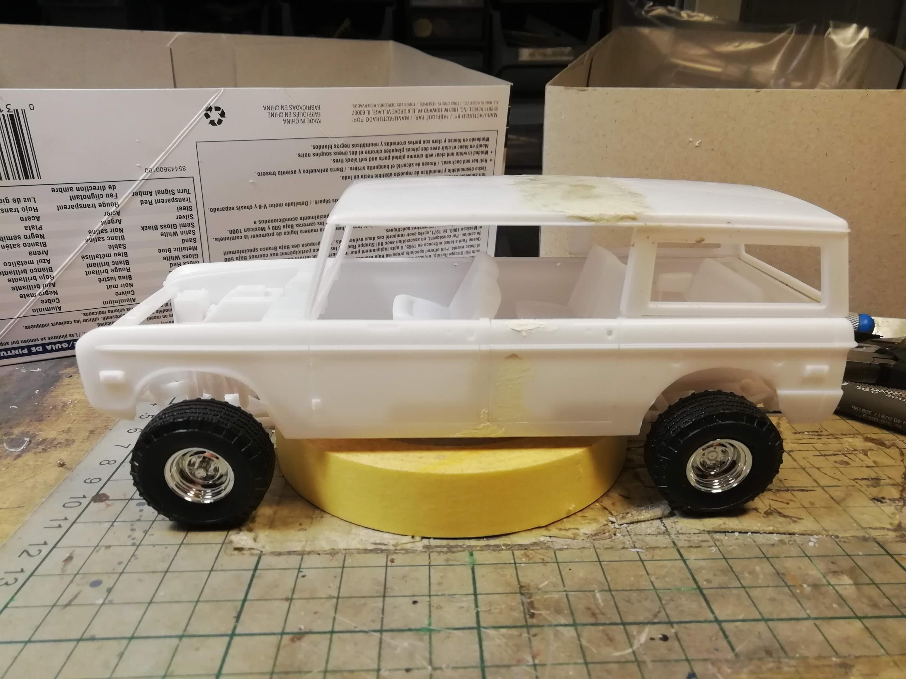

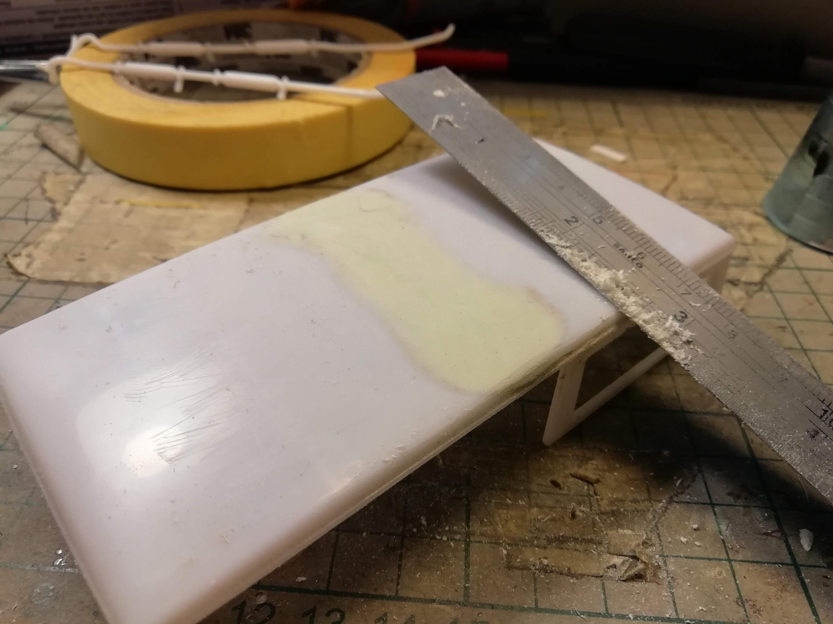

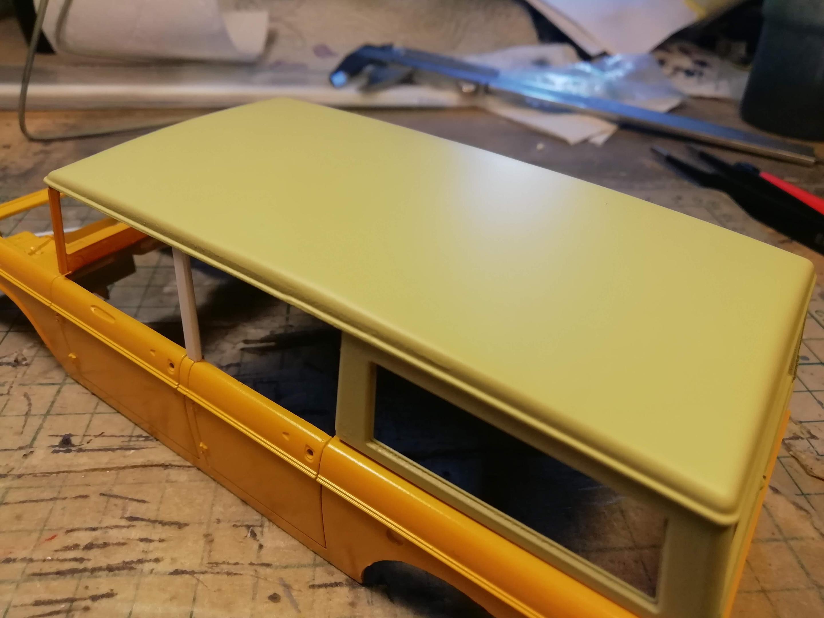

Finally got the roof ready for paint. It took several coats of filler and filler primer to get it smooth. Wasn't easy to get it "straight" as it is roundish in 2 ways. Roof will be white. Body is TS-34 Camel Yellow. -

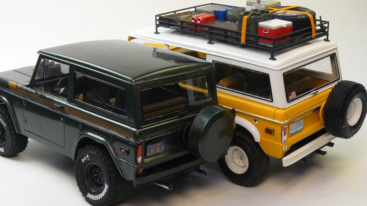

I agree with the roof. It isn't so bad irl. Its stock height in the picture, but I cut 1mm from windshield frame. -

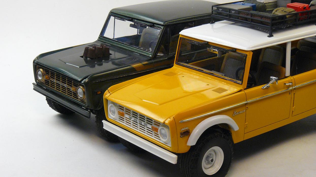

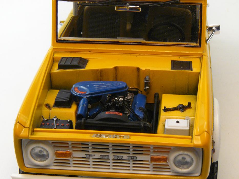

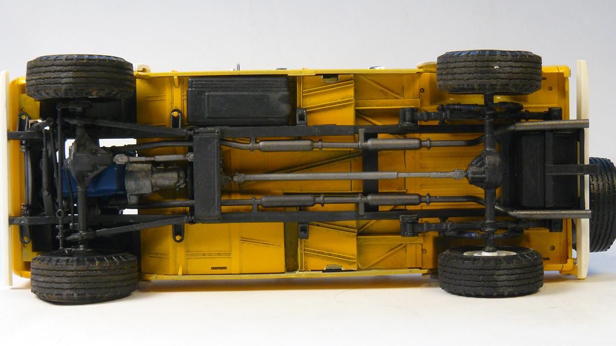

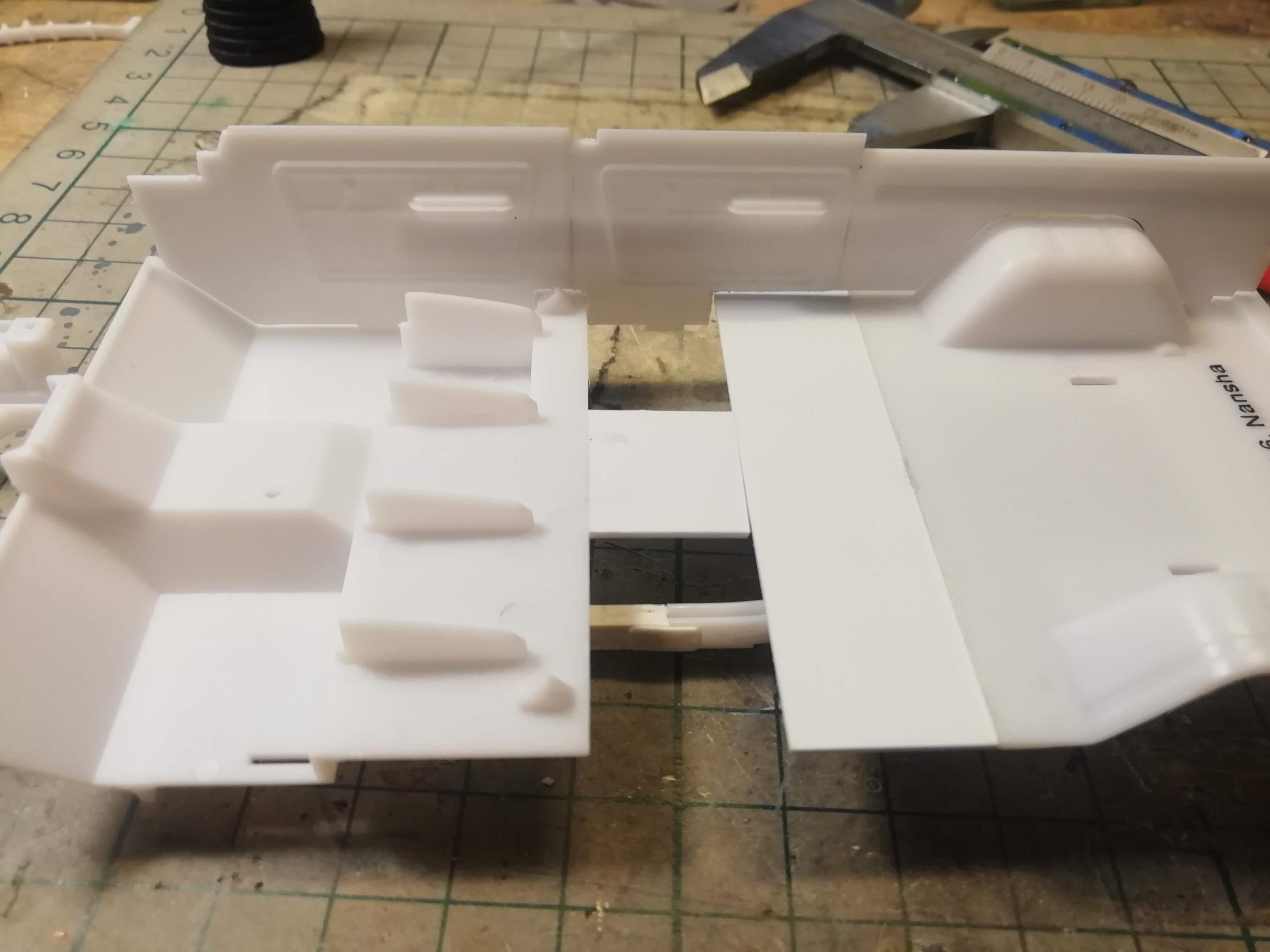

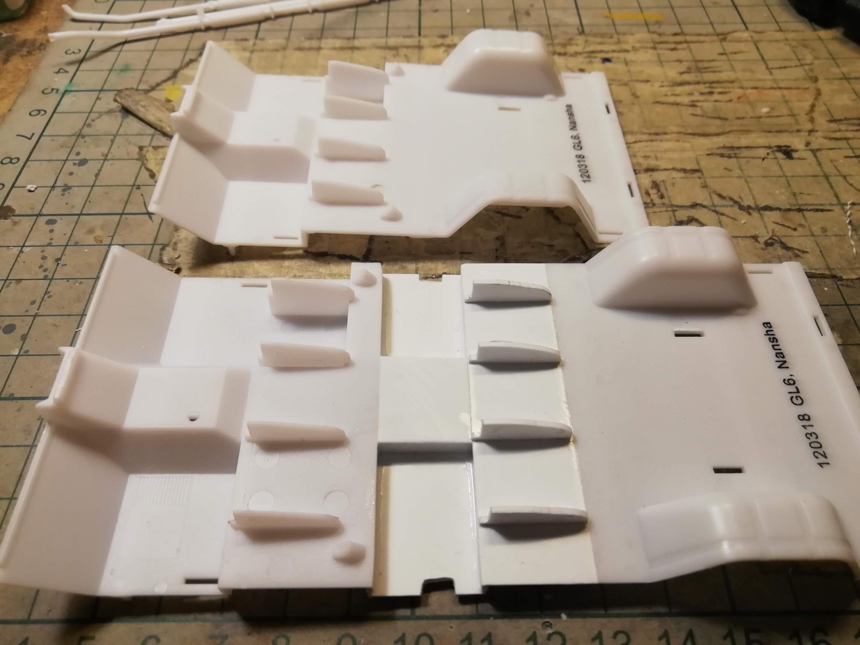

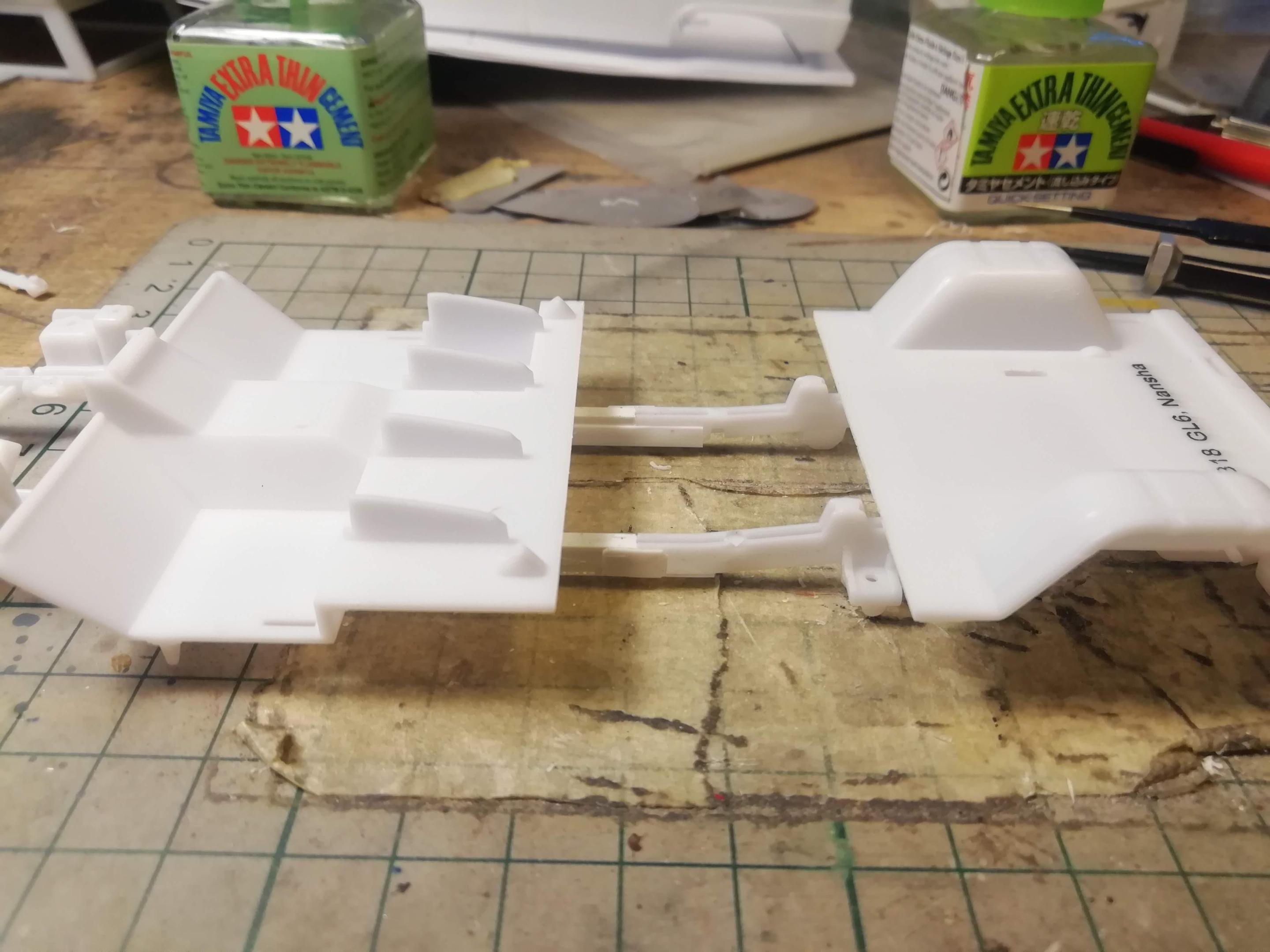

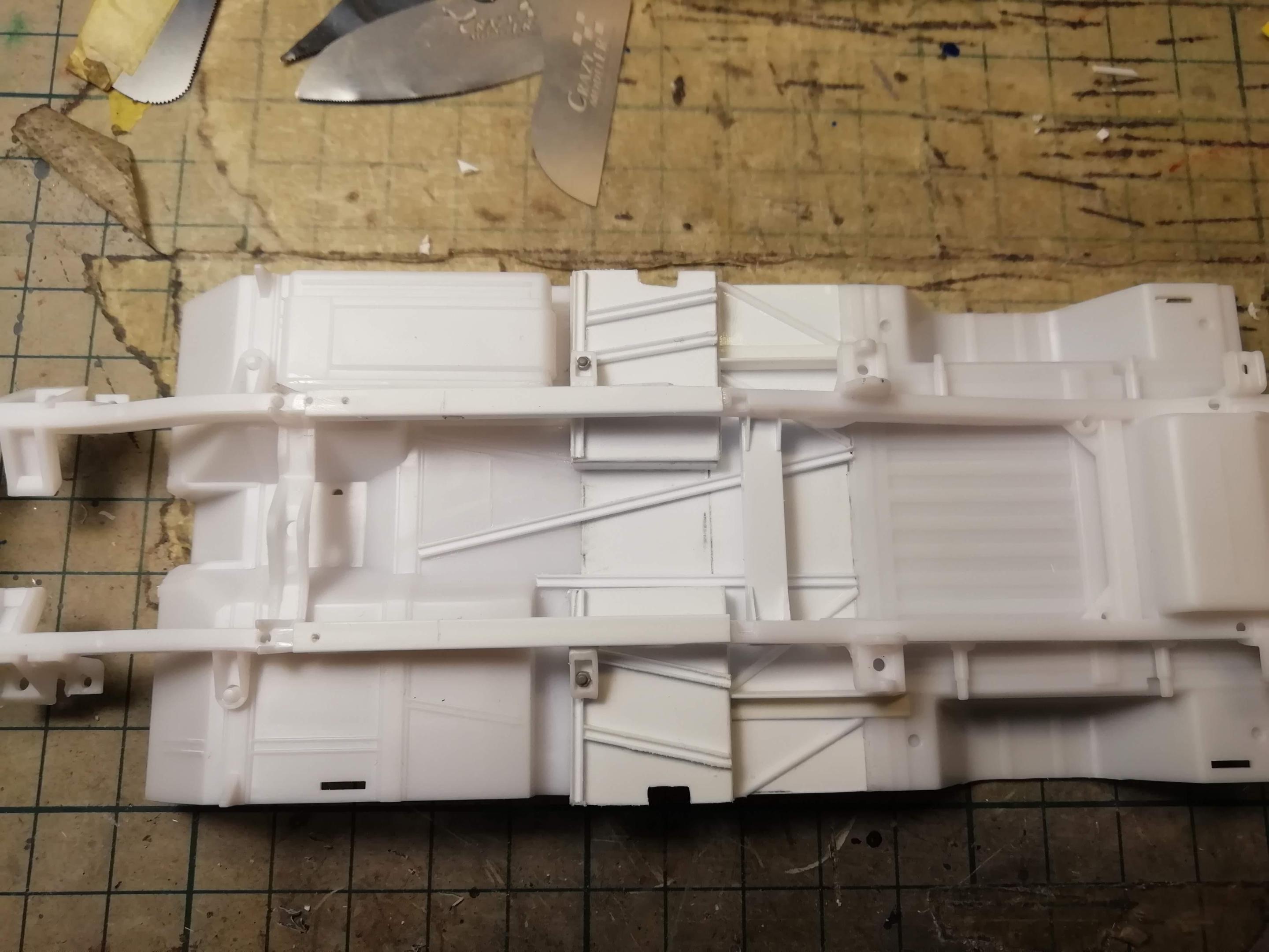

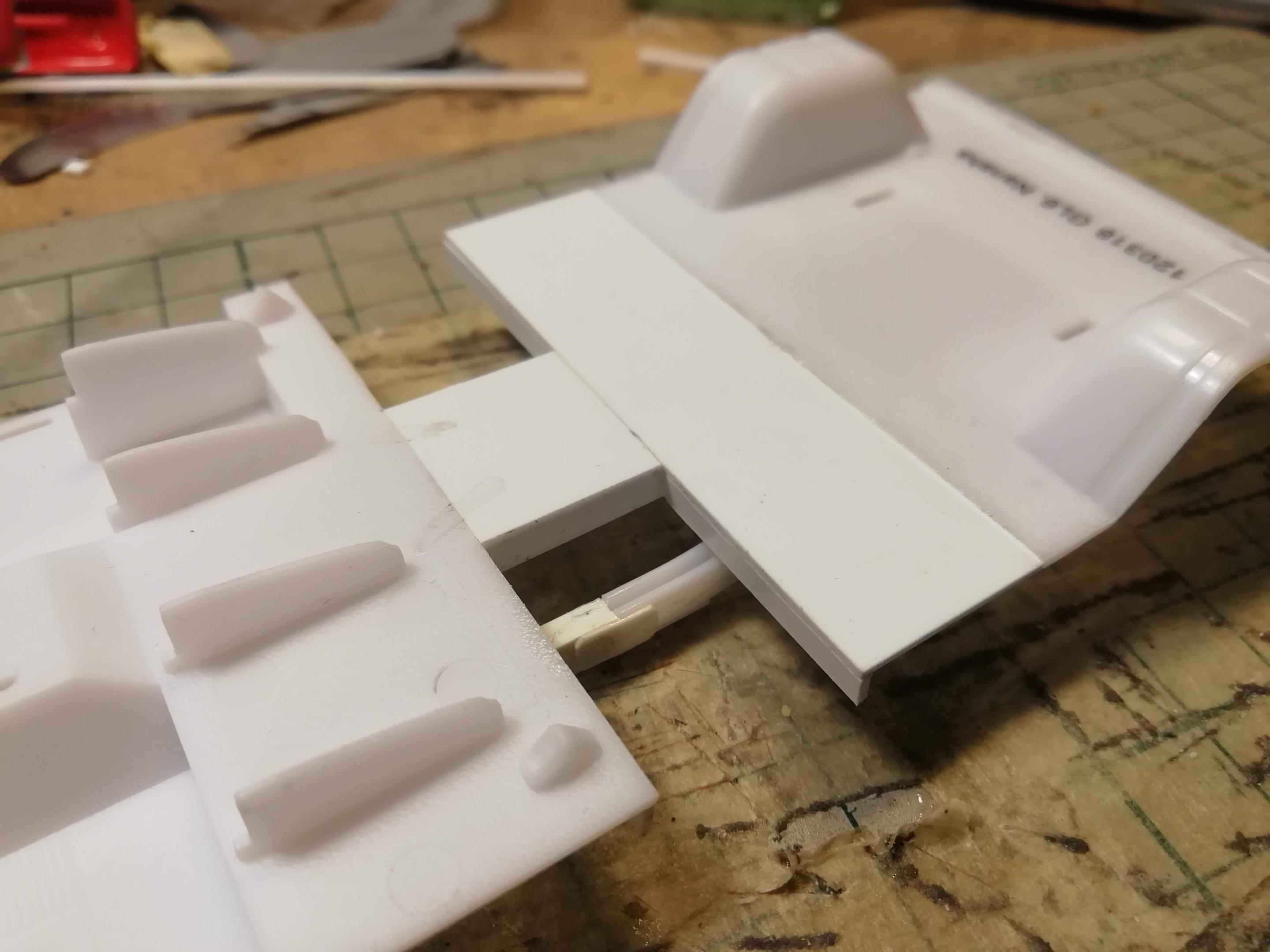

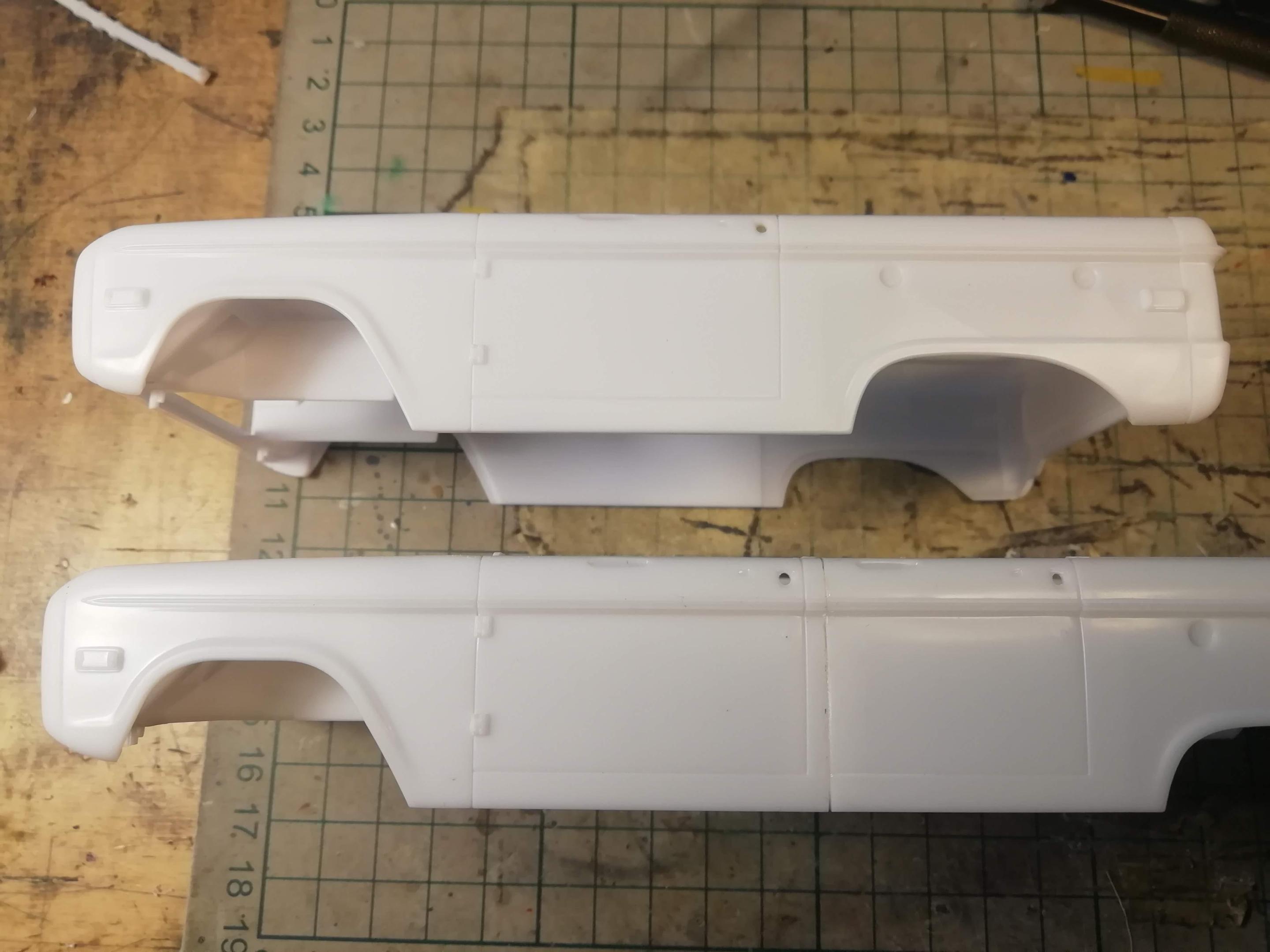

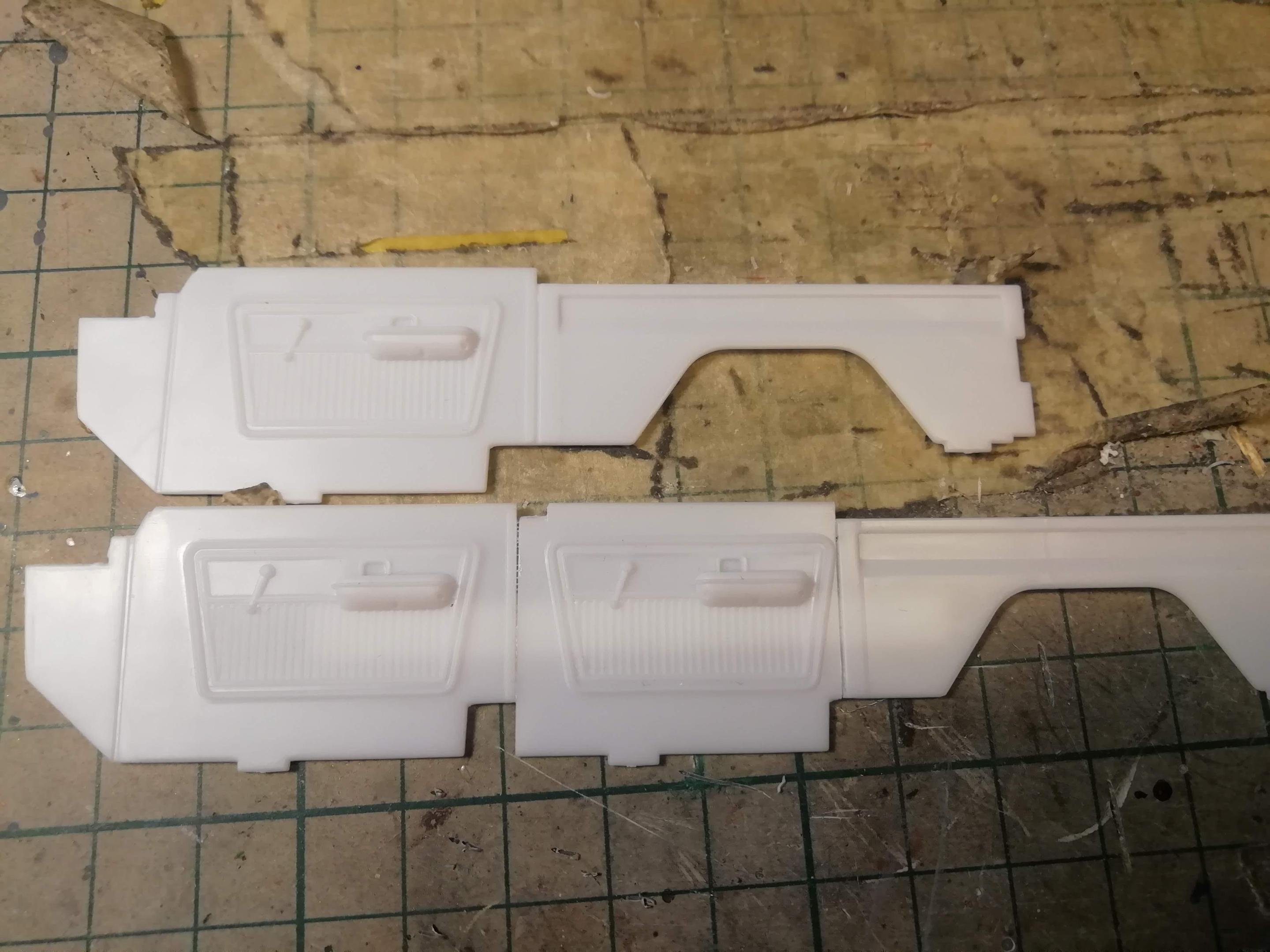

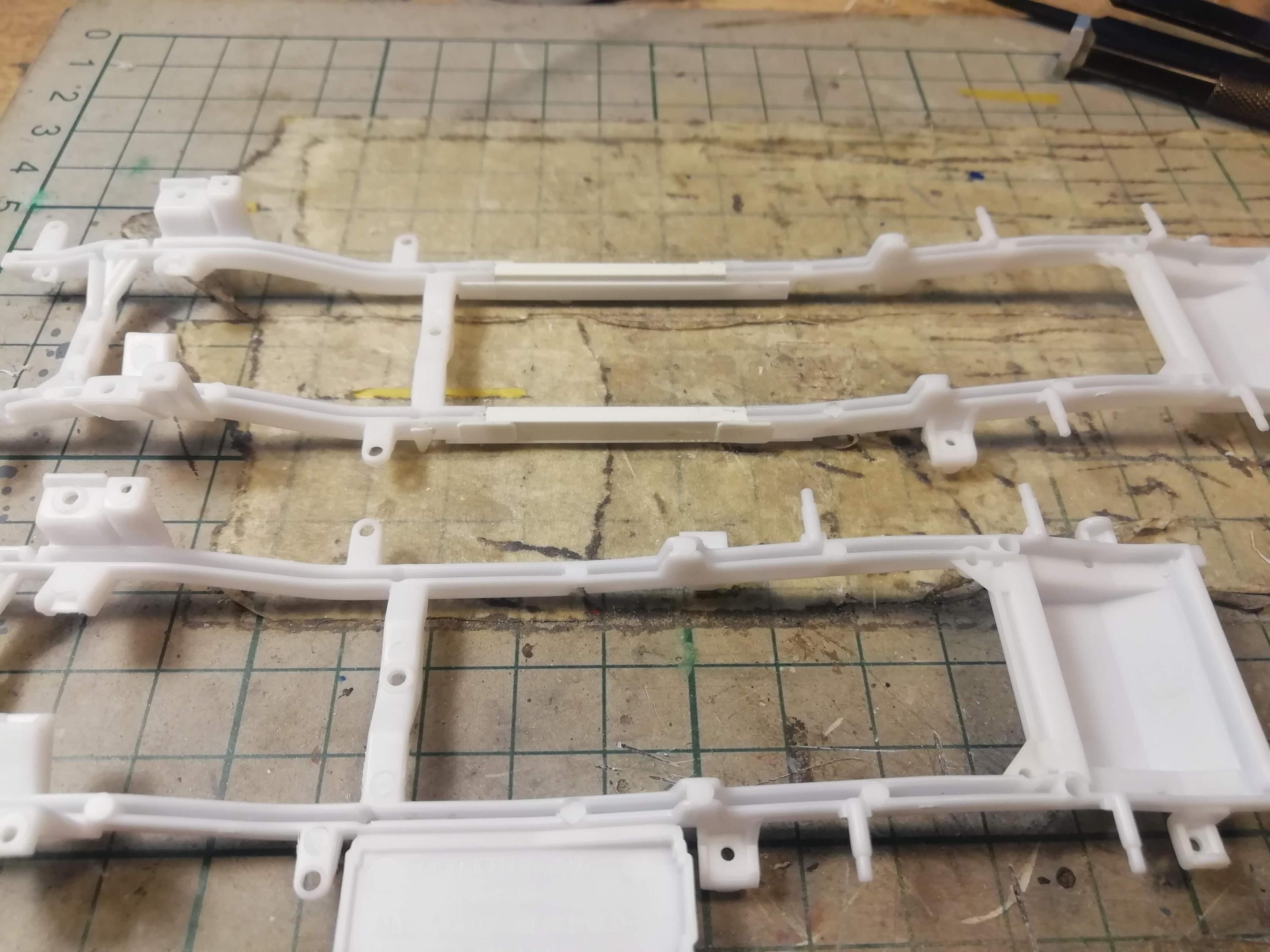

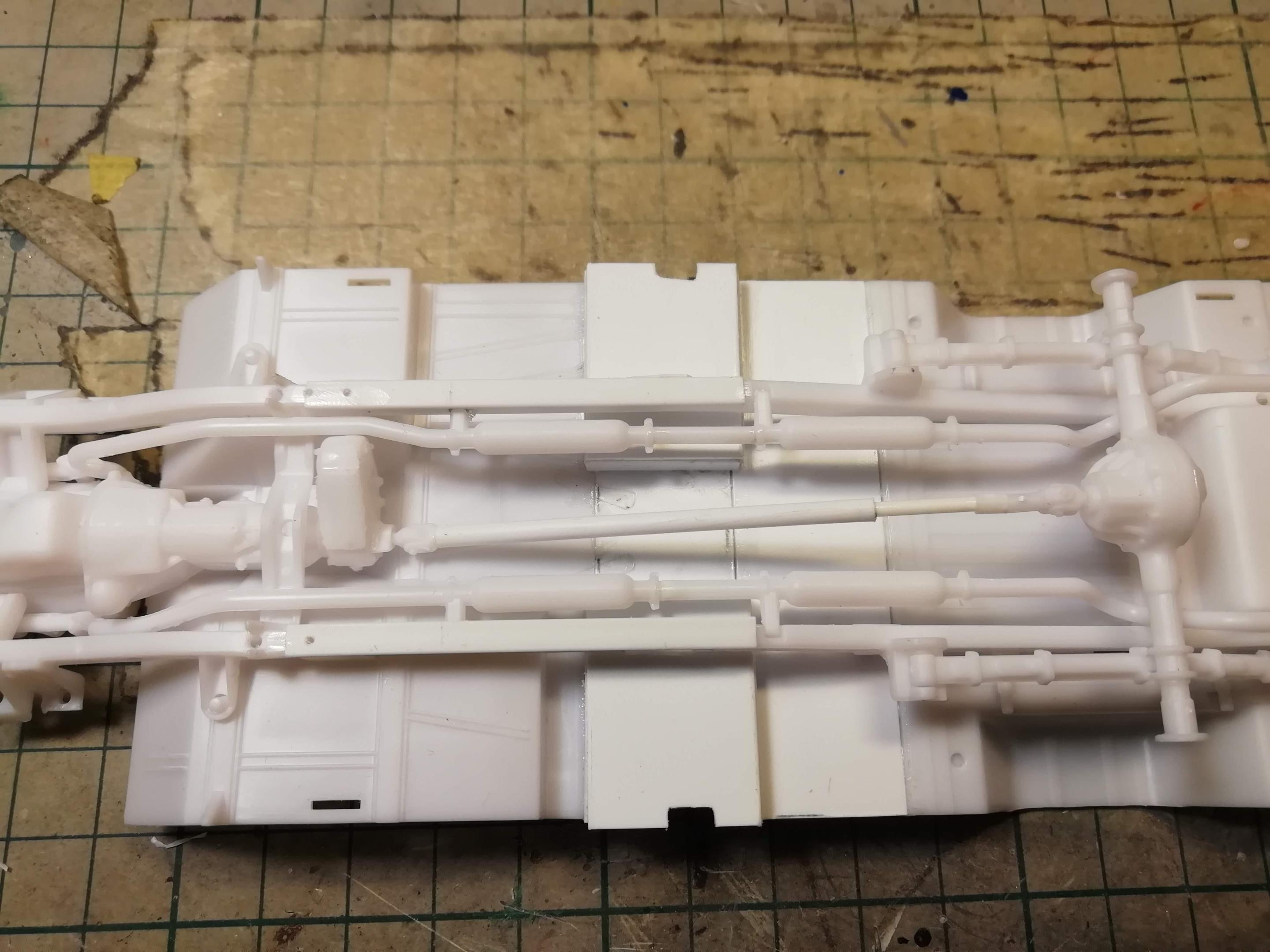

I originally had one stock version and one Baja version with incorrect body. Then I recieved second Bronco as trophy, which had both bodies. Since I had three kits with three stock bodies and one with Baja body, I decided to make one to a 4 door version. First step was to cut two bodies and combine them. I decided to make rear doors little bit shorter. After gluing the halves, I measured that body was lengthened by 3,3 centimeters. That was important measurement as it would be needed later. Then the same measurement was used to stretch the frame. I used evergreen L profile and straights for the extra bits. I cut it so that the middle exhaust support would be moved back. More on that later. Then it was time to cut the floor and door panels. Both floors halves had locating pins at the frame, so locating them was easy. Then it was matter of filling the hole with new floor bits. I made the floor to have same kind of foor space, as in front seats. I had to use two door pieces per side. That means that I have to fabricate new door panels to the donor car. Door panels had locating slots, that were used to tell me correct lenght that I needed to make the cuts. I also copied the shape of the front seats mounts and made couple more. Missing are seat belt things, but I added them later. Afted that, it was time to focus on mechanical side. Lengthening of tailshaft was done using evergreen rods. For the exhaust pipes, I again used two sets. Locating slots for the exhausts came in handy. When I cut the pipes, rear section were placed on its place. Then I measured what th front needed to be. Only one section had to be added in between passenger side mufflers. I used part of that tailshaft. I also added some floor strenghtening, frame support and body mounts. Last big thing was to extend the roof using again donor kits roof. That one will obviously be a roofless racing version, since I've robbed stock exhaust, stock seats and stock doorpanels. Missing are the hinges, which I've added later. If you notice, the roof seems to be lifted a tiny bit. I later cut 1 mm from the windshield frame. I made the wheels arches bigger, to house Baja wheels. I also found some flares from my parts bin. I don't want to glue before the paint, since they will be diffent color. Now it's time to fill the gaps and sand. I used tamiya epoxy putty on the roof, because I don't want the putty to shrink. Middle of the roof needs alot of filling, because otherwise it would have a nasty dip in it. First sanding was done with 80 grit. Then I used metal ruler the same way the carpenters use scrapers to finish wooden surfaces. There will be another layer of different putty so make roof smooth and the arch contistent. I hope I managed to open my process a bit. Feel free to ask questions.

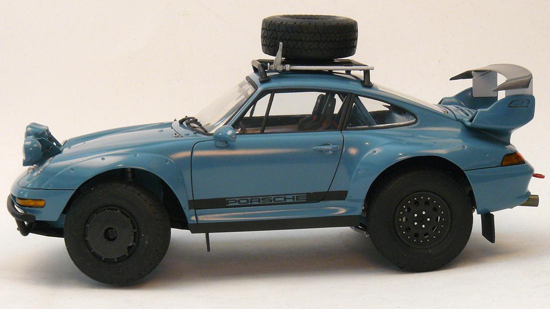

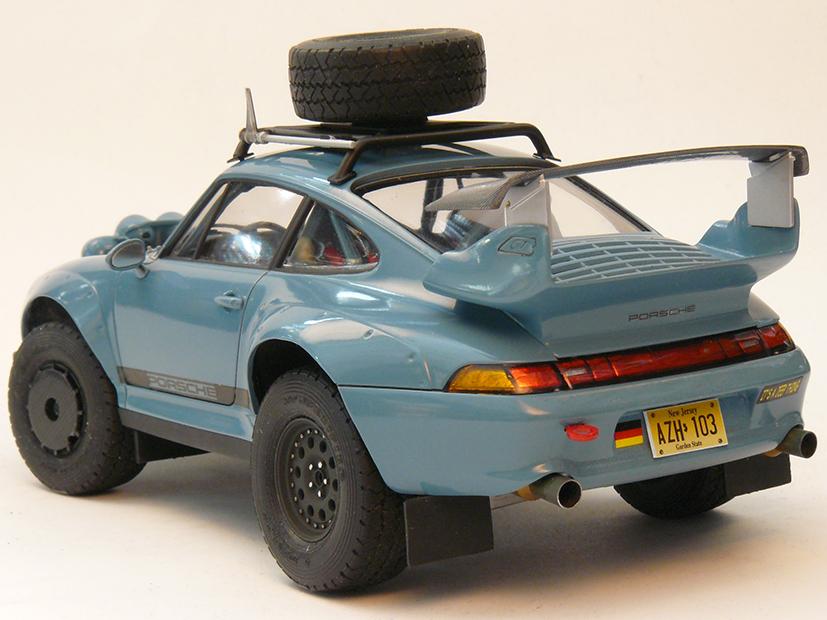

Thanks. I lifted it with lifting blocks. Wasn't keen on cutting every suspension arm, so I took the easy way out. I did add reinforcements to those white connection points. You also have to remember to lift the gear box.

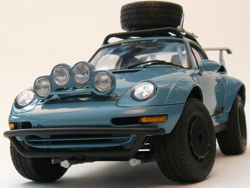

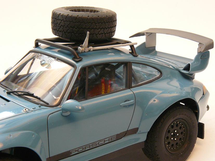

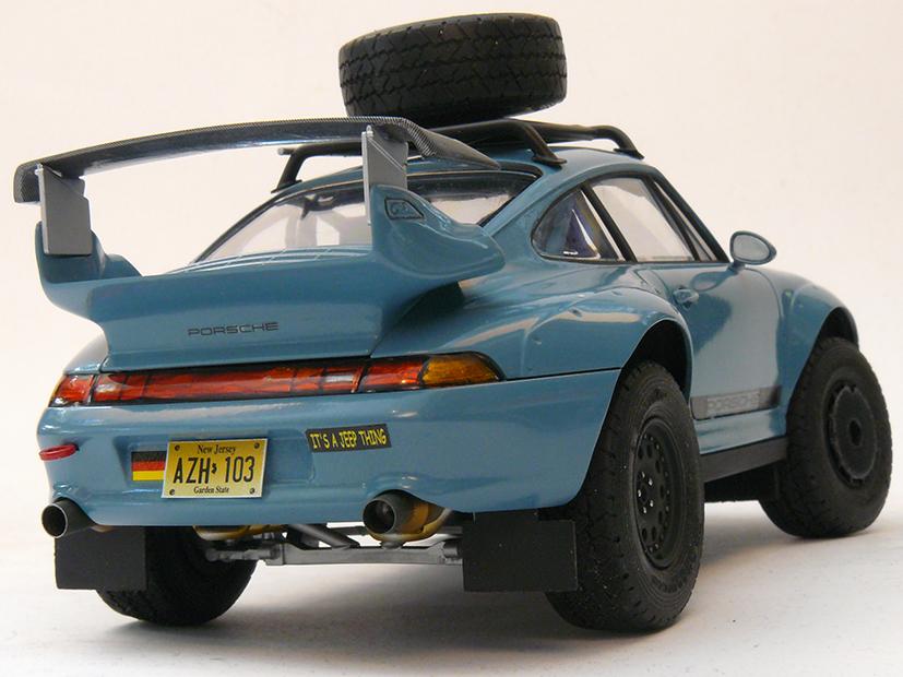

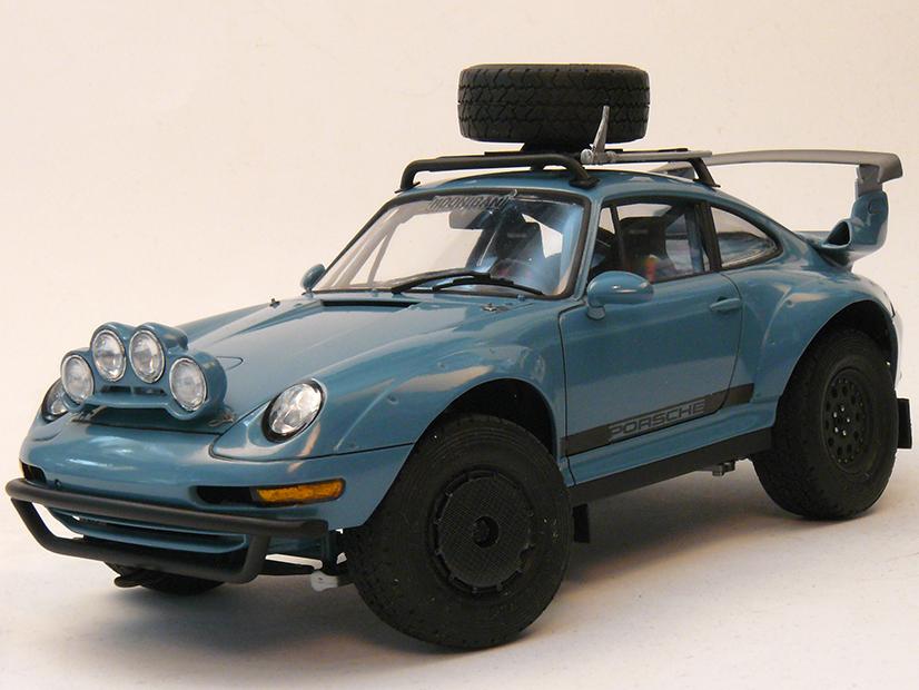

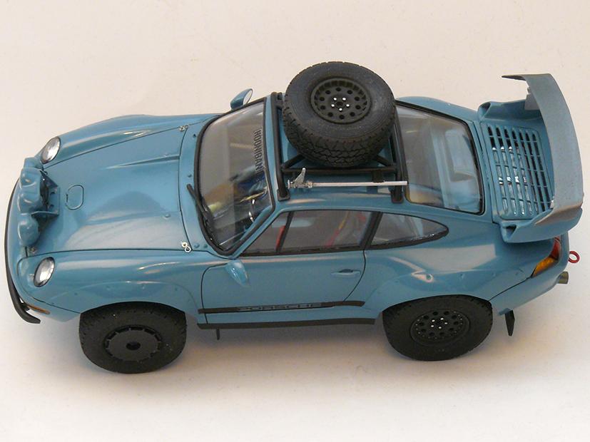

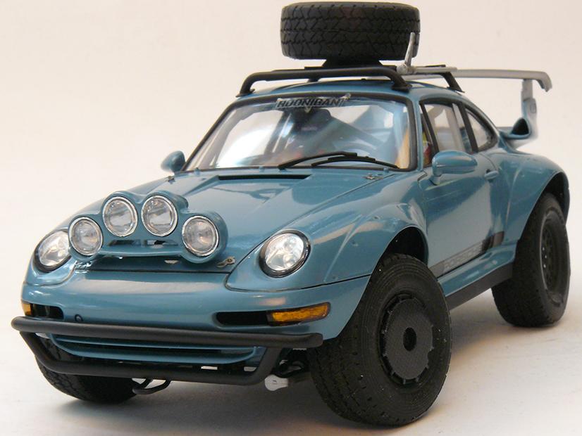

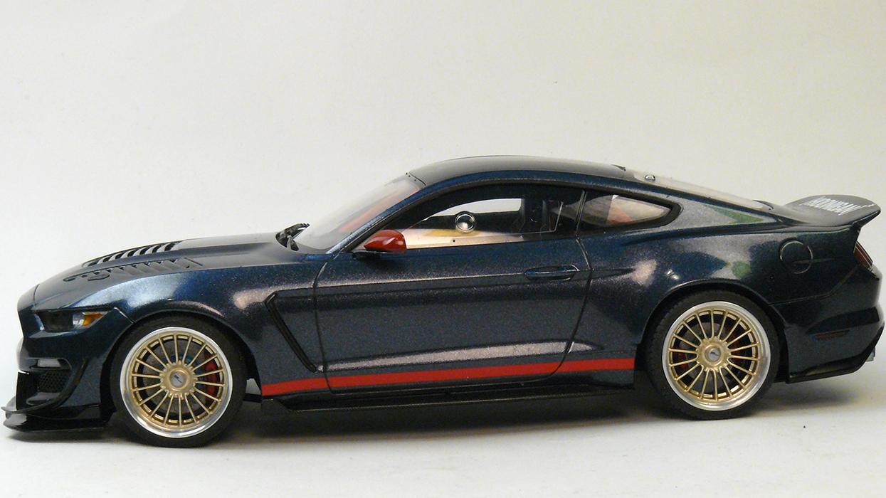

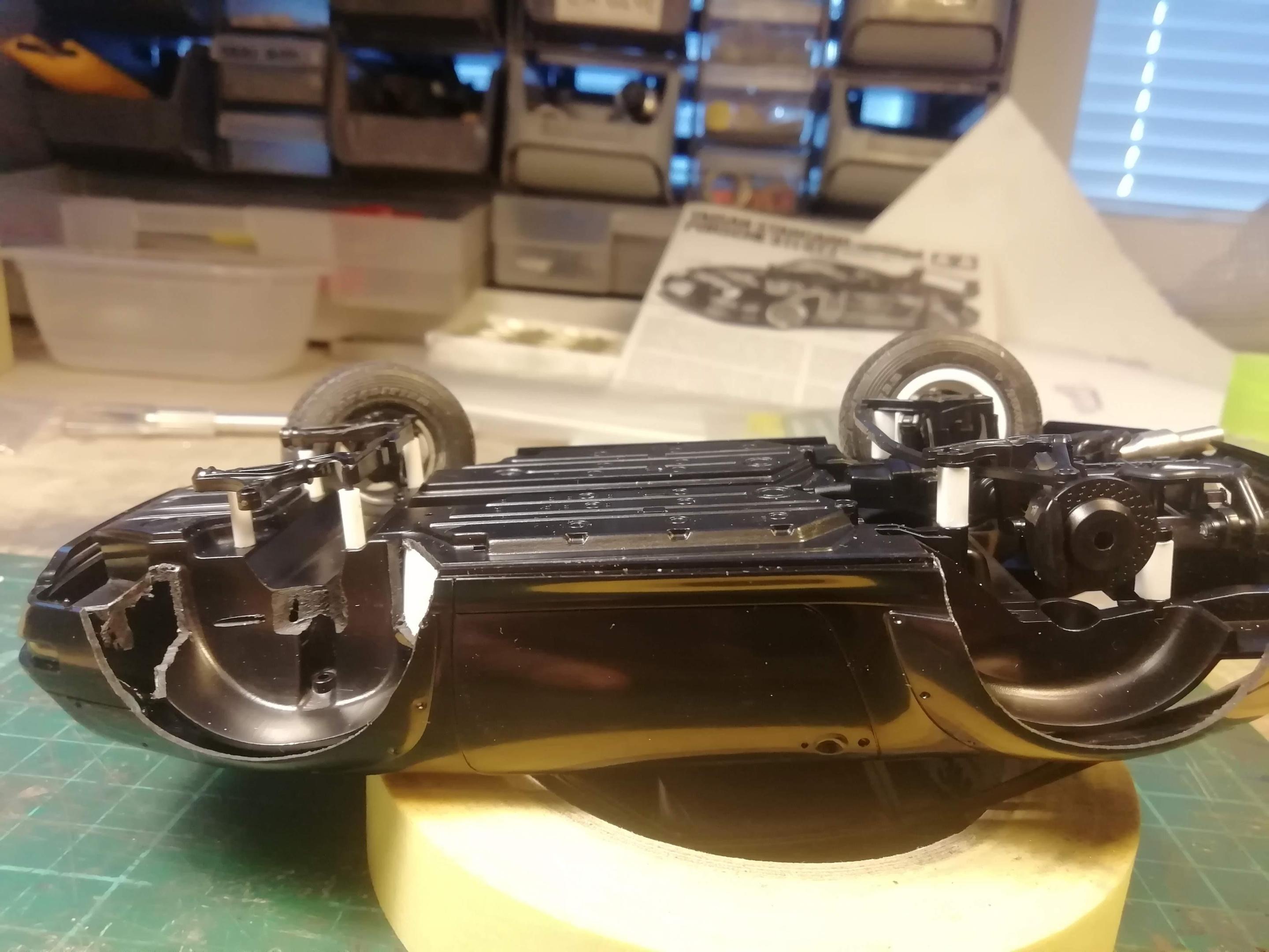

I got 2 Tamiya 911 GT2's cheap. So first got some lifting action. I added lifting block to both subframes. Tyres are from Tamiya Toyota Landcruiser. I had to use it's rims at the front, since I didn't have 5 similar Lancia 037 rims. Hence the carbon fiber Turbo Fans. I made the front pushbar and roof rack. Extra lights are from Belkits Opel Manta. Metal rear exhaust silencers added. Rear wing changed. Paint is Tamiya AS-19 Intermediate Blue (US Navy).
Glad you noticed that. Couple of my friends said last weekend at model show, that they noticed that only when seeing it live.

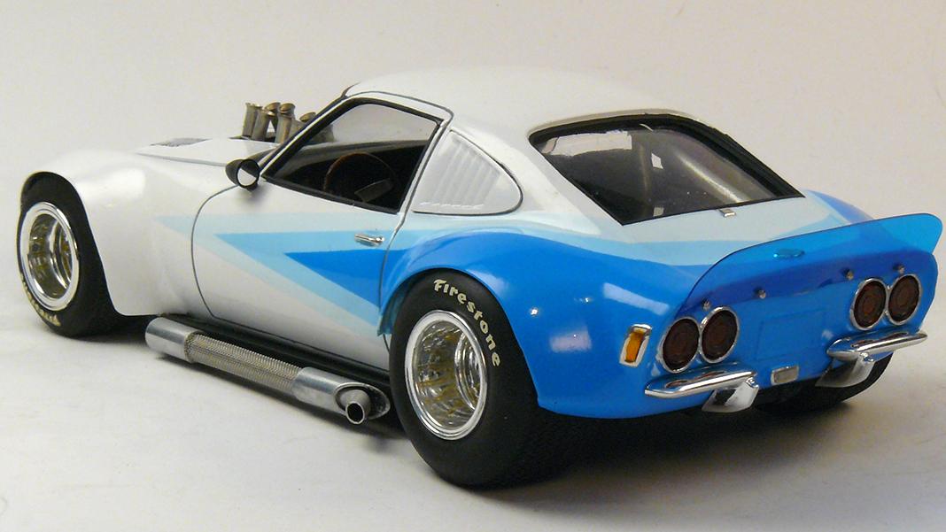

I painted them first with Molotow chrome, then with Tamiya yellow clear. That's it. -

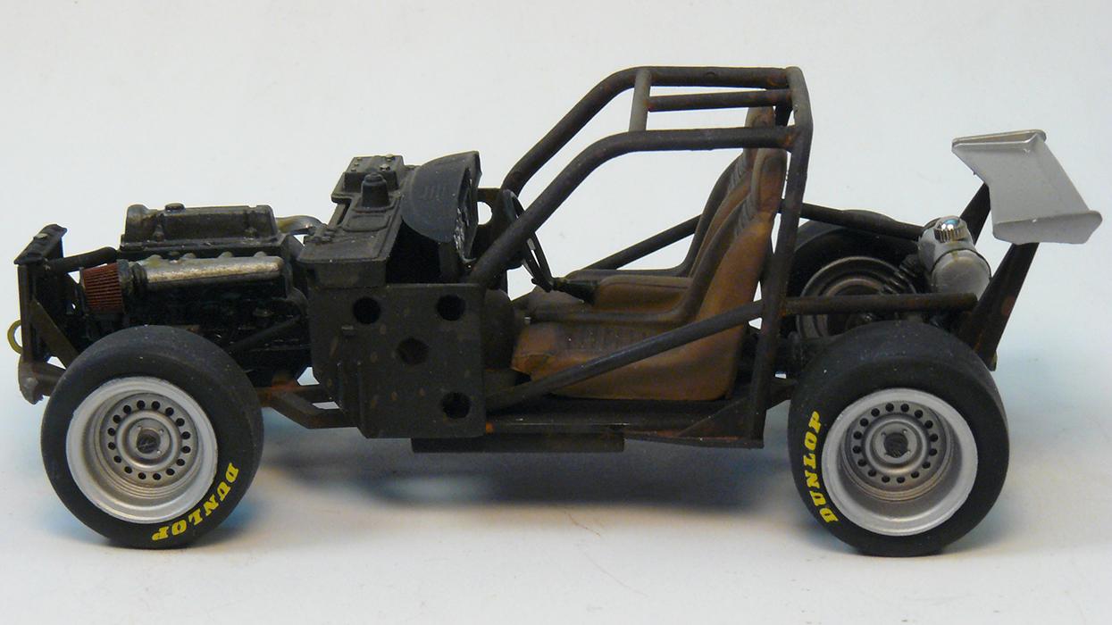

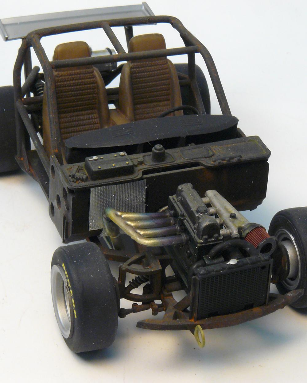

Thanks. I had to make them, as ignition wires "had" to routed very close to exhaust headers. Shield is just some rope I had lying around.
In a way this has been built before. Inspiration came from Roadkill's Super Camaro. I copied it's paintjob.
Tips were made from radio antenna tube. Then heated with torch. Remember to clean them before heating. Fingerprints leave ugly surface when heated.

If I remember correctly, they were from Aoshima Nissan Silvia S13 kit, which has an engine. -

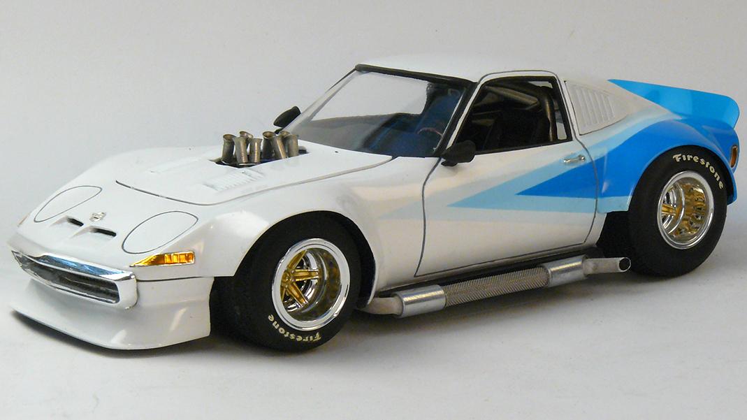

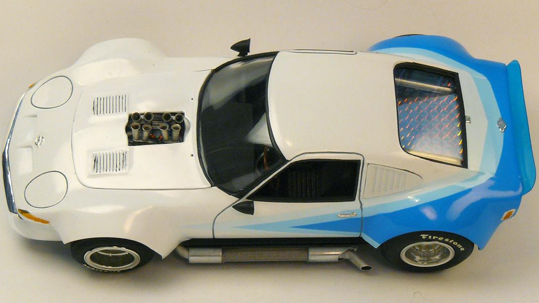

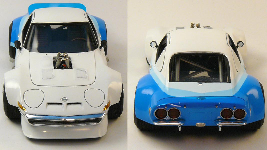

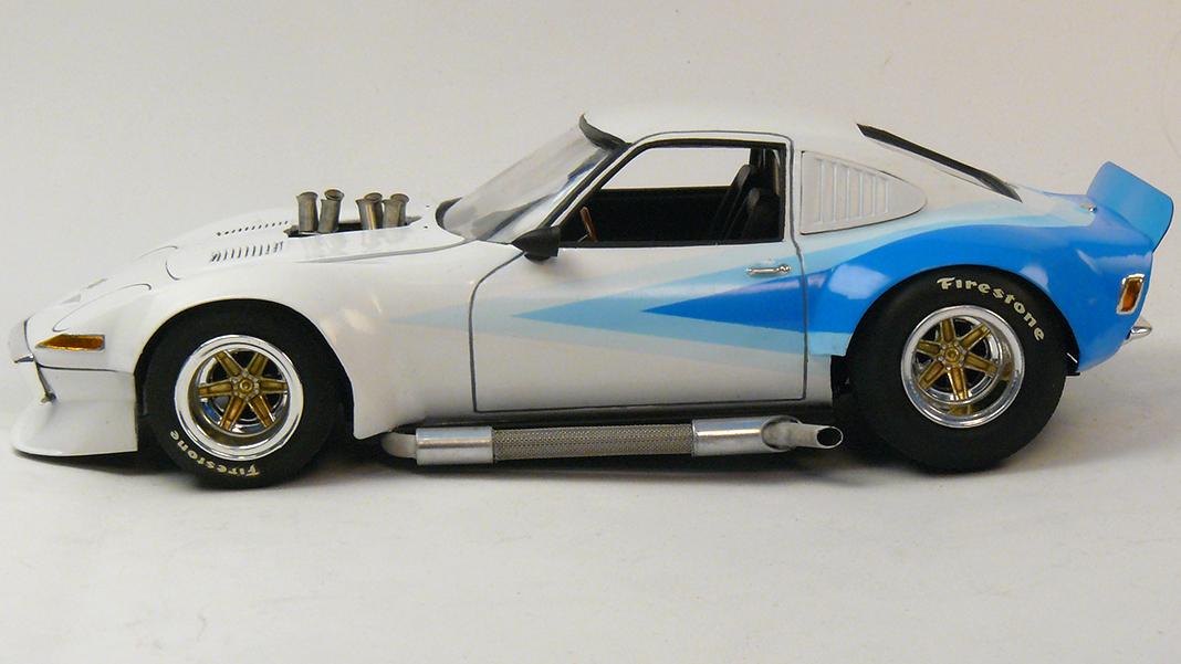

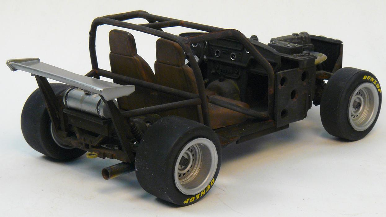

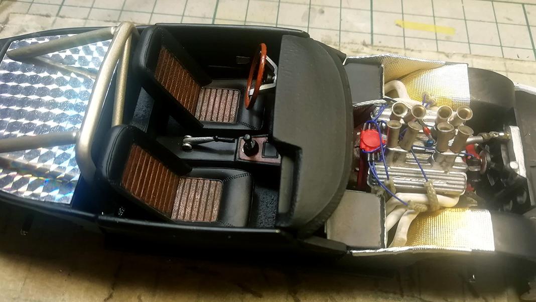

Changes: - Fender flares from Fujimi set - Engine is Corvette V8. Changed the intake manifold and carbs. Scratchbuild distributor and exhaust headers - Sidepipes made from brass tubes - Model Factory Hiro's 70' prototype tyres with widened kit rims - Front spoiler out of Peugeot 206 WRC rear spoiler. Rear spoiler is styrene sheet

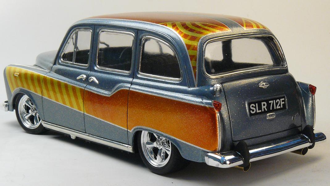

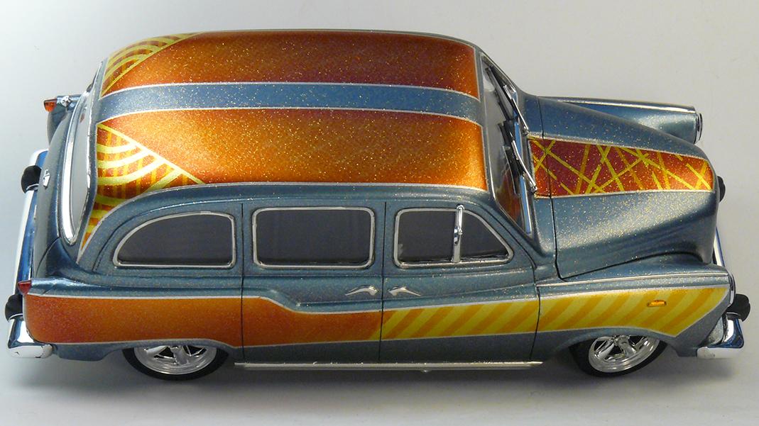

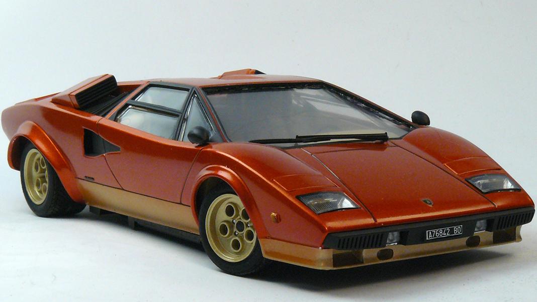

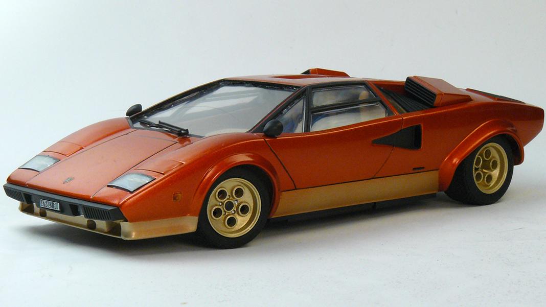

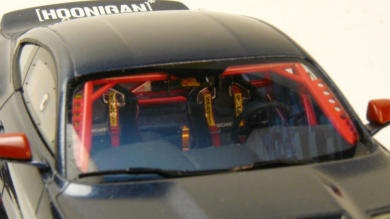

Changes: - Lowering - Wheels and tyres - Double exhaust - Sideview mirror place switched - Custom paintjob Lowest picture is the same kit, built by me in early 2000's. Notice the kit's updated licence plate.
