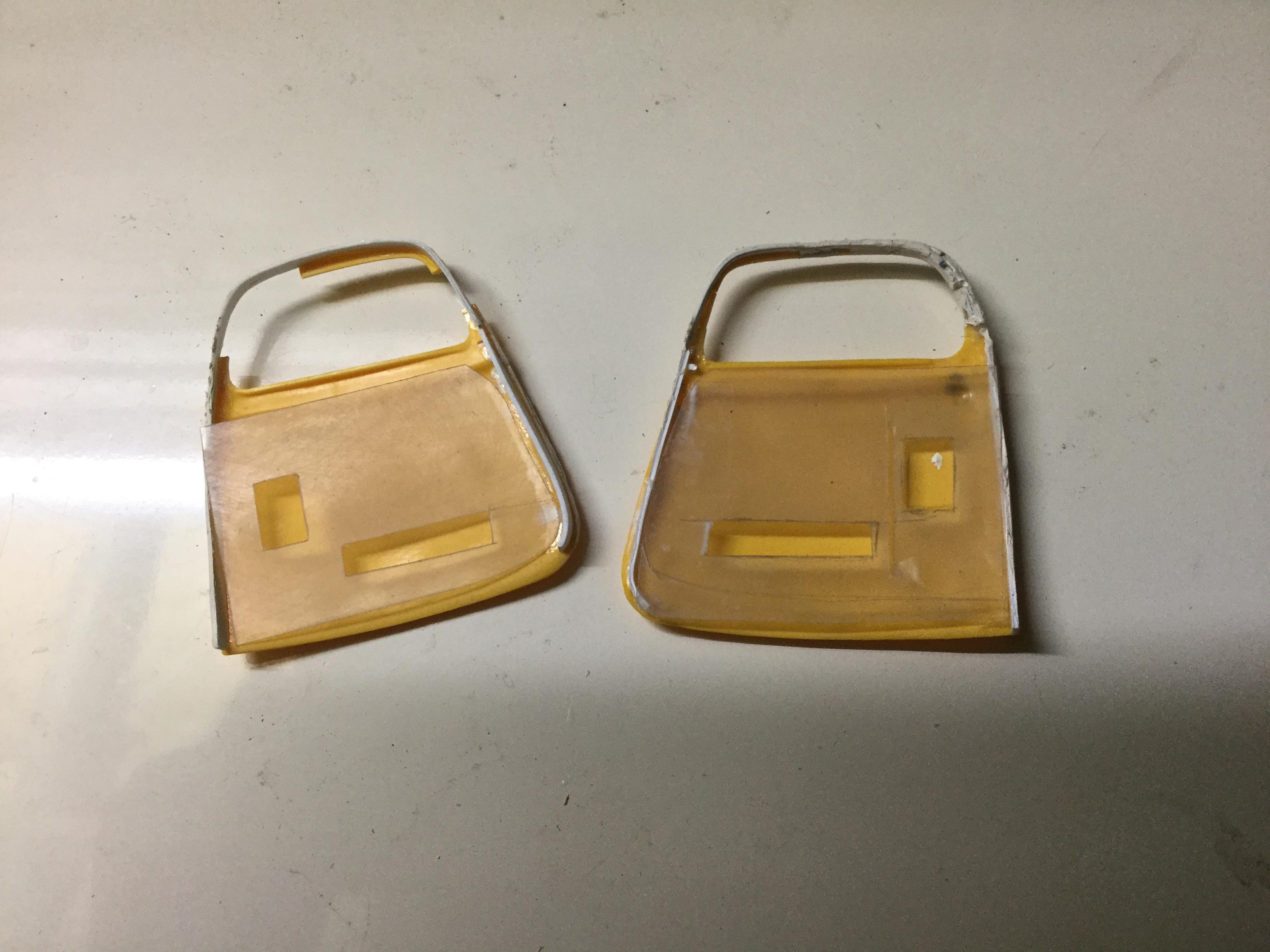

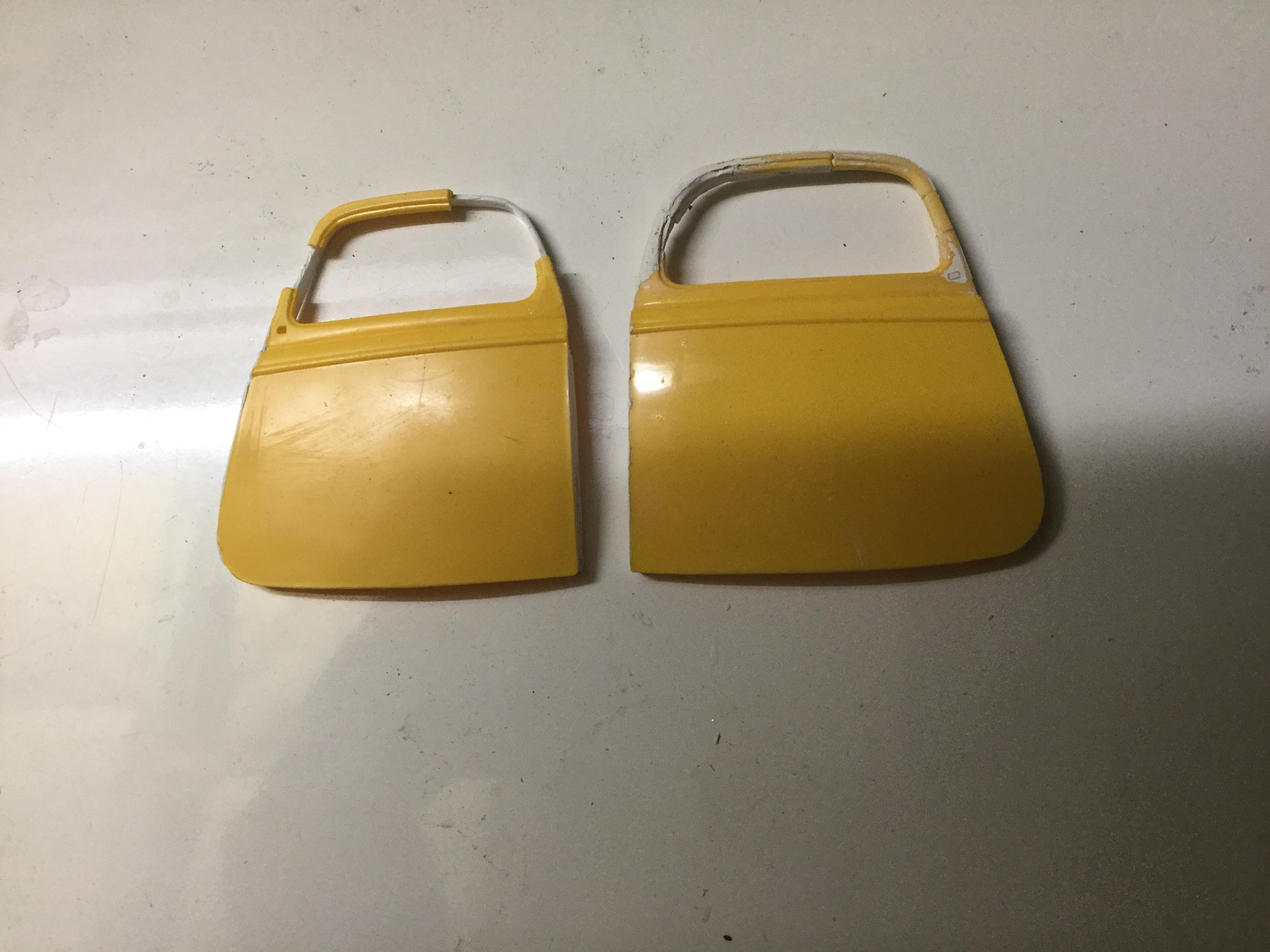

  1. That’s what I will be doing with the finished frame as it’s too damaged to repair. The other door frame will carefully be put back together utilising as much of the original as possible as there is already a styrene backing frame to attach it.

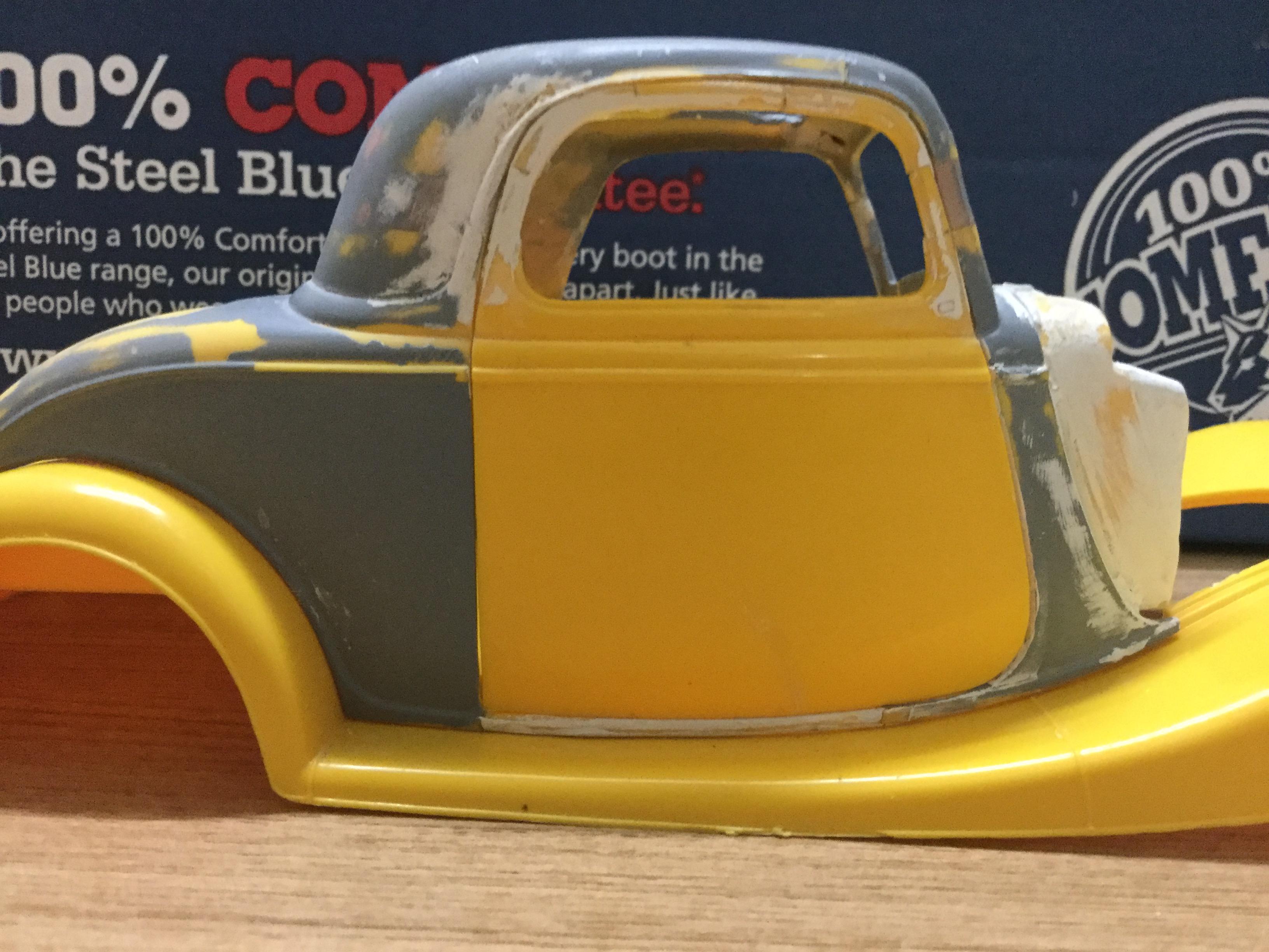

  2. As far as the door frames go, they will need a lot of reworking to end up matching each other. I was not happy with the severe rake on the b pillars so I re-did the passenger side of the body and door. At first I was happy with how the door frame was looking until I looked at the other one. I then realised I had carved too much of the shape away in the re-contouring that no amount of putty will fix. I have decided to finish the other frame and get a template from it to re-do the first one in new styrene. That will be the next task.
  3. Here they are sitting over the over the outers.

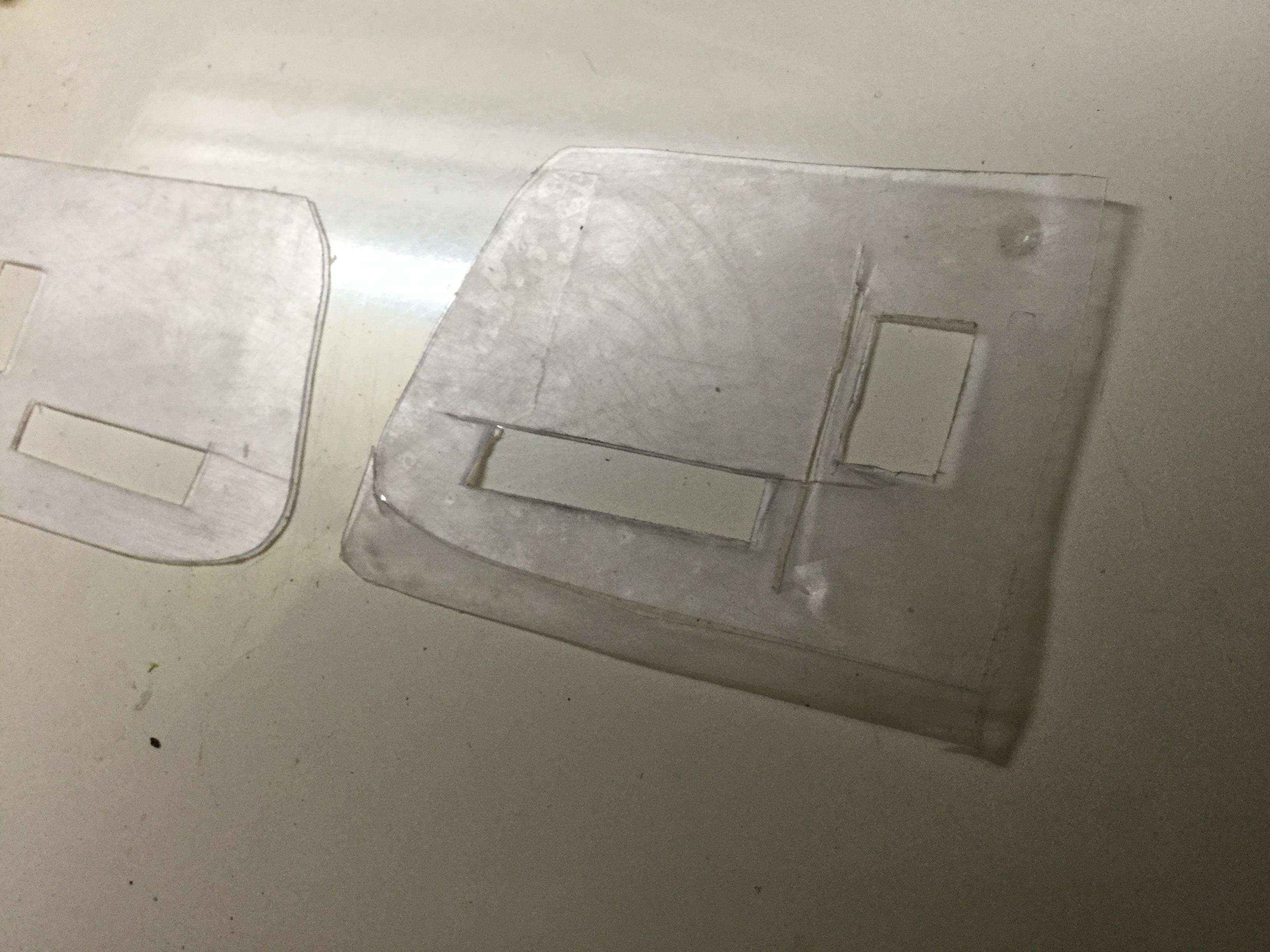

  4. Hey Guys. Another long overdue update. The doors are getting the inner skins. I am using styrene for the edges but for the skins themselves I am using thin clear styrene I sourced from packaging. The reason I am using this is because it’s thin enough to put the recesses into it like the original.

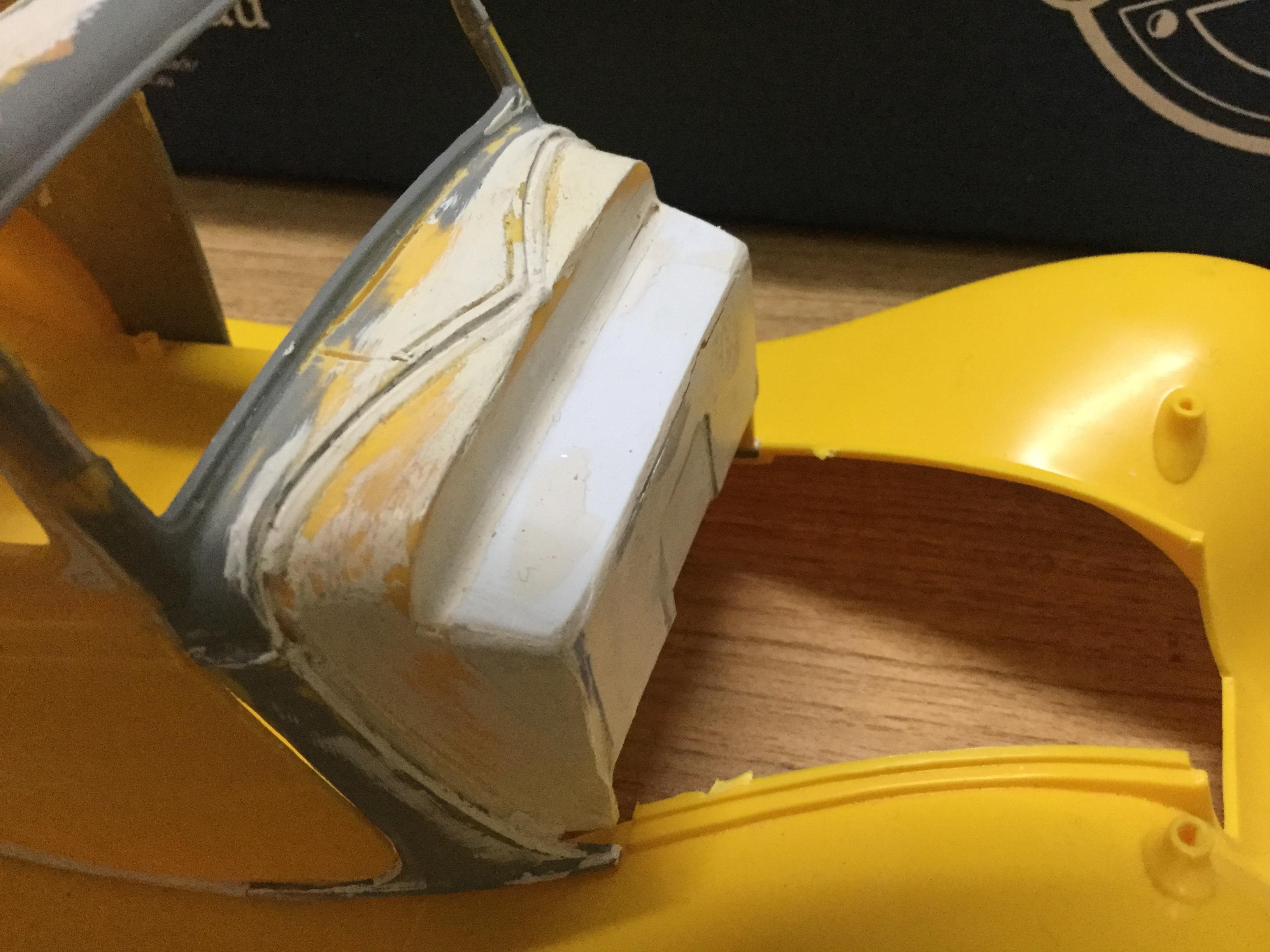

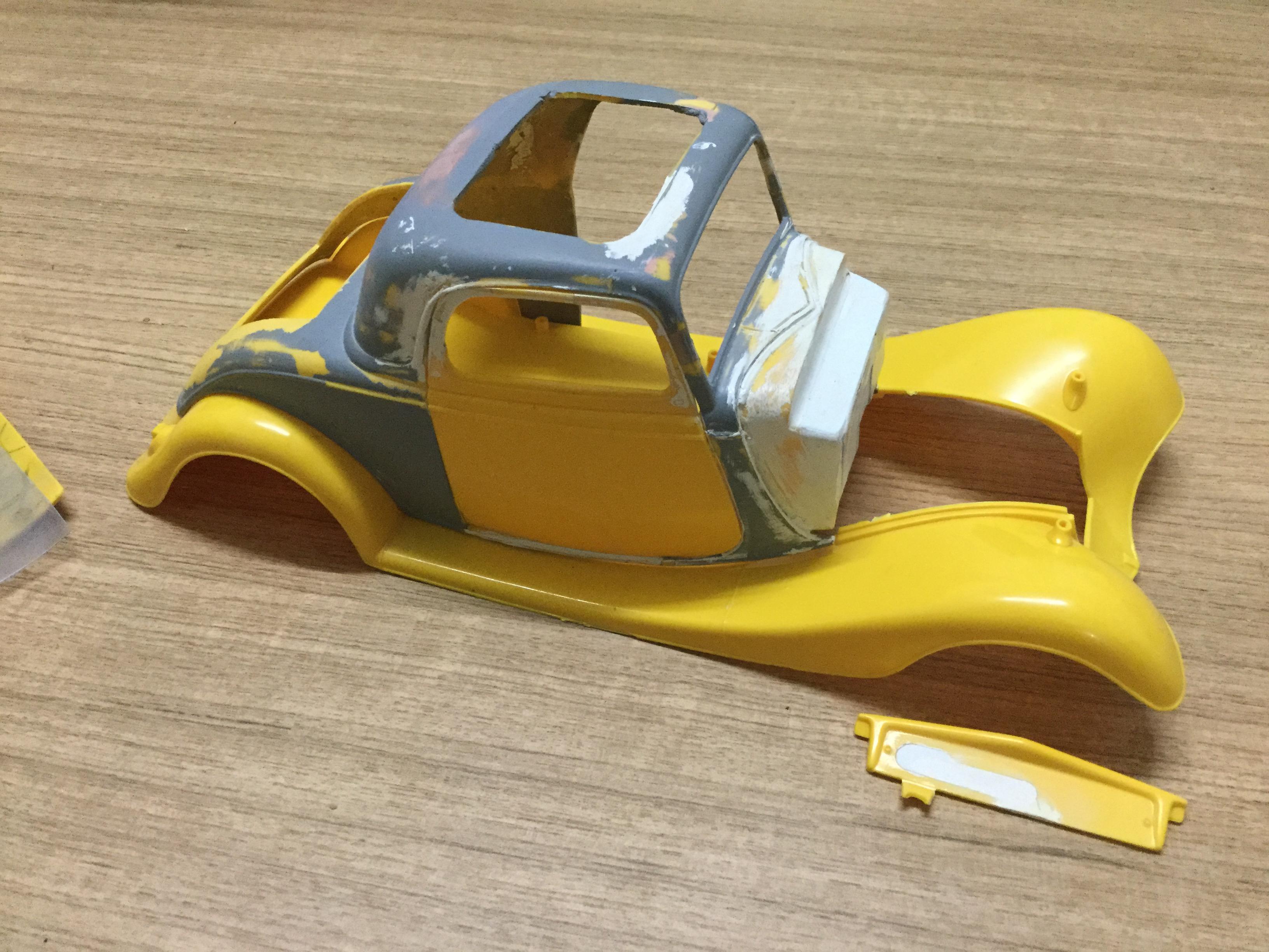

  8. After looking at images of stock three windows, I soon realised the Roof on mine was wrong. The error is in the b pillar, due to the more severe rake. While this looks fine on the standard kit, on my stock height version it kept bugging me so I decided to do something about it.
  9. The other change I have been making is in the roof itself.

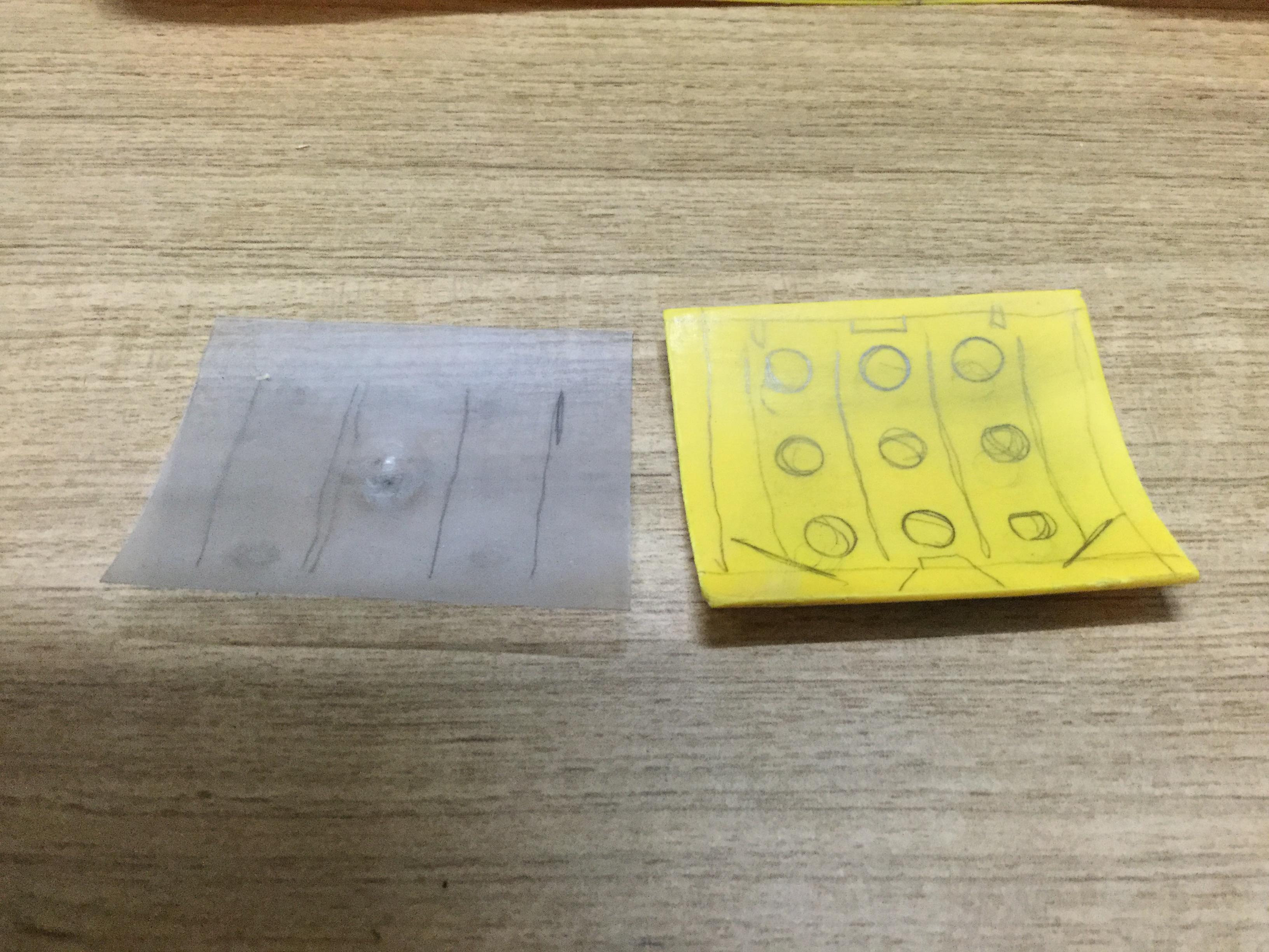

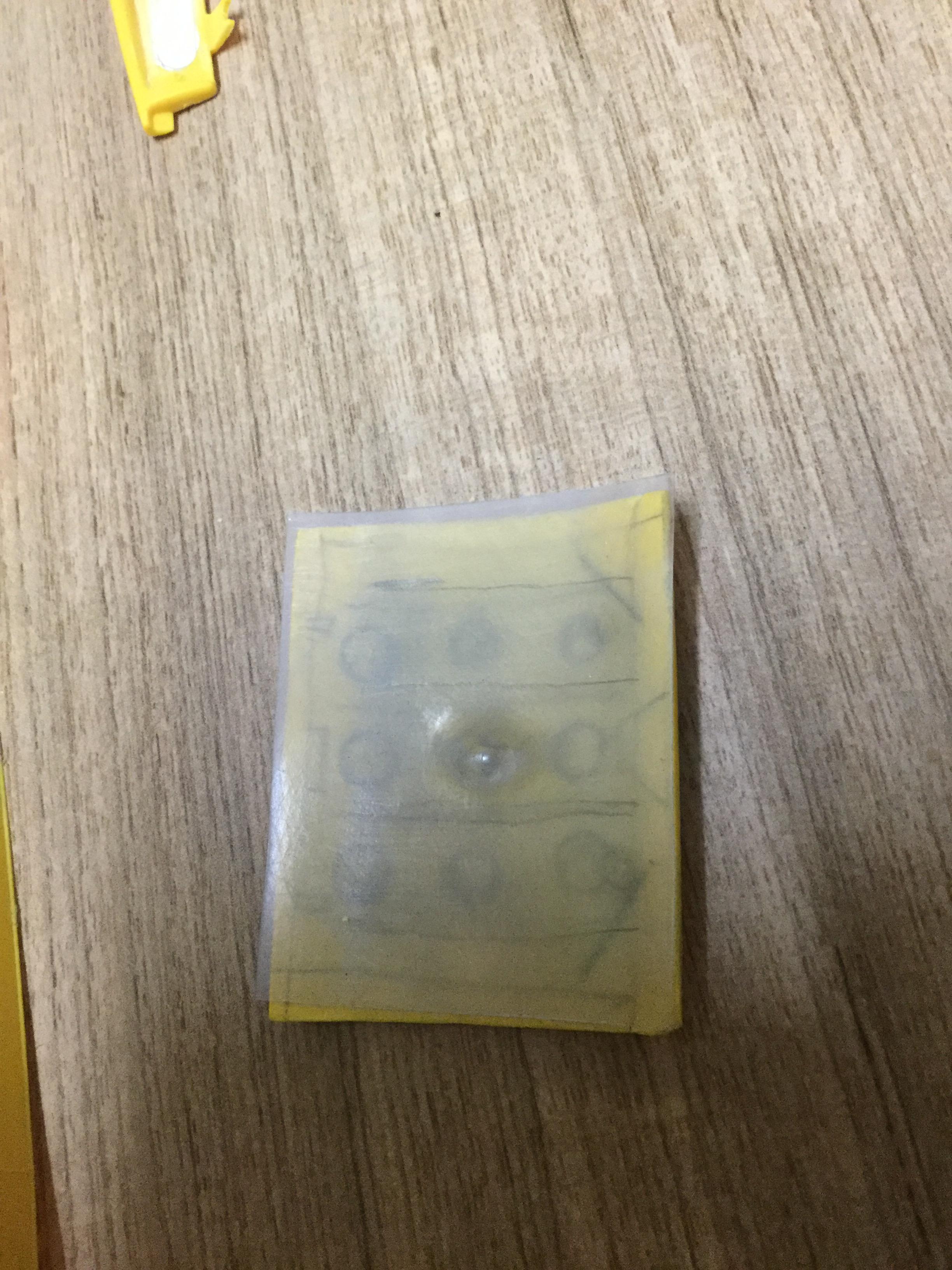

  10. The deck lid was carefully cut out and like the firewall, this too will feature the stock features. One of the most challenging tasks was in creating the inner skin. This has been fashioned from a strip of clear styrene with the center section pushed up to resemble the raised section on the 1:1 that stopped oil canning. The reason I used clear styrene was so that I could place it over the outer lid and accurately mark out the holes.
  11. As happy as I am with kit, there have been a number of changes I have made, aside from un chopping the roof. The most obvious has been the addition of a stock style firewall. It will include all the standard flanges and beads.
