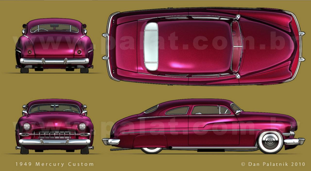

  9. There is a blueprint of a 49 on this site. http://www.palat.com.br/cars.htm It also has a LOT of other cars this guy has done in 3D in renderings and blueprint type drawings. Look at the top of the page and you will see his blueprint page. Heck... Here is the image of the 49. (I am not sure if the admins will allow this so if not please remove it. ((Or ask me to and I will)) Hope it helps.

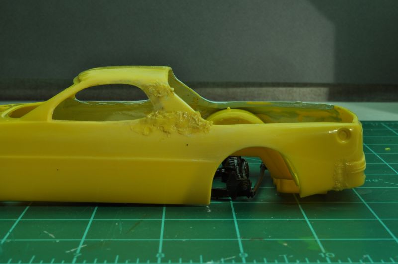

  14. Ok some more progress. Keeping with my theme of low, smooth and shiny I decided to do a mild chop. I am not a fan of radical chops, especially on the 40 Ford Coup. The lines of this car are beautiful just the way they came from the factory but that doesn't mean it can't be improved on. This is the first chop I have done in a number of years but I am not afraid of cutting up a perfectly good car so... I decided to do a mild 1 1/2" chop because I wanted it to be subtle and I also didn't want to distupt the lines of the body (especially the roof line flowing down into the trunk. At first I thought about doing a raked chop leaving the back about where it was but I decided on a full 1 1/2 all the way around. I actually raked it backwards very slightly leaving it just a bit taller in the front. That is a trick I learned a long time ago (it gives the illusion of stock proportions when doing a mild chop). Here is the progress on how I did it and the final results. Enjoy, Bob I cut a strip if blue tape 1 1/2 inches wide and laid out where I wanted to cut. The Cut I left the tape on and then sprayed some paint on it so I could tell where my guide lines were. I then sanded the white area up to my guide line.
