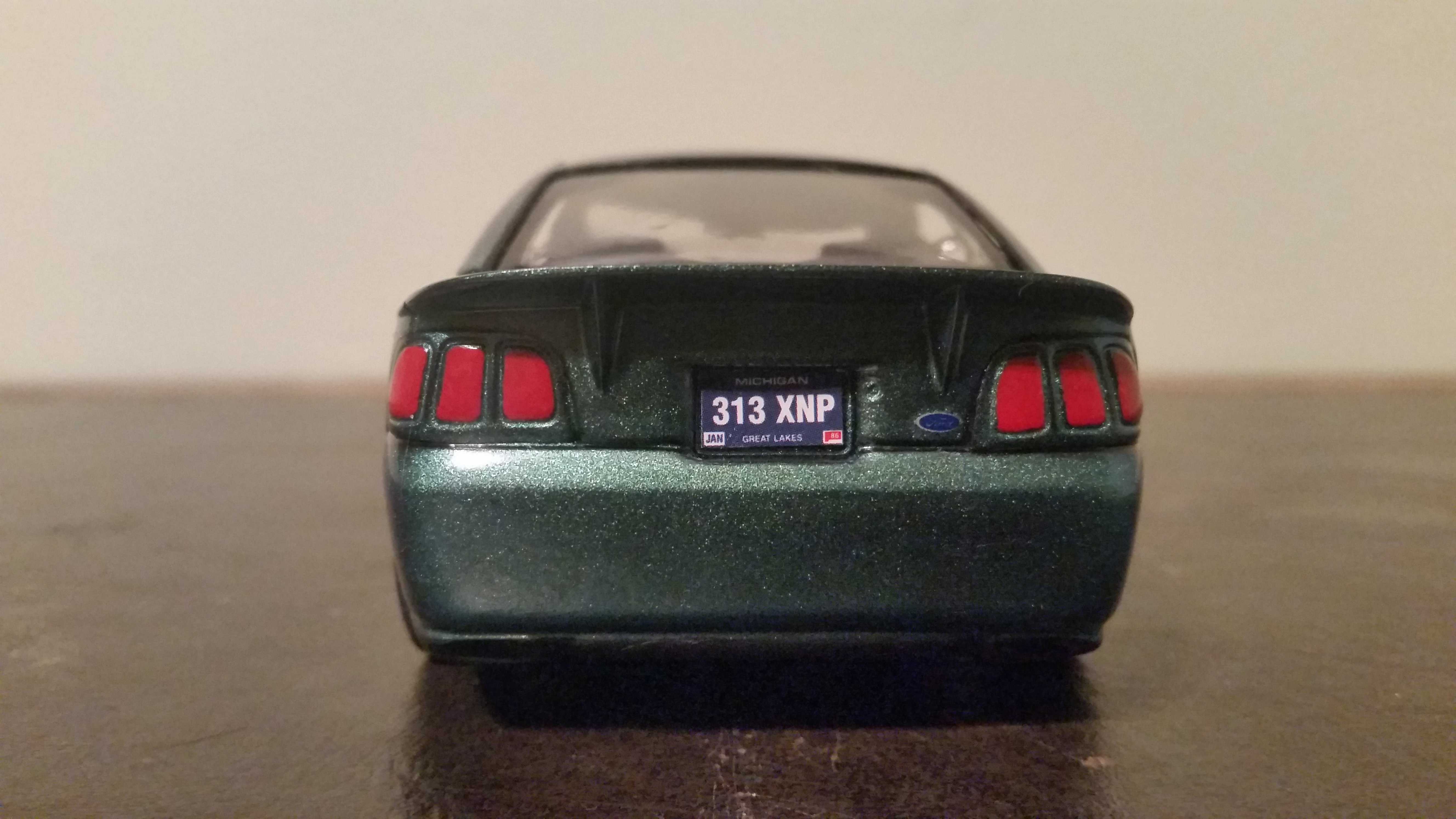

  2. Revell kit mostly OOB, but had some simplified bits (which are actually carry overs from the snap-tite Shinoda Boss kit) swapped out with guts from the '99 Cobra. Front suspension was missing springs and shocks, so that and IRS came from the 99. However, while the interiors are the same sans small differences in door panels and seats, the SS's chassis had to be swapped with the Cobra's as the former had indents that were meant for the solid rear axle setup and wouldn't work with the IRS. My kit despite being sealed, had a horribly deformed (short shot?) steering wheel, so I found a replacement parts one from what appears to be a Monogram '70 Mustang Boss. The one off 5.4 DOHC engine (just DOHC heads on a SOHC truck 2 valve motor, which is different than the 4.6) while somewhat simplified and based on the 5.0 in the Shinoda Boss, was used as is considering you won't see much of it with the supercharger and all. However, the '99 Cobra's exhaust had to have the tips trimmed so it would not interfere with the body-to-frame fit frame and also had the tranny cross-member at a different place and shape and wouldn't work with the 5.4. So out went that and in came the brace from the Super Stallion chassis that was cut and placed to aprox it's original location. Paint is Testors Color Shift Emerald Turquoise cleared with Pledge. Color looks like a metal flake British Racing Green in the pics, though in certain lighting you can see somewhat of a shift to Blue.
