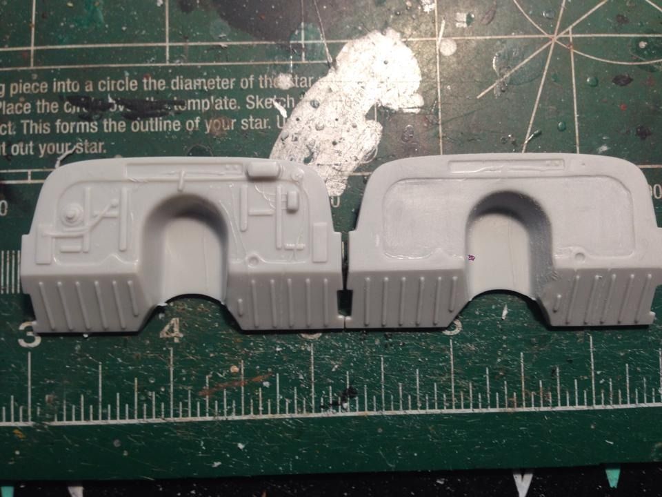

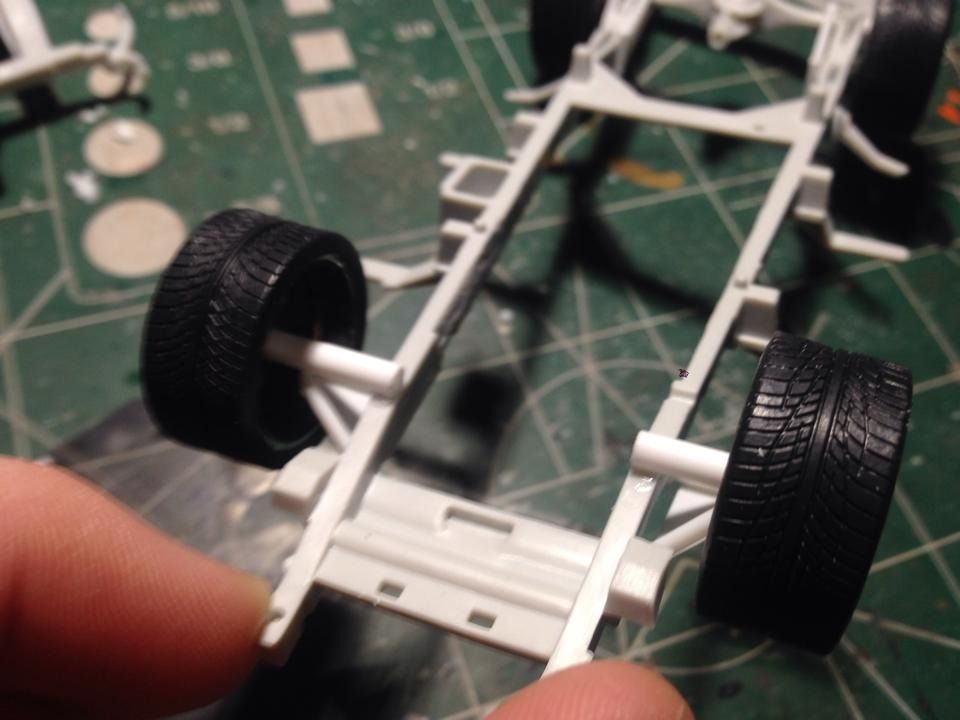

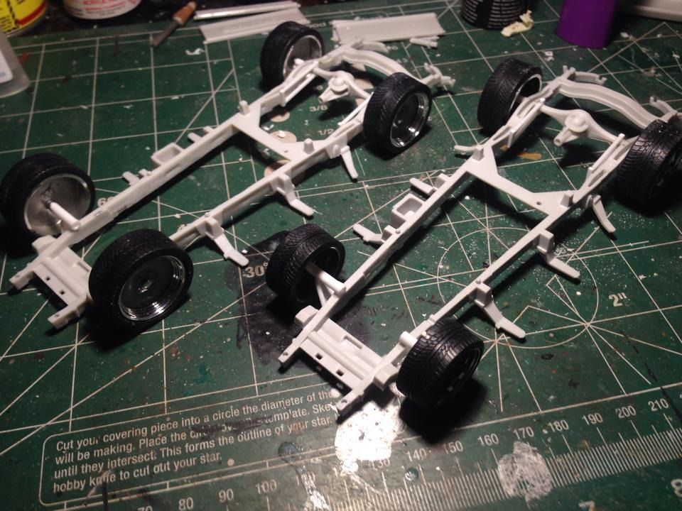

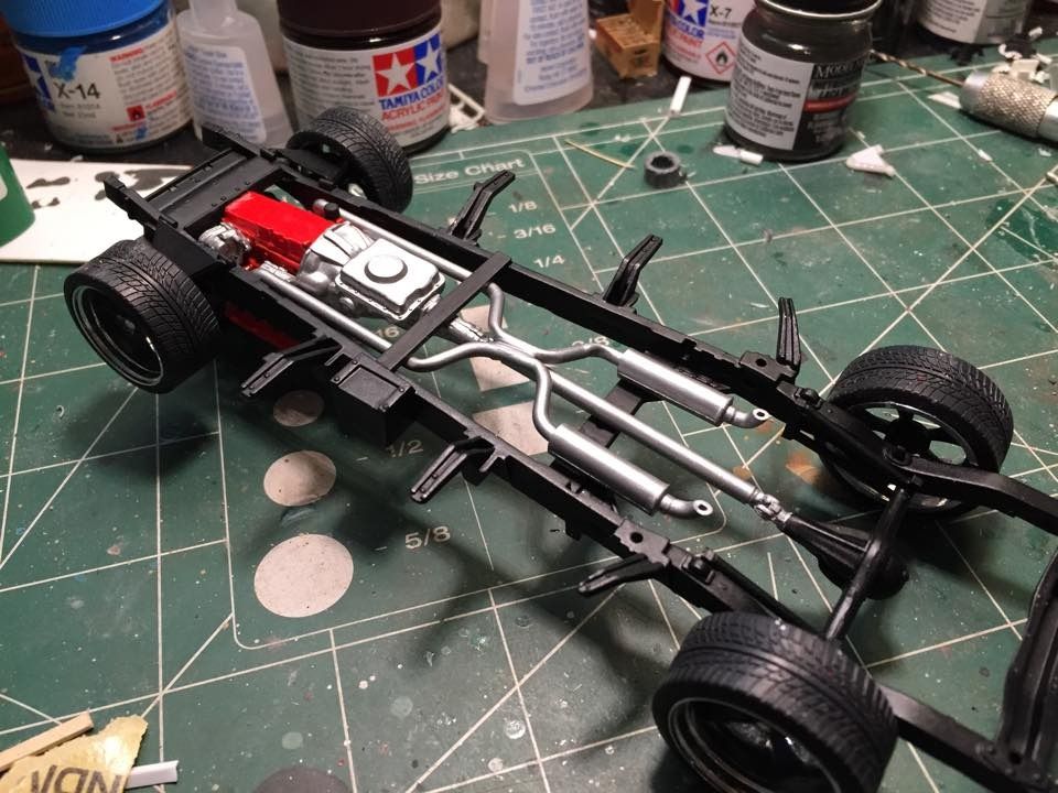

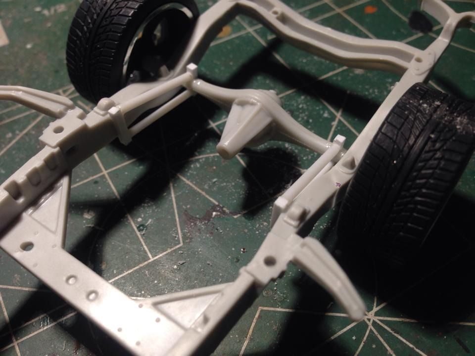

Well when I started these trucks they were intended to be some what of a curbside. Thats why the suspension is so simple. However I decided to put engines in them so now to keep the simple suspension I am trying to disguise it as a more realistic suspension. This is mainly for judging purposes as shows. From what I've learned it seems the judges don't look for exact accuracy just as long as the parts are there and it looks somewhat right. Also for anyone wondering, the wheels are from Steven Zimmerman. Some of the nicest wheels out there in my opinion. My inner fenders will hide the tubing attaching the wheel to the frame. So when finished everything will appear correct.

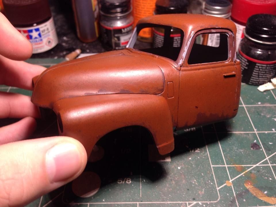

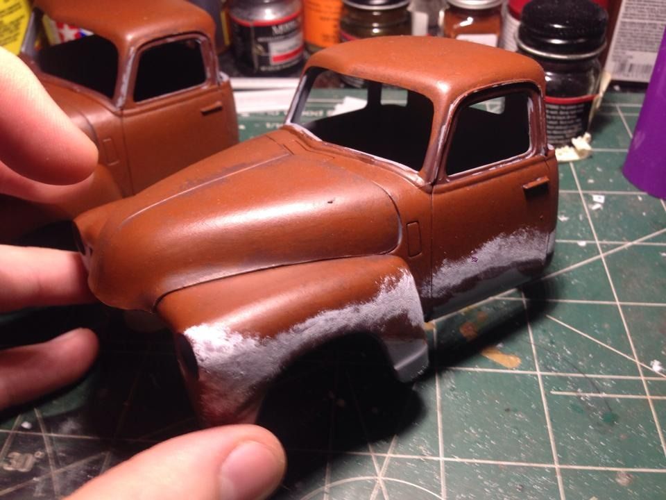

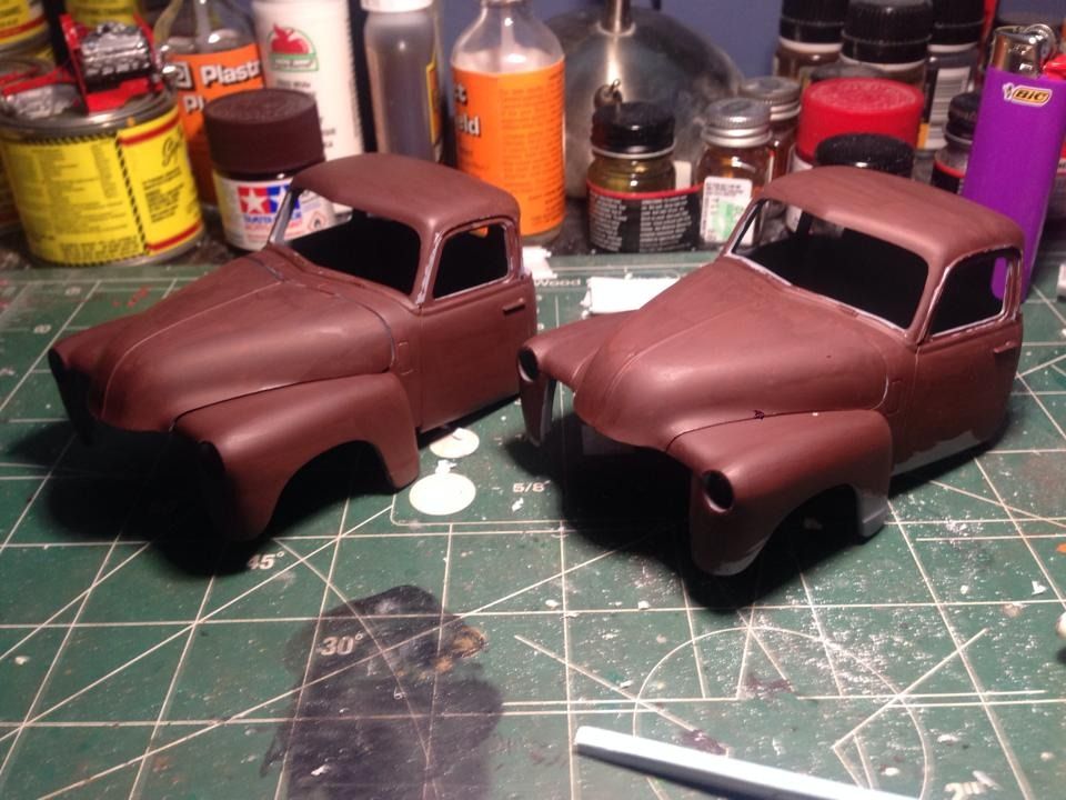

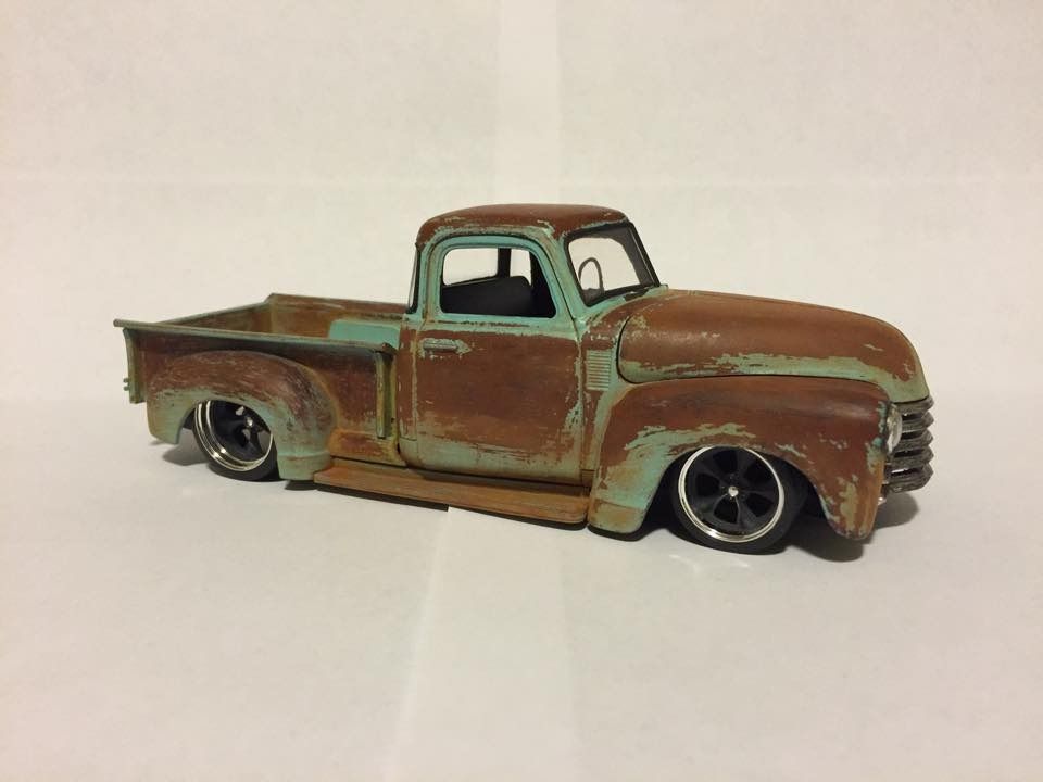

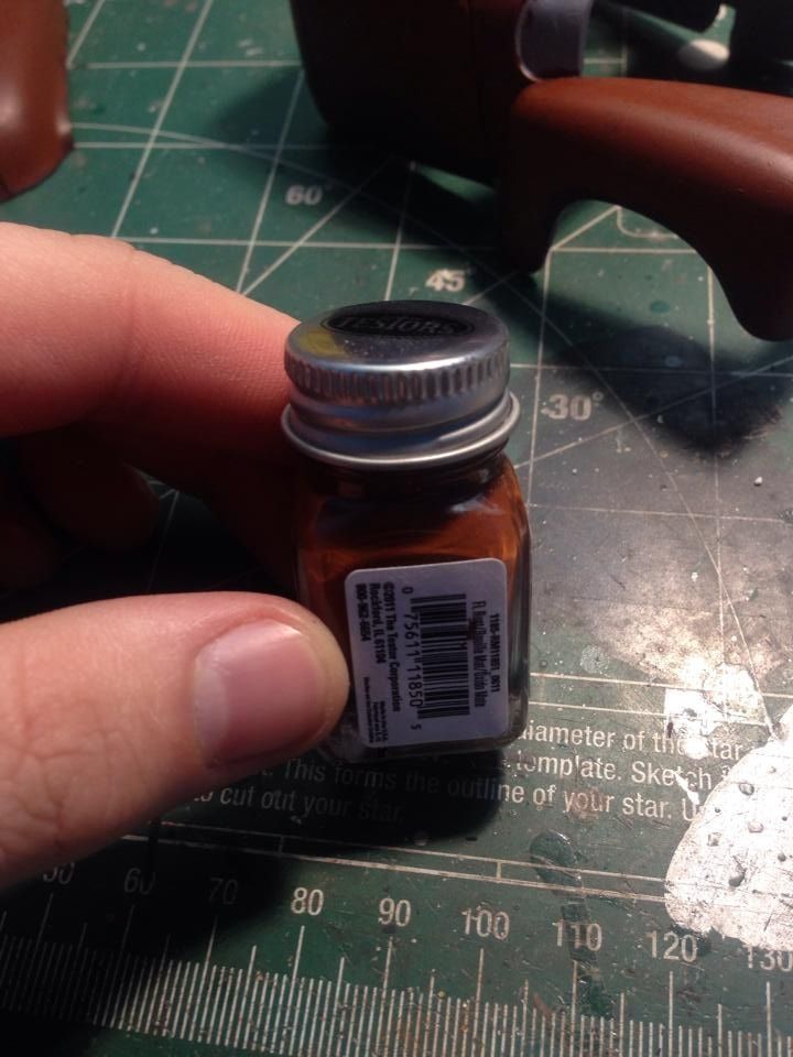

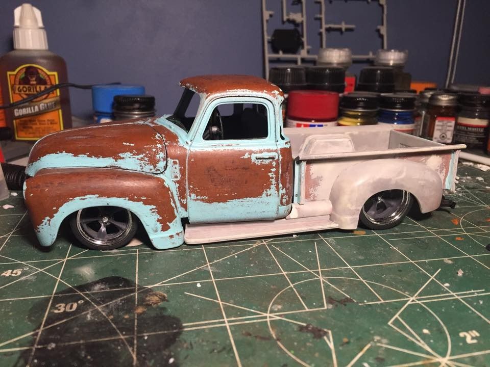

Here is my painting process, I actually seen this method in scale auto mag. Its meant to be done with an air brush but I don't have one so I am making it work with what I have. First I primer my body as I would with any typical paint job. After I apply tamiya hull red as a rusty base in any area I see that I might add rust. Next I apply testors flat rust. I dont just brush it on like I do the tamiya hull red. I kinda dry brush it so its not a full solid coat. After those two layer you can add in any other color you see fit. As you can see on one of mine I decided to add a little white. Its not pictured but after you are done with that I spray a couple layers of hairspray. The reason for this is because after you spray your body color you can apply water to the area you want the other colors to show through and it will dissolve the hair spray. That allows you to chip the paint so the other colors show through with a more natural look. Once I get my body color sprayed I will take some more pictures to show the process a little better.

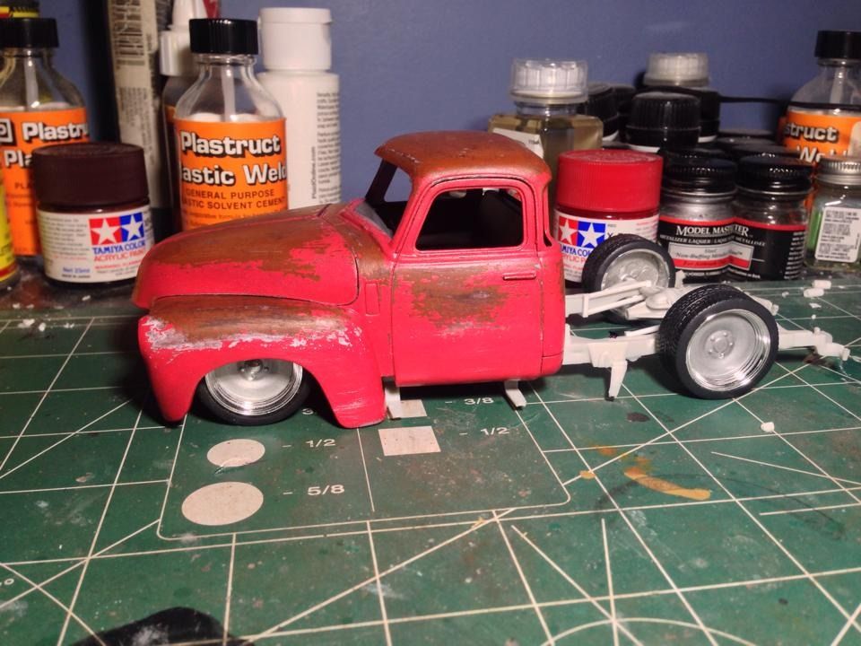

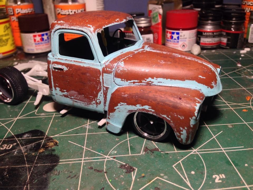

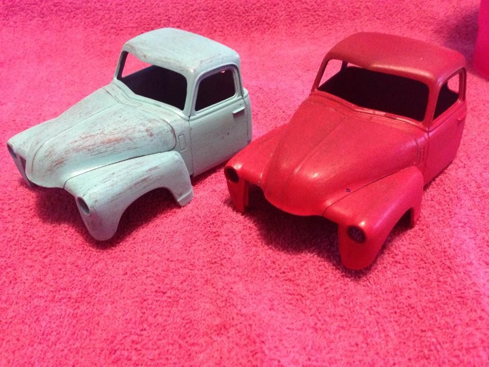

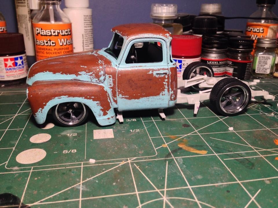

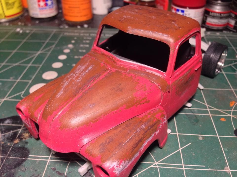

Here are the cabs after the method I have been describing. After getting them out of paint and letting them dry for a day or two the first thing I usually do is scuff the paint with some sand paper. I usually go over the whole body and sand heavier on the areas where I want rust to show through. The reason for that is because the paint is to thick for the water to penetrate. That's why it works best with an air brush cause you have a lot more control than your typical spray can. Once you apply water to the paint it will start to bubble as the hairspray dissolves. Then I just use a stiff brush to chip away the paint. Its a pretty simple process and I like look I can achieve with it. I still need to add a wash and some weathering powders to the cabs but that will come later. On the red truck I will try and get some better pictures of the body. My phones camera just doesn't show the true color of the red.

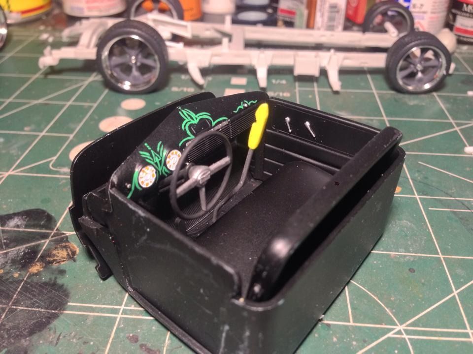

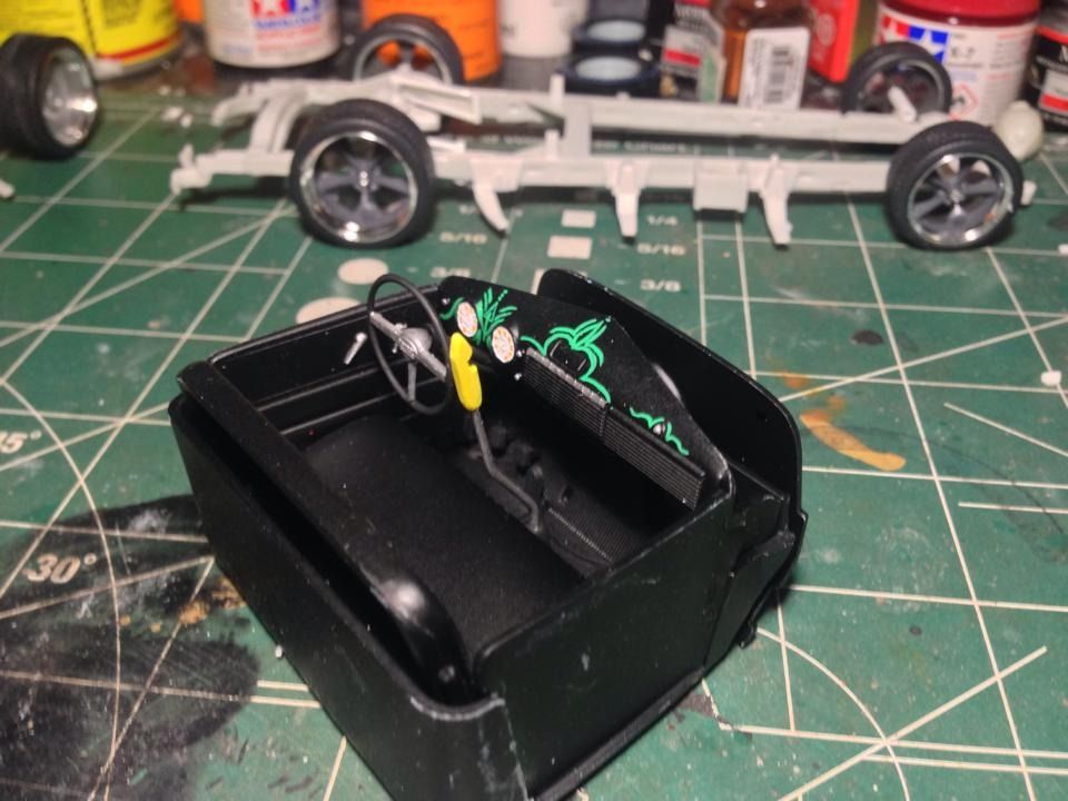

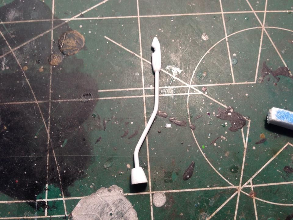

Here's the interior for the blue truck. The pinstriping has kinda been a signature thing for me on my last few trucks so I figured I would do it again. On the shifter I built it to resemble my shifter in my 1:1. I carved out a boot and surfboard from square stock. The surfboard is supposed to be like a landshark lager beer tap.

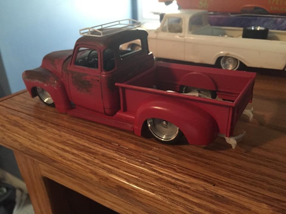

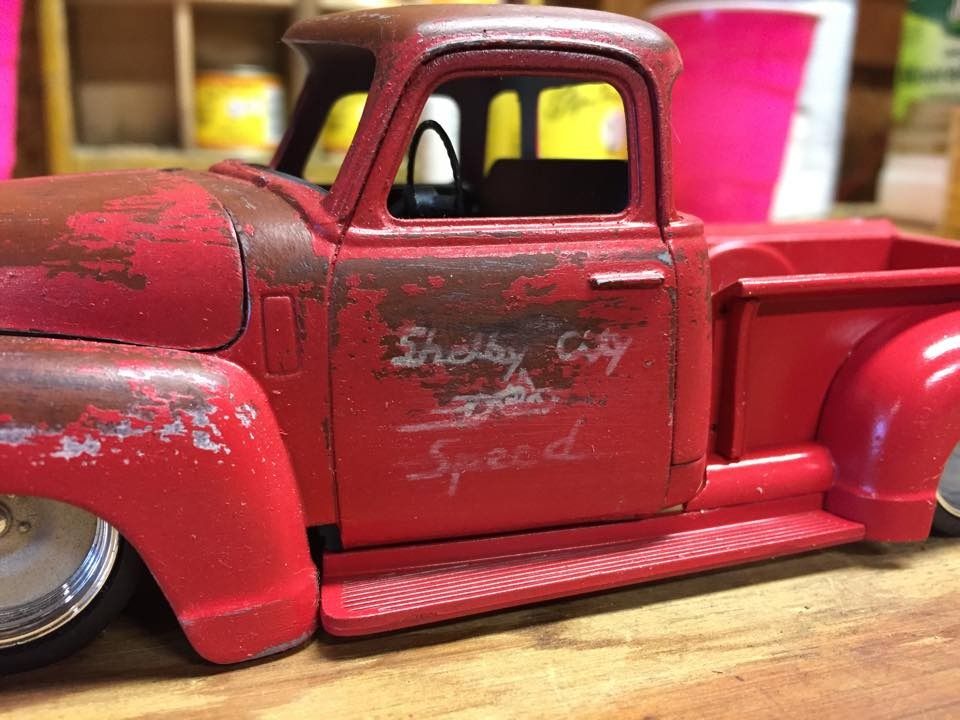

Finally got back on these trucks. Had a big set back, got my beds assembled and realized I forgot to spray the hair spray under the body color. So the beds are coming back apart and in the stripper to be repainted. Whats everyones thoughts on the roof rack? I tried out some door lettering last night and I am very pleased with it. Shelby City is the old part of my town that doesnt really exist anymore. I thought it fit the idea of an old speed shop so the name stuck. I've had a big obsession with old motorcycles here lately so that's where I came up with the idea.

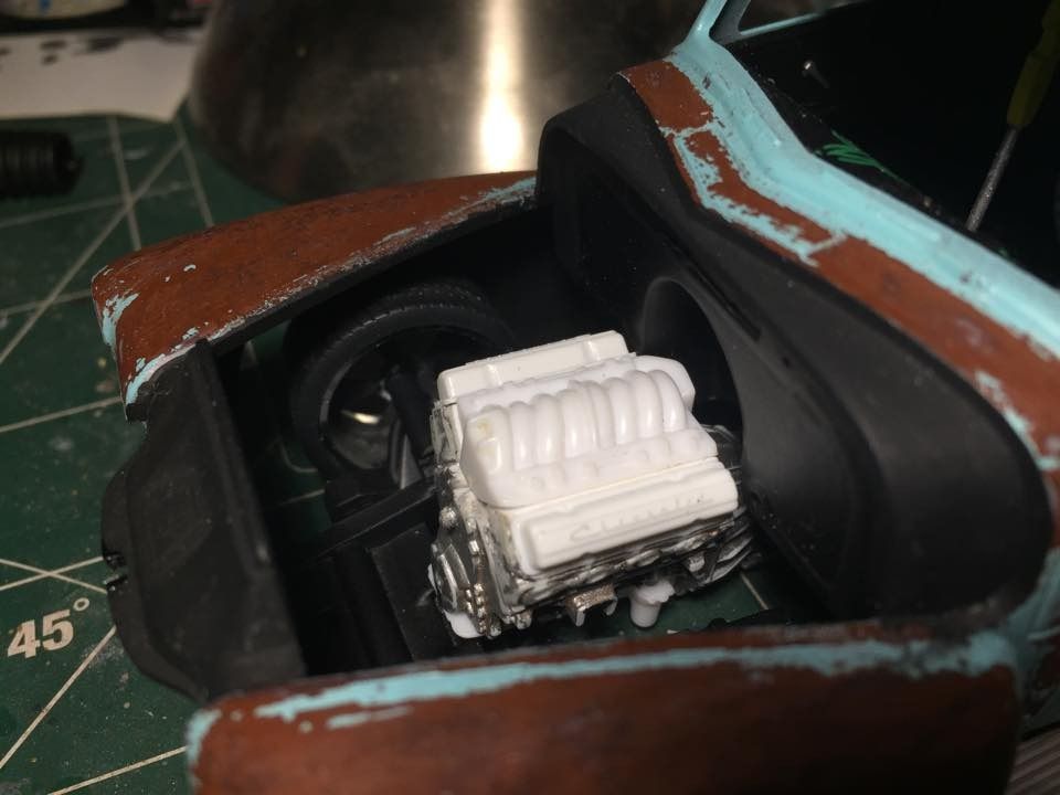

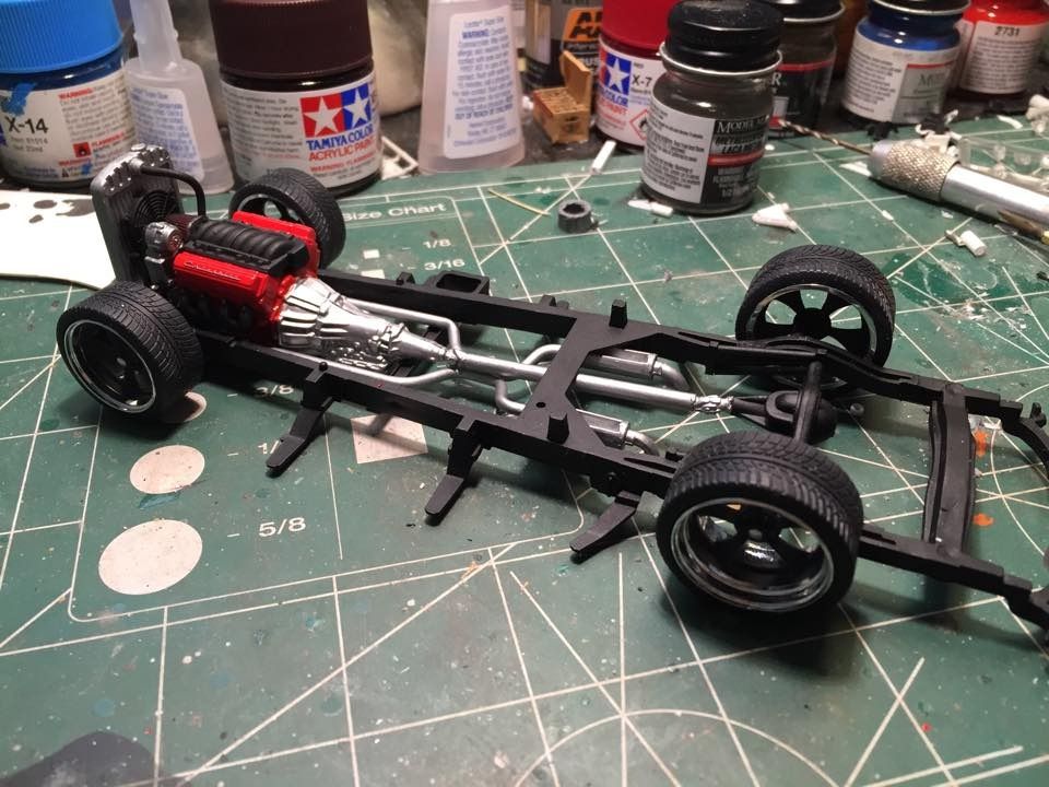

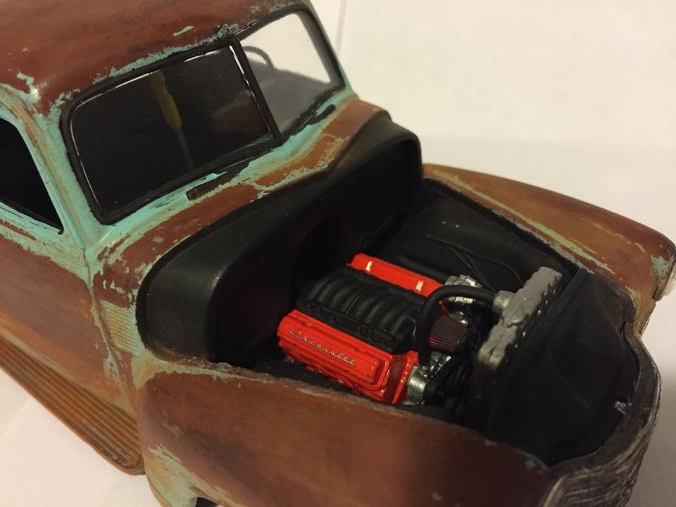

Here's another update on my builds. I have a contest next weekend some I am really gonna have to get after it and finish these up. I decided to LS swap the blue truck. I decided to give the LS a classic look with the script valve covers. I'll just relocate the coil packs to the firewall. The beds are going back in paint tonight.
