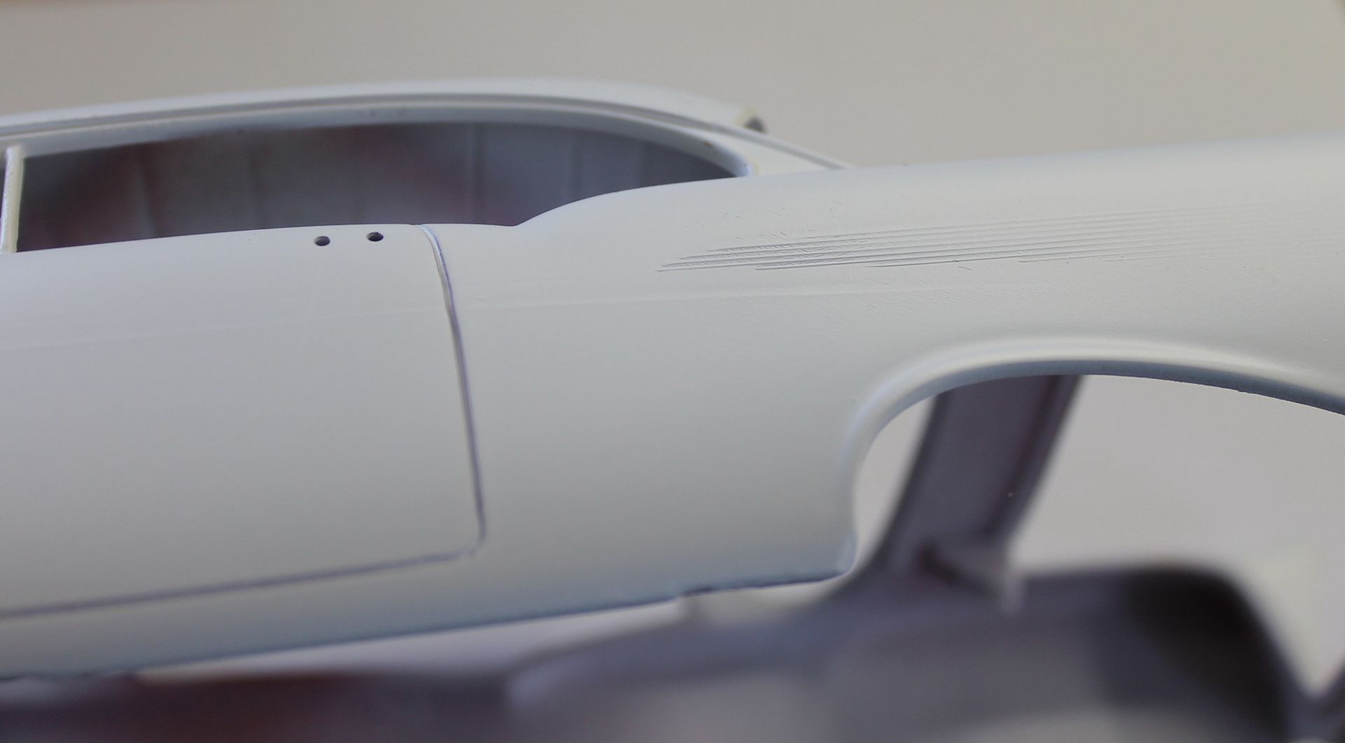

After lots of sanding I thought the sidetrim was gone, felt nothing with my fingertip and did not see anything either but after primer it sure came back again:huh:
After another round of sanding I thought I really had seen the last of the trim on the back but after a new layer of primer it was back again. Now the body has gone in the brakefluid bath and after that I will use filler and try to cover it over that way.

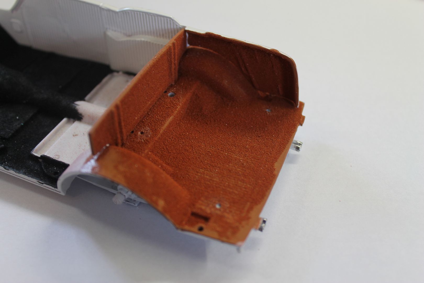

The trunk/luggage compartment. I have glued the rear wall behind the rearseat inplace but the sidepanel is in the picture only put there to show how it is going to look.

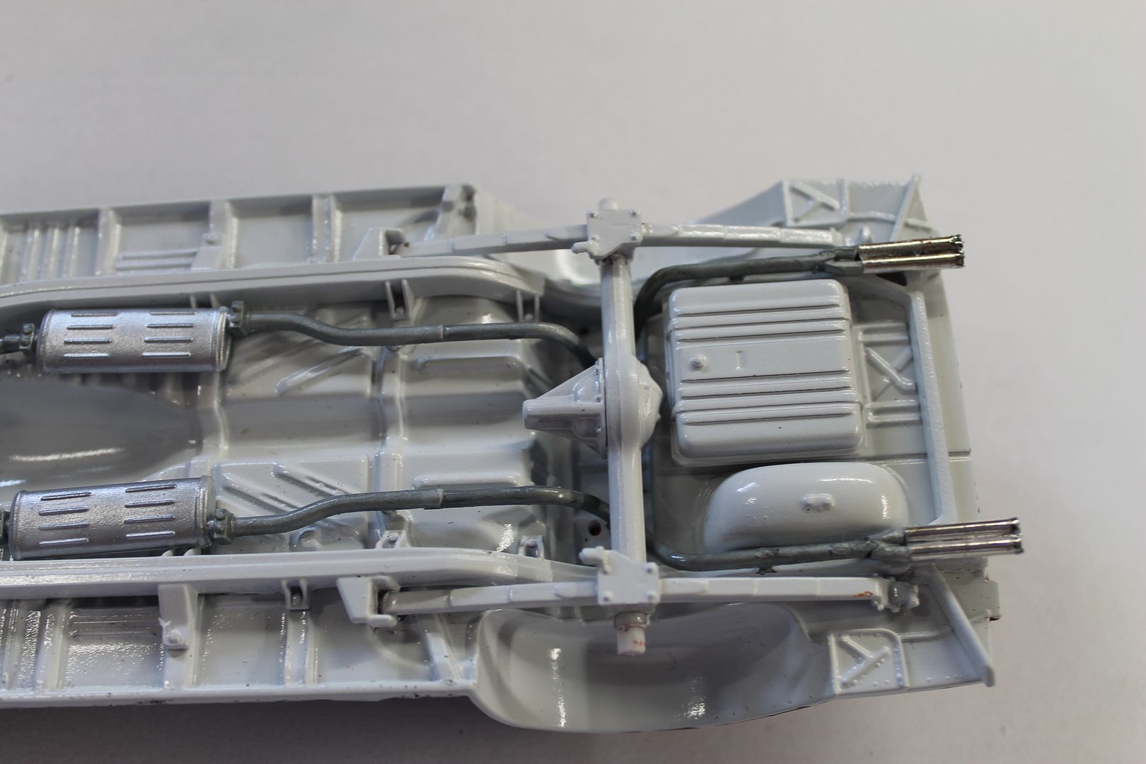

The exhaust is done and the rear axel with springs is in place
I think it looks strange with all being white under there and it is only my guess that it was this way on the moviecar.

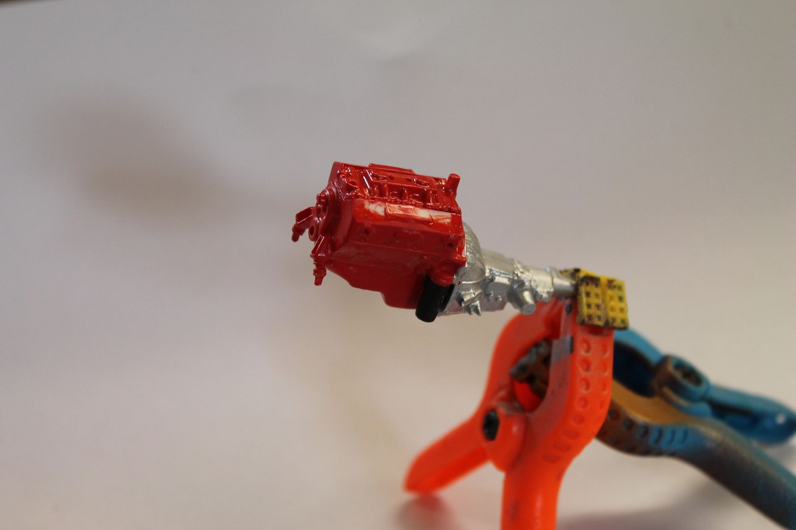

Engine is started. I painted the block with cylinderheads, intake and oilpan in the color I had that I think matches chevy engine red the closest. I think the movie car possibly could have had chrome valvecovers (despite not being able to see them in the film) so I will find some that will fit in my partsbox

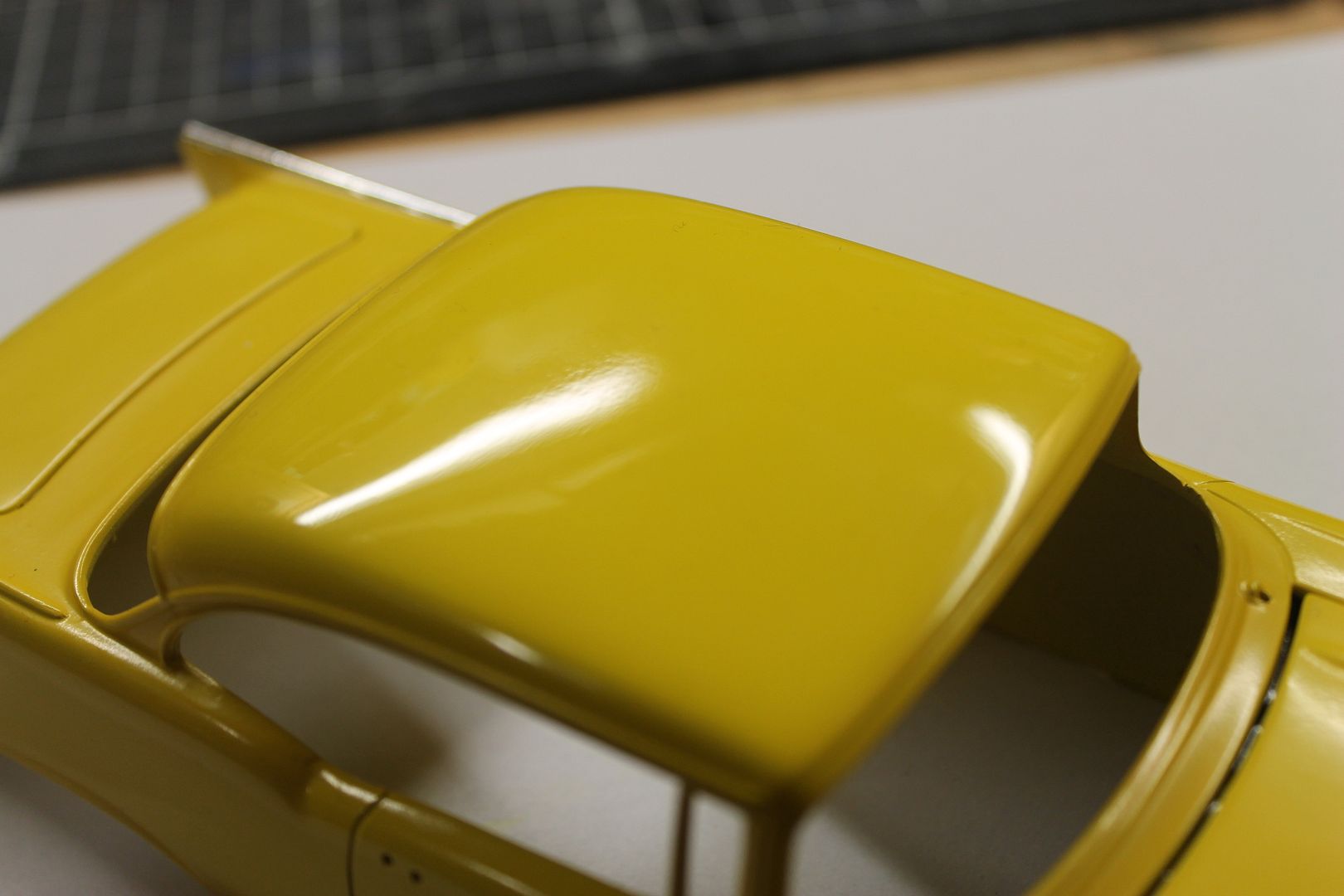

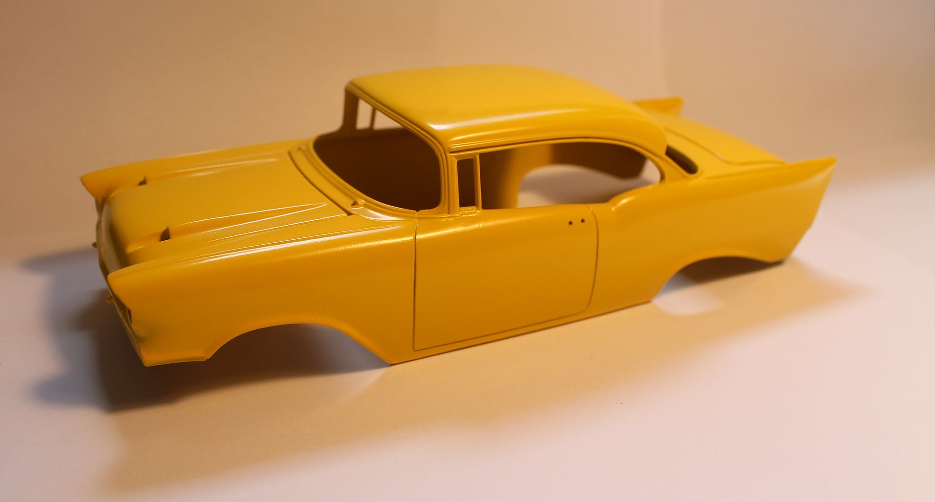

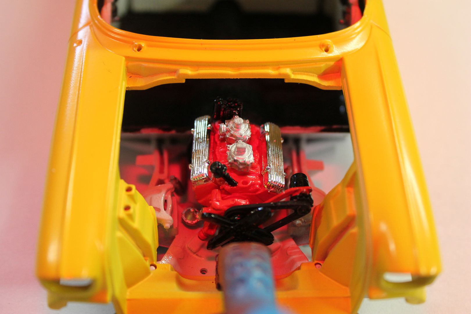

And here is the body in color!
This is what the Rape Yellow looks like on the body, I think it looks quite right.

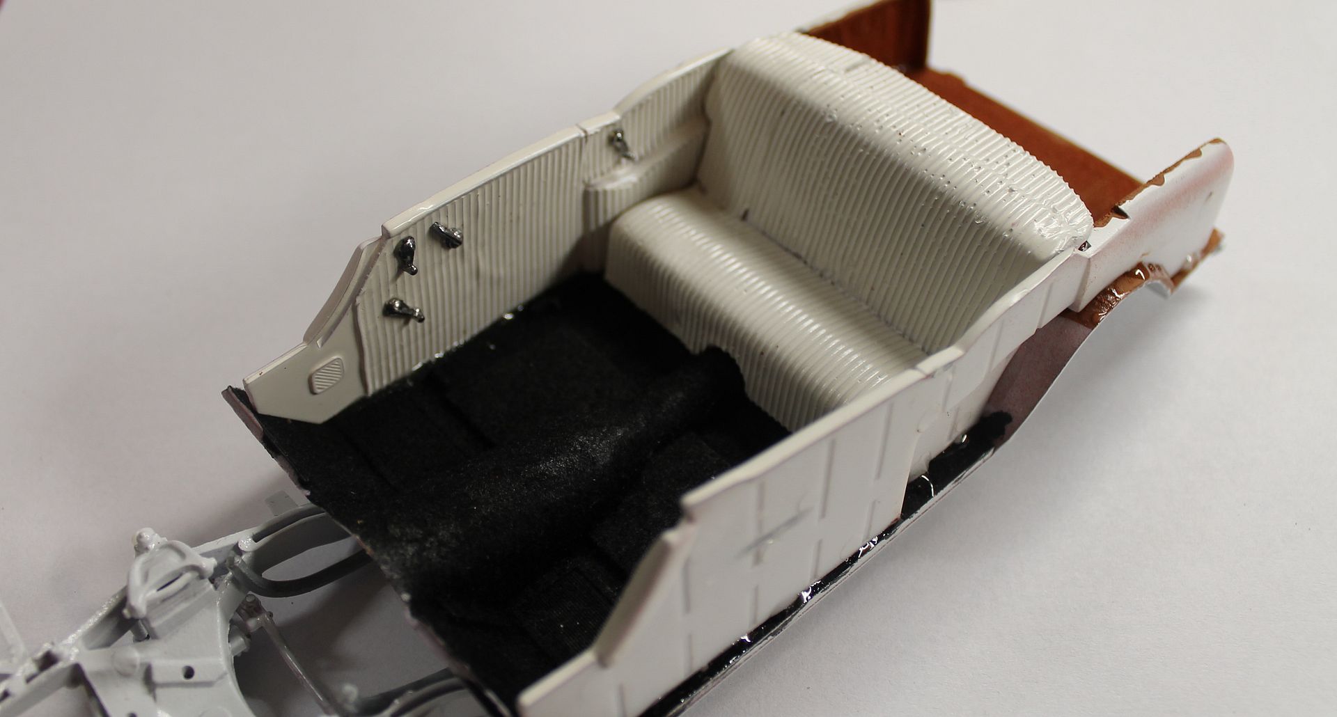

I have now mounted the sidepanels of the interior. I will redo the backseat as it did not turn out very well. I already have a batch of more Tuck'nRoll in the making.

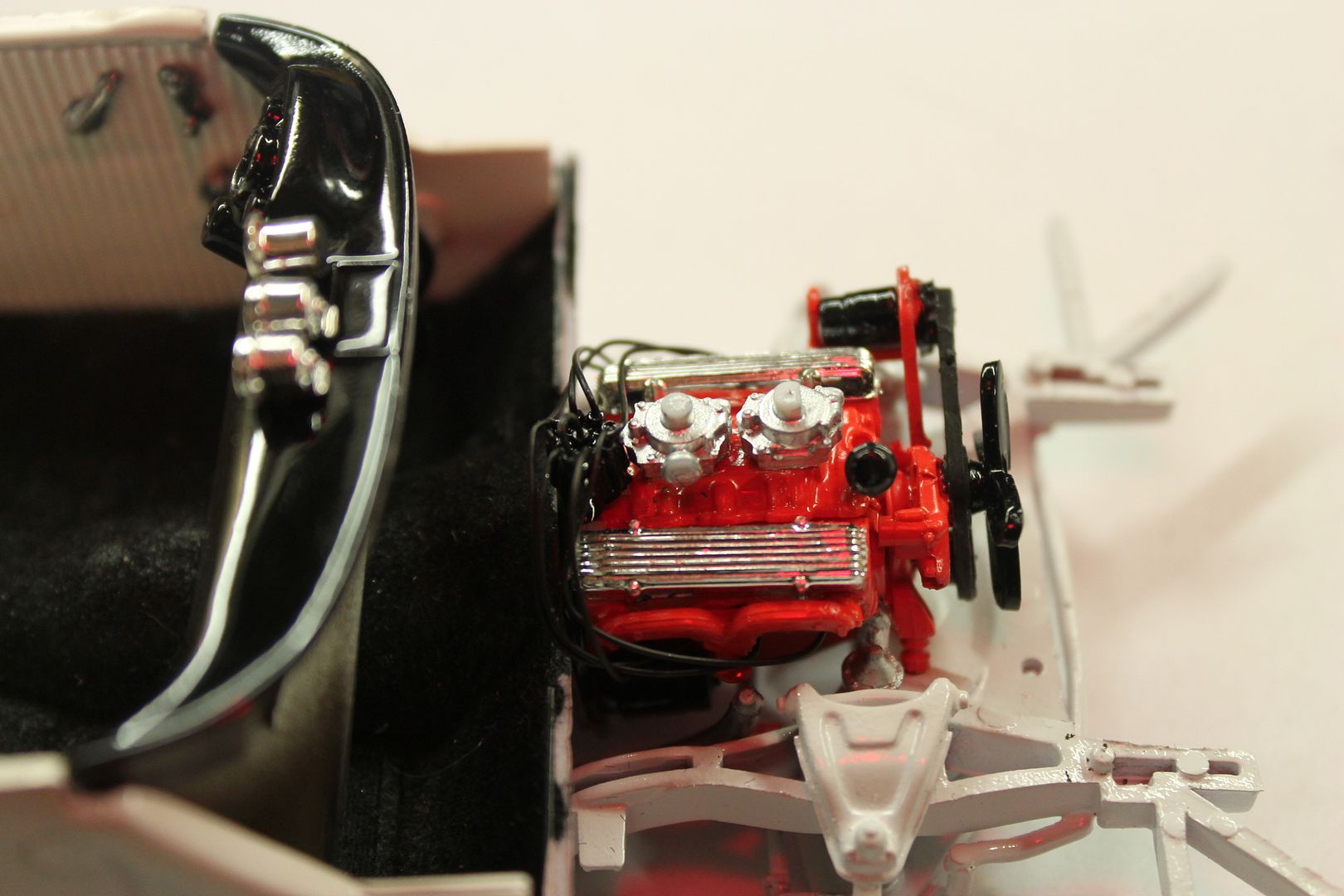

Well, I was thinking of doing more work on the engine and then remembered that there was a lot of small parts not having been painted yet so I spent some time on painting parts like the distributorcap, startermotor, fan, belts and pulleys and so on. But I did manage to put two parts on the engine aswell.

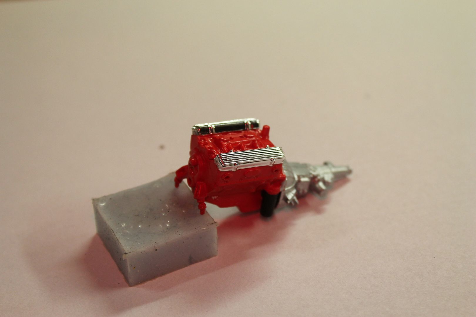

I can't make out what valvecovers are on the enigne in the movie but since there is a lot of other chromebits on it I figured they have put chromevalvecovers on aswell. I found a couple that matched the size in my partsbox and glued them in place.

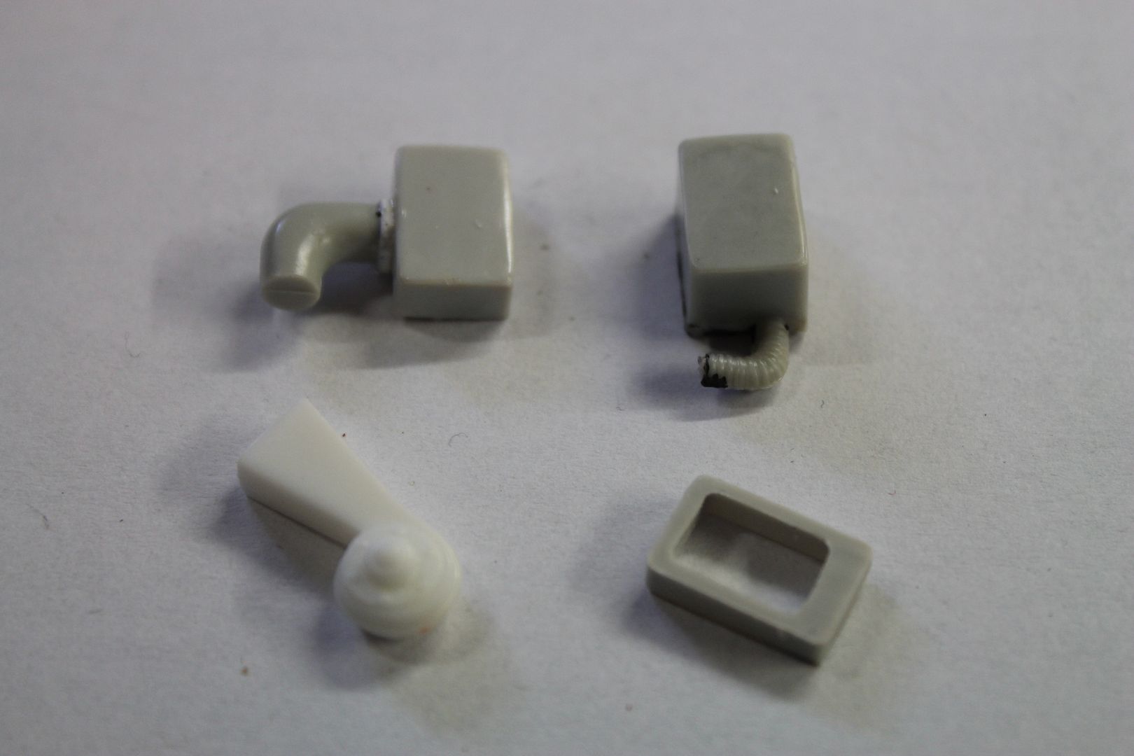

Here is another small update, I have started to modify the Paxton parts from AMT 57 Ford so that it will look like the setup in the movie. Modified part on the top left with what I have sawed off it at the bottom right and original AMT 57 Ford part on the top right. On the bottom left is the heaterfan box from the kit that I will modify to look like the "supercharger" in the movie.
I have also built up most of the engine, will add plugwires later.

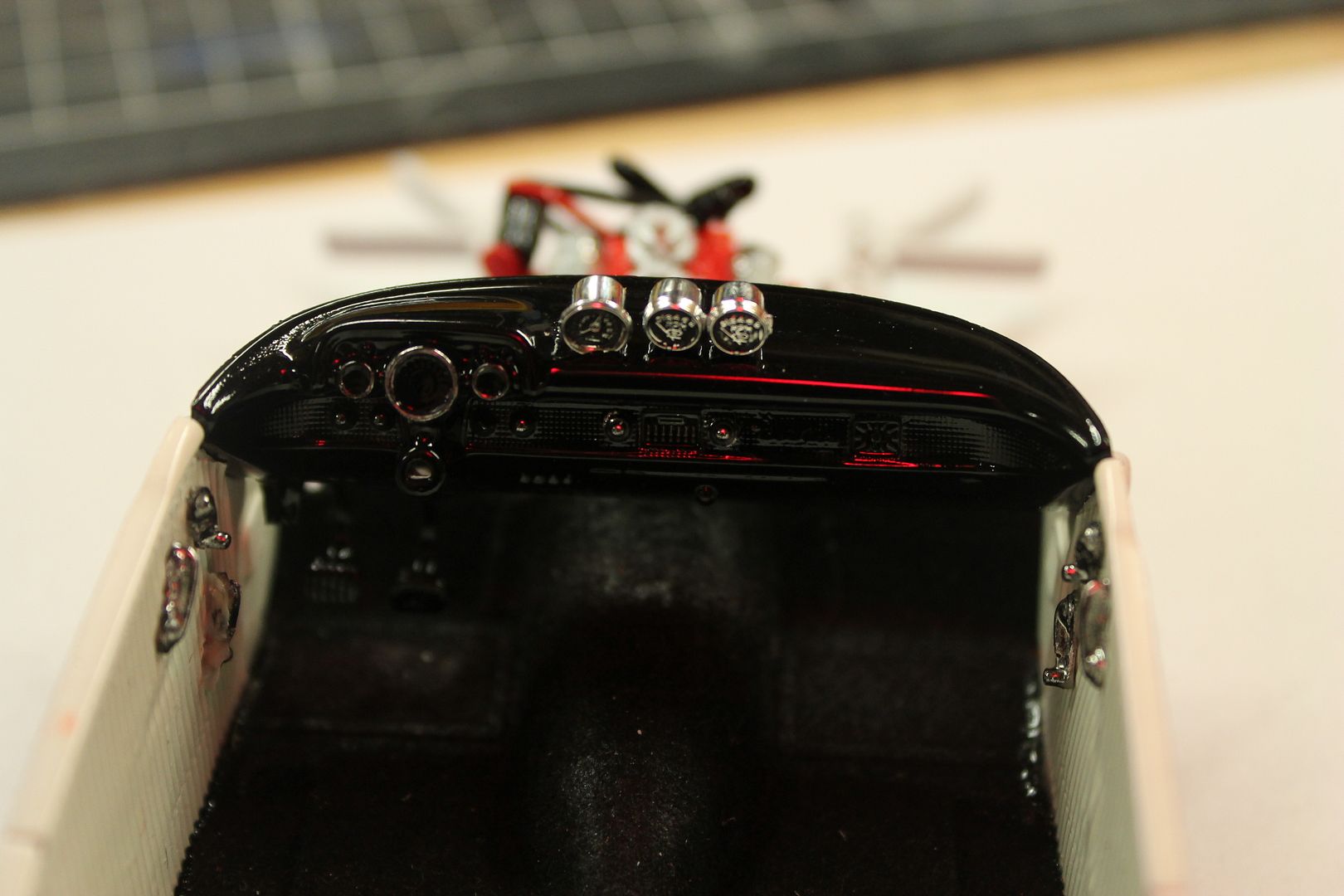

I have also found extra instruments to put on the dash, they are still not glued in place but in the picture you see how it will look. Not exactly like the film but close enough.
