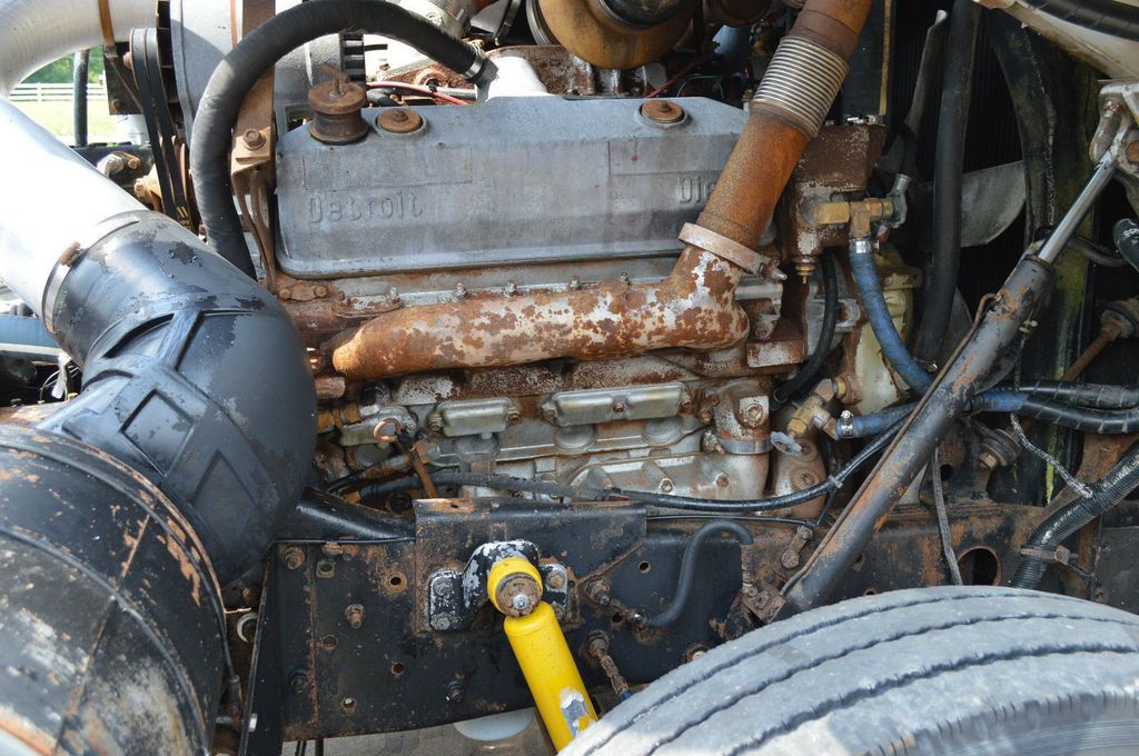

DRIPTROIT 71 Posted June 17, 2015 Share Posted June 17, 2015 Here is a photo. You can see the water shut off valves where the heater hoses are located. Quote Link to comment Share on other sites More sharing options...

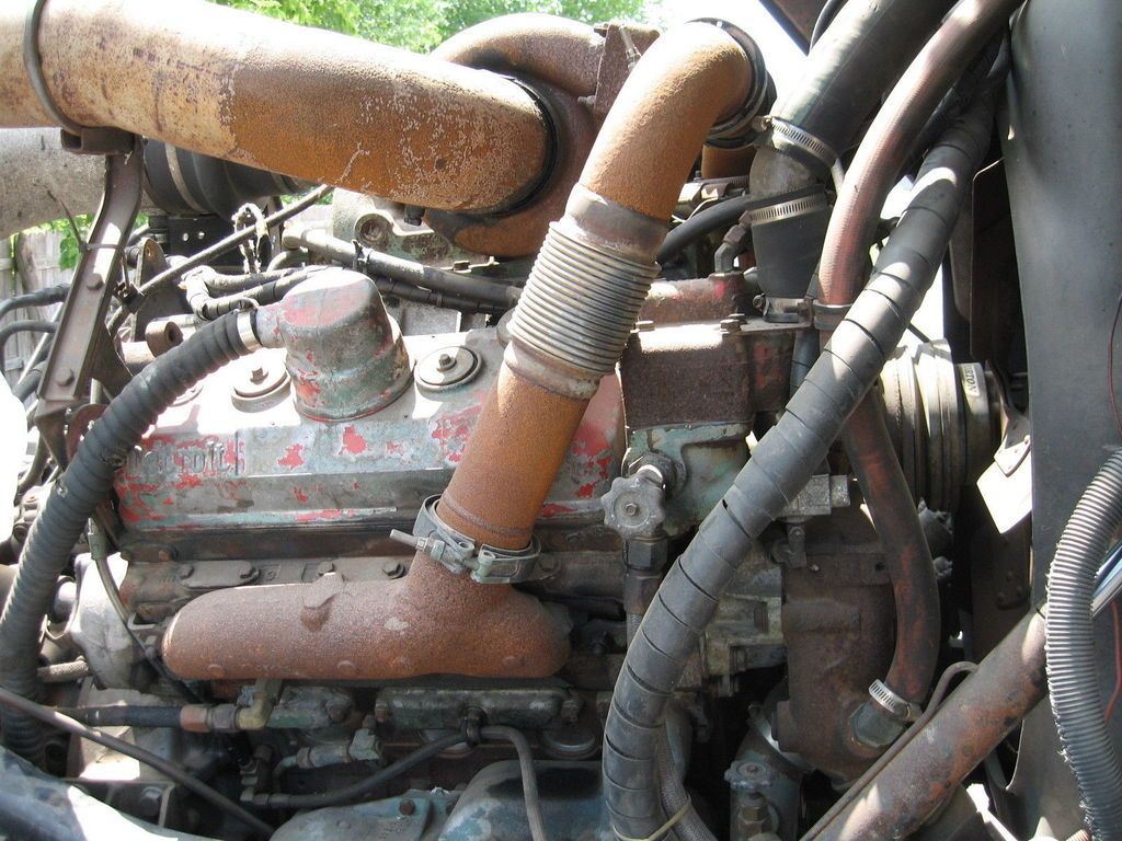

DRIPTROIT 71 Posted June 17, 2015 Share Posted June 17, 2015 This is an 8v-92 but it's a little more clear. Quote Link to comment Share on other sites More sharing options...
DRIPTROIT 71 Posted June 17, 2015 Share Posted June 17, 2015 Generally there are several plugs in those two areas where water outlets can be placed. The 6v-92 pictured seems to have two sets of hoses. One set may be for a coolant filter, but this gives the general idea of where to run your hoses. The 8v-92 gives a clearer picture. I'm looking forward to seeing this one finished! Quote Link to comment Share on other sites More sharing options...
olsbooks Posted June 18, 2015 Share Posted June 18, 2015 Good pix Brian. Thanks. I had long forgotten that more often than not, these things had a manual shut off gate valve in highway applications. My final years in this racket was off highway and had been forgotten. I got a 1/16 8V92 I am working on for a General and will need to go back and fab some up. Peace. Quote Link to comment Share on other sites More sharing options...
