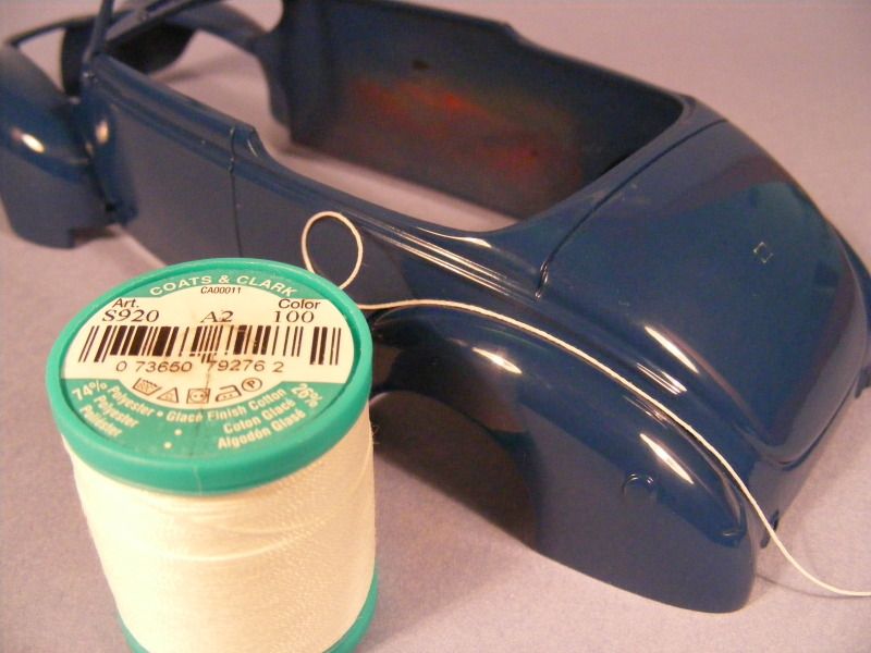

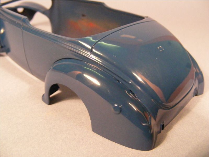

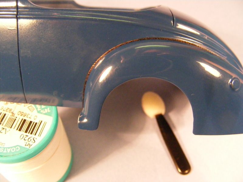

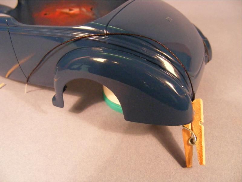

BigTallDad Posted May 8, 2015 Posted May 8, 2015 (edited) When I built it, I found that the rear fenders are separate from the body and need to be glued on. No matter how I fussed and fiddled with the alignment, there's still a gap. Here's a shot of the fender/body gap on the model. Here's a shot showing (for photographic purposes) the white thread I'm using. It's Button & Carpet, 74% synthetic and 26% cotton. The cotton lends itself to magic markers as well as Elmer's white cement. After coloring with a magic marker, run the thread through some Elmer's white glue and wipe off the excess. Using a doll-house clothes pin, secure one end then push the remaining thread into place. Here's what it looks like after the glue has dried and the ends are trimmed off. Any excess glue can be removed with a swab and Windex. The final results. This will look great under some Tamiya TS-13 clear. Edited May 8, 2015 by BigTallDad
