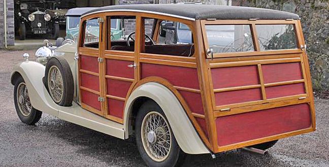

Harry P. Posted May 9, 2015 Posted May 9, 2015 This is a project that has been kicking around in my cranium for literally years. This is what I have in mind (not necessarily this exact car, but something similar): My first plan was to use the Pocher "Star of India" RR as the donor kit. I even went so far as to buy a Pocher "Star of India" RR for mucho bucks. with the intention of going ahead with this project. But for some reason, I was never able to pull the trigger. I went over the building sequence in my head dozens of times... but every time, I decided that it was just too much of a project. Scratchbuilding a 1/8 scale woody body just seemed like a mountain I couldn't climb... and the project stalled. I still have the Pocher "Star of India" kit... still unstarted. Maybe someday I'll build it. But I finally decided to actually do this project–in a smaller (and hopefully easier) scale. Since I have amassed quite a collection of classics in 1/16 scale (as those of you who follow my posts already know), I figured it made sense to do my RR woody at that scale. From what I found out doing my research, it seems that most RR woodies (or "shooting brakes" or "estate wagons" to use the proper British terms) were based on the Phantom III. So step one was to find a suitable kit. I bought this Entex Phantom III on ebay, from a seller that described it as a "junkyard kit"... The reason the ebay seller described the kit as a "junkyard kit" was that there were a lot of broken pieces. The fenders, the frame rails, many smaller frame and suspension parts were literally broken in pieces. I have no idea how that happened, but I got the kit for a steal because of the "junkyard" status. Turns out that all the broken bits were in the box... the kit was complete. A little gluing together of various parts here and there and the kit was good to go. The only rub was that the instruction booklet was missing, but as usual, MCM forum members came to the rescue,

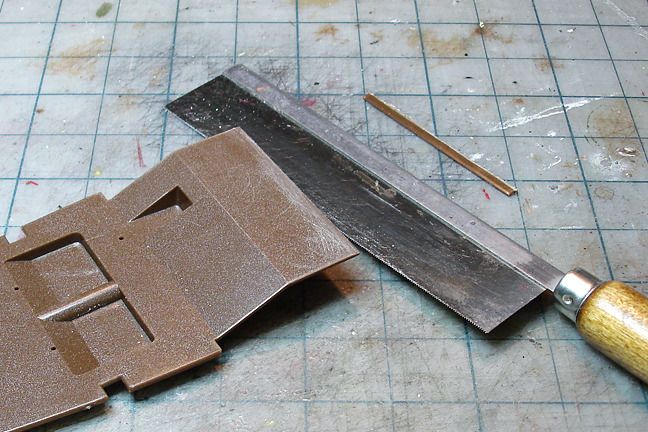

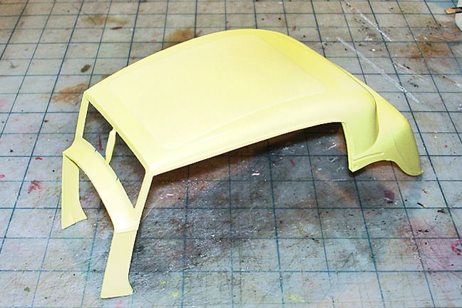

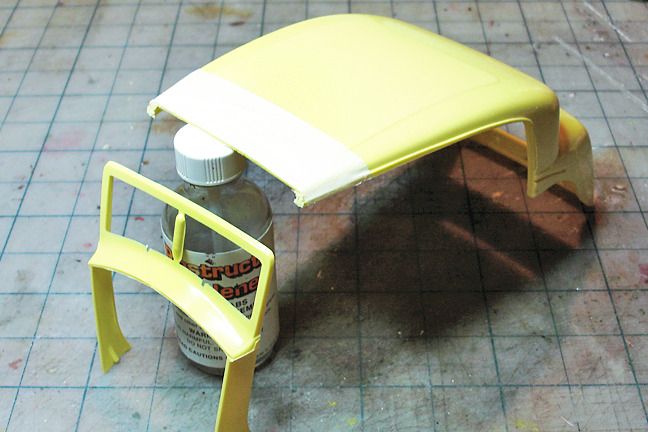

Harry P. Posted May 9, 2015 Author Posted May 9, 2015 Let's get started. I jump around while I build... might work on the chassis a while, jump to the interior/dash, back to the engine, etc. The first thing I'll do is get rid of what I don't need. Here's the stock body: The only part of this that I need is the cowl and windshield frame. All else will be scratchbuilt. So let's cut the portion I need from the portion I don't. A razor saw makes quick work of it... Everything from the cowl back goes in the trash...

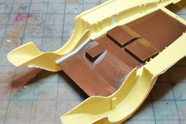

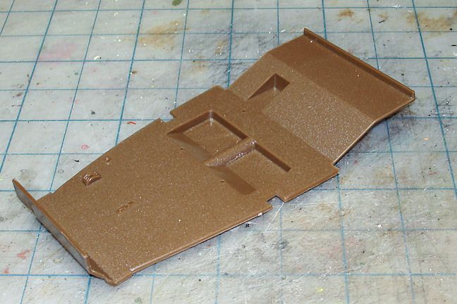

Harry P. Posted May 10, 2015 Author Posted May 10, 2015 The floor ends where the trunk begins. The woody body obviously doesn't have a trunk, so I'll need to extend the floor back to meet the rear wall of the woody body. I'll need to get rid of that raised edge at the back... Once again, a razor saw makes the job easy... Once I have the new body developed further, I'll know exactly how far I'll need to extend that floor backwards.

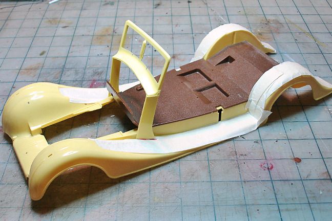

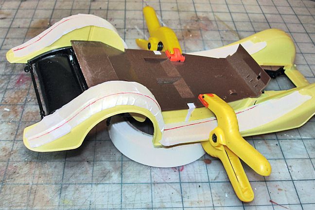

Harry P. Posted May 10, 2015 Author Posted May 10, 2015 In building the woody body. I'll need a solid base to build on and to mark the various reference points. I glued the broken fender unit together, then glued the altered floorboard in place. Then I covered the fenders and running boards with masking tape and temporarily added the cowl in place. I used a red Sharpie to mark on the running boards where the outer surface of the cowl is... Then I used the Sharpie to draw a line along the running boards and rear fenders to represent the outer edge of the woody body:
Harry P. Posted May 10, 2015 Author Posted May 10, 2015 Because the body sides of the woody will be fairly straight vertically and not "tuck under" at the running boards like the sheetmetal of the stock body and doors, the woody body will be wider at the base then the stock sheetmetal body would be. That means I can't use the kit's door posts as is... I'll have to move the door posts further out a bit. So I filled the openings where the stock doorposts would go with sheet styrene...
Harry P. Posted May 10, 2015 Author Posted May 10, 2015 Because the fenders/floorboard unit will get a lot of handling as I build the body, I want all glue joints to be extra strong. I didn't want to rely on only the edges of the floorboard gluing to the rear fenders, I wanted a meatier joint. So I added lengths of square styrene rod to reinforce that joint (after making sure there was enough clearance between the frame rails and the underside of the floor. Liquid cement is the way to go...

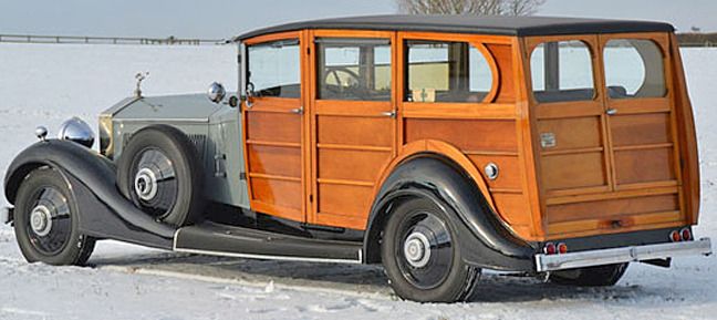

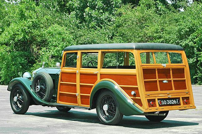

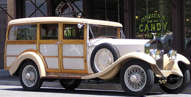

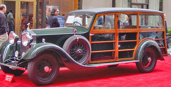

Harry P. Posted May 10, 2015 Author Posted May 10, 2015 Here are a few more examples. As you can see, no two are exactly alike, they were all custom-bodied... which means that no matter how I build mine, I can't be wrong! I'm going to take a detail from one, a detail from another, make up a few details, and create my own design.
Harry P. Posted May 10, 2015 Author Posted May 10, 2015 Sure-you don't have to lace these....you scoundrel. And I'm going with the full wheel covers, too. Like this one...
Cato Posted May 10, 2015 Posted May 10, 2015 That's a good thing in this scale. This last one looks like a poor job of coachbuilding - roof sags and looks like the body broke apart. All the horizontal lines are on different planes. The first one seems the best with straight hood, roof, side panels and good swoopy fenders. Tiny tires for carrying loads though...

Harry P. Posted May 10, 2015 Author Posted May 10, 2015 That's a good thing in this scale. This last one looks like a poor job of coachbuilding - roof sags and looks like the body broke apart. All the horizontal lines are on different planes. It looks like the Pontiac Aztec of RR woodies!
