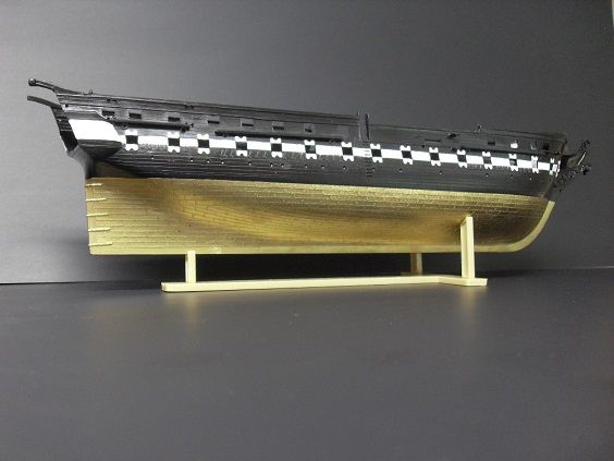

This is going to be my first ship model! It's the 1/196 Revell U.S.S. Constitution, I was so excited about getting it, that I started on it immediately.....
My main reason for putting up a WIP is that I'll have a lot of questions as I go.......
This is a couple days in, feel free to tell me what you think.....!!

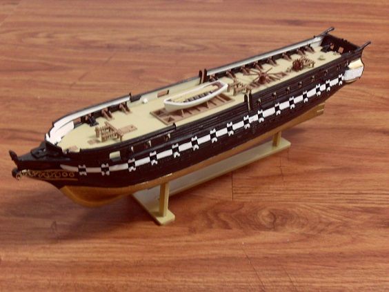

Hey, friend.... The gold color doesn't look very realistic for copper, does it? Maybe there is a way to tone it down some? I'm open to suggestions......
Accurate or not, I'm having lots of fun! I'm mounting the lower cannons now......... :)
I'm no expert ship modeler, but I'm thinking for this scale (1/196) your best bet is Testors Copper paint. Maybe with a black wash or Dul-Coat to tone it down a little. Here is the Testors Copper on the deflector dish of my 1/2500 USS Enterprise. I think it will fit the bill for what you're looking for.

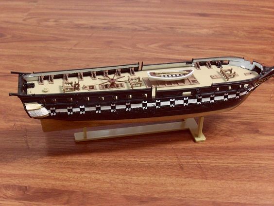

Here I have the deck pretty much finished....... still some touch-up to do. I had to use a pin vise on the holes for the cannon barrels, as they were too tight a fit.......
Again, it's probably not accurate, but I'm having a blast....!!
Testors makes a nice copper, I'd spray it with that. Nice progress otherwise though.

Looks really great so far I did this ship when I was in my late teens as I remember it builds into a lovely ship. I've just discovered guilding and I know they do copper leaf have you thought of using that it's dead easy and of course if you wet it being actual copper you would get a very real look. Now I've done some guilding I will use metal leaf wherever I need a real metal look.

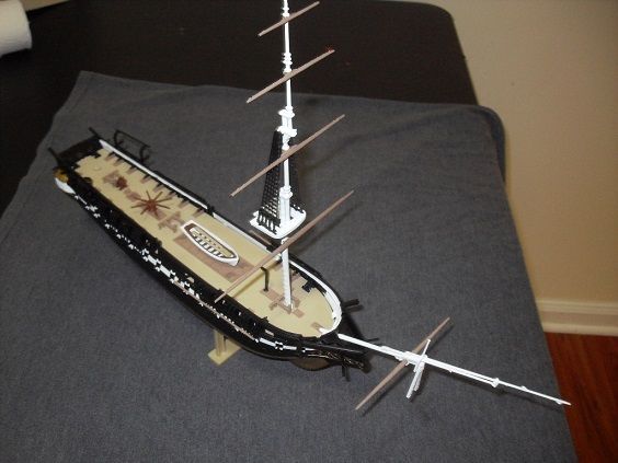

Here's the front mast standing! It's not glued in place, yet....... A question for anyone who has built this, would it be easier to tie the sails to the yards before I stand the masts?
I was looking through the instructions, and it says to stand all the masts, then tie the sails, but that looks to be pretty difficult...........
Interested to hear what you have to say, and thanks for looking in........!!
I think you might want to do some of the standing rigging before you add the sails as I would be quite difficult after the sails are added so I would suggest glue them in first. But hey its your model do it you're way.
I agree with Ken, Standing rigging, sails, running rigging. Good luck. It's looking really nice.

Thanks, Ken and James......... I'll do as the instructions say and as you guys say. Learning as I go that this isn't a car model, and it's best to follow the order suggested....
Thanks again......!! :)
What I did with my Thermopylae as to mount the foremast,tie the ratlines,put on the standing rigging and shrouds and then tied the sails to the yards off of the model.Then I mounted the yards up then did the running rigging.

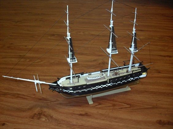

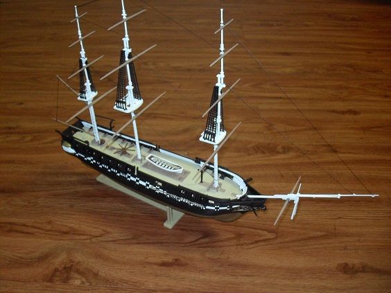

Here is the masts all standing....!! I also ran the basic rigging. The color of the photos is way off, but it was the only way I could capture the rigging well.....
Feel free to comment, it's always appreciated.......! :)
