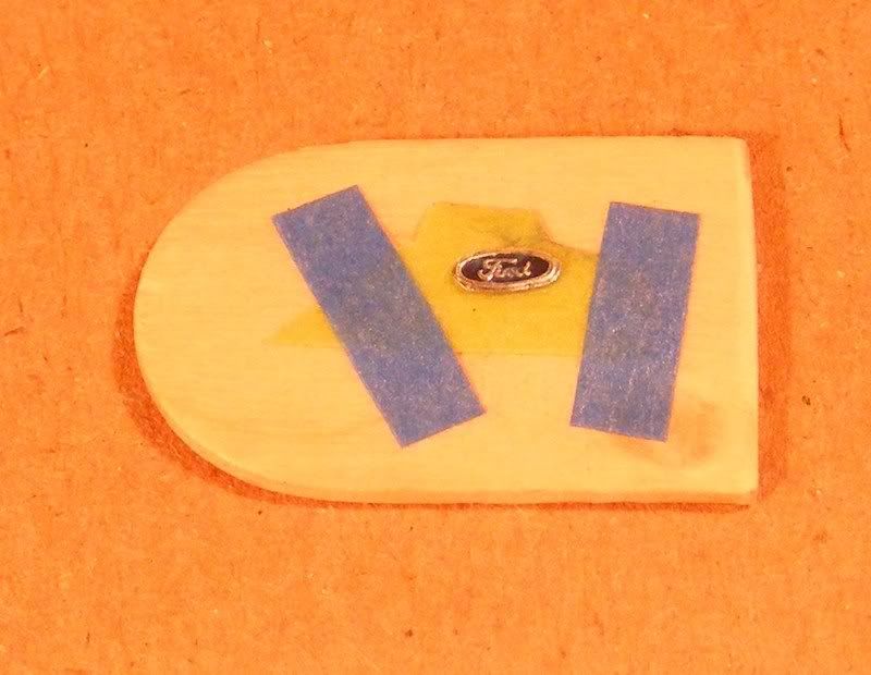

Owing to the poor casting of the hood emblem, I had to scratch-build one. Some aluminum foil burnished over the trunk emblem then back-filled with epoxy worked pretty well.

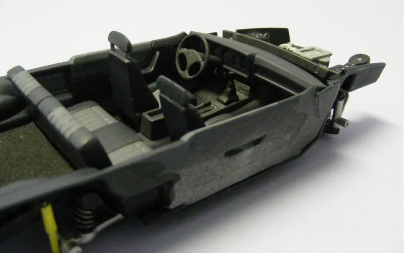

The interior was straght-forward. I raised the driver's seat headrest up just for giggles, then used prismacolor silver pencil to do the edging.

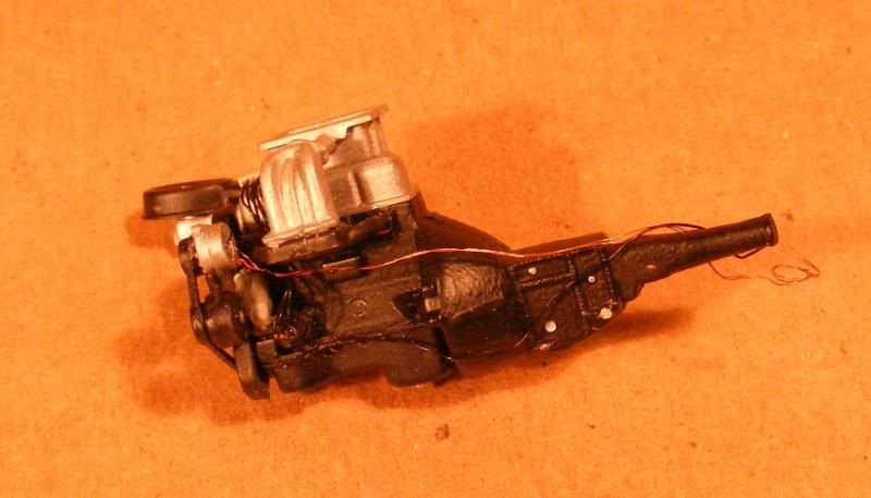

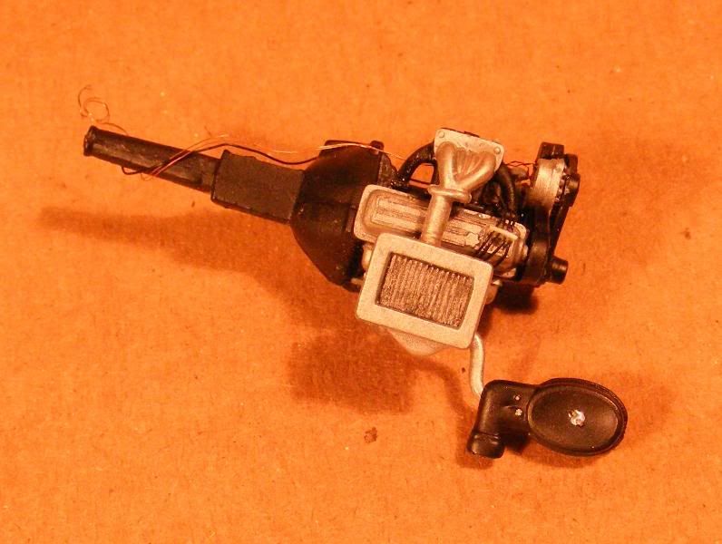

Got the engine ready to go; other than the scratch-built loom for the plug wires and washing the intercooler, there is nothing out of the ordinary.
I really need to get a better photography set up!

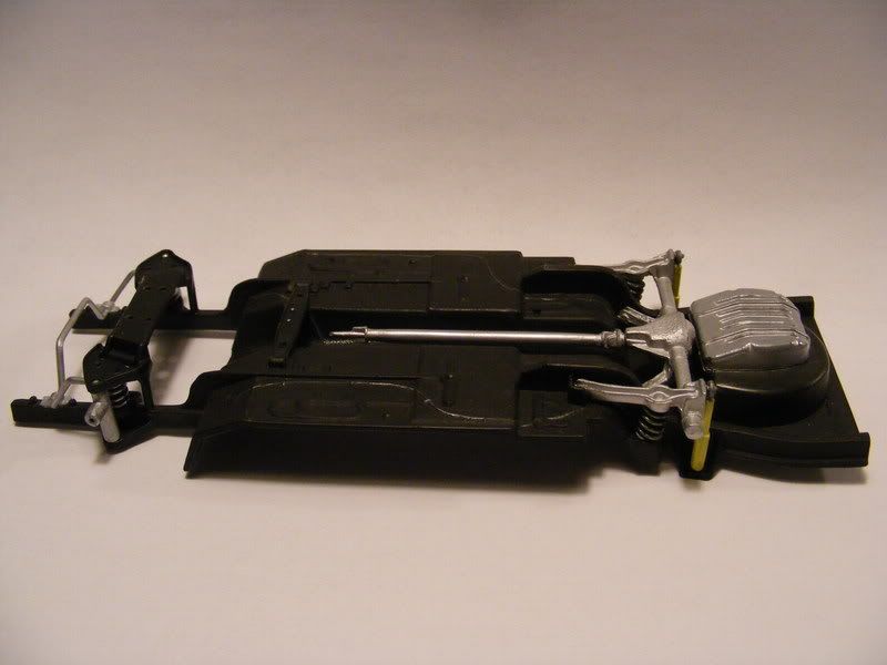

Cleaned all the flash from the coil springs, sprayed 'em flat black then highlighted the coils. Used a prismacolor silver pencil to highlight the brake and fuel lines.

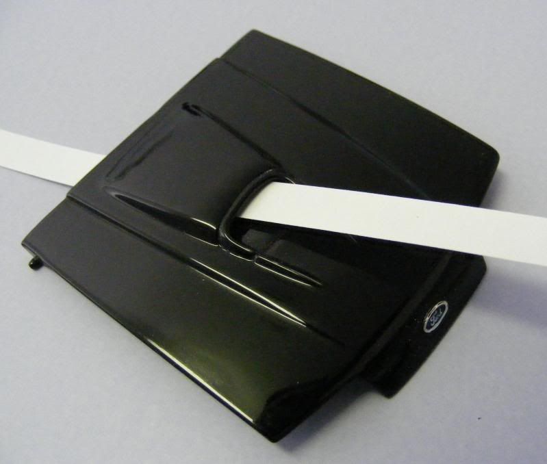

got the hood done, complete with functional scoop (this one is different, the scoop directs the air over the intercooler) and am applying some coats to the body.

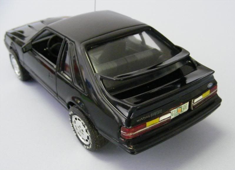

Maybe I could have sub-titled this SVO project "Details without Dollars". Here are the rear lenses: I used automotive lens repair tape (amber) for the turn signals, and the backup areas of the lenses are painted off-white.

The SVO hood has a scoop that directs fresh air over the intercooler; the kit didn't. I opened the hole in the top, then built up the tunnel underneath. That white streak you see is a strip of paper. You can also see the scratch built (foil casting) hood emblem in place.
The interior tub is also assembled. In the cheap details category, I raised the headrest on the driver's seat and (although difficult to see from this angle) reclined the passenger's seat just a little.

The amber is, IMHO, too bright but what you see is what you get. The vacu-form sealed beams are hard to distinguish, but the scratch-built hood ornament looks good.
A shot from the passenger side
A shot from the other side. On this one, I put the BMF on before I painted it, then used lacquer thinner to remove the paint from the MUSTANG word. The kit-supplied SVO decal is lame at best.
