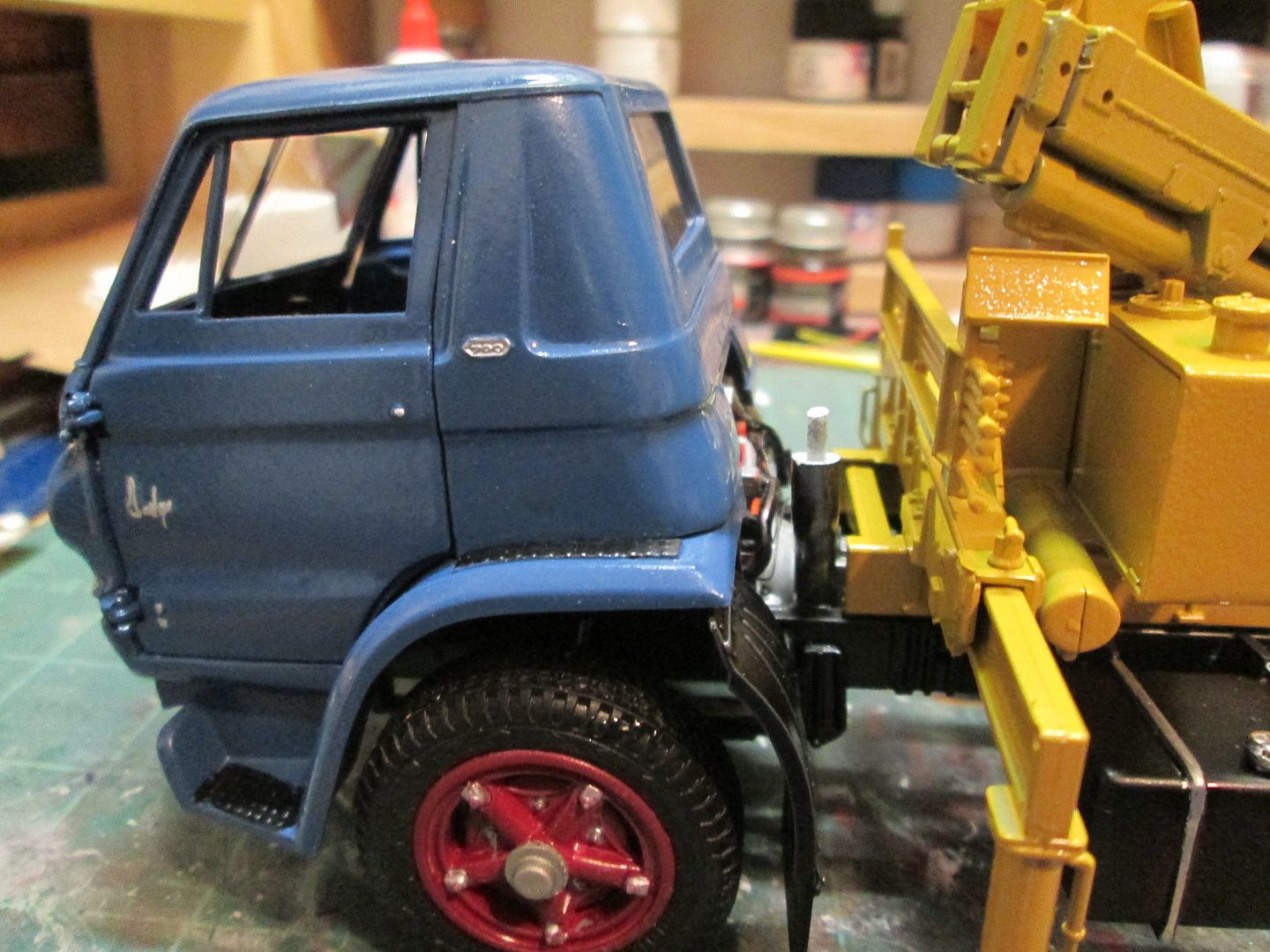

landman Posted July 15, 2015 Author Posted July 15, 2015 (edited) Gator, that tank isn't glued yet and the outrigger clears it if it isn't retracted fully, but yes, I think I'll move it back a bit. The crane is assembled. Still needs paint & detailing. Edited December 21, 2020 by landman
gatorincebu Posted July 15, 2015 Posted July 15, 2015 Pat, Looking good! I like your detailing so far. Be Well Gator

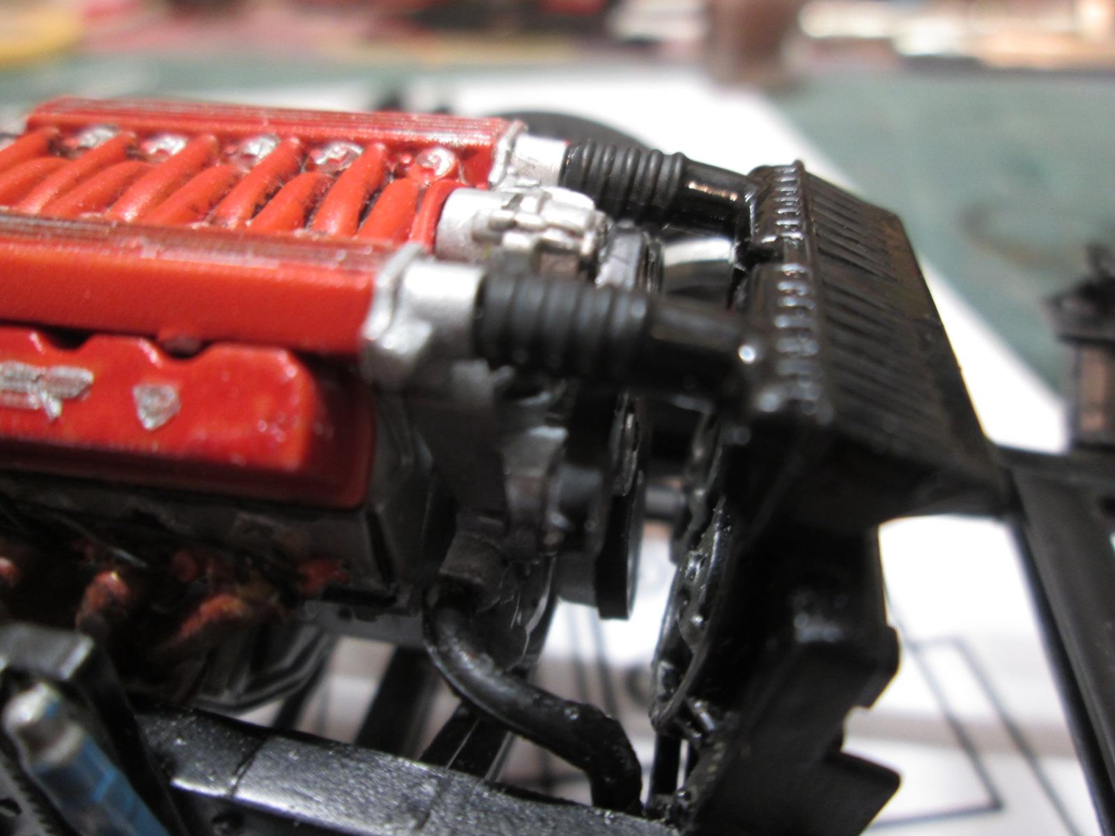

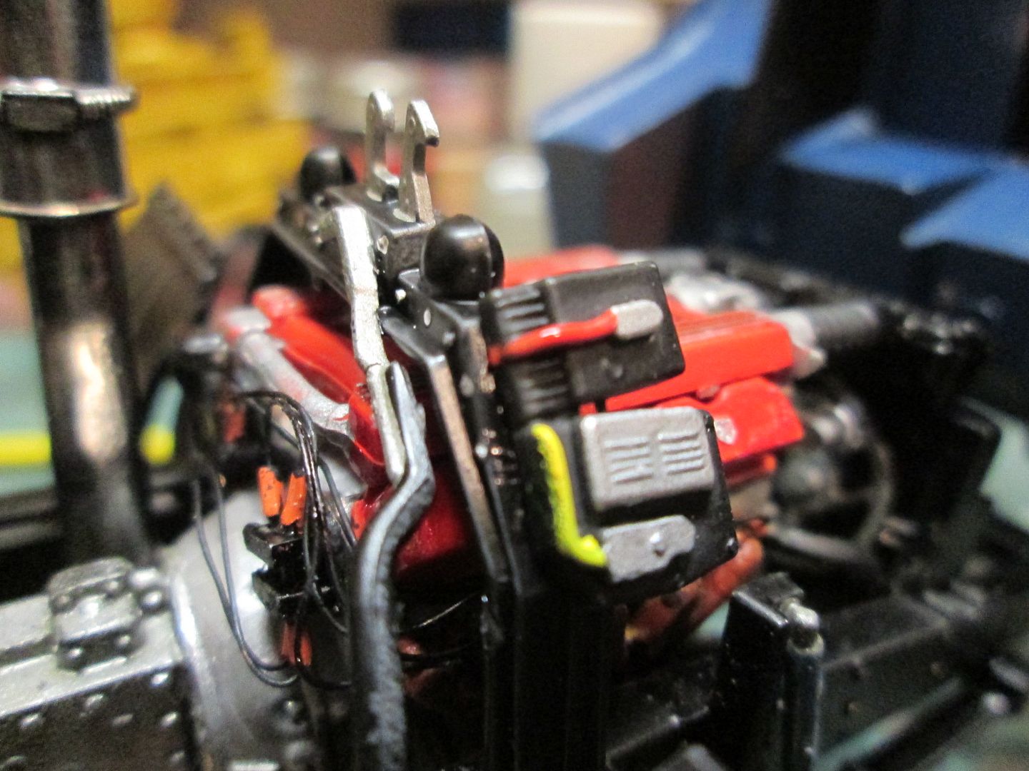

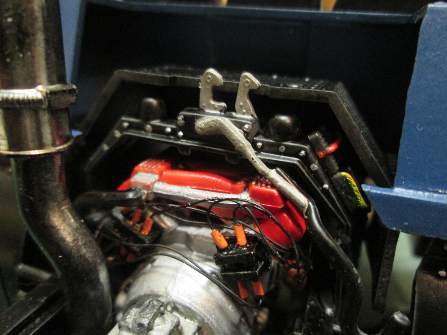

landman Posted July 18, 2015 Author Posted July 18, 2015 (edited) Amazing. This forum doesn't work at all now on my Internet Explorer. Had to go into Google Chrome to get it. On the other one I only see part of the stuff. Anyway, do you think I can swing this? Never did a correct firing order before. At least I have the coils in the right position. Added the wires, the rad hoses and the air intake. Edited December 21, 2020 by landman
gatorincebu Posted July 18, 2015 Posted July 18, 2015 Pat, I agree with Ken. This one is looking real good! As for the plug wires. Looks to me like you did a fine job on them. Be Well Gator
landman Posted July 18, 2015 Author Posted July 18, 2015 (edited) Thanks guys. Marc, when I set out I had my PE wire looms out to make things orderly. I got so engrossed I never saw them until i had about 75% of them in place. I hope it has nothing to do with age. Edited July 18, 2015 by landman Spelling

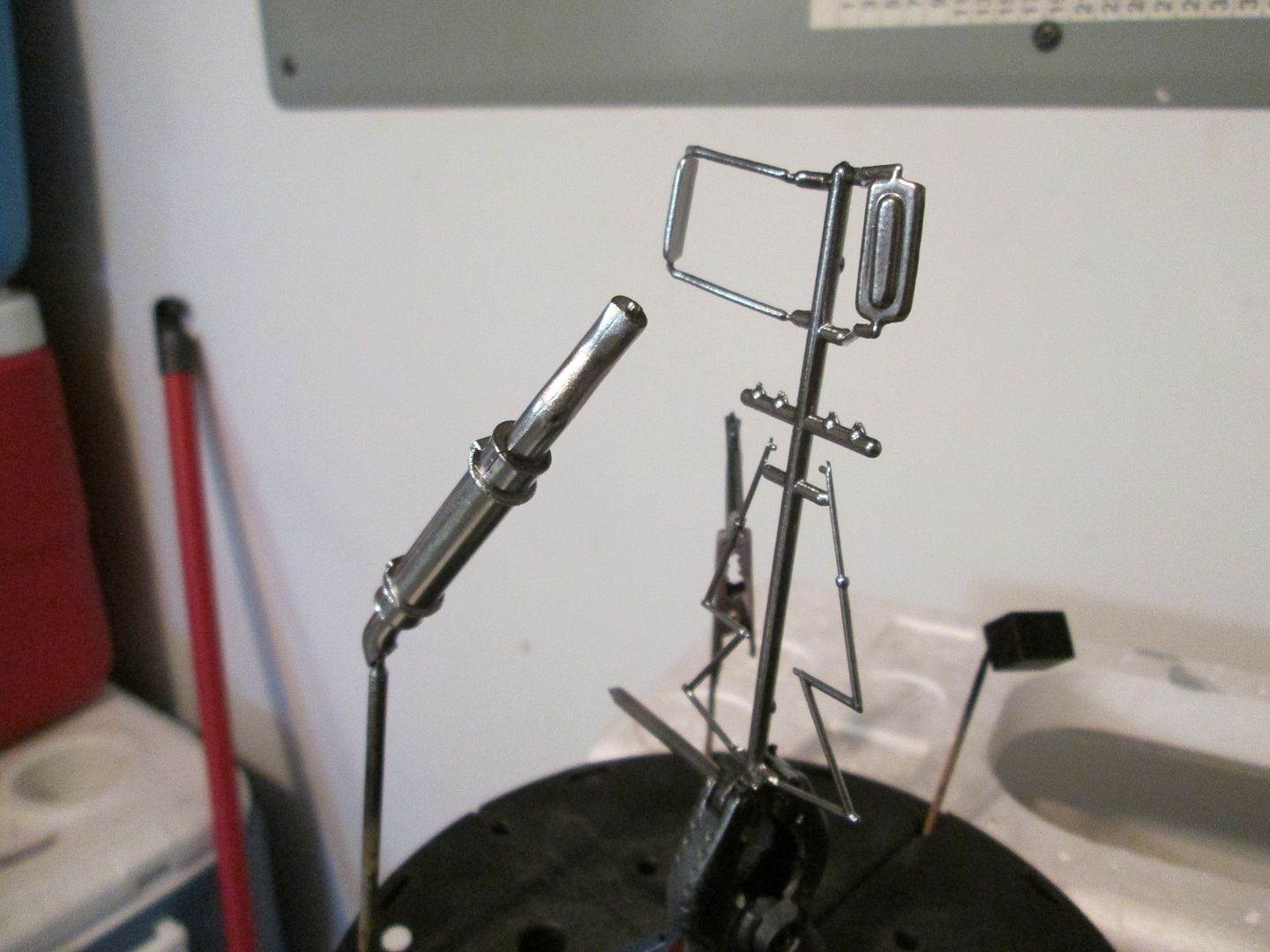

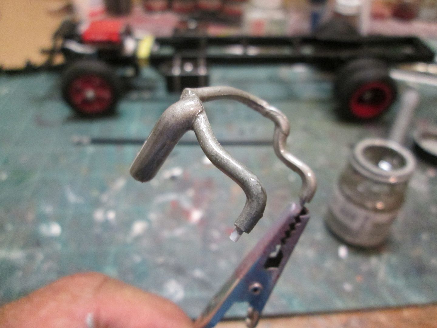

landman Posted July 20, 2015 Author Posted July 20, 2015 (edited) Fired up the compressor and Alcladed a few parts. Looking for a good spot for a stack. Has to clear the cab and the crane and be where I can attach it to something. Edited December 21, 2020 by landman
gatorincebu Posted July 20, 2015 Posted July 20, 2015 Pat, You've got this one looking real good .And you are not far from finishing it out. Fo the exhaust. Do you have enough room on the chassis ,to build a mount for it?I like you alclad work. But if it were up to me I would leave it with the weed burner exhaust. Be WellGator

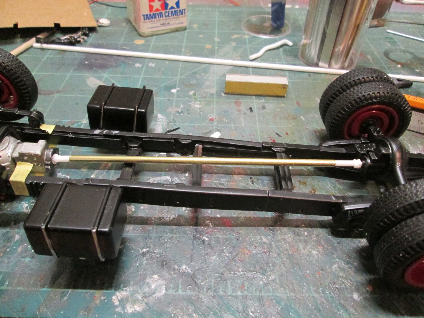

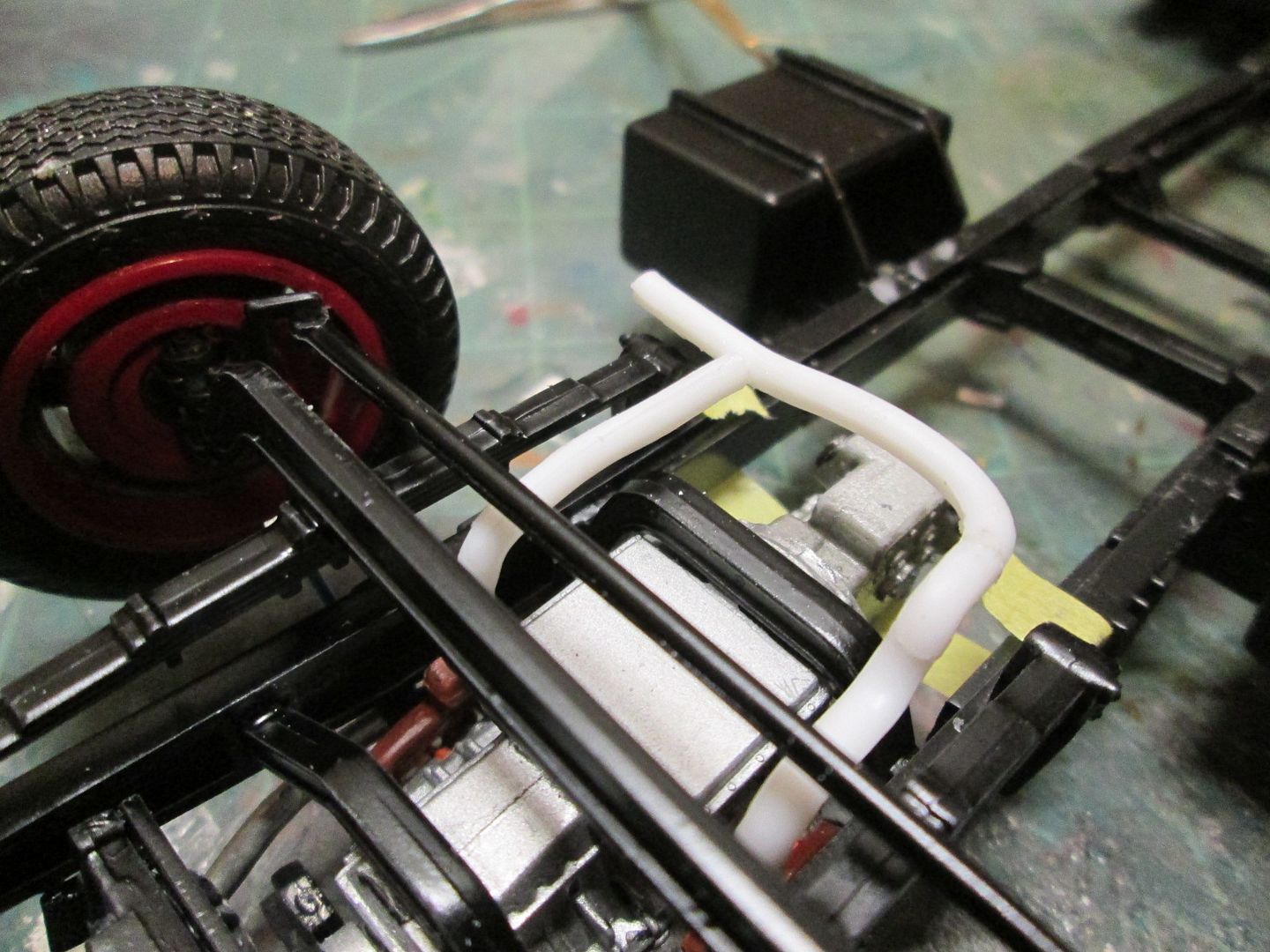

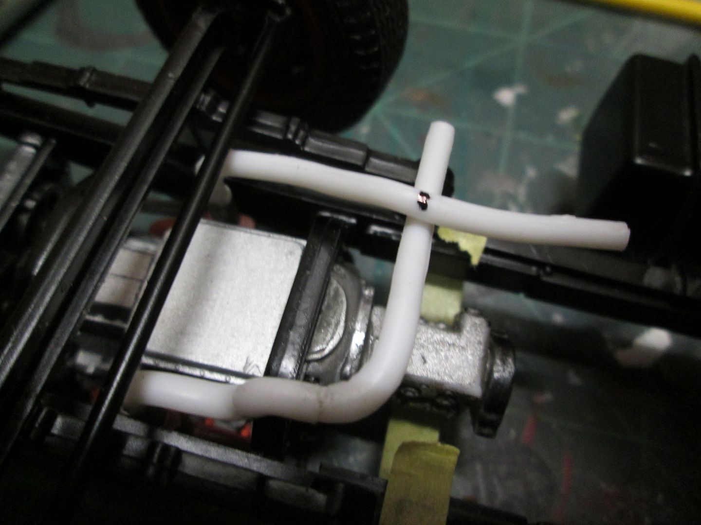

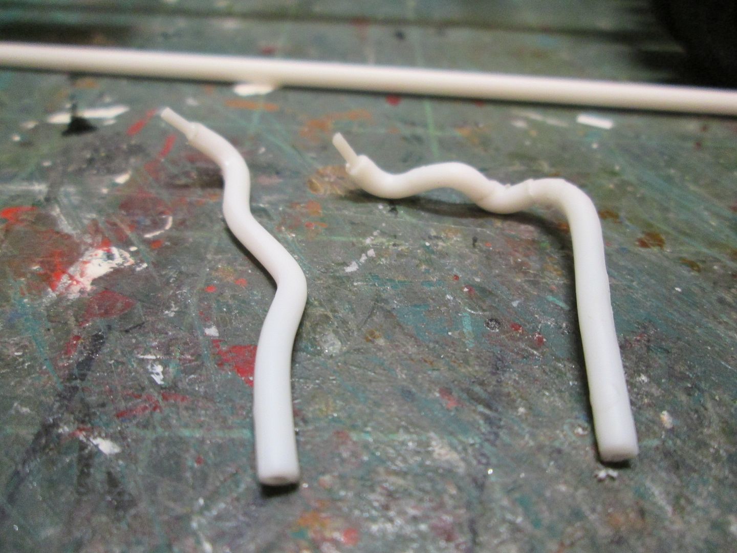

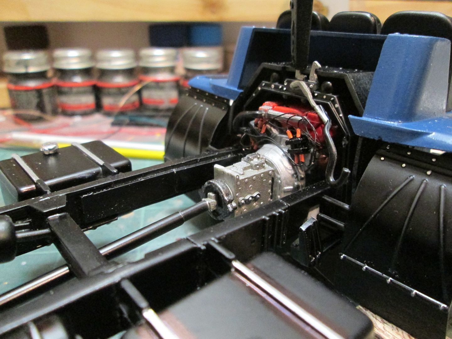

landman Posted July 21, 2015 Author Posted July 21, 2015 (edited) Extended the driveshaft to fit the new wheelbase. Intially I was going to have a hanger bearing and two shafts but I elected to go with the sliding spline style. Lazy eh? Cut & rolled the L-700's exhaust pipes to make it go where I want it to go. Shaping the "upturn". Gator, I found that neat stack with an engine I got on eBay and felt the need to use it here. The bracket will be on the frame of the truck against the front of the crane's frame. Edited December 21, 2020 by landman
gatorincebu Posted July 21, 2015 Posted July 21, 2015 Looking good! Hey go with what you want. Its your model and I think you are doing a fine job on it. And if you have room on the chassis for the upright exhaust. That is cool. Be Well Gator

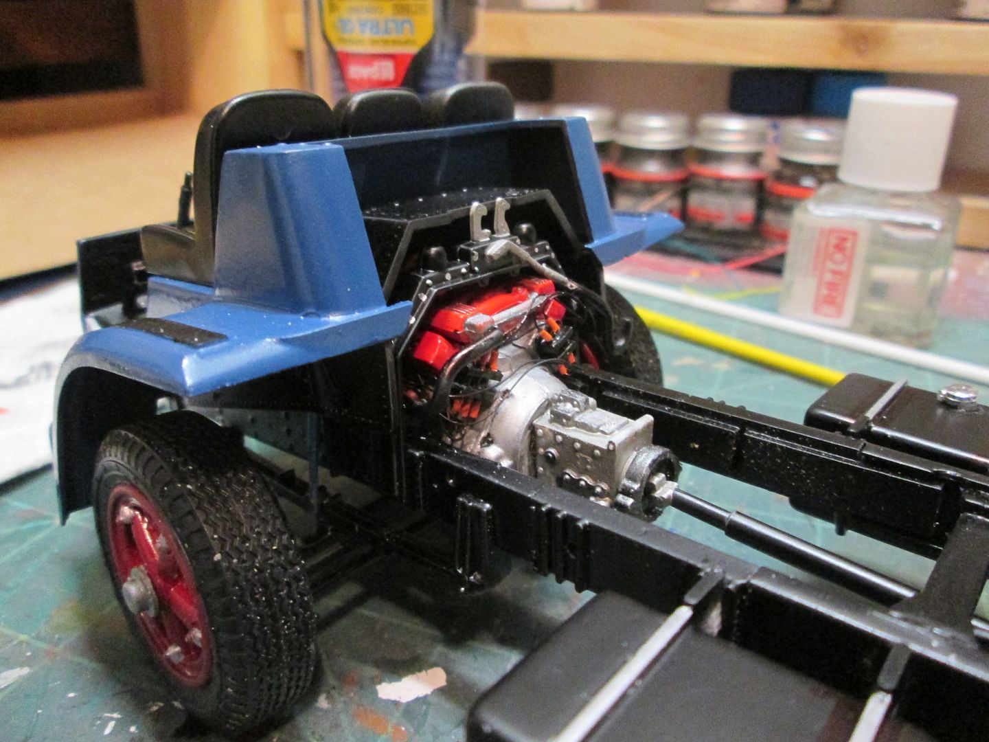

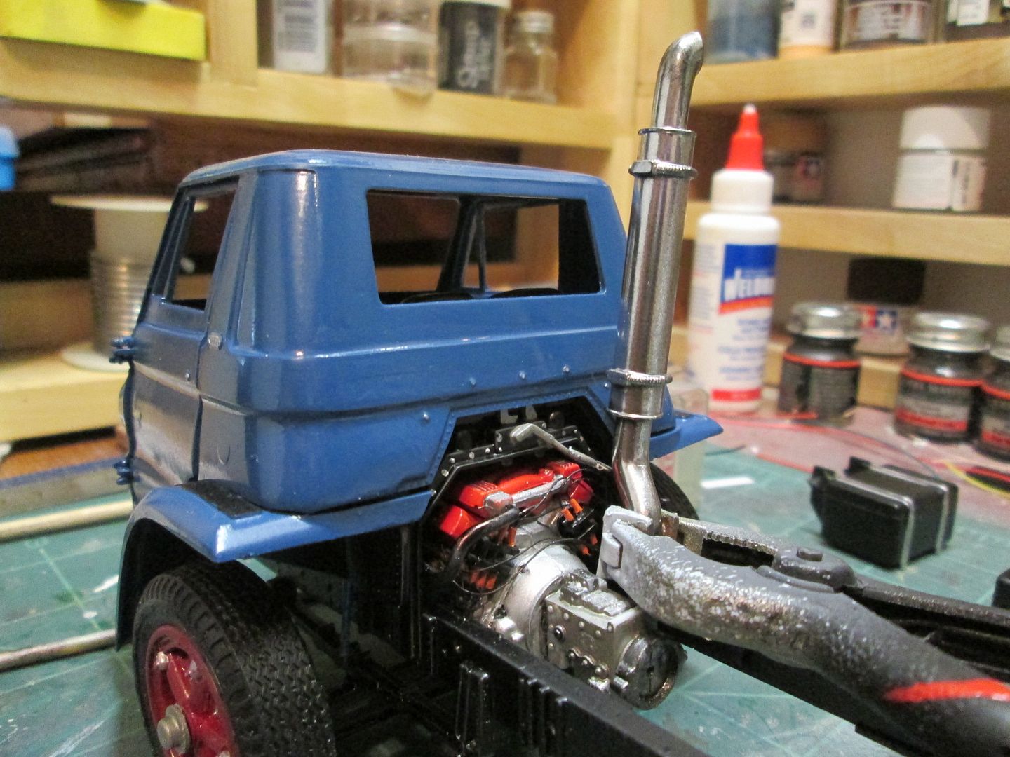

landman Posted July 22, 2015 Author Posted July 22, 2015 Completed the exhaust pipe. Added the floor pan, driveshaft & mudgards. Had to cut the stack & pin it to be able to rotate it to the proper orientation.
landman Posted July 22, 2015 Author Posted July 22, 2015 Added the stack,THEN made up the bracket. Doing things backward. No choice since I found it a lot easier to take the measurements with the stack in place.
gatorincebu Posted July 24, 2015 Posted July 24, 2015 Added the stack,THEN made up the bracket. Doing things backward. No choice since I found it a lot easier to take the measurements with the stack in place. Looks to me like you method worked! :-) Be Well Gator
landman Posted July 24, 2015 Author Posted July 24, 2015 Added the stack,THEN made up the bracket. Doing things backward. No choice since I found it a lot easier to take the measurements with the stack in place. Looks to me like you method worked! :-) Be Well GatorI held that stack in position what what seemed like a long, long time before it stayed upright without leaning. It was next to impossible to prop it up because of where it is. It is in situations like this that my patience gets really tested.

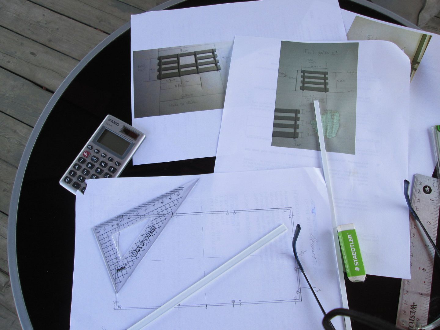

landman Posted July 24, 2015 Author Posted July 24, 2015 (edited) This is the only place I could find to mount the ECU. Set up in my outside office with measurements and photos provided by GrunpoyGrowly and 1930fordpickup and set out to make a set of plans to scratchbuild the deck. Edited December 21, 2020 by landman

gatorincebu Posted July 24, 2015 Posted July 24, 2015 Looks like a bed for the Dodge in the making! Will be watching how you do this. Be Well Gator

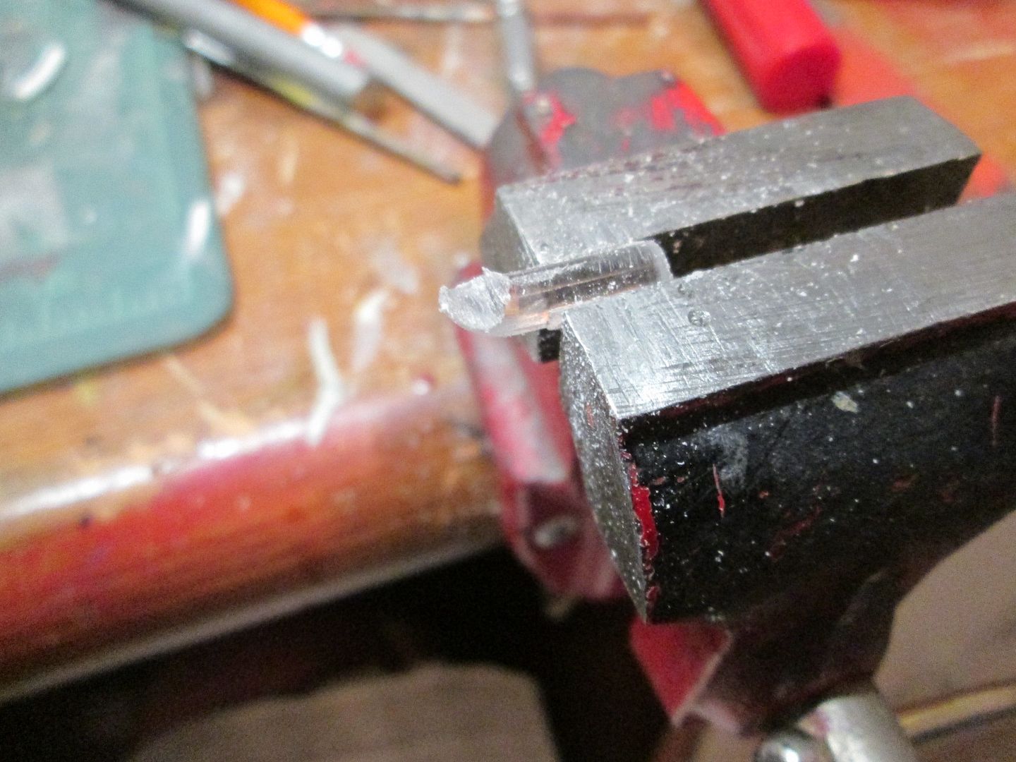

landman Posted July 28, 2015 Author Posted July 28, 2015 No real update. Haven't worked on the model all weekend, it was the annual Lumberjack Festival. Yesterday started to paint some details on the crane. Noticed the windshield wasn't quite straight and proceeded to break it while removing it. Have to make another one out of acetate. Also succeeded in smudging one of the side windows. So I quit while I was still ahead.
gatorincebu Posted July 28, 2015 Posted July 28, 2015 Pat, Do you ever get the feeling . That sometimes you are just not supposed to work on your models??? Broken windshield, smudged window................ What forces are at work here??? Lol Hey guy I am sure you will get things squared away in short order. Be Well Gator
landman Posted July 29, 2015 Author Posted July 29, 2015 (edited) Worked on the deck. Fired up the bandsaw and made some decking timbers It'll look something like this Edited December 21, 2020 by landman
