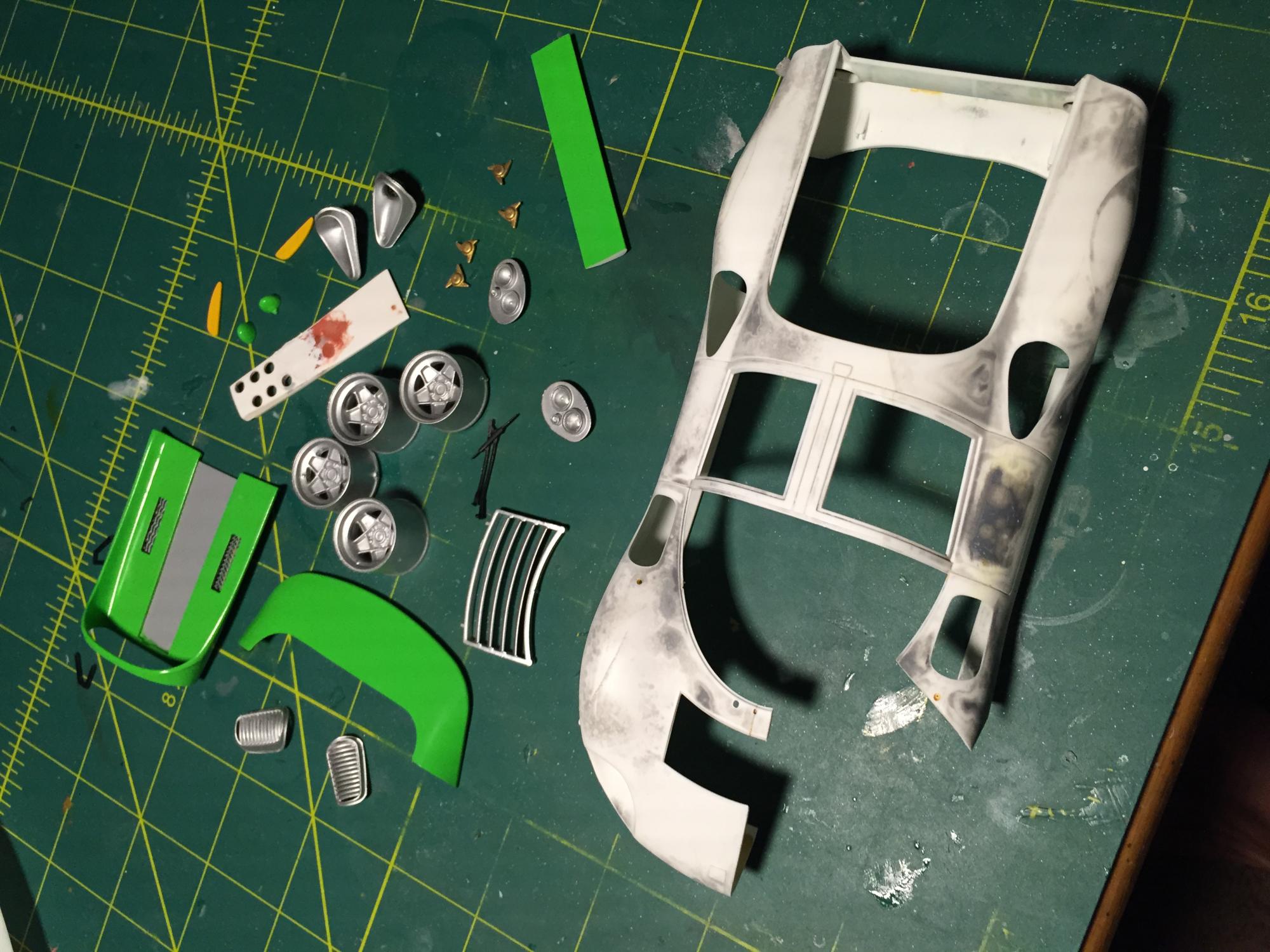

aurfalien Posted September 12, 2015 Author Posted September 12, 2015 (edited) I was just about done when I warped the front quarter panel/hood. Just about everything else is painted but I had to strip the body which was turning out a very cool yellow. I ran out of RTV silicone to cast the front quarter so this is on hold for a bit. Edited September 12, 2015 by aurfalien

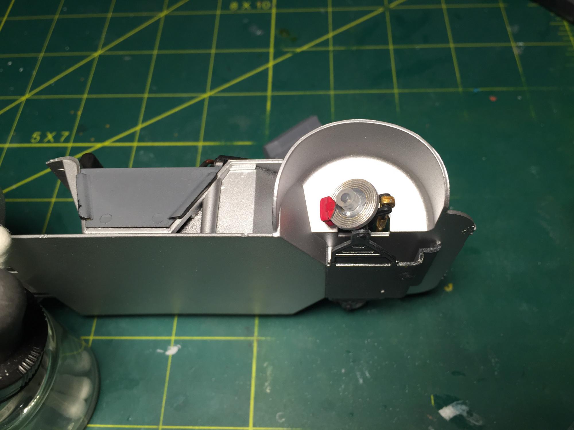

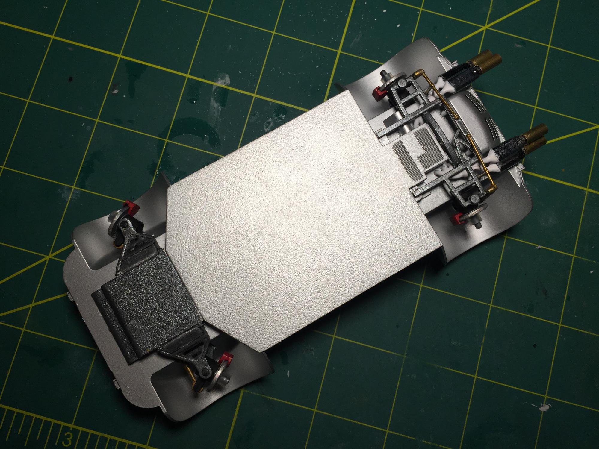

aurfalien Posted September 12, 2015 Author Posted September 12, 2015 Forgot, some chassis shots. Slight orange peel but I didn't mind much as it wll be obscured by wheels etc...

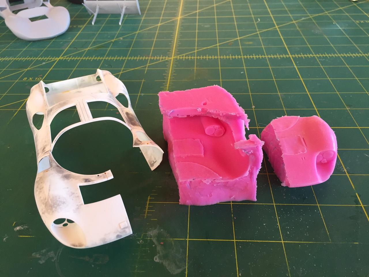

aurfalien Posted September 21, 2015 Author Posted September 21, 2015 So I've created the molds needed to repair the front end. I ran out of Alumilte silicone and got PinkySil. I prefer the harder stuff like what Alumilite has but the mold turned out perfect, no air bubbles etc...

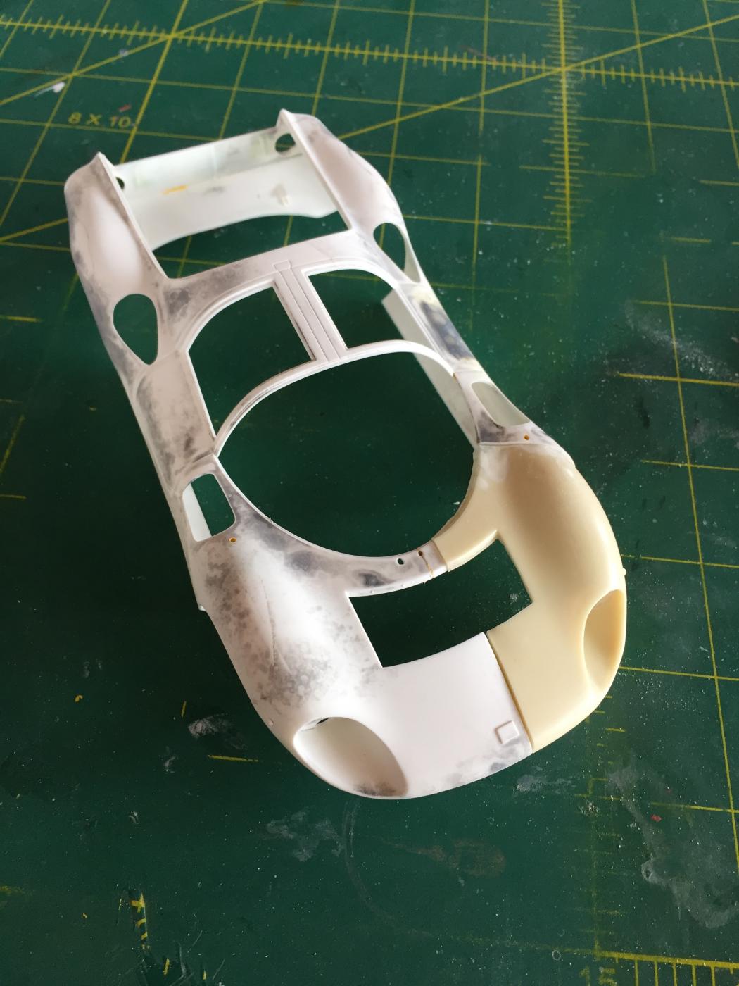

aurfalien Posted October 4, 2015 Author Posted October 4, 2015 And so the saga continues. What started out as a simple model almost ended as a melt down due to impatience. The recast front quater went well enough and gave me a base albeit serious body work is still needed. But at least I have a full body now. The proper way would have been to replace the entire front end evenly but I only wanted to cast a small amount keeping as much of the original body as possible. I'm looking to complete this one very soon and move on to a amore simple model.

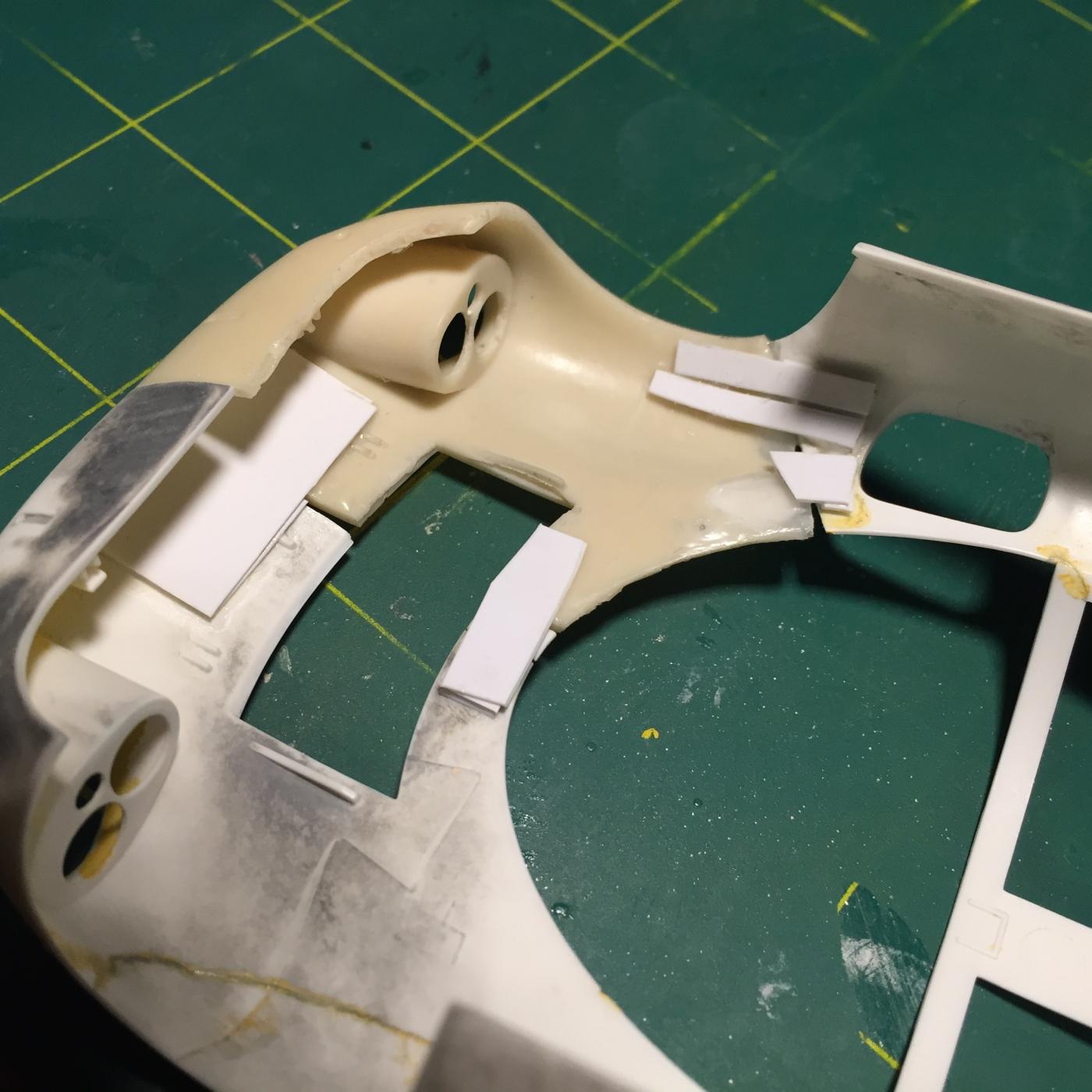

aurfalien Posted October 5, 2015 Author Posted October 5, 2015 Great choice for the project Brian, I am following closely with great anticipation. Regards Brian Thanks dude. I just aligned and glued on the cast quarter to the body using supports placed underneath. I did this so the surface is level with the rest of the car as my cast part is a little thicker then the plastic. It was a hack cast, and I built my mold box from clay and did other things to cut corners and speed the casting process.

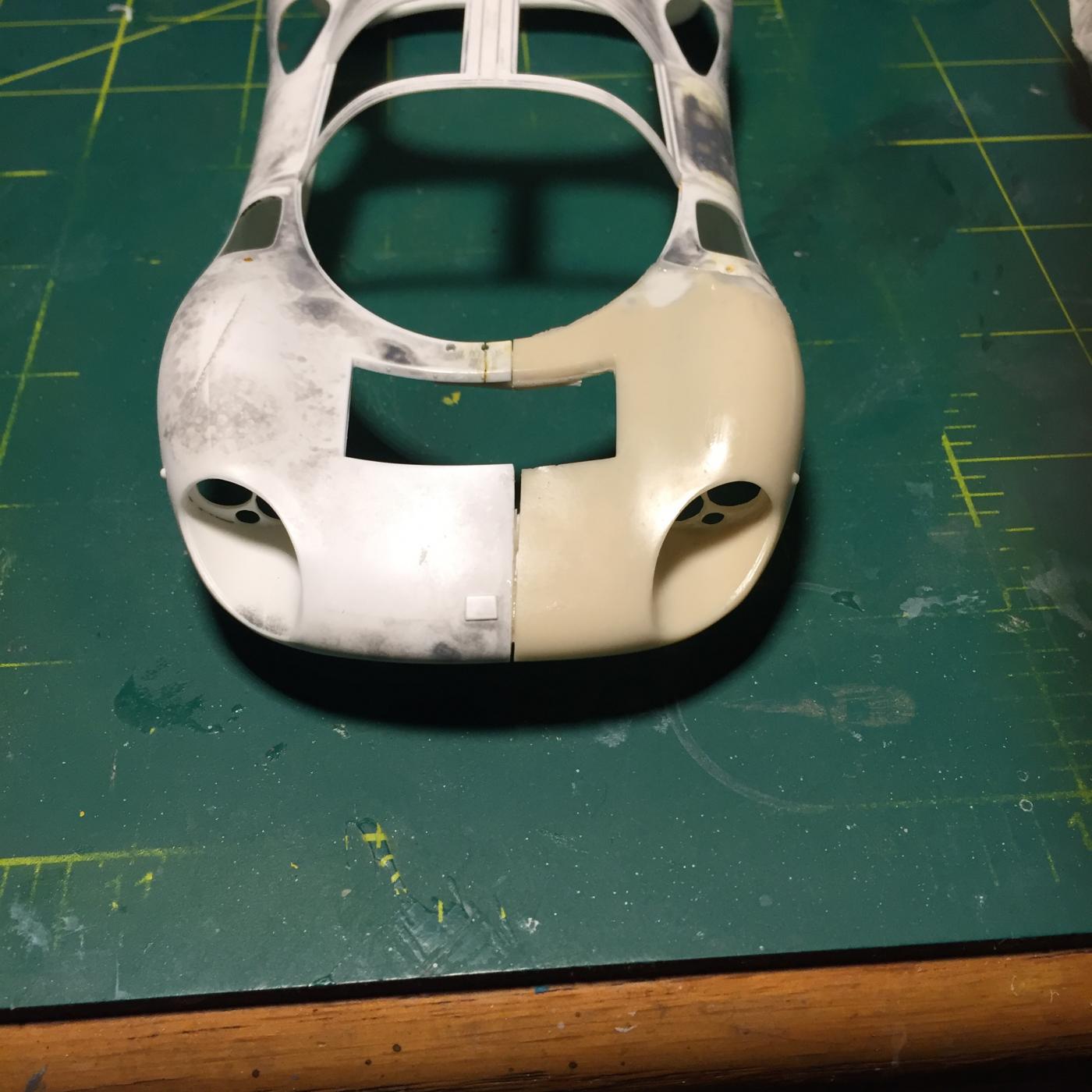

aurfalien Posted October 12, 2015 Author Posted October 12, 2015 So I finally got it primered. Still unsure if I'm going to do a final white or yellow primer before the final yellow paint though. The picture is of the completely replaced front right quarter as it originally melted. Plus I sat on the poor thing and had to use a filler/primer. I just can't give up on this little car. So much for being an easy 3rd build. I did what AFX said and went with an easier kit, one thats curb side. Oh well. Now I know I can do resin casting and panel replacements which is cool. Although I don't plan on doing it any time soon
Twokidsnosleep Posted October 12, 2015 Posted October 12, 2015 (edited) That is an impressive save.....I dare say I would have had to bin it as don't have those moulding skills. I can't figure how you got an impression of the LHS front if it was warped and destroyedDid you use another body?Nicely done Edited October 12, 2015 by Twokidsnosleep
aurfalien Posted October 12, 2015 Author Posted October 12, 2015 That is an impressive save.....I dare say I would have had to bin it as don't have those moulding skillsNicely doneThanks dude!Well, I put a lot of time in the other parts of this this thing and it pained me to have it wasted.Plus this modeling thing is a real PITA for me.Its "just" fun enough to keep me going.But others build posts keep me motivated.Thanks again dude.
aurfalien Posted October 12, 2015 Author Posted October 12, 2015 Did you use another body?Forgot to answer your question.At first I studied reverse molding and came to the conclsuion of f%^*$ it!I then bought another kit, made a mold and sold it (traded rather).I used PinkySil as it was cheaper then the Alumilite stuff but it's a soft mold. I prefer the hard kind as is supplied by Alumilite.I look forward to a totally fun build.
Twokidsnosleep Posted October 12, 2015 Posted October 12, 2015 (edited) You are a fast reply :)In my world of dental stuff, it is challenging when someone busts an anterior tooth and I need to make them a temporary. I either have to sculpt it out of direct resins OR wax the shape and take an image of the wax up and then make the temporary. I can't see making a wax quarter panel for something complicated like a car Edited October 12, 2015 by Twokidsnosleep
