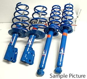

On the suspension thing, back in my real race-car days, before you could buy tuner parts ready made, we dropped strut-type cars a couple of ways. Simply using shorter springs is one option. If the strut in question has a bolt-on spindle, another way is to cut off the mounting ears for the spindle from the strut, and re-weld them higher up. This lowers the car the exact corresponding amount you raised the ears. This would work on the struts on the left, shown below.
This type of strut, or struts that have integral spindles, can be lowered by cutting the strut body below the spring mounting plate and shortening it. This method requires a shorter strut insert cartrigge.
The spring mount can also be cut free from the strut and re-welded LOWER. This lets the car drop, but can keep the same spring rate.
Another option is to convert the struts to an adjustable configuration like these BMW units, and use a shorter spring and cartridge. You can buy stuff like this for 1:1 cars too.
In some cases, you can also get some drop by using a trick upper strut-mount / camber plate that allows the top of the strut to protrude farther up in the tower, and again, lowers the car a corresponding amount.
There are many variations of these methods, and which one a tuner chooses depends on the exact design of the suspension under the vehicle, the amount of lowering desired, and they all require careful measuring and understanding of the principles involved to work well.
Raising the stub-axles on a model relative to the strut body, as long as you put a nice backing plate or brake rotor in the correct location too, will usually accomplish a believable lowering job...and unless your audience has built a lot of real cars, if you do it clean, no one will say it's wrong for a particular vehicle.
