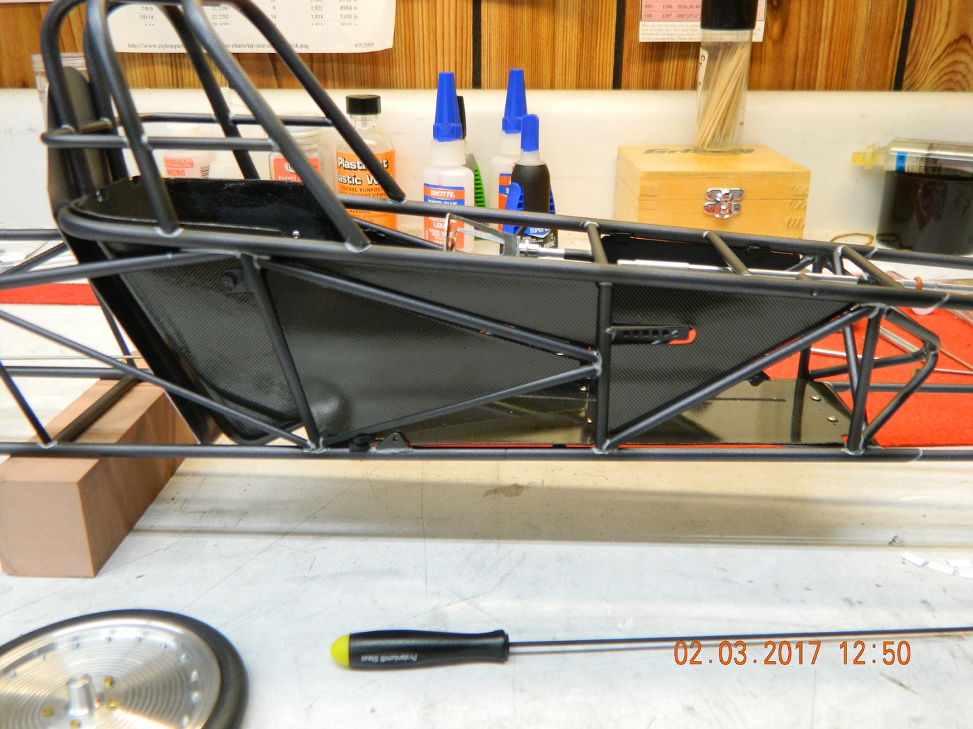

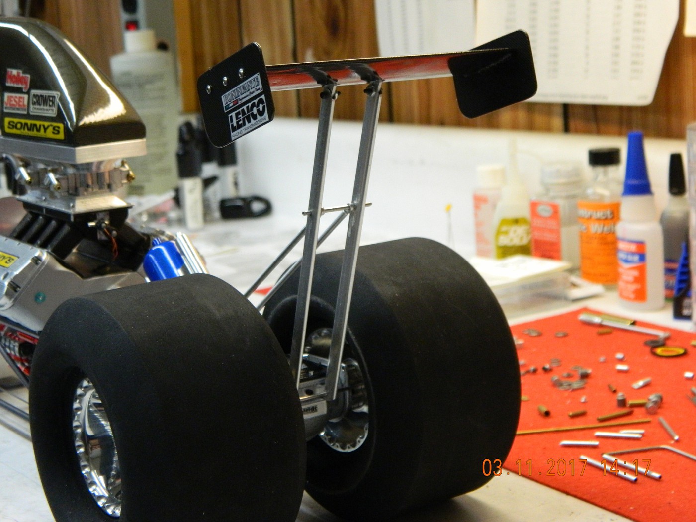

comp1839 Posted February 3, 2017 Author Share Posted February 3, 2017 (edited) i've been working on the steering and finished the rack. the steering shaft, the steering wheel and the quick disconnect for the wheel. fabbed and decaled the carbon fiber interior panels. i'm waiting for some parts to finish putting the panels on. and i did some wing support work. Edited July 16, 2017 by comp1839 Quote Link to comment Share on other sites More sharing options...

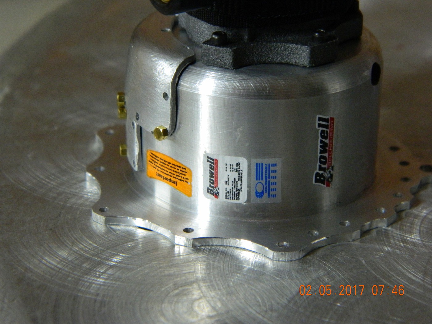

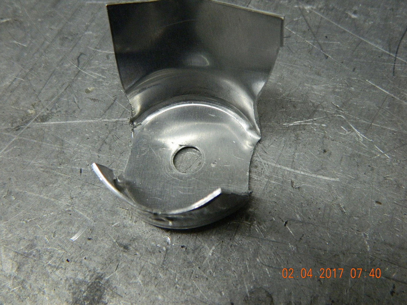

comp1839 Posted February 4, 2017 Author Share Posted February 4, 2017 (edited) i needed a cover for the clutch can openings so, i decided to make a pair of dies to form the aluminum into the shape i needed rather than try to machine them. if you want a better explanation just ask and i will give you the full tilt deal. short story...... made dies from some scrap i had laying around. pressed aluminum. cut out the basic shape of cover. Edited July 16, 2017 by comp1839 Quote Link to comment Share on other sites More sharing options...
comp1839 Posted February 4, 2017 Author Share Posted February 4, 2017 (edited) this is the set up i will use to produce the bolt pattern in the can and then replicate it in the cover. any questions .......just ask. Edited July 16, 2017 by comp1839 Quote Link to comment Share on other sites More sharing options...

Codi Posted February 4, 2017 Share Posted February 4, 2017 Thanks for sharing the inspection cover methodology. I see what you did there and it's beautiful in its simplicity. Need I add, the cover is the perfect shape. Now about that "gizmo" you have in the last pic, what the heck is that thing and how do you use it specifically? I'll give you a call to learn more about that bugger. Can't wait to see the result after you've completed it. All looks great Dave!!! cheers, tim Quote Link to comment Share on other sites More sharing options...
mr68gts Posted February 5, 2017 Share Posted February 5, 2017 (edited) Indexing head!Would love to watch it in use....hint hint... (video) lol. Ive never used one but Ive watched videos on them.So when you did your form, how much clearance did you give it for the aluminum?. Just the thickness of the aluminum sheet?Paul Edited February 5, 2017 by mr68gts Quote Link to comment Share on other sites More sharing options...
comp1839 Posted February 5, 2017 Author Share Posted February 5, 2017 (edited) joe, pics below. hope you like 'em. tim, thanks buddy. paul's correct. the tools are a spin index and a 3" chuck w/ internal jaws on a 5 c arbor. paul, it is a very versatile tool. the video would have to be pretty intense to show all of it's attributes. be happy to show you some time. i left .005"-.006" per side for clearance. the sheet is .040". the male die is 1.600 on the o.d., the female die is 1.690" on the i.d. i am by no means an expert at making pressing dies. they should have been steel. i didn't have any steel laying around so, i made do with what i had. i have a little knowledge from a friend of mine who was a tool and die maker ( he was also my mentor) he helped me make some dies for pressing the intake runners for my 1:1 intake manifolds. so, i'm probably more dangerous than anything, hehe. so, here are the results. i filed the edges around some of the corner bolt holes a little thin. i can live with it. all of the holes from the cover line up correctly to the bell housing. . Edited July 16, 2017 by comp1839 Quote Link to comment Share on other sites More sharing options...
