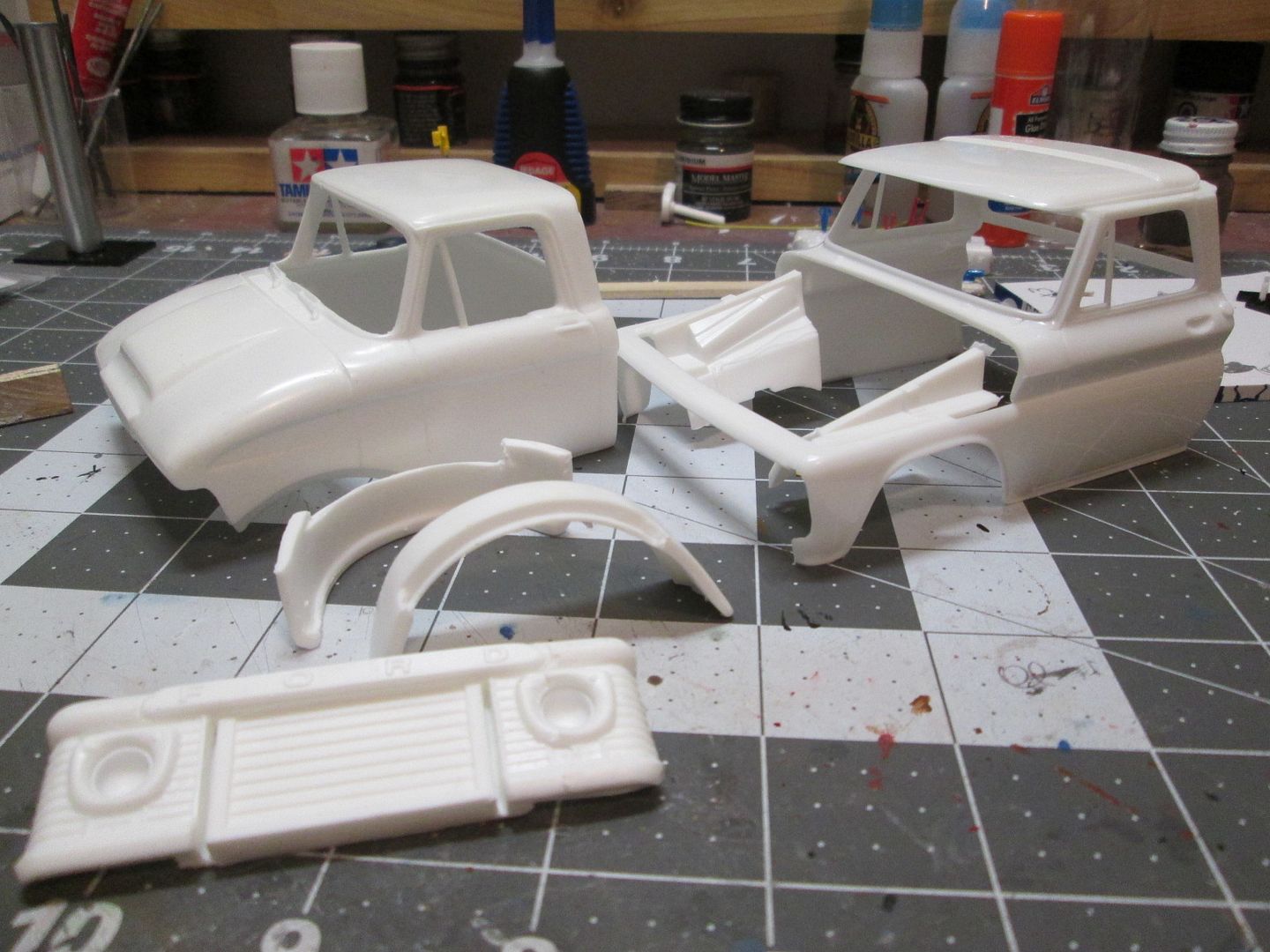

landman Posted October 30, 2015 Posted October 30, 2015 (edited) So now that I have an engine, might as well build the truck. Here are the main ingredients for the cab. Edited January 14, 2021 by landman

landman Posted October 30, 2015 Author Posted October 30, 2015 (edited) Thanks guys for the vote of confidence, It turns out the body may be just past the end of my skill set. There are some major differences between both the Chevy cab,the Ford hood and the B-7000's cab & hood. For starters the upper door feature stops short of the firewall on the B while it goes into the fender on the pickup cab. As well, the Ford hood's top surface is straight out from the back while the B's narrows towards the front. And the B's A pillars slants to the front while the pickup cab's slants to the rear. This will be seriously challenging. . Edited January 14, 2021 by landman
dodgefever Posted October 30, 2015 Posted October 30, 2015 The tapered hood looks like the most challenging problem. You could fill the back of the character line/crease at the cowl area then file & sand it to shape. The '60-'63 cabs had wraparound windshields; '64-'66 had the same style as your Revell pickup cab, so you could just say it's a later model. Otherwise, the AMT '60 Chevy cab could work.

landman Posted October 30, 2015 Author Posted October 30, 2015 (edited) On 10/30/2015 at 5:00 PM, dodgefever said: The tapered hood looks like the most challenging problem. You could fill the back of the character line/crease at the cowl area then file & sand it to shape. The '60-'63 cabs had wraparound windshields; '64-'66 had the same style as your Revell pickup cab, so you could just say it's a later model. Otherwise, the AMT '60 Chevy cab could work. Thank you, thank you, thank you! I went back & looked at the one I'm trying to reproduce and BINGO! it is newer than 63. One less hurdle. Edited January 14, 2021 by landman
