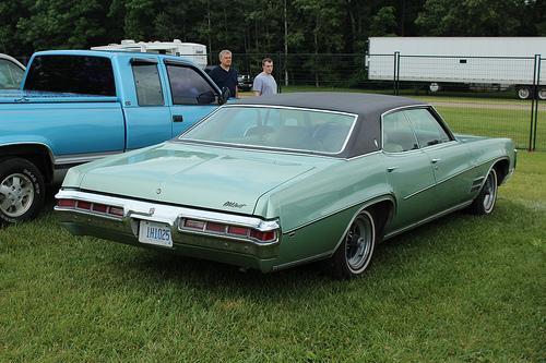

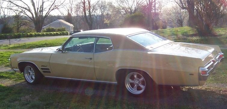

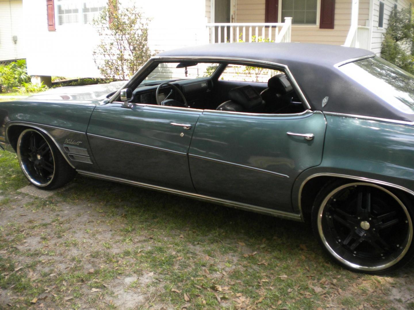

John Goschke Posted November 4, 2015 Posted November 4, 2015 The short answer is, no, the '69-'70 Wildcat 2-door and 4-door hardtops did not share the same roof stamping. While they are superficially similar, the 4-door roof is longer and has a larger back window opening. The side window openings are different in profile, where the 2-door is shorter in length. In these photos you can see difference in size between the back windows, the overall length of the roofs, and the different side widow opening profiles. The 2-door hardtop is a true coupe, in the sense that there is less leg room in the rear seat, while the 4-door rear seat leg room is the same, or nearly so, as the 4-door sedan.
