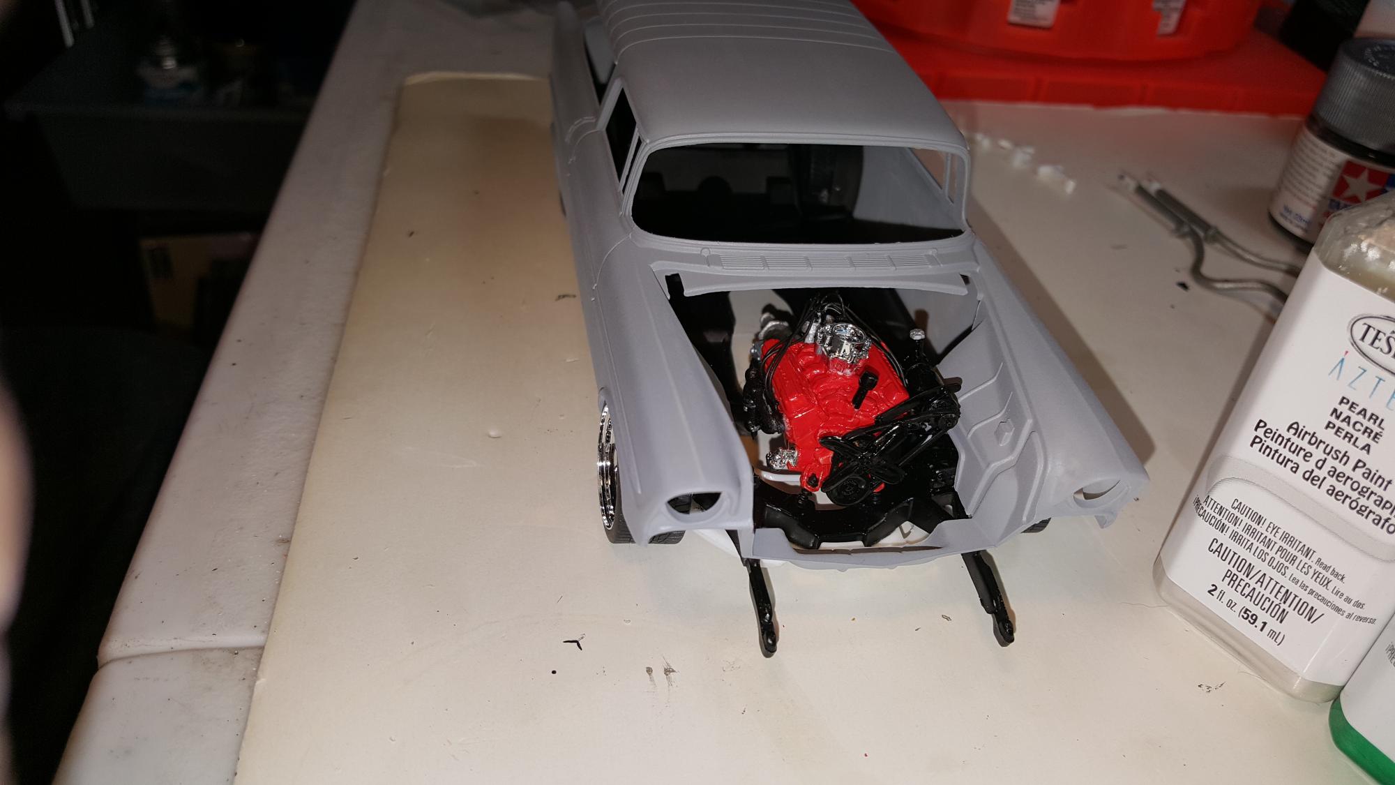

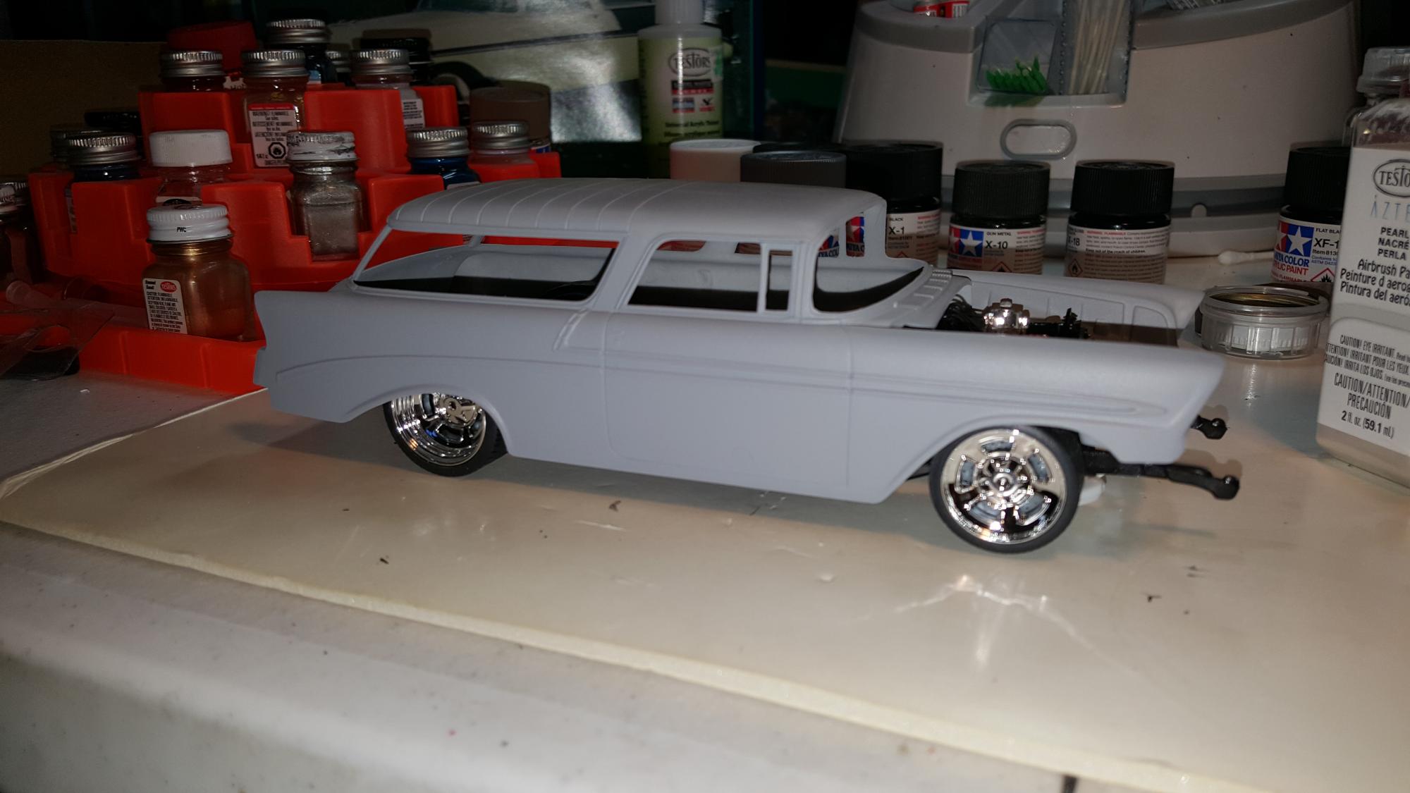

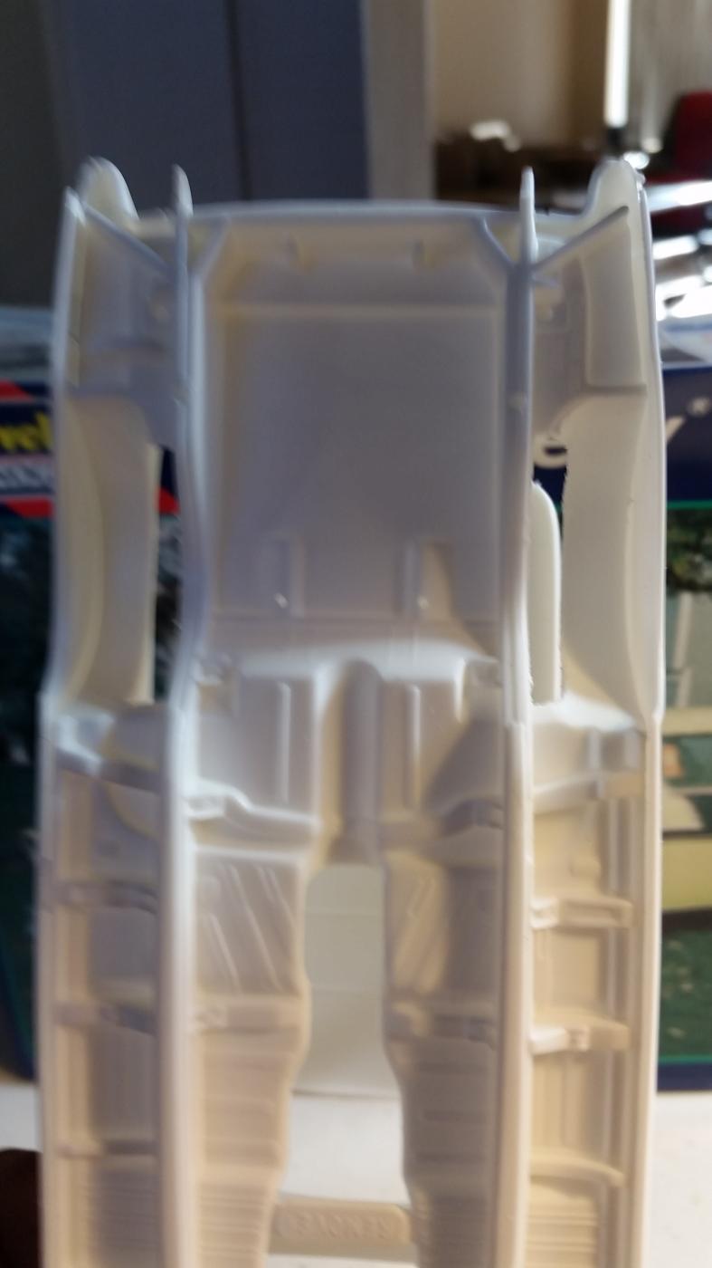

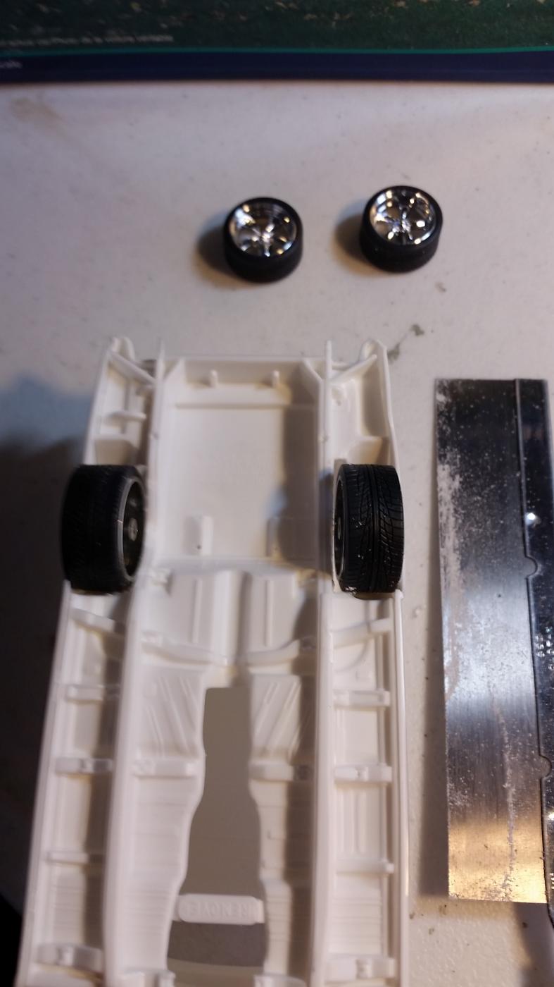

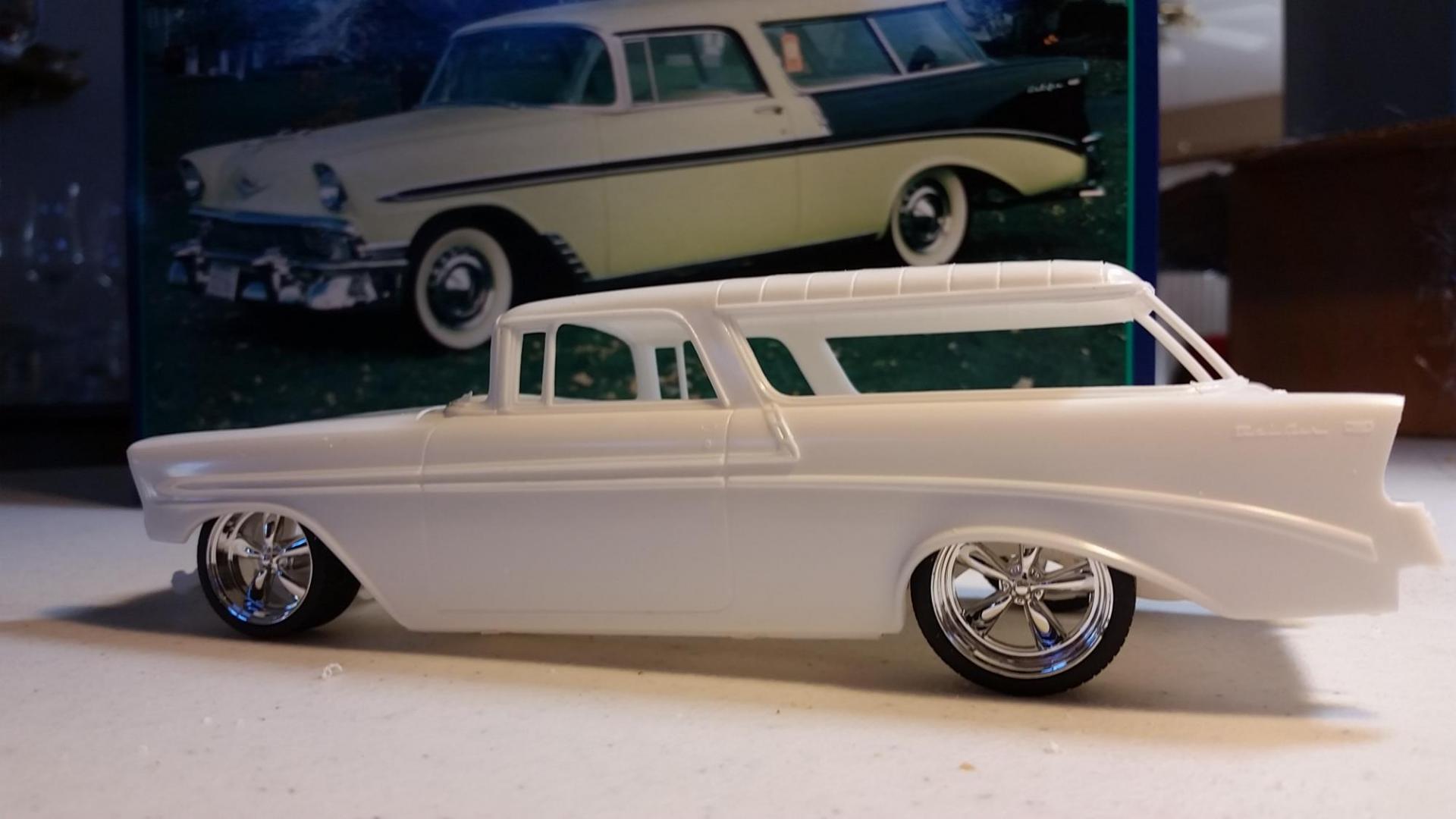

parkflyrer 50 Posted November 12, 2015 Posted November 12, 2015 Hello Guys... Well here's my next project. I picked up this kit up at a local model expo here in Buena Park. So Cal for $10..Not too bad I was able to talk the price down from $I8.. I want to take it to the mild custom style i'll probably go with a stock two tone paint job with all the stock chrome pieces and interior. I did have to cut slots in the wheel wells to get the wide tires to fit at the lowered stance I want..Wish me luck.....
espo Posted November 12, 2015 Posted November 12, 2015 This is a great kit and I like your ideas on the build. I built one last year with the same Pegasus wheels you're using. As I'm sure you're finding out the stock rear suspension has to be relocated. Look at either mounting the leaf springs inside the frame or go to a four link setup. Taller spindles on the front should get it real low. Be sure when mount you're differential that the drive shaft doesn't hit the floor boards.It could be that you can raise the tunnel a little for clearance of the drive shaft. Look forward to seeing how you're build goes.

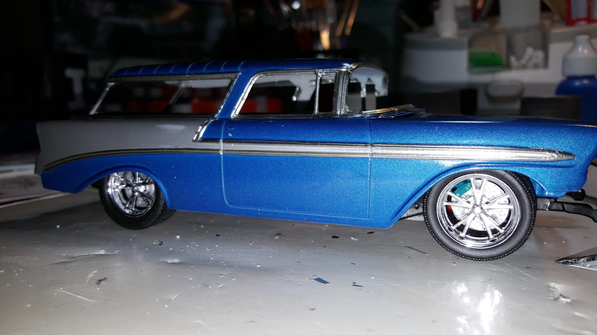

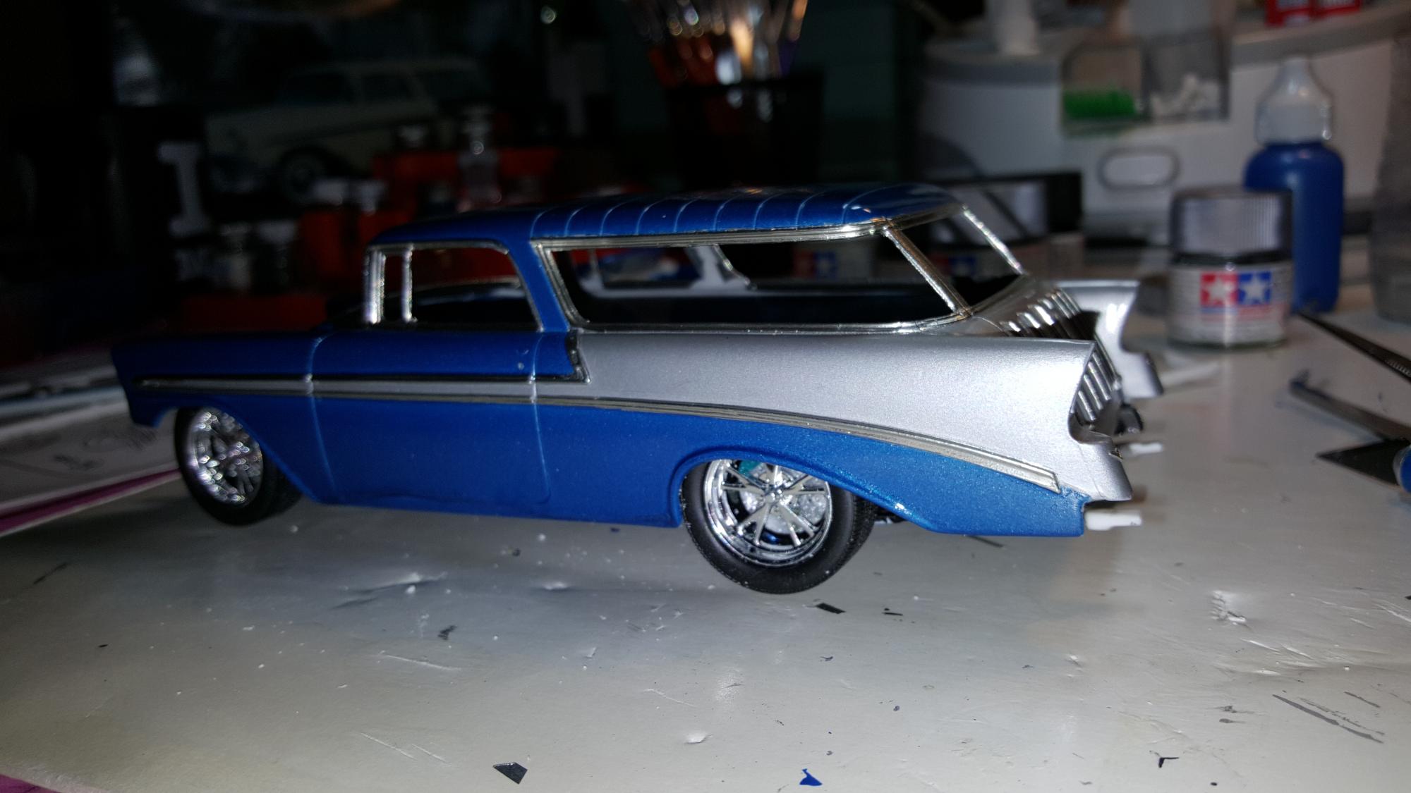

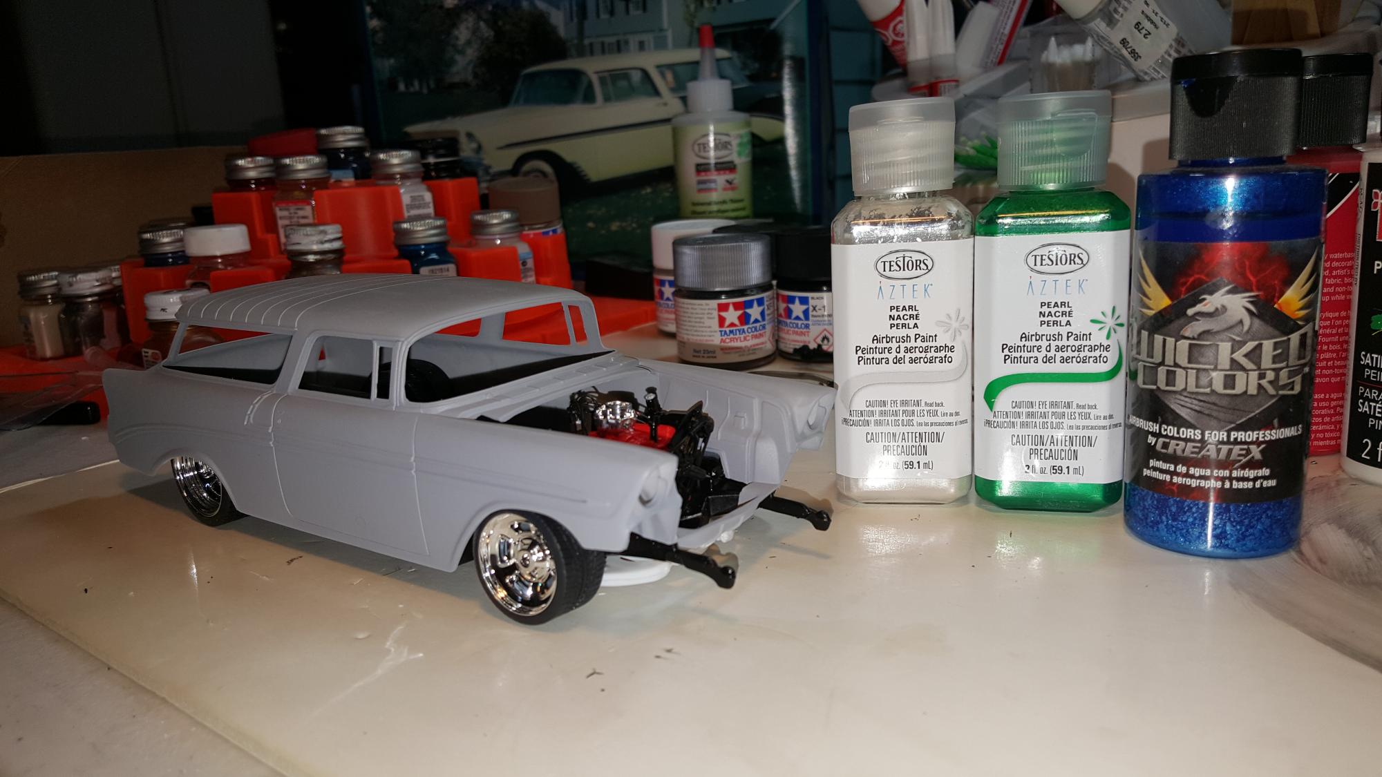

parkflyrer 50 Posted January 2, 2016 Author Posted January 2, 2016 here are a couple picture updates..I know it doesnt look like I've done much but with the holidays and work schedules its been very difficult to carve out hobby time around here....
crazyrichard Posted January 2, 2016 Posted January 2, 2016 looks great ! .. personlly i liked the first set of rims ...not that these are bad .. just feel the others matched the car better
GTJUNIOR Posted January 2, 2016 Posted January 2, 2016 looks great ! .. personlly i liked the first set of rims ...not that these are bad .. just feel the others matched the car betterx 2.
parkflyrer 50 Posted January 2, 2016 Author Posted January 2, 2016 Yea..gonna have to agree the other rims were nicer..thanks guys..

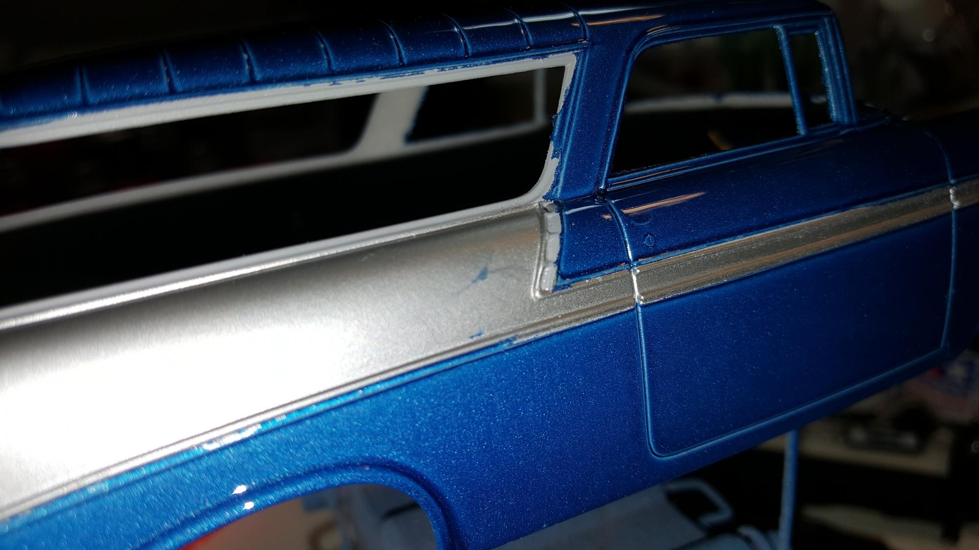

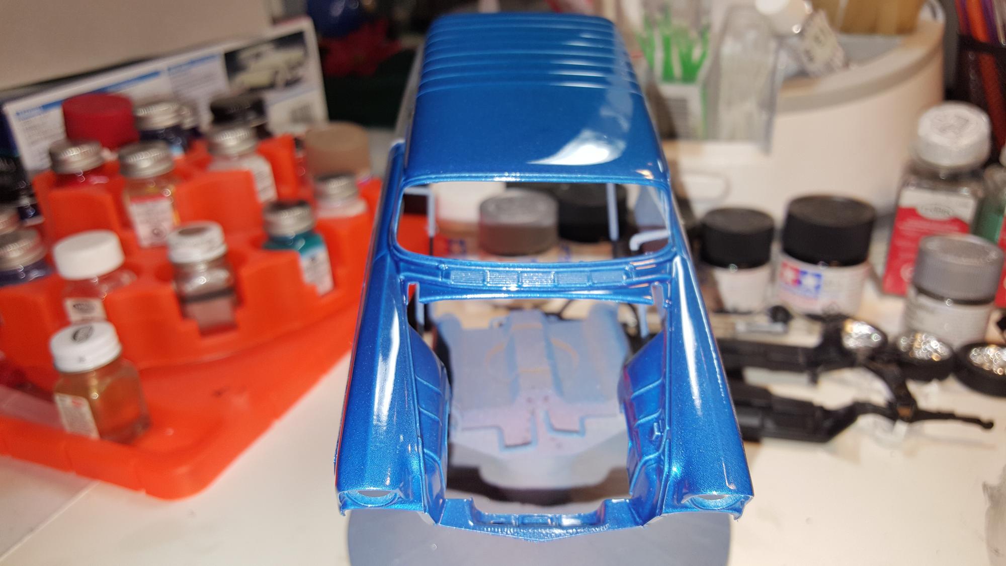

parkflyrer 50 Posted January 6, 2016 Author Posted January 6, 2016 Okay so these are probably a rookie moves but hey I'm a rookie..I got some overspray on on the grey area of the paint job and I tried to be as carefull as I could about the coats but got some runs.below the driver side door. any advise on howto fix these would greatly appreciated
GTJUNIOR Posted January 6, 2016 Posted January 6, 2016 Not sure, but you may be able to carefully polish them out once the paint has fully cured. I am sure that one of the more experienced members will be able to give you much better advice.
Deathgoblin Posted January 6, 2016 Posted January 6, 2016 I agree with GTJUNIOR. Wait for it to cure and then polish it out. Try using Novus on a Q-Tip and just buff it out.
Tom Geiger Posted January 6, 2016 Posted January 6, 2016 As said above that little bit of blue should polish right out. I've polished away much worse! Not really a rookie move, we all do things like this. It seems sometimes no matter how well you mask up a body for a two tone, there's one little place it sneaks through. In modeling it's not how you screw up, it's how you recover!
parkflyrer 50 Posted January 21, 2016 Author Posted January 21, 2016 Okay guys hopefully you can help me here.. So I've never really wet sanded and technically polished out a paint job before..I have tried but it seemed all I did was scratch up an already shiny finish. I've always had to settle for a mostly shiny finish but with dust and speck flaws in them..I feel like when I put sand paper to paint its doing more damage than good and I have tried using very fine grit paper..so with that said can anyone give me a sorta step by step instruction or at least point me in the direction of where I can get more information possably a youtube video or something...this paint job came out pretty will aside from the over spray. Its been more than 2 weeks since painting it so Im pretty sure it cured well enough. It does have some dust specks and what looks like a small hair on one side..Thanks so much in advance for any replies....

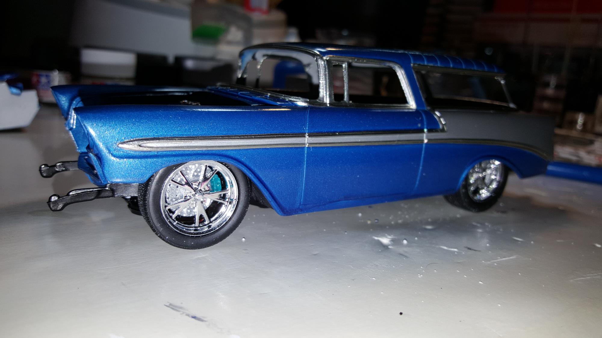

parkflyrer 50 Posted February 1, 2016 Author Posted February 1, 2016 Well here are a couple more pics of the progress..this project is going way too slow..too many life distractions going on..Im only getting about 1-2 days per week if even that to work on it and its causing me to get impatient...I made a couple of goofs on the paint and what makes it worse is they're on both sides of the car..just my luck they both could'nt be on the same side..now I gotta back track to repair it..but hey thats all part of the hobby I guess...
