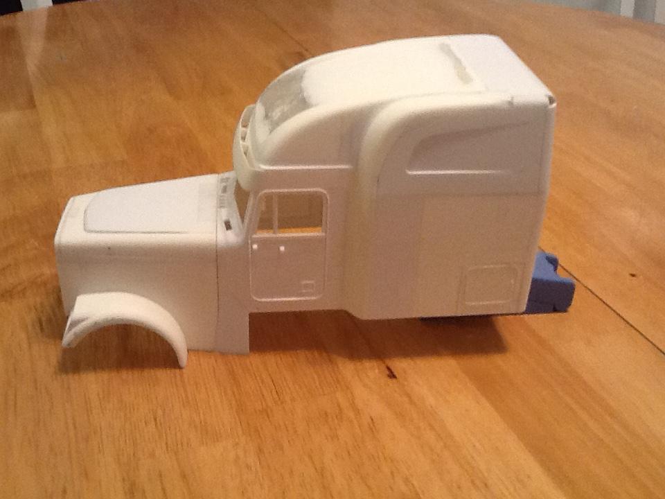

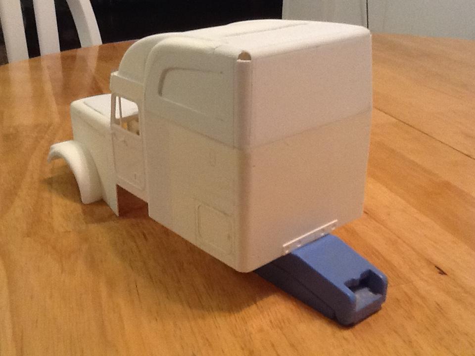

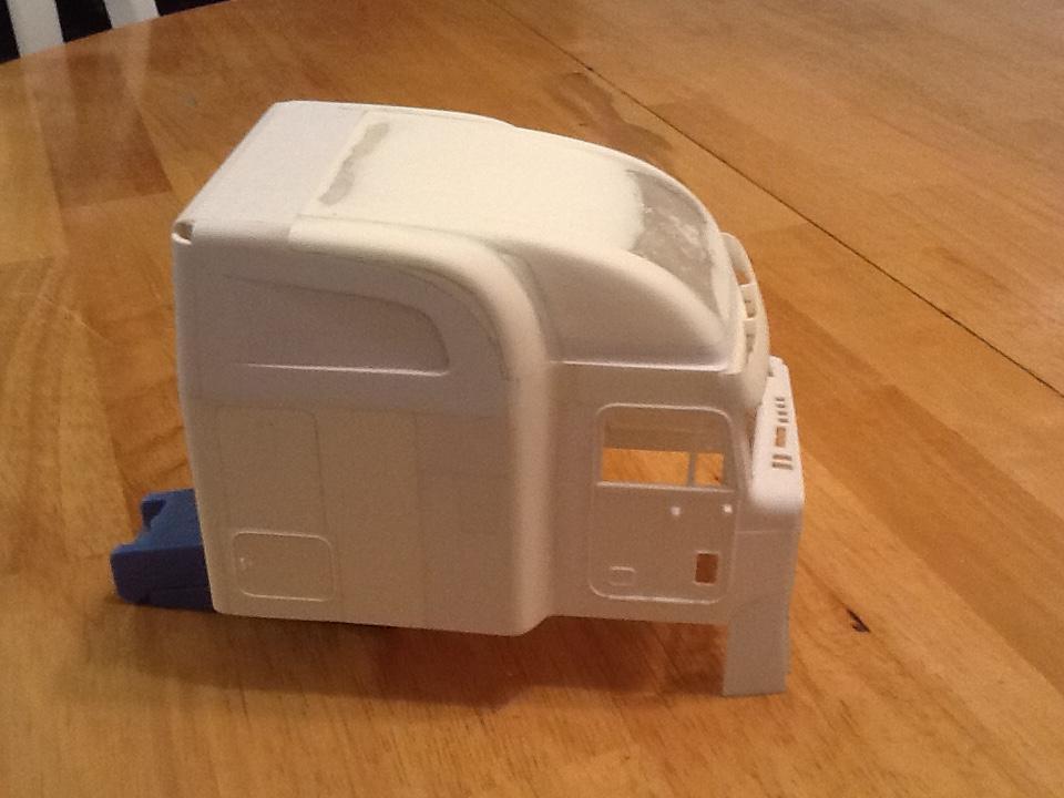

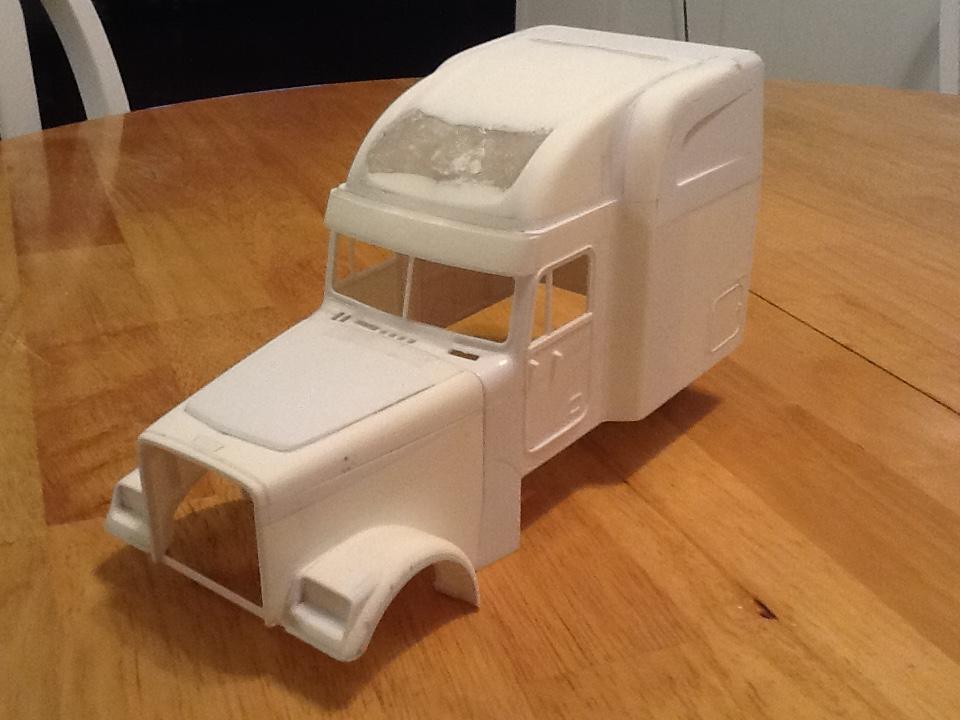

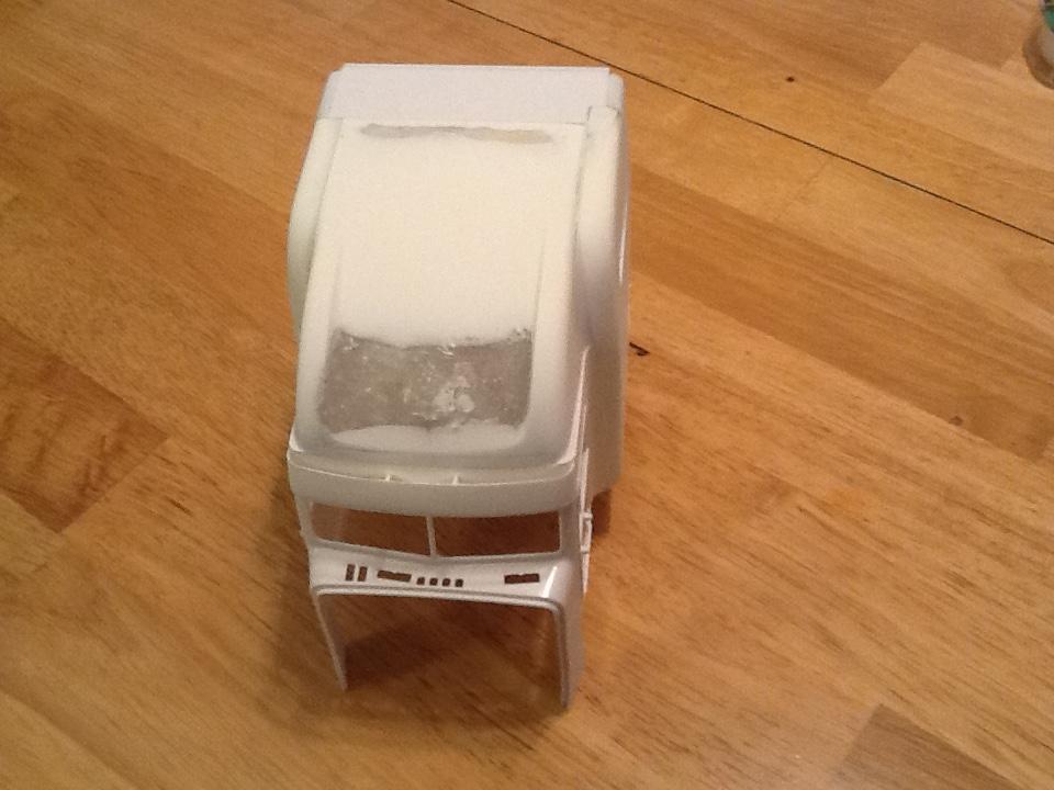

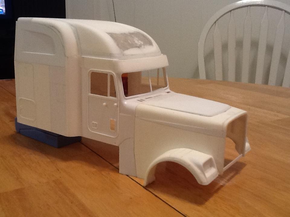

Here are some pics of the cab / sleeper almost roughed in. I still have the back corners of the roof to build, then sand, sand, and sand it again. I hope the next update will have some more sub assemblies, like the frame, engine, or interior platform.
This is a mix of resin and plastic. Not mention a ton of CA glue. Almost forgot, the semi-transparent areas are the super glue and used dryer sheets combination. Sort of a scale fiberglass. It is really strong, but will probably need a little putty to make it perfect. It is very hard, but not the easiest to sand smooth. It was the easiest way to fill the places I sanded through the resin.

Dude !!!!! Dryer sheets and super glue??? I never would have thought of that....That sounds like an Excellent way to fill in gaps....This is looking great....I've always wanted to do one of these for myself.....Very nice work....
JT, I know, sounds crazy, but it works just like full scale fiberglass mat and resin, just sets up a lot faster. Very strong too. I am also testing the sheets with paint, as a replica of unfinished 'glass for the underside of W900 and other 'glass hoods. Will post updates on that on this hood.
