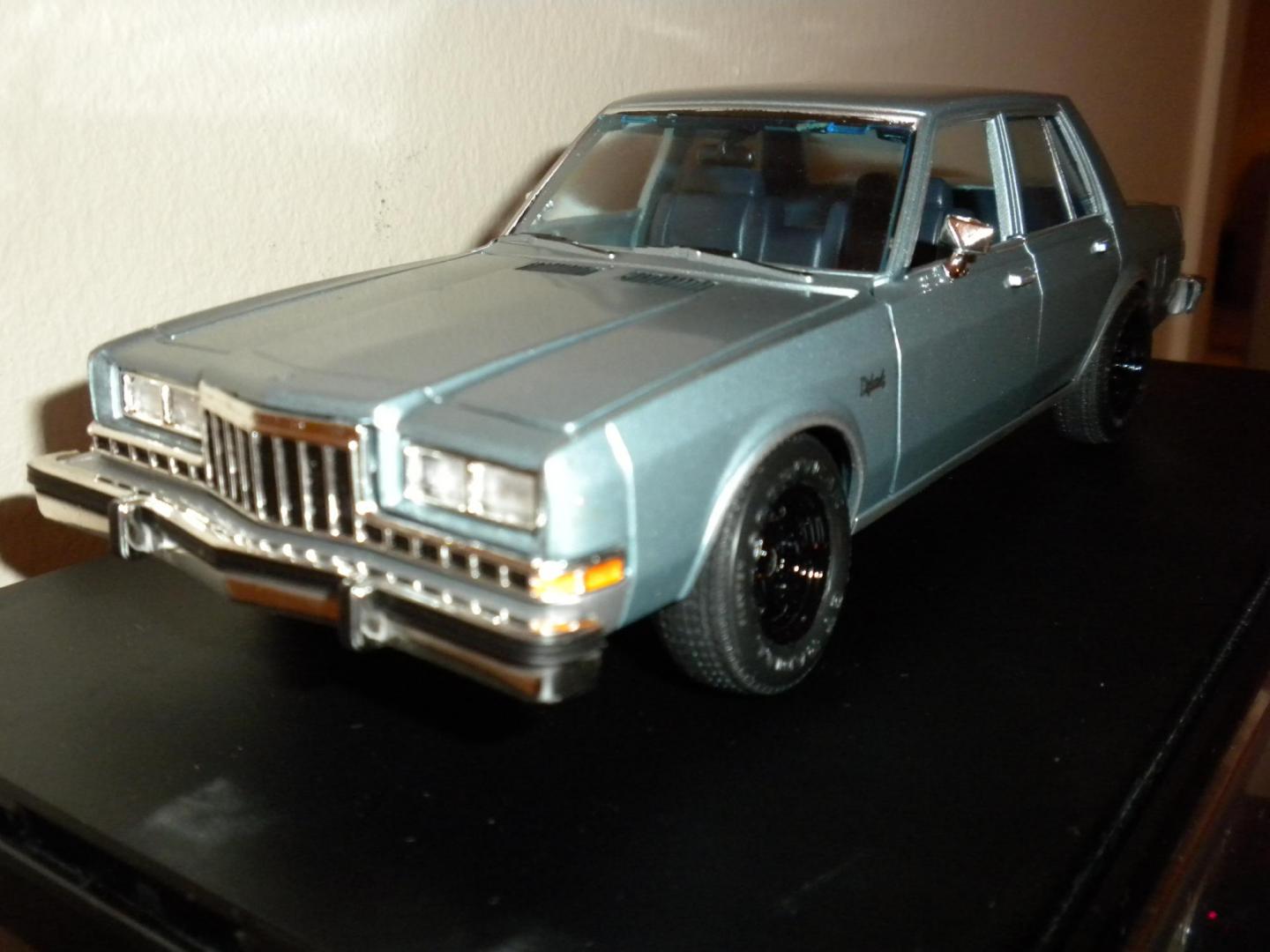

...this would be the Motor Max model combined with 1:25th AMT '65 GTO Rally I wheels, and then combined with chrome plated hand cast resin Modelhaus MPC '77 Fury poverty caps.  The ventilation holes on the hubcaps were reproduced by hand, while other modest things that can be made out are the urethane bumper fill panels painted silver on this light blue metallic replica.  The tires are 1:24th Monogram Goodyear GT Radials mostly seen within the space of their '70 Challenger T/A release.  The tires have to be filed to expand the center diameter a bit, but otherwise work well on this application.

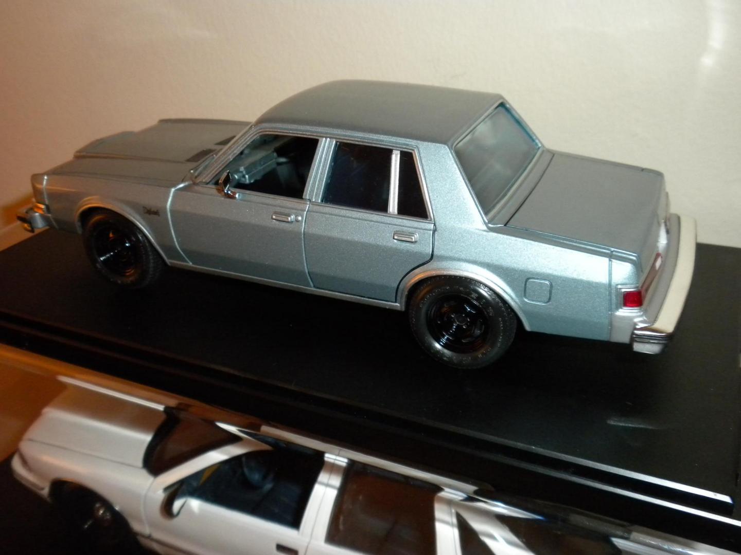

...looking hardly different, this would be the same model fitted out with Monogram '70 Roadrunner optional police six-slot pressed steel wheels with the same hubcaps as before.  Wishing to reproduce the brushed finish on the center of each cap, I employed a cotton swab and silver paint and spun each assembly before applying a small amount of half-dried color.  Further, some panel lines were made a bit more prominent for an application of black wash.

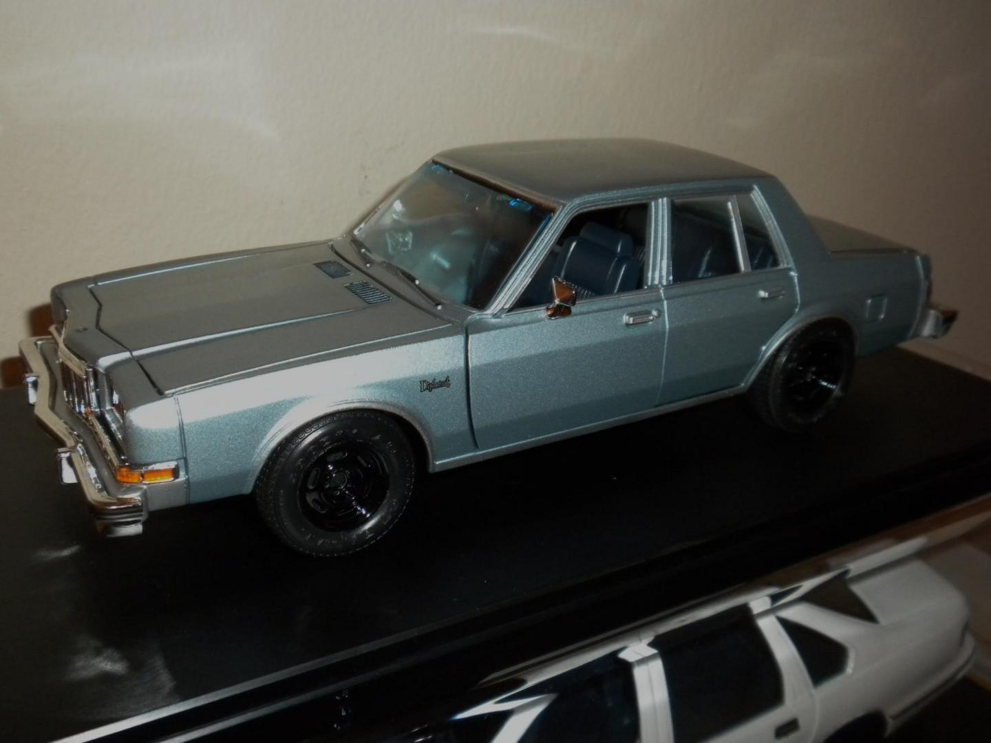

...this would be the new wheels in place on the new Diplomat model.  All will be removed to paint the brakes discs and drums.  Note the tinted glass with the sunscreen just visible here, whereas the side indicator lamps up front have been touched it to ensure they'll be a bit more prominent.  Though well nigh invisible, the navy blue 1:1 vinyl interior refinish spray has been used hear and reflects back a nice semi-gloss tone.

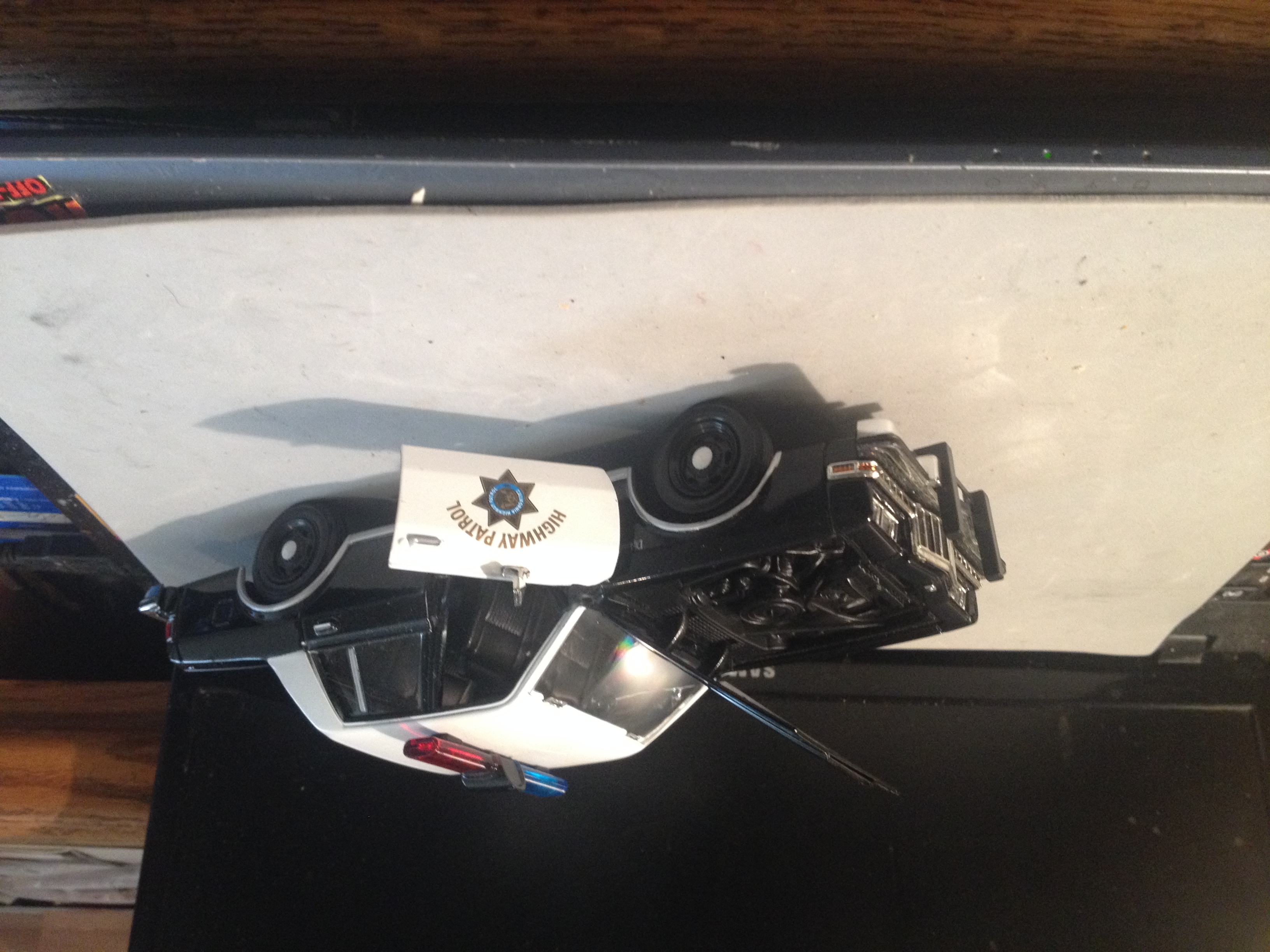

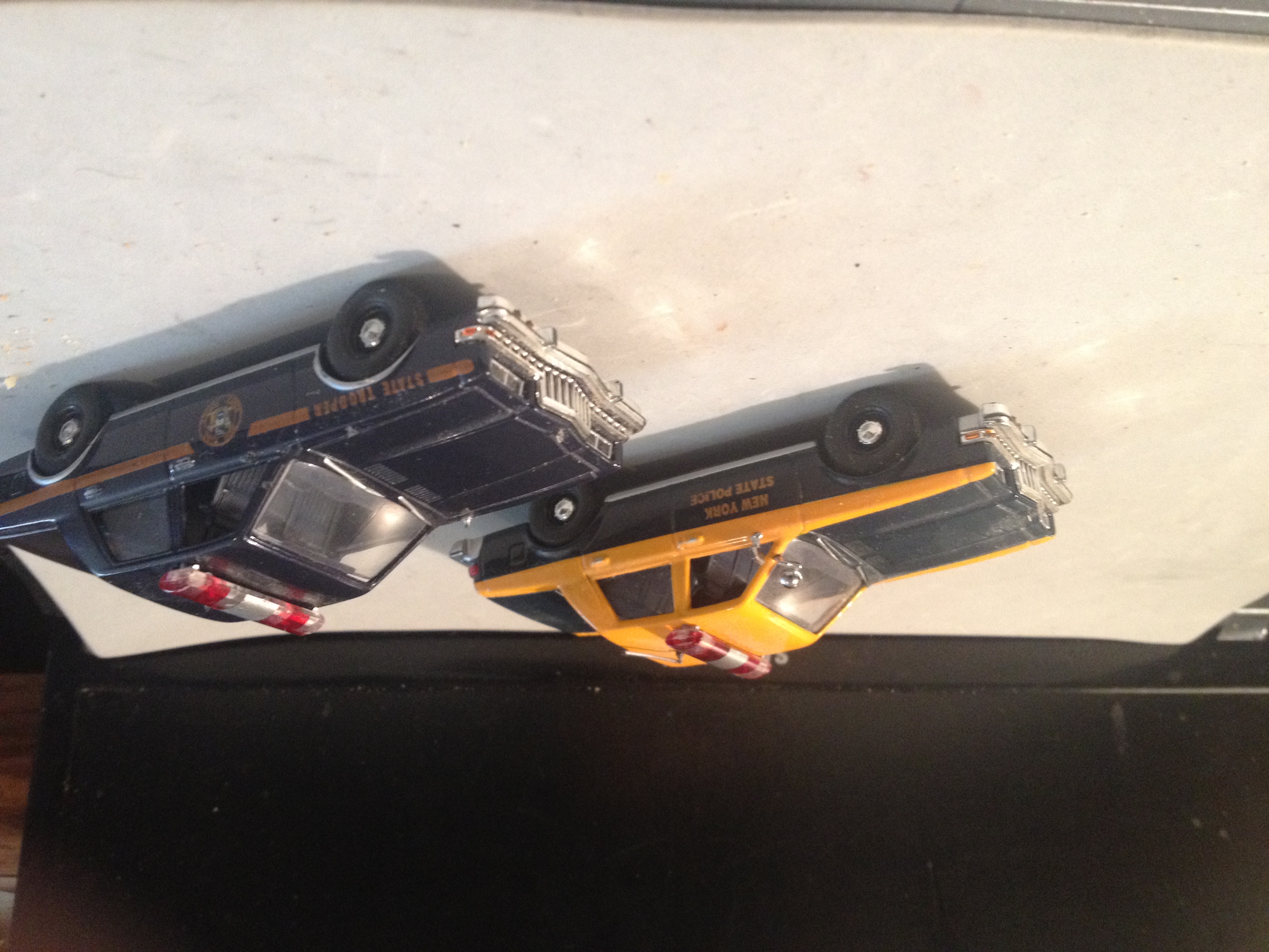

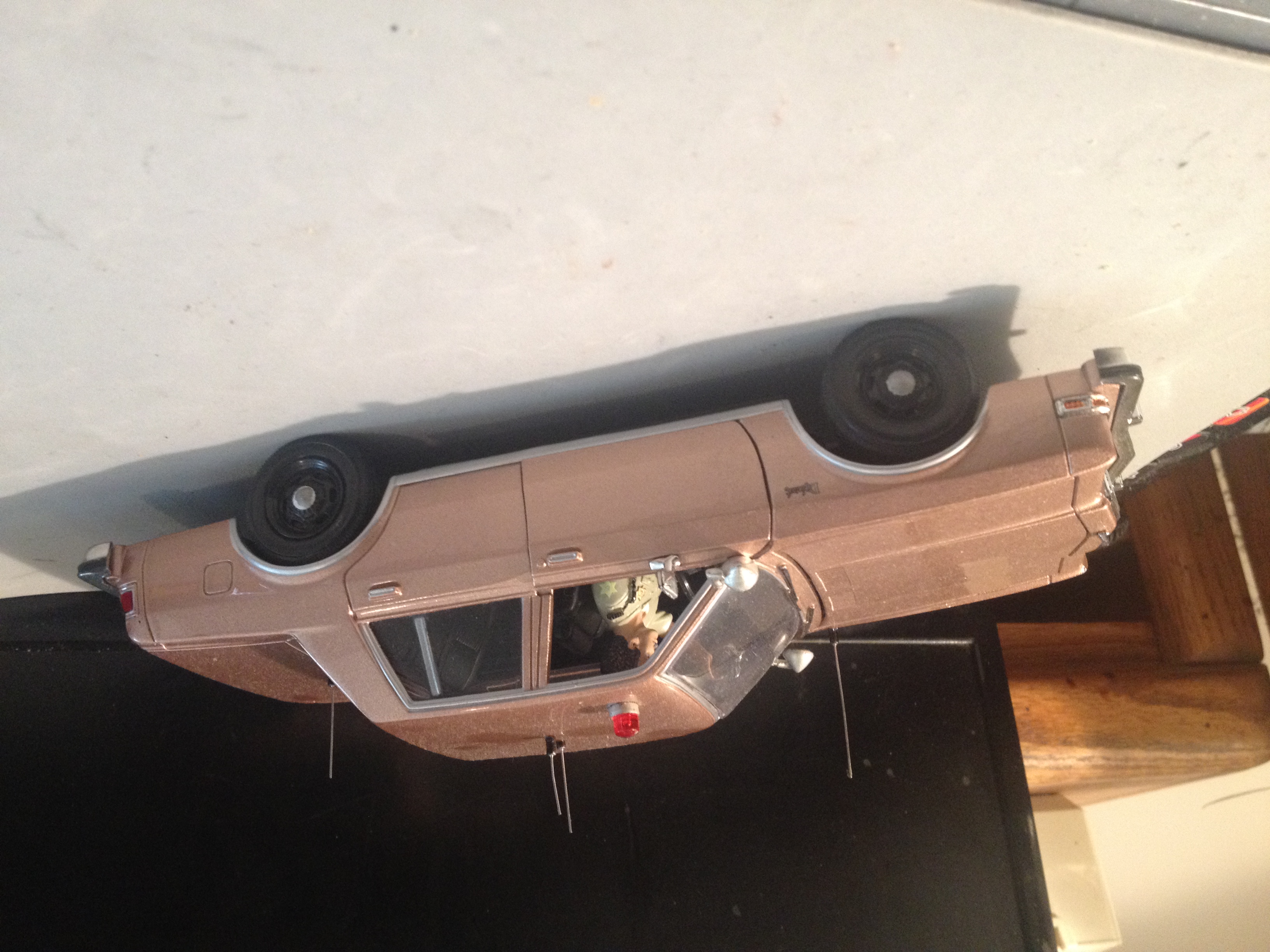

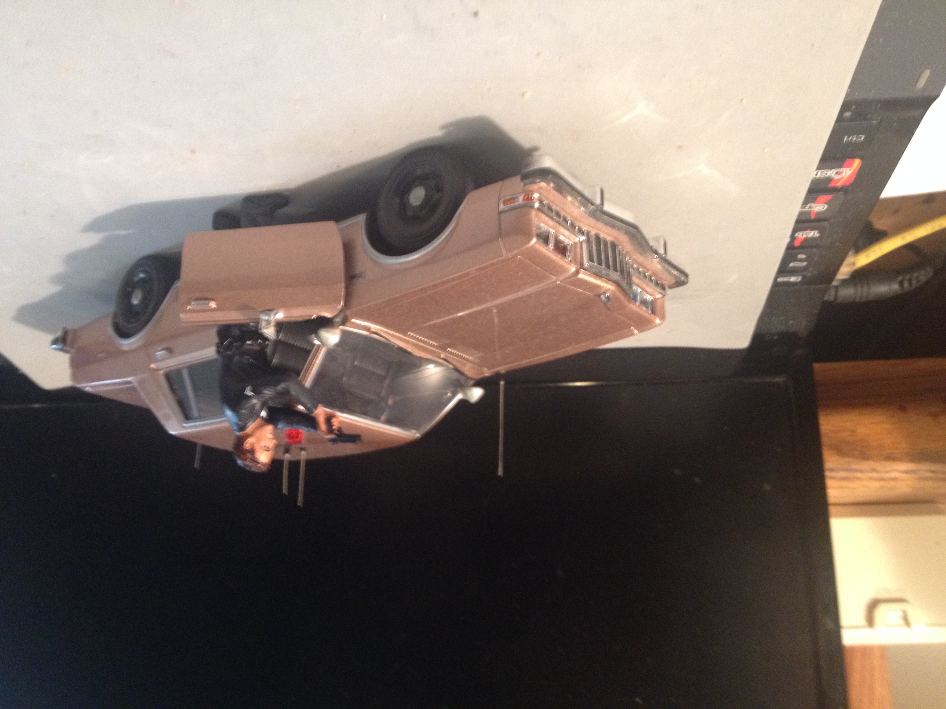

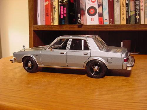

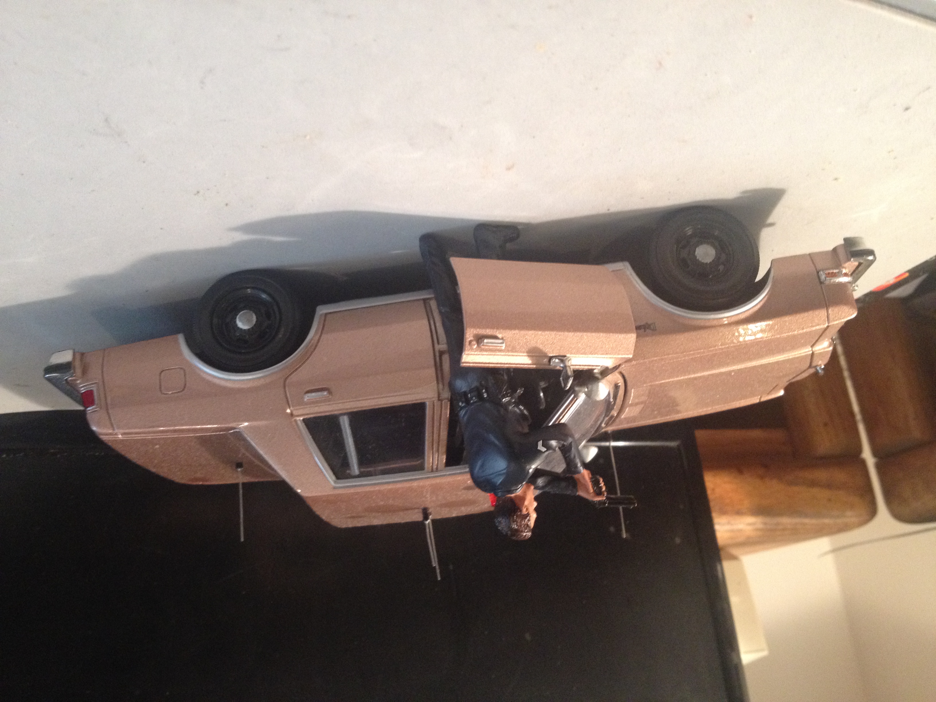

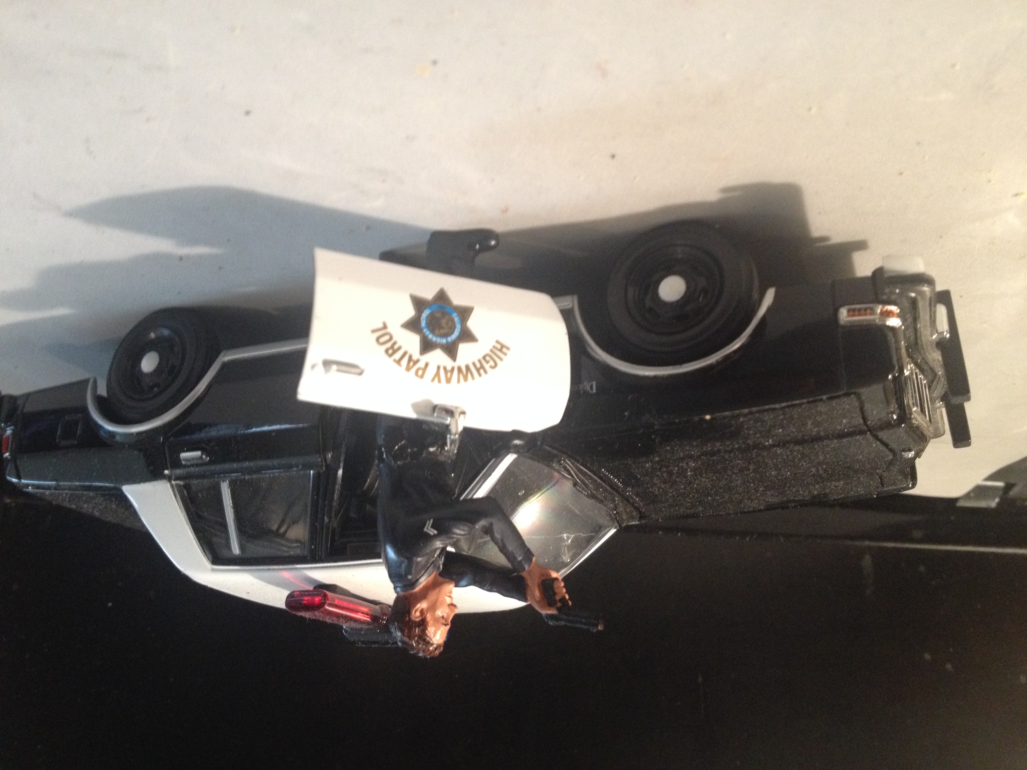

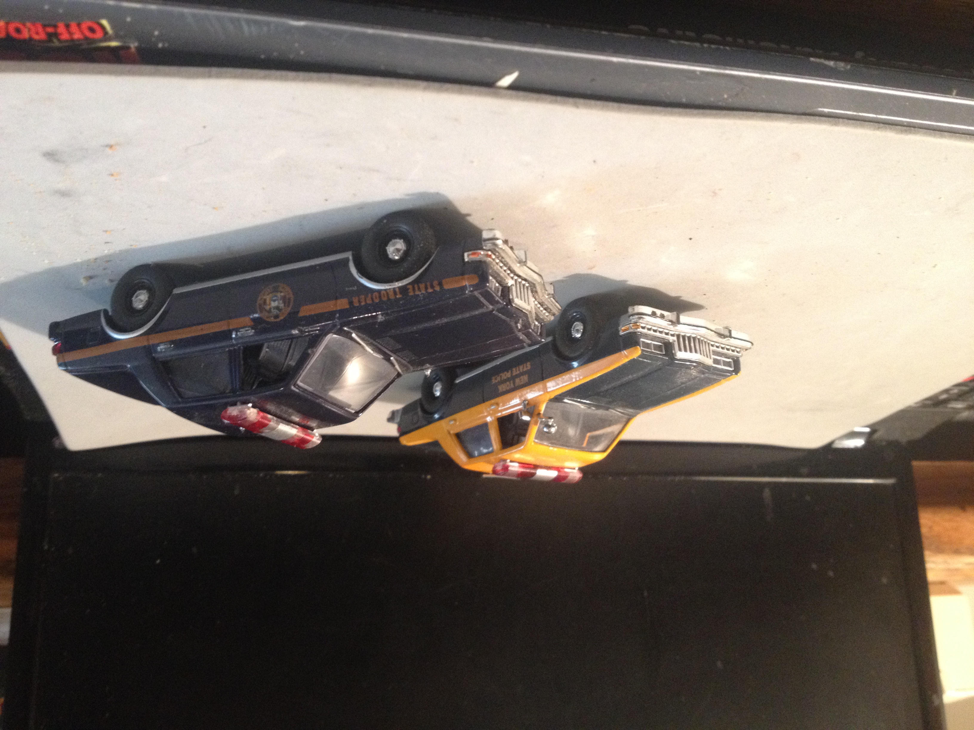

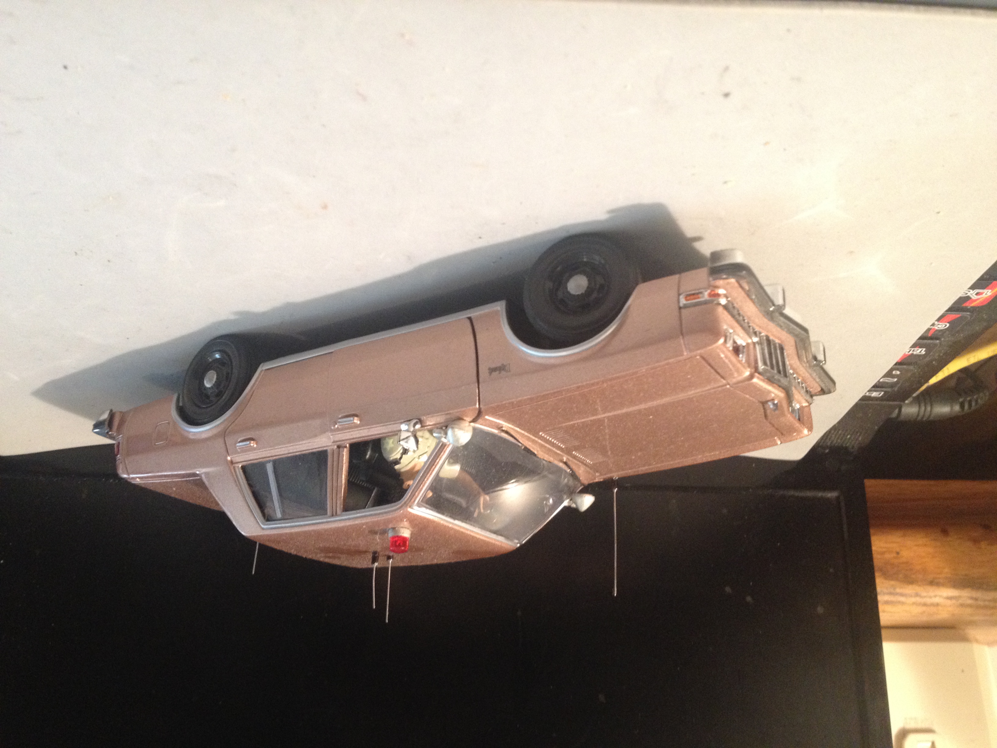

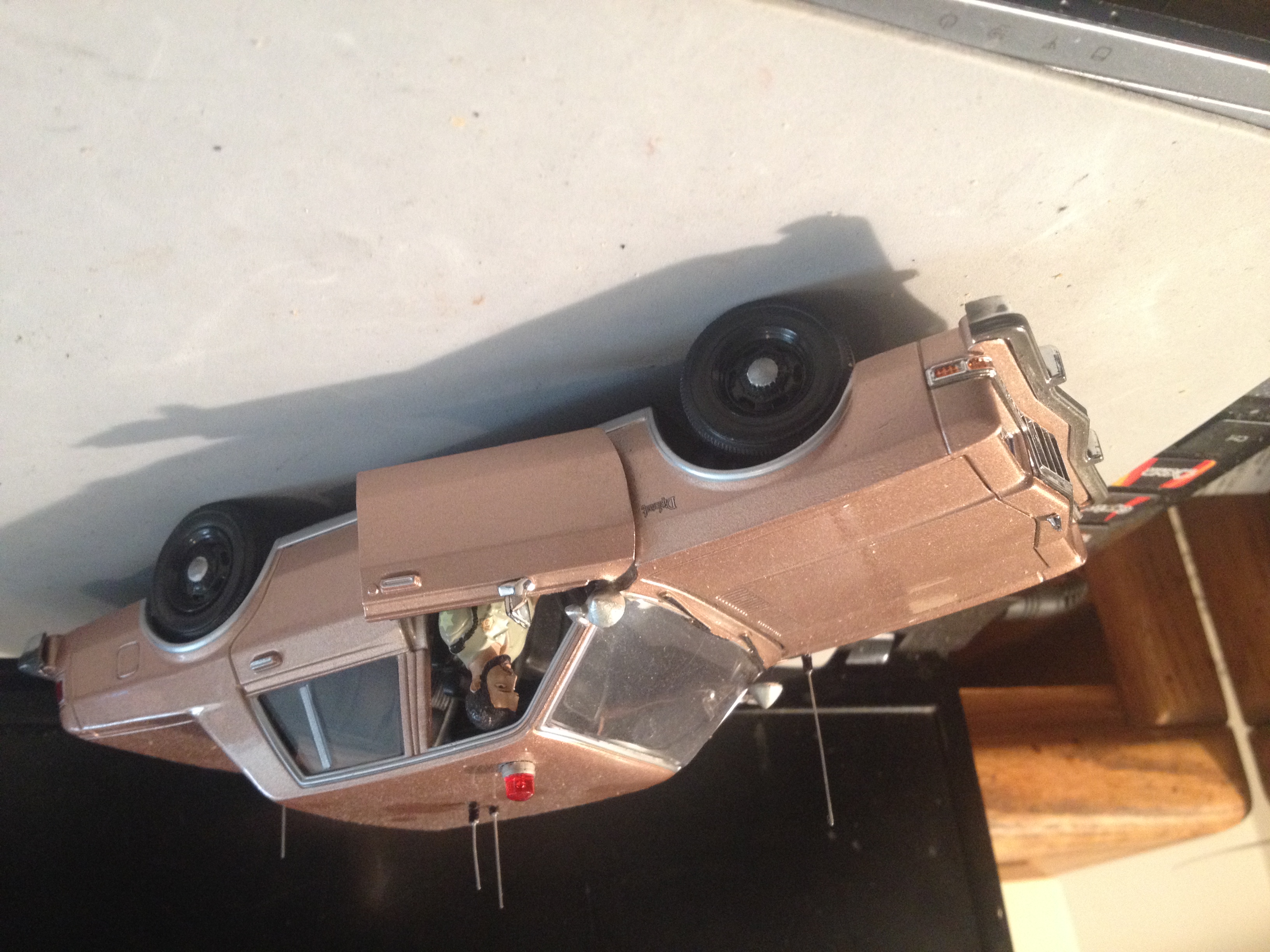

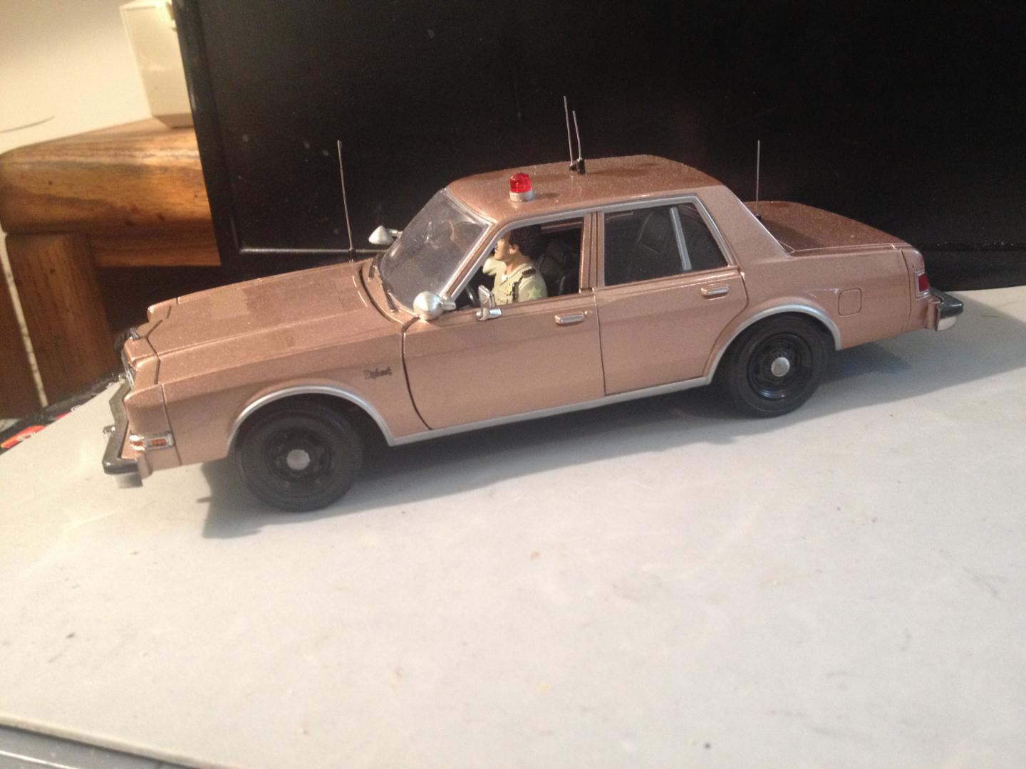

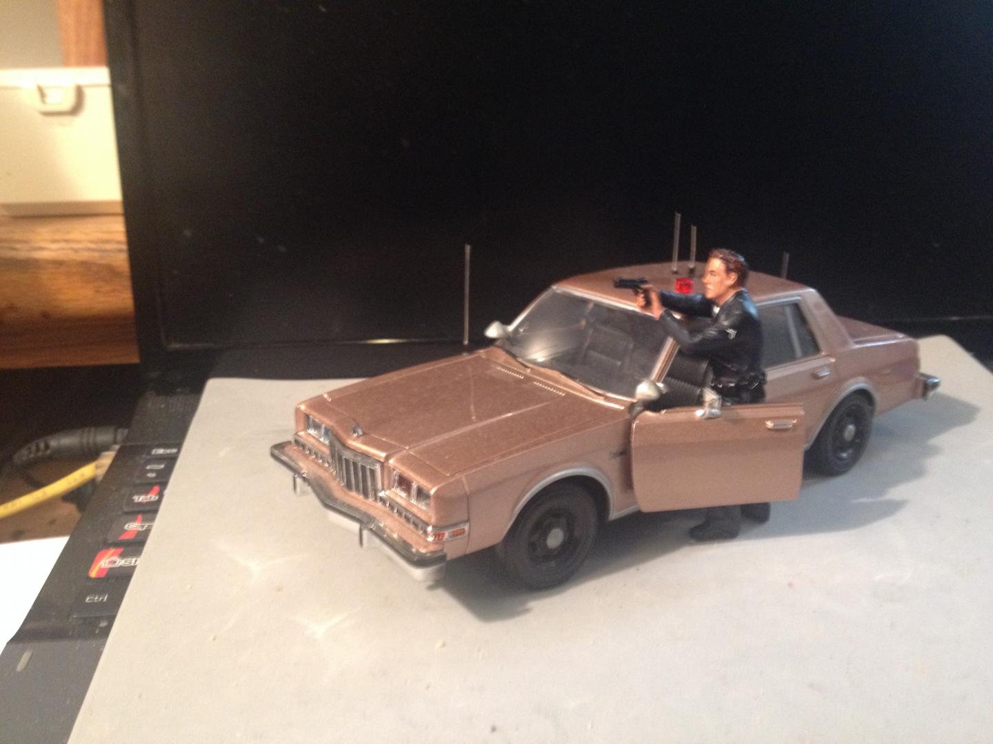

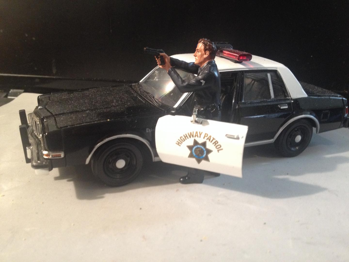

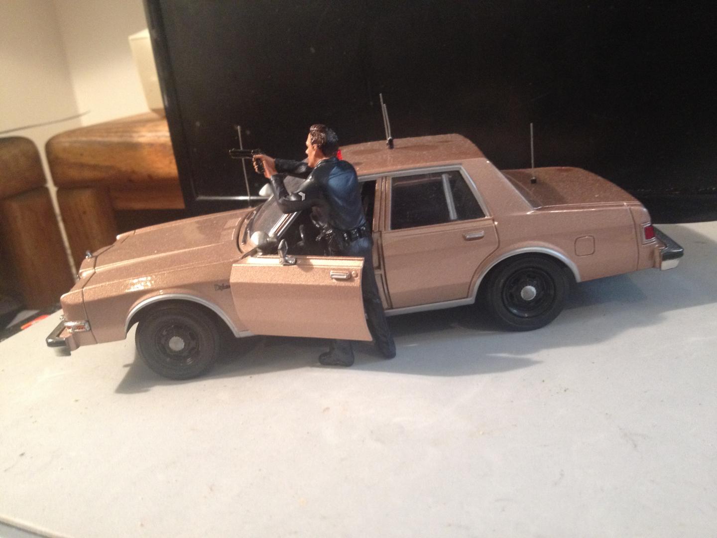

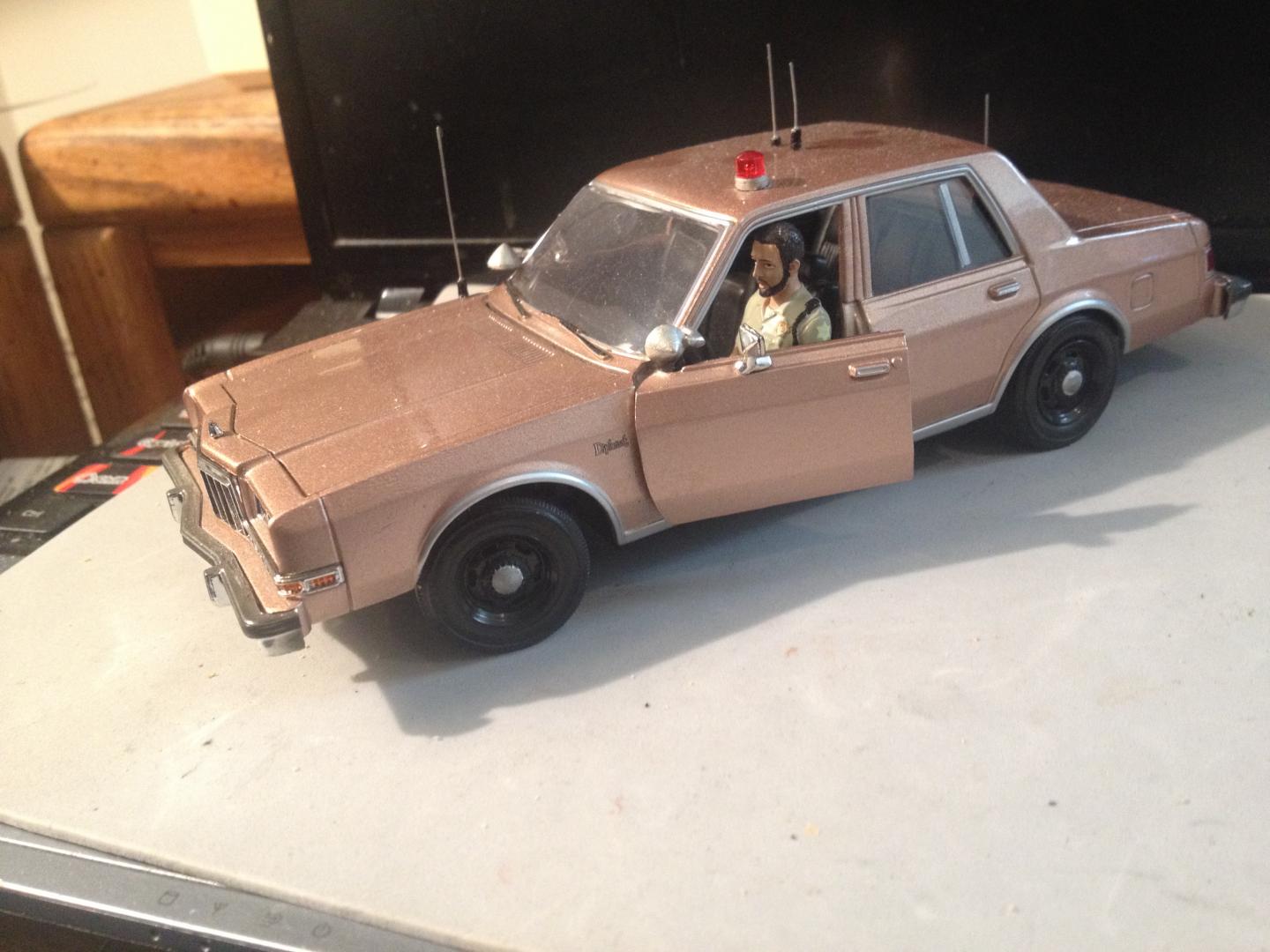

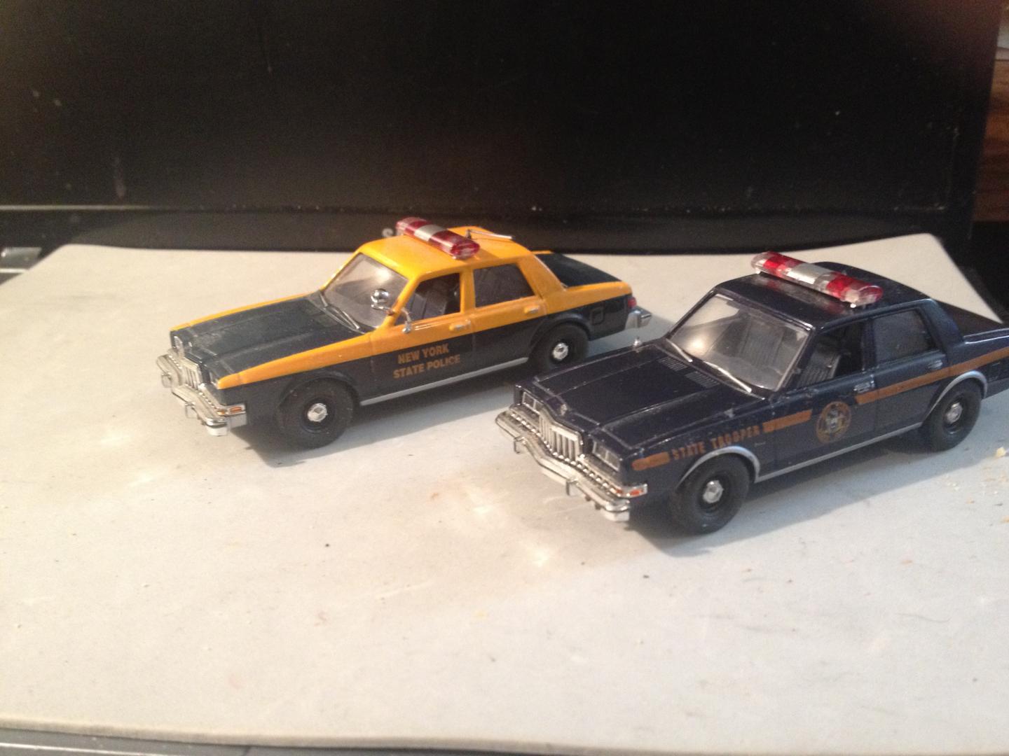

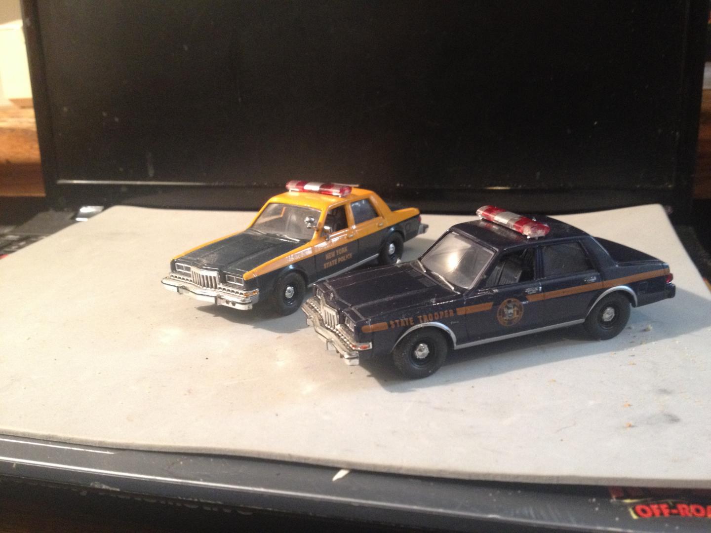

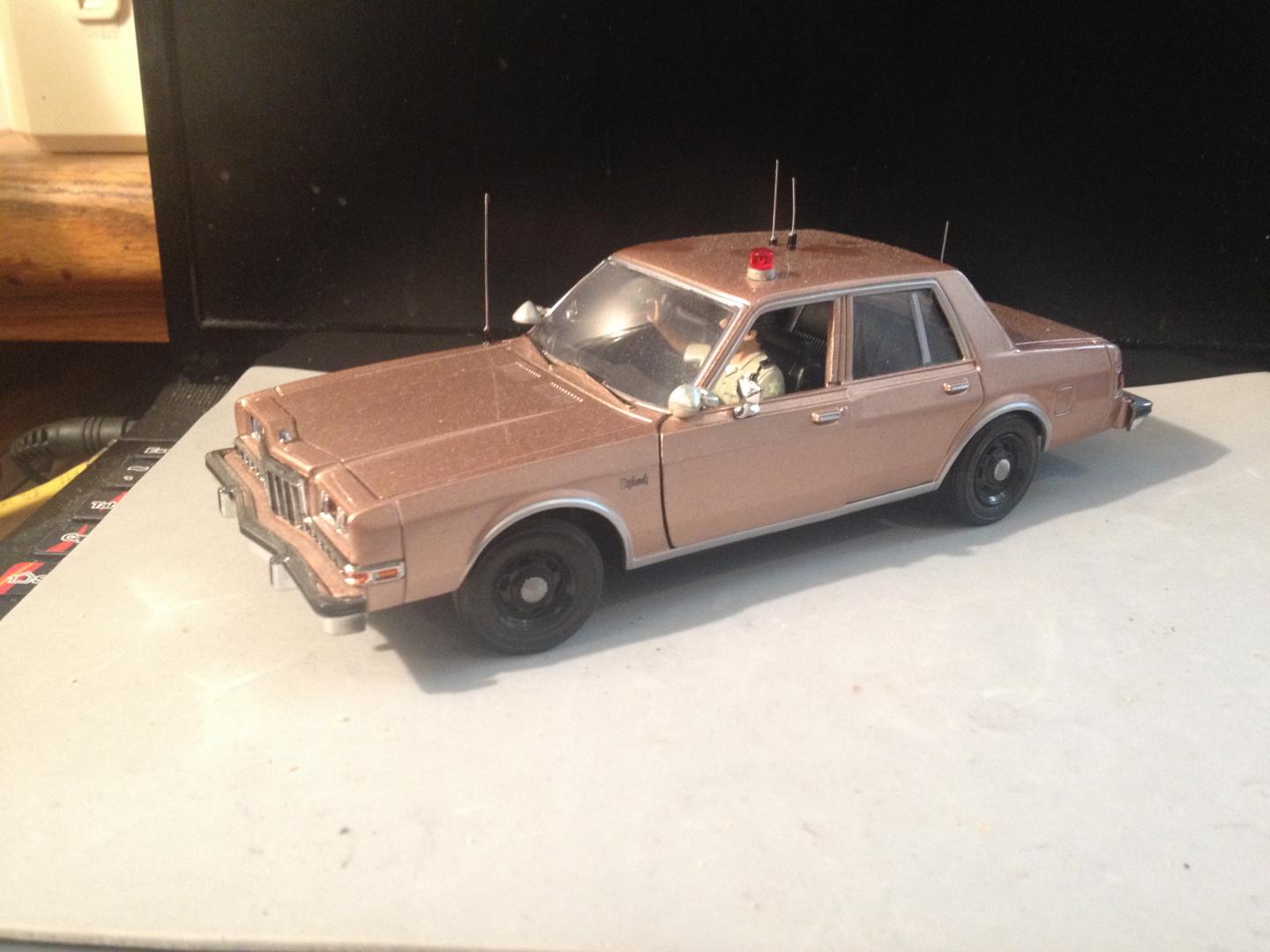

image.thumb.jpeg.0ca2e658229eabf384da327Ah,you hit a soft spot in my favorite types of PO-PO,? cars.The good ole'Dodge Diplomat.I have a small collefction of different kinds,and scales of police cars.Some marked,some unmarked.Here are a few of the Diplomats in my collection.I added a few details,such as some antennas,along with some different police officers inside their cars,doing some paperwork.While other are drawing their guns out of their cars.

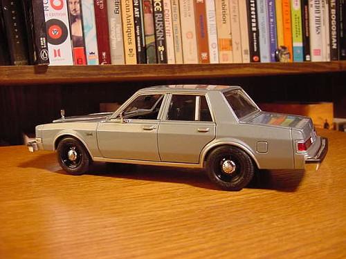

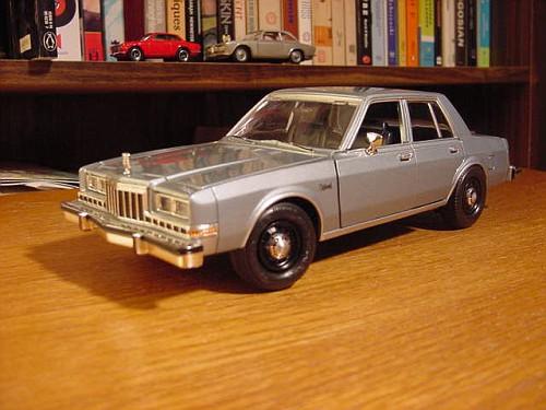

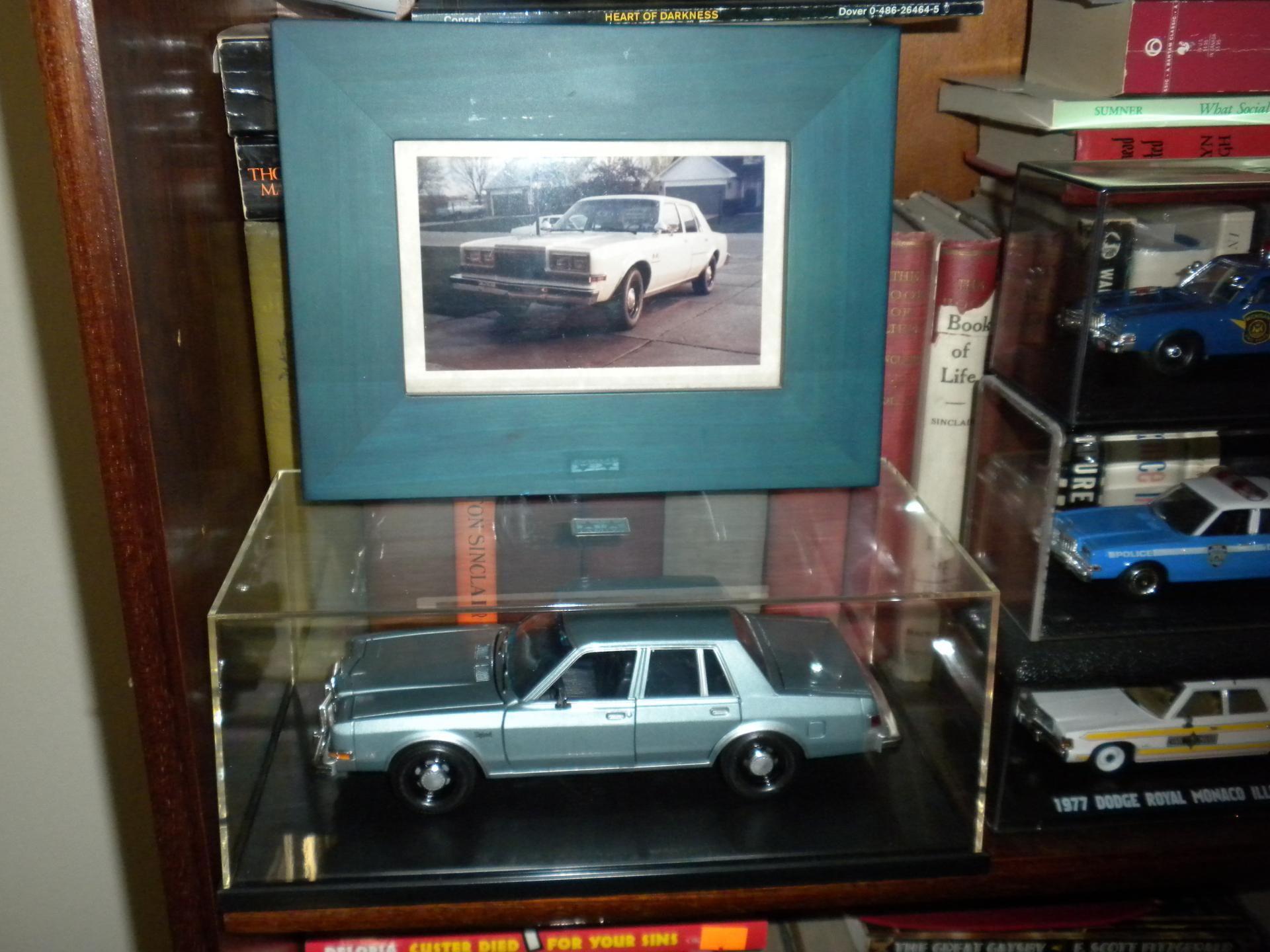

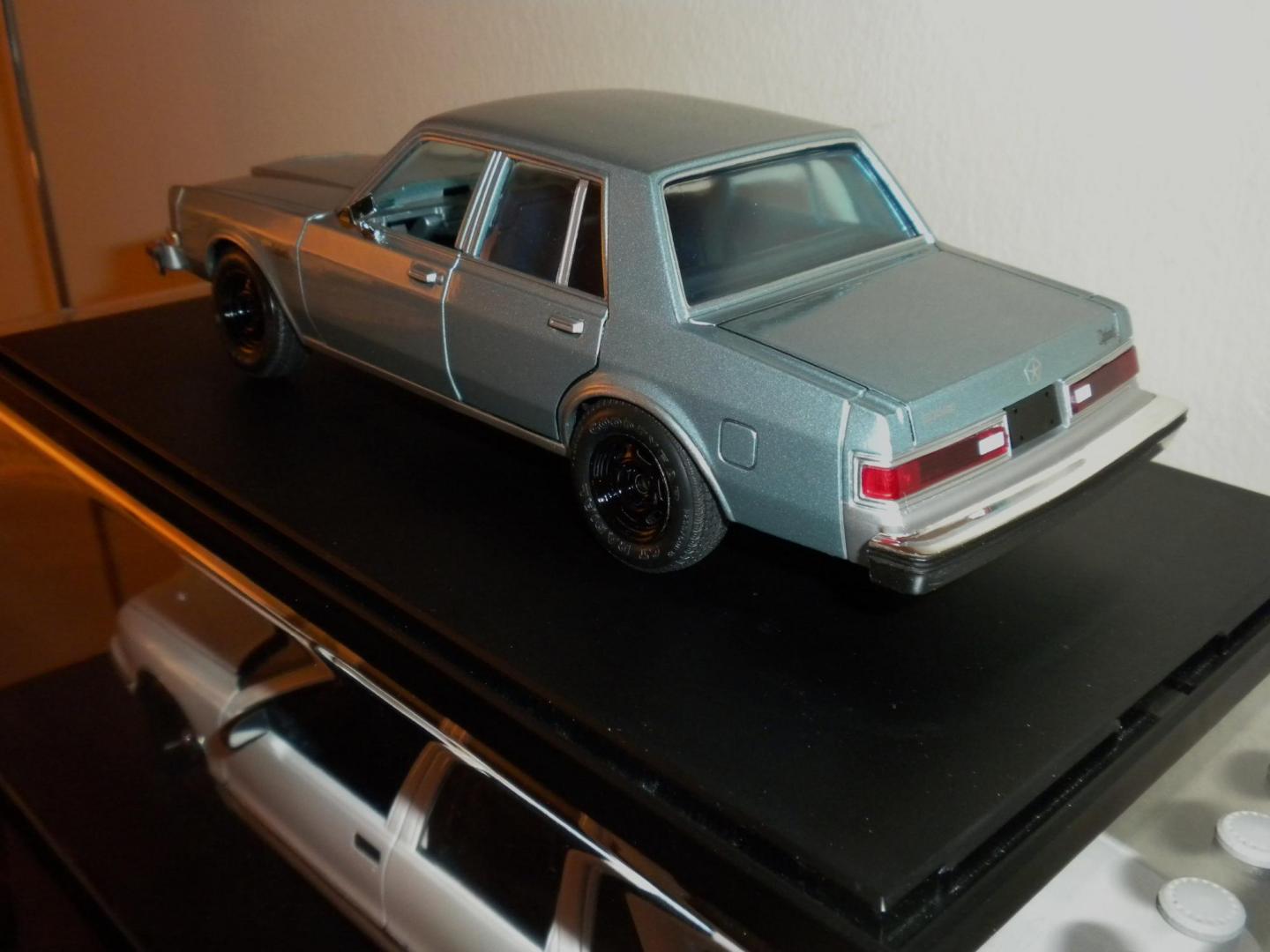

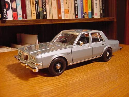

Very neat!  Thanks for the kind comments and interest displayed.  Since I last posted combined the resin wheel covers with the resin wheels, although after doing so it seemed that the caps stuck out a bit more than I'd desire.  Absent the hub caps, the resin pressed steel six-slot wheels are really outstanding, but maybe less so with the caps in place.  I ended up removing the resin wheels and substituting in the Monogram '70 Roadrunner wheels and combining these with drilled ventilation hole Police-spec hubcaps that I sent to a vacuum chroming outfit to come up with what seemed the best compromise.  I'll attach a photo or two to this post in a week or so, taking care to also include a shot of my then-prized 1983 A38 Plymouth Gran Fury with was equipped with everything but the accessory oil cooler; i.e. 4BBL 318, light blue silicone hoses, the small oil pressure gauge, the 125 mph instrument cluster, as well as what factory stereo equipment could be retrofitted from the then common Fifth Avenue iteration of the venerable M-body.  Oh - and yes, it did have twin functional spotlights as well as the disc-style interior roof light!  Again, flattered I am to notice this thread resurrected...
Diplomat_1.thumb.JPG.a61c98185e370de85aa
Diplomat_6.thumb.JPG.32695f8d3a1613402a5
