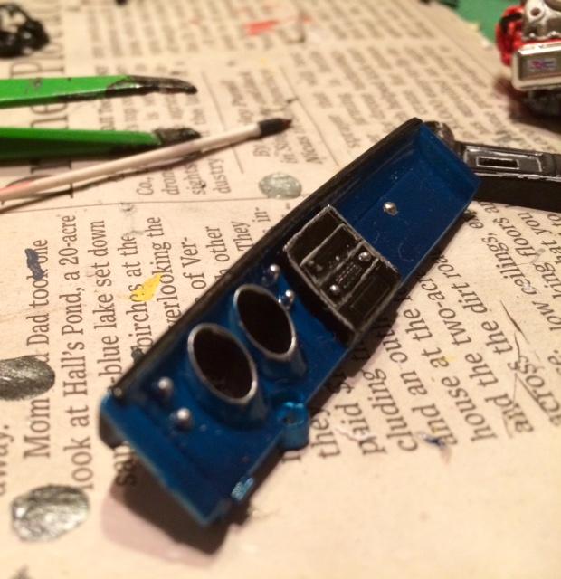

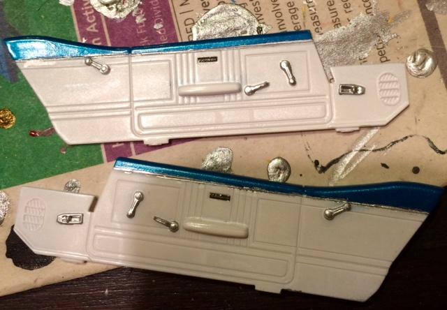

To really make it "pop," I've seen some early Camaros that had the tops of the inner doors and the dashboard face in body color.  With this deep turquoise, it was a definite.  I've painted and detailed them.  I have the Camaro emblems on the doors, put the radio decal into the dash and put the gauge decals on the glass piece, but haven't glued those in yet.  Also painted up the console and added the auxiliary gauge decal

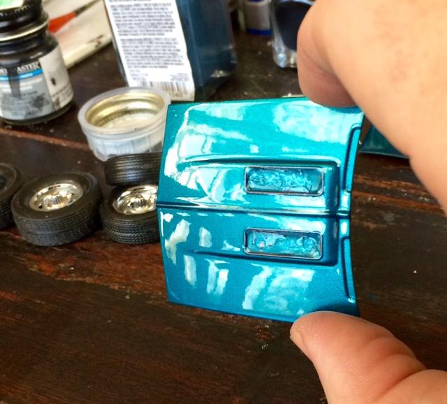

However, I also had an unfortunate event.  Remember, this is the hood that got ruined in my BOD Camaro build, but was salvaged.  I had submitted a part request, and received my replacement hood two days ago, however, as I no longer needed it, I was about to throw it away.  But, last night I decided to go ahead and insert the hood vents, just to get as much of the body work done as possible and not handle it until final assembly.  I glued them in using Loctite Gel Super Glue, which I have used regularly, including on body components before with no problem.  Furthermore, this car has been painted for a full month, so there's nothing still curing.  I glued the vents in right before dinner.  A few hours later, I came back to do a couple little things before putting it away for the night, and picked up my hood.  The paint all around the hood vents was completely fried... it was now a dull haze:

Before doing anything rash, you should try taking that haze off with some polishing compound. Usually, that's just the fumes condensing on the surrounding surfaces and will buff right off.
That is looking nice Kevin and like Steve mentioned, try buffing that hood out before starting over. Also, maybe a hobby CA glue would work better?
Like Mike mentioned, I second trying to rub the hood out first before going through stripping it. If you're familiar with the polishing cloths out there (Detail Master comes to mind), you could start with the 6000 grit cloth and work up. Then polish out with a mild liquid polish. A favorite of mine is Meguiar's Car Cleaner Wax.
The only caveat I see is that since your paint is a metallic, the finish of the hood might come out a bit swirly due to "disturbing" the flakes embedded in the finish.
Also, please don't ever use CA glue on a painted finish! :o It's much better to use a five minute epoxy on bodywork so in case you mess up, you can take the epoxy off and start over. The paint job otherwise on the body looks VERY nice, and that's a good color for a '67 Camaro. ;)
Hope all this helps!
OK, first of all, THANK YOU to everyone for the suggestions... I've begun painting another hood, but I will attempt to polish this one out and see if I can fix it enough.  I've never had that glue do anything like that... and I've used it for rearview mirrors and other small body components where the gel keeps it from running all over the body, but I will not be using it on body parts anymore after this experience.  Also, not a lot of progress, but continuing to paint all the little pieces:

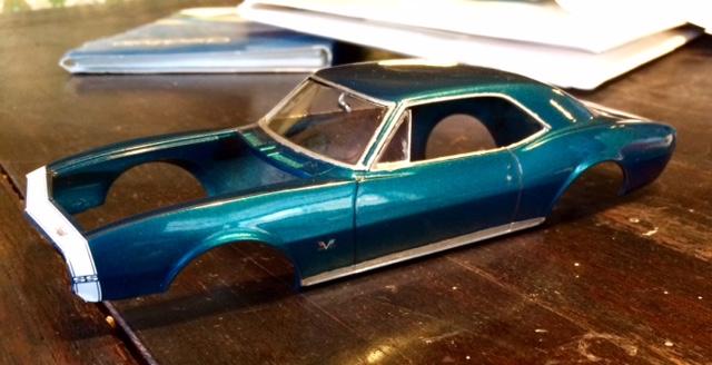

Then I got to work on finishing some small detail painting leftovers, decaled everything and started some assembly.  Got all body decals in place and installed the glass:
67_Camaro_22.thumb.jpg.681887235a3d569f4

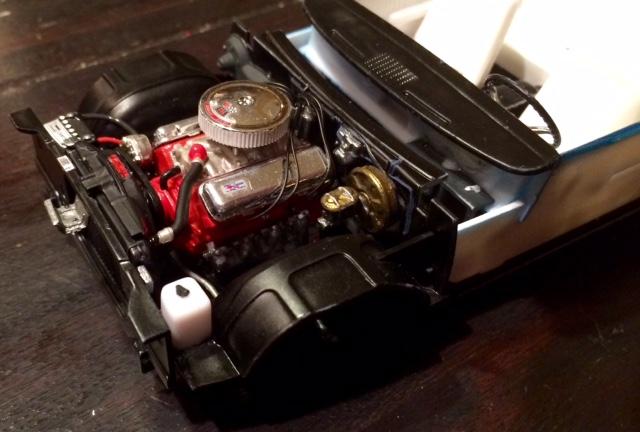

Finished and installed the engine:
67_Camaro_24.thumb.jpg.a4f7ae7d36cd5287b

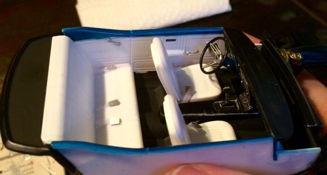

Started the interior:
67_Camaro_25.thumb.jpg.b3312d03ac8f762d7
