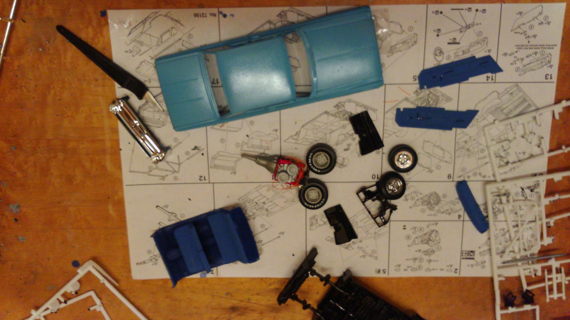

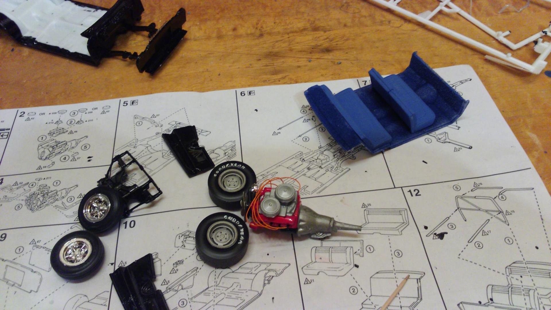

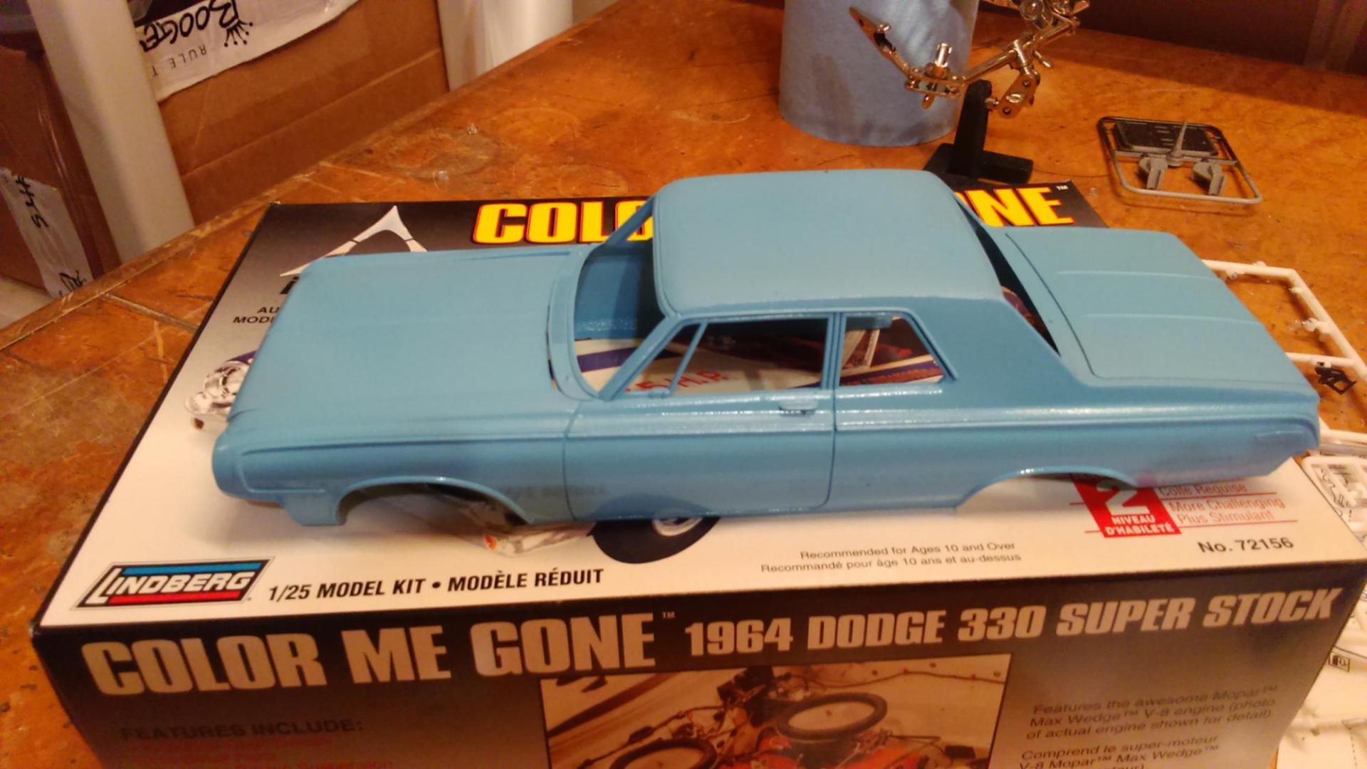

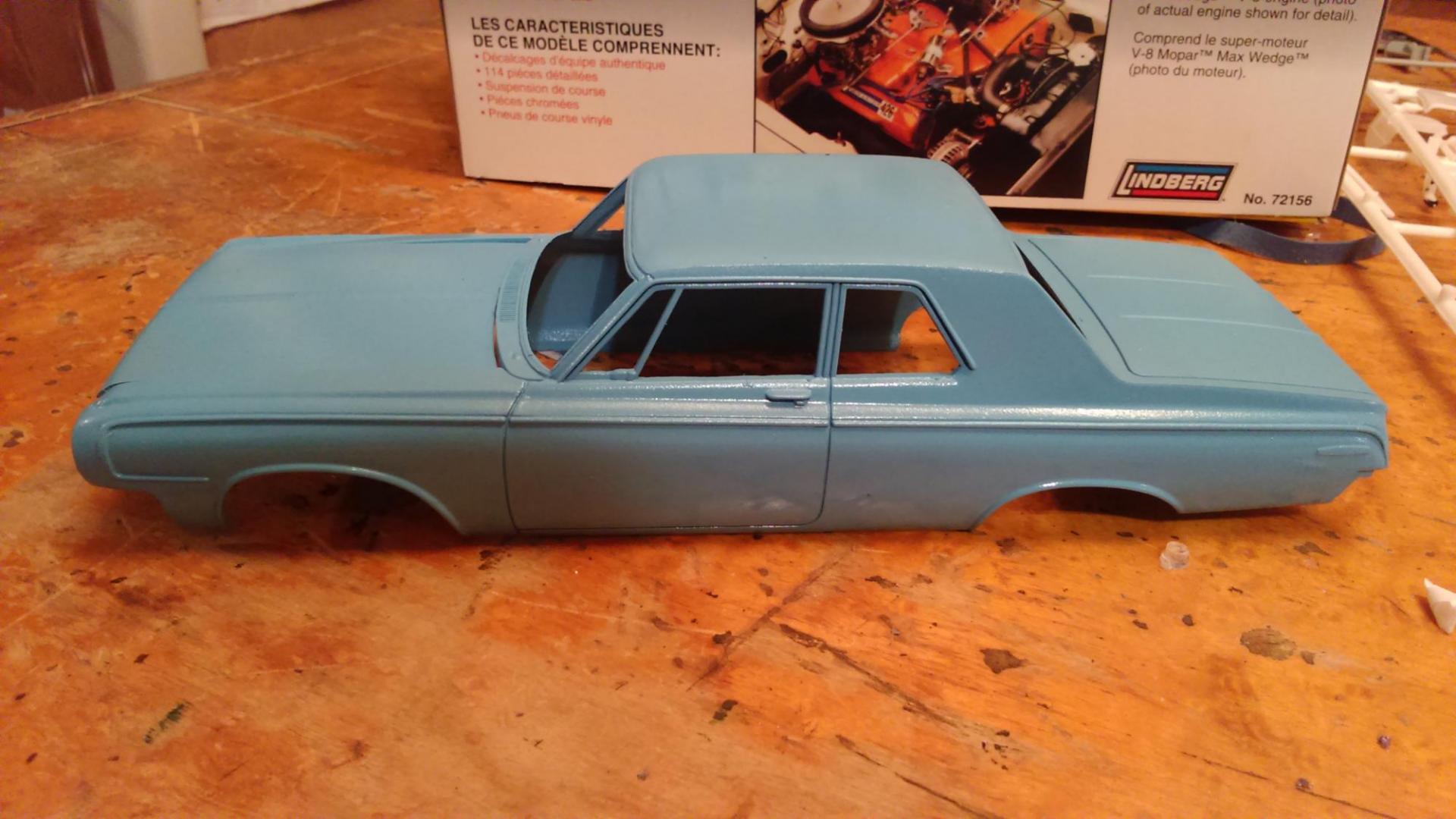

This is my first post in this forum. Kinda been holding off due to nervousness, been a long time between builds. First one in 40 years was last fall, this is the second. Building this as a street machine/bracket racer. First time using flocking, didn't turn out so good. Motor parts fit not the best. The paint looks splotchy in spots, but it is just the poor lighting in my basement.
Any comments, hints or criticisms are whole heartdly welcome.
Looks pretty good to me. Don't give up. Remember, give it your best shot and see where you have gone wrong so that you can correct those errors on your next build. We tend to be our own worst critics. I think your flocking looks darned good for a first attempt, maybe you are being a little bit to hard on yourself?
I've always loved that kit.  I'm trying to hold off until I get some builds done but you're making it difficult!!
The only thing I would advise is using semi-gloss black for the chassis instead of gloss.  Unless of course that's the look you were going for.
If that's the case, then have at it!
Realized after I should have used semi-gloss, didn't have the heart to strip it and start over.
No need to strip the gloss black paint, just give it a dust coat of semi-gloss or even flat clear.
I definately see potenial here, just keep working with what you have so far, i.e., wet sand the body and put some clear on it, you may be suprised. The engine looks nice, put a black wash on the front wheels, dull up that chassis, and I think you'll be suprised at the result. I like the colors you've used as well. :)
If the pics are any indication, I see thin areas on the tranny / drive shaft hump and the back seat deck. The beauty of flocking is, it's easy to fix if it's too much or not enough.
STEP THE FIRST: If it's too thick, sand a chisel head onto a large toothpick or ice cream stick, then scrape away any excess. Don't worry about removing too much. Use an X-Acto if you have to. That's where STEP THE SECOND comes in.
STEP THE SECOND: If it 's too thin you can build up a thin or splotchy area in no time. Simply thin some Elmer's glue with water or, use a brush-on paint of a closely matching color, then flock again. Next, tamp down the area using firm pressure and the dull flat tool of your choice. Sometimes the "non-business" end of a paint brush works. This gives the flocking a chance to soak in, as opposed to just it's own weight. Warning. This can create a high area. If this occurs, refer to STEP THE FIRST.
