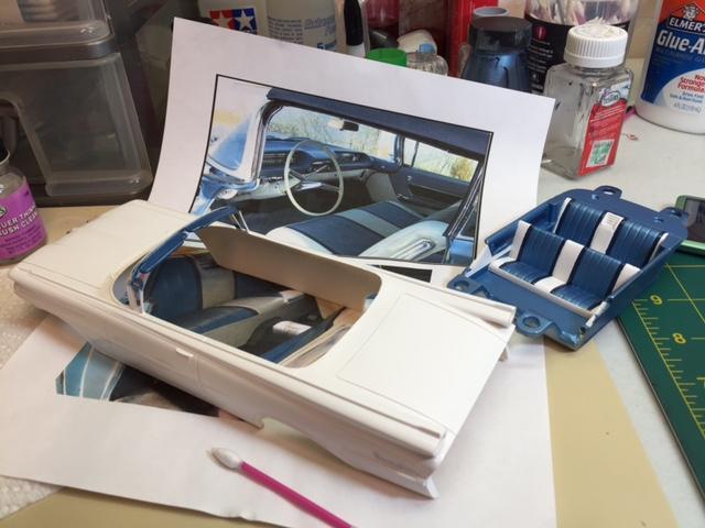

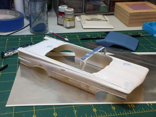

Curt Posted April 11, 2016 Posted April 11, 2016 (edited) I started this a while ago, my first resin build. I laid down a nice smooth paint job with Tamiya TS-26. I had some trouble with the tri-tone interior, so I needed to strip the paint and start over. I looked online and someone had suggested alcohol, so I soaked the tub in 91% IPA for a couple days and it cleaned up nicely. I re-did the interior paint and it turned out well. . Last week as I was starting to foil the body I noticed some paint lift. I must not have soaked the body long enough in Westley's, so I thought I'd strip it and repaint, just as I'd done with the interior. I let it soak all night in the alcohol and when I checked it in the morning it was badly warped and can't be salvaged (note the cowl and trunk).. I don't know if or when I'll be able to order a replacement from the Modelhaus. I wish I had soaked it in Westley's instead of alcohol but hindsight is 20/20. Just wanted to share this in case it can keep someone else from making the same error. Edited April 11, 2016 by Curt wording

Curt Posted April 12, 2016 Author Posted April 12, 2016 "If it's any consolation, the interior looks terrific".Thanks, Steve. That is a real compliment considering how much I have admired the interiors of your builds. Hopefully I will get to use this one some time in the future. ?
