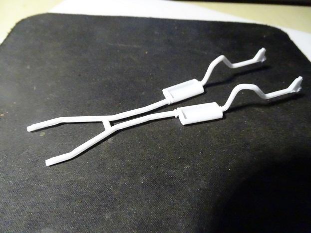

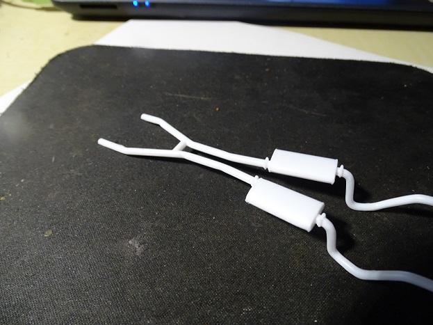

Jon Haigwood Posted May 23, 2016 Posted May 23, 2016 I have a few 64 Mopars that need some exhaust systems made up. I have been trying to make some mufflers up from aluminum tubing and have had fair success at best. My next thought that maybe I could duplicate the muffler set from the Revell 68 Charger. If I can duplicate it from the front to the back of the mufflers I can make it work on most my current builds. My question is what would would be the best way to make molds of the front pipes to the back of the mufflers resin casting ? Keep in mind I have never tried any resin casting.

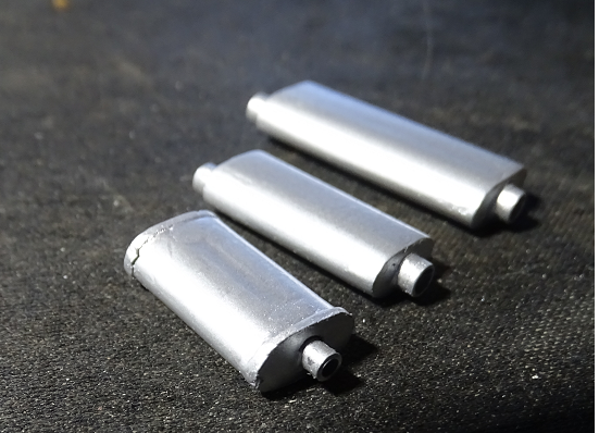

Jon Haigwood Posted May 24, 2016 Author Posted May 24, 2016 Another way to make mufflers... cut some large aluminum tubing to length, then carefully flatten the tube to oval shape by placing a small piece of wood on the tubing and then gently tapping with a small hammer. Don't go too far, you want to get an oval cross-section, but don't want to totally flatten the tubing. Muffler ends made of styrene sheet, drilled to accept solder pipes. Smaller diameter aluminum tube cut to short lengths and slipped over the ends of the solder pipes to create the open exhaust tips.I don't see the advantage of making the pipes by using styrene tubing with brass rod inserted into it when solder alone can be bent easily and will hold its shape just fine... yet is soft/bendable enough to allow you to fine tune the fit easily.The three in the picture was using aluminium tubing gently tapped down until I achieved a desired shape. Went thru 3 different sizes of tube until I achieved the desired size and shape. Top two I used smaller tubing for the end pipes and filled them with a super glue baby powder mix and filed/sanded to get a flat end. These did not have the ribbed end I wanted so on the bottom one I used pieces of an old credit card.The only styrene I had was .040" thick. I think if I can get something about .020" it should look better.
