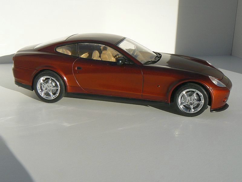

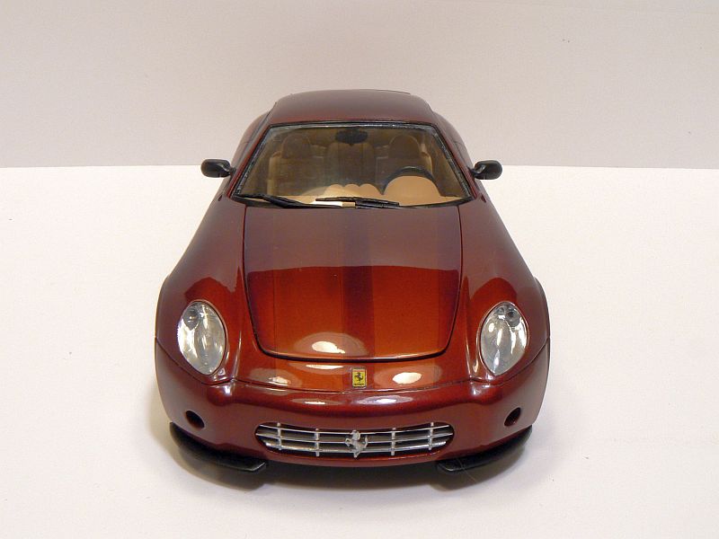

Michael, did you consider House Of Kolors Root Beer? I've used it, and it's a great color, but I'm not sure how close it is to what you're wanting, here's a couple of pics of it. This is over a Copper base, with Silver for the stripes and side coves.
Mike,  I did look at the House Of Kolors Root Beer but it's a candy color and doesn't appear quite brown enough.
The color I chose, 1966 Cadillac Autumn Rust, is a metallic and more brown in appearance.  In the sun it appears more golden brown like a root beer color.  This color is almost spot on to the color of the 1:1 car.
If you look at the 2 pictures of the actual car I put in my first post you can see the color is more brown and is a metallic not a candy.
BTW, the House Of Kolor Root Beer on your Ferrari is beautiful!

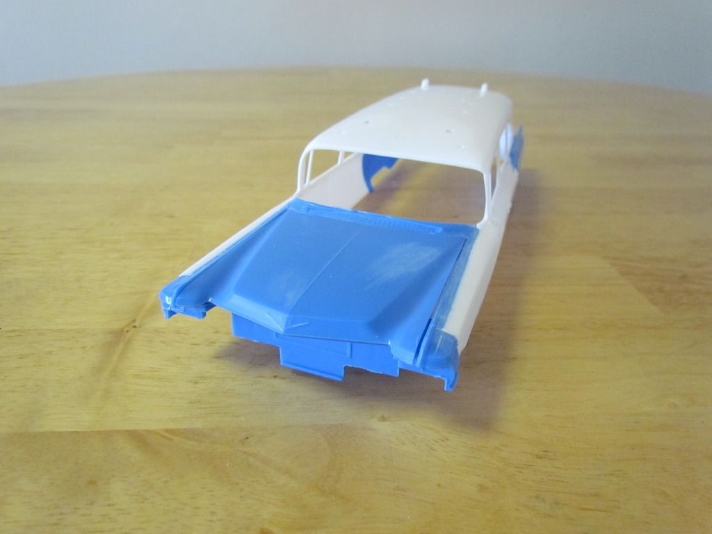

The body of a 1964 Cadillac Ambulance has a taper.  It widens at the doors after the A-Pillar(as Brian Austin mentioned earlier).  The Polar Lights Ecto-1 body doesn't have the taper. I narrowed the front fenders and added the taper to the front doors.  I checked reference pictures and feel it looks more correct now.
I widened the front(Jo-Han) section of the chassis to blend in with the rear Polar Lights chassis.  The front of the inner fender wells were cut off and extended to meet the radiator support which is how they are in a '64 Cadillac ambulance.
Since I removed the front of the PL chassis I decided to use the fender wells for the rear of the chassis to close it up.  It may not be 100% correct but I think it looks more complete this way instead of having no rear fender wells.
I still have to add the rear window pillars and the trim moldings which I should get to in the next few days.
Thanks for looking in!
Mike.

I forgot to include this picture in the post above.  I shortened the front doors by re-scribing the seam between the doors about 2 mm forward.  The front doors on the Polar Lights Ecto-1 are too long for a 'Superior Coach' ambulance.  I believe the Miller-Meteor ambulances, that the Ecto-1 was based on had longer front doors.
Mike.
