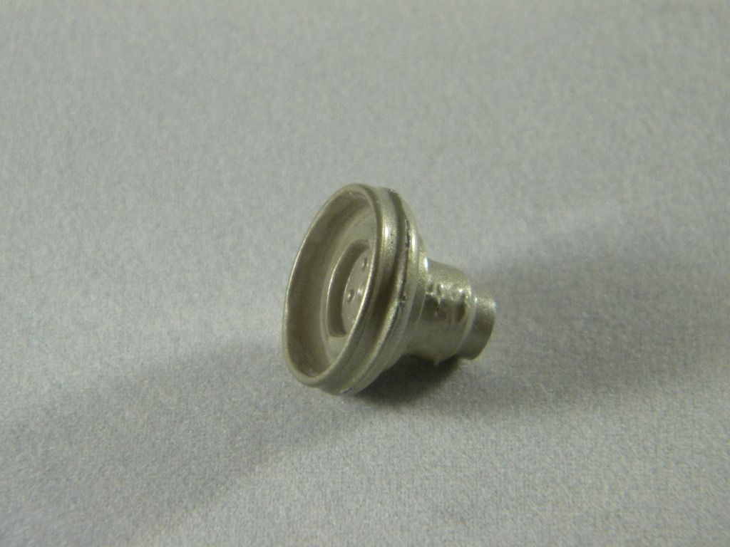

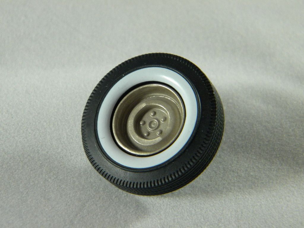

I will tell you though, if you have the type of wheels that were common on many of the early 60s kits that have a flange on the outside, the AMT tires just pop right on.
These wheels are from an AMT '60 Merc.
Steve
