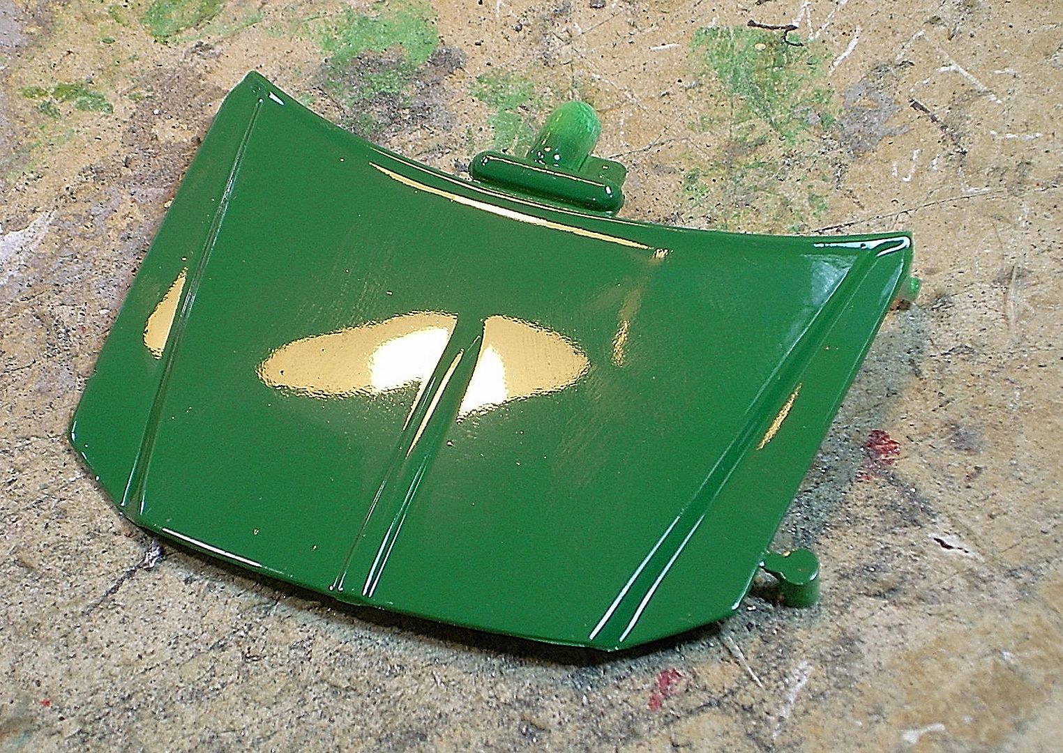

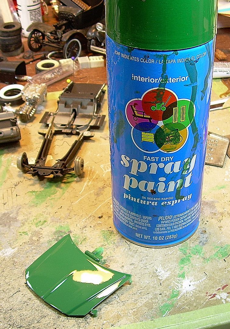

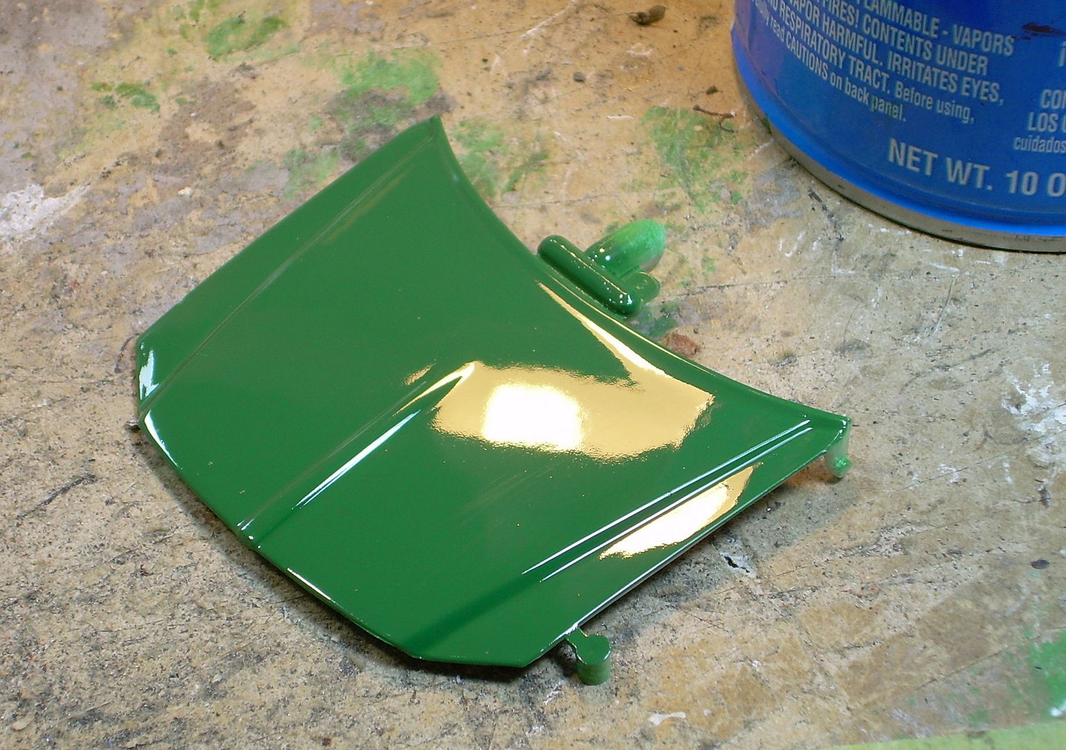

Ace-Garageguy Posted July 17, 2016 Posted July 17, 2016 (edited) I bought several cans of this ultra-cheapo stuff several years ago to do a Q&D camo job on some tarps. I had a couple cans left over and sprayed out a little color a few days back. Though the monitor may not show it, it's a pretty good match for a '51-'54 Ford commercial color I wanted to do a pickup in, and certainly close enough to represent a repaint. The bare plastic was scuffed with a generic Comet equivalent, washed with 70% iso, and then received 4 coats of paint at about 15 minute intervals. It was slicker than snot initially. After drying about an hour, it still looked pretty good. After shrinking in for a couple of days, it's not as nice, but still acceptable as a starting point. A little 'grain' has showed up in it, and small particles of dust have become more visible. After almost a week, it still looks pretty much the same. As soon as the enamel smell goes almost entirely away, the plan is to wetsand it and polish. We'll see how she looks then. Edited July 17, 2016 by Ace-Garageguy

Ace-Garageguy Posted July 17, 2016 Author Posted July 17, 2016 ...with other, better products available, why bother?In this case, I've got the stuff and it's a damm close match for a color I want for a specific project.And...lotsa modelers are, let's say...frugal when it comes to buying materials and paint. Never hurts to know something cheap that can look as good as the expensive stuff. Even top-line paints need sanding and polishing to look their best usually.

Ace-Garageguy Posted July 17, 2016 Author Posted July 17, 2016 When I'm doing a test, I usually shoot the first coat wet, as wet as I can without running it. I know this goes against the prevailing wisdom of shooting light or mist coats first, but it shows immediately if there's any chance whatsoever of a crazing problem.The enamel stink is about gone now, a little over a week after shooting it. I'm going to put it in the sun to try to harden it a little more and then sand / polish / photograph.No matter what the outcome, I'll hit the whole panel with oven cleaner and see what happens then.
